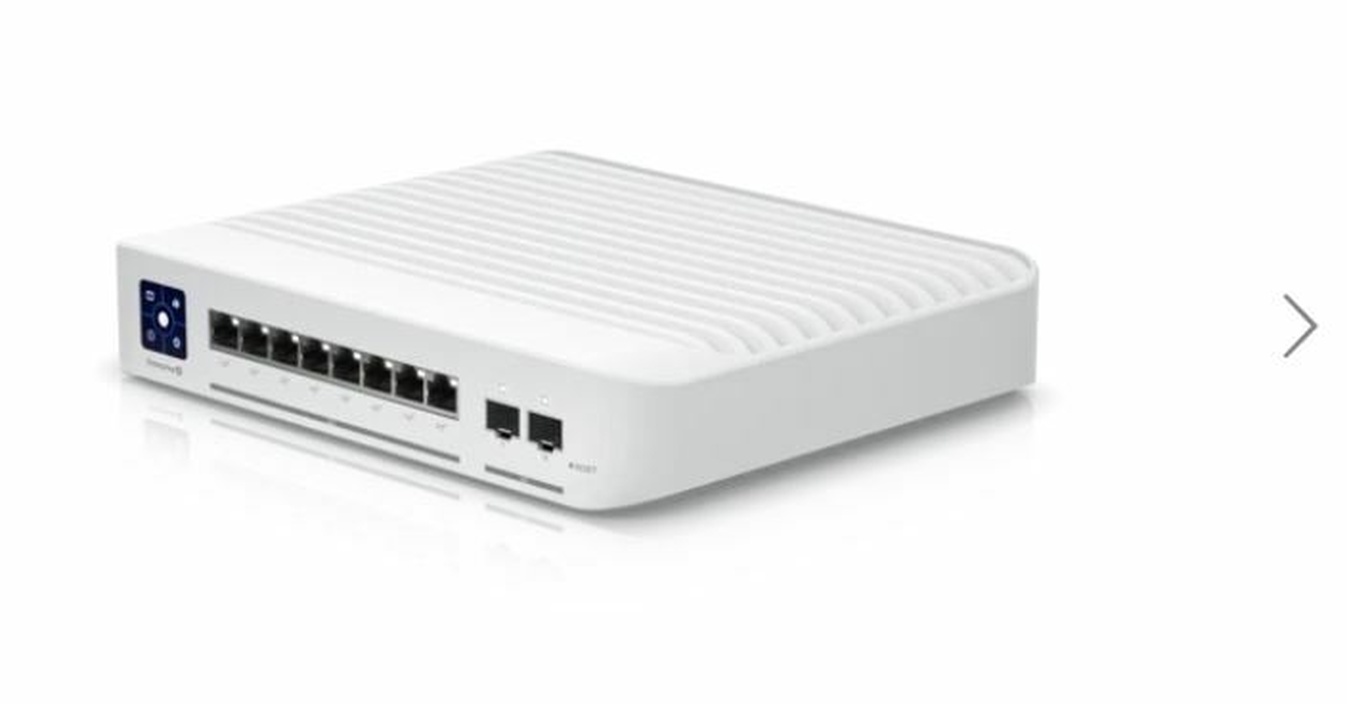

:no_upscale():strip_icc():fill(white):strip_exif()/f/image/u0GHKQ7waB4lp1vQBtOtUIYq.jpg?f=user_large)
https://store.ui.com/coll...ifi-enterprise-8-poe-beta (EA)
