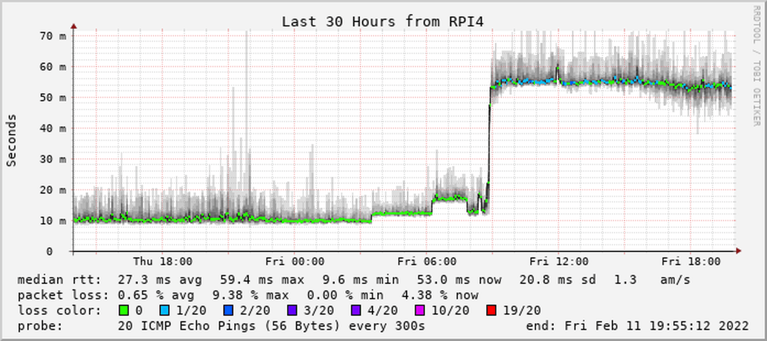

tubejack schreef op vrijdag 11 februari 2022 @ 19:40:
Is bij jullie ook Cloudflare zo traag?
PING 1.1.1.1 (1.1.1.1): 56 data bytes
64 bytes from 1.1.1.1: icmp_seq=0 ttl=56 time=56.989 ms
64 bytes from 1.1.1.1: icmp_seq=1 ttl=56 time=52.651 ms
64 bytes from 1.1.1.1: icmp_seq=2 ttl=56 time=59.088 ms
64 bytes from 1.1.1.1: icmp_seq=3 ttl=56 time=55.236 ms
64 bytes from 1.1.1.1: icmp_seq=4 ttl=56 time=59.105 ms
64 bytes from 1.1.1.1: icmp_seq=5 ttl=56 time=56.085 ms
64 bytes from 1.1.1.1: icmp_seq=6 ttl=56 time=59.476 ms
64 bytes from 1.1.1.1: icmp_seq=7 ttl=56 time=65.752 ms
64 bytes from 1.1.1.1: icmp_seq=8 ttl=56 time=57.687 ms
traceroute to 1.1.1.1 (1.1.1.1), 64 hops max, 52 byte packets
1 fritz.box (192.168.178.1) 4.456 ms 0.954 ms 0.821 ms
2 i138xxxxx.upc-i.chello.nl (xxxxxxx) 11.833 ms 8.871 ms 10.082 ms
3 212.142.52.1 (212.142.52.1) 8.507 ms 11.103 ms 10.158 ms
4 asd-rc0001-cr101-be112-2.core.as33915.net (213.51.7.90) 11.245 ms 12.090 ms 11.560 ms
5 nl-ams14a-ri1-ae50.core.as9143.net (213.51.64.58) 24.819 ms 33.900 ms 11.594 ms
6 bundle-ether1.amstr1.amsterdam.opentransit.net (193.251.150.95) 45.346 ms 46.542 ms 44.756 ms
7 193.251.129.194 (193.251.129.194) 46.501 ms
193.251.129.223 (193.251.129.223) 50.986 ms
81.52.200.119 (81.52.200.119) 72.414 ms
8 193.251.240.214 (193.251.240.214) 56.921 ms
193.251.128.144 (193.251.128.144) 53.143 ms
193.251.240.214 (193.251.240.214) 57.400 ms
9 193.251.150.0 (193.251.150.0) 55.625 ms 60.327 ms 59.469 ms
10 one.one.one.one (1.1.1.1) 55.820 ms 52.342 ms 52.099 ms
jup, hier ook (ziggo AMS)
Ik gebruik dns.sb als alternatief voor Cloudflare, aangezien 1.1.1.1 wel heel erg vaak rare routes neemt via Ziggo.
