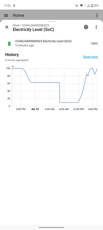

Tosti Ham-Kaas245 schreef op woensdag 22 april 2026 @ 10:30:
Zat net even in de app naar mijn accugegevens te kijken, daar zie ik gisterochtend dat de accu's zijn ontladen tot 3%... Da's bijzonder toch als 5% het minimum is?
Ik heb een tijd terug hetzelfde probleem gehad. Ik kreeg de indruk dat dit veroorzaakt werd door een mode wissel in de Zendure app waardoor kennelijk de minimum SOC niet meer gerespecteerd werd. Ik heb hiervoor een ticket bij Zendure aangemaakt en kreeg onderstaande reactie:
Dear Customer,
Thank you for your patience. We are dedicated to serving you.
Regarding your question, our technical staff has the following response:
Explanation: Low-temperature characteristics of lithium batteries: When the ambient temperature drops, the chemical activity inside a lithium battery decreases, leading to a temporary reduction in its total usable capacity. This is not a malfunction, but a physical characteristic common to all lithium batteries. At the same time, the basic energy consumption (self-discharge) required to maintain system operation still exists. Therefore, with a smaller capacity and the same consumption, the decrease in the percentage of charge (SOC) will be more noticeable.
Regarding the discharge lower limit setting: The "discharge lower limit" you set for your device (e.g., 20%) is a safe threshold to stop drawing power from the battery during operation to protect it. However, when the device is in standby mode, the battery still experiences a small amount of self-discharge. Therefore, if the battery is not charged for an extended period, its actual charge will slowly decrease due to self-discharge, eventually potentially falling below the set discharge lower limit. This is normal.
Our Recommendations: To ensure you have sufficient power during the winter, we recommend the following: Regularly perform AC supplemental charging: Winter sunlight is shorter and weaker, and solar charging alone may not be enough. We suggest you perform a short AC supplemental charge daily or every few days during periods of lower electricity prices (such as at night). This will effectively maintain the battery in optimal condition.
Perform a complete charge-discharge cycle: If you notice a significant discrepancy in the battery level display, try performing a complete charge-discharge cycle (using the battery to a low level and then fully charging it) whenever convenient. This helps the system more accurately calibrate the battery level display.
Please rest assured that if the battery remains below its discharge limit for an extended period or reaches 0 SOC, our device will use AC power to force-charge the battery to prevent over-discharge.
Thank you for your patience and trust during this time, and we sincerely apologize for any inconvenience caused.
Best wishes
Zendure Support Team

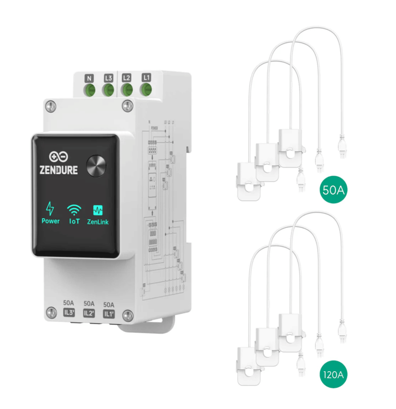

Even een vraagje over de Zendure P1 meter. Ik heb vorige week de twee accu's en een 2400 AC+ binnen gekregen. Dit waren drie dozen.
De P1 meter zou in diezelfde zending gezeten moeten hebben. Maar ik zag ook op de website een regels staan van GLS (accu's) en DHL (P1).
Is de ervaring dt de P1 meestal met de accu's meekomt? Zal voor de zekerheid ook melden bij zendure dat ik geen P1 heb ontvangen.

Nicap schreef op woensdag 22 april 2026 @ 13:02:
Dat is hier al vaker langsgekomen, @Nicap
Zendingen gaan wel vaker in verschillende delen en soms ook met verschillende vervoerders. Dat kan komen doordat het uit verschillende magazijnen komt.
Bij mij kwam de P1 meter apart, ongeveer een week later.

Zie deze drop in SOC met een SolarFlow Plus 800, kan dit kwaad?
Afbeeldingslocatie: https://tweakers.net/i/GnNgiqHwHXVTnZqPqYUFSVvXMEc=/x800/filters:strip_exif()/f/image/43CJxiiBBse5um4iNbqeKvnU.png?f=fotoalbum_large
Instelling staat default op min 10% en max 100%.

DJ-Promo schreef op woensdag 22 april 2026 @ 19:49:
Kan maar zo zijn dat HA geen gegevens heeft ontvangen na een bepaalde tijd, en in de ochtend opeens wel. Heeft hij tijdens die periode wel gewoon teruggeleverd aan de woning?
Uit je grafiek zou blijken dat hij verder vanacht niet heeft ontladen. Als je gewoon NOM draait dan lijkt het dus eerder een fout in de visualisatie en was vanmorgen de batterij gewoon leeg.
  • DJ-Promo
  • Laatst online: 12:14
Thanks! Zal de homewizard app ook even checken die heeft p1 meter standen. Zou zomaar kunnen de batterij zit ver van mijn wifi punt.

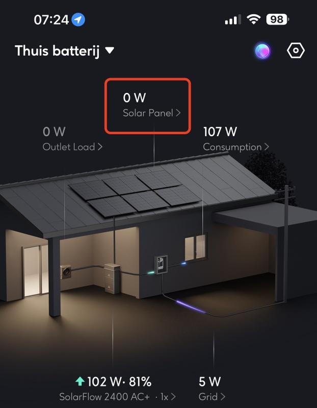

Wellicht dat iemand mij hier bij kan assisteren, ik vind de Zendure app prima werken en heb geen behoefte meer aan de Homewizard app en ga dat eco systeem verlaten. Enige dat er wat mij betreft nog aan mankeert v.,w.b. de Zendure setup is dat ik in de app geen inzicht heb wat mij panelen opwekken.
Afbeeldingslocatie: https://tweakers.net/i/C0iWIdiu2fEZsN89x59Sk6tRTm0=/x800/filters:strip_icc():strip_exif()/f/image/HANavffcktdaS0y1nWu6A2iQ.jpg?f=fotoalbum_large
Volgens mij moet het mogelijk zijn om met de Zendure 3CT kwh meter hier wel in te voorzien. Ergens heb ik de afgelopen weken gelezen dat een ander Zendure gebruiker hier een oplossing voor had. Kennelijk is het mogelijk om maar 1 fase te gebruiken om te meten met bovenstaande kwh meter, het is dan mogelijk om in de Zendure app aan te geven dat een van de meetspoelen de output van de panelen meet. Dat laatste word dan zichtbaar in de app als de opbrengst van de panelen. Mijn vraag is nu alleen hoe sluit ik deze meter dan aan tussen mijn zonnepanelen en het net en volstaan de 120A meetspoelen of moet ik voor de nauwkeurigheid (een aanname) de 50A meetspoelen aanschaffen samen met de 3CT meter van Zendure.
Afbeeldingslocatie: https://tweakers.net/i/qTiGIOEcfzBS2oDSMU4kNH9luPk=/x800/filters:strip_exif()/f/image/IPwLVXivBoKOj4x4hMcB2yf1.png?f=fotoalbum_large
Ik word niet helemaal wijs uit uit de manual van Zendure, wellicht dat iemand mij in de juiste richting kan sturen. Ik heb nu een HW 1-fase kwh meter tussen de panelen en de automaat zitten,m die gaat er dan uit.

Martijn-V4 schreef op donderdag 23 april 2026 @ 07:36:
Je hebt inderdaad de CT3 nodig en 1 50A klem om de ingaande fase van de panelen.
De app is alleen erg “buggy” de registratie van de panelen verdwijnt regelmatig en dan moet je opnieuw instellen en opslaan. Dus niet ideaal.

Jetro schreef op donderdag 23 april 2026 @ 07:56:
Duidelijk, ik had al zo'n vermoeden dat ik daar een meetspoel moet aansluiten. Ik vermoed ook zomaar dat de percentuele meetfout van de 120A meetspoel groter is dan die van een 50A meetspoel. Hoe sluit ik dan de kwh meter aan, want dat ding moet ook gevoed worden. Gewoon aansluiten op een fase en de nul (L1 en N) niet zijnde de fase en nul van de panelen?
Ik ben bang (maar weet niet 100% zeker) dat je dit alleen kunt doen in een 1-fasesysteem. Dan heb je namelijk maar één CT nodig bij de hoofdschakelaar voor NOM en heb je een CT ‘over’ voor het meten van wat anders, zoals PV.
Je kunt voor NOM bij een 3-fase aansluiting niet volstaan met slechts één CT bij de hoofdschakelaar omdat je niet weet wat de andere twee fasen doen. En dan heb je geen CT meer over voor het meten van je PV.

Hippe Lip schreef op donderdag 23 april 2026 @ 08:41:
Ik heb een 1-fase aansluiting. Ik wil die Zendure 3CT meter alleen maar gebruiken om mijn panelen opbrengst te integreren in het Zendure eco systeem en zo ook zichtbaar te maken in de app.

Martijn-V4 schreef op donderdag 23 april 2026 @ 08:01:
De meetspoel meet een stroomsterkte (in A), om daar uiteindelijk een vermogen (in W) van te maken is ook de spanning (in V) nodig, en moet dus ook van elke te meten fase/groep de L draad worden aangesloten. Afhankelijk van de fabrikant wordt 1 van deze L aansluitingen dan wel een aparte aansluiting gebruikt voor de voeding.

Martijn-V4 schreef op donderdag 23 april 2026 @ 10:04:
Waarom niet even wachten... ze hebben aangekondigd dat zichtbaar te maken middels API.

koboy schreef op donderdag 23 april 2026 @ 10:08:
Dan word de meter van Zendure dus aangesloten op de uitgaande fase en nul van de omvormer en de meetspoel op diezelfde fase?

Martijn-V4 schreef op donderdag 23 april 2026 @ 10:25:
@Martijn-V4 de nul en fase zorgen alleen voor de voeding van de 3CT. De spoel verzorgt de meting van de fase draad waarop die zit. Het maakt niet uit waar je de fase vanaf haalt om je 3CT te voeden.
Als je een 1-fase aansluiting hebt, sluit je de fase aan op L3. Optioneel kan je dan L3 op de 3CT doorlussen naar L2 en naar L1, dat zorgt er alleen voor dat je geen melding krijgt dat er een fase mist, maar heeft geen enkel effect op de echte werking can de 3CT. Bij een 3 fase aansluiting geldt dit niet en natuurlijk individueel aansluiten.

Arwbo schreef op donderdag 23 april 2026 @ 10:48:
Duidelijk, ik kan de meetspoel dan op de uitgaande fase van de omvormer aansluiten om het opgewekte vermogen van de panelen te meten? Dat ik in het geval van een 1-fase installatie deze moet aansluiten op L3 had ik inderdaad al in de handleiding gelezen ;-)

Martijn-V4 schreef op donderdag 23 april 2026 @ 10:56:
Voor de zekerheid, de 120A spoel om de hoofdfase, en de 50A spoel om de fase van de PV-omvormer, je wilt het verschil meten tussen die twee.

Arwbo schreef op donderdag 23 april 2026 @ 11:18:
Juist, en dan de meter op L3 voeden met een willekeurige fase draad, het is tenslotte met de uitzondering van uitgaande fase van de panelen allemaal dezelfde fase in een 1-fase systeem.
Precies!
Let op! Om een CT spoelen meter het vermogen te kunnen laten bepalen moet ook de spanning ter plekke worden gemeten. Per klem is er dus ook een L aansluiting!
Aangezien er een kleine spanningsval kan zijn tussen de uitgang van de omvormer en verderop in de meterkast is het het beste de L aansluiting van de betreffende spoel zo dicht mogelijk bij de spoel te doen.
P=V x I. De spoel levert de I, de L draad de V.
Als de CT meter een aparte voeding aansluiting heeft maakt het niet uit waar je de voeding plaatst, maar dit is afhankelijk van de uitvoering van de meter. Kan ook dat de L aansluiting van de eerste klem voor de voeding wordt gebruikt.
Edit: uitgaande van het vervangen van een P1 meter door spoelen in een 1 fase aansluiting: eerste spoel om de netaansluiting en ook de L1 en nul draad daar afnemen. Tweede (en derde) spoel en betreffende L draad daar waar je extra wilt meten zoals bijvoorbeeld bij een PV omvormer groep.

koboy schreef op donderdag 23 april 2026 @ 12:24:
Het plan is niet om de Zendure kwh mijn huidige P1 meter te laten vervangen, ik wil dat ding alleen gebruiken om de opbrengst van mijn panelen zichtbaar te maken. Dus de fase en nul van de panelen op de Zendure khw meter aansluiten (L3 en N) en de meetspoel op de fase van de panelen. Als dat niet kan dan heb ik er ook geen problemen mee om de Zendure kwh meter te gebruiken als alternatief voor mijn huidige P1 meter. Dan word het de fase van het net op L3 en N en de fase van de panelen op bijvoorbeeld L2. De 120A meetspoel komt dan op de inkomende fase in de groepenkast en de 50A meetspoel op de fase van de panelen. Dan mijn huidige P1 meter uit de Zendure setup halen de de Zendure kwh meter toevoegen als P1 meter.
En als ik dan ga sleutelen in de meter kast maak ik wel zwart licht in huis en sluit ik de koelkast aan op de noodstroom aansluiting van de Solarflow.

Martijn-V4 schreef op donderdag 23 april 2026 @ 13:17:
Als je een 1 fase aansluiting hebt, en toch in de meterkast aan het sleutelen gaat: gewoon inzetten op vervangen van de P1 meter door CT klemmen. Heb je maar 1 systeem/meter. Sla even goed de handleiding van de accu en van de CT klemmen er op na om alles te dubbelchecken.
Maar persoonlijk zou ik even wachten op de release van zenki/HEMS2.0, daar zit volgens sommigen het opnemen van externe PV in. Ook kun je HA als alternatief bekijken, geeft een betere aansturing in wat ingewikkelder situaties dan HEMS op dit moment kan bieden.

koboy schreef op donderdag 23 april 2026 @ 13:31:
Als daar de levering van externe PV systemen in komt dan zal dat toch echt via een aparte verbruiks monitor moeten gaan zoals een extra opnemer met CT klemmen.
Die gegevens rechtstreeks van de PV omvormer krijgen kun je wel vergeten.
Zie het regelmatig voorbij komen dat externe PV ondersteund word in HEMS 2.0. Waar komt dit vandaan, ik heb hier geen screenshots van gezien. En zit geloof ik ook niet in de HEMS 2.0 beta app.
Jij wel?

Ben(V) schreef op donderdag 23 april 2026 @ 13:37:
Al helemaal met een GoodWe omvormer want daar heeft HW ook niet al te beste ervaringen mee als het gaat om API limieten.
Tot die conclusie ben ik inmiddels ook gekomen, dat gaat wel lukken ;-)
En dat is precies waar ik nu meer bezig ben, uiteindelijk komt het er gewoon op neer dat ik mijn huidige P1 setup ga vervangen door een Zendure 3CT kwh meter in mijn 1-fase systeem waardoor ik ook mijn pv opbrengst zichtbaar kan maken in de Zendure app met een van de resterende meet spoelen/fase aansluitingen.
Martijn-V4 schreef op donderdag 23 april 2026 @ 13:45:
Maar dan ga je dus van een P1 sturing die sneller is (mits een 5.0 slimme meter) naar een minder nauwkeurige CT sturing alleen om je PV in de Zendure APP te krijgen? -O-
Zendure-HA.com | Run Zendure your way — in Home Assistant
  • Martijn-V4
  • Laatst online: 13:08
gielz schreef op donderdag 23 april 2026 @ 13:48:
Volgens de reviews even snel, wellicht iets minder nauwkeurig maar dat zien we wel als de boel draait.
  • koboy

gielz schreef op donderdag 23 april 2026 @ 13:41:
Jij wel?
Is iets wat Zendure heeft geroepen rond te tijd van de aankondiging van HEMS 2.0. Maar gezien de "Chinese marketing" kan het natuurlijk ook betekenen dat je via de AC poort kan opladen vanaf PV.....
Normaal ben ik heel stil op dit punt, juist omdat ik ook de berichten vanuit de bèta versie gebruikers langs heb zien komen, maar nu HEMS 2.0 op het punt staat uitgerold te worden (was eind april toch?) zou ik zelf dit even afwachten voor je in de meterkast aan de gang gaat.

a2aan schreef op donderdag 23 april 2026 @ 15:28:
Ik zie zowel aan de onderkant (22%-16%), als aan de bovenkant (92%-100%) dat de grafiek soms een 'sprongetje' maakt (de ene dag meer dan de andere), maar naar mijn idee viel dat binnen de 'gebruikelijke' marge van LFP in combinatie met de toch wat onnauwkeurige SoC-tracking van Zendure.
Voor statistieken ben ik afhankelijk van de Zendure app (dus lastig 'te zien', en met een lage resolutie), maar op dagen dat ik van 5% naar 100% ga met mijn 5,76kWh aan gespecificeerde totale batterijcapaciteit, zie ik er wel 6,3-6,5kWh aan energie in gaan, dus ik had niet het idee dat ik iets 'te kort' kom. RTE (volgens HomeWizard) is in april tot nu toe zo'n 84%, dus wat mij betreft ook prima.
Dit sprong gedrag zag ik de laatste paar weken, daarvoor niet en het totaal vermogen liep ook terug.
Dat er bij jou 6,5 kWh ingaat lijkt mij normaal, voor 2 stuks 3000 batterijen. lijkt mij bij jou niks aan de hand.
