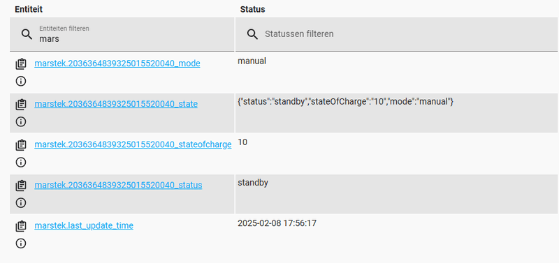

Zijn hier mensen die goed zijn met integraties maken binnen home assistant?
Ben best een eind vind ik zelf maar de puntjes op de i kom ik niet uit.
Maak de file: /homeassistant/custom_components/marstek/__init__.py aan
24
25
26
27
28
29
30
31
32
33
34
35
36
37
38
39
40
41
42
43
44
45
46
47
48
49
50
Read MQTT data from marstek server.
The security from marstek is not that good, There is a middleman server for more secure connections.
from __future__ import annotations
import voluptuous as vol
import paho.mqtt.client as mqtt
from datetime import datetime
from homeassistant.core import HomeAssistant, ServiceCall
from homeassistant.helpers.typing import ConfigType
DOMAIN = "marstek"
CONF_USERNAME = "username"
CONF_PASSWORD = "password"
def setup(hass: HomeAssistant, config: ConfigType) -> bool:
    entity_id = 'hello_state.last_message'
    topic = "marstek/+/+"
    def on_connect(client, userdata, flags, rc) -> None:
        """A new MQTT message has been received."""
        client.subscribe(topic)
    # Listen to a message on MQTT.
    def on_message(client, userdata, msg) -> None:
        hass.states.set('marstek.last_update_time', datetime.now().strftime("%Y-%m-%d %H:%M:%S"))
        hass.states.set(msg.topic.replace("marstek/", "marstek.").replace("/", "_"), msg.payload.decode())
    # Create an MQTT client instance
    client = mqtt.Client()
    client.username_pw_set(CONF_USERNAME, CONF_PASSWORD)
    client.on_connect = on_connect
    client.on_message = on_message
    # Connect to the MQTT server
    client.connect("marstekmqtt.geemert.nl", 8883, 60)
    client.loop_start()
    # Return boolean to indicate that initialization was successfully.
    return True
Maak de file /homeassistant/custom_components/marstek/manifest.json aan
  "domain": "marstek",
  "name": "Marstek integration!",
  "version": "1.0.0"
maak in je configuration.yaml een extra regel met alleen
marstek:
stuur mij dan een PM met de id nummer van je accu (te vinden op https://eu.hamedata.com/app/AfterSales/), ik stuur je username en password terug die je boven in de code moet zetten.
zo komt het bij mij in home assistant:
Afbeeldingslocatie: https://tweakers.net/i/DMSzexiOt_ie9HbqZrKgVnvsZqo=/800x/filters:strip_exif()/f/image/33ouyVG91KVkC48MMzpEHzIN.png?f=fotoalbum_large

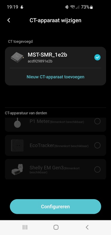

Als ik dezelfde keuze maakt voor de P1 kan ik vanuit de accu via CT niet de dongle kiezen? Kun jij je stappenplan weergeven?
  • Janp1963
  • Registratie: Oktober 2019
  • Laatst online: 25-09 09:42
kiezen doe je in het CT003 scherm
In de app bven op het pijltje naast äccu" klikken dan ct003 selecteren en dan op het tandwiel rechtsboven daar kun je de meter wijzigen.
[ Voor 68% gewijzigd door Janp1963 op 09-02-2025 18:22 ]

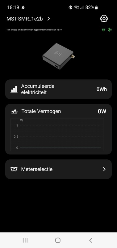

@hallorichard Hoe ziet bij jou dit scherm er uit? krijg je hier ook data te zien?
Afbeeldingslocatie: https://tweakers.net/i/PN-GZVJaQhHU6ctnNdAB3p_iias=/x800/filters:strip_icc():strip_exif()/f/image/uAVo3nE4mGCgeU7LC4TUJG1d.jpg?f=fotoalbum_large
[ Voor 1% gewijzigd door Janp1963 op 09-02-2025 18:27 . Reden: aanvulling ]
A-label (huur)bungalow 90m2 4000WP zonnepanelen, Marstek 5.2 KWh thuisaccu V157.1 HW P1 meter 5.1903 , lucht lucht airco LG 3,5 KW, elektrische boiler, inductiekookplaat, Homewizard energie monitor systeem sinds 01-06-2019 gasloos

Ik heb de swr-w/r dongle . Accu en dongle zijn in de Marstek app zichtbaar, krijg het alleen niet gekoppeld?? Vanuit accu menu CT wijzigen en de dongle kiezen gaat niet lukken. Wellicht doe ik iets verkeerd? Maar geen idee wat?
  • Janp1963
Satbird schreef op zondag 9 februari 2025 @ 18:30:
Wifi en BT icoontje groen? anders scherm een paar keer omlaag trekken om proberen verbinding te maken.
[ Voor 9% gewijzigd door Janp1963 op 09-02-2025 18:32 ]

Janp1963 schreef op zondag 9 februari 2025 @ 18:26:
Afbeeldingslocatie: https://tweakers.net/i/0Ph1ziVjKHRIujLLahYyzWdZr_A=/x800/filters:strip_icc():strip_exif()/f/image/CXAaCnA6JCDutD08sr8qC26D.jpg?f=fotoalbum_large

Hmm , ik krijg geen data in dat scherm, heb dezelde meter als jij geselecteerd.
Ik heb ook een Iskra meter wel een ander type de ME382 Accu doet niets op de auto- en AI stand kan alleen op manueel tot nu toe.

Janp1963 schreef op zondag 9 februari 2025 @ 18:47:
Je hebt een oude smart meter. Iskra ME382 / MT382 (DSMR 2.2).
Nu zitten we al op smr5, die van mij is nieuw.
Dus iskra van 2010 is zeker anders dan die van 2024.
Misschien opvragen bij je leverancier of je meter wel ondersteund gaat worden.
  • Janp1963
hallorichard schreef op zondag 9 februari 2025 @ 18:57:

[Afbeelding]. Na opnieuw alles toevoegen blijf ik hetzelfde probleem houden.
In het menu heb je regelstrategie, als je daar kies voor auto, dan staat je p1 toch al geselecteerd.
En als ik op ct in het hoofdscherm klik, dan krijg ik eerst dit scherm
Afbeeldingslocatie: https://tweakers.net/i/Yrcxr1LsCILLmPjtpgL4HOINBbw=/x800/filters:strip_icc():strip_exif()/f/image/Yo2ykj8SpOKd7d4awrNUOtR4.jpg?f=fotoalbum_large
En bij wijziging kan ik kiezen uit de marstek, maar ook homewizard en shelly (simulator), je ik heb ze alle die, maar ik gebruik die van Marstek.
Afbeeldingslocatie: https://tweakers.net/i/pTggj39cyQifLpslwSCGog5V5us=/x800/filters:strip_icc():strip_exif()/f/image/B3TQZgBLHJAKVAUdQSXogjpW.jpg?f=fotoalbum_large
Poeh, kost nogal wat een upgrade bij Enexis,
Afbeeldingslocatie: https://tweakers.net/i/XbctAWwGlcmALYumYYX1ICAZqOE=/800x/filters:strip_icc():strip_exif()/f/image/dqflFI1JABVWb8csNjsul6PX.jpg?f=fotoalbum_large
Helaas niet🫣

Zie wel verschillen in de app of je I os of Android hebt, mijn ct selectiescherm lijkt meer toekomstige opties te hebben als bij jou.
Staan nog 2 shelly versies onder in het selectiescherm.
Afbeeldingslocatie: https://tweakers.net/i/nbbUJLHqDMwei5BUno0fGUQvJ7E=/x800/filters:strip_icc():strip_exif()/f/image/5OkmsgtjricysNhTsuy8ERJ3.jpg?f=fotoalbum_large
dezelfde aantallen CT varianten heb ik ook. Mijn scherm staat op 125% grote😊
