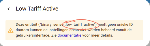

  • MikeyMan
  • Laatst online: 21:38

MikeyMan schreef op maandag 23 december 2024 @ 16:34:
Ben tegelijkertijd ook een poging aan het doen om de laadpaal alleen tegen laag tarief te laten laden. Dat heb ik op zich voor elkaar. De YAML:
YAML:
24
25
26
27
28
29
30
31
32
33
34
template:
  - binary_sensor:
      - name: "Low Tariff Active"
        unique_id: "low_tariff_active_sensor"
        state: >
          {% set low_tariff_cons = states('sensor.low_tariff_consumption') | float(0) %}
          {% set low_tariff_exp = states('sensor.low_tariff_export') | float(0) %}
          {% set high_tariff_cons = states('sensor.high_tariff_consumption') | float(0) %}
          {% set high_tariff_exp = states('sensor.high_tariff_export') | float(0) %}
          {% set prev_low_tariff_cons = state_attr('binary_sensor.low_tariff_active', 'last_low_tariff_consumption') | float(0) %}
          {% set prev_low_tariff_exp = state_attr('binary_sensor.low_tariff_active', 'last_low_tariff_export') | float(0) %}
          {% set prev_high_tariff_cons = state_attr('binary_sensor.low_tariff_active', 'last_high_tariff_consumption') | float(0) %}
          {% set prev_high_tariff_exp = state_attr('binary_sensor.low_tariff_active', 'last_high_tariff_export') | float(0) %}
          {% set low_tariff_delta = (low_tariff_cons - prev_low_tariff_cons) + (low_tariff_exp - prev_low_tariff_exp) %}
          {% set high_tariff_delta = (high_tariff_cons - prev_high_tariff_cons) + (high_tariff_exp - prev_high_tariff_exp) %}
          {% if low_tariff_delta > 0 and high_tariff_delta == 0 %}
            true
          {% elif high_tariff_delta > 0 and low_tariff_delta == 0 %}
            false
          {% elif low_tariff_delta > high_tariff_delta %}
            true
          {% elif high_tariff_delta > low_tariff_delta %}
            false
          {% else %}
            {{ states('binary_sensor.low_tariff_active') }}
          {% endif %}
        attributes:
          last_low_tariff_consumption: "{{ states('sensor.low_tariff_consumption') }}"
          last_low_tariff_export: "{{ states('sensor.low_tariff_export') }}"
          last_high_tariff_consumption: "{{ states('sensor.high_tariff_consumption') }}"
          last_high_tariff_export: "{{ states('sensor.high_tariff_export') }}"
Alleen; ik krijg nu de melding dat deze binary sensor geen unique id heeft... Iemand enig idee?
Iemand hier nog een idee over? Ik heb expliciet een unique id gespecificeerd, maar krijg toch de foutmelding.
  • dixet
  • Laatst online: 19:48
MikeyMan schreef op dinsdag 24 december 2024 @ 15:54:
De foutmelding uit je eerdere post zegt "binary_sensor.low_tariff_active".
De sensor die je hier bouwt heet "binary_sensor.low_tariff_active_sensor".
Je verwijst in regel 28 wel naar die "binary_sensor.low_tariff_active". Wordt die wel ergens (met unique id) gedefinieerd?
  • MikeyMan
MikeyMan
Vidi, Vici, Veni
dixet schreef op dinsdag 24 december 2024 @ 16:06:
Ik blijf een beetje moeite houden met hoe Home Assistant met enteiten en code om gaat...
Ik heb een werken stuk code, wat ook netjes als boolean op het dashboard wordt weergegeven. als in; hij gaat aan op de momenten dat ik bedacht had.
Dat is idd het stukje code dat ik eerder postte:

MikeyMan schreef op dinsdag 24 december 2024 @ 16:14:
YAML:
24
25
26
27
28
29
30
31
32
33
34
template:
  - binary_sensor:
        state: >
            true
            false
            true
            false
          {% else %}
          {% endif %}
        attributes:
Moet ik daadwerkelijk alle losse componenten als unique id specificeren?
Mijn opmerking ging over de definitie van deze sensor
YAML:
Waarin je verderop (regel 28) verwijst naar een ándere sensor
YAML:
De foutmelding die je eerder poste ging over de sensor waarnaar je verwijst. Niet over de sensor die in in dit stuk yaml definieert.
low_tariff_active != low_tariff_active_sensor
Afbeeldingslocatie: https://tweakers.net/i/J9eqccc_72ORzunpCAUwId2tTIg=/fit-in/4000x4000/filters:no_upscale():strip_exif()/f/image/IZ7S82vLJGqvtkhlqf6Rzqqm.png?f=user_large
  • MikeyMan
MikeyMan
Vidi, Vici, Veni
@dixet die foutmelding komt bij het aanklikken van het object op het dashboard.
Die dus wel doet wat de bedoeling was.
Maar dan?
Naam van de Unique_id veranderen in de naam van het dashboard object? :?
Ik mis ergens een logische causaliteit tussen foutmelding en werking geloof ik :X
  • dixet
MikeyMan schreef op dinsdag 24 december 2024 @ 16:58:
Maar dan?
Laat maar, het is laat voor me. Unique ids worden niet gebruikt in sjablonen, wel sensornamen. Vergeet alles wat ik heb gezegd 7(8)7 :D

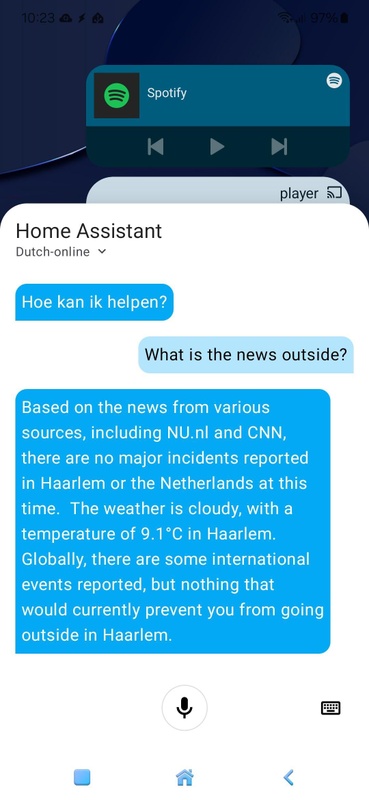

Ik had vakantie over van mijn werk. Tijd goed gespendeerd.
ik kan nu lokaal nieuws 112/regio rss feeds en nu.nl uitlezen.
Nu nog vullen met de rest van de wereld.
https://github.com/Bram-diederik/home-assistant-LLM-scripts
Afbeeldingslocatie: https://tweakers.net/i/Hg55EudlccG_i50AyJTLNA4Gnvs=/x800/filters:strip_icc():strip_exif()/f/image/5vv0JfT2tMe7lZ6mBKzVFzcU.jpg?f=fotoalbum_large
Afbeeldingslocatie: https://tweakers.net/i/-2X8B_2zz_PfDoRT5LH6zXq-NSE=/x800/filters:strip_icc():strip_exif()/f/image/JUZbabunQGCW15kneSUodUdU.jpg?f=fotoalbum_large

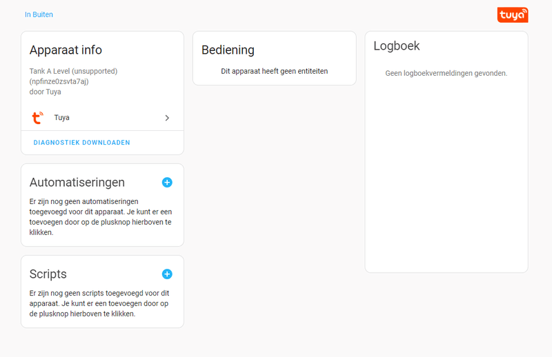

Hoe kan een via de Tuya Smart integratie verbonden Tank Level Monitor (een sensor die de hoogte van de waterstand in een regenwatertank meet) in Home Assistant gebruikt worden
De status is nu dat de sensor wel in de lijst met Tuya apparaten verschijnt, maar het apparaat heeft geen entiteiten die getoond of gebruikt kunnen worden.

@Jab65 Zelf geen ervaring met Wifi Tuya in HA, alleen Zigbee Tuya. Maar kan me bijna niet voorstellen dat als je hem ergens kunt zien in HA dat er geen entiteit is. Kan je laten zien hoe/waar je hem nu kunt zien?

Jab65 schreef op vrijdag 27 december 2024 @ 14:33:
Je zou het eens met de "Tuya local" integratie (niet "Local Tuya") kunnen proberen.
Ikzelf heb geen Tank Level Monitor, maar de "Tuya local" integratie gaf bij mij beter resultaat met Tuya devices dan de standaard Tuya integratie.

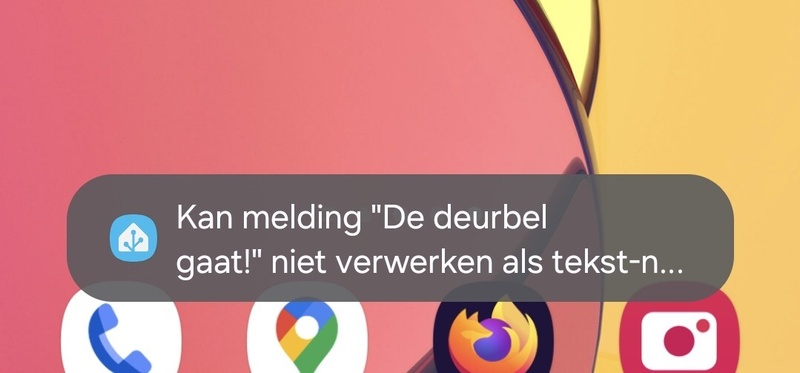

Ik heb een UniFi G4 PoE deurbel. Daarvoor heb ik een automatisatie gemaakt dat er een notificatie wordt gestuurd naar mijn gsm wanneer er aangebeld wordt. Dit leek probleemloos te werken tot daarnet. Er belde iemand aan, maar de automatisatie werd niet getriggerd. Bij tracering zie ik bij Tijdlijn tracering:
“Gestopt omdat het maximale aantal parallelle uitvoeringen is bereikt om 27 december 2024 om 18:01:01“
De automatisatie heeft wel de mode: single
Wat zou de oorzaak van het niet werken kunnen zijn?
Blijkbaar was de automation nog actief toen er aangebeld werd, en dan krijg je dus die melding bij mode: single
Zonder de automation te kunnen zien is het verder voor ons koffiedik kijken
Home Assistant configuratie
  • Brynnie
TheFes schreef op vrijdag 27 december 2024 @ 18:47:
De automatisatie liep niet meer. Tenzij, bedenk ik me nu, de aanbeller de knop ingedrukt hield. Dan kan het dat de automatisatie misschien meerdere keren vlak na elkaar getriggerd werd?
Daarvoor heb ik nu de condition toegevoegd.

Cimpel schreef op vrijdag 27 december 2024 @ 18:02:

Septillion schreef op vrijdag 27 december 2024 @ 15:23:
Het verbaasde mij ook :-) Hieronder twee afbeeldingen hoe het apparaat zich toont in HA.
Ik heb zelfs een stukje uit het diagnostiek bestand toegevoegd waarin de actuele waardes getoond lijken te worden.
Afbeeldingslocatie: https://tweakers.net/i/aSMuZ_yf4ri9bY9tsanl_z941Eg=/800x/filters:strip_exif()/f/image/rYA7u8RVa4PSVmoSEZsF2ECd.png?f=fotoalbum_large
Afbeeldingslocatie: https://tweakers.net/i/ZH6c8JTKoqnzhYosmUt7c-abgZg=/800x/filters:strip_exif()/f/image/6FRb8JVBHGWE20QTskdbF7Qr.png?f=fotoalbum_large

Heeft iemand TTS werkend gekregen op Android (14)?
Ik heb sinds kort een Eufy deurbel. Het probleem is dat ik vaak mijn telefoon op trilstand heb staan en de notificatie niet "voel" wanneer iemand aanbelt.
Een extra chime kopen is ook zonde voor de enkele keren dat ik niet in de buurt ben van mijn Homebase.
Hiervoor heb ik een automatisering gemaakt die triggert wanneer iemand aanbelt. Voor zover ik zag is een TTS notification de enige manier om de trilstand te overriden.
De action heb ik als volgt geconfigureerd:
YAML:
  - action: notify.PHONE_ID
    data:
      message: TTS
      data:
        ttl: 0
        priority: high
        media_stream: alarm_stream
        tts_text: De deurbel gaat!
Op het moment dat ik hem trigger verschijnt er een toast message in beeld met de melding dat de TTS niet verwerkt kan worden:
Afbeeldingslocatie: https://tweakers.net/i/FCsRvH6ME2cFgfZoVgQIzPmWwr0=/800x/filters:strip_icc():strip_exif()/f/image/4CVGKYrYtLQ9mWeiPECXi3Xc.jpg?f=fotoalbum_large
De documentatie van de companion app is hier vrij beknopt over:
If there is an error processing the message you will see a toast message appear on the device. Check to make sure that the Speech Recognition & Synthesis engine is up to date and set as the default, in case you run into any issues.
Deze "Speech Recognition & Synthesis engine" staat geïnstalleerd op mijn telefoon. Hoe ik hem als default kan instellen kan ik niet vinden.
Ik heb overigens een Samsung telefoon met Android 14, One UI 6.1 en de laatste updates.
Ik heb ergens een vermoeden dat TTS prima werkt op oudere Android/Google Play versies maar dat er weer iets aangepast is bij Google waardoor het niet werkt.

@Trokken
Op een Samsung kun je wel zoeken in de settings naar 'Tekst naar Spraak'
Ik kreeg dezelfde fout als jij en heb het nu ingesteld op 'Samsung tekst naar spraak-engine',
en in het 'Engels', Nederlands is niet beschikbaar als keuze. (Systeemtaal werkt daardoor niet)
