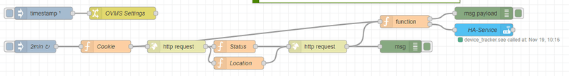

Daarna in NodeRed kun je hetvolgende doen om notificaties te krijgen met verwachte laden klaar en hoeveel tijd het moet kosten om te laden om thuis te kunnen komen (laatste is nog zwaar in alpha :+ )
[{"id":"297e8ef0.6e64b2","type":"tab","label":"OVMS","disabled":false,"info":""},{"id":"b5616507.7edd58","type":"api-call-service","z":"297e8ef0.6e64b2","name":"Notify Mobile","server":"4b66b686.9fc358","version":1,"debugenabled":false,"service_domain":"notify","service":"mobile_app_sm_m315f","entityId":"","data":"{\"title\":\"{{Title}}\",\"message\":\"{{payload}}\"}","dataType":"json","mergecontext":"","output_location":"","output_location_type":"none","mustacheAltTags":false,"x":1750,"y":220,"wires":[[]]},{"id":"bbf45f39.d2f5a","type":"server-state-changed","z":"297e8ef0.6e64b2","name":"","server":"4b66b686.9fc358","version":1,"exposeToHomeAssistant":false,"haConfig":[{"property":"name","value":""},{"property":"icon","value":""}],"entityidfilter":"sensor.mg_v_c_current","entityidfiltertype":"exact","outputinitially":true,"state_type":"str","haltifstate":"","halt_if_type":"str","halt_if_compare":"is","outputs":1,"output_only_on_state_change":true,"for":0,"forType":"num","forUnits":"minutes","ignorePrevStateNull":false,"ignorePrevStateUnknown":false,"ignorePrevStateUnavailable":false,"ignoreCurrentStateUnknown":false,"ignoreCurrentStateUnavailable":false,"x":170,"y":140,"wires":[["be3a7070.362b3","502259a4.66e4b8","ff4dc54a.19afa8"]]},{"id":"2807b7d3.01fee8","type":"debug","z":"297e8ef0.6e64b2","name":"","active":false,"tosidebar":true,"console":false,"tostatus":false,"complete":"false","statusVal":"","statusType":"auto","x":1490,"y":100,"wires":[]},{"id":"be3a7070.362b3","type":"function","z":"297e8ef0.6e64b2","name":"Calc charge time","func":"\nif(msg.topic == \"sensor.mg_v_c_voltage\"){\n  flow.set(\"Voltage\", msg.payload);\n}\nif(msg.topic == \"sensor.mg_v_b_soc\"){\n  flow.set(\"SoC\", msg.payload);\n}\n\n\nvar Current = Number(flow.get(\"current\"));\nvar Voltage = Number(flow.get(\"Voltage\"));\nvar SoC = Number(flow.get(\"SoC\"));\nvar kWhremain = flow.get(\"kwhFull\") - (flow.get(\"kwhFull\") * (SoC/100.0))\n\nvar range = flow.get(\"range_est\");\nvar distanceToHome = flow.get(\"dth\");\nvar averageW_km = flow.get(\"kw100km\")*10;\n\n\nif(msg.topic == \"sensor.mg_v_c_current\"){\n    flow.set(\"current\", msg.payload);\n    Current = msg.payload;\n    \n    if( Current > 3.0 && !isNaN(SoC) && SoC < 95.0 ){\n        if(Voltage === 0.0){\n             Voltage = 230.0;\n        }\n        \n        var watth = Voltage * Current;\n        var wh_km_charging = watth/averageW_km;\n        var TimeSec_homedist = 0.0;\n        if(distanceToHome > range){\n            TimeSec_homedist = ((distanceToHome - range)/wh_km_charging) *3600;\n            flow.set(\"TimeChargeHome\", TimeSec_homedist);\n        }\n        var TimeSec = (kWhremain / ((Voltage * Current)/1000)) *3600;\n        \n        // Time HH:MM:SS from number\n        \n        // Hours\n        var Hours = ((TimeSec)/3600);\n        Hours = Math.floor(Hours);\n        \n        // Minutes\n        var Minutes = (TimeSec-(Hours*3600))/60;\n        Minutes = Math.floor(Minutes);\n        \n        // Seconds\n        Seconds = (TimeSec-(Hours * 3600)-(Minutes * 60));\n        \n        // Concatenate\n        //var Time = ('0' +Hours).slice(-2)+':'+('0' +Minutes).slice(-2)+':'+('0' +Seconds).slice(-2);\n        \n        \n        var PrevTime = context.get('PreviousFininshed');\n        if (Math.abs(TimeSec-PrevTime)>3600 || isNaN(PrevTime)  ){\n            flow.set('PreviousFininshed', TimeSec);\n\n            var msg1 = { payload :  Date.now() + (TimeSec* 1000)};\n            \n            \n            return [msg1,null];\n        }\n        \n        var msg2 = { payload :  Date.now() + (TimeSec_homedist* 1000)};\n    }\n}","outputs":2,"noerr":0,"initialize":"// Code added here will be run once\n// whenever the node is deployed.\nvar Voltage;\nvar Current;","finalize":"","x":690,"y":140,"wires":[["a9e4314b.bf46c"],["9b825fa1.3c01f"]]},{"id":"502259a4.66e4b8","type":"api-current-state","z":"297e8ef0.6e64b2","name":"","server":"4b66b686.9fc358","version":1,"outputs":1,"halt_if":"","halt_if_type":"str","halt_if_compare":"is","override_topic":true,"entity_id":"sensor.mg_v_c_voltage","state_type":"str","state_location":"payload","override_payload":"msg","entity_location":"data","override_data":"msg","blockInputOverrides":false,"x":470,"y":80,"wires":[["be3a7070.362b3"]]},{"id":"ff4dc54a.19afa8","type":"api-current-state","z":"297e8ef0.6e64b2","name":"","server":"4b66b686.9fc358","version":1,"outputs":1,"halt_if":"","halt_if_type":"str","halt_if_compare":"is","override_topic":true,"entity_id":"sensor.mg_v_b_soc","state_type":"str","state_location":"payload","override_payload":"msg","entity_location":"data","override_data":"msg","blockInputOverrides":false,"x":460,"y":200,"wires":[["be3a7070.362b3","fad5e357.77616"]]},{"id":"e6006a2b.650e78","type":"moment","z":"297e8ef0.6e64b2","name":"FullChargeTime","topic":"FullChargeTime","input":"","inputType":"msg","inTz":"Europe/Amsterdam","adjAmount":0,"adjType":"days","adjDir":"add","format":"calendar","locale":"C","output":"","outputType":"msg","outTz":"Europe/Amsterdam","x":1060,"y":120,"wires":[["35b46e8e.a8e302"]]},{"id":"35b46e8e.a8e302","type":"function","z":"297e8ef0.6e64b2","name":"Concat","func":"var msg1  = { Title: \"Charging\", payload : \"Charging will be finished \" + msg.payload };\nreturn msg1;","outputs":1,"noerr":0,"initialize":"","finalize":"","x":1320,"y":140,"wires":[["2807b7d3.01fee8","b5616507.7edd58"]]},{"id":"45618d7b.b07634","type":"json","z":"297e8ef0.6e64b2","name":"","property":"payload","action":"","pretty":false,"x":1390,"y":480,"wires":[["e1fbd701.d974b8"]]},{"id":"e1fbd701.d974b8","type":"function","z":"297e8ef0.6e64b2","name":"Parse data","func":"msg.payload = (msg.payload.routes[0].legs[0].distance.value / 1000) *1.1;\nflow.set(\"dth\",  msg.payload);\n\nvar msg2;\nif(flow.get(\"locked\") === \"yes\"){\n    msg2 = {Title : \"Car is locked\",payload : \"and distance to home is: \" + parseFloat(msg.payload).toFixed(1) + \"km\"};\n}\n\nreturn [msg,msg2];","outputs":2,"noerr":0,"initialize":"","finalize":"","x":1550,"y":480,"wires":[["92b6a164.9252f"],["b5616507.7edd58"]]},{"id":"92b6a164.9252f","type":"debug","z":"297e8ef0.6e64b2","name":"","active":false,"tosidebar":true,"console":false,"complete":"false","statusVal":"","statusType":"auto","x":1770,"y":460,"wires":[]},{"id":"884ecfb7.c6fcc","type":"api-current-state","z":"297e8ef0.6e64b2","name":"","server":"4b66b686.9fc358","version":1,"outputs":1,"halt_if":"","halt_if_type":"str","halt_if_compare":"is","override_topic":true,"entity_id":"sensor.mg_v_p_latitude","state_type":"str","state_location":"payload","override_payload":"msg","entity_location":"data","override_data":"msg","blockInputOverrides":false,"x":830,"y":460,"wires":[["9acb3c3e.63483"]]},{"id":"c7ab82d.f93c88","type":"api-current-state","z":"297e8ef0.6e64b2","name":"","server":"4b66b686.9fc358","version":1,"outputs":1,"halt_if":"","halt_if_type":"str","halt_if_compare":"is","override_topic":true,"entity_id":"sensor.mg_v_p_longitude","state_type":"str","state_location":"payload","override_payload":"msg","entity_location":"data","override_data":"msg","blockInputOverrides":false,"x":820,"y":520,"wires":[["9acb3c3e.63483"]]},{"id":"9acb3c3e.63483","type":"function","z":"297e8ef0.6e64b2","name":"","func":"if(msg.topic == \"sensor.mg_v_p_latitude\"){\n  flow.set(\"lat\", msg.payload);\n}\nif(msg.topic == \"sensor.mg_v_p_longitude\"){\n  flow.set(\"lon\", msg.payload);\n}\n\nvar key = flow.get(\"api\");\nvar lat = flow.get(\"lat\");\nvar lon = flow.get(\"lon\");\nvar home = flow.get(\"home\");\n\nif( !isNaN(lat) && !isNaN(lon) ){\n    var SendString = 'https://maps.googleapis.com/maps/api/directions/json?origin=' + lat + ',' + lon + '&destination=' + home + '&key=' + key +'&mode=driving&units=metric&departure_time=now' ;\n    var msg1 = { method : 'GET', url : SendString, payload : SendString};\n    return msg1;\n}\n","outputs":1,"noerr":0,"initialize":"","finalize":"","x":1060,"y":480,"wires":[["d33cb6e3.043888"]]},{"id":"d33cb6e3.043888","type":"http request","z":"297e8ef0.6e64b2","name":"","method":"use","ret":"txt","paytoqs":"ignore","url":"","tls":"","persist":false,"proxy":"","authType":"","x":1230,"y":480,"wires":[["45618d7b.b07634"]]},{"id":"f15aa41.24b2158","type":"api-current-state","z":"297e8ef0.6e64b2","name":"","server":"4b66b686.9fc358","version":1,"outputs":1,"halt_if":"","halt_if_type":"str","halt_if_compare":"is","override_topic":true,"entity_id":"sensor.mg_v_c_pilot","state_type":"str","state_location":"payload","override_payload":"msg","entity_location":"data","override_data":"msg","blockInputOverrides":false,"x":320,"y":540,"wires":[["cab9082f.a36988"]]},{"id":"b8ed0e12.b9499","type":"inject","z":"297e8ef0.6e64b2","name":"","props":[{"p":"payload"},{"p":"topic","vt":"str"}],"repeat":"","crontab":"","once":false,"onceDelay":0.1,"topic":"","payload":"","payloadType":"date","x":80,"y":540,"wires":[["f15aa41.24b2158"]]},{"id":"80003270.7f224","type":"server-state-changed","z":"297e8ef0.6e64b2","name":"","server":"4b66b686.9fc358","version":1,"exposeToHomeAssistant":false,"haConfig":[{"property":"name","value":""},{"property":"icon","value":""}],"entityidfilter":"sensor.mg_v_c_pilot","entityidfiltertype":"exact","outputinitially":false,"state_type":"str","haltifstate":"","halt_if_type":"str","halt_if_compare":"is","outputs":1,"output_only_on_state_change":true,"for":0,"forType":"num","forUnits":"minutes","ignorePrevStateNull":false,"ignorePrevStateUnknown":false,"ignorePrevStateUnavailable":false,"ignoreCurrentStateUnknown":false,"ignoreCurrentStateUnavailable":false,"x":320,"y":480,"wires":[["cab9082f.a36988"]]},{"id":"cab9082f.a36988","type":"function","z":"297e8ef0.6e64b2","name":"","func":"if(msg.topic === \"sensor.mg_v_c_pilot\"){\n  flow.set(\"pilot\", msg.payload);\n\n}\n\nif(msg.topic === \"sensor.mg_v_e_locked\"){\n  flow.set(\"locked\", msg.payload);\n\n}\n\nreturn msg;","outputs":1,"noerr":0,"initialize":"","finalize":"","x":560,"y":500,"wires":[["884ecfb7.c6fcc","c7ab82d.f93c88"]]},{"id":"719d3ad3.b8acd4","type":"server-state-changed","z":"297e8ef0.6e64b2","name":"","server":"4b66b686.9fc358","version":1,"exposeToHomeAssistant":false,"haConfig":[{"property":"name","value":""},{"property":"icon","value":""}],"entityidfilter":"sensor.mg_v_b_range_est","entityidfiltertype":"exact","outputinitially":true,"state_type":"str","haltifstate":"","halt_if_type":"str","halt_if_compare":"is","outputs":1,"output_only_on_state_change":true,"for":0,"forType":"num","forUnits":"minutes","ignorePrevStateNull":false,"ignorePrevStateUnknown":false,"ignorePrevStateUnavailable":false,"ignoreCurrentStateUnknown":false,"ignoreCurrentStateUnavailable":false,"x":940,"y":220,"wires":[["167786f3.2bdbb9"]]},{"id":"167786f3.2bdbb9","type":"function","z":"297e8ef0.6e64b2","name":"","func":"if(flow.get(\"pilot\") === \"yes\" || flow.get(\"locked\") === \"yes\"){    \n    if(msg.topic == \"sensor.mg_v_b_range_est\"){\n      var range =  Number(msg.payload);\n      flow.set(\"range_est\",range);\n      var var1 = context.get(\"messageSend\");\n      \n      var dht = flow.get(\"dth\");\n      dht =  parseFloat(dht).toFixed(1);\n      \n      if(!var1 && range > dht){\n          var msg1 = {Title: \"You can get home now\", payload : \"Distance to home: \" + dht + \"km\" };\n          context.set(\"messageSend\" , true)\n          return msg1;\n      }\n        \n    }\n\n}\nelse\n    context.set(\"messageSend\" , false);\n\n","outputs":1,"noerr":0,"initialize":"","finalize":"","x":1320,"y":220,"wires":[["a8242fd5.3a2f1","b5616507.7edd58"]]},{"id":"a8242fd5.3a2f1","type":"debug","z":"297e8ef0.6e64b2","name":"","active":false,"tosidebar":true,"console":false,"tostatus":false,"complete":"false","statusVal":"","statusType":"auto","x":1490,"y":240,"wires":[]},{"id":"cd8a2fac.df059","type":"comment","z":"297e8ef0.6e64b2","name":"Google Call","info":"Set home address here","x":1100,"y":440,"wires":[]},{"id":"a9e4314b.bf46c","type":"moving-average","z":"297e8ef0.6e64b2","name":"4 msg avg","amount":"4","weight":"cumulative","x":890,"y":120,"wires":[["e6006a2b.650e78"]]},{"id":"9b825fa1.3c01f","type":"moving-average","z":"297e8ef0.6e64b2","name":"4 msg avg","amount":"4","weight":"cumulative","x":890,"y":160,"wires":[["65f3a25b.55230c"]]},{"id":"65f3a25b.55230c","type":"moment","z":"297e8ef0.6e64b2","name":"HomeChargeTime","topic":"HomeChargeTime","input":"","inputType":"msg","inTz":"Europe/Amsterdam","adjAmount":0,"adjType":"days","adjDir":"add","format":"calendar","locale":"C","output":"","outputType":"msg","outTz":"Europe/Amsterdam","x":1070,"y":160,"wires":[["35b46e8e.a8e302","2e43bda8.4e9db2"]]},{"id":"2e43bda8.4e9db2","type":"debug","z":"297e8ef0.6e64b2","name":"","active":false,"tosidebar":true,"console":false,"tostatus":false,"complete":"false","statusVal":"","statusType":"auto","x":1290,"y":180,"wires":[]},{"id":"fad5e357.77616","type":"api-current-state","z":"297e8ef0.6e64b2","name":"","server":"4b66b686.9fc358","version":1,"outputs":1,"halt_if":"","halt_if_type":"str","halt_if_compare":"is","override_topic":true,"entity_id":"sensor.mg_v_b_range_est","state_type":"str","state_location":"payload","override_payload":"msg","entity_location":"data","override_data":"msg","blockInputOverrides":false,"x":940,"y":280,"wires":[["167786f3.2bdbb9"]]},{"id":"31d2ae39.1ade82","type":"server-state-changed","z":"297e8ef0.6e64b2","name":"","server":"4b66b686.9fc358","version":1,"exposeToHomeAssistant":false,"haConfig":[{"property":"name","value":""},{"property":"icon","value":""}],"entityidfilter":"sensor.mg_v_e_locked","entityidfiltertype":"exact","outputinitially":true,"state_type":"str","haltifstate":"","halt_if_type":"str","halt_if_compare":"is","outputs":1,"output_only_on_state_change":true,"for":0,"forType":"num","forUnits":"minutes","ignorePrevStateNull":false,"ignorePrevStateUnknown":false,"ignorePrevStateUnavailable":false,"ignoreCurrentStateUnknown":false,"ignoreCurrentStateUnavailable":false,"x":310,"y":400,"wires":[["cab9082f.a36988"]]},{"id":"367f7425.6a16ec","type":"change","z":"297e8ef0.6e64b2","name":"Set variables","rules":[{"t":"set","p":"api","pt":"flow","to":"","tot":"str"},{"t":"set","p":"home","pt":"flow","to":"Binnenhof+12+Den+Haag","tot":"str"},{"t":"set","p":"kw100km","pt":"flow","to":"18.1","tot":"num"},{"t":"set","p":"kwhFull","pt":"flow","to":"44","tot":"num"}],"action":"","property":"","from":"","to":"","reg":false,"x":230,"y":40,"wires":[[]],"icon":"node-red/leveldb.png","info":"# Set your variables here\n## Get api-key from Google\n * Go to https://console.cloud.google.com/apis and be sure to make a project\n * Enable \"Directions API\" on your project\n * Make sure to have billing enabled but be assured you will get 200USD free from google each month so you should not be making any costs\n * In the api-key security only enable directions api\n * Copy the api key and paste it in the flow.api\n\n## Set your home address\n * Set it human readable where you replace the spaces with a \"+\" sign. For example \"binnenhof+12+Den+Haag\" (do not type the quotes)\n\n## Set your average consumption\n * Get this value from your car. For example \"18.1\" do not type the quotes.\n\n##  Set yhe size of the battery pack\n * For MG \"44.0\" do not type the quotes."},{"id":"777558cd.3c1128","type":"inject","z":"297e8ef0.6e64b2","name":"Boot","props":[{"p":"topic","vt":"str"}],"repeat":"","crontab":"","once":true,"onceDelay":0.1,"topic":"\"Boot\"","x":90,"y":40,"wires":[["367f7425.6a16ec"]],"icon":"node-red/alert.svg"},{"id":"4b66b686.9fc358","type":"server","name":"Home Assistant","addon":true}]

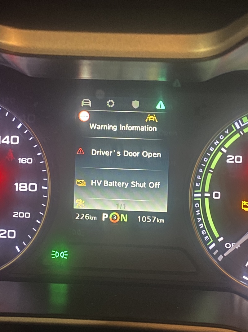

Zal nu iedereen die updates gaan krijgen? Of nog steeds willekeurig klanten?
Ik kon vandaag namelijk niet in de versnelling pas na 5 keer opnieuw starten en ontgrendelen en vergrendelen van de auto.
Afbeeldingslocatie: https://tweakers.net/i/8TbcKuQ4nSG5MJiV1U09eJ4eZ3U=/800x/filters:strip_icc():strip_exif()/f/image/UlUWcjcnG5kpg50hPQV2bZHa.jpg?f=fotoalbum_large

Voor diegene die zelf met de data van OVMS aan de slag willen gaan op een wat "simpelere" manier dan de MQTT oplossing. De volgende code genereert een device_tracker in Home Assistant gebruikmakend van de data op de OVMS webserver (dexter als voorbeeld)
Afbeeldingslocatie: https://tweakers.net/i/OTAn8qDg9wu0Kxo7-lB1ZSAf3co=/800x/filters:strip_exif()/f/image/aAPzFhPD1rFR9jmQCqsIoSyx.png?f=fotoalbum_large
[{"id":"6d1c55e.b7501ac","type":"http request","z":"46ae342b.998d5c","name":"","method":"use","ret":"txt","paytoqs":"ignore","url":"","tls":"","persist":false,"proxy":"","authType":"","x":450,"y":120,"wires":[["f9b0a4ce.328ce8","2d2d21bd.b3932e"]]},{"id":"d1743c63.d9337","type":"inject","z":"46ae342b.998d5c","name":"2min","props":[{"p":"payload"},{"p":"topic","vt":"str"}],"repeat":"120","crontab":"","once":true,"onceDelay":0.1,"topic":"","payload":"","payloadType":"date","x":110,"y":120,"wires":[["963e4dbc.401cd"]]},{"id":"99da97c9.113f48","type":"debug","z":"46ae342b.998d5c","name":"","active":true,"tosidebar":true,"console":false,"tostatus":false,"complete":"true","targetType":"full","statusVal":"","statusType":"auto","x":990,"y":120,"wires":[]},{"id":"f9b0a4ce.328ce8","type":"function","z":"46ae342b.998d5c","name":"Status","func":"msg.headers = {\n    Cookie : \"ovmsapisession=\"+msg.responseCookies.ovmsapisession.value + \"; id=\"+msg._msgid.replace('.',''),\n    Accept : \"*/*\",\n    \"User-Agent\" : \"curl/7.58.0\",\n    Host : flow.get(\"Server\"),\n    //connection : \"keep-alive\"\n}\n\nvar SendString = \"https://\" + flow.get(\"Server\") + \"/api/status/\" + flow.get(\"VehicleName\");\nmsg.topic = \"Status\";\nmsg.method = 'GET';\nmsg.url = SendString;\nmsg.payload = SendString;\n\nreturn msg;","outputs":1,"noerr":0,"initialize":"","finalize":"","x":590,"y":120,"wires":[["ee3125c3.0b4598"]]},{"id":"2791a88f.130558","type":"api-call-service","z":"46ae342b.998d5c","name":"HA-Service","server":"4b66b686.9fc358","version":1,"debugenabled":false,"service_domain":"","service":"","entityId":"","data":"","dataType":"json","mergecontext":"","output_location":"","output_location_type":"none","mustacheAltTags":false,"x":1190,"y":80,"wires":[[]]},{"id":"86f57ff2.e68db","type":"inject","z":"46ae342b.998d5c","name":"","props":[{"p":"payload"},{"p":"topic","vt":"str"}],"repeat":"","crontab":"","once":true,"onceDelay":0.1,"topic":"","payload":"","payloadType":"date","x":130,"y":40,"wires":[["9f5a33b6.62cc1"]]},{"id":"9f5a33b6.62cc1","type":"change","z":"46ae342b.998d5c","name":"OVMS Settings","rules":[{"t":"set","p":"Login","pt":"flow","to":"","tot":"str"},{"t":"set","p":"Password","pt":"flow","to":"","tot":"str"},{"t":"set","p":"VehicleName","pt":"flow","to":"","tot":"str"},{"t":"set","p":"Server","pt":"flow","to":"ovms.dexters-web.de:6869","tot":"str"},{"t":"set","p":"OVMSenable","pt":"flow","to":"false","tot":"bool"}],"action":"","property":"","from":"","to":"","reg":false,"x":320,"y":40,"wires":[[]]},{"id":"ee3125c3.0b4598","type":"http request","z":"46ae342b.998d5c","name":"","method":"use","ret":"obj","paytoqs":"ignore","url":"","tls":"","persist":false,"proxy":"","authType":"","x":790,"y":120,"wires":[["99da97c9.113f48","a70251da.f1313"]]},{"id":"963e4dbc.401cd","type":"function","z":"46ae342b.998d5c","name":"Cookie","func":"//If not enabled do not run the api call\nif(flow.get(\"OVMSenable\")){\n    var SendString = \"https://\" + flow.get(\"Server\") + \"/api/cookie?username=\" + flow.get(\"Login\")+ \"&password=\" + flow.get(\"Password\");\n    msg.topic = \"GetCookie\";\n    msg.method = 'GET';\n    msg.url = SendString;\n    msg.payload = SendString;\n    \n    return msg;\n}","outputs":1,"noerr":0,"initialize":"","finalize":"","x":280,"y":120,"wires":[["6d1c55e.b7501ac","a70251da.f1313"]]},{"id":"a70251da.f1313","type":"function","z":"46ae342b.998d5c","name":"","func":"var Temp1 = 1;\nvar Temp2 = 2;\nvar Temp3 = 3;\n\nif (msg.topic == \"GetCookie\"){\n    Temp1 = 0;\n    msg.payload = Temp1;\n    //Start of new message reset markers\n    context.set(\"rStatus\", false);\n    context.set(\"rLocation\", false);\n}\n\nelse if (msg.topic == \"Status\"){\n    context.set(\"SoC\", Number(msg.payload.soc) );\n    msg.payload = msg.payload.soc;\n    context.set(\"rStatus\", true);\n}\n\nelse if (msg.topic == \"Location\"){\n    context.set(\"latitude\", msg.payload.latitude);\n    context.set(\"longitude\", msg.payload.longitude);\n    context.set(\"rLocation\", true);\n    }\n\nif (context.get(\"rStatus\") && context.get(\"rLocation\")){\n    msg.payload = \"both received\";\n    context.set(\"rStatus\", false);\n    context.set(\"rLocation\", false);\n    \n    var msgLoc = { \n        payload: {\"domain\" : \"device_tracker\",\n                  \"service\" : \"see\",\n                  \"data\" : {  \"dev_id\"      : flow.get(\"VehicleName\"),\n                              \"host_name\"   : flow.get(\"VehicleName\"),\n                              //\"location_name\":\"home\",\n                              \"gps\"         :[context.get(\"latitude\"),context.get(\"longitude\")],\n                              \"gps_accuracy\":   20,\n                              \"battery\"     :  context.get(\"SoC\").toFixed(0)\n                }\n        }\n    \n    \n    }\n}\n\n    \nreturn [msg,msgLoc];","outputs":2,"noerr":0,"initialize":"// Code added here will be run once\n// whenever the node is deployed.\ncontext.set(\"rStatus\", false);\ncontext.set(\"rLocation\", false);","finalize":"","x":1000,"y":60,"wires":[["320b369c.7d0a3a"],["2791a88f.130558"]]},{"id":"320b369c.7d0a3a","type":"debug","z":"46ae342b.998d5c","name":"","active":true,"tosidebar":true,"console":false,"tostatus":false,"complete":"false","statusVal":"","statusType":"auto","x":1190,"y":40,"wires":[]},{"id":"2d2d21bd.b3932e","type":"function","z":"46ae342b.998d5c","name":"Location","func":"msg.headers = {\n    Cookie : \"ovmsapisession=\"+msg.responseCookies.ovmsapisession.value + \"; id=\"+msg._msgid.replace('.',''),\n    Accept : \"*/*\",\n    \"User-Agent\" : \"curl/7.58.0\",\n    Host : flow.get(\"Server\"),\n    //connection : \"keep-alive\"\n}\n\nvar SendString = \"https://\" + flow.get(\"Server\") + \"/api/location/\" + flow.get(\"VehicleName\");\nmsg.topic = \"Location\";\nmsg.method = 'GET';\nmsg.url = SendString;\nmsg.payload = SendString;\n\nreturn msg;","outputs":1,"noerr":0,"initialize":"","finalize":"","x":600,"y":160,"wires":[["ee3125c3.0b4598"]]},{"id":"4b66b686.9fc358","type":"server","name":"Home Assistant","legacy":false,"addon":true,"rejectUnauthorizedCerts":true,"ha_boolean":"y|yes|true|on|home|open","connectionDelay":false,"cacheJson":true}]

@Steefph interessant!
Dus als ik het goed begrijp, zou ik met de standard Node RED add-on in Home Assistant alles kunt uitlezen en automatiseren vanuit de OVMS zonder een MQTT setup te hebben draaien?
Steefph schreef op donderdag 19 november 2020 @ 10:28:

Fremske schreef op donderdag 19 november 2020 @ 16:40:
Ja, ben niet thuis in het hele cookie verhaal dus dit was voor mij een try till it works dingetje :> MQTT is nog niet optimaal bij OVMS omdat die alle data altijd verstuurd dus ook dingen als geheugen terwijl dit in veel van de gevallen niet interessant is en daardoor alleen maar data verbruikt. (trying to be lean)
Kopieer mijn flow in je nodered pas de variabelen links boven aan naar jouw OVMS installatie (dexter website login) en je krijgt een device_tracker element in HA waarbij de batterij waarde gelijk is aan je huidige SoC. En locatie natuurlijk.
Ondertussen alweer uitgebreid naar alle waardes door gebruik te maken van de "protocol" api. Zal deze later posten.
[ Voor 12% gewijzigd door Steefph op 19-11-2020 16:47 ]

@Fremske Onderstaande zou hetzelfde moeten bewerkstelligen zonder MQTT :)
[{"id":"6d1c55e.b7501ac","type":"http request","z":"46ae342b.998d5c","name":"","method":"use","ret":"txt","paytoqs":"ignore","url":"","tls":"","persist":false,"proxy":"","authType":"","x":450,"y":120,"wires":[["6647e070.9d76d"]]},{"id":"d1743c63.d9337","type":"inject","z":"46ae342b.998d5c","name":"2min","props":[{"p":"payload"},{"p":"topic","vt":"str"}],"repeat":"","crontab":"","once":true,"onceDelay":"5","topic":"","payload":"","payloadType":"date","x":110,"y":120,"wires":[["963e4dbc.401cd"]]},{"id":"99da97c9.113f48","type":"debug","z":"46ae342b.998d5c","name":"","active":false,"tosidebar":true,"console":false,"tostatus":false,"complete":"true","targetType":"full","statusVal":"","statusType":"auto","x":1110,"y":40,"wires":[]},{"id":"f9b0a4ce.328ce8","type":"function","z":"46ae342b.998d5c","name":"Status","func":"msg.headers = {\n    Cookie : \"ovmsapisession=\"+msg.responseCookies.ovmsapisession.value + \"; id=\"+msg._msgid.replace('.',''),\n    Accept : \"*/*\",\n    \"User-Agent\" : \"curl/7.58.0\",\n    Host : flow.get(\"Server\"),\n    //connection : \"keep-alive\"\n}\n\nvar SendString = \"https://\" + flow.get(\"Server\") + \"/api/status/\" + flow.get(\"VehicleName\");\nmsg.topic = \"Status\";\nmsg.method = 'GET';\nmsg.url = SendString;\nmsg.payload = SendString;\n\nreturn msg;","outputs":1,"noerr":0,"initialize":"","finalize":"","x":670,"y":160,"wires":[["ee3125c3.0b4598"]]},{"id":"2791a88f.130558","type":"api-call-service","z":"46ae342b.998d5c","name":"HA-Service","server":"4b66b686.9fc358","version":1,"debugenabled":false,"service_domain":"","service":"","entityId":"","data":"","dataType":"json","mergecontext":"","output_location":"","output_location_type":"none","mustacheAltTags":false,"x":1410,"y":160,"wires":[[]]},{"id":"86f57ff2.e68db","type":"inject","z":"46ae342b.998d5c","name":"","props":[{"p":"payload"},{"p":"topic","vt":"str"}],"repeat":"","crontab":"","once":true,"onceDelay":0.1,"topic":"","payload":"","payloadType":"date","x":130,"y":40,"wires":[["3423df35.e836"]]},{"id":"ee3125c3.0b4598","type":"http request","z":"46ae342b.998d5c","name":"","method":"use","ret":"obj","paytoqs":"ignore","url":"","tls":"","persist":false,"proxy":"","authType":"","x":930,"y":120,"wires":[["99da97c9.113f48","ffd78a9a.2aa848"]]},{"id":"963e4dbc.401cd","type":"function","z":"46ae342b.998d5c","name":"Cookie","func":"//If not enabled do not run the api call\nif(flow.get(\"OVMSenable\")){\n    var SendString = \"https://\" + flow.get(\"Server\") + \"/api/cookie?username=\" + flow.get(\"Login\")+ \"&password=\" + flow.get(\"Password\");\n    msg.topic = \"GetCookie\";\n    msg.method = 'GET';\n    msg.url = SendString;\n    msg.payload = SendString;\n    \n    return msg;\n}","outputs":1,"noerr":0,"initialize":"","finalize":"","x":280,"y":120,"wires":[["6d1c55e.b7501ac"]]},{"id":"320b369c.7d0a3a","type":"debug","z":"46ae342b.998d5c","name":"","active":false,"tosidebar":true,"console":false,"tostatus":false,"complete":"false","statusVal":"","statusType":"auto","x":1410,"y":220,"wires":[]},{"id":"2d2d21bd.b3932e","type":"function","z":"46ae342b.998d5c","name":"Location","func":"msg.headers = {\n    Cookie : \"ovmsapisession=\"+msg.responseCookies.ovmsapisession.value + \"; id=\"+msg._msgid.replace('.',''),\n    Accept : \"*/*\",\n    \"User-Agent\" : \"curl/7.58.0\",\n    Host : flow.get(\"Server\"),\n    //connection : \"keep-alive\"\n}\n\nvar SendString = \"https://\" + flow.get(\"Server\") + \"/api/location/\" + flow.get(\"VehicleName\");\nmsg.topic = \"Location\";\nmsg.method = 'GET';\nmsg.url = SendString;\nmsg.payload = SendString;\n\nreturn msg;","outputs":1,"noerr":0,"initialize":"","finalize":"","x":680,"y":200,"wires":[["ee3125c3.0b4598"]]},{"id":"bc62beb9.8efa3","type":"function","z":"46ae342b.998d5c","name":"Charge","func":"msg.headers = {\n    Cookie : \"ovmsapisession=\"+msg.responseCookies.ovmsapisession.value + \"; id=\"+msg._msgid.replace('.',''),\n    Accept : \"*/*\",\n    \"User-Agent\" : \"curl/7.58.0\",\n    Host : flow.get(\"Server\"),\n    //connection : \"keep-alive\"\n}\n\nvar SendString = \"https://\" + flow.get(\"Server\") + \"/api/charge/\" + flow.get(\"VehicleName\");\nmsg.topic = \"Charge\";\nmsg.method = 'GET';\nmsg.url = SendString;\nmsg.payload = SendString;\n\nreturn msg;","outputs":1,"noerr":0,"initialize":"","finalize":"","x":680,"y":240,"wires":[["ee3125c3.0b4598"]]},{"id":"fe30a699.4829e8","type":"function","z":"46ae342b.998d5c","name":"tpms","func":"msg.headers = {\n    Cookie : \"ovmsapisession=\"+msg.responseCookies.ovmsapisession.value + \"; id=\"+msg._msgid.replace('.',''),\n    Accept : \"*/*\",\n    \"User-Agent\" : \"curl/7.58.0\",\n    Host : flow.get(\"Server\"),\n    //connection : \"keep-alive\"\n}\n\nvar SendString = \"https://\" + flow.get(\"Server\") + \"/api/tpms/\" + flow.get(\"VehicleName\");\nmsg.topic = \"tpms\";\nmsg.method = 'GET';\nmsg.url = SendString;\nmsg.payload = SendString;\n\nreturn msg;","outputs":1,"noerr":0,"initialize":"","finalize":"","x":670,"y":280,"wires":[["ee3125c3.0b4598"]]},{"id":"6647e070.9d76d","type":"function","z":"46ae342b.998d5c","name":"protocol","func":"msg.headers = {\n    Cookie : \"ovmsapisession=\"+msg.responseCookies.ovmsapisession.value + \"; id=\"+msg._msgid.replace('.',''),\n    Accept : \"*/*\",\n    \"User-Agent\" : \"curl/7.58.0\",\n    Host : flow.get(\"Server\"),\n    //connection : \"keep-alive\"\n}\n\nvar SendString = \"https://\" + flow.get(\"Server\") + \"/api/protocol/\" + flow.get(\"VehicleName\");\nmsg.topic = \"protocol\";\nmsg.method = 'GET';\nmsg.url = SendString;\nmsg.payload = SendString;\n\nreturn msg;","outputs":1,"noerr":0,"initialize":"","finalize":"","x":680,"y":120,"wires":[["ee3125c3.0b4598"]]},{"id":"892bd269.4806b","type":"ha-entity","z":"46ae342b.998d5c","name":"OVMS State","server":"4b66b686.9fc358","version":1,"debugenabled":false,"outputs":1,"entityType":"sensor","config":[{"property":"name","value":"OVMS State"},{"property":"device_class","value":"car"},{"property":"icon","value":"mdi:car"},{"property":"unit_of_measurement","value":""}],"state":"payload.d.2","stateType":"msg","attributes":[{"property":"doors1","value":"payload.d.0","valueType":"msg"},{"property":"doors2","value":"payload.d.1","valueType":"msg"},{"property":"lockunlock","value":"payload.d.2","valueType":"msg"},{"property":"tpem","value":"payload.d.3","valueType":"msg"},{"property":"tmotor","value":"payload.d.4","valueType":"msg"},{"property":"tbattery","value":"payload.d.5","valueType":"msg"},{"property":"trip","value":"payload.d.6","valueType":"msg"},{"property":"odometer","value":"payload.d.7","valueType":"msg"},{"property":"speed","value":"payload.d.8","valueType":"msg"},{"property":"parktimer","value":"payload.d.9","valueType":"msg"},{"property":"ambient","value":"payload.d.10","valueType":"msg"},{"property":"doors3","value":"payload.d.11","valueType":"msg"},{"property":"staletemps","value":"payload.d.12","valueType":"msg"},{"property":"staleambient","value":"payload.d.13","valueType":"msg"},{"property":"vehicle12v","value":"payload.d.14","valueType":"msg"},{"property":"doors4","value":"payload.d.15","valueType":"msg"},{"property":"vehicle12v_ref","value":"payload.d.16","valueType":"msg"},{"property":"doors5","value":"payload.d.17","valueType":"msg"},{"property":"tcharger","value":"payload.d.18","valueType":"msg"},{"property":"ovms_version","value":"payload.f.0","valueType":"msg"},{"property":"car_vin","value":"payload.f.1","valueType":"msg"},{"property":"net_sq","value":"payload.f.2","valueType":"msg"},{"property":"can_write","value":"payload.f.3","valueType":"msg"},{"property":"car_type","value":"payload.f.4","valueType":"msg"},{"property":"gsmcops","value":"payload.f.5","valueType":"msg"},{"property":"latitude","value":"payload.l.0","valueType":"msg"},{"property":"longitude","value":"payload.l.1","valueType":"msg"},{"property":"direction","value":"payload.l.2","valueType":"msg"},{"property":"altitude","value":"payload.l.3","valueType":"msg"},{"property":"gpslock","value":"payload.l.4","valueType":"msg"},{"property":"stalegps","value":"payload.l.5","valueType":"msg"},{"property":"lspeed","value":"payload.l.6","valueType":"msg"},{"property":"ltrip","value":"payload.l.7","valueType":"msg"},{"property":"drivemode","value":"payload.l.8","valueType":"msg"},{"property":"power","value":"payload.l.9","valueType":"msg"},{"property":"energyused","value":"payload.l.10","valueType":"msg"},{"property":"energyrecd","value":"payload.l.11","valueType":"msg"},{"property":"motor_power","value":"payload.l.12","valueType":"msg"},{"property":"inv_efficiency","value":"payload.l.13","valueType":"msg"},{"property":"soc","value":"payload.s.0","valueType":"msg"},{"property":"units","value":"payload.s.1","valueType":"msg"},{"property":"linevoltage","value":"payload.s.2","valueType":"msg"},{"property":"chargecurrent","value":"payload.s.3","valueType":"msg"},{"property":"chargestate","value":"payload.s.4","valueType":"msg"},{"property":"chargemode","value":"payload.s.5","valueType":"msg"},{"property":"idealrange","value":"payload.s.6","valueType":"msg"},{"property":"estimatedrange","value":"payload.s.7","valueType":"msg"},{"property":"chargelimit","value":"payload.s.8","valueType":"msg"},{"property":"chargeduration","value":"payload.s.9","valueType":"msg"},{"property":"chargeb4","value":"payload.s.10","valueType":"msg"},{"property":"chargekwh","value":"payload.s.11","valueType":"msg"},{"property":"chargesubstate","value":"payload.s.12","valueType":"msg"},{"property":"chargestateN","value":"payload.s.13","valueType":"msg"},{"property":"chargemodeN","value":"payload.s.14","valueType":"msg"},{"property":"chargetimer","value":"payload.s.15","valueType":"msg"},{"property":"chargestarttime","value":"payload.s.16","valueType":"msg"},{"property":"cac100","value":"payload.s.17","valueType":"msg"},{"property":"charge_etr_full","value":"payload.s.18","valueType":"msg"},{"property":"charge_etr_limit","value":"payload.s.19","valueType":"msg"},{"property":"charge_limit_range","value":"payload.s.20","valueType":"msg"},{"property":"charge_limit_soc","value":"payload.s.21","valueType":"msg"},{"property":"cooldown_active","value":"payload.s.22","valueType":"msg"},{"property":"cooldown_tbattery","value":"payload.s.23","valueType":"msg"},{"property":"cooldown_timelimit","value":"payload.s.24","valueType":"msg"},{"property":"charge_estimate","value":"payload.s.25","valueType":"msg"},{"property":"charge_etr_range","value":"payload.s.26","valueType":"msg"},{"property":"idealrange_max","value":"payload.s.27","valueType":"msg"},{"property":"chargetype","value":"payload.s.28","valueType":"msg"},{"property":"chargepower","value":"payload.s.29","valueType":"msg"},{"property":"battvoltage","value":"payload.s.30","valueType":"msg"},{"property":"soh","value":"payload.s.31","valueType":"msg"},{"property":"chargepower_input","value":"payload.s.32","valueType":"msg"},{"property":"charger_efficiency","value":"payload.s.33","valueType":"msg"},{"property":"fr_pressure","value":"payload.w.0","valueType":"msg"},{"property":"fr_temperature","value":"payload.w.1","valueType":"msg"},{"property":"rr_pressure","value":"payload.w.2","valueType":"msg"},{"property":"rr_temperature","value":"payload.w.3","valueType":"msg"},{"property":"fl_pressure","value":"payload.w.4","valueType":"msg"},{"property":"fl_temperature","value":"payload.w.5","valueType":"msg"},{"property":"rl_pressure","value":"payload.w.6","valueType":"msg"},{"property":"rl_temperature","value":"payload.w.7","valueType":"msg"},{"property":"staletpms","value":"payload.w.8","valueType":"msg"},{"property":"wrec_time","value":"payload.w.9","valueType":"msg"}],"resend":true,"outputLocation":"","outputLocationType":"none","inputOverride":"allow","x":1510,"y":100,"wires":[[]]},{"id":"52488416.bda5ec","type":"join","z":"46ae342b.998d5c","name":"","mode":"custom","build":"object","property":"payload","propertyType":"msg","key":"topic","joiner":"\\n","joinerType":"str","accumulate":false,"timeout":"","count":"5","reduceRight":false,"reduceExp":"","reduceInit":"","reduceInitType":"","reduceFixup":"","x":1330,"y":100,"wires":[["892bd269.4806b"]]},{"id":"fa79d39c.696d2","type":"debug","z":"46ae342b.998d5c","name":"all.csv","active":true,"tosidebar":true,"console":false,"tostatus":false,"complete":"payload","targetType":"msg","statusVal":"","statusType":"auto","x":1310,"y":280,"wires":[]},{"id":"ffd78a9a.2aa848","type":"function","z":"46ae342b.998d5c","name":"ProtocolSplit","func":"if (msg.topic == \"protocol\"){\n\n    var msgd,msgf,msgl,msgs,msgw;\n    var length = msg.payload.length;\n    \n    for (i = 0; i < length; i++) {\n      if(msg.payload[i].m_code == \"F\"){\n          msgf = { \"topic\": \"f\",\n                    \"payload\" : msg.payload[i].m_msg.split(',')};\n      }\n      \n        if(msg.payload[i].m_code == \"S\"){\n          msgs = { \"topic\": \"s\",\n                    \"payload\" : msg.payload[i].m_msg.split(',')};\n      }\n      \n        if(msg.payload[i].m_code == \"D\"){\n          msgd = {  \"topic\": \"d\",\n                    \"payload\" : msg.payload[i].m_msg.split(',')};\n        \n          msgd.payload[6] = msgd.payload[6]/10;\n          msgd.payload[7] = msgd.payload[7]/10;\n      }\n      \n        if(msg.payload[i].m_code == \"L\"){\n          msgl = {  \"topic\": \"l\",\n                    \"payload\" : msg.payload[i].m_msg.split(',')};\n                    \n                    \n                    \n                    \n                    \n                    \n      }\n      \n        if(msg.payload[i].m_code == \"W\"){\n          msgw = {  \"topic\": \"w\",\n                    \"payload\" : msg.payload[i].m_msg.split(',')};\n                    \n          msgw.payload[0] = (msgw.payload[0]/14.5037).toFixed(3);\n          msgw.payload[2] = (msgw.payload[2]/14.5037).toFixed(3);\n          msgw.payload[4] = (msgw.payload[4]/14.5037).toFixed(3);\n          msgw.payload[6] = (msgw.payload[6]/14.5037).toFixed(3);\n      }\n    \n      \n    }\n    \n        var Soc = Number(msgs.payload[0]).toFixed(0);\n        var msgLoc = { \n            payload: {\"domain\" : \"device_tracker\",\n                  \"service\" : \"see\",\n                  \"data\" : {  \"dev_id\"      : flow.get(\"VehicleName\"),\n                              \"host_name\"   : flow.get(\"VehicleName\"),\n                              //\"location_name\":\"home\",\n                              \"gps\"         :[  msgl.payload[0],\n                                                msgl.payload[1]],\n                              \"gps_accuracy\":   20,\n                              \"battery\"     :  Soc\n                }\n            }\n        }\n    \n        return [msgd,msgf,msgl,msgs,msgw,msgLoc,msg];\n\n\n}","outputs":7,"noerr":0,"initialize":"","finalize":"","x":1130,"y":120,"wires":[["52488416.bda5ec"],["52488416.bda5ec"],["52488416.bda5ec"],["52488416.bda5ec"],["52488416.bda5ec"],["2791a88f.130558","320b369c.7d0a3a"],["fa79d39c.696d2"]]},{"id":"3423df35.e836","type":"credentials","z":"46ae342b.998d5c","name":"","props":[{"value":"Login","type":"flow"},{"value":"Password","type":"flow"},{"value":"VehicleName","type":"flow"},{"value":"Server","type":"flow"}],"x":310,"y":40,"wires":[[]]},{"id":"4b66b686.9fc358","type":"server","name":"Home Assistant","legacy":false,"addon":true,"rejectUnauthorizedCerts":true,"ha_boolean":"y|yes|true|on|home|open","connectionDelay":false,"cacheJson":true}]
let wel dat de update rate hierbij je "idle" setting is (default 10min). Ik ben nog aan het zoeken om het op afstand op de snellere modus te krijgen (connected) maar, dit lijkt in de V2 api (nog) niet geïmplementeerd.
Bij de MQTT variant is dit dan weer wel te doen door een "active" command te sturen met de waarde 1 maar, dan krijg je alsnog alle parameters wat dus bijvoorbeeld tijdens het rijden niet nodig is.
