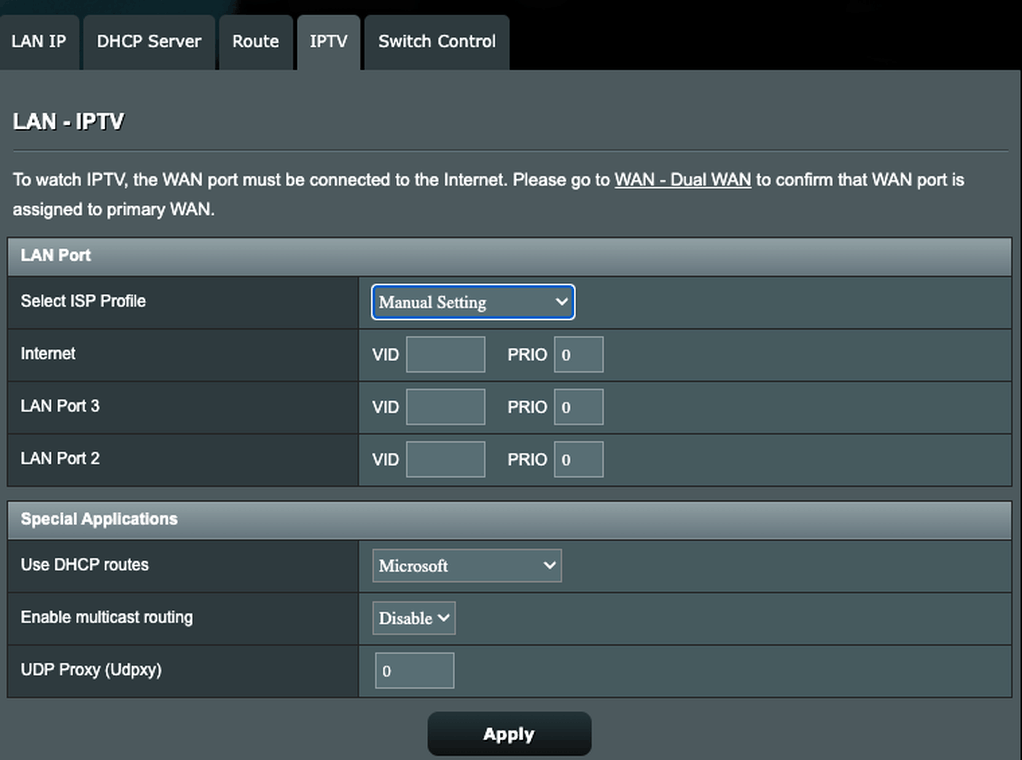

So, Nokia connected XS-010G-Q.
PON light turns on solid.
Connected my ASUS router. But, the data doesn’t turn on. I was able to turn on the clan to 100 (and tried 500). But data doesn’t turn on.
On the ASUS it claims the network cable on the WAN isn't connected.
when the PON wasnt solid or if i restart the modem the data does blink.
any suggestions?

Afbeeldingslocatie: https://tweakers.net/i/u8E7mXajPjRVkf9jh05uRTXqjmA=/full-fit-in/4000x4000/filters:no_upscale():fill(white):strip_exif()/f/image/E4IHc0tSQOnufFhb0ToPHmZp.png?f=user_large
I put here on the internet 100
I assume I do not need to do it on the other lab ports?

Tell us which Asus router you’re using.
No need for software update if PON light is solid.
I think the vlan mapping in your router is wrong.

yeahbaby schreef op maandag 18 december 2023 @ 19:49:
This is an ASUS XT8
I also have “waiting” RT-AC88U (currently not connected).
I tried to replace the cable without result. Very odd behavior.

Disconnect router from ONT. Fill in 100 in Vid behind internet, leave others same, save, restart router. After restart connect router blue WAN port to ONT.

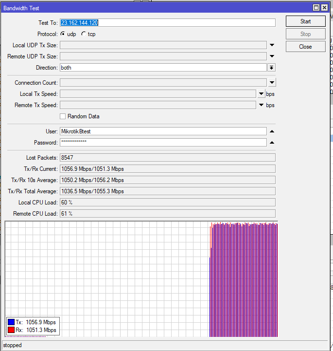

Speedtesten gedaan en netjes 985Mbps Down en 996Mbps Up.. Wat mij vooral opvalt en ook goed merkbaar is is de latency, de IDM SE test deze met verschillende SaaS diensten. Bij Ziggo is dit 19ms en nu met Delta/Glas maar 5-6ms.
Ziggo ook maar opgezegd, kan als backup, maar is voor mij een beetje overdreven.. 😇

Connected it again tonight. Woke up - eureka! Data is light.
Connected to the Webui and Afbeeldingslocatie: https://tweakers.net/i/r-zmf5U_x_qzu0xMRL2bNbn61qE=/800x/filters:strip_exif()/f/image/mYtb3T9JZtf5jTNq3rz7PKAL.png?f=fotoalbum_large
Seems like a different version from what's mentioned in the TS?
Anyway, setup the Asus on router mode + VLAN on 100 and done.
Internet is working. I need to connect directly later to check the speed.
I wonder if it's just the system working as expected or did @R3D pulling the strings on the back.
I'll try to write an E2E guide for more novice people.

De eerste bandwidth test met een 1 Gb abo, Uitgevoerd op een RB5009 met zaram.
Afbeeldingslocatie: https://tweakers.net/i/QgYMFM7LGa4HPEivDPVjvfhTgrY=/full-fit-in/4000x4000/filters:no_upscale():fill(white):strip_exif()/f/image/CgTzabhi5CRdmTzh3QP1A66X.png?f=user_large
Zie forum:
https://forum.mikrotik.co...1ed8a5745ed79d5db77b58a07

henleu schreef op woensdag 20 december 2023 @ 14:35:
Zie forum:
Dat kan helemaal niet… volgens PostNL is jouw pakket nog onderweg :) .
Top man, mooi dat het dus direct in een rb5009 werkt!

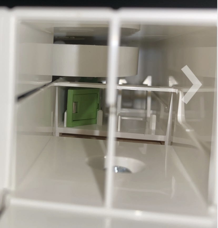

Ecke schreef op woensdag 20 december 2023 @ 15:29:
Een koppelstukje (zoals ik de TS lees) gebruik je alleen om de kabel te verlengen. Dan is dit wel nice! Ik doe zelf denk ik de kabel rechstreeks in de attema inschuifmodule (schuiflade). Heb ik nu ook met mijn AON verbinding.
In de FTU zit een SC/APC female aansluiting met een verend klepje.
Afbeeldingslocatie: https://tweakers.net/i/9gk_sXJkH9bLAyI5cywK3QVzzbQ=/full-fit-in/4920x3264/filters:max_bytes(3145728):no_upscale():strip_icc():fill(white):strip_exif()/f/image/p37cISdb7oOwg1SIB1WWMlK2.jpg?f=user_large
In de praktijk kan het voorkomen dat de insteek connector van de schuiflade achter het klepje vast komt te zitten en dan heb je een probleem. Terug steken lukt dan ook niet meer, officieel zul je dan een monteur moeten laten komen en bij Delta kan dat rustig een aantal dagen duren. Je kunt (officieel) het zelf niet oplossen omdat de FTU verzegeld is… 😉 })
Afbeeldingslocatie: https://tweakers.net/i/vvrFZq0YG5KQmiZERjQnvXQrt7s=/800x/filters:strip_icc():strip_exif()/f/image/zOOFOmMzAWhTVwaRTfqb0CEb.jpg?f=fotoalbum_large
