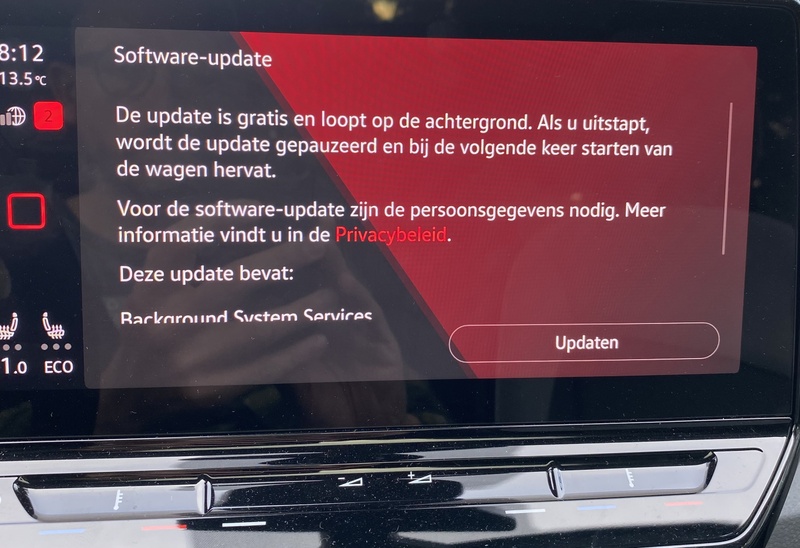

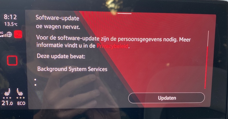

Hier kreeg ik vanochtend ineens een "Background Services" update aangeboden, die had ik een paar weken terug ook al eens een gehad. Geen idee of dit iets met de gefaalde deel 2 update te maken heeft, vooralsnog download deel 2 van de 2.3 OTA in elk geval nog niet opnieuw.

Kreeg die "Background services" net ook, na afronding 2.3 (deel 2). Eveneens inderdaad al tijd geleden gehad (ORUN)
Denk dus dat iedereen die vandaag gepushed krijgt?

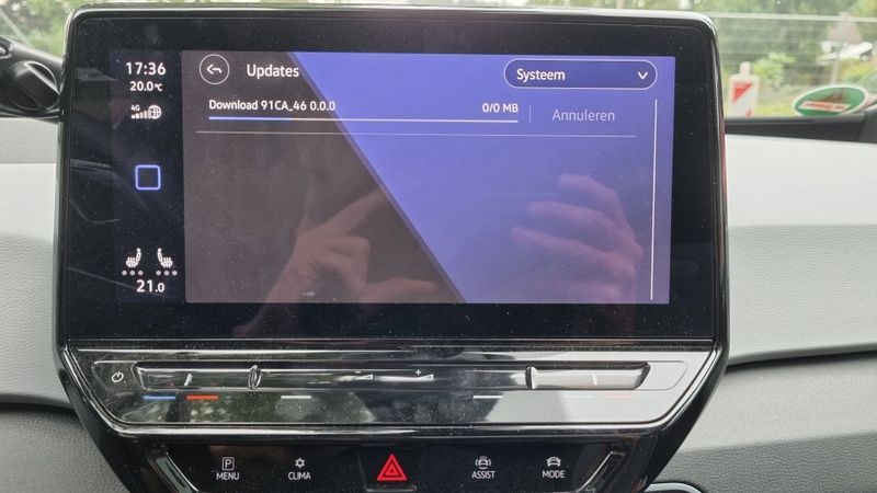

Volgens mij is deel 2 nu aan het downloaden... duurt een stuk langer dit keer...

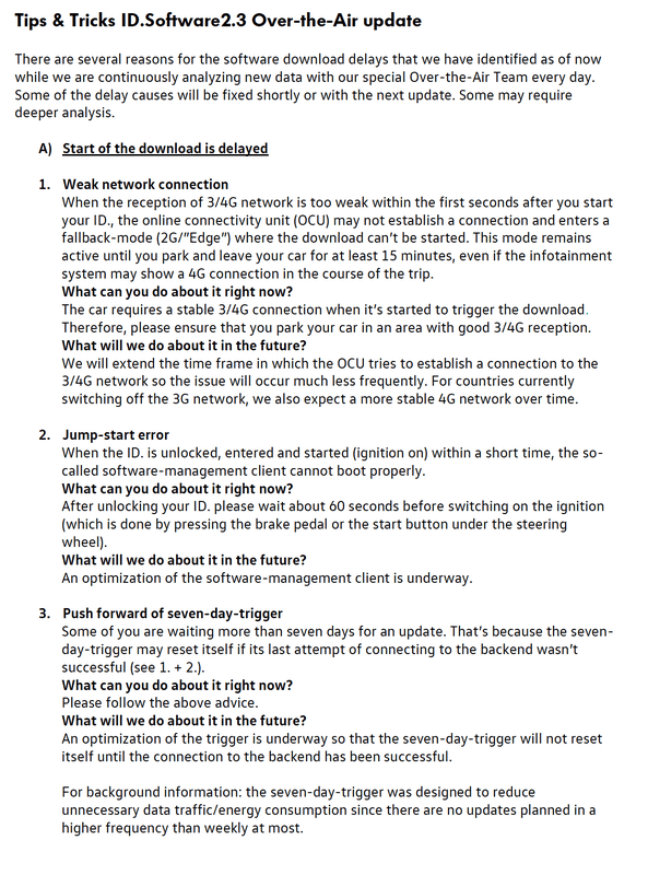

Deze heeft VW net in de Facebook groep geplaatst.

Bericht van Volkswagen in de groep:
Dear First Movers,
We have started the rollout of the ID.Software2.3 - the very first Volkswagen Over-the-Air Update. Based on your comprehensive and constructive feedback we have already learned a lot from those of you who had updates without any problems and those of you who for instance are still awaiting the update. We are happy to share this information so any First Mover who will receive the update soon can already benefit from the previous experiences and make use of the tips & tricks we learned along the way.
The update has been up and running for a few days now and worked well on a couple of hundred cars. We are glad to see many happy customers with “thumbs up” for not having to visit a dealer for new software. At the same time, despite never having seen such delays in our test cars before, we are facing unexpected delays in the download process with (too) many of you!
The main reason for the delays appears to be an unfortunate coincidence of switching of the 3G network in some markets. This causes download delays from our backend in which case the car stops the download process following pre-installed cyber-security rules.
Please check our recent “Tips & Tricks” attached here that contain some information on how to avoid problems during the update process and answers many questions that we collected over the past days. Thank you for your patience and understanding, that we don’t give such comprehensive answers to your questions on a daily basis but rather collect & structure the topic for all of you.
Thank you for your feedback and input - keep it coming! Among other topics, we have started to take up the following key points for improving the future Over-The Air updates:
Measures to enable downloads despite poor network quality at the start of a trip
Better We Connect ID. app integration
Triggered downloads and timed installation of updates
Better display of the progress for download and installation
Presentation of release notes on multiple channels
Please let us know if we have missed anything. Thank you, enjoy your holidays!
Best regards,
your Volkswagen ID. Team
Ook nog een PDF zelfde als Screenshot @MJMaverick : https://1drv.ms/b/s!Ag8ftmEegXgrmJRVTIR83afMPDmSQw?e=0He6dD

C0C0 schreef op dinsdag 3 augustus 2021 @ 18:26:
Ook nog een PDF- (ff uploaden)
Ik wist niet hoe het uploaden moest, dus ik heb maar screenshots gemaakt :P

Vanochtend een update melding gehad (ID.3 1st Max) maar ik ben geen first-mover lid/member, enig idee wat dit is? Heb de update nog niet uitgevoerd omdat ik aan het rijden was, vanavond maar eens aanzetten.
Afbeeldingslocatie: https://tweakers.net/i/H5u10_B6DADOWST24vVbK7fZG-g=/800x/filters:strip_icc():strip_exif()/f/image/v2VPdOFXhHLj9Bc9Zg2epegN.jpg?f=fotoalbum_large
Afbeeldingslocatie: https://tweakers.net/i/IoU2Ub8ydEtXbfNZqu6qhoHKcPs=/800x/filters:strip_icc():strip_exif()/f/image/FVkpOmlIgwtCfKTAfIfP8mg8.jpg?f=fotoalbum_large

  • FlowDesign
  • Laatst online: 08:40
Ongoing....
Afbeeldingslocatie: https://tweakers.net/i/eHL6IP4LtZyCEfbBqrhmBsOPrlc=/800x/filters:strip_icc():strip_exif()/f/image/Hhdm6yTuQZSe5Oq5liTeViza.jpg?f=fotoalbum_large

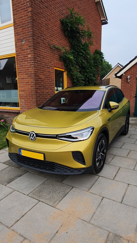

avluijk schreef op dinsdag 6 juli 2021 @ 21:19:
Vandaag mijn toekomstige nieuwe leaseauto alvast kunnen bewonderen bij de dealer. Eerste keer dat ik hem in het echt in deze kleur zag en ben er heel blij mee! Jammer genoeg krijg ik hem pas over kleine twee maanden mee wanneer mijn huidige leasecontract afloopt (al hoop ik stiekem nog iets met de lm te kunnen regelen).
Na 5 maandjes wachten staat mijn VW ID.4 Business dan eindelijk op onze oprit. Deze is trouwens afgeleverd met software 2.1. Maar goed, eerst maar eens alles gaan verkennen, die update naar 2.3 zie ik (hopelijk) vanzelf wel een keer binnenkomen.
Afbeeldingslocatie: https://tweakers.net/i/G4hwk7F7HKJBm7dnNvzAyxAEQLg=/x800/filters:strip_icc():strip_exif()/f/image/GwtaVbDlsast3iwTG2TioVoc.jpg?f=fotoalbum_large

MJMaverick schreef op dinsdag 3 augustus 2021 @ 18:26:
Dit verklaard wel een boel. Heb twee weken terug factory reset gedaan, dus dat kan verklaren waarom ik de update nog niet gehad heb.
Vraag me nu ook af hoe sterk de 4G verbinding moet zijn, want bij ons in de auto zie ik meestal maar 1 of 2 streepjes. Lijkt wel of ik alleen 4 streepjes heb als ik vlak onder de paal door rij in het centrum van het dorp. Blijft vreemd hoe slecht de 4G verbinding lijkt te zijn van de auto terwijl ik met mijn mobiel gewoon volle bak bereik heb. Waar hebben ze de 4G antenne in de auto verstopt 8)7
Laten we leuk blijven tegen elkaar
Heb last van optie 2. Is de oplossing alleen de auto unlocken of moet ik ook in de auto gaan zitten?
When the ID. is unlocked, entered and started (ignition on) within a short time, the so-called software-management client cannot boot properly.What can you do about it right now?After unlocking your ID. please wait about 60 seconds before switching on the ignition (which is done by pressing the brake pedal or the start button under the steering wheel).
  • Simply1337
  • Laatst online: 29-11-2024
niki_lauda schreef op woensdag 4 augustus 2021 @ 09:05:
je mag alles doen behalve de auto opstarten (rempedaal/startknop indrukken).
Denk dat je er in moet zitten anders start het entertainment systeem niet op.
  • Kacang
  • Laatst online: 09:39
Na het lezen van de pdf. Zojuist in de auto gaan zitten en 2 minuten gewacht. Daarna rempedaal ingetrapt. Binnen 10 minuten kreeg ik de update melding. Hij is nu eindelijk aan het updaten.

Zoals ik al aangaf, slechts 1 of 2 streepjes 4G is voldoende om de update te downloaden. Zolang je maar 4G bereik hebt. Als ie in 2G (Edge) of 3G schiet dan lukt het niet. En aangezien we in Nederland binnenkort voor zover ik weet dat niet meer hebben zal dat niet zo snel gebeuren.
Overigens ben ik nog steeds benieuwd of er nou wel of geen 5G modem aanwezig is.

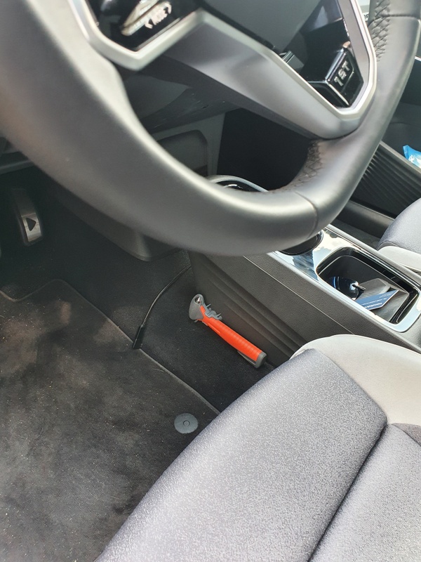

Waar zit bij jullie de noodhamer?
  • MJMaverick
  • Laatst online: 19-08 21:36
Ronvgs schreef op woensdag 4 augustus 2021 @ 12:32:
Afbeeldingslocatie: https://tweakers.net/i/KbgnjUG9s2voya-B4LXefH67URs=/x800/filters:strip_icc():strip_exif()/f/image/fAJFPbqCxeftsA0dMGU9JgK8.jpg?f=fotoalbum_large

Kacang schreef op woensdag 4 augustus 2021 @ 10:01:
Ook geprobeerd maar helaas :)
Ik denk ook dat 1 streepje 4G voldoende is want de Background Services kreeg ik gister wel meteen. Ik stap in en trap de rem al in voor ik de gordel om heb, dus dat is een kwestie van 2 seconden. Omdat de achteruitrijdcamera ook meteen reageert zonder lag rijd ik ook altijd meteen weg. Lijkt dus alsof daar het probleem bij mijn ID.3 niet in zit.

Van FB:
Dear First Movers,
We see a lot of your posts and questions regarding the updates you get in your ID.s and would like to explain the differences between them.
In our ID. models, we distinguish between the following types of Over-the-Air software updates:
System updates”, for example the ID.Software2.3, are applied to numerous control units and basically can be seen as the operating system of your car. Previously, a workshop-visit was necessary for those updates. The ID.3 was our first model capable to receive them without visiting the workshop.
System In-Car Apps”, for example the digital manual, legal app, etc., are pre-installed apps that perform important tasks but do not influence the behavior of your car in terms of driving, charging or safety. Those apps can be updated much more frequently because they don’t require such extensive testing. This makes it easier for us to adopt to your feedback and wishes within a much shorter amount of time.
Navigation updates” are well-known and basically do not differ from what you may be used to in our conventional (combustion engine) cars.
While we have just started the rollout of our very first system update, the ID.Software2.3, we have yet deployed a few System In-Car Apps already. You have seen them (or soon will) in your infotainment system:
Digital Manual” replaced the physical manual in most countries and allows us to update the manual without having to print and send out tons of paper. They are also a prerequisite for upcoming system updates (otherwise you would have to change your physical manual at the dealer).
ORURN” turns the visualization of release notes (for system updates) from plain text into a HTML format including pictures and formatted fonts.
Background System Service” fixes a bug that has caused the notification on the availability of new System In-Car App updates to show up only once. After installing the “Background System Services” update, future notifications will come up again until you have installed the update.
PLEASE NOTE: If you have received but not yet installed the “ORURN” In-Car App, you will see the notification for it again and can now install it subsequently.
UPCOMING: “Information for system updates” is basically the same as “ORURN” but this time we chose a more descriptive text (also in the details under “This update contains:”).
Important note: The In-Car Apps do not affect the system updates. Both run independently from each other but in some cases, In-Car Apps can only be deployed to cars with the latest ID. software version.
Do you have any questions regarding the different types of updates? Please let us know in the comments below.
Best Regards,
Your Volkswagen ID. Team
