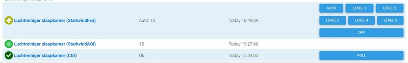

Ikea heeft die, incl luchtreiniger
Afbeeldingslocatie: https://tweakers.net/i/Nb-VpEeEPV8Cr_EmU-E_WE8MIpM=/800x/filters:strip_icc():strip_exif()/f/image/aopHVNAnLHKMd6k9c0OJCgbT.jpg?f=fotoalbum_large

Ik heb het tafelmodel, en deze werkt iig met homeseer (daar is de screenshot van) prima
Mocht je ook iets met mqtt kunnen doen is een combi van
https://www.ikea.com/nl/n...kwaliteitsensor-70498242/
met een hack kan je deze wel uitlezen

info  2021-10-20 15:47:11: Logging to console and directory: '/opt/zigbee2mqtt/data/log/2021-10-20.15-47-07' filename: log.txt
info  2021-10-20 15:47:11: Starting Zigbee2MQTT version 1.21.2 (commit #44922120)
info  2021-10-20 15:47:11: Starting zigbee-herdsman (0.13.149)
info  2021-10-20 15:47:15: zigbee-herdsman started (resumed)
info  2021-10-20 15:47:15: Coordinator firmware version: '{"meta":{"maintrel":3,"majorrel":2,"minorrel":6,"product":0,"revision":20201127,"transportrev":2},"type":"zStack12"}'
info  2021-10-20 15:47:15: Currently 0 devices are joined:
warn  2021-10-20 15:47:15: `permit_join` set to  `true` in configuration.yaml.
warn  2021-10-20 15:47:15: Allowing new devices to join.
warn  2021-10-20 15:47:15: Set `permit_join` to `false` once you joined all devices.
info  2021-10-20 15:47:15: Zigbee: allowing new devices to join.
info  2021-10-20 15:47:16: Connecting to MQTT server at mqtt://localhost:1883
info  2021-10-20 15:47:16: Connected to MQTT server
info  2021-10-20 15:47:16: MQTT publish: topic 'zigbee2mqtt/bridge/state', payload 'online'
info  2021-10-20 15:47:16: MQTT publish: topic 'zigbee2mqtt/bridge/config', payload '{"commit":"44922120","coordinator":{"meta":{"maintrel":3,"majorrel":2,"minorrel":6,"product":0,"revision":20201127,"transportrev":2},"type":"zStack12"},"log_level":"info","network":{"channel":11,"extendedPanID":"0x00124b0018e2ef0c","panID":6754},"permit_join":true,"version":"1.21.2"}'
Nu heb ik twee problemen:
- De controller accepteert geen nieuwe devices/lampen (ondanks dat de lampjes netjes in factory mode gaan).
- In Domoticz (op een ander rpi die verbinding maakt via poort 1883) wordt de verbinding verbroken. Python plugin wordt gezien en plugin zigbee2mqtt ook geinstalleerd.
Log:
2021-10-20 19:04:34.979 Status: zigbee: (zigbee) Started.
2021-10-20 19:04:34.979 Status: zigbee: (zigbee) Entering work loop.
2021-10-20 19:04:35.198 zigbee: (zigbee) Installing plugin custom page...
2021-10-20 19:04:35.217 zigbee: (zigbee) Installing plugin custom page completed.
2021-10-20 19:04:35.269 zigbee: (zigbee) Connected to MQTT Server: 192.168.0.37:1883
2021-10-20 19:04:35.372 zigbee: (zigbee) Zigbee2mqtt bridge is online
2021-10-20 19:04:35.373 zigbee: (zigbee) Joining new devices is enabled on the zigbee bridge
2021-10-20 19:04:35.374 zigbee: (zigbee) Received available devices list from bridge
2021-10-20 19:04:35.374 zigbee: (zigbee) Received available devices groups from bridge
2021-10-20 19:04:35.196 Status: zigbee: (zigbee) Initialized version 3.1.0-beta
Wie kan mij verder helpen? Na twee dagen tobben en zoeken etc. weet ik het niet meer. Wie wel? Alvast bedankt!
