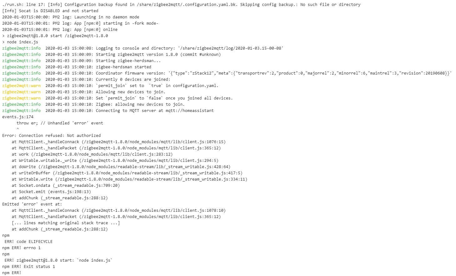

Ik heb een geflashte CC2531 stick gekocht van een mede-tweaker en deze aangesloten op mijn RPI met Hassio en de add-ons “Mosquitto broker” en “Zigbee2mqtt”.
In mijn Mosquitto broker logs zie de volgende errors:
1578050814: Socket error on client <unknown>, disconnecting.
1578050823: New connection from 172.30.33.1 on port 1883.
1578050823: Socket error on client <unknown>, disconnecting.
1578050833: New connection from 172.30.33.1 on port 1883.
1578050833: Socket error on client <unknown>, disconnecting.
1578050840: New connection from 172.30.33.1 on port 1883.
etc
Waar is dat IP adres van? Is iig geen adres in mijn netwerk denk ik.
In Zigbee2mqtt logs zie ik het volgende:
> node index.js
zigbee2mqtt:info 2020-01-03 12:34:37: Logging to console and directory: '/share/zigbee2mqtt/log/2020-01-03.12-34-37'
zigbee2mqtt:info 2020-01-03 12:34:38: Starting zigbee2mqtt version 1.8.0 (commit #unknown)
zigbee2mqtt:info 2020-01-03 12:34:38: Starting zigbee-herdsman...
zigbee2mqtt:info 2020-01-03 12:34:39: zigbee-herdsman started
zigbee2mqtt:info 2020-01-03 12:34:39: Coordinator firmware version: '{"type":"zStack12","meta":{"transportrev":2,"product":0,"majorrel":2,"minorrel":6,"maintrel":3,"revision":20190608}}'
zigbee2mqtt:info 2020-01-03 12:34:39: Currently 0 devices are joined:
zigbee2mqtt:warn 2020-01-03 12:34:39: `permit_join` set to `true` in configuration.yaml.
zigbee2mqtt:warn 2020-01-03 12:34:39: Allowing new devices to join.
zigbee2mqtt:warn 2020-01-03 12:34:39: Set `permit_join` to `false` once you joined all devices.
zigbee2mqtt:info 2020-01-03 12:34:39: Zigbee: allowing new devices to join.
zigbee2mqtt:info 2020-01-03 12:34:39: Connecting to MQTT server at mqtt://core-mosquitto
events.js:174
throw er; // Unhandled 'error' event
Error: Connection refused: Not authorized
at MqttClient._handleConnack (/zigbee2mqtt-1.8.0/node_modules/mqtt/lib/client.js:1076:15)
at MqttClient._handlePacket (/zigbee2mqtt-1.8.0/node_modules/mqtt/lib/client.js:365:12)
at work (/zigbee2mqtt-1.8.0/node_modules/mqtt/lib/client.js:283:12)
at Writable.writable._write (/zigbee2mqtt-1.8.0/node_modules/mqtt/lib/client.js:294:5)
at doWrite (/zigbee2mqtt-1.8.0/node_modules/readable-stream/lib/_stream_writable.js:428:64)
Het lijkt erop dat er iets mis is met de authorisaties (klopt dit?), maar ik kan niet vinden waar ik dat moet instellen. Kan iemand mij op weg helpen? De LED op de stick brandt groen.

@Jerry33 Wat is de mqtt instelling in de add-on? Probeer dit:
  "mqtt": {
    "base_topic": "zigbee2mqtt",
    "server": "mqtt://homeassistant",

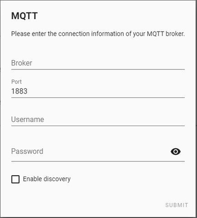

@Slaut Ik werk met Hassio en heb de MQTT add-on opnieuw geinstalleerd. Dan krijg ik onderstaand invulformulier. Wat vul ik in bij broker? Is dat gewoon een naam of een url of zo?
Username en password heb ik gewoon ingevuld met mijn Hassio inloggegevens. Is dat OK?
Afbeeldingslocatie: https://tweakers.net/ext/f/ZdeOHTHVjVqe3DFLgS2X74D7/thumb.jpg
Edit: ik heb inmiddels gevonden dat ik mijn Hassio ip adres moet invullen. Dit heb ik gedaan en het formulier wordt geaccepteerd. Nu alles even herstarten en kijken wat er gebeurt.
[ Voor 34% gewijzigd door Jerry33 op 03-01-2020 14:45 ]

@Jerry33 Ik bedoelde de zigbee2mqtt add-on, kun je daar de mqtt settings invullen die ik deelde?
  • Jerry33
  • Registratie: Mei 2014
  • Laatst online: 26-11 06:43
@Slaut wijziging gedaan in regel 3. De rest was al OK. Ik heb de addon opnieuw gestart en krijg dan deze log:
zigbee2mqttlog
Edit. Probleem inmiddels opgelost. Ik weet niet zeker wat ik allemaal geprobeerd heb, maar volgens mij was het autorisatie gerelateerd. Ik heb iig een nieuwe user aangemaakt, ik las ergens dat je niet dezelfde user mag gebruiken als de standaard HA user. Ik heb dus een nieuwe user aangemaakt speciaal voor mqtt.
Daarnaast las ik ook ergens dat als je anonimous op true zet dat je een lijst met authorized users moet opstellen en die had ik niet. Anonimous staat nu op false en mqtt werkt nu met mijn mqtt user.
Pff, het is allemaal niet simpel en kost erg veel tijd, maar wel leuk als het uiteindelijk toch werkt...
[ Voor 52% gewijzigd door Jerry33 op 03-01-2020 21:43 ]

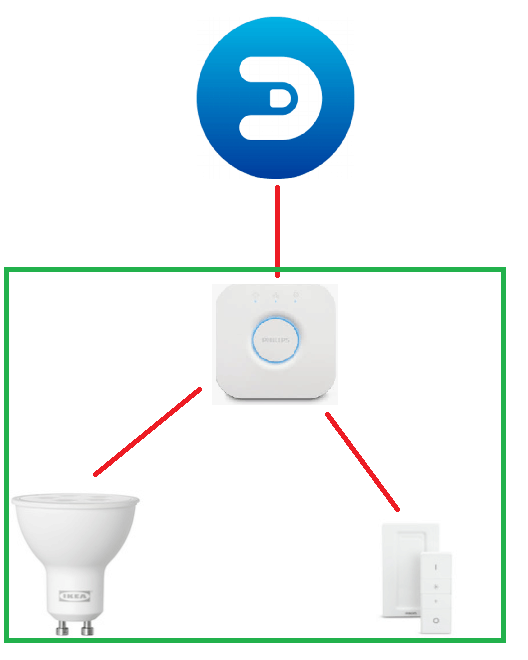

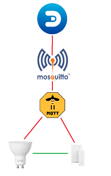

Iemand een slim idee op het volgende.
ik bouw mijn domotica altijd in met een Fail-safe modus.
Nu heb ik mijn huidige situatie een fail safe zitten dmv een Hue hub
(alle verlichting is niet meer te gebruiken bij uitval van Domoticz)
(mijn ikea spots blijven altijd bedienbaar via de HUE hub en de HUE remote, mocht domoticz uitvallen).
Afbeeldingslocatie: https://tweakers.net/ext/f/VVsTaAPa9fJgXPDFEf6c6HhF/thumb.png
Nu heb ik ook Zigbee2mqqt in mijn settup geïntroduceerd, en heel wat op draaien.
En nu wil ik eigenlijk ook mijn ikea Led spots erop hebben.
Echter loopt de communicatie nu heel anders, en krijgt Domoticz nu de Rol als controller ipv de HUE hub. dus valt me Fail safe functie weg.
Iemand een idee hoe ik ook een HUE remote Direct kan laten communiceren met de Ikea Spots zonder gebruik van de HUE hub/ IKEA hub?
Waarbij de groene lijn dus een failsafe iets zou moeten zijn.
(ik ben dus bang dat ik niet ontkom aan de HUE hub)
Afbeeldingslocatie: https://tweakers.net/ext/f/dkvKM9Az9w6eIr4wLmWCfcy0/thumb.png
Iemand een idee?

luigi87 schreef op vrijdag 24 januari 2020 @ 15:51:
Iemand een idee?
Ja, dat kan met binding, zie https://www.zigbee2mqtt.io/information/binding.html
Eenmaal ingesteld werkt dit ook als je coördinator offline is.

  • Dacuuu
  • Laatst online: 17:44
BartV schreef op zaterdag 25 januari 2020 @ 08:42:
Dit is ook eigenlijk wat ik nu wilde vragen hier. Ik heb nu een xiaomi hub voor mn zigbee stuff, ik heb ook ervaring met Zwave fibaro dimmer, deze dimmer module dimt de domme lampen zonder enige vorm van domotica, En dat is wel prettig, toch alles bedienbaar via domotica, maar ook gewoon zonder, zodat het altijd werkt.
met zigbee bindings kan je dus een tradfri dimmer direct aan een tradfri lamp koppelen zodat je de dimfunctie van het dim-kastje goed kan gebruiken, kan je het tradffri dimmer-kastje ook aan een andere zigbee lamp koppelen, zodat je die natve kan dimmen?
Ik dim nu met node-red,zodra ik op de knop druk, doet hij de huidige status +5 bijv zodat de lamp feller gaat, werkt prima, maar traploos native dimmen zou wel mooier zijn.
