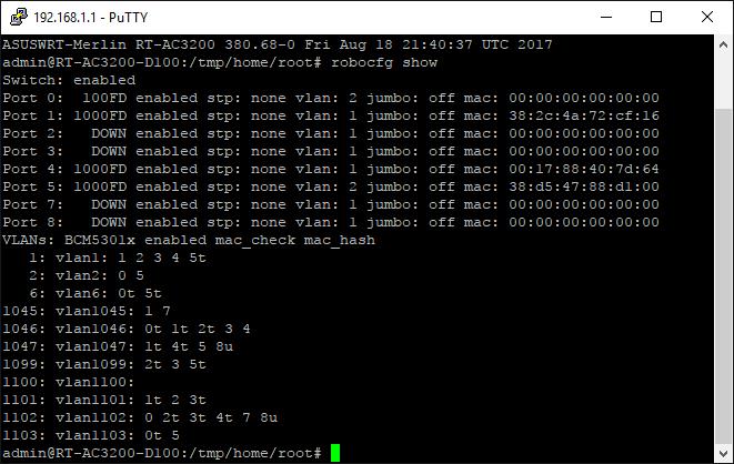

  • DLeijen
  • Laatst online: 14-11 15:16
Na tweemaal de handleiding gevolgt te hebben lijk ik hetzelfde probleem te hebben als @Martijn1899 had, is hier een oplossing voor?
Log:
Aug 1 02:04:42 pppd[597]: Timeout waiting for PADO packets
Aug 1 02:04:42 rc_service: httpd 544:notify_rc reboot
Aug 1 02:04:43 dnsmasq[538]: read /etc/hosts - 5 addresses
Aug 1 02:04:43 pppd[597]: Unable to complete PPPoE Discovery
Aug 1 02:04:43 pppd[597]: Hangup (SIGHUP)
Aug 1 02:04:43 pppd[597]: Terminating on signal 15
Aug 1 02:04:43 pppd[597]: Exit.
Aug 1 02:04:43 dnsmasq-dhcp[538]: DHCPREQUEST(br0) 192.168.1.241 a4:f1:e8:96:e3:03
Aug 1 02:04:43 dnsmasq-dhcp[538]: DHCPACK(br0) 192.168.1.241 a4:f1:e8:96:e3:03
Aug 1 02:04:43 iTunes: daemon is stopped
Aug 1 02:04:43 FTP_Server: daemon is stopped
Aug 1 02:04:43 Samba_Server: smb daemon is stopped
Aug 1 02:04:43 kernel: gro disabled
Aug 1 02:04:44 Timemachine: daemon is stopped
Aug 1 02:04:44 WEBDAV_Server: daemon is stopped
Aug 1 02:04:44 NAT_Tunnel: AAE Service is stopped
Aug 1 02:04:44 kernel: usbcore: deregistering interface driver cdc_mbim
Aug 1 02:04:44 kernel: usbcore: deregistering interface driver cdc_ncm
Aug 1 02:04:44 kernel: usbcore: deregistering interface driver qmi_wwan
Aug 1 02:04:44 kernel: usbcore: deregistering interface driver cdc_wdm
Aug 1 02:04:44 kernel: usbcore: deregistering interface driver rndis_host
Aug 1 02:04:44 kernel: usbcore: deregistering interface driver cdc_ether
Aug 1 02:04:44 kernel: usbcore: deregistering interface driver asix
Aug 1 02:04:44 kernel: usbcore: deregistering interface driver usblp

wan-start script:
#!/bin/sh
# Leave VOIP traffic tagged for original router
# /usr/sbin/robocfg vlan 7 ports "0t 3t 5t"
# Setup VLAN4 on the CPU as well so we can talk to it
/usr/sbin/robocfg vlan 4 ports "0t 5t"
# /usr/sbin/robocfg vlan 1 ports "1 2 4 5t"
# Add VLAN4 as a physical interface
/sbin/vconfig add eth0 4
# Request an IP-address and setup static routes
/usr/bin/killall udhcpc
sleep 1
udhcpc -i vlan4 --clientid-none -O msstaticroutes -O staticroutes -V IPTV_RG -s /jffs/scripts/vlan4.script -p /var/run/vlan4.pid -b -O33 -O249
# Restart IGMP proxy
sleep 20
/usr/bin/killall igmpproxy
sleep 1
/usr/sbin/igmpproxy /jffs/configs/igmpproxy.conf
Robocfg show output:
Robocfg
De experiabox v10 klapte hiervoor er om het half uur uit, dus zit nu geheel zonder internet :| .

Eén dingetje waar wellicht anderen nog wat aan kunnen hebben: router ID. Het 'CPU-ADDRESS', verkregen bij stap 4.5 in de handleiding, was bij mij opeens veranderd na een reboot aan het einde van de handleiding. De interactieve TV werkte niet en ben dus op onderzoek uit gegaan. Ik zag dat mijn '8t' (ik gebruik even voorbeelden, weet niet meer exact wat het ID was) opeens naar '7t' was veranderd. Na de regels in het wan-start script veranderd te hebben naar het nieuwe ID werkte alles als een zonnetje. Echt top, thanks y'all!
Mooi mooi! :D
Dat het hardwareadres kan veranderen is mij niet bekend iig.

Helaas krijg ik toch een probleem, WAN wordt niet meer gestart:
Aug 1 02:00:39 custom_script: Running /jffs/scripts/nat-start
wordt keurig uitgevoerd, maar wan-start niet. dat komt doordat plotseling de WAN niet meer wordt gestart.
Zodra ik het soort overzet naar PPPoE wordt de WAN niet meer gestart.
Daardoor volgt deze melding:
Aug 1 02:00:38 custom_config: Using custom /jffs/configs/igmpproxy.conf config file.
Aug 1 02:00:39 igmpproxy[908]: There must be at least 2 Vif's where one is upstream.
Dan krijg ik uiteraard deze melding:
Aug 1 02:01:03 pppd[566]: Timeout waiting for PADO packets
doordat er geen WAN is, valt er geen PPPoE op te zetten, dus komt er een fout op de 'Offer' (Waarom trouwens niet op de PADI omdat die niet kan worden verstuurd?).
In ieder geval: Hier staat m'n syslog: https://www.dropbox.com/s/23oxgr3ufiudgug/syslog.txt?dl=0
Dit is trouwens niet eens m'n eerste log. Volgens mij had ik hier de settings eerst weer terug gezet en vervolgens nogmaals geprobeerd om de handleiding letter voor letter te volgen. (In totaal 3x geprobeerd; 2x vanaf factory reset, 1x vanaf een werkzame situatie met de asus op de experia V8)
En heel erg bedankt voor jullie effort die jullie hier al in steken!

@Arcow -> Heb je ook je vlan ingesteld in je IPTV tab?
Afbeeldingslocatie: http://i65.tinypic.com/28be06q.png
