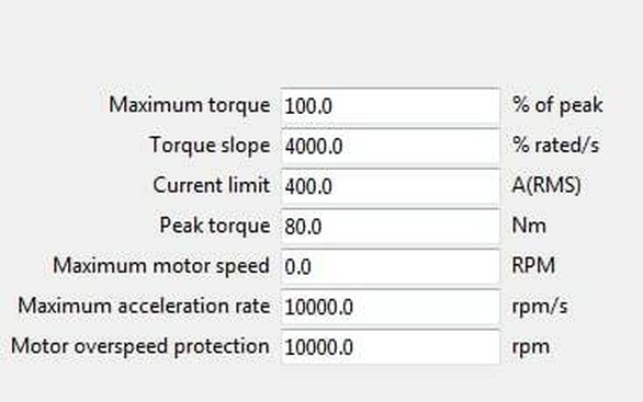

  • Miscelaneo
  • Registratie: Juni 2022
  • Laatst online: 19-09-2022
Hi, I bought an used Govecs Go 3.4 and was been limited by the first owner. I'm no trying to know the limits with the DVT software. Does any one has the original config file? No idea what where the original parameters and I'm only shooting in the dark.
For now I've tried with 3600rpm and 65 amps with 100% of torque on 114Nm. Gets to 95km/h. During acceleration I get the High Current display alert.
Nice forum you have here.
if you dont know how DVT works you should probably not mess with it without backing up your original config file first. there are not many people with a 3.6 config file so be careful with your config. i have almost every config but not the 3.6 as it has the big boy parker motor that almost nobody has.
how fast does it go with wheel off the ground?

I made a copy of the already customized config that came when I bought it. It's a 3.4, not a 3.6.
With the wheel on the air reaches 95 km/h.

Had no idea where the limit is. I have been riding at 41°, summer here in Spain. No heat alert. The sensor seems to be activated on the DVT software.
The motor looks square, no stickers on it.
The torque curves are flat on DVT, is that normal?
Wich would be to he safe speed or rpm for this motor? Could you share the original config file?
Thanks for the help.

First show what motor you actually have. The parts change depending on the country. Loading up the wrong dcf could be "bad" to say the least.

This is the boy. Govecs go 3.4.
Afbeeldingslocatie: https://tweakers.net/i/NFCTih_hmm_Ly13ktozo3g30p8A=/x800/filters:strip_icc():strip_exif()/f/image/YGJYsXLGEmsxBV3ljNAgkPkB.jpg?f=fotoalbum_large
Afbeeldingslocatie: https://tweakers.net/i/FRYBeHIjJrFAxpCt27eL8FcuaQI=/full-fit-in/4000x4000/filters:no_upscale():strip_exif()/f/image/le5cTqdnMQZEn9qarazCm0fL.png?f=user_large
  • flippy
flippy
Alle rechten voorbehouden.
That is the big parker. Its a 3.6.

The limits are already set in the motor section of the tree tab in DVT. But you need to change the operating limits, those are in other places. Do NOT change parameters in the motor tab. You WILL kill your motor if you do that. DVT is a program without handlebars, its extremely easy to damage things if you dont know what buttons you are actually pressing.

I mean the motor limits, the specs, can't trust the data that came on the DVT since the original owner changed things.

Please share your settings on the motor and tourque settings. See if anything jumps out. I dont know the original specs but wrong things usually stick out.

This is how it came to my hands.
Afbeeldingslocatie: https://tweakers.net/i/Ywq24G-zxplRfkT5pA87uuOVuTY=/full-fit-in/4920x3264/filters:max_bytes(3145728):no_upscale():strip_icc():fill(white):strip_exif()/f/image/xEnX80yeJ1jsFtvcslQwEJmv.jpg?f=user_large

When I set more than 75A on the sevcon the motor cuts at 50/60 km/h more or less when I am at ful throttle. Then I have to wait and recicle with the key.
hook it up when it cuts out and read the fault code.

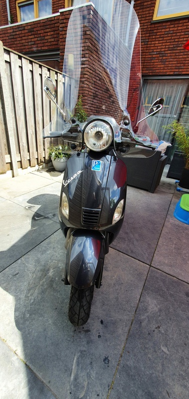

OlafBso
Eindelijk klaar
Afbeeldingslocatie: https://tweakers.net/i/KqR6BCaETS4tdVDG8uu2VXBHJ14=/800x/filters:strip_icc():strip_exif()/f/image/WyF4Pf453rTDwUWrz2WwphuZ.jpg?f=fotoalbum_large
Afbeeldingslocatie: https://tweakers.net/i/7VHlGe_Q5wjB2Dje962wUp_gEUc=/x800/filters:strip_icc():strip_exif()/f/image/9RgVpHdzwlcM3AM4bcd8tKPZ.jpg?f=fotoalbum_large
Afbeeldingslocatie: https://tweakers.net/i/qyhqrVoL7ETVvOA_M-bRE7bOn6k=/800x/filters:strip_icc():strip_exif()/f/image/mSuY2vjQ5MtOFkAEbRsRqPYw.jpg?f=fotoalbum_large
Afbeeldingslocatie: https://tweakers.net/i/fy-ZOUtbK9kulefT7fpIX6vTBv8=/x800/filters:strip_icc():strip_exif()/f/image/JgFWtdD0SzcFgz9FRPNhQHmI.jpg?f=fotoalbum_large
Afbeeldingslocatie: https://tweakers.net/i/qI2MDuUFXvOAYEsMTpuho7V66Gg=/x800/filters:strip_icc():strip_exif()/f/image/71lSo5xJR1hgp9B5JmgZNiem.jpg?f=fotoalbum_large
Weer schoongemaakt, in de wax gezet, onderdelen gesmeerd, bandencheck en mijn verVespaliseerde Novox C50 ziet er weer uit om door een ringetje te halen.
8 jaar oud al weer.
De accu, een lithium 76volt 40ah, met de onderhoudsvrije controller Kelly KLS-S 120A / 300A peak.
2500 watt motor houdt het nog steeds, ooit 2e hands gekocht omdat de originele er de brui aan gaf.
Ik vraag me af: als het écht niet meer kan, die Chinese meuk, wat moet ik dan doen met de controller en accupack als ik de rest naar de schroot breng?
Volgens de verkoper van de accu overleeft deze mijn scooter ruimschoots (gaat zeker 10 jaar mee).
IVA NCE PROlaf
