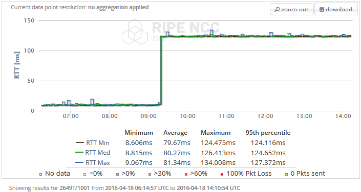

Fijn zo'n RIPE Atlas probe. Dan vallen dingen zoals dit opeens op:
Ping to k.root-servers.net (193.0.14.129)
Afbeeldingslocatie: http://www.briandickens.nl/GoT/atlas-stats.png
Zo rond 09:15 uur. Iets in Ziggo routering veranderd of gewoon iets aan de kant van de rootservers zelf?

Wildfire schreef op maandag 18 april 2016 @ 16:28:
C:\Users\Jerry>tracert 2001:7fd::1
Tracing route to k.root-servers.net [2001:7fd::1]
over a maximum of 30 hops:
  1     *        *        *     Request timed out.
  2     9 ms     9 ms     9 ms  gv-rc0052-cr102-xe-1-0-5-0.core.as9143.net [2001:b88:0:e6f::1]
  3    16 ms    11 ms    13 ms  asd-tr0610-cr101-ae58-0.core.as9143.net [2001:b88:0:101::1]
  4    16 ms    13 ms    12 ms  2001:7f8:1::a502:3148:2
  5    15 ms    20 ms    12 ms  2001:4868:0:8000::22a
  6    30 ms    27 ms    28 ms  2001:4868:0:8000::266
  7    28 ms    27 ms    27 ms  2001:4868:0:8000::261
  8   120 ms   121 ms   121 ms  2001:4868:0:8000::c5
  9   141 ms   137 ms   136 ms  2001:4868:0:8000::39
 10   132 ms   132 ms   132 ms  2001:4868:0:8000::12
 11   133 ms   132 ms   131 ms  router.us-mia.k.ripe.net [2001:4868:100:40::2]
 12   131 ms   131 ms   131 ms  k.root-servers.net [2001:7fd::1]
Trace complete.
C:\Users\Jerry>tracert 193.0.14.129
Tracing route to k.root-servers.net [193.0.14.129]
  1     1 ms    <1 ms    <1 ms  ubee.evw321b.net
  2     *        *        *     Request timed out.
  3     8 ms    16 ms     9 ms  gv-rc0011-cr101-xe-1-0-3-0.core.as9143.net [213.51.181.169]
  4    12 ms    10 ms    10 ms  asd-tr0042-cr101-ae8-0.core.as9143.net [213.51.158.12]
  5    11 ms    11 ms    10 ms  80.249.211.145
  6   125 ms   126 ms   126 ms  85.112.0.140
  7   126 ms   124 ms   125 ms  85.112.0.174
  8   125 ms   126 ms   126 ms  85.112.0.145
  9   128 ms   128 ms   128 ms  t0-1-0-1.br2.mia.terremark.net [66.165.160.85]
 10   130 ms   135 ms   128 ms  t0-1-0-7.br2.mia.terremark.net [66.165.161.137]
 11   126 ms   126 ms   125 ms  t9-1.gw1.mia.terremark.net [66.165.161.94]
 12   125 ms   127 ms   127 ms  router.us-mia.k.ripe.net [204.51.68.250]
 13   124 ms   124 ms   128 ms  k.root-servers.net [193.0.14.129]
Trace complete.
Die probes zijn gaaf :)
Het lijkt alleen vanuit jouw perspectief te komen als ik de tools van Ripe gebruik.

ANdrode schreef op maandag 18 april 2016 @ 19:27:
Het lijkt alleen vanuit jouw perspectief te komen als ik de tools van Ripe goed gebruik:
Weet niet wat je hier precies wilde laden, maar er wordt niets getoond :P
Als ik naar mijn andere grafieken kijk, blijven die gewoon normaal. Het is alleen deze ene die opeens verandert rond 09:15 uur. Ben gewoon benieuwd waar het probleem ligt: andere routering ofzo van Ziggo, of toch een probleem aan de kant van k.root-servers.net?
Niet dat het voor m'n verbinding zelf iets uitmaakt :P

Het lijkt erop dat het vanuit Ziggo naar de k-root in Miami wordt verstuurd. Waarom begrijp ik niet, die in Amsterdam is iig up:
admin@RT-AC66U-0B00:/tmp/home/root# traceroute 193.0.14.129
traceroute to 193.0.14.129 (193.0.14.129), 30 hops max, 38 byte packets
 1  1-0-201-31.ftth.glasoperator.nl (31.201.0.1)  2.974 ms  2.934 ms  2.938 ms
 2  10.10.80.6 (10.10.80.6)  4.214 ms  4.230 ms  3.519 ms
 3  *  router.nl-ams.k.ripe.net (80.249.208.240)  4.200 ms  4.135 ms
 4  k.root-servers.net (193.0.14.129)  4.358 ms  5.077 ms  4.418 ms
  • ANdrode

Wildfire schreef op maandag 18 april 2016 @ 19:35:
De forum software vind de link niet leuk. Nieuwe poging: https://goo.gl/FnQHWq

hcQd schreef op maandag 18 april 2016 @ 19:55:
Dit is vreemd inderdaad. Ik zie hetzelfde, vanuit Ziggo gaat hij naar Miami.
Vanaf mijn werk (Geo IP in UK) gaat hij naar London/LINX.

TFHfony schreef op vrijdag 15 april 2016 @ 10:44:
Grappig ;) Toch eens een aanvraag de deur uit gedaan (Tegen beter weten in...)
Ik ben benieuwd wanneer en of ik wat te horen krijg ;)
Bovenstaande post was i.v.m. de aanvraag van een probe voor de RIPE Atlas: Ik krijg net een e-mail dat er eentje deze kant op komt, dus... :)
Weer een meetpuntje er bij in het Ziggo netwerk.
