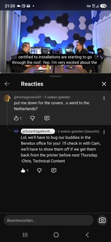

Sinds dit filmpje wilde ik ook alleen nog maar de Nexis

Omdat mijn systeem de MPPT steeds uitschakelt tijdens het ontladen vd accu naar het net, heb ik vorige week Cam en Chris van de Office Hours show gemailt.
Afbeeldingslocatie: https://tweakers.net/i/ZcUd0h9gwos4LHKrwxaQyTM2QRE=/232x232/filters:strip_exif()/f/image/mGj2M1yxGuFPQalOZgdmW5MN.png?f=fotoalbum_tileAfbeeldingslocatie: https://tweakers.net/i/V2ZlvUM-3eZcDxAsC6WKTPFZcmA=/232x232/filters:strip_exif()/f/image/gPRZCDaRfujitTSqG44DvhTP.png?f=fotoalbum_tileAfbeeldingslocatie: https://tweakers.net/i/n0m7HnSFn4UUXklVbcXpVHJ2BXY=/232x232/filters:strip_icc():strip_exif()/f/image/ZW8X7jhdkZaZitWa73jfXSU7.jpg?f=fotoalbum_tile
Afbeeldingslocatie: https://tweakers.net/i/3WrW7ISg9If9CUWS9t56Bi2u3is=/232x232/filters:strip_icc():strip_exif()/f/image/T1QpDGAez5KdwtzHKRCQbyXC.jpg?f=fotoalbum_tile
Hi Jurgen,
Thanks for sending over those details. Cam and I have a theory that the reason your PV is idle during discharge events is because many programs require that only battery power be sent to the grid. Having additional PV discharging increases the amount of credits that can be received by system owners during these events – thus more payout from program managers. We’re checking in with the international team to see if that is expected behavior from Tibber and to verify that your system is using the correct settings.
Long story short, this may be an expected behavior, we just want to make sure it’s the right behavior.
We’re in a bit of a holding pattern while we wait for the Euro team to get back to us. Our access to systems is limited regionally, so we can only look at systems on this hemisphere.
I’ll keep harassing folks on this side for you – AND let you know when we get the custom covers.
🥳🤡Afbeeldingslocatie: https://tweakers.net/i/7b48MszBpfo-FxOEdU4QoLmbHG8=/x800/filters:strip_icc():strip_exif()/f/image/FQwsO7pjdSnrL9XekZ3dqUx4.jpg?f=fotoalbum_large
Also, cheers to you and your port crew!
-Chris and Cam"
Heb het voor nu maar even voor me gehouden dat SE-NL heeft aangegeven geen ondersteuning te leveren totdat de Nexis officieel in NL is uitgebracht.🤫
