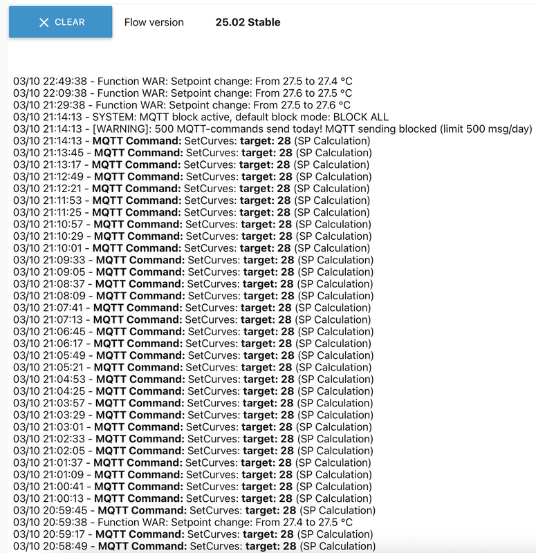

@edterbak Laatste software geupdate. Flow version
25.04 (ALPHA 3)
systeem bij mij geen zone 2, geen dhw wel een probleem g ruim 600 mqtt commands
nu gereset en weer hetzelfde
23/09 09:10:45 - MQTT Command: SetCurves: target: null (SP Calculation)
23/09 09:10:17 - MQTT Command: SetCurves: target: null (SP Calculation)
23/09 09:09:49 - MQTT Command: SetCurves: target: null (SP Calculation)
23/09 09:09:21 - MQTT Command: SetCurves: target: null (SP Calculation)
23/09 09:08:53 - MQTT Command: SetCurves: target: null (SP Calculation)
23/09 09:08:25 - MQTT Command: SetCurves: target: null (SP Calculation)
23/09 09:07:57 - MQTT Command: SetCurves: target: null (SP Calculation)
23/09 09:07:29 - MQTT Command: SetCurves: target: null (SP Calculation)
23/09 09:07:01 - MQTT Command: SetCurves: target: null (SP Calculation)
23/09 09:06:33 - MQTT Command: SetCurves: target: null (SP Calculation)
23/09 09:06:06 - Compressor: stopped
23/09 09:06:05 - MQTT Command: SetCurves: target: null (SP Calculation)
23/09 09:05:37 - MQTT Command: SetCurves: target: null (SP Calculation)
23/09 09:05:09 - MQTT Command: SetCurves: target: null (SP Calculation)
23/09 09:04:41 - MQTT Command: SetCurves: target: null (SP Calculation)
23/09 09:04:25 - MQTT Command: SetCurves: target: 20 (SP Calculation)
23/09 09:04:25 - Functions Final setpoint: Current zone 1 setpoint: 23 °C. Calculated new setpoint: 20 °C
23/09 09:04:25 - Function CCC (Zone 1): Setpoint change: From 21 to 20 °C
23/09 09:04:14 - Function CCC (Zone 1): Setpoint change: From 23 to 21 °C
23/09 09:04:14 - Compressor: running
23/09 09:04:13 - MQTT Command: SetCurves: target: null (SP Calculation)
23/09 09:03:54 - MQTT Command: SetCurves: target: 23 (SP Calculation)
23/09 09:03:54 - Functions Final setpoint: Current zone 1 setpoint: 20 °C. Calculated new setpoint: 23 °C
23/09 09:03:54 - Function CCC (Zone 1): Setpoint change: From 20 to 23 °C
23/09 09:03:54 - Function - CCC (Zone 1): 1
23/09 09:03:45 - MQTT Command: SetCurves: target: null (SP Calculation)
23/09 09:03:17 - MQTT Command: SetCurves: target: null (SP Calculation)
23/09 09:03:01 - SYSTEM: MQTT block inactive, default block mode: BLOCK ALL
23/09 06:27:03 - Function RTC (Zone 1): Correction change: From -2.4 to 0 °C (Room actual: 20.58 °C)
23/09 01:42:03 - Function RTC (Zone 1): Correction change: From -2.9 to -2.4 °C (Room actual: 21.08 °C)
Ook wanneer CCC uitstaat blijft hij MQTT Coommands versturen
Na systeem update NUC debian lijkt alles goed te gaan
Flow version
25.04 (ALPHA 3)

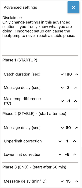

Update *** Alpha 4 versie ***
link: https://github.com/edterb...n_control/tree/25.1-ALPHA
Changes:
- Added logic about the selected p1 meter-type so it does not forget the selected value in the dashboard.
- Added delay funtionality to "Auto start DHW" option. Popup and all.
- Improved on Solar²DHW dashboard. Tried to reduce too large datasets to prevent loading issues.
@hemertje
Zodra je 'Auto start DHW' uit > aan zet, krijg je nu een popup met de mogelijkheid om een delay te zetten.

  • Pietjebel10
  • Laatst online: 09:43
Aziona schreef op zaterdag 27 september 2025 @ 07:41:
@Pietjebel10 ik heb hetzelfde probleem met Alpha 3 in docker. Oplossing is een update van Node Red?
IK heb ook de nieuwere versies geprobeerd maar op een gegeven moment blijft die zich elke 30-40 seconds herhalen. Dacht dat ik het opgelost had met de firmware update maar achteraf ging die ook weer herhalen.
23/09 09:08:53 - MQTT Command: SetCurves: target: ben terug gegaan naar Flow version
25.02 Stable hier geen last. Dus ik wacht wel eventjes af.

Ik krijg deze melding in node: Home Assistant "Error: Supervisor token not found." Ik heb nu 25.02 geinstalleerd en het werkt perfect. Ik ben als een kind zo blij met deze tool zo vlak voor de herst/winter.
Bij Alpha3 had ik inderdaad ook dat MQTT geblokkeerd werd door teveel van die null meldingen. Een schone installatie mocht niet baten.
[ Voor 133% gewijzigd door Aziona op 29-09-2025 16:50 ]

  • edterbak
  • Laatst online: 29-08 13:17
Ik zal vanavond kijken naar deze meldingen.
Vooral met de focus op de SP null meldingen. Dit zou niet mogen gebeuren

  • Knopsje
@edterbak dank je wel voor je heldere uitleg! Snap nu inderdaad dat het een lastig werkgebied is. Hier wat screenshots. Het betreft een 5J in een tussenwoning met voorlopig alleen vloerverwarming op de begane grond. Komen later radiatoren bij op de bovenverdieping. Dat maakt misschien ook dat hij nu z'n warmte niet zo goed kwijt kan.
Afbeeldingslocatie: https://tweakers.net/i/QNH5ip7X5-Dr9a9y2qk_N-ySgxY=/232x232/filters:strip_exif()/f/image/LiFR7nh8c0EDkbKH7svmwNVT.png?f=fotoalbum_tileAfbeeldingslocatie: https://tweakers.net/i/KCydCQtuC0o_y1ZlPhUw2ja24vE=/232x232/filters:strip_exif()/f/image/KQcoMBtMAQyR2uXZ7orEleM2.png?f=fotoalbum_tileAfbeeldingslocatie: https://tweakers.net/i/QTyEoNqAxZ9pmsehTlVmiZPjUjA=/232x232/filters:strip_exif()/f/image/VXTQwIik9pfFc9FmFoH8y70F.png?f=fotoalbum_tile
Meteen nog een vraag: vorig seizoen draaide ik op WAR + interne thermostaat van de controller. Om de WAR van Node-Red te kunnen gebruiken heb ik nu de Heating Mode op 'direct' gezet. Ik denk dat de thermostaat nu alleen nog wel het aan / uit gedrag van de warmtepomp regelt? Volgens HomeAssistant staat 'Aquarea Zone 1 sensor setting' nog op 'Internal Thermostat'.
Hij heeft sinds 12u vanmiddag niet meer gedraaid, ik verwacht omdat het nu warm genoeg is binnen. Dat is op zich prima, maar heb nu niet zo goed inzicht in waarom hij nu wel of niet aanslaat. Is het beter om de thermostaat ook nog uit te zetten en bijvoorbeeld met de RTC functie te regelen? Voor de WAR functie heb ik een betere temperatuursensor gekoppeld trouwens.
[ Voor 3% gewijzigd door Knopsje op 03-10-2025 22:10 ]
  • edterbak
Knopsje schreef op vrijdag 3 oktober 2025 @ 22:08:
Ik heb ongeveer de zelfde situatie als jij. Een tussenwoning met op BG vloerverwarming, 1e en 2e radiatoren. De beneden-tussendeur laten we zo veel mogelijk open staan om de warmte zo prettig mogelijk door het huis te laten dwarrelen. Tevens hebben we 2x van die speedcomfort ventilatortjes achter de radiatoren op zolder. Dat helpt...
De thermostaat aan de muur, daar bepaal je nu de gewenste temperatuur van de kamer.
Als het kouder is, dan gaat de waterpomp aan, en kan de compressor aan/uit gaan naar behoefte.
Als het warmer is, dan gaat de waterpomp uit.
SoftStart.
Kun je nog een screenshot geven van SoftStart settings. Achter het tandwiel icoontje.
Ik zie in de afbeelding dat je de runtime op 15 minuten hebt staan.
Dit houd in dat vanaf de start van de compressor de SoftStart logica slechts 15 minuten gebruikt mag worden. Dit zie je in de grafiek doordat de correctie ineens zakt vanaf +4 naar 0
Je kunt deze runtime sowieso verlengen naar 1h.
Verder nog even kijken naar je instellingen voor meer uitspraken.
  • Knopsje
@edterbak Wederom dank voor de heldere uitleg!
Ik dacht dat ik nog geen instellingen had aangepast, maar heb nu de runtime op 1 uur gezet. Dat had het standaard dus moeten zijn? Als het goed is heb ik de Advanced instellingen sowieso nog niet aangepast:
Afbeeldingslocatie: https://tweakers.net/i/cRJmicCFE62mHsxpn49Y-3b8ODY=/x800/filters:strip_exif()/f/image/xjPvKuadynmdp8pACL2RASyz.png?f=fotoalbum_large
  • edterbak
Staat op zich prima zo.
Bij phase 2, [upperlimit correction] kun je straks gaan verhogen als je denkt dat het setpoint niet goed genoeg mee naar boven kan schuiven met de retour temperatuur. (als dit temperatuur verschil te hoog wordt, slaat de compressor weer uit)
Maar eerst even kijken wat hij met +1 doet
  • Knopsje
@edterbak super, we gaan het zien!
Laatste vraag voor vanavond: ik kreeg net de melding dat er al 500 MQTT berichten zijn verstuurd. Ik zie dat hij het SetCurves Command heel vaak achter elkaar verstuurt, is dat de bedoeling of gaat er dan wat mis?
Afbeeldingslocatie: https://tweakers.net/i/HBr0o1VaCSVoO7s4Ha5bnpRTiNA=/x800/filters:strip_exif()/f/image/V2zDrTgu1Sadkn68fdgsHCHk.png?f=fotoalbum_large
  • edterbak
Nee, dat is een bug
Dat is in de laatste versie Alpha 5 verholpen.

edterbak schreef op zondag 5 oktober 2025 @ 20:27:
Hoi @ercolano en @Brokencore
Sorry voor de late reacite. had een sportief weekend, en ben stuk hahaha..
Is die 90 seconden en -1 iets dat ik in de HELP tekst mag zetten?
Ik keek net, maar volgens mij is -1 default. althans, volgens de tooltip. Ik kijk nog wel even na of dit ook zo gezet wordt out of the 'box'
Geen probleem, ik waardeer vooral al je tijd en inzet!
Wil eerst nog even een aantal weken verder testen met mijn waarden voor de 9J.
Er kan denk ook nog wat geoptimaliseerd worden in phase 2 (stable): Een hysterese voor het verhogen/verlagen van setpoint. Nu schommelt het setpoint mee met fluctuaties in de Ta. Mogelijk pas bij Ta + 2 het setpoint verhogen en bij zodra Ta onder het setpoint komt weer verlagen. Exacte waarden moet even mee getest worden. Dit zou elk geval in mijn geval een hoop MQTT commands schelen.
05/10 18:12:28 - MQTT Command: SetCurves: target: 26 (SP Calculation)
05/10 18:12:28 - Functions Final setpoint: Current zone 1 setpoint: 27 °C. Calculated new setpoint: 26 °C
05/10 18:12:28 - Function SoftStart (Zone 1): Correction: 1 > 0 °C - (ENDING) Freq: 20Hz, SP_Final: 27°C (Ta: 27.25°C)
05/10 17:46:53 - MQTT Command: SetCurves: target: 27 (SP Calculation)
05/10 17:46:53 - Functions Final setpoint: Current zone 1 setpoint: 26 °C. Calculated new setpoint: 27 °C
05/10 17:46:53 - Function SoftStart (Zone 1): Correction: 0 > 1 °C - (STABLE) Freq: 19Hz, SP_Final: 26°C (Ta: 27.25°C)
05/10 17:43:38 - MQTT Command: SetCurves: target: 26 (SP Calculation)
05/10 17:43:38 - Functions Final setpoint: Current zone 1 setpoint: 27 °C. Calculated new setpoint: 26 °C
05/10 17:43:33 - Function SoftStart (Zone 1): Correction: 1 > 0 °C - (STABLE) Freq: 20Hz, SP_Final: 27°C (Ta: 26.75°C)
05/10 17:43:28 - MQTT Command: SetCurves: target: 27 (SP Calculation)
05/10 17:43:28 - Functions Final setpoint: Current zone 1 setpoint: 26 °C. Calculated new setpoint: 27 °C
05/10 17:43:28 - Function SoftStart (Zone 1): Correction: 0 > 1 °C - (STABLE) Freq: 20Hz, SP_Final: 26°C (Ta: 27.25°C)

kunnen jullie in lekentaal eens uitleggen wat hier nu precies staat?
Phase 1 (STARTUP)
Catch duration (sec) 180
Message delay (sec) 3
Max temp difference (°C) -1
Phase 2 (STABLE) - (start after sec)
Message delay (sec) 60
Upperlimit correction 1
Lowerlimit correction -5
Phase 3 (END) - (start after min)
Message delay (min/°C) 15
(y)
Hallo Ed, Om verwarring te voorkomen, de 90 seconden uit de post van Brokencore en mij gaat over de tijd vanaf het bereiken van Ta+2 voordat de pomp afslaat. Die tijd lijkt lijkt in de praktijk te variëren tussen de verschillende pompen. Heeft dus niet met de werking van jou flow te maken, maar heeft wel invloed op hoe je die instelt. Naast de afslatijd, spelen delta T, afgifte, en hoe hoog je je stooklijn hebt ook een rol in hoe de sofstart kan functioneren.
Je kunt/wilt niet alle situaties beschrijven in een help. Zou ik niet doen.
p.s. hier een super tevreden gebruiker van de softstart !

ercolano schreef op maandag 6 oktober 2025 @ 09:30:
Goedemorgen @ercolano
is er wel een manier hoe je deze theoretisch kunt bepalen of proefondervindelijk optimaal kunt instellen?

hemertje schreef op maandag 6 oktober 2025 @ 10:40:
Vooral kijken wat er gebeurd. Veel kijken en leren begrijpen waarom dingen gebeuren. Eerst de WP begrijpen en dan pas in node-red gaan fine-tunen. En wat is je doel ? WAF / minimaal aantal cycli / zo energie zuinig ?
<< off -topic >>
Aantal dingen om mee te geven:
- loopt je wp gewoon door maar wordt het niet warm. te weinig ernergie je huis in, stooklijn omhoog of RTC gebruiken.
- Wanneer slaat je pomp af bij TA+2 ? Is dat op minimaal vermogen (voor een 9J is dat ongeveer 10 liter per minuut op 20Hz), dan kan hij zn minimale vermogen niet kwijt in je huis, waardoor Ta oploopt. Stooklijn wellicht te laag ? (boven de 12 graden buiten heb ik 29 nodig om genoeg warmte af te geven). Huis nog niet warm, stooklijn omhoog.
- hoe staat je Delta T ingesteld. Ik merkte zelf dat bij 2 of 3 de pomp heel lang op hoog freq bleef lopen om de Tr binnen de delta van de Td te krijgen. Op de andere forums wordt 5 aangegeven als verstandig. Zelf ben ik in het voorjaar op 6 en nu op 7 aan het draaien. Gevolg, de gemiddelde watertemperatuur in je huis gaat omlaag dus minder afgifte dus hogere stooklijn. Echter de wp gaat ook eerder terug in freq omdat de Tr eerder in de delta-box zit (dit lijkt tot langere runs te leiden in voor/najaar). Met de RTC compensatie kan je dan de boel perfect naar de gewenste temperatuur trekken.
- hoe stijl is je stooklijn en hoe heb je je RTC correctie ingesteld. De verandering van 1 graad in de TA is meestal wel door de wp op te vangen met freq verlagen. Je wilt niet een graad verlaging door hogere buitentemperatuur in combinatie met een correctie van 1 graad door de RTC te dicht op elkaar ,want dat is een recept voor afslaan. Gebeurd dat bij jou, dan stooklijn vlakker en rtc correcties slimmer.
afijn genoeg om naar te kijken en te tweaken
Wel off-topic hier, dus als je verder wilt gaan wellicht een eigen topic starten, wil ik daar best naar kijken
