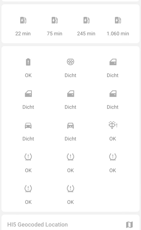

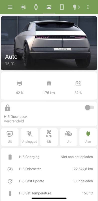

FunkStar_ schreef op woensdag 22 juni 2022 @ 19:55:
Sure!
[REQUIREMENTS]
Hacs (https://hacs.xyz/)
Kia Uvo / Hyundai Bluelink (https://github.com/fuatakgun/kia_uvo)
Lovelace card:
24
25
26
27
28
29
30
31
32
33
34
35
36
37
38
39
40
41
42
43
44
45
46
47
48
49
50
51
52
53
54
55
56
57
58
59
60
61
62
63
64
65
66
67
68
69
70
71
72
73
74
75
76
77
78
79
80
81
82
83
84
85
86
87
88
89
90
91
92
93
94
95
96
97
98
99
type: vertical-stack
cards:
  - type: picture
    image: /local/Images/Ioniq5.jpg
    tap_action:
      action: none
    hold_action:
      action: none
    card_mod:
      style: |
        ha-card {
          --ha-card-background: transparent;
          box-shadow: none;
  - type: custom:stack-in-card
    mode: vertical
    keep:
      background: false
      border_radius: false
      box_shadow: false
      margin: false
      outer_padding: false
    cards:
      - type: glance
        entities:
          - entity: binary_sensor.ioniq_5_plugged_in
          - entity: binary_sensor.ioniq_5_charging
          - entity: sensor.ioniq_5_range_by_ev
        show_state: true
        show_name: true
        state_color: true
      - type: custom:bar-card
        icon: mdi:battery-charging
        entities:
          - entity: sensor.ioniq_5_ev_battery
        columns: '0'
        entity_row: false
        direction: right
        positions:
          icon: outside
          indicator: 'off'
          minmax: 'off'
          value: inside
        severity:
          - color: '#4CAF50'
            from: '60'
            to: '100'
          - color: '#FFC107'
            from: '25'
            to: '60'
          - color: '#FF5722'
            from: '0'
            to: '25'
      - type: glance
        entities:
          - entity: binary_sensor.ioniq_5_tire_pressure_all
          - entity: sensor.ioniq_5_car_battery
          - entity: lock.ioniq_5_door_lock
        show_state: true
        show_name: true
        state_color: true
      - type: markdown
        content: ___
      - type: glance
        entities:
          - entity: sensor.ev_mileage_since_last_charge
          - entity: sensor.ev_comsumption
          - entity: sensor.ioniq_5_odometer
        show_state: true
        show_name: true
        state_color: true
      - type: custom:button-card
        entity: sensor.ioniq_5_last_update
        show_last_changed: true
        styles:
          grid:
            - grid-template-areas: '"i n l"'
            - grid-template-rows: 100%
            - grid-template-columns: 25% 45% 30%
          label:
            - justify-self: start
          name:
            - justify-self: end
            - margin-right: 10%
        name: 'Last Updated:'
        aspect_ratio: 7/1
        tap_action:
          action: call-service
          service: kia_uvo.force_update
2 helpers voor TRIP & Consumption
automatisation:
alias: Update EV Mileage Stats
description: Updates mileage stats after EV charger is connected
trigger:
  - platform: state
    entity_id: binary_sensor.ioniq_5_plugged_in
    from: 'off'
    to: 'on'
condition: []
action:
  - service: input_number.set_value
    data_template:
      entity_id: input_number.ev_total_mileage_since_last_charge
      value: '{{states(''sensor.ev_mileage_since_last_charge'') | float }}'
    data_template:
      entity_id: input_number.ev_mileage_since_last_charge_base
      value: '{{states(''sensor.ioniq_5_odometer'') | float }}'
mode: single
Berekening (waar dus nog een foutje in zit).
Zit bij mij in config\includes\sensors.yaml maar als je niet met onderverdelingen werkt gewoon in "config/configuration.yaml". (wel opletten met indentation dan bij copy paste)
  - platform: template
    sensors:
      ioniq_5_battery_capacity:
        value_template: "72.6"
        unit_of_measurement: "kWh"
      ev_mileage_since_last_charge:
        value_template: "{{ states('sensor.ioniq_5_odometer') | int(0) - states('input_number.ev_mileage_since_last_charge_base') | int }}"
      ioniq_5_battery_capacity_remaining:
        value_template: "{{ ((states('sensor.ioniq_5_battery_capacity') | float * states('sensor.ioniq_5_ev_battery') | float ) / 100) | round(1) }}"
      ev_comsumption:
        value_template: "{{ (states('sensor.ev_mileage_since_last_charge') | float / ((states('sensor.ioniq_5_battery_capacity') | float - states('sensor.ioniq_5_battery_capacity_remaining') | float ))) | round(1) }}"
        unit_of_measurement: "km/kWh"
Alles behalve de berekening kan via de GUI.
Super bedankt ziet er clean uit :D
voor de andere mensen die dit ook willen, download via HACS deze frontend repo's: stack in card, bar card en button card

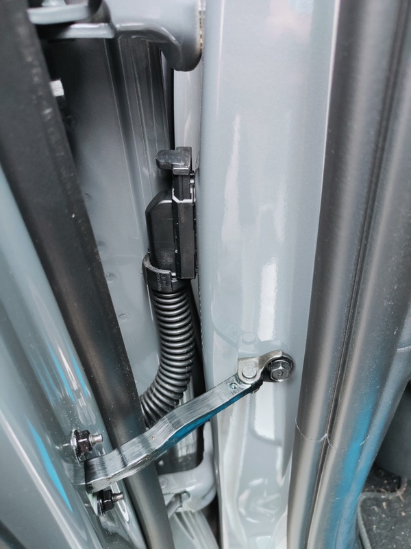

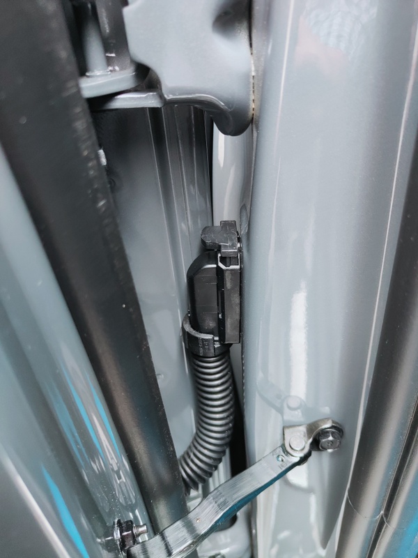

edvanleeuwen schreef op woensdag 22 juni 2022 @ 23:25:
Toevallig een trekhaak? Want als je daar dan iets mee vervoert werkt iPedal niet.
Ik heb inderdaad een afneembare trekhaak, maar die zit er niet op. Wellicht heeft het daar toch mee te maken, want ik krijg af en toe ook meldingen dat ik het remlicht van de aanhanger moet controleren.
  • P86
  • Registratie: April 2020
  • Laatst online: 10-09 12:13
P86
IONIQ 5 Connect RWD LR
souris schreef op donderdag 23 juni 2022 @ 09:34:
Kabelbreukje in je 13 polige of evt een draadje wat elkaar raakt?
Hoe zit die weggewerkt als je de trekhaak er niet op hebt? Zit er dan alsnog een gat onder of?

P86 schreef op donderdag 23 juni 2022 @ 10:03:
Voor de trekhaak wordt een gat uit de onderkant van de bumper gezaagd.

bilgy_no1 schreef op donderdag 23 juni 2022 @ 11:26:
Dat klopt. Alleen zichtbaar als je onder de auto kruipt. Dat wil zeggen als het netjes is gedaan. Ik heb ook wat horrorverhalen hier voorbij zien komen. Maar dat is bij mij niet het geval. Het is netjes aangesloten.

Kratos schreef op donderdag 23 juni 2022 @ 08:58:
voor de andere mensen die dit ook willen download via HACS deze frontend repo's: stack in card, bar card en button card
Oops... Ik zal de post editen en idd deze frontend hacs elements toevoegen.

Motorfret schreef op donderdag 23 juni 2022 @ 21:57:
€800,- bij trekhaakcentrum.nl
In hoeverre is het een risico om de trekhaak bij een ander dan de Hyundai-dealer te laten monteren? Die hebben verstand van deze elektrische auto. De electronica van de auto moet toch constateren dat er iets aan de haak hangt.
Weet een extern bedrijf hoe en waar de kabelboom moet worden aangesloten op het EV-systeem en zijn er nog aanvullende softwarematige instellingen nodig? Het is per slot van rekening geen "simpele" ice. :)
Ik laat hem ook bewust door de dealer monteren.

HappyBart schreef op woensdag 22 juni 2022 @ 23:58:
Was ook mijn gedachte... of zonder trekhaak maar wel in trailer mode. Klopt dat dan inderdaad i-Pedal niet werkt, maar wel regeneratie 0 t/m 3.
Het heeft hier inderdaad mee te maken. Als ik de aanhangermodus op "off" zet, kan ik wel gewoon auto en i-pedal gebruiken. De auto denkt dus onterecht dat er een aanhanger achter zit, terwijl de trekhaak er niet eens op zit.
De bekabeling maar eens na laten kijken. @HappyBart en @edvanleeuwen hartelijk dank voor de tips!

Om de een of andere reden is mijn linkerachterdeur kapot, alle elektrische functies werken niet meer.
Raam bijv. gaat niet meer open, heeft iemand enig idee wat het zou kunnen zijn?
zekering misschien?
betreft een lounge 2021 73kwh
  • -CJ
  • Registratie: Februari 2021
  • Laatst online: 07:57
-CJ
Not remastered
dgb schreef op vrijdag 24 juni 2022 @ 22:40:
zekering misschien?
Doet de verlichting en de knop voor de stoelverwarming het nog wel?

-CJ schreef op vrijdag 24 juni 2022 @ 22:54:
Nee ook niet :-(
zekering misschien?
Klinkt als een kabelbreuk, een losse stekker van de deur stuurunit of een gefrituurde stuurunit.
IONIQ 5 Lounge 73kw & Polestar 2 LRDM Launch Edition
  • MeelezerT
  • Registratie: December 2021
  • Laatst online: 09-04 21:41
Superbedankt @-CJ @FunkStar_ en @Kratos voor jullie uitleg over Raspberry Pi, Home Assistant, HACS, Kia Uvo/Hyundai Bluelink en de integraties, dashboards en de Lovelace cards & frontends die daarbij kwamen kijken want het is gelukt!
Afbeeldingslocatie: https://tweakers.net/i/T2jJ5Av5l_e_GmQrTfkYSNPQ0Yc=/x800/filters:strip_icc():strip_exif()/f/image/gw8PzEp8bh58vm1DISdTiuEp.jpg?f=fotoalbum_largeAfbeeldingslocatie: https://tweakers.net/i/wWNgylbLbw3M5R1bejP9yPtIiy0=/x800/filters:strip_icc():strip_exif()/f/image/OT0FlHottoOmApAq4wkzhyL8.jpg?f=fotoalbum_large

  • dgb
  • Laatst online: 07-08 23:07
dgb
de meester01 schreef op zaterdag 25 juni 2022 @ 00:23:
Klinkt als te ingewikkeld om zelf te fixen, gelijk maar meenemen met de recall.
Thanks voor de input :)

dgb schreef op zaterdag 25 juni 2022 @ 01:12:
Ik zou inderdaad niet zelf gaan pielen ;)

  • dgb
dgb
de meester01 schreef op zaterdag 25 juni 2022 @ 02:03:
Ik heb zelf even gekeken en het bleek uiteindelijk "een losse stekker van de deur stuurunit" te zijn.
Het was alleen het clipje van de aansluiting er weer in duwen en alles werkte weer :)
  • lackaday
  • Laatst online: 27-09 21:37
dgb schreef op maandag 27 juni 2022 @ 08:16:
Nice! En waar vond je dat stekkertje?

  • dgb
dgb
lackaday schreef op maandag 27 juni 2022 @ 08:34:
Hoe het was
Afbeeldingslocatie: https://tweakers.net/i/5P3aJih6qPJ7ul14p0Ppp-nkNlU=/x800/filters:strip_icc():strip_exif()/f/image/3FE4MStFtizcrQnIPQbumlf7.jpg?f=fotoalbum_large
Hoe het moet.
Afbeeldingslocatie: https://tweakers.net/i/JR5bS7sM_wMO9Rs3lBptRnRcR_4=/x800/filters:strip_icc():strip_exif()/f/image/8fg6a96so9d5dbKisCmxsLcZ.jpg?f=fotoalbum_large
  • de meester01
  • Laatst online: 20-11 14:45
de meester01
Ja, dan hoef je de portierbekleding niet weg te halen _/-\o_
Easy fix
