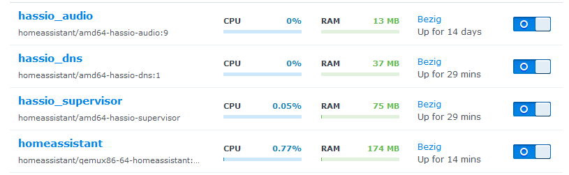

  • sn33ky
  • Laatst online: 14-09 21:12
Via https://community.home-as...dsm-native-package/125559 dat paar dockers creëer, naast mijn al bestaande dockers die werken.
Afbeeldingslocatie: https://tweakers.net/i/UEhN1sggBPjyKI-QR-xjPKMAPdw=/800x/filters:strip_exif()/f/image/6jIhTIJmhkv5Xka2EbDqMOGT.png?f=fotoalbum_large

koelkast schreef op donderdag 26 maart 2020 @ 11:51:
Welke GUI gebruik jij eigenlijk voor je docker containers? Of dit is Synology?
Dat is inderdaad de docker GUI van synology.

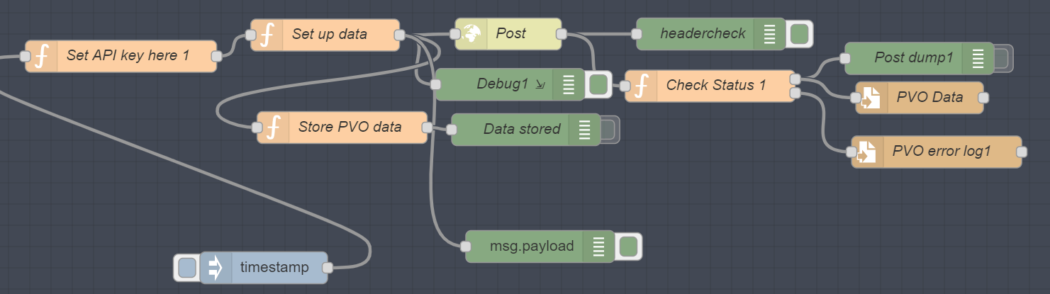

Heronimo schreef op maandag 23 maart 2020 @ 12:26:
@CAP-Team @D3nnisd Hier ook een Solax omvormer. Het is mij niet gelukt om de data direct in het netwerk af te tappen. Ik gebruik nu een Node-Red flow om de data vanuit de webportal naar PVoutput te schieten en lokaal in m'n Lovelace weer te geven.
Hieronder de Node-Red flow:
[{"id":"d7d2bbe.ff4ff48","type":"http request","z":"12e5f047.fde86","name":"Post","method":"POST","ret":"txt","url":"","x":1190,"y":700,"wires":[["ac1e3c76.2e609","129c59a9.8258d6"]]},{"id":"9b8e63fe.2f16f","type":"function","z":"12e5f047.fde86","name":"Set API key here 1","func":"msg.action = msg.payload;\nmsg.headers = { \n 'X-Pvoutput-Apikey': 'putpvoutputkeyhere',\n 'X-Pvoutput-SystemId': 'putsystemidhere',\n 'Content-Type': 'application/x-www-form-urlencoded'\n};\n\nreturn msg;","outputs":1,"noerr":0,"x":825.75,"y":721,"wires":[["e166266a.6c8f28"]]},{"id":"ac1e3c76.2e609","type":"debug","z":"12e5f047.fde86","name":"headercheck","active":false,"console":"false","complete":"true","x":1380.75,"y":700,"wires":[]},{"id":"c7e82d2d.8c6d","type":"debug","z":"12e5f047.fde86","name":"Debug1","active":false,"console":"true","complete":"payload","x":1191.75,"y":747.5,"wires":[]},{"id":"e166266a.6c8f28","type":"function","z":"12e5f047.fde86","name":"Set up data","func":"msg.action = msg.payload;\n\nmsg.url = \"http://pvoutput.org/service/r2/addstatus.jsp\";\n\n// set up the data/time\nvar now = new Date(); \nvar year = now.getFullYear(); \nvar month = now.getMonth()+1; // Months start at 0 not 1 - FTFY\nvar day = now.getDate();\nvar hour = now.getHours(); \n\n//var hour = now.getHours()+1; // GMT to BST\n//if (hour === 24) { // BST overflow - This clearly needs some work!\n// hour = 0;\n// day = day +1;\n//} \n\nvar minute = now.getMinutes();\nvar second = now.getSeconds(); \n\n// fix any short date/times so all values are two digits\nif(month.toString().length == 1) { var month = '0'+month; }\nif(day.toString().length == 1) { var day = '0'+day;}\nif(hour.toString().length == 1) { var hour = '0'+hour; }\nif(minute.toString().length == 1) { var minute = '0'+minute; }\nif(second.toString().length == 1) { var second = '0'+second; }\n\nuploaddate = year.toString()+month.toString()+day.toString(); // string the dates or we get errors!\n\n//pull back stored data\nvar power = msg.payload.gridPower; // Power1 - Grid power import/export\nvar gentot = msg.payload.todayYield * 1000; // Generation total for the day (watts)\nmsg.payload = {\"d\":uploaddate,\"t\":hour+':'+minute,\"v1\":gentot,\"v2\":power};\n\nreturn msg;","outputs":1,"noerr":0,"x":1017.75,"y":701,"wires":[["d7d2bbe.ff4ff48","c7e82d2d.8c6d","88a6ba7a.5ea8e8"]]},{"id":"129c59a9.8258d6","type":"function","z":"12e5f047.fde86","name":"Check Status 1","func":"if (msg.statusCode == 200) { \n var stat = \"\";\n flow.set('pvostat','200'); // this clears the outstanding PVO data, so it won't be uploaded again\n var msg1 = null;\n var msg2 = null;\n} else {\n var time = new Date().toString();\n flow.set('pvostat', msg.statusCode);\n var stat = \"FAILED: Time:\" + time + \" StatusCode:\" + msg.statusCode + \" StatusMsg:\" + msg.payload;\n var msg1 = null;\n var msg2 = null;\n// msg1.payload = stat;\n// msg2.payload = stat;\n var msg1 = { payload: stat };\n var msg2 = { payload: stat };\n}\nreturn (msg1, msg2);","outputs":"2","noerr":0,"x":1379.75,"y":749,"wires":[["8de4d102.29f8b","5267aac6.aa4414"],["f18df306.52316"]]},{"id":"8de4d102.29f8b","type":"debug","z":"12e5f047.fde86","name":"Post dump1","active":false,"console":"false","complete":"payload","x":1576.75,"y":723,"wires":[]},{"id":"f18df306.52316","type":"file","z":"12e5f047.fde86","name":"PVO error log1","filename":"/media/usb/pvo_errors.log","appendNewline":true,"createDir":true,"overwriteFile":"false","x":1592.75,"y":811,"wires":[[]]},{"id":"88a6ba7a.5ea8e8","type":"function","z":"12e5f047.fde86","name":"Store PVO data","func":"//store the PVO data in case it doesn't upload correctly\nflow.set ('pvodata',msg.payload)\nreturn msg;","outputs":1,"noerr":0,"x":1033.75,"y":788,"wires":[["58e2f31c.7b06ec"]]},{"id":"5267aac6.aa4414","type":"file","z":"12e5f047.fde86","name":"PVO Data","filename":"PVO_data.log","appendNewline":true,"createDir":true,"overwriteFile":"false","x":1576.75,"y":760,"wires":[[]]},{"id":"58e2f31c.7b06ec","type":"debug","z":"12e5f047.fde86","name":"Data stored","active":false,"console":"false","complete":"payload","x":1206.75,"y":790,"wires":[]}]
Andere optie is om iets van een reverse proxy op te zetten zoals hier uitgelegd: https://www.home-assistant.io/integrations/solax/
Dank je voor deze flow, dit komt heel mooi uit, omdat het gisteren eindelijk gelukt is om mijn SMA via modbus uit te lezen.
Aangezien ik nog een totale noob ben op het gebied van Node-Red 8)7 hoop ik je dat mij iets verder kan helpen.
Ik krijg het niet voor elkaar om in de flow mijn payload.gridPower en payload.todayYield te koppelen.
Ik lees de data uit de SMA door middel van een aantal sensoren, het gaat hier om de:
sensor.modbus_sma_pv_power
sensor.pv_daily_yield
Waar moet ik deze invullen?
24x LG Mono Full Black 320Wp, SMA Sunny Tripower 6000TL/ Atlantic 270 L WP-Boiler
  • Heronimo
  • Laatst online: 21:00
Kenny73 schreef op vrijdag 27 maart 2020 @ 07:51:

  • Kenny73
  • Laatst online: 08:08
-Casper schreef op vrijdag 27 maart 2020 @ 08:17:
Rechts bovenin node red staan 3 streepjes om het menu te openen waarna je een optie import krijgt.
Daar kan je de JSON plakken
Ja, dat heb ik ook gedaan.
Deze is geheel geïmporteerd:
Afbeeldingslocatie: https://tweakers.net/i/YRJH-lpQkhCfD25eFMw81_mqMtg=/800x/filters:strip_exif()/f/image/28VPQjHYpXTPyR0uj32gkds4.png?f=fotoalbum_large
Het eerste blok is niet zo moeilijk, daar vul je de API-key en je system-ID. Het gaat echter om het blok "set data"
Daar weet ik dus niet hoe ik mijn sensoren hierin moet vullen.

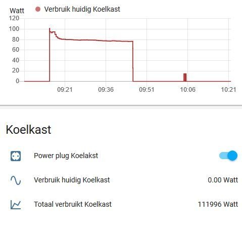

Ik heb een aantal Shelly pluggen tussen mijn apparatuur zitten om het verbruik te meten.
Nu na elke keer opstarten (opnieuw laden configuration.yalm) gooit HA alles door elkaar.
Voorbeeld. Huidig verbruik van de droger staat nu bij koelkast en totaal koelkast bij totaal verbruik vrieskist.
Hoe kan ik dit verkomen? Is super lastig als ik er later 10 heb dan ben ik echt wel de weg kwijt wat bij welke plug hoort.
Idem eigenlijk voor mijn drie camera's ook die gooit hij heel vaak door elkaar.
  • barrymossel
  • Laatst online: 26-09 08:54
RoTeK70 schreef op zaterdag 28 maart 2020 @ 08:19:
Hmmm, dit lijkt me heel erg onlogisch. Ik kan me geen reden bedenken dat dit überhaupt gebeurt. Maar misschien kun je wat meer vertellen over je setup? Hoe heb je de Shelly's (en camera's) verbonden met Home Assistant?
  • barrymossel
Welke robot stofzuiger gebruiken jullie. Ben me aan het oriënteren aangezien hier tegen de kinderen niet op te stofzuigen is. Wensen/eisen: niet te duur en mag niet met China praten.
  • RoTeK70
  • Laatst online: 02-06 19:50
barrymossel schreef op zaterdag 28 maart 2020 @ 08:36:
Ja sorry, is misschien wel handig.
Camera's via Ip.
camera 2:
  - platform: foscam
    ip: 192.168.2.171
    username: Camxx
    password: xxxxxx
Shellies via MQTT onderscheid is bij de switch en sensoren van de shellies goed te zien in de lovelace.
Bijvoorbeeld: sensor.totaal_verbruikt_3 de anderen hebben een 1 of 2.
sensor 13:
  - platform: mqtt
    name: "Totaal verbruikt"
    icon: mdi:chart-line
    state_topic: "shellies/shellyplug-s-DAC947/relay/0/energy"
    unit_of_measurement: "Watt"
Andere pluggen hebben zelfde code waarbij de DAC947 bij elke plug natuurlijk anders is.
  • barrymossel
RoTeK70 schreef op zaterdag 28 maart 2020 @ 08:58:
Camera's via Ip.
camera 2:
  - platform: foscam
    ip: 192.168.2.171
    username: Camxx
    password: xxxxxx
sensor 13:
  - platform: mqtt
Je moet de names uniek maken. Dus name: "Totaal verbruikt koelkast".

  • RoTeK70
barrymossel schreef op zaterdag 28 maart 2020 @ 09:01:
Ja dat werkt! Bedankt

Dus in onderstaande voorbeeld niet 111996 watt maar 111,9 kWh?
Afbeeldingslocatie: https://tweakers.net/i/aK6YFDJxVHT6hIBT-b2vIRAQrgs=/f/image/yC9e9Crt4PFvDbeD4YmvLOTQ.jpg
  • barrymossel
RoTeK70 schreef op zaterdag 28 maart 2020 @ 10:28:
Gaan we ook een keer proberen, bedankt!
Kan ik nu ook het taal verbruik omzetten naar kWh. Heb hem op watt gezet want de Shellies geven getallen in watt. Ik wil graag het totaal in kWh!
Kijk eens hier: martinvdm in "Home Assistant: Open source Python3 home automation - deel 2"
