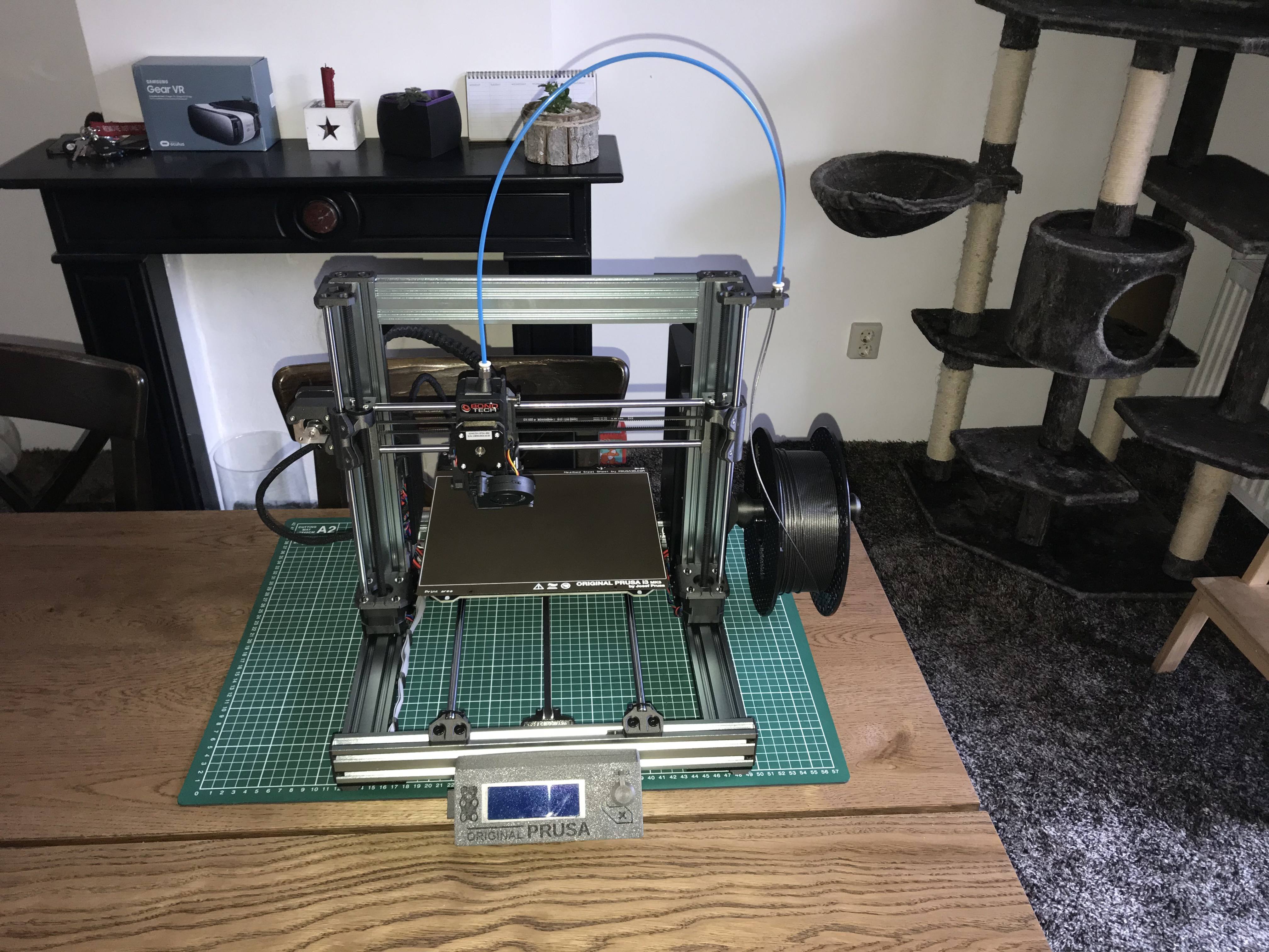

Afgelopen weekend mijn mk3s voorzien van de wat upgrades.
Afbeeldingslocatie: https://tweakers.net/ext/f/ENiKNQ7xYfryHT2FsIxNgVVS/thumb.jpg
| Victory is reserved for those who are willing to pay it's price | To become your own champion, believe and achieve |
