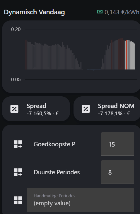

Dynamisch NOM (Duur)
Wanneer sensor.dynamisch_duurste_periode op JA staat zal hij NOM gaan ontladen en de rest van de tijd staat de batterij in standby.
betekent dit dat je tijdens de grijze periodes geen NOM houdt?
Afbeeldingslocatie: https://tweakers.net/i/R3mHQo47nWB1fsIdCTv7yYgy1LU=/x800/filters:strip_exif()/f/image/VKjiFkmKHwGDJ3lIQXOsL6GQ.png?f=fotoalbum_large

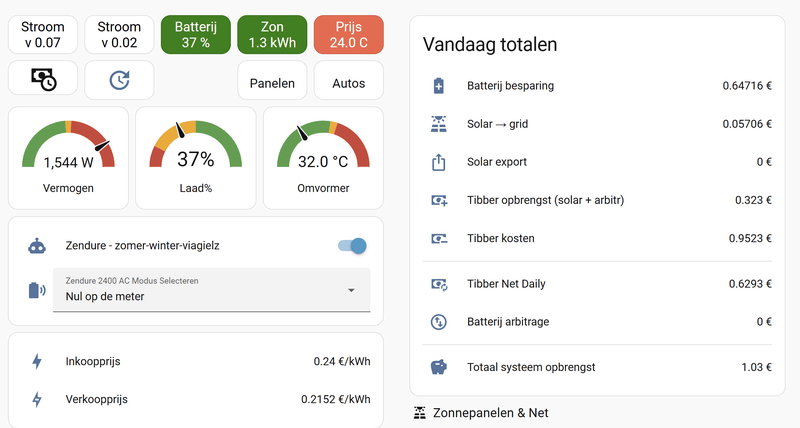

      - name: "Solar Profit 15m"
        unique_id: solar_profit_15m
        unit_of_measurement: "€"
        icon: mdi:solar-power
        state: >
          {# Puur de besparing van zon → huis/auto direct verbruik #}
          {# Export naar net zit al bij Tibber reward — geen dubbeltelling #}
          {# Batterijlading uitgefilterd — die stroom zetten we later in #}
          {% set solar    = states('sensor.solar_production_15m') | float(0) %}
          {% set grid_exp = states('sensor.grid_export_15m')      | float(0) %}
          {% set bat_chg  = states('sensor.battery_charge_15m')   | float(0) %}
          {% set bat_dis  = states('sensor.battery_discharge_15m')| float(0) %}
          {% set buy      = states('sensor.electricity_buy_price_eur') | float(0) %}
          {% set bat_to_grid      = [bat_dis, grid_exp] | min %}
          {% set solar_to_grid    = [grid_exp - bat_to_grid, 0] | max %}
          {% set direct_home_auto = [solar - solar_to_grid - bat_chg, 0] | max %}
          {{ (direct_home_auto * buy) | round(5) }}
      # --- Werkelijke kosten MET batterij ---
      # + grid_import * inkoopprijs
      # - grid_export * verkoopprijs
      # + laadverlies als gewogen gemiddelde van solar/net aandeel
      - name: "Cost with battery"
        unique_id: cost_with_battery
        icon: mdi:battery-charging
        state: >
          {% set import_kwh = states('sensor.grid_import_15m')            | float(-1) %}
          {% set export_kwh = states('sensor.grid_export_15m')            | float(-1) %}
          {% set bat_chg    = states('sensor.battery_charge_15m')         | float(-1) %}
          {% set buy        = states('sensor.electricity_buy_price_eur')  | float(-1) %}
          {% set sell       = states('sensor.electricity_sell_price_eur') | float(-1) %}
          {% set eff        = states('input_number.battery_efficiency')   | float(90) / 100 %}
          {% if import_kwh < 0 or export_kwh < 0 or bat_chg < 0 or buy < 0 or sell < 0 %}
            {{ states('sensor.cost_with_battery') | float(0) }}
          {% else %}
            {% set grid_cost    = import_kwh * buy %}
            {% set grid_revenue = export_kwh * sell %}
            {% set solar_15m   = states('sensor.solar_production_15m') | float(0) %}
            {% set total_in    = import_kwh + solar_15m %}
            {% set solar_ratio = (solar_15m / total_in) if total_in > 0 else 0 %}
            {% set grid_ratio  = (import_kwh / total_in) if total_in > 0 else 1 %}
            {% set loss_price  = solar_ratio * sell + grid_ratio * buy %}
            {% set loss_cost   = bat_chg * (1 - eff) * loss_price %}
            {{ (grid_cost - grid_revenue + loss_cost) | round(5) }}
          {% endif %}
      # --- Virtuele kosten ZONDER batterij ---
      # Werkelijk huisverbruik = solar + grid_imp + bat_dis - grid_exp - bat_chg
      # Zonder batterij dekt solar dit verbruik direct:
      #   virtual_import  = max(load - solar, 0) → inkoopprijs
      #   virtual_export  = max(solar - load, 0) → verkoopprijs
      - name: "Cost without battery"
        unique_id: cost_without_battery
        icon: mdi:home-lightning-bolt
        state: >
          {% set solar    = states('sensor.solar_production_15m')        | float(-1) %}
          {% set grid_imp = states('sensor.grid_import_15m')             | float(-1) %}
          {% set grid_exp = states('sensor.grid_export_15m')             | float(-1) %}
          {% set bat_dis  = states('sensor.battery_discharge_15m')       | float(-1) %}
          {% if solar < 0 or grid_imp < 0 or grid_exp < 0 or bat_chg < 0 or bat_dis < 0 or buy < 0 or sell < 0 %}
            {{ states('sensor.cost_without_battery') | float(0) }}
          {% else %}
            {% set real_load      = [solar + grid_imp + bat_dis - grid_exp - bat_chg, 0] | max %}
            {% set virtual_import = [real_load - solar, 0] | max %}
            {% set virtual_export = [solar - real_load, 0] | max %}
            {{ ((virtual_import * buy) - (virtual_export * sell)) | round(5) }}
          {% endif %}
      # --- Besparing per 15 minuten dankzij de batterij ---
      # Positief = batterij bespaart geld
      # Negatief = batterij kost geld (bv. laden uit net op hoge prijs)
      # FIX: als batterij niets doet én vol is → 0 (voorkomt SolarEdge buffering artefact)
      - name: "Battery Profit 15m"
        unique_id: battery_profit_15m
        icon: mdi:cash-plus
        state: >
          {% set without = states('sensor.cost_without_battery') | float(-999) %}
          {% set with_b  = states('sensor.cost_with_battery')    | float(-999) %}
          {% set bat_dis = states('sensor.battery_discharge_15m') | float(0) %}
          {% set soc     = states('sensor.solarflow_2400_ac_electric_level') | float(0) %}
          {% if bat_chg <= 0.002 and bat_dis <= 0.002 and soc >= 98.5 %}
            0
          {% elif without == -999 or with_b == -999 %}
            {{ states('sensor.battery_profit_15m') | float(0) }}
          {% else %}
            {{ (without - with_b) | round(5) }}
          {% endif %}

title: Batterij ROI
path: batterij-roi
icon: mdi:cash-fast
type: sections
max_columns: 2
sections:
  - cards:
      - square: false
        columns: 5
        type: grid
        cards:
          - type: custom:button-card
            entity: sensor.zendure_p1_power_kw
            show_state: true
            show_icon: false
            state_display: |
                const v = parseFloat(entity.state);
                if (isNaN(v)) return entity.state;
                if (v >= -0.1 && v <= 0.1) {
                  if (v < 0) return `v ${Math.abs(v).toFixed(2)}`;
                  if (v > 0) return `^ ${v.toFixed(2)}`;
                  return `${v.toFixed(2)}`;
                if (v < -0.1) return `${Math.abs(v).toFixed(2)}`;
                return `${v.toFixed(2)} kW`;
            state:
              - operator: <
                value: -0.1
                styles:
                  card:
                    - color: white
                    - background-color: green
              - operator: ">"
                value: 0.1
                styles:
                  card:
                    - color: white
                    - background-color: tomato
              - operator: ">="
                value: -0.1
                styles:
                  card:
                    - color: black
                    - background-color: white
            entity: sensor.p1_actueel_kw
            show_state: true
            show_icon: false
            state_display: |
            state:
              - operator: <
                value: -0.1
                styles:
                  card:
                    - color: white
              - operator: ">"
                value: 0.1
                styles:
                  card:
                    - color: white
              - operator: ">="
                value: -0.1
                styles:
                  card:
                    - color: black
            entity: sensor.solarflow_2400_ac_electric_level
            show_state: true
            show_icon: false
            triggers_update:
              - sensor.zendure_2400_ac_modus
            styles:
              card:
                - color: white
                - background-color: |
                      const state = states['sensor.zendure_2400_ac_modus']?.state;
                      if (state === 'Opladen') return 'green';
                      if (state === 'Ontladen') return 'tomato';
                      return 'gray';
            state_display: |
                return entity.state + ' %';
            entity: sensor.sensor_solaredge_current_power_kwh
            show_state: true
            show_icon: false
            state:
              - operator: ">"
                value: 0
                styles:
                  card:
                    - color: white
              - operator: "="
                value: 0
                styles:
                  card:
            entity: sensor.sensor_tibberprijs
            show_state: true
            show_icon: false
            state_display: |
                return `${v.toFixed(1)} C`;
            state:
              - operator: <
                value: 23
                styles:
                  card:
                    - color: white
              - operator: ">"
                value: 23
                styles:
                  card:
                    - color: white
            entity: sensor.dynamisch_duurste_periode
            show_state: false
            show_name: false
            icon: mdi:cash-clock
            state:
              - value: Ja
                styles:
                  card:
                    - color: white
                  icon:
                    - color: white
              - value: Nee
                styles:
                  card:
                    - background-color: var(--card-background-color)
                    - color: var(--primary-text-color)
          - show_name: false
            show_icon: true
            type: button
            entity: input_button.update_roi
            tap_action:
              action: toggle
          - type: custom:gap-card
          - show_name: true
            show_icon: true
            type: button
            tap_action:
              action: navigate
              navigation_path: /lovelace/energie
          - show_name: true
            show_icon: true
            type: button
            tap_action:
              action: navigate
              navigation_path: /lovelace/tesla
      - square: false
        type: grid
        columns: 3
        cards:
          - type: gauge
            entity: sensor.zendure_2400_ac_vermogen_aansturing
            needle: true
            min: -2400
            max: 2400
            severity:
              green: -2400
              yellow: -100
              red: 100
          - type: gauge
            entity: sensor.zendure_2400_ac_laadpercentage
            needle: true
            min: 0
            max: 100
            severity:
              green: 50
              yellow: 15
              red: 0
          - type: gauge
            entity: sensor.zendure_2400_ac_omvormer_temperatuur
            needle: true
            severity:
              green: 0
              yellow: 55
              red: 60
      - type: entities
        entities:
          - entity: automation.zendure_zomer_winter_goedkoopst_duurst
          - entity: input_select.zendure_2400_ac_modus_selecteren
      - type: entities
        entities:
          - entity: sensor.electricity_buy_price_eur
            icon: mdi:lightning-bolt
          - entity: sensor.electricity_sell_price_eur
            icon: mdi:lightning-bolt-outline
        show_header_toggle: false
      - type: heading
        heading: Batterij
        heading_style: title
        icon: mdi:home-battery-outline
      - type: entities
        title: Besparing (zelfverbruik + arbitrage)
        entities:
          - entity: sensor.battery_profit_daily
          - entity: sensor.battery_profit_monthly
          - entity: sensor.battery_profit_yearly
      - type: entities
        title: Arbitrage (zit al in besparing)
        entities:
          - entity: sensor.battery_arbitrage_daily
            icon: mdi:lightning-bolt-circle
          - entity: sensor.battery_arbitrage_monthly
          - entity: sensor.battery_arbitrage_yearly
      - type: history-graph
        title: Batterij besparing (24u)
        hours_to_show: 24
        entities:
      - type: custom:apexcharts-card
        apex_config:
          chart:
            height: 150px
        header:
          show: true
          title: Batterij besparing — 30 dagen
          show_states: true
          colorize_states: true
        graph_span: 30d
        series:
            color: "#378ADD"
            show:
              in_chart: false
              in_header: true
            color: "#378ADD"
            stroke_width: 0
            type: column
            show:
              in_chart: true
              in_header: false
            group_by:
              func: max
              duration: 1d
        apex_config:
          chart:
            height: 150px
        header:
          show: true
          title: Opbrengst & besparing per maand — 12 maanden
          show_states: true
        graph_span: 365d
        series:
          - entity: sensor.tibber_reward_monthly
            name: Tibber opbrengst (EUR)
            color: "#EF9F27"
            stroke_width: 0
            type: column
            group_by:
              func: max
              duration: 30d
            color: "#378ADD"
            stroke_width: 0
            type: column
            group_by:
              func: max
              duration: 30d
  - cards:
      - type: entities
        entities:
            name: Batterij besparing
            icon: mdi:battery-plus-variant
          - entity: sensor.solar_profit_daily
            icon: mdi:solar-power-variant
            name: Solar → grid
          - entity: sensor.roi_solar_export_profit_daily
            icon: mdi:export-variant
          - entity: sensor.tibber_reward_daily
            name: Tibber opbrengst (solar + arbitr)
          - entity: sensor.tibber_cost_daily
          - type: divider
          - entity: sensor.tibber_net_daily
            name: Batterij arbitrage
            icon: mdi:swap-vertical-circle-outline
          - type: divider
          - entity: sensor.system_total_profit_daily
            name: Totaal systeem opbrengst
            icon: mdi:piggy-bank
        title: Vandaag totalen

Dit is het dashboard, wel wat van mijn verwijzingen verwijderen ;-)

Gaaf! En wat een werk (y)
Heb je een paar screenshots hoe dat in HA eruit ziet?
Gasloos 2019 + WP Panasonic H-serie 7kW + 300 liter boilervat + PV 12.415Wp + Home Assistant + Hyundai Ioniq 6 First Edition + Zaptec laadpaal
  • edjes
  • Registratie: December 2025
  • Laatst online: 20:37
hemertje schreef op zondag 19 april 2026 @ 08:50:
Afbeeldingslocatie: https://tweakers.net/i/fHPmVmFGztZ_6Vr3aczAgObVPXU=/800x/filters:strip_exif()/f/image/B9AFwpZaheUlXaad7bwhx06I.png?f=fotoalbum_large
Afbeeldingslocatie: https://tweakers.net/i/NBYmJ7m_v7PZhpGE2KRoH907fUw=/800x/filters:strip_exif()/f/image/FIMdsBT5B2ecgZZQixuKNCtJ.png?f=fotoalbum_large
Afbeeldingslocatie: https://tweakers.net/i/Gumv9lUUuGlcWNwviJylrC5gO1o=/800x/filters:strip_exif()/f/image/riGhlS7Pd6z4FjfELmaLGBaz.png?f=fotoalbum_large
Afbeeldingslocatie: https://tweakers.net/i/H1Rp4hDPi4OdiQfBN-98sjuHzyg=/800x/filters:strip_exif()/f/image/v1lcG6kfshioMfSGIa3nQinC.png?f=fotoalbum_large
Afbeeldingslocatie: https://tweakers.net/i/MUQOmwOSgm_pTmLpqJXGySz_e_U=/800x/filters:strip_exif()/f/image/PUFuevIsbm574EL1PgwWydm1.png?f=fotoalbum_large
  • Flexiilex
  • Laatst online: 19-10 17:54
Ik heb nu een weekje 8,16 kWh staan waarvan dit eerst aangestuurd werd door HEMS. Toch wilde ik voor 2026 niet NOM gaan draaien maar een modus waarin dit jaar meer winst valt te halen. Ik heb de integratie nu sinds gisteren draaien maar ik snap dus nog niet echt welke modus dit jaar rendabel is. Zelf vermoed ik dynamisch NOM (duur) ivm veel opwek op de dag en eigenlijk weinig momenten waarbij de accu zou moeten bijspringen om het huis op NOM te krijgen.
Ik snap alleen even niet zo goed hoe je dit goed werkend krijgt en misschien zit ik er wel naast wat in mijn situatie dan beter is, maar ook in de duren uren wilt de batterij gaan laden terwijl dit niet nodig is lijkt mij. In de TS staat hier verder ook niks over. Heb wel de verschillende faq gelezen op github en de modussen enz.
Iemand die mij hierbij een zetje in de juiste richting kan geven? Ik zag net ook dat @edjes een yaml had gedeeld om te zien hoeveel je verdient hebt etc etc. Is daar ergens een stappenplan van? Dat ziet er namelijk ook heel nice uit!
  • hemertje
  • Registratie: Juli 2015
  • Laatst online: 22:49
deze heb je nu in het Giel dashboard geintegreerd zie ik?
of toch een los dashboard?
wat doet die zomer-winter-viagielz? heb je een linkje?

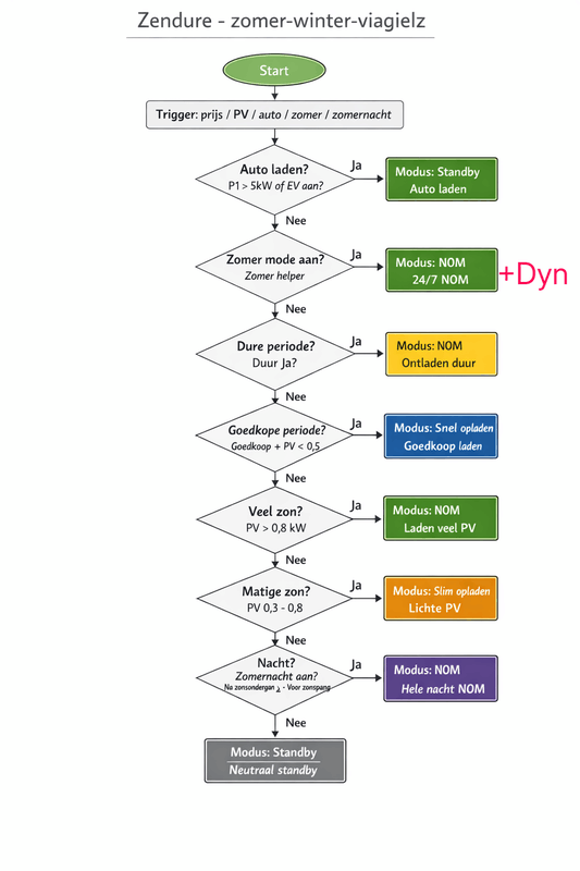

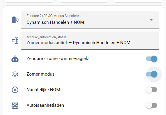

  • edjes
hemertje schreef op zondag 19 april 2026 @ 10:32:
Die zomer-winter stuurt Gielz weer aan wat hij moet doen volgens onderstaand schema.
Ik heb een zomer modus, dan gooit hij de batterij vol met zon, en dan NOM+dyn (met opladen uit net uit; goedkope periodes = 0).
Voorts een helper om te bepalen of de batterij goed vol 2 uur voor zonsondergang, dan gaat hij de hele nacht NOMMEN. En anders gooit hij de batterij leeg wat er is op de dure momenten.
En heel belangrijk, als de auto laadt, dan moet hij naar standby, daar is ook een kleine automation voor die een helper aanstuurt.

alias: Zendure - zomer-winter-viagielz
description: >
  Stuurt Zendure 2400 AC, prijs, Nul op de meter, zomernacht-helper, PV-drempel

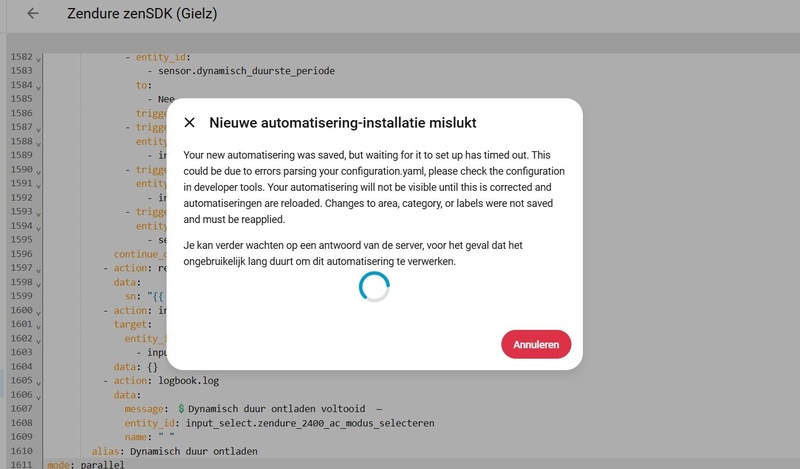

Hij staat nu op dynamisch handelen in Gielz. 2400AC met 4x AB3000X. 6 uur goedkoop, 5 uur duur, minimale spread 25%.
Ontladen duurt dik 4 uur, opladen net een paar minuten meer dan 5 met de laatste update.
Wat ik zie is dat hij in een paar tellen naar vol vermogen gaat en terug, alleen het einde van het (ont)laden wordt teruggeregeld. Ik zou dus prima kwartier tarieven kunnen gebruiken, maar Zonneplan doet daar nog niet aan en rekent nog in uren.
Ik zie ik zie wat jij niet ziet, en het is....... ach laat ook maar je ziet het toch niet!
Ik heb eerst de standaard installatie gedaan, met de zendure p1 meter en daarna hems geactiveerd. Kon ik een beetje begrijpen hoe dat werkte, voor ik me aan Gielz waagde. Was (is) een steile leercurve voor mij dus ik ben blij dat ik het zo gedaan heb.

Ik probeer altijd alle uren te pakken. Standaard is 3. Vandaag waren er meer uren laag. Wat ik dan doe is die allemaal selecteren en het laadvermogen te verlagen. Bij 2400 Watt is de efficiency een 91%. Bij 1800 Watt is die 93%. Dus vandaag op 1800 gezet gezien de uren. Ontladen is altijd 3. Dan zijn ze een eind leeg. Wat je zegt, je moet wel zo plannen dat de batterijen vol komen.
Afbeeldingslocatie: https://tweakers.net/i/yPEA19i0orfOTEsspyrRHJLyFJI=/800x/filters:strip_icc():strip_exif()/f/image/cv0iFaHlMvV3TtECU8bpDMeq.jpg?f=fotoalbum_large
Vandaag dus deze instelling. Genoeg goedkope uren. Duur maar 1. Waarom? Morgenochtend een betere prijs.
Afbeeldingslocatie: https://tweakers.net/i/q9DH2yCNDqg-NhViUOG-1nUYPLo=/800x/filters:strip_icc():strip_exif()/f/image/YiTSOCaFGXC8D3KTeLjFNexX.jpg?f=fotoalbum_large
Dynamisch Handelen NOM zet ik hem dus neer als ik leeg wil zijn voor de nieuwe handel. Dan loopt de batterij dus verder leeg op NOM en zal bij de volgende goedkope uren weer laden.
Die 30% is idd voor het afdekken van laad- en ontlaadverliezen.

Ik ben al een tijdje bezig en kom er helaas echt niet uit. Ik heb de Zendure 2400 AC+ gisteren ontvangen. Ik gebruik deze tot nu met de p1 meter via HEMS. Nu wil ik hem in Home Assistant krijgen. Dit wilde ik eerst doen via de Zendure integratie via HACS. Dit ging niet goed. Hij verbond wel, maar ik kreeg geen data door. Deze heb ik uiteindelijk uitgezet in Home Assistant. Ik wilde later naar de Gielz1986 ZenSDk gaan. Daar ben ik gister avond aan begonnen. Maar ik kom niet verder. Tot de stap dat je Automation moet plakken in de automatisering gaat alles goed. Daarna krijg ik de volgende foutmelding. (zie afbeelding onderaan)
Belangrijk om te weten:
Ik draai Home Assistant via Docker op een Synology NAS.
Mijn Zendure kan ik niet update verder dan firmware 1.03, dat lijken meer mensen te hebben die er sinds kort mee zijn gestart las ik in forums van Zendure zelf.
Ik gebruik de Homewizard P1 meter.
Wat heb ik al gedaan:
Al drie keer alles verwijderd en volledig opnieuw gestart met wat ik moet doen volgens https://github.com/Gielz1...DK/blob/main/README.nl.md
Via Chatgpt geprobeerd tot een antwoord te komen.
Ik start met HEMS uitzetten in de app op mijn telefoon. Ik zet het vinkje om bij de accu "toevoegen aan HEMS", maar verwijder het niet of iets dergelijks. Vervolgens pas in de configuration file aan en zet ik de bestanden over.
Het lijkt maar niet te lukken. Heeft iemand anders een goed idee?
Kun je überhaupt wel een eigen andere nieuwe automatisering via Home Assistant zelf aanmaken?

gielz schreef op zondag 19 april 2026 @ 21:08:
Goede vraag. Ik zie nu dat ik überhaupt geen automatisering kan aanmaken. Ik heb al mijn automatiseringen nog in Homey zitten. Toevallig een idee hoe ik dit ga oplossen?
slvans schreef op zondag 19 april 2026 @ 21:13:
@Devke had jij ook niet exact hetzelfde probleem (lang geleden)?
Zendure-HA.com | Run Zendure your way — in Home Assistant
Pakhaas schreef op zondag 19 april 2026 @ 21:03:
En teruglever boete? Dan is NOM idd wel goed. Maar is je batterij de volgende dag wel leeg?
Ik heb geen terugleverboete. Batterij kan in deze periode inderdaad leeg zijn als de warmtepomp aanspringt. Dat verwacht ik komende week nog wel. En anders is er ook nog een auto die geladen wordt.
En wat is “goed”? Ik wil eerst zien hoe NoM gaat, dus vind ik dit “goed” 😄
En @gielz. Klopt. Ff nadenken hoor dit is al ff terug. Zorg dat je automations.yaml in de hoofd directory van HA staat. Ik had in mijn configuration.yaml een verwijzing naar een subdirectory gezet. Een map waar al mijn automatiseringen bijelkaar stonden. Iedere automatisering in een apart bestand. Als je dan via de GUI ook automatiseringen wilt toevoegen dan werkt dit niet lekker. Beste is de de automatiseringen via de GUI toe te voegen. Dan krijg je wel 1 automations.yaml maar werkt wel.
