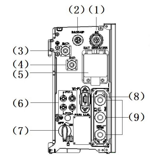

  • SaaX
  • Registratie: Mei 2025
  • Laatst online: 17-09 07:57
@Ruud916 The location depends on the model, it's (2) for my G3-S5.
Afbeeldingslocatie: https://tweakers.net/i/Ska6zcTtkqveAQCYhgxUT5Od704=/fit-in/4000x4000/filters:no_upscale():strip_exif()/f/image/p5wSKxdzeZrERGPTdcBKnhq0.png?f=user_large
The switch I'm using is the Hager SF263, but the G3-S5 is a single phase inverter - again, this depends on your model. For the connection I'd assume country specific regulation apply. I'm based in Ireland, so not of much use I guess. Also this is not a DIY job, get a certified electrician to do the job.
  • Ruud916
  • Registratie: December 2025
  • Laatst online: 26-12-2025
Thanks @SaaX
I think so as well, our model is a 3-phase.
Easiest is to buy the right plug and connect a couple of wall sockets directly on it for emergency use.
