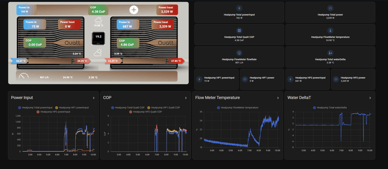

  • Gregory76
  • Laatst online: 12-10 10:12
Gregory76
PlayStation enthusiast
Trackerfire schreef op woensdag 18 september 2024 @ 22:26:
Hier de eerder geposte versie van @gwjonker omgebouwd naar een enkele versie.
Toevoegen aan configuration.yaml

sensor:
  # Quatt
  # HP1 working mode
  - name: "Quatt HP1 Control Mode"
    icon: mdi:auto-mode
    state: >
      {% if is_state('sensor.heatpump_hp1_workingmode', '0') %}
        Standby
      {% elif is_state('sensor.heatpump_hp1_workingmode', '1') %}
        Standby - heating
      {% elif is_state('sensor.heatpump_hp1_workingmode', '2') %}
        Heating - heatpump only
      {% elif is_state('sensor.heatpump_hp1_workingmode', '3') %}
        Heating - heatpump + boiler
      {% elif is_state('sensor.heatpump_hp1_workingmode', '4') %}
        Heating - boiler only
      {% elif is_state('sensor.heatpump_hp1_workingmode', '96') %}
        Anti-freeze protection - boiler on
      {% elif is_state('sensor.heatpump_hp1_workingmode', '97') %}
        Anti-freeze protection - boiler pre-pump
      {% elif is_state('sensor.heatpump_hp1_workingmode', '98') %}
        Anti-freeze protection - water circulation
      {% elif is_state('sensor.heatpump_hp1_workingmode', '99') %}
        Fault - circulation pump on
      {% endif %}
  # Quatt Costs per kWh heat for CV and HP
  - name: Costs kWh heat CV
    unique_id: costs_kwh_heat_cv
    unit_of_measurement: "€/kWh"
    state: >
      {% set priceGas = 1.1 | float %}
      {% set kwhPerM3Gas = 9.8 | float %}
      {% set efficiencyCV = 0.9 | float %}
      {{ '%.4f'%(priceGas / kwhPerM3Gas / efficiencyCV) | float }}
  - name: Costs kWh heat HP
    unique_id: costs_kwh_heat_hp
    state: >
      {% set priceElec = 0.21 | float %}
      {% set totalCOP = states('sensor.heatpump_hp1_cop') | float %}
      {{ '%.4f'%(priceElec/totalCOP) | float }}
  # Quatt costs and savings daily
  - name: Quatt costs input daily
    unique_id: quatt_costs_input_daily
    unit_of_measurement: "€"
    state: >
      {% set kwhInput = states('sensor.quatt_hp1_power_input_kwh_daily') | float %}
      {% set kwhPrice = 0.21 | float %}
      {{ '%.2f'%(kwhInput * kwhPrice) | float }}
  - name: Quatt savings heat daily
    unique_id: quatt_savings_heat_daily
    state: >
      {% set kwhHeat = states('sensor.quatt_hp1_heat_input_kwh_daily') | float %}
      {% set kwhPriceCVHeat = states('sensor.costs_kwh_heat_cv') | float %}
      {% set costsInputDaily = states('sensor.quatt_costs_input_daily') | float %}
      {{ '%.2f'%(kwhHeat * kwhPriceCVHeat - costsInputDaily ) | float }}
  - name: Quatt gas saving daily
    unique_id: quatt_gas_savings_daily
    unit_of_measurement: "m3"
    state: >
      {{ '%.2f'%(kwhHeat / kwhPerM3Gas / efficiencyCV) | float }}
  # Quatt daily CoP
  - name: Quatt COP daily
    unique_id: quatt_cop_daily
    unit_of_measurement: "CoP"
    state: >
        {% set total_heat = states('sensor.quatt_hp1_heat_input_kwh_daily') | float %}
        {% set total_input = states('sensor.quatt_hp1_power_input_kwh_daily') | float %}
        {{ '%.2f'%(total_heat/total_input) | float }}
        # 24-hour average for heatpump_hp1_cop
  - platform: statistics
    name: "Heatpump HP1 COP 24h Average"
    entity_id: sensor.heatpump_hp1_quatt_cop
    state_characteristic: mean
    max_age:
      hours: 24
utility_meter:
  quatt_hp1_heat_input_kwh_daily:
    source: sensor.heatpump_hp1_power
    cycle: daily
  quatt_hp1_power_input_kwh_daily:
    source: sensor.heatpump_hp1_powerinput
    cycle: daily
  heatpump_hp1_cop_daily:
    source: sensor.heatpump_hp1_quatt_cop
    cycle: daily
Toevoegen aan kaart:

type: picture-elements
elements:
  - type: state-label
    entity: sensor.heatpump_hp1_powerinput
    style:
      top: 14%
      left: 24%
      font-weight: bold
      color: white
      font-size: 80%
  - type: state-label
    style:
      top: 14%
      left: 58%
      font-weight: bold
      color: white
      font-size: 80%
  - type: state-label
    entity: sensor.heatpump_hp1_quatt_cop
    style:
      top: 42%
      left: 24%
      font-weight: bold
      color: white
      font-size: 80%
  - type: state-label
    entity: sensor.heatpump_hp1_temperatureoutside
    style:
      top: 61%
      left: 88%
      font-weight: bold
      color: white
      font-size: 50%
  - type: state-label
    entity: sensor.heatpump_qc_supervisory_control_mode
    style:
      top: 66%
      left: 40%
      font-weight: bold
      color: white
      font-size: 80%
  - type: state-label
    entity: sensor.kamer_1_temperatuur
    style:
      top: 29%
      left: 88%
      font-weight: bold
      color: white
      font-size: 100%
  - type: state-label
    entity: sensor.heatpump_thermostat_room_setpoint
    style:
      top: 34%
      left: 88%
      color: white
      font-weight: bold
      font-size: 65%
  - type: state-label
    entity: sensor.heatpump_hp1_temperaturewaterin
    style:
      top: 66%
      left: 10%
      font-weight: bold
      color: white
      font-size: 65%
  - type: state-label
    entity: sensor.heatpump_hp1_temperaturewaterout
    style:
      top: 66%
      left: 73%
      font-weight: bold
      color: white
      font-size: 65%
  - type: state-label
    entity: sensor.heatpump_flowmeter_flowrate_2
    style:
      top: 86%
      left: 25%
      font-weight: bold
      color: white
      font-size: 75%
  - type: state-label
    entity: sensor.heatpump_flowmeter_temperature
    style:
      top: 90%
      left: 25.5%
      font-weight: bold
      color: white
      font-size: 75%
image: https://tweakers.net/fotoalbum/image/Cr6iOljKJksl20U37HHcNRZD.png
dark_mode_image: https://tweakers.net/fotoalbum/image/Cr6iOljKJksl20U37HHcNRZD.png
camera_view: live
card_mod:
  style: ''
Sorry, ik ben nog een beetje een HA noob, maar heb inmiddels al wel veel apparaten werkend gekregen. Nu die mooie Quatt weergave nog. ;)
Wat bedoel je precies met:
"Toevoegen aan kaart:
code:"
Dank alvast!
PSN: GregNL76 - Consoles: PS1, PS2, PS3 phat, slim & superslim, PS4 (fw 5.05), PS4 Pro, PS4 Slim, PS5 Pro, PS5, PS Portal, PS Vita (HENkaku), PSP, PlayStation TV, PSVR, Nintendo Wii U, Switch (unpatched), DS, NES, GameBoy and more consoles!

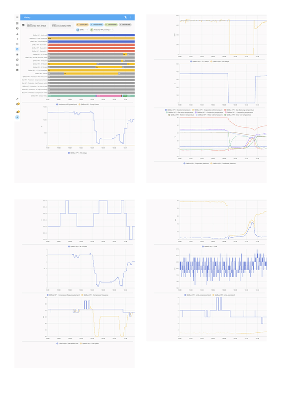

Afbeeldingslocatie: https://tweakers.net/i/KvY-v6tpBUKY36vCKflDMB3ec_A=/fit-in/4000x4000/filters:no_upscale():strip_exif()/f/image/zVfJOdb1YOxjRlTYcEzRzheK.png?f=user_large
Afbeeldingslocatie: https://tweakers.net/i/GAL7w9p_Nj7TV48acUA12BA40Ao=/800x/filters:strip_exif()/f/image/bycrOItyuWmqEmHFKqXx0jU6.png?f=fotoalbum_large
Second page: nerd stats, a must have
Afbeeldingslocatie: https://tweakers.net/i/-J1uQOx2s1TbvYxNrPOW1G-hdg4=/800x/filters:strip_exif()/f/image/tGrFluMU1PdSQX7yTlwpUl0R.png?f=fotoalbum_large
Third page: development only, the things I need to make it run but not displayed to other devices
How does it work
Every room can demand heat, if there is heat demand, a change in temperature setpoint or a change in real temperature an automation is run.
-If there is need to heat, the automation increases the temperature by 0.1C

With dynamic mode, Home assistant also checks the current energy level prices in the 24h:
- if very_cheap or cheap the thermostat setpoint is increased by 0.5C (example set temperature 20C -> 20.5) and the gradual temperature increases are of 0.2C instead of 0.1 (the Duo pushes a bit harder)
- if normal everything stays the same
- expensive or very_expensive, the thermostat setpoint is decreased by 0.5 (example set temperature 20C -> 20.5)
Last functionality, if you set the system to OFF, it will set the temperature to 18C fixed and disable the automation.
Very happy with the result, only missing away mode (lower down if both me and my partner phones are not at home) and fixed setpoint, without dynamic energy prices increases/decreases.
For the one interested, this is the main automations, there are some helpers used.

  • verguldebarman
  • Laatst online: 18:01
djlorenz schreef op zaterdag 23 november 2024 @ 10:26:
Ok, for this message I will go with English, I don't think google translate can do a decent job to explain this.
After many, many, many pages of Ervaringen met Quatt Deel 2, I decided I wanted something more and easier than messing around with tado schedule (not easy to create gradual increases of 0.1 and adjust them from the phone UI).
House Situation
- Energy label A house
- Quatt Duo
- ground floor with underfloor heating (vvw) and main Tado thermostat
- other two floors with radiators
- two other important rooms both with 2x compact (type 11) radiators, one with Tado valve and one with normal thermostatic valve, set on 5
What I wanted
- small step adjustment
- ability to adjust upstairs room differently (they loose heat way quicker than ground floor)
- ability to set a "normal schedule" that I can change easily
- adjustment based on energy tariff, if price is cheap, push a bit harder.
- Ability to easily turn off everything
- Away mode (when you are out for only a few hours) <-- Still TODO
- Fixed setpoint mode <-- Still TODO
With the help of chatGPT and a week without parner in the house, I started thinkering.
My creation:
Home assistant super-smart thermostat
In this section I have the main control and overview of the thermostat, Temperature shown for each room and ability to set temperature individually.
I can also change schedule easily:
How does it work
-If there is no need to heat: the automation decreases the temperature by 0.5C
-If there temperature is the same set: the automation keeps the same temperature set.

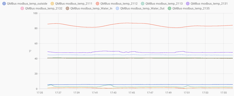

De snelle logs (samplerate .5 Hz) laten een maximale op -of afschalen van powerinput zien van 20%, en dat per elke halve minuut. Geen idee wat dat voor de levensduur van de compressor betekent. We gaan zien wat de reactie van Quatt zal zijn. Wordt vervolgd.
Voorlopig antwoord van Quatt:
Op dit moment hebben we nog geen direct antwoord op de punten die je hebt aangekaart. We willen je bevindingen eerst verder onderzoeken om een goed onderbouwde reactie te kunnen geven. .....
Tijdens de koude periode dezelfde "oscillaties" in de powerinput gezien nu ook bij de hogere vermogens. Dit resulteerde in een jankend effect van het geluid dat doordrong tot in de huiskamer. We wachten op het vervolgantwoord.

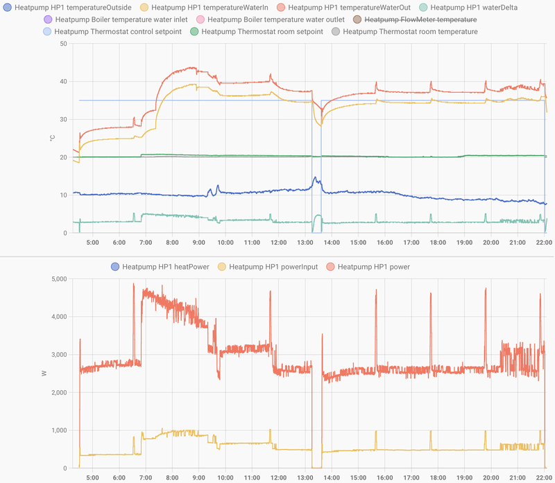

NH, vrijstaand huis 70m2 bg vvw/40m2 boven radiatoren, Gas 2023:1500m3, 2024:200m3, Quatt 4kw, TS:DIY-Arduino, 6400 Wp panelen/SolarEdge.
  • m10tech
  • Registratie: April 2024
  • Laatst online: 30-09 15:38
Ik ben een verklaring tegengekomen voor een fenomeen dat speelt bij zacht weer, zoals vandaag.
Om de ~2 uur gaat de powerconsumptie kort van 480W of 600W naar 980W.
Als er al gewoon op 1000W wordt gewerkt, dan is dat niet zo, en de eerste piek is 2 uur na het teruggaan naar lager vermogen. Plaatje van 14 november.

Het viel me op dat in de modbus dit overeenkomt met bit3 van register 2019. De powermode blijft identiek, de vraagfrequentie ook, maar de daadwerkelijke frequentie gaat fors omhoog en daarmee ook het vermogen.
Ik kwam een handleiding tegen van een zweedse pomp pag40, en daar is bit3 van de P meldingen =P04 precies wat hier lijkt te gebeuren.
P04 Compressor oil return protection   -> Compressor speed up
If unit has been continuously working in low speed for certain period of time,
unit starts this protection to suck compressor oil back into compressor.
This is a normal protection and does not need any treatment.
Misschien dat de overige omschrijvingen ook kloppen voor dit register...
Maar gelukkig heb ik daar nog geen voorbeelden van.
Ik zie diverse merken allemaal dezelfde teksten en codes gebruiken, dus misschien is dit mooi overgenomen door quatt of hoort het bij de compressor handleiding.

Afbeeldingslocatie: https://tweakers.net/i/DNsDH5LKsq6DVOK13OMmzWtCSO0=/800x/filters:strip_exif()/f/image/hcKIkBOOAUHmrPUoUXKlF6f8.png?f=fotoalbum_large

  • Nielsvde
  • Laatst online: 12-10 13:57
Mijn HA Quatt scherm:
Afbeeldingslocatie: https://tweakers.net/i/EyHmVyaow9SKySzweI2snW0-cqo=/x800/filters:strip_exif()/f/image/blGMOnufDmrhw9v6qgDN6SO3.png?f=fotoalbum_large
En als de cv bijschakels wijzigt het plaatje:
Afbeeldingslocatie: https://tweakers.net/i/hOfcgIMR0U8QN9tDl-EBDr7hEBI=/x800/filters:strip_exif()/f/image/ucHgG2FtywZZDOemPmz5TUmx.png?f=fotoalbum_large
Helaas regelmatig deze situatie:
Afbeeldingslocatie: https://tweakers.net/i/sD9hHSZ6Af67i9knfPMVBY3Mw5w=/800x/filters:strip_icc():strip_exif()/f/image/6EuZ5jNwNDWeNJaz9OTpPhSD.jpg?f=fotoalbum_large
[ Voor 49% gewijzigd door Nielsvde op 28-11-2024 01:00 ]
  • jj85
  • Laatst online: 22:26
Heb je de verversingsinterval van de Quatt integratie toevallig aangepast (anders dan de standaard 10 sec)?
  • Fragger123
  • Laatst online: 18:36
Vermoedelijk wel, ik heb deze laatst ook eens aangepast naar 5 seconden, dit gaf het zelfde probleem beeld. Nu weer terug naar 10 sec en geen last meer van.
  • jj85
Fragger123 schreef op donderdag 28 november 2024 @ 10:41:
Precies dit, bij 5 seconden krijg je deze 'foutmeldingen'
@Lasoul enig idee waarom?
  • Lasoul
  • Laatst online: 22:39
jj85 schreef op donderdag 28 november 2024 @ 10:43:
Ik kan het bij mij zelf ook reproduceren als ik het interval op 5 seconden zet. Ik krijg dan de melding "Error fetching quatt data: Error fetching information". Wellicht is de vorige call nog bezig en wordt deze geblokkeerd. Ik ga eens kijken wat precies het probleem is.

    style:
      top: 7%
      left: 50%
  - type: state-label
    style:
      top: 16%
      left: 13%
  - type: state-label
    entity: sensor.heatpump_thermostat_room_temperature
    style:
      top: 18%
      left: 38%
  - type: icon
    icon: mdi:numeric-1-box
    style:
      left: 32%
      top: 39%
  - type: state-label
    entity: sensor.heatpump_thermostat_control_setpoint
    style:
      left: 92%
      top: 78%
  - type: state-label
    style:
      left: 90%
      top: 13%
visibility:
  - condition: state
    entity: binary_sensor.heatpump_boiler_on_off_mode
    state: "on"
image: /api/image/serve/872b81ab539beb39839d77c2dd9494fe/512x512
HP2
24
25
26
27
28
29
30
31
32
33
34
35
36
37
38
39
elements:
  - type: state-label
    entity: sensor.heatpump_hp2_quatt_cop
    style:
      top: 43%
      left: 41%
  - type: state-label
    entity: sensor.heatpump_hp2_workingmode_text
    style:
      top: 91%
      left: 52%
  - type: state-label
    entity: sensor.heatpump_hp2_temperaturewaterout
    style:
      left: 89%
      top: 42%
  - type: state-label
    entity: sensor.heatpump_hp2_temperaturewaterin
    style:
      top: 29%
      left: 15%
  - type: state-label
    entity: sensor.heatpump_hp2_powerinput
    style:
      top: 59%
      left: 15%
  - type: state-label
    style:
      top: 23%
      left: 66%
  - type: icon
    icon: mdi:numeric-2-box
    style:
      left: 32%
      top: 13%
image: /api/image/serve/35d8be418dc0ed64071bf09588b6dec7/512x512
dark_mode_image: /api/image/serve/58aea43de7580e0f33e8c0b999ba2d7e/512x512

gwjonker schreef op donderdag 12 september 2024 @ 22:35:
In de topic gwjonker in "Ervaringen met Quatt Deel 2" kreeg ik van een aantal het verzoek de code voor het onderstaande dashboard te delen. Hierbij een eerste poging.
Vooraf
Btw, het is een picture-elements weergave. Het achtergrondplaatje heb ik gemaakt in PowerPoint en middels een screenshot opgeslagen als png.
De plaatsing en grootte van de tekstelementen is relatief en op maat gemaakt voor mijn Iphone 12 Pro Max (portrait).
Benodigd
- Geinstalleerde Quatt Duo (duh...)
- Home Assistant draaiend (duh...)
- HACS
- Quatt-integratie draaiend: https://github.com/marcoboers/home-assistant-quatt
- Achtergrondplaatje m.b.v. bijvoorbeeld de add-on Samba-share geplaatst op je HA in /config/www [Afbeelding]
- De code van de kaart toegevoegd aan een dashboardpagina:
card_mod:
  style: |
    ha-card { height: 150px !important; }
elements:
  - type: state-label
    entity: sensor.heatpump_total_powerinput
    style:
      top: 12%
      left: 9%
      font-weight: bold
      color: white
      font-size: 130%
  - type: state-label
    entity: sensor.costs_kwh_heat_cv
    suffix: ' CV heat'
    style:
      top: 7%
      left: 25%
      font-weight: bold
      color: white
      font-size: 80%
  - type: state-label
    entity: sensor.costs_kwh_heat_hp
    suffix: ' HP heat'
    style:
      top: 12%
      left: 25%
      font-weight: bold
      color: white
      font-size: 80%
  - type: state-label
    entity: sensor.heatpump_total_quatt_cop
    style:
      top: 12%
      left: 50%
      font-weight: bold
      color: white
      font-size: 130%
    state: |
      [[[ return (entity.state === 'Onbekend') ? '-' : entity.state; ]]]
  - type: state-label
    entity: sensor.heatpump_total_waterdelta
    style:
      top: 10%
      left: 76%
      font-weight: bold
      color: white
      font-size: 110%
  - type: state-label
    style:
      top: 12%
      left: 88%
      font-weight: bold
      color: white
      font-size: 130%
  - type: state-label
    style:
      top: 30%
      left: 15%
      font-weight: bold
      color: white
      font-size: 130%
  - type: state-label
    style:
      top: 30%
      left: 33%
      font-weight: bold
      color: white
      font-size: 130%
  - type: state-label
    style:
      top: 30%
      left: 66%
      font-weight: bold
      color: white
      font-size: 130%
  - type: state-label
    style:
      top: 30%
      left: 87%
      font-weight: bold
      color: white
      font-size: 130%
  - type: state-label
    style:
      top: 52%
      left: 15%
      font-weight: bold
      color: white
      font-size: 130%
  - type: state-label
    style:
      top: 52%
      left: 66%
      font-weight: bold
      color: white
      font-size: 130%
  - type: state-label
    style:
      top: 63%
      left: 38%
      font-weight: bold
      color: white
      font-size: 100%
  - type: state-label
    entity: sensor.heatpump_hp2_temperatureoutside
    style:
      top: 63%
      left: 61%
      font-weight: bold
      color: white
      font-size: 100%
  - type: state-label
    entity: sensor.quatt_hp2_control_mode
    style:
      top: 72%
      left: 76%
      font-weight: bold
      color: white
      font-size: 100%
  - type: state-label
    entity: sensor.quatt_hp1_control_mode
    style:
      top: 72%
      left: 24%
      font-weight: bold
      color: white
      font-size: 100%
  - type: state-label
    prefix: 'CiC '
    style:
      top: 29%
      left: 50%
      font-weight: bold
      color: white
      font-size: 100%
  - type: state-label
    entity: sensor.t6_thermostaat_thermostat_indoor_temperature
    style:
      top: 42%
      left: 50%
      font-weight: bold
      color: white
      font-size: 120%
  - type: state-label
    style:
      top: 45%
      left: 50%
      color: white
      font-weight: bold
      font-size: 100%
  - type: state-label
    style:
      top: 72%
      left: 7%
      font-weight: bold
      color: white
      font-size: 100%
  - type: state-label
    style:
      top: 72%
      left: 41%
      font-weight: bold
      color: white
      font-size: 100%
  - type: state-label
    style:
      top: 72%
      left: 58%
      font-weight: bold
      color: white
      font-size: 100%
  - type: state-label
    style:
      top: 72%
      left: 93%
      font-weight: bold
      color: white
      font-size: 100%
  - type: state-label
    style:
      top: 88%
      left: 17%
      font-weight: bold
      color: white
      font-size: 100%
  - type: state-label
    style:
      top: 92%
      left: 17%
      font-weight: bold
      color: white
      font-size: 100%
  - type: state-label
    entity: sensor.quatt_total_power_input_kwh_daily
    prefix: 'Today input: '
    style:
      top: 87%
      left: 33%
      color: white
      font-size: 80%
      align: left
  - type: state-label
    entity: sensor.quatt_total_heat_power_kwh_daily
    prefix: 'Today heat: '
    style:
      top: 90%
      left: 33%
      color: white
      font-size: 80%
      align: left
  - type: state-label
    entity: sensor.gas_daily
    prefix: 'Today gas: '
    style:
      top: 93%
      left: 33%
      color: white
      font-size: 80%
  - type: state-label
    entity: sensor.quatt_cop_daily
    prefix: 'Today CoP: '
    style:
      top: 86%
      left: 53%
      color: white
      font-size: 80%
      align: left
  - type: state-label
    entity: sensor.quatt_costs_input_daily
    prefix: 'Today costs: '
    style:
      top: 89%
      left: 53%
      color: white
      font-size: 80%
      align: left
  - type: state-label
    entity: sensor.quatt_savings_heat_daily
    prefix: 'Today savings: '
    style:
      top: 92%
      left: 53%
      font-weight: bold
      color: white
      font-size: 80%
  - type: state-label
    entity: sensor.quatt_gas_saving_daily
    prefix: 'Today gas savings: '
    style:
      top: 95%
      left: 53%
      color: white
      font-size: 80%
  - type: state-label
    style:
      top: 90%
      left: 80%
      font-weight: bold
      color: white
      font-size: 90%
image: /local/quatt12.png

De powerin kan tijdens een defrost kort onder de 100W komen.. tenminste dat zegt mijn data (volgens anderen is dit volstrekt onmogelijk...)
Probleem hier was een korte dip onder de 100 en dan weer terug omhoog. Resultaat 2 defrosts geteld ipv 1.
Afbeeldingslocatie: https://tweakers.net/i/KysWKJGK-GGX0rzAmn_jEv7M5Rg=/800x/filters:strip_exif()/f/image/CrNxNHtsFi1r6Aim8bgxsotl.png?f=fotoalbum_large

Even kijken waar hier is ? Quatt en domotica. Oke, prima.
In jouw plaatje is de powerIn zelfs even gelijk aan 0. Misschien moet je dan wel spreken over twee defrosts.
Ik heb in mijn algoritime, dat gebaseerd is op powerin<100 en powerOut=0, een periode gekozen hoelang deze periode minimaal moet duren (nu ingesteld op minimaal 60s) zodat de spikes weggefilterd worden die ontstaan bij in- en uitschakelen van de quatt. Dit is waarschijnlijk niet nodig als je het algoritme op de temperatuur baseerd, want die heeft al wat traagheid.
Ik ben het wel met je eens dat de stroming door de warmtepomp wel hoog is, dus de vertraging is klein, maar de warmte moet ook nog naar de temperatuursensoren doordringen. Dat is ook weer wat trager. Je krijgt dan geen exact beeld van de defrost periode. Wat ik hier roep is deels wel op aannamen gebaseerd want ik heb nog niet veel goede data.

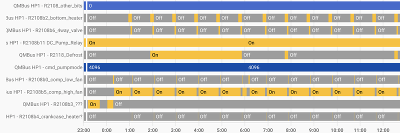

We zijn bezig de modbus sniffer betrouwbaar te maken. Daar is defrost een boolean bit in de rapportage.
Wellicht kun je voor jezelf ook een RS485 bordje aanschaffen zodat jullie wat betrouwbare input hebt en daar de fuzzy logic op kunt kalibreren.
Voor details, PB...?

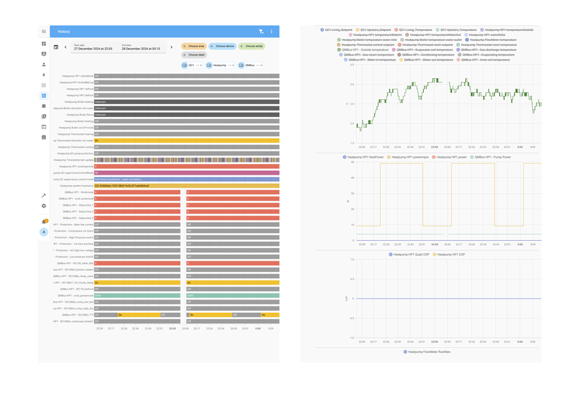

En om iedereen een beetje lekker te maken voor wat je dan kunt zien:
Het 'janken' van de compressor die om de zoveel seconden harder en zachter gaat. (@Freeckje jouw ontdekking) en het continue bij sturen van de pomp (omdat origineel de flow alleen bekend was bij de CiC en de pomp in de Quatt zit)
Afbeeldingslocatie: https://tweakers.net/i/wSCubG74HBTg83kpQ8fYoT3u9Qw=/800x/filters:strip_exif()/f/image/Ici0DBejfrR12QfdVaUBw2PM.png?f=fotoalbum_large
Afbeeldingslocatie: https://tweakers.net/i/UfexFKFRSn3SGmmvss0PsEk2_nU=/800x/filters:strip_exif()/f/image/dkyOXw2RFIKsj1jQ9ddBzzw5.png?f=fotoalbum_large
En alle geheimzinnige temperaturen
Afbeeldingslocatie: https://tweakers.net/i/FU4RsflD9l6XTEPjJ2CpD-NG-sk=/800x/filters:strip_exif()/f/image/nzwbwVG3p6IuV6HoIuycSWbs.png?f=fotoalbum_large

  • jj85
Hulde aan @m10tech voor zijn werk!
Goed om te vermelden dat dit op basis van ESPHome is, wat weer zorgt voor een fijne integratie in HA *O*
Al even wat mee gespeeld
Afbeeldingslocatie: https://tweakers.net/i/9b7NeOB6UdEdAmSPZ_VNcmKZ57Q=/x800/filters:strip_exif()/f/image/BHy5kGZwjLimz3sbTtltcR6r.png?f=fotoalbum_large

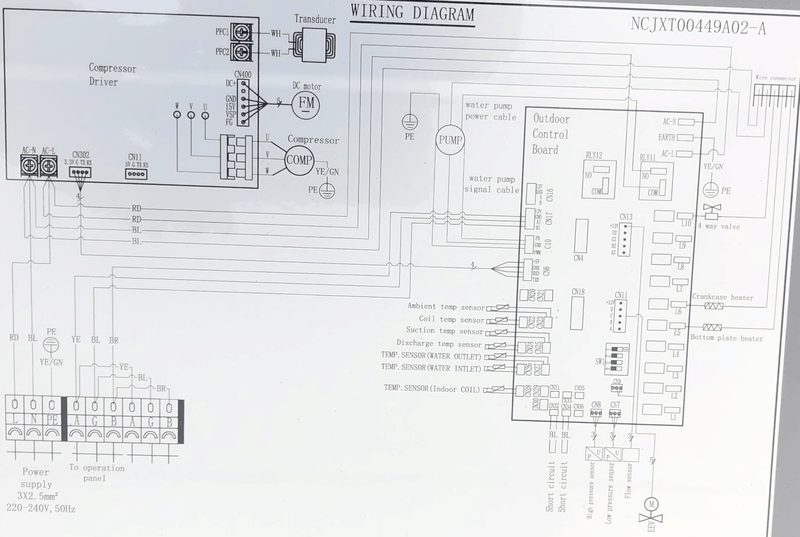

Voor de mensen die ook modbus willen sniffen:
@TeslaNerd heeft dit bordje gevonden waar alles op en aan zit, maar waar je nog de TX lijn moet doorsnijden en drie weerstanden moet verwijderen (om het echt goed te doen, R1,R2,R3).
https://www.tindie.com/pr...s-and-optional-touch-tft/
Ikzelf gebruik mijn eigen ESP, voeding en dit bordje:
https://www.aliexpress.co...st_main.47.6b0b1802qxz4T8
Daarop hoef ik alleen een 120ohm weerstand te verwijderen (markering 122, dus 1200 ohm en kan dus ook gewoon blijven).
Ook Olimex heeft een RS485 bordje, maar geen ervaring mee:
https://www.olimex.com/Products/Modules/Interface/MOD-RS485/

  • m10tech
En hoe je de TX lijn moet doorkrassen op het ESPC3 bordje dat TeslaNerd heeft:
Afbeeldingslocatie: https://tweakers.net/i/5UD_Sr0nPkRmcCc5LoWqPovmkV4=/fit-in/4920x3264/filters:max_bytes(3145728):no_upscale():strip_exif()/f/image/7XbVNteLF2ey9MDoABkI3SC5.webp?f=user_large

  • m10tech
Met de Quatt-sniffer op versie 0.1.4 denken we dat het delen van metingen een goede stap is om meer te leren over onze Quatt.
Hieronder als voorbeeld een (grote) weergave van een periode waarin de CiC extreem veel wisselingen in de power-mode (cmd_compressorlevel) deed. Dat was al besproken op basis van een tekstuele modbus dump, maar met deze grafieken komen we een stuk sneller tot inzicht.
Is dat snelle schakelen gezond voor een compressor? We hebben het hier over op en afschalen in luttele seconden!!
Afbeeldingslocatie: https://tweakers.net/i/p7afc7aOW4HAhLV0KIioMNtoiHs=/x800/filters:strip_exif()/f/image/ZwfEPz9I3db5YnFwlmPUnMNp.png?f=fotoalbum_large
PS. de onderste balken zijn leeg omdat dit nog op basis van v0.1.2 was

En dit is het beeld van een defrost zonder bodemplaatverwarming.
Kunnen we speculeren wat al die bits voorstellen??

Over de bits in R2108, het schema in de Quatt geeft wel wat hints:
L5=bottom plate heater
L6=Crankcase heater
L10=4 way value
RLY11=pump
CN11=EEVmotor=ElectronicExpansionValve
Afbeeldingslocatie: https://tweakers.net/i/CdhlR1U_icJ6S77_CN1hK6XshGM=/800x/filters:strip_exif()/f/image/x6cGL3B0FFa6haL07KlZuziq.png?f=fotoalbum_large
Foto gemaakt bij de vervanging door Quatt monteur van de flowmeter

Nog een defrost, maar nu mét bodemplaatverwarming.
Je kunt het 150 watt extra verbruik zien...
Bit6 is waarschijnlijk de 4wegklep en
bit0, bit4 en bit5 lijken elkaar onderling uit te sluiten
De CiC is zich hier allemaal niet van bewust, dit is autonoom gedrag van de Quatt.

Ik zie een compressor-driver eenheid op het diagram.
Ik kan me goed voorstellen dat deze al deze functies bevat.
Het zou interessant zijn om te weten welk merk die eenheid is, en hoe die werkt, anyone???
Deze unit wordt middels een seriële interface aangestuurd (evt modbus...) dus daar kan alles in geregeld worden, ook spanning en stroom metingen.

  • jj85
m10tech schreef op zondag 22 december 2024 @ 21:17:
Megmeet hiplus3000?
Zie foto's op
timmert26 in "Ervaringen met Quatt Deel 2"
en
VindiGoosh in "Ervaringen met Quatt Deel 2"

Een aandachtspunt voor de ModBus sniffer.
Deze is bij mij niet 100% betrouwbaar maar bij @jj85 wel.
In onderstaande plaat kun je veel defrosts zien, elk met hun karakteristieke patroon van register 2108 bits 0, 2, 4, 5, 6 en register 2118. Maar bij register 2118 ontbreken er overgangen!
Vlak voor 8:00 en na 12:00 is het patroon zoals verwacht, dus alle andere overgangen hebben issues.
Na ~ 2:00, 3:00, 4:00 en 5:00 had er een Off moeten worden geregistreerd, maar die werd pas na 5:52 gezien.
En om~ 7:00, 9:00, 10:00, 10:50 en 11:50 hadden er On overgangen moeten zijn
Omdat ik de modbus op twee manieren trace kan ik in de ruwe dump zien dat die overgangen er wel waren.
Met deze context hebben we al een aantal dingen ontdekt:
  • eerst was mijn wifi signaal maar -85 dBm en toen was dit nog veel erger, nu is met -62 dBm.
    jj85 heeft -50dBm
  • in verbose mode kon ik zien dat de API buffer problemen heeft (zie verder)
  • jj85 heeft een DUO en dus nog veel meer sensoren, dus het kan wel
Bij elke ontvangst van een volle set van 40 registers krijg ik soms geen, maar vaak tussen de 3-10 foutmeldingen. Ik heb een speciale versie gemaakt waarbij deze foutmelding al in debug mode komt.
[D][api.connection:1534]: Cannot send message because of TCP buffer space
[W][component:237]: Component modbus_controller took a long time for an operation (96 ms).
[D][api.connection:147]: Home Assistant 2024.12.5 (192.168.178.9): Sending keepalive failed 2 time(s), will retry in 1000 ms
Code inspectie laat zien dat in zo'n geval de update niet alsnog wordt verzonden op een later moment.
Verder gebruik ik een laptop met HAOS en een ESP32, dus performance lijkt me ook geen issue.
Mijn vragen:
- wie weet hoe je de TCP buffer kunt vergroten zonder een super perfecte wifi te gebruiken
- en is dat ook een goede oplossing
- of een andere methode om dit te fixen?
Afbeeldingslocatie: https://tweakers.net/i/_9E9_sIqjiDEJyfEDE27P6uyPEo=/800x/filters:strip_exif()/f/image/3YP0wEejNC3BsAjFkSVTrfQp.png?f=fotoalbum_large

  • m10tech
Nog een reactie op een deel2 vraag
s020506 schreef op zaterdag 28 december 2024 @ 07:36:
Misschien bij nieuwere modellen. Bij mij springt de bodemverwarmer aan als de temperatuur onder de 4 graden komt. Of als de Quatt heeft uitgestaan, na 10 minuten.
We hebben een ander bit, 3, gevonden in register 2108 dat op de json een extra 40W inputPower geeft, maar dit gebeurd alleen als de Quatt niet actief is.
Als speculatie, stel dat de bodemverwarming bestaat uit twee weerstanden. In parallel zou dat 150W zijn, de waarde die we al vaker hebben gezien.
Dan is die twee weerstanden in serie een kwart daarvan, dus ongeveer die 40W.
Nou is elke waarde die de json doorgeeft een formule waarde, geen meting, dus dat kan nog steeds kloppen.
En de relatie met de buitentemperatuur is er ook niet echt...
Kortom, brainstorming speculatie...
Heeft iemand een andere verklaring voor de 40W van bit3?
Afbeeldingslocatie: https://tweakers.net/i/ARA6ud0MDGd8ZpP5SQFJeFe724E=/800x/filters:strip_exif()/f/image/tnStUG19egcfCQrmBLDlZR25.png?f=fotoalbum_large
[ Voor 14% gewijzigd door m10tech op 28-12-2024 19:00 ]

  • jj85
m10tech schreef op zaterdag 28 december 2024 @ 18:50:
Crankcase heaters zitten wel in die range van 40W, lijkt mij wel een logische verklaring
Aangestuurd door relais L5
Afbeeldingslocatie: https://tweakers.net/i/zmYr7yWNHbMixK8USx1OnS1iNSM=/800x/filters:strip_icc():strip_exif()/f/image/HFI7uNFk2C6mFTnKxjyyAxNw.jpg?f=fotoalbum_large

  • m10tech
jj85 schreef op zaterdag 28 december 2024 @ 20:35:
OK, dus dan is bit3 de crankcase heater, maar wat is dan bit4? Elke keer heel kort aan...
160m2 hoekh Utrecht,bj2000,VaillantKetelOT,eigen thermostaat gebouwd,Quatt202406 op platdak,onder VVW@20°C,boven@20/19.5°C 6m T11+4m convector+VVW badk,stooklijn 7k3W/15°C,3600Wp EPv
  • jj85
m10tech schreef op zaterdag 28 december 2024 @ 22:35:
Ben wat historie kwijt... maar nu vooral na elke defrost actief.
Afbeeldingslocatie: https://tweakers.net/i/xKqzuiRGo5cXX0rb0y9VTu_HPU4=/800x/filters:strip_exif()/f/image/vDZ1Y8172kKPStswOpIWk9OS.png?f=fotoalbum_large
