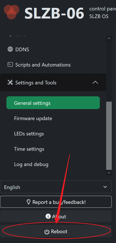

  • Cyrus The Virus
  • Laatst online: 02-10 08:37
Ik heb al een aantal maanden zonder issues 2 instances draaien in HA in combinatie met 2x SLZB-06. Alleen sinds vandaag wil 1 Z2M niet meer starten en krijg ik de volgende error
[10:24:34] INFO: Preparing to start...
[10:24:35] INFO: Socat not enabled
[10:24:35] INFO: Starting Zigbee2MQTT...
Starting Zigbee2MQTT without watchdog.
[2026-03-13 10:24:37] info:     z2m: Logging to console, file (filename: log.log)
[2026-03-13 10:24:37] info:     z2m: Starting Zigbee2MQTT version 2.9.1 (commit #unknown)
[2026-03-13 10:24:37] info:     z2m: Starting zigbee-herdsman (9.0.9)
[2026-03-13 10:24:37] info:     zh:zstack:znp: Opening TCP socket with 192.168.1.18:6638
[2026-03-13 10:24:37] info:     zh:zstack:znp: Socket connected
[2026-03-13 10:24:37] info:     zh:zstack:znp: Socket ready
[2026-03-13 10:24:37] info:     zh:zstack:znp: Writing CC2530/CC2531 skip bootloader payload
[2026-03-13 10:24:38] info:     zh:zstack:znp: Skip bootloader for CC2652/CC1352
[2026-03-13 10:24:56] error:    z2m: Error while starting zigbee-herdsman
[2026-03-13 10:24:56] error:    z2m: Failed to start zigbee-herdsman
[2026-03-13 10:24:56] error:    z2m: Check https://www.zigbee2mqtt.io/guide/installation/20_zigbee2mqtt-fails-to-start_crashes-runtime.html for possible solutions
[2026-03-13 10:24:56] error:    z2m: Exiting...
[2026-03-13 10:24:56] error:    z2m: Error: Failed to connect to the adapter (Error: SRSP - SYS - ping after 6000ms)
    at ZStackAdapter.start (/app/node_modules/.pnpm/zigbee-herdsman@9.0.9/node_modules/zigbee-herdsman/src/adapter/z-stack/adapter/zStackAdapter.ts:107:27)
    at Controller.start (/app/node_modules/.pnpm/zigbee-herdsman@9.0.9/node_modules/zigbee-herdsman/src/controller/controller.ts:145:29)
    at Zigbee.start (/app/lib/zigbee.ts:70:27)
    at Controller.start (/app/lib/controller.ts:111:29)
    at start (/app/index.js:156:5)
Nu heb ik al volledige reboots/power cycles geprobeerd van HA en de SLZB, evenals een firmware upgrade en downgrade. Maar in geen gevallen wil hij starten. Via google kom ik ook niet op een oplossing.
Enige wat ik nog niet geprobeerd heb is Z2M te verwijderen en alles opnieuw te installeren (want dan moet ik alles weer opnieuw pairen).
Iemand wat tips ?

Cyrus The Virus schreef op vrijdag 13 maart 2026 @ 10:55:
Iemand wat tips ?
EDIT: Zelfs een nieuwe install werkt niet
Ik had hetzelfde, is hier opgelost door de firmware van SLZB-06 te downgraden naar 20250325.
https://github.com/Koenkk/zigbee2mqtt/issues/31329

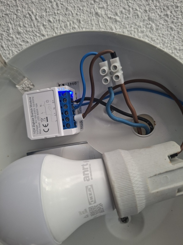

Zo mijn volgens mij mijn laatste lampen in huis (badkamer en zolder) toch ook maar even smart gemaakt.
Maar wel op een manier dat ze altijd werken, ook als HA eruit ligt. Blij met de hoeveel verschillende zigbee mogelijkheden er zijn. Afbeeldingslocatie: https://tweakers.net/i/Z794cgmzOj4sRaaOR736jXXv3_A=/x800/filters:strip_icc():strip_exif()/f/image/Uxbb8A4l30rHmUZYLYvSTOoi.jpg?f=fotoalbum_large
Afbeeldingslocatie: https://tweakers.net/i/t-V18lCYxIpcuyIADDDL_OEYAwk=/x800/filters:strip_icc():strip_exif()/f/image/82BGe8VISryiKnjlguFcHEFZ.jpg?f=fotoalbum_large

Prisma16 schreef op zaterdag 14 maart 2026 @ 13:26:
Held _/-\o_ dit fixed het voor mij, ik zie nu ook dat ik bij de andere die wel gewoon nog werkte firmware van 2024 had daar stond auto update namelijk uit.

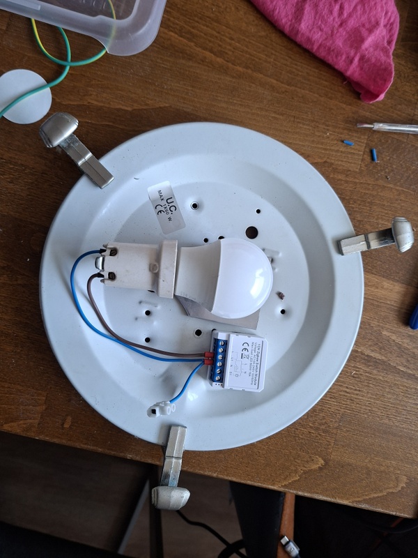

Cyberpope schreef op zaterdag 14 maart 2026 @ 15:28:
Maar wel op een manier dat ze altijd werken, ook als HA eruit ligt. Blij met de hoeveel verschillende zigbee mogelijkheden er zijn. [Afbeelding]
Op deze manier haal je wel telkens de stroom van de zigbee module af (?) als de normale schakelaar uit staat. Hoe heb je dat opgelost?

roelieboelie schreef op zaterdag 14 maart 2026 @ 19:38:
Als je de zigbee module aansluit volgens het schema wat er op gedrukt staat dan kun je je lamp altijd bedienen ook als zigbee eruit ligt. Ik snap de reden dan ook niet om het anders aan te sluiten.

Cyrus The Virus schreef op zaterdag 14 maart 2026 @ 19:05:
Ik heb de auto update nu ook maar uitgezet.
Als je voldoende routers hebt dan is dit niet iets waar je je druk om hoeft te maken. Overdag hebben wij op de eerste verdieping iets van 10 Hue lampjes die spanningsloos zijn en 's nachts hebben we beneden zo'n 31 Hue lampjes die spanningsloos zijn. Daar kan ons Zigbee netwerk (met in totaal 71 routers) prima mee overweg.
Nee, de module wordt gevoed door de fase en nul (bruin en blauw). De zwarte van de schakelaar zit ook op de module. Die activeert de switch die op zijn beurt het relay activeert (1 versie) of via binding een ikea lamp (de andere versie, want die wilde ik ook varieren in lichtsterkte). Maar de module op zich krijgt dus altijd stroom.
Maar besef dat je dat hier niet op ziet, want dit is alleen de bedrading gereed maken om hem aan te sluiten. Maar als je er op klikt zie je schema wat erop staat. En zo is het aangesloten.

Cyberpope schreef op zaterdag 14 maart 2026 @ 21:22:
Dus zwart zit dan op S1? Is er een plaatje van hoe het uiteindelijk is aangesloten?
  • Cyberpope
Cyberpope
When does the hurting stop??
podarcis schreef op maandag 16 maart 2026 @ 08:42:
Ja, zwart zit op de S1. En nee, helaas geen plaatje en is ook bij beide lampen verschillend omdat de ene gaat via de relay en de ander via binding.
Dit is degene via binding, dus heel makkelijk bedraad. Daar kon ik makkelijk bij. Afbeeldingslocatie: https://tweakers.net/i/yvBl3XTtTvYrt9UwMNun7ozw9VU=/x800/filters:strip_icc():strip_exif()/f/image/ed509oHoNhickz0Ng3aLUQWf.jpg?f=fotoalbum_large
En ja, ik had de zwarte iets korter moeten afknippen. :o Had ik op dat moment geen zin in.. :+

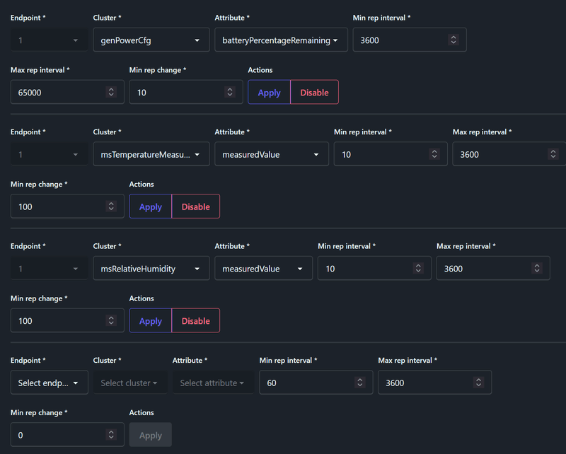

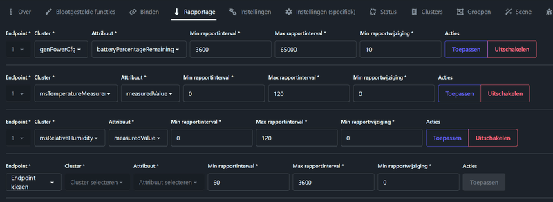

Sinds kort ervaar ik een probleem met mijn TS0601_soil_3 bodemvochtsensor (https://www.zigbee2mqtt.io/devices/TS0601_soil_3.html): de batterijen raken binnen een paar dagen leeg, terwijl dit voorheen maanden goed ging op één setje.
Wat ik observeer:
  • Batterijen (zelfde type als voorheen) zijn binnen enkele dagen leeg
  • Opnieuw pairen in Zigbee2MQTT lost het probleem niet op
  • Na opnieuw pairen met volle batterijen wordt direct een batterijniveau van <60% gerapporteerd
  • Dit gedrag is nieuw; de sensor werkte eerder langdurig zoals verwacht
Wat ik al heb gecontroleerd / geprobeerd:
  • Zelfde batterijtype gebruikt als toen het nog goed werkte
  • Sensor opnieuw gepaird
  • Nieuwe batterijen geplaatst
Ik ben bekend met mogelijke battery drain door te frequente reporting/updates. Wat mij echter opvalt is dat onder het tabblad ‘Reporting’ geen endpoints zichtbaar zijn.
Afbeeldingslocatie: https://tweakers.net/i/HjbbFKlYuRydfJ_I1qpzUKuGvx8=/fit-in/4000x4000/filters:no_upscale():strip_exif()/f/image/8Wo7DVhNu7JRUhj140zFvOzx.png?f=user_large
Vraag:
Is het normaal dat deze sensor geen reporting endpoints toont in Zigbee2MQTT?

JBS schreef op zaterdag 2 mei 2026 @ 08:53:
Een wat uitbreidere post over dit issue:
Wat ik observeer:
Vraag:
Als je zegt: "zelfde batterijtype", bedoel je dan het zelfde merk, zelfde type en zelfde leverancier? Ik heb in het verleden binnen type nogal eens verschillen gemerkt op basis van leverancier ook al lag de datum nog 5 jaar in de toekomst.... Overigens, ook binnen mijn set van 100 Panasonic CR2032 afkomstig van Alie zitten flinke levensduur verschillen binnen hetzelfde Zigbee device. Ik zet tegenwoordig elke datum waarop er een nieuwe batterij ingaat in het commentaar bij de sensor. Verschilt dan tussen 3-14 maanden....

DjoeC schreef op zaterdag 2 mei 2026 @ 10:54:
Dezelfde, want ik gebruik oplaadbare AAA batterijen. Ik realiseer me dat het voltage daarvan lager is dan niet-oplaadbare, maar ook met (deze) oplaadbare AAA batterijen heeft deze sensor hiervoor altijd goed en langdurig gewerkt.

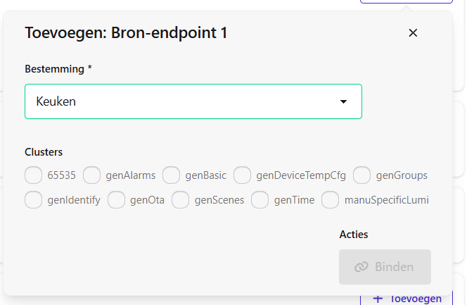

Naar aanleiding van mijn issue met mijn netwerk, is mijn ha momenteel niet bereikbaar.
Daardoor heb ik nu een ander probleem: ik krijg mijn verlichting niet meer aan, aangezien mijn automations niet meer draaien. Ik meen mij echter te herinneren dat Zigbee een directe verbinding kan maken tussen een schakelaar en een lichtpunt, zodat het licht nog steeds werkt als Home Assistant offline is.
Kan iemand mij in de juiste richting duwen hoe ik dit kan instellen?
Het gaat om de volgende toestellen:
  • Schakelaar: Aqara H1 (ingesteld in decoupled mode)
  • Lichtpunt: Aqara T1M
  • Coordinator: SLZB-06
Extra context:
De schakelaar staat momenteel in decoupled mode zodat Home Assistant een automation kan uitvoeren om het licht aan/uit te zetten. Dit werkte prima, maar wel iets trager dan relay mode.
Nu Home Assistant offline is, werkt die automation uiteraard niet meer en kan ik het licht dus helemaal niet bedienen.
Bestaat er een manier om rechtstreeks een binding tussen de H1 en de T1M te maken zodat de schakelaar ook zonder Home Assistant blijft werken?

MakhouT schreef op vrijdag 29 mei 2026 @ 09:06:
Extra context:
Hier is Zigbee binding voor ontwikkeld: https://www.zigbee2mqtt.io/guide/usage/binding.html
Als je remote en lamp van hetzelfde merk zijn, kan het vaak ook met een combinatie zonder tussenkomst van Z2M ingesteld worden.

BiG-GuY schreef op vrijdag 29 mei 2026 @ 09:40:
Aha!
Ik had nu wel enkel z2m geinstalleerd op HA. Maar deze kan ik nu dus niet bereiken, is er een andere manier hoe ik hier aan geraak? (ben nog een noob in deze space :p)
  • RobertMe
  • Laatst online: 05:23
MakhouT schreef op vrijdag 29 mei 2026 @ 10:38:
Aha!
Daarop geeft @BiG-GuY ook al antwoord. Spullen van hetzelfde merk kan het vaak "direct" met een bepaalde knoppen combinatie. Afstandsbediening bij de lamp houden, de juiste knoppen sequence uitvoeren en ze zijn aan elkaar gekoppeld (met direct bindings dus).
Tussen spullen van verschillende merken zal zo'n pairing denk ik vaak niet bestaan en kan alleen de coördinator het regelen met de juiste commando's.
Ergo: lees even de handleiding van ouw Aqara spullen ;)

RobertMe schreef op vrijdag 29 mei 2026 @ 10:52:
Ah ik had het anders begrepen! Nu ik het terug lees was ik gewoon mis! Ik zal eens zoeken!
Ze zijn beiden van Aqara, dus zal wel lukken zeker! Ik kom er nog op terug!

MakhouT schreef op vrijdag 29 mei 2026 @ 10:54:
Let wel op: Hierdoor ontkoppelen apparaat soms van het zigbee netwerk door met elkaar te gaan praten.

  • MakhouT
  • Registratie: September 2016
  • Laatst online: 08-09 11:45
Ik heb er eindelijk naar kunnen kijken, maar hier zit dus totaal niets van in de handleiding. Met wat opzoekwerk en chatgpt gesprekjes is de conclusie dat dit niet gesupport wordt? Maar ik dacht net dat dit de bedoeling was van zigbee? Heb ik nog opties?

Mimiix schreef op vrijdag 29 mei 2026 @ 11:25:
Bedoel je eenmalig, of telkens dat ze met elkaar willen communiceren?

MakhouT schreef op woensdag 3 juni 2026 @ 23:36:
Ze willen alleen met elkaar praten. Niet meer met de rest.

Mimiix schreef op vrijdag 5 juni 2026 @ 17:24:
Bij de ikea knopjes en lampen moest ik eerst met elkaar koppelen, daarna met de coordinator, en dan werkte het beide (andersom verbreekt de verbinding met de coordinator idd). Dacht hetzelfde met een hue bulb maar weet niet helemaal zeker meer.
Groot voordeel van dit is dat als je pctje met met zigbee en HA etc het even niet doet, je nog steeds je lamp kunt bedienen met de knop

Ik maak de verbinding via Z2M, daar kun je ook direct in koppelen. En dan werkt het ook met Z2M uit de lucht is.

Step5 schreef op zondag 14 juni 2026 @ 11:07:
In ZigBee werkt dit principe met groups. Je stopt lampen en switches in een group en dan kennen ze elkaar. Als de coördinator dan down is(het pctje) blijft het werken.
Met hue kan dit ook, maar zodra je touch link gebruikt gaat ie uit je netwerk. Je moet dus de groepen vanuit de coördinator vullen.

Mimiix schreef op zondag 14 juni 2026 @ 15:22:
Nee, een Zigbee Group is enkel bedoeld voor dezelfde type apparaten, bijvoorbeeld meerdere lampen. Zigbee Binding is wat je bedoeld.

BiG-GuY schreef op zondag 14 juni 2026 @ 18:02:
Why not both? :p
De lampen in een group en de switch via direct bindings de group laten bedienen. Zo heb ik al jaren een Hue Dimmer Switch met direct bindings aan een group van Hue spotjes. Puur als backup voor als evt de stick stuk is / Z2M niet werkt / ....
Eeh, niet geheel. Een hue switch heeft een default group, alle lampen die ik daarin stop worden bedienbaar vanaf de switch.
Overigens geloof ik direct dat in mijn geval deconz iets geinige doet.

gebruikt er iemand al een mcp voor zigbee2mqtt om via ai dingen te kunnen doen als:
Bindings, firmwares zoeken of hier advies over geven.
Ik heb namelijk een groot aantal powerplugs:
die ondanks dat ze dezelfde firmware hebben de ene geen power in Watt doorgeeft en de andere wel en ik krijg mijn vinger er maar niet achter :(
Zigbee model: TS011F
_TZ3000_w0qqde0g
Definitie (Zigbee2MQTT) TS011F_plug_1
Smart plug (with power monitoring) Tuya
Gadget-freakz.com. Feedback en tips zijn welkom.

remcoXP schreef op maandag 13 juli 2026 @ 09:39:
_TZ3000_w0qqde0g
De eerste vraag die ik zou stellen is, weet je 100% zeker dat het allemaal _plug_1 types zijn? Er zijn namelijk heel veel varianten van de TS011F, waaronder ook zonder monitoring en waar je moet pollen voor de monitoring.
Het zou ook kunnen dat ze verkeerd herkend worden, dus kijk echt op de hardware zelf of ze echt dezelfde variant zijn.
Daarnaast heb ik bij een aantal van de TS011F opnieuw moeten interviewen tot het werkte.

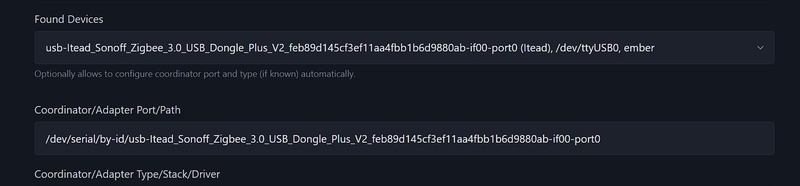

  • JW te R
  • Laatst online: 01-10 19:58
Ik heb Zigbee2MQTT draaien via Docker, en wilde een nieuwe rolluikschakelaar in gebruik nemen, maar die wordt niet herkend. Dit dacht ik te verhelpen met een update van Zigbee2MQTT.
En daar begon de ellende, want mijn coordinator (ethernet, geen USB) wordt niet meer herkend.
Wat ik ook probeer, hij blijft melden 'Cannot discover TCP adapters at this time.'
Ok, duck.ai hielp me uiteindelijk verder. Kennelijk moet je tegenwoordig ook de adapter vermelden in de configuration.yaml; de vorige versie werkte al met alleen een vermelding van 'port'.
YAML:
serial:
  port: tcp://<COORDINATOR_IP>:20108
  adapter: zstack
Nu nog uitvinden hoe je de looptijden van zo'n schakelaar instelt. De handleiding zegt daar niks over ...
En die webinterface op port 8080 is erg mooi geworden!

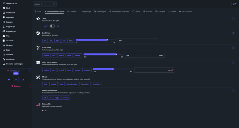

Ik heb een vraagje over de werking van een NodOn SIN-4-2-20 die niets meer door geeft aan Z2M. Tot een week of twee geleden werkte die perfect. Maar nu geeft die blijkbaar geen status meer door als die manueel bediend wordt met een schakelaar.
Deze gebruik ik in een toiletruimte. De verlichting wordt met deze aan en uit gezet. Afhankelijk van de duur van het licht aan, wordt de ventilatie gestart, een vijftal seconden na licht-uit. Maar het is me nu pas opgevallen dat de ventilatie niet meer aangaat. Iedereen zal wel doorhebben hoe dit me is opgevallen ;)
Ik kan de verlichting en de ventilatie in- en uitschakelen via Home Assistant. Ik kan de verlichting aan- en uitschakelen via de schakelaar. Maar als ik dat laatste doe, wordt er geen status doorgegeven naar Z2M.
Ik wou het toestelletje eens resetten en opnieuw toevoegen maar omdat het niet zo gemakkelijk bereikbaar is, toch even hier een vraag stellen. Ik kan er geen exacte tijd opzetten hoe lang het niet meer werkt. Ik vermoed een week of twee. Het kan overeen komen met een update van Z2M.
Er zijn volgens mij maar twee mogelijkheden:
  • Nodon zendt geen bericht meer als er manueel geschakeld wordt. Kan (hopelijk) met een reset opgelost worden
  • Nodon zendt wel bericht maar niet in een formaat dat Z2M wil.
Nu gaat het mij om het laatste punt. Als dit het geval zou zijn, kan ik dit ergens zien in logging van Z2M? Ergens een lijst van "rejected messages" of zoiets?
Los van bovenstaand, moet ik zeggen dat ik de laatste tijd Z2M moet herstarten. Er lijkt iets niet goed te gaan tussen Home Assistant en Z2M. Van HA kan ik dan niets meer bedienen. Ga ik naar Z2M, dan lukt het wel. Even Z2M herstarten en het werkt weer. Raar en beetje vervelend probleem maar ja, als het opgelost is met even te herstarten ...

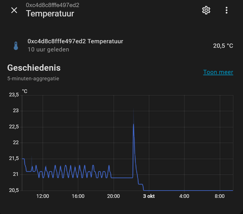

Afbeeldingslocatie: https://tweakers.net/i/k8AzrCyGwpzCP0QI4yyQfTk-XiI=/800x/filters:strip_exif()/f/image/0TBKuzycatg4N1cU0OwfMXAS.png?f=fotoalbum_large
Hmm. Ik zie hier perioden van een dag of 10 zonder verandering in Energie. Nou, onze wasmachine krijgt nooit meer dan een dag of 3-4 pauze (dus moet ik toch eens induiken).
Edit: Die in April lijkt niet te kloppen (maar kan ook een andere oorzaak hebben). Tussendoor heeft de socket een update (of 2) gekregen en lijkt het prima te doen. Die laatste 10 dagen in Juli blijkt daadwerkelijk te kloppen.
[ Voor 22% gewijzigd door HuismAndré op 31-08-2026 16:14 ]
