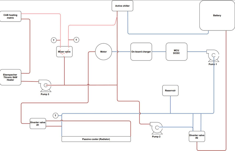

Daarnaast na een tip van Edwin op de FB groep nog een interessant stuk van de Noorse Polestar FB groep. Excuses voor de vertaling, maar mijn Noors is niet zo goed dus ik vertrouw maar even op Facebook ;)
Battery preheating:
I read a post earlier this week ang. preheating battery and that Polestar had confirmed that Polestar 2 did not have hardware installed for this. This information seemed to me very strange.
I turned a little Polestar 2 tonight and have followed all of the cooling water hoses on the car as well as drawn this up schematically. And quite right. Polestar 2 has a cooling water system that is arranged for active heating of the drift battery. Note the following simplifications in form: Double set of engines and inverters have not been drawn in. Only front set of engine and inverter has been drawn in.
The engine compartment in Polestar2 with a description of some components is shown in the first picture.
In picture 2, the schematic production of the cooling water system is shown in the car.
I have drawn ′′ Mixer Valve ′′ into a position where it stands and mixes a certain amount of hot water from the cabin heater into the battery circuit. The reason why this valve isn't an off and off valve like the two ′′ diverting vaults ′′ is that the battery needs to be warmed up gradually. You have to mix to the right temperature on the water into the battery. Usually you mix the water about 30 degrees warmer than the cell temperature.
Furthermore, you can decide with Diverter Valve #1 whether the water from cooling the engine and inverters should be circulated through the radiator, or whether the radiator should be bypassed completely. It is also that Diverter valve #2 enables the interference of the battery water into the engine circuit and also the interference of the engine circuit's cooler into the battery circuit. When we drive with Polestar 2, the latter is taking place: Diverter valve #2 is in position against the right so that Pump 1 sucks water from the battery circuit. This is how the heat developments from engine, inverter and DCDC can help to give some heat to the battery. In these cases, the radiator is probably bypassed in ′′ Diverter valve #1 ′′ to get as much heat as possible for the battery. But thus the most important message in this post:
Polestar 2 HAS hardware in the car to actively heat the battery. The system looks pretty similar to Tesla's if I don't remember all wrong.
So why it is communicated that this is not so... And when can we get this functionality in place?

ach-jee schreef op maandag 4 januari 2021 @ 15:24:
Ah je hebt gelijk. Er zit geen dedicated battery-heater in, maar blijkbaar wordt de batterij van de Model 3 bij de preconditioning alsnog verwarmd. Het lijkt mij functionaliteit die je wel zou mogen verwachten van een automaker uit de Nordics in ieder geval.
Toch stond in een eerste presentatie van de P8 dat de batterij onder de 5 graden verwarmd wordt. Derde regel van onderen op deze slide.

Mga1600 schreef op maandag 4 januari 2021 @ 16:06:
Tx voor het delen! Dat lijkt ook wel te kloppen, maar dit lijkt dus alleen te gebeuren zodra je daadwerkelijk gaat rijden, let maar eens op je verbruik in de eerste KMs. Je zou daarom verwachten dat het ook mogelijk is om dit systeem aan te zetten voor vertrek.
Ook ik dacht dat bij de pre-conditioning de batterij verwarmd zou worden. Daarom ga ik 's ochtends 45 minuten voor vertrek naar buiten om in de kou de verwarming aan te zetten :-(
Wellicht is het verbeelding maar als ik de pre-conditioning niet aanzet en vertrek staat het verbruik, al is het heel kort op 300kWh/100 km. Bij pre-conditioning is mij dit hoge verbruik niet opgevallen.
Het zou mooi zijn als we de waarheid kunnen achterhalen. En dan zou ik ook nog graag weten wat de maximale pre-conditioning tijd is. Of zou de auto dit bepalen afhankelijk van de buiten temperatuur?
  • 4v4t4r
  • Laatst online: 16:15
Recharge365 schreef op maandag 4 januari 2021 @ 16:22:
Het zal heus wel wat helpen als je de auto verwarmd tot 22 graden, maar blijkbaar doet het niet genoeg

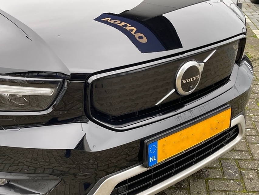

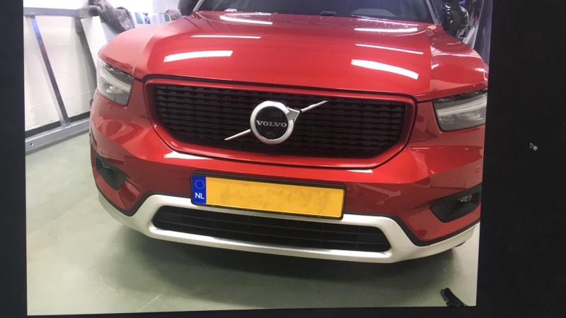

Ik heb foto’s van de r-design print grille. Bij de rode is er eerst een mat-zwarte ondergrond aangebracht met de grille print in glans en bij de zwarte is er eerst een glanzend zwarte ondergrond aangebracht met de grille print in mat. Foto’s heb ik van Hooftman in Alphen gekregen. (Er is ook een foto met alleen de matte ondergrond op de rode).
Afbeeldingslocatie: https://tweakers.net/i/-Wd4cbe_FNiKbkYDMuuAMS4vGOY=/full-fit-in/4920x3264/filters:max_bytes(3145728):no_upscale():strip_icc():fill(white):strip_exif()/f/image/I7NE0ci9W7q4O1t6flPAagJH.jpg?f=user_large
Afbeeldingslocatie: https://tweakers.net/i/2e7G3TKtyGUEUy_T8tn5KyxBFuM=/full-fit-in/4920x3264/filters:max_bytes(3145728):no_upscale():strip_icc():fill(white):strip_exif()/f/image/a1RwdWhguZ4iIR1LpbQDEHak.jpg?f=user_large
Afbeeldingslocatie: https://tweakers.net/i/tpmkr8-CxrVakiJJBQEpFtvPAe0=/800x/filters:strip_icc():strip_exif()/f/image/zfwrgtHT7vs5Kgv9TmxcqKdv.jpg?f=fotoalbum_large
Afbeeldingslocatie: https://tweakers.net/i/dNQRuq67xFpTiSm-LiKWuUX_Wik=/800x/filters:strip_icc():strip_exif()/f/image/0pq1xjtfmr5ssKRubtDtSEZI.jpg?f=fotoalbum_large

Dit ziet er, vooral op die rode, zo op het plaatje bedrieglijk echt uit! Zeker iets om serieus te overwegen omdat het wel wat ‘levendiger’ is dan een zwart gespoten oppervlakte. Wat de levensduur van folie is weet ik niet...iemand?

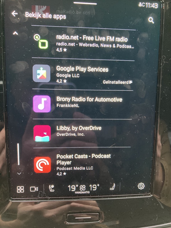

Brony radio Staat inmiddels op beschikbare apps, of was dat al zo? Heb net eindelijk de p8 weer opgehaald na hersteloperatie kabelboom, on board charger en laadpoort. Euvel van lekkend koelvloeistof bij fabricage op aansluiting hoofdoplader is hiermee opgelost.
Overigens twijfelden de monteurs ook over voorverwarmen accupakket bij preheating, de hardware is er, maar software zou het pas gaan verwarmen tijdens rijden was de indruk
Afbeeldingslocatie: https://tweakers.net/i/zYpuS0liiZrVxqGmsmtmRlNwH5s=/x800/filters:strip_icc():strip_exif()/f/image/Cd9jtdT5HCWQijntY1MhqiU7.jpg?f=fotoalbum_large

Lancer schreef op dinsdag 5 januari 2021 @ 10:47:
Dank! Heb je ook prijsopgave hiervan weten los te peuteren?

basp8 schreef op dinsdag 5 januari 2021 @ 11:47:
Dit idee heb ik ook, voorverwarmen doet gewoon weg niks aan je verbruik bij wegrijden. Enige wat dit zal doen is dat het wat minder energie kost om het interieur te verwarmen. Maar het verbruikt zakt pas echt als je 10/15km verder bent en soms nog wel langer maar hangt echt af van de temperatuur buiten. Hopelijk kunnen ze het in de toekomst juist wel mogelijk maken om het voor te verwarmen, dit kan erg veel schelen bij korte afstanden mits hij aan de lader hangt.
Inmiddels antwoord van Polestar Support op mijn vraag omtrent dit onderwerp:
Uw constateringen zijn allemaal juist, het koude weer heeft een enorme invloed op het verbruik van de auto. We doen ons uiterste best om een update te lanceren waarmee pre-heating van de accu in de toekomst mogelijk is. Helaas hebben we hierover nog geen concrete informatie.
Fijn dat het duidelijk is, jammer dat het nu nog niet werkt maar biedt wel perspectief richting de toekomst.

wijmabrouwer23 schreef op dinsdag 5 januari 2021 @ 12:13:
Ah kijk dat is goed nieuws dat het dus wel mogelijk zal zijn in de toekomst. We wachten het maar (weer) af!
Bedankt voor het posten! Qua stijl weet ik het niet. Ik vind de look van de grill gewoon in Thunder voor mijn auto eigenlijk wel heel fraai!

basp8 schreef op dinsdag 5 januari 2021 @ 12:01:
€395 ex. Btw
En idd de rode lijkt bedrieglijk echt.
