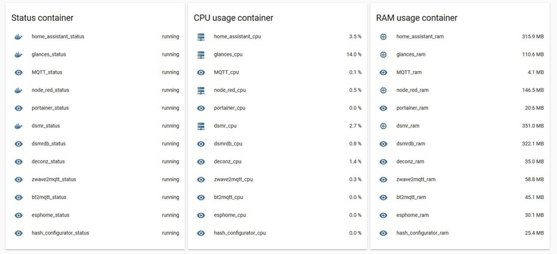

  • Mich
  • Laatst online: 25-10 12:29
Voor wie Glances en Docker heeft.
Ik kwam er laatst per toeval achter dat je via een api call je docker gegevens kan uitlezen.
Ik heb in node-red nu een scriptje gemaakt die automatisch alle docker gegevens uitleest en de status (running / down), cpu verbruik en ram verbruik via MQTT op de bus zet.
Mocht iemand interesse hebben:
[{"id":"de2b18b7.7107a","type":"tab","label":"Glances API","disabled":false,"info":""},{"id":"f8f914d7.3976f8","type":"inject","z":"de2b18b7.7107a","name":"","topic":"","payload":"{\"topic\":\"tele/Mysonoff_TH10/SENSOR\",\"payload\":\"{\\\"Time\\\":\\\"2018-12-21T16:51:09\\\",\\\"AM2301\\\":{\\\"Temperature\\\":69.4,\\\"Humidity\\\":33.9},\\\"TempUnit\\\":\\\"F\\\"}\",\"qos\":0,\"retain\":false,\"_topic\":\"tele/Mysonoff_TH10/SENSOR\",\"_msgid\":\"dae7f7bc.36e5f8\"}","payloadType":"json","repeat":"","crontab":"","once":false,"onceDelay":0.1,"x":730,"y":840,"wires":[[]]},{"id":"ec31ede1.2c0378","type":"http request","z":"de2b18b7.7107a","name":"","method":"GET","ret":"obj","paytoqs":false,"url":"http://192.168.1.188:61208/api/3/docker","tls":"","proxy":"","authType":"","x":410,"y":120,"wires":[["7f8af7bd.03c3a8"]]},{"id":"7c695d4c.323894","type":"mqtt out","z":"de2b18b7.7107a","name":"","topic":"","qos":"","retain":"true","broker":"4a5ede30.119e58","x":950,"y":120,"wires":[]},{"id":"7f8af7bd.03c3a8","type":"function","z":"de2b18b7.7107a","name":"","func":"var i = 0;\nvar message = msg.payload;\nfor (i = 0; i < message.containers.length; i++) {\n  var name = message.containers[i].name;\n  var status = message.containers[i].Status;\n  var cpu = message.containers[i].cpu_percent;\n  var ram = message.containers[i].memory_usage;\n\n  msg.payload = \n  {\n    \"name\": name,  \n    \"status\": status,\n    \"cpu\": cpu.toFixed(1),\n    \"ram\": (ram / 1000000).toFixed(1),\n  }\n  msg.topic = \"glances/\" + name\n  node.send(msg);\n}\n\n","outputs":1,"noerr":0,"x":610,"y":120,"wires":[["60859ef8.90b198"]]},{"id":"60859ef8.90b198","type":"json","z":"de2b18b7.7107a","name":"","property":"payload","action":"str","pretty":true,"x":790,"y":120,"wires":[["7c695d4c.323894"]]},{"id":"428521a1.b192f","type":"inject","z":"de2b18b7.7107a","name":"10 sec","topic":"","payload":"","payloadType":"date","repeat":"10","crontab":"","once":true,"onceDelay":"2.5","x":140,"y":120,"wires":[["ec31ede1.2c0378"]]},{"id":"4a5ede30.119e58","type":"mqtt-broker","z":"","name":"mosquito","broker":"192.168.1.188","port":"1883","clientid":"","usetls":false,"compatmode":true,"keepalive":"60","cleansession":true,"birthTopic":"","birthQos":"0","birthPayload":"","closeTopic":"","closeQos":"0","closePayload":"","willTopic":"","willQos":"0","willPayload":""}]
Je moet alleen even je eigen ip adres van glances invullen in de http-request en je eigen mqtt server invullen.
Afbeeldingslocatie: https://tweakers.net/i/DwQEd488CAFOXhc0-J4cUYHeVv4=/800x/filters:strip_icc()/f/image/tNG4JrWqYOEAYEMPv9W34yGb.jpg?f=fotoalbum_large
Nu alleen nog kijken hoe ik het een beetje fancy kan weergeven >:)

Mich schreef op zaterdag 7 maart 2020 @ 20:17:
Een hele mooie glances/docker NodeRED voorbeeld, ik heb het even getest maar de glances docker heeft jammer genoeg niet alle nuttige informatie :-( De volgende dingen missen/incorrect:
  • Memory gebruik klopt niet met "docker stats", want de cached memory wordt er bij geteld
  • Uptime is ook niet beschikbaar
Ik gebruik https://github.com/Sanderhuisman/docker_monitor

UTMachine schreef op zondag 8 maart 2020 @ 09:32:
Ah, ik wist niet dat er al andere custom components waren, behalve ha-dockermon.
Ik zal eens kijken wat het verschil in RAM dan is. Het enige wat ik echt wilde weten was de status. Het cpu/ram verbruik leek me nog handig om te zien of de containers niet te veel resources snoepen.
Het voordeel van een plugin direct op het systeem is wel dat mijn info afhankelijk is van Node-Red Glances en MQTT. Als die containers falen weet ik nog niets. Ook al is dat met home assistant weer mogelijk met een rest sensor.
