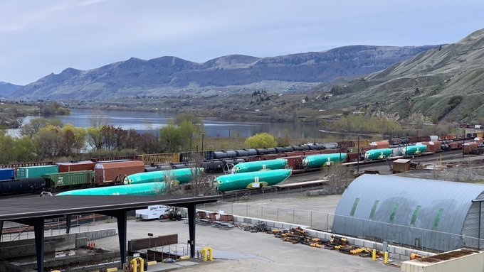

Boeing zou alvast scenario's uitwerken waarbij het de productie van de 737 MAX moet verlagen:
Boeing and suppliers are looking at scenarios including a slowdown in production of the 737 MAX if the plane’s grounding in the wake of two accidents lasts for a number of months, as many analysts expect, a person familiar with the process said.
Boeing assembles 52 737-family aircraft per month and its newest version, the MAX, represents the lion’s share of this production, although Boeing has declined to give exact numbers.

De productieverlaging is zonet bevestigd:
Boeing Co. will cut production of its 737 MAX by almost a fifth over the next several weeks and has appointed a special board committee to examine its handling of new-airplane development.
Boeing said Friday that by mid-April it will trim monthly output of its best-selling jet by 10 to 42. The move overrides Boeing’s previous plan to boost monthly output of its best-selling plane to 57 by this summer.

Als gevolg van de productieverlaging bereiken niet alle 737 onderdelen uit Wichita de assembly plaats in Renton. De trein heeft een stop gemaakt in Wenatchee, waar momenteel een aantal romp-onderdelen opgeslagen worden:
Afbeeldingslocatie: https://tweakers.net/ext/f/RiP4AS5tHiH8NqGlUJBvDJ0J/full.jpg
Looks like Wenatchee has begun collecting #737MAX (?) fuselages. There were 5 sitting here all week; the other two arrived over the weekend.
