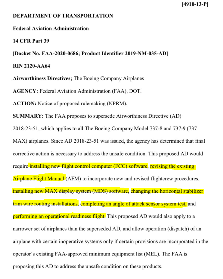

De volgende stappen zijn, nog iets gedetailleerder:
  • JOEB Validation & FSB Review – The FAA’s Flight Standardization Board (FSB) and the Joint Operations Evaluation Board (JOEB) which includes international partners from Canada, Europe, and Brazil will evaluate minimum pilot training requirements. The FSB will issue a draft report for public comment addressing the findings of the FSB and JOEB.
  • Final FSB Report – The FAA will publish a final FSB report after reviewing and addressing public comments.
  • Final Design Documentation and TAB Report – The FAA will review Boeing’s final design documentation in order to evaluate compliance with all FAA regulations. The multi-agency Technical Advisory Board (TAB) will also review the final Boeing submission and issue a final report prior to a final determination of compliance by the FAA.
  • CANIC & AD – The FAA will issue a Continued Airworthiness Notification to the International Community (CANIC) providing notice of pending significant safety actions and will publish an Airworthiness Directive (AD) that addresses the known issues for grounding. The AD will advise operators of required corrective actions before aircraft may re-enter commercial service.
  • FAA Rescinds Grounding Order – This marks the official ungrounding of the aircraft, pending completion by operators of the work specified in the AD, along with any required training.
  • Certificates of Airworthiness – The FAA will retain its authority to issue airworthiness certificates and export certificates for all new 737 MAX airplanes manufactured since the grounding. The FAA will perform in-person, individual reviews of these aircraft.
  • Operator Training Programs – The FAA will review and approve training programs for all part 121 operators.

De FAA heeft nu een AD naar buiten gebracht waarin beschreven staat wat er aan elk 737 MAX toestel veranderd moet worden.
Afbeeldingslocatie: https://tweakers.net/i/66u69voSBydZRBCMqIynr3CJpEM=/full-fit-in/4000x4000/filters:no_upscale():fill(white):strip_exif()/f/image/pkAQHufq43aMzhMJEPcl1Gss.png?f=user_large

Blijft wel minimaal mijns inziens. Geen oplossing voor de missende Angel of attack sensor en ik ben er ook niet uit hoe de flight computers nu wel zouden communiceren (wat dacht ik in een 737 by design niet gebeurt want ontwerp uit het jaar kruik).
Ik stap (of trap) er nog niet in persoonlijk, de NG ook niet meer zo graag - daar was de bedrading toch ook een punt van aandacht?
Er komt weer vaart in!
De trim wire installatie klinkt als de moeilijkste in-service handeling. Verder software updates die misschien langzaam gaan maar makkelijk door te voeren en één AoA check...
Het stukje over de software update van de FCC gemist?

Nee. Maar aan een verouderd ontwerp kan je alle software updaten die er maar in past en toch blijft een te oud ontwerp. Het blijft een jaren 60 kist van de vorige eeuw.

De software update schijnt niet veel te doen: Indien AoA niet klopt tussen de twee sensoren dan gaat MCAS uit. Plus maximaal maar 1x ingrijpen door MCAS. Volgend probleem: wat indien bij een vlucht er iets uitzonderlijks gebeurd waarvoor MCAS meerdere keren of 1 keer zou moeten ingrijpen. Alleen doet MCAS niks omdat AoA sensoren afwijken, of omdat het al 1x eerder had ingegrepen.
Lijkt niet alsof MCAS wordt aangepast om echt gebruik te maken van meerdere sensoren (zover ik op internet lees).
De oplossing lijkt dus te zijn om MCAS te minimaliseren. Maar dan kan je weer andere problemen mee veroorzaken.

De wijzigingen die de FAA hierboven voorgesteld heeft, staan nu open voor commentaar.
The proposed plan outlined Monday by the Federal Aviation Administration (FAA) setting the requirements for the Boeing 737 MAX return to service was formally published in the Federal Register Thursday, starting the clock on a 45-day public comment period that will last through Sept. 21.
That schedule means FAA clearance for the MAX to fly passengers again is unlikely before late October.
The safety agency must assess and respond to the comments, potentially making adjustments to the requirements, before making the plan final with an Airworthiness Directive that mandates changes to the airplane and the crew procedures.
Iedereen die wil heeft 45 dagen tijd om een antwoord in te zenden:
Comments on the FAA proposal can be submitted by:
Online at the Federal eRulemaking Portal at www.regulations.gov.
By fax: 202-493-2251.
By mail: U.S. Department of Transportation, Docket Operations, M-30, West Building Ground Floor, Room W12-140, 1200 New Jersey Avenue S.E., Washington, D.C. 20590.
By hand delivery to the above address.
