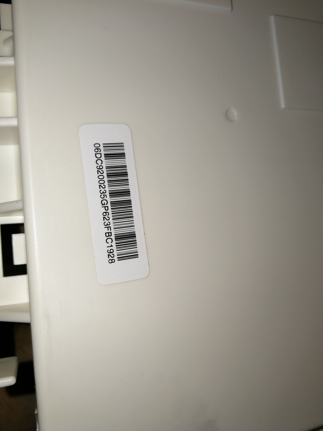

Hey, (non Dutch speaker here, apologies in advance for writing in English) our washing machine was having the same issue after 2 years and 8 months and so after reading about it in this thread and in a few places else, I've just completed the re-soldering of the PCB. I'm only an amateur with the soldering iron so I wanted to ask here: I noticed that with most of the pins, as soon as I touched them for a sec or two, the tin would begin to kinda boil and bubble, as if air was coming out from underneath the board. This means that, after hardening, the tin would almost always end up either with a hole or with a hollow bubble shape or both • . Adding new tin on top didn't help much, it seemed to only sort of mask the issue. Is this normal/expected or are my soldering skills _that_ bad?
• It can be seen in this pic: https://drive.google.com/...f6nmukpRJCLiJg-CNoQR/view
Nonetheless, after completing the job and reassembling the whole thing, the washing machine is running a program right now as I write this, so at least I didn't break anything critical :). It remains to be seen whether the issue is actually fixed or not, too early to tell, but fingers crossed. If not then I guess I'll just have to buy a goddamn new PCB (€130 is the cheapest I've found so far).
Thanks for all the valuable info in this thread!

oscahie schreef op woensdag 22 augustus 2018 @ 15:06:
That mostly happens on the bigger parts like the relays etc. Happened to me also , don't worry just add a little bit of flux if you got that. If not , just leave it as It is now.
Biggest problem is the smaller pins in the middle.

Wil je eens een foto maken van jou print?
  • The_Cube
  • Laatst online: 26-11 13:31
Ja is goed. Is het de bovenste kap verwijderen? Daar zou hij moeten zitten? Ik heb een WF70F5EBP4W
https://www.dropbox.com/s...8%2022%2019%2044.jpg?dl=0
https://www.dropbox.com/s...8%2022%2023%2005.jpg?dl=0

Daar ga ik wel vanuit. Bovenste kap eraf en dan zie je een plastic bakje zitten.

Als er 230 op het stopcontact zit blijft er niet heel veel meer over dan de print.
Er zit nog een ander onderdeel waar de stroom binnen komt maar ik denk dat je een bolle elco hebt. Sommige printen hebben dat.
Heb je een foto van de print?
  • kettu
  • Laatst online: 02-11-2025
Hierbij de foto;
https://www.dropbox.com/p...1124ZAC.jpg?role=personal
Zou de fout misschien ook in het frontpaneel kunnen zitten?
