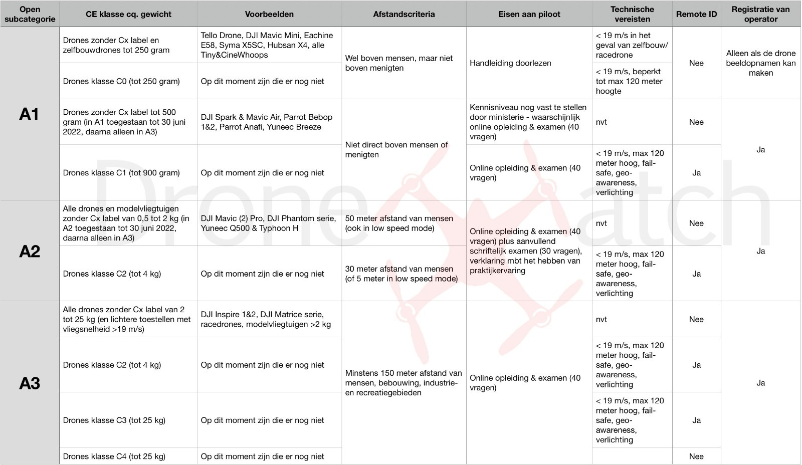

Je mag FPV vliegen, zolang er een observer bij is die de drone in VLOS in de gaten houdt.
Waar staat die regel beschreven dan? Zover ik weet is dit gewoon niet waar. Nogmaals: Regeling modelvliegen rept er met geen woord over. Sterker nog, er staat nadrukkelijk dat je enkel LOS mag vliegen.
En ook de overkoepelende EU regels, die ergens deze zomer worden ingevoerd,zijn hier heel duidelijk in.
Dus nogmaals, heb je regelgeving waarin die regel beschreven word? Ik ben die regel namelijk nergens tegen gekomen...

GM1 UAS.OPEN.060(4) Responsibilities of the remote pilot
ROLE OF THE UA OBSERVER AND FIRST PERSON VIEW
The remote pilot may be assisted by a UA observer helping them to keep the UA away from obstacles.
The UA observer must be situated alongside the remote pilot in order to provide warnings to the
remote pilot by supporting them in maintaining the required separation between the UA and any
obstacle, including other air traffic.
UA observers may also be used when the remote pilot conducts UAS operations in first-person view
(FPV), which is a method used to control the UA with the aid of a visual system connected to the
camera of the UA. In any case, including during FPV operations, the remote pilot is still responsible for
the safety of the flight.
As the UA observer is situated alongside the remote pilot and they must not use aided vision (e.g.
binoculars), their purpose is not to extend the range of the UA beyond the VLOS distance from the
remote pilot. Exceptions are emergency situations, for instance, if the pilot must perform an
emergency landing far from the pilot’s position, and binoculars can assist the pilot in safely performing
such a landing.
https://www.easa.europa.e...%E2%80%94%20Issue%201.pdf
JE HEBT GELIJK IS NOG NIET VAN KRACHT, MAAR STRAKS WANNEER DE EASA-REGELGEVING VAN KRACHT GAAT WEL
@ChojinZ
P.S.Dit komt uit de GM en is in regelgeving terug te vinden... De GM leest wat makkelijker weg.
[ Voor 3% gewijzigd door TechClash op 30-01-2020 14:37 ]

  • ChojinZ
  • Laatst online: 30-09 15:28
ChojinZ
TechClash schreef op donderdag 30 januari 2020 @ 14:32:
such a landing.
@ChojinZ
Netjes gevonden! :)
Maar dat is wel gek: Op zo'n beetje elke site van de EU, word nadrukkelijk aangegeven dat enkel LOS mogelijk is:
"Operations in the open category do not require prior authorizations or pilot license. However, they are limited to operations: in visual line of sight (VLOS), below 120 m altitude and performed with a privately built drone or a drone compliant with the technical requirements defined in the regulation. "
https://dronerules.eu/sl/professional/eu_regulations_updates
https://dronerules.eu/assets/covers/Dronerules-table-2.png
Operatial restrictions: Operate in visual line of sight below 120 m altitude.

Voor zowel particulieren als beroepsmatige piloten van drones, gelden vanaf 1 juli 2020 nieuwe regels. De Inspectie Leefomgeving en Transport (ILT), heeft besloten dat je een wettelijke verplichte vergunning aan moet vragen voor het besturen van drones (vanaf 250 gram). Ook moet de drone en transmitter (radio) worden voorzien van een zichtbare persoonsgebonden PH-registratienummer.
+ Dat je je 'Vliegbewijs' moet halen middels een examen.
+ Dat je je drone moet voorzien van een brandplaatje (aluminium/rvs etc.) met PH-Serienummer.
Ik heb mij info weg bij ILenT en een webshop waar het duidelijk is uitgelegd. (link hier).
Alleen is het zo dat je een aankoopbewijs moet opsturen naar hun. En aangezien we vaak onze drones zelfbouwen, gaat deze vlieger niet op!! Heb nog geen informatie hoe ze dit gaan doen.. :F
Speculatie:
- Denk dat de volgende stap inderdaad hetzelfde kan zijn als de US. Als ze echt willen weten waar iedereen in de lucht uit hangt. Maar voorlopig is dit nog het enige.
- Ze kunnen ons mogelijk verplichten om goedgekeurde hardware te gebruiken, speciaal geselecteerd en gekeurd door ILT

Ik heb even gekeken wat dit zou kunnen betekenen voor de DJI Mavic Mini. Deze staat in de fabriekspapieren op 249g en zou dus niet behoren tot de categorie voor het aanvragen van een PH-Nummer. Maar.... Als je wilt vliegen met (zelfgebouwde) drones tot 250 gram zonder camera (die worden gezien als speelgoed) mogen zonder registratie worden gevlogen. De minimumleeftijd voor een dronevlieger is vastgesteld op 16 jaar, uitgezonderd bestuurders van speelgoeddrones.Dus een DJI Mavic heeft een PH-Nummer nodig in verband met de camera.
Drones tussen 900 gram en 4kg moet je al beschikken over een 'theoriecertificaat'. Dat is waarschijnlijk vergelijkbaar met het huidige NL theoriecertificaat voor minidrones (ROC-Light). En er is meer.... dat geldt alleen voor buiten! :*)
Voor drones (incl. zelfbouw) tussen de 250 gram en 900 gram moet men een online training en kennistoets doorlopen. Dat geldt ook als je met een tiny whoop vliegt. Binnen zijn deze regels niet van toepassing en maak je geen deel uit van het luchtruim. Dus je antwoord, ja ook een whoop heb je een kennistoets nodig en dus waarschijnlijk ook een plaatje ( :+ ), mits je buiten gaat vliegen dan.
Sensei_D schreef op woensdag 12 februari 2020 @ 16:05:
Maar is dit dus wel zo? Mijn whoops zitten onder 250g en kunnen geen beelden opslaan. Ook haal ik zeker geen 80J aan energieoverdracht :P Echter zit er wel een cam op. Ik snap de privacy concerns, maar dit deel vind ik dus onduidelijk. Oh, en als ik er een alu plaatje op moet doen dan ja.... gaat ie de lucht niet meer in :+
Nee, sommige whoops hebben geen ingebouwde DVR, maar bijvoorbeeld i.c.m. een Fatshark dan weer wel (tenzij je de DVR uit zet). Zo kan je zien dat het wel een erg grijs gebied is wat nu wel en niet mag. Maar volgens de nieuwe regels valt de whoop eigenlijk onder de speelgoeddrone zonder plaatje, mits je binnen vliegt.
En dan nog dit:
Het is wel verboden in de open categorie (straks genaamd C0 en C1) (waar zelfbouw dus ook thuis hoort) om FPV te vliegen, met uitzondering van de lokale modelbouw vliegvelden. ILT is bezig met een onderzoek om het daar wel te legaliseren.
Voor wie dit interessant vind kan je hier alle informatie vinden: Dronewatch

Ik kom even terug op het bovenstaande. Na wat grondig uitzoekwerk kom ik tot de volgende conclusie (onder voorbehoud tot na 1 juli 2020).
Voor zelfbouw FPV vliegen gaat gelden:
- Consumenten Informatie doornemen
- Drone online test maken
- Theorie examen doen voor een 'Dronebewijs'.
- Wel persoonsregistratie
- Geen E-ID of GEO met S/N
- Geen drone registratie/keuring via PH-nummer
Voor FPV vliegen gaat vanaf 1 juli 2020 het volgende gelden:
Vliegen met FPV is toegestaan met een spotter die zicht heeft op jou drone.
Vliegen met FPV valt onder categorie 'OPEN A3' - Specifiek
Vliegen is toegestaan vanaf 150 meter buiten bewoonbaar gebied en/of personen.
Goed nieuws tot dusver. 8)

Op deze sheet ook meer info:
Afbeeldingslocatie: https://tweakers.net/ext/f/RGjVnrvWTUwziXqxjBiwn53E/medium.jpg
