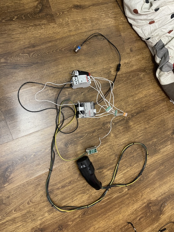

some time ago I aquired this (used)
https://www.evracing.cz/evse-wb-wallbox/
it has 48/63 or 80A option, but I dont know how to change that - I put 100ohm resistor so its should give me full 48A but max which I got is 25A - I cant even set it up to 32A, I emailed manufacturer but no help from them :(
  • Solarsparc
  • Laatst online: 04-11 20:15
I have just checked my SmartEVSE V3, max current can be set from 6 to 80A in 1A steps.
This is the same as advertised on the main website, as well as https://github.com/SmartE...ter/docs/configuration.md (though the minimum on the latter seems to be incorrect, 8A vs. 6A).
If you've found different numbers on "official" SmartEVSE sources, it would be nice to inform them so it can be corrected.
As for your current evse, it's hard to tell without knowing the details. If you want to troubleshoot that (or if you want us to troubleshoot that) it's best to dump all info plus pictures of the current situation here.
A 25A limit does seem to suggest you put the 100k resistor across prog pin 5 instead of pin 4, so you could check that.
If it's not that, there's a good chance the setting was programmed. In that case, the next step would be to get the modbus connection sorted out.
[ Voor 35% gewijzigd door Solarsparc op 07-04-2026 01:12 ]
  • rvdgaag
  • Registratie: December 2015
  • Laatst online: 27-11 12:29
szczur333 schreef op maandag 6 april 2026 @ 22:24:
thanks
I am from Poland, regular home
I have 3x63A main breakers + 3phase 25kWp of solar power
also
I think, suspect, this is an other evse, not the type/make we're talking about here.
Deye 12kW Hybrid, 10,6 kW peak solar, 62,4 kWH Seplos batteries, Panasonic K-series 5kW all-electric heatpump
  • szczur333
  • Registratie: April 2024
  • Laatst online: 09-04 22:32
Yes, probably its coded in firmware but I dont have to clue to how to change it - to advanced for me but I am ditching it for now bcoz today I bought PHOENIX CONTACT 2902802
I bought it fully accidently - just browsing local online marketplace and it was in great price 40euro :O
I dont know if its working but I plugged it to 230V and ethernet and I saw config tool, so probabaly it will work
I connected it super temporary for test purposes only - Tommorow I will check it on 6A at first, later I will check if I can change current in car to 48A (relax, I will not even try to start charging connected like this)
Even 6A will be for minute only

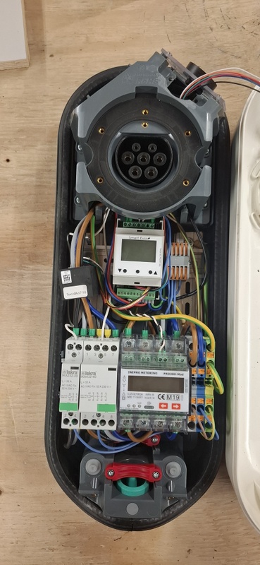

Ook hier een newmotion omgebouwd.
Een business pro 2.1 socket van marktplaats gehaald voor 50 euro en vervolgens de smartEVSE met RFID en button geinstalleerd. Met een setje van 4 din rails van amazon een nieuwe rail bovenin gezet en alles netjes aan kunnen sluiten inclusief de EVSE rechtop. Overal netjes adereindhulzen op gezet en 6mm draad gebruikt waar de flinke power loopt.
Afbeeldingslocatie: https://tweakers.net/i/7Bfreowhisbs4QZYGQuY_skupFE=/x800/filters:strip_icc():strip_exif()/f/image/mUwmmVTrNDtx3NkU3umeiplW.jpg?f=fotoalbum_large
Heb geen sensorbox gekocht want had al een slimmelezer. Die geflashed met een aangepaste code die is geschreven met hulp van dit topic en gemini. Data komt daardoor buiten Home Assistant om rechtstreeks naar de laadpaal. (wel de evse MAINS MET op API zetten, ik had hem op homewizzard staan en bleef maar tegen fouten aanlopen)
Voor de liefhebbers de code voor de slimmelezer:

10us10 schreef op donderdag 9 april 2026 @ 21:46:

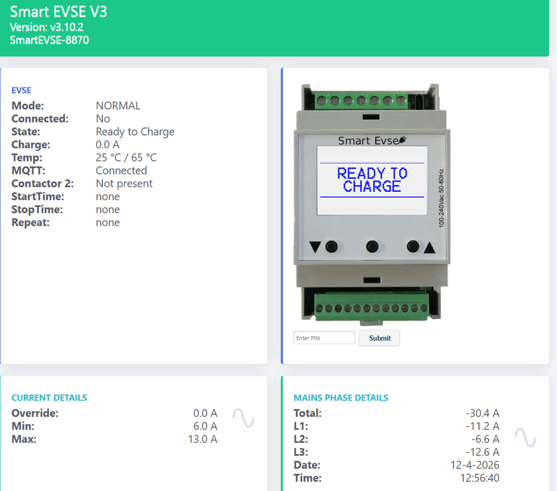

Beste tweakers, graag jullie input:
Om te testen heb ik de smartevse v3 in testopstelling gezet zonder EV. De configuratie draait en heb ook PP via 680 ohm verbonden met PE. Toch krijg ik hem niet in Connected mode.
Wat doe ik verkeerd of ben ik mogelijk vergeten?Afbeeldingslocatie: https://tweakers.net/i/zGFpnGDEyw_gmhWwMnZmLm98LYo=/800x/filters:strip_exif()/f/image/ooeej0EYkW8bPjxfkSaXoZ70.png?f=fotoalbum_large
[ Voor 3% gewijzigd door diamanten op 12-04-2026 13:39 ]

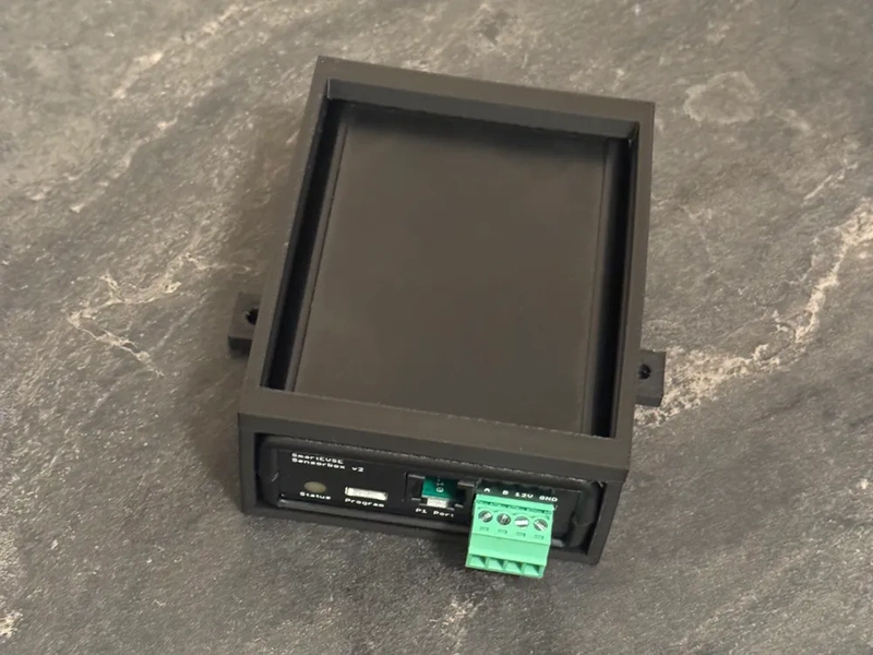

Ik draai al een tijdje de SmartEVSE, maar tot recent maar op 1 fase 10 amp (u mag raden hoe die was aangesloten).
Nu op 11kw en ook een sensorbox. Ik heb een heel laf mountje gemaakt die vrij is om te worden afgedrukt met een 3d printer.
https://makerworld.com/nl...rtevse-sensorbox-v2-mount
Afbeeldingslocatie: https://tweakers.net/i/_qJQHnQLBpfxsc5sq_PNE8u6uVg=/800x/filters:strip_exif()/f/image/gJIVL6IQgLZ9urGbzP9F40Si.webp?f=fotoalbum_large

Ik heb even een snelle vraag (ik kom er via google niet uit en co-pilot geeft willekeurige antwoorden afhankelijk van hoe ik de vraag stel ;) ) over SMARTevse. Als ik een master - slave situatie maak, heb ik dan 2 residual current modulles nodig of alleen 1 gekoppeld aan de master (uiteraard alle fasen en N door de spoel laten lopen). Nu zit er ook een aardlek automaat voor de laadpaal in een verdeelkast in de tuin, zou dat on sich ook al genoeg zijn?
Mijn laadpaal wordt 2 aansluitingen met master-slave, elke aansluiting in princiepe 1 fase. Aaansluitng 1: max 32A, aansluitng 2 max 16A en total curicuit 32A, grid import voor de zekerheid op 23A).
  • bbbrumbrum
mjl schreef op maandag 13 april 2026 @ 16:08:
Type B alamat van niet-Chinees merk zijn nogal kostbaar (>EUR250), dus tenzij je die hebt, is die module zeker wel een goed idee om DC lekstromen te detecteren.
Hoe wil je eea aansluiten?
[ Voor 3% gewijzigd door bbbrumbrum op 13-04-2026 16:39 ]
  • mjl
  • Laatst online: 27-11 10:40
mjl
Ugh
Dit ben ik van plan te bouwe ofwel met 2 rest stroom meters of 1. Bij dat laatste is die dan verbonden met de Master SmartEVSE, ik vraag me dan af of die beide SmartEVSE's dan laat weten om te stoppen als er een lekstroom is. Overigens zit op de aarlek automaat ook een spoel om lekstroom te meten (afgesteld op 30mA).
Afbeeldingslocatie: https://tweakers.net/i/_kk3NiCkYav-MFTgoQZJ8n9D-gU=/800x/filters:strip_exif()/f/image/dngUWp7O6m1Xsy3l1vRXJCNK.png?f=fotoalbum_large
Afbeeldingslocatie: https://tweakers.net/i/SA0dvpTOBlXYq9Vfe0n29kFmWTg=/fit-in/4000x4000/filters:no_upscale():strip_exif()/f/image/oYJwsLzNvehHrraS0O9AMWtJ.png?f=user_large
[ Voor 21% gewijzigd door mjl op 13-04-2026 19:44 ]

Ik ga een nieuwe laadpaal bouwen omdat ik het in de Tesla Wallbox Gen 2 toch allemaal wat te krap vind (en iets met ERE en MID meter). Ik was wat gaan zoeken en zo op de EVBOX terecht gekomen, een H1161-1001. Heb voor een paar tientjes een 1 fase model gekocht op Marktplaats. Zag dat er ook 3F modellen zijn met dubbele dinrail, zeeën van ruimte.
Had misschien even moeten opzoeken hoe gróót dat ding echt is. :X Hij is net aan breder dan de paal waar ik mijn laadpaal op heb gemonteerd haha.
Even nadenken of ik deze aanhoud of toch nog ga zoeken naar wat anders. Maar denk dat ik het antwoord wel weet: accepteren dat het wat uitsteekt. Dit ding geeft mij ook mooi ruimte om een esp32 met voeding naast m'n auto te plaatsen.
Technisch gezien ja, praktisch gezien nee. Je krijgt de draden niet door 1 RCM en de software interface tussen de 2 EVSE's bestaat niet,
Vaillant AroTHERM+ WP - 15kWp O-Z-W PV - 14kWh ESS - Kona EV + Kia ev3 - ESP8266 FTW!
  • mjl
mjl
Ugh
maarten_NL schreef op maandag 13 april 2026 @ 21:14:
De draden passen prima door 1 RCM, er zaten origineel 3p+N doorheen en dat wordt nu dan 2P+2N
Welke software interface bedoel je? SMARTevse heeft een master en maximaal 7 slaves nodes configuratie, ik kan echter niet vinden of die ook de residual current doorgeeft aan de node(s). Een splitter op de kabel van de RCM aansluiten zal niet werken? Dan sluit ik die op beide SmarEVSE’s aan.
Maar op zich heeft de aardlekautomaat ook al een RCM, dat zou toch ook voldoende moeten zijn? Die zit een 8 meter voor de laadpalen.
[ Voor 11% gewijzigd door mjl op 13-04-2026 22:07 ]

mjl schreef op maandag 13 april 2026 @ 22:04:
De ene SmartEVSE gaat de andere niet vertellen dat een voor hem irrelevante RCM getripped is. Dit is wat de code doet:

Wat is je plan hier dan precies? De 1 fase EVBOX ombouwen naar een 3 fase lader met smartEVSE?
Waarom verwacht je dat deze zelfbouw wel voor ERE in aanmerking komt? Zat er al een MID meter in de EVBOX en hergebruik je die? (en is die dan wel 3 fase?).
Ik ben serieus geinteresseerd, niet bedoeld om je idee onderuit te halen
Beekforel schreef op maandag 13 april 2026 @ 20:17:
  • Beekforel
  • Laatst online: 10:03
Beekforel
Is eigenlijk geen vis
Medjai schreef op dinsdag 14 april 2026 @ 10:32:
Van de EVBox gebruik ik alleen de behuizing, alle componenten erin worden nieuw. Inderdaad een MID meter erin. Her en der al wel wat tweakers die hiermee "akkoord" hebben behaald volgens mij.
Obv de regelgeving kom je dan volgens mij in aanmerking, de laadpaal heeft een geïntegreerde MID meter.

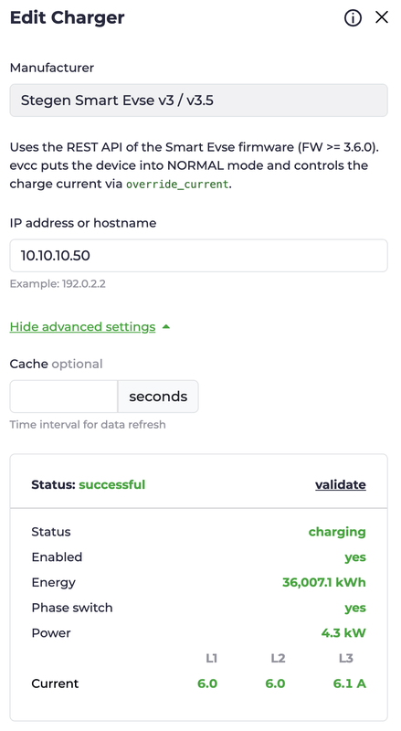

  • jpiscaer
  • Laatst online: 10:23
THM0 schreef op vrijdag 10 april 2026 @ 15:34:
https://github.com/evcc-io/evcc/pull/28782
Er lijkt iets in het vat te zitten… _/-\o_
Weet niet of iemand hier er aan heeft gewerkt maar dit zou zo’n mooie verbetering zijn voor een SmartEVSE setup!
Voor de mensen die EVCC draaien: de nightly van vannacht heeft de Smart EVSE (Go-based) integratie erin zitten, en na wat eerste testen lijkt 'ie volledig te werken!Afbeeldingslocatie: https://tweakers.net/i/wsYcIHftppjhkrIIz2jrMVU557Q=/x800/filters:strip_exif()/f/image/EeZLblV9lwcXEVa2emhRXPkD.png?f=fotoalbum_large
  • THM0
  • Laatst online: 11:24
jpiscaer schreef op woensdag 15 april 2026 @ 14:13:
Voor de mensen die EVCC draaien: de nightly van vannacht heeft de Smart EVSE (Go-based) integratie erin zitten, en na wat eerste testen lijkt 'ie volledig te werken![Afbeelding]
Kudos! Ik heb hem direct geconfigureerd op beide SmartEVSE’s.
  • Soepvlieg
  • Laatst online: 08-11 22:21
Ben erg benieuwd of dat goed blijft gaan met die REST API (ipv via MQTT) met EVCC.
Ik heb EVCC nu soort halfbakken draaien met een 'type: custom' charger om in elk geval al mijn laadessies te loggen, maar heb zo af en toe een compleet gecrashte ip-stack op de smartEVSE en verdenk het overvragen met de REST API, maar heb nog geen tijd gehad om het grondig uit te zoeken.
  • jpiscaer
Soepvlieg schreef op woensdag 15 april 2026 @ 19:49:
Ik ben ook benieuwd. Vooralsnog gaat dat goed. Er is tijdens de diverse PRs discussie over mqtt, ocpp en http geweest, en de ontwikkelaars hebben manieren om (een deel van de gegevens) te cachen. We zullen zien.

  • Mike_S
  • Laatst online: 27-11 07:56
V3.10.3 geïnstalleerd, ben benieuwd…
Display in UI geeft problemen (iOS Safari), zie hieronder, auto koppel ik morgen pas aan…
Afbeeldingslocatie: https://tweakers.net/i/N6dhR5gODAA0rAfTs7uVOP8-BWc=/x800/filters:strip_icc():strip_exif()/f/image/Qazh9UqYEmwINvIbdn5fKKT3.jpg?f=fotoalbum_large

  • dingo35
  • Laatst online: 27-11 20:08
dingo35
@Mike_S Ik kan dat probleem ook op Android reproduceren, Linux/Firefox gaat wel goed.
Ik heb de contributor getagged.
  • Mike_S
Nevermind, ik had je reactie verkeerd gelezen. Thx voor het oppakken.

diamanten schreef op zondag 12 april 2026 @ 13:00:
Wat doe ik verkeerd of ben ik mogelijk vergeten?[Afbeelding]
Voor diegene, die ook eens wil testen zonder EV:
CP via een diode en een weerstand van 880 ohm verbinden met PE en het laden start! Afbeeldingslocatie: https://tweakers.net/i/cRcbjQVE1b71FV5OPbwgH8LON48=/800x/filters:strip_exif()/f/image/N8L3l9KQeGDTiGNBT8mqGOrz.png?f=fotoalbum_large
