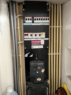

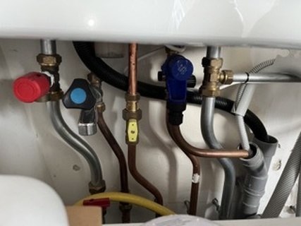

Foto's situatie
Afbeeldingslocatie: https://tweakers.net/i/46s6Y20LAGLFYQiYKJRm8Txj9dE=/full-fit-in/4920x3264/filters:max_bytes(3145728):no_upscale():strip_icc():fill(white):strip_exif()/f/image/5s87l2vmsGCT7TUP26wKPpkN.jpg?f=user_large
Afbeeldingslocatie: https://tweakers.net/i/-NDvSq91uGiiVc6mS7jMIBHOR7g=/full-fit-in/4920x3264/filters:max_bytes(3145728):no_upscale():strip_icc():fill(white):strip_exif()/f/image/umngaL3xv3CHhfxGq4BLQpj1.jpg?f=user_large
Afbeeldingslocatie: https://tweakers.net/i/bqZPB-beykkLRNnenYnv42Qm6fw=/full-fit-in/4920x3264/filters:max_bytes(3145728):no_upscale():strip_icc():fill(white):strip_exif()/f/image/MvJ5oOqckdNmbncfvB4mOHvg.jpg?f=user_large
Afbeeldingslocatie: https://tweakers.net/i/euITXEr_NlhD7Mtxn0Kw2SP3cpI=/full-fit-in/4920x3264/filters:max_bytes(3145728):no_upscale():strip_icc():fill(white):strip_exif()/f/image/AcUpZ11LzNHtTvse7DikrZNR.jpg?f=user_large
Afbeeldingslocatie: https://tweakers.net/i/PO0VTbNob1W4eg4ob8WZ0TqH0kQ=/full-fit-in/4920x3264/filters:max_bytes(3145728):no_upscale():strip_icc():fill(white):strip_exif()/f/image/PoucPKVvhLFsCYxqRWwuWOma.jpg?f=user_large
Afbeeldingslocatie: https://tweakers.net/i/7qYyuYR6ZvxfJ0O7hkgqTv9-KnM=/full-fit-in/4920x3264/filters:max_bytes(3145728):no_upscale():strip_icc():fill(white):strip_exif()/f/image/JRIGv81WXrnVxZZDMBsHYfsS.jpg?f=user_large
Afbeeldingslocatie: https://tweakers.net/i/JA6h17Ek6O6pkFTpHCD2Kirm_XE=/full-fit-in/4920x3264/filters:max_bytes(3145728):no_upscale():strip_icc():fill(white):strip_exif()/f/image/mwhcUTOrrWKVqns0X1NmHSAK.jpg?f=user_large
Afbeeldingslocatie: https://tweakers.net/i/n9QfpbzvjhD3wcYEwwyaXqxz98s=/full-fit-in/4920x3264/filters:max_bytes(3145728):no_upscale():strip_icc():fill(white):strip_exif()/f/image/FShgWjB0Qsgo9iaBjftSaZvx.jpg?f=user_large
Afbeeldingslocatie: https://tweakers.net/i/rUGILOnTwB4JkFctHT9mwNqLeCM=/full-fit-in/4920x3264/filters:max_bytes(3145728):no_upscale():strip_icc():fill(white):strip_exif()/f/image/KUDOM0po3g9TVtQ3Ni13Ifdt.jpg?f=user_large

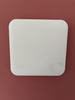

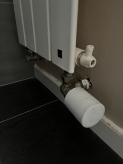

ik snap niet helemaal waarom men zo op hybride aan het hameren is.
er is totaal geen reden te zien waarom die gasketel moet blijven. simpele 5kW warmtepomp met een tank en die gasketel kan bij het grofvuil.
die vloerverderler moet je inderdaad wel vervangen maar door eentje zonder pomp en al die prul moet van de leidingen af wat de flow begrenst.
in ergste geval moet je links en rechts een radiatortje upgraden naar iets van een T33 en een fan eronder of zo maar dat is snel gedaan met beetje struinen op marktplaats.
weg met die gasaansluiting net als dat hele tado verhaal. met een warmtepomp werkt dat niet meer. zoneregeling is nutteloos is zo'n woning.

De goedkoopste manier om gas te besparen is denk ik om inderdaad een monoblock in de tuin te zetten en deze direct beneden vlakbij de vloerverwarming in te koppelen. De verdeler vervangen is dan wel fijn, maar dan een pomploze (dus niet de Robot Hybride). Werkt zuiniger en is nog goedkoper ook.
De radiatoren hobbelen dan mee op de 35 graden aanvoer, met wat fans komt daar meestal nog wel voldoende warmte uit (bedenk: je laat het niet afkoelen).
De ketel koppel je af van de verwarming (afdoppen of afsluiter ertussen) maar laat je hangen voor SWW, want als je wegens koken toch niet gasloos gaat, dan heeft een boilertank neerzetten een heel slechte gedoe/opbrengst verhouding.
Tado... beter van niet.

TD-91 schreef op zondag 12 november 2023 @ 21:38:
Wat valt er wel te regelen? op dit moment stoken we bijv naast vloerverwarming (continu 19 tot 20 graden (dag/nacht) vaak alleen op zolder (werkkamer) en zijn de overige radiatoren continu uit. Ofwel, hoe zorg ik op gezette tijden voor een warme kamer zonder ze continu warm te houden. Of als alle kamers continue een beetje warm worden gehouden, hoe zorg ik dan op gezette tijden voor aanvulling tot gewenste temperatuur?
je verwarmt de hele toko constant. je refentieruimte (de woonkamer) zet de WP aan en uit of beter gezet: die grijpt in als het te warm dreigt te worden. de WP regelt de temperatuur van het water aan de hand van de buitentemperatuur dus die loopt met dit weer eignelijk non stop. die is alleen maar bezig met de warmte die je verliest 1:1 aan te vullen.
je zal merken dat je BG vloer het meeste werk doet dan en je temperatuur in huis ineens veel stabieler is.

Nogmaals dank, ik wordt al een stuk enthousiaster van deze aanpak. Ik kom nu op het volgende en heb nog wat vragen.
Stappen
  1. Monoblock in de tuin, zou in mijn geval zijkant woning kunnen.
  2. M.b.v. terrendis slang proberen via meterkast in ruimte te komen met verdeler
  3. Verdeler vervangen voor pomploze verdeler aansluiten op monoblock
  4. De leidingen die vanaf CV/radiatoren komen koppelen zodat restwarmte vloerverwarming naar de radiatoren gaat.
  5. CV ketel afkoppelen van radiatoren/vloerverwarming
  6. TADO vervangen door 1 thermostaat in woonkamer gekoppeld aan warmtepomp.[/i]
  7. Evt. T-22 radiatoren vervangen voor T-33 met fan.
  8. Voor SWW kunnen we vervolgens vooruit met CV-ketel, maar dan wordt het rekensommetje om volledig van gas af te gaan in ieder geval interessanter > dus warmtepompboiler aansluiten op warmwater leidingen > hier moet ik nog even wel even de draaglast van de vloer voor checken denk ik
  9. CV ketel volledig verwijderen
  10. Gasfornuis vervangen voor elektrische kookplaat
  11. Gas aansluiting opzeggen
ergens tussendoor wellicht nog wat stalen kozijnen met koudebrug laten vervangen, helaas zijn de alternatieven niet zo mooi ;) Vervolgens staat een vorm van mechanische ventilatie ook nog op mijn wensenlijstje.
