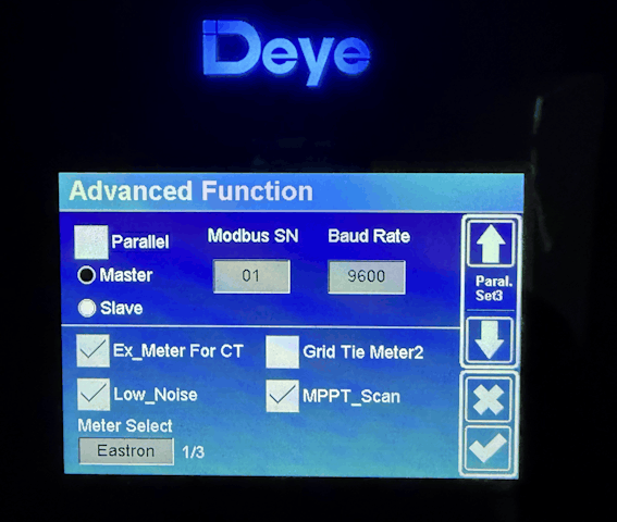

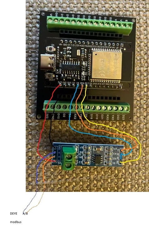

Heeft iemand ervaring met het emuleren van een SDM630 / SDM72 modbus meter als externe meter voor de Deye?
Dit is het relevante snippet uit mijn esphome .yaml file:
24
25
26
27
28
29
30
31
32
33
34
35
36
37
38
39
40
41
42
43
uart:
  - id: mod_bus
    rx_pin: GPIO3
    tx_pin: GPIO1
    baud_rate: 9600
    stop_bits: 1
  - id: sdm72_uart
    rx_pin: GPIO16
    tx_pin: GPIO17
    baud_rate: 9600
    stop_bits: 1
    debug:
      direction: BOTH
      dummy_receiver: true
      after:
        delimiter: "\n"
      sequence:
        - lambda: |-
            UARTDebug::log_hex(direction, bytes, 0x20);
modbus:
  - id: sdm72_modbus
    uart_id: sdm72_uart
    role: server
#    flow_control_pin: 4
    disable_crc: true
modbus_controller:
  - modbus_id: sdm72_modbus
    address: 0x1
    server_registers:
      - address: 0x000c
        value_type: FP32
        read_lambda: !lambda 'return id(sdm72_l1_power).state;'
      - address: 0x000e
        value_type: FP32
        read_lambda: !lambda 'return id(sdm72_l2_power).state;'
      - address: 0x0010
        value_type: FP32
        read_lambda: !lambda 'return id(sdm72_l3_power).state;'
      - address: 0x0030
        value_type: FP32
        read_lambda: !lambda 'return id(sdm72_total_power).state;'
.... en dit is het resultaat:
24
25
26
27
28
29
[16:12:26][D][sensor:094]: 'SDM72 Total power': Sending state -37.60000  with 1 decimals of accuracy
[16:12:26][D][sensor:094]: 'deye-WiFi Signal': Sending state -54.00000 dBm with 0 decimals of accuracy
[16:12:27][D][sensor:094]: 'SDM72 L2 power': Sending state -12.50000  with 1 decimals of accuracy
[16:12:27][D][sensor:094]: 'SDM72 L3 power': Sending state -12.20000  with 1 decimals of accuracy
[16:12:27][D][uart_debug:114]: <<< 01 04 00 0C 00 06 B0 0B 01 04 00 0C 00 06 B0 0B 01 04 00 0C 00 06 B0 0B 01 04 00 0C 00 06 B0 0B 01 04 00 48 00 04 71 DF 01 04 00 0C 00 06 B0 0B 01 04 00 0C 00 06 B0 0B
[16:12:27][D][modbus_controller:113]: Received read holding/input registers for device 0x1. FC: 0x4. Start address: 0xC. Number of registers: 0x6.
[16:12:27][D][modbus_controller:124]: Matched register. Address: 0x0C. Value type: 12. Register count: 2. Value: -12.8.
[16:12:28][D][modbus_controller:124]: Matched register. Address: 0x0E. Value type: 12. Register count: 2. Value: -12.5.
[16:12:28][D][modbus_controller:124]: Matched register. Address: 0x10. Value type: 12. Register count: 2. Value: -12.2.
[16:12:28][D][uart_debug:114]: <<< 01 04 00 0C 00 06 B0 0B
[16:12:28][D][uart_debug:114]: >>> 01 04 0C C1 4C CC CD C1 48 00 00 C1 43 33 33 51 67
[16:12:28][D][modbus_controller:113]: Received read holding/input registers for device 0x1. FC: 0x4. Start address: 0xC. Number of registers: 0x6.
[16:12:28][D][modbus_controller:124]: Matched register. Address: 0x0C. Value type: 12. Register count: 2. Value: -12.8.
[16:12:29][D][uart_debug:114]: <<< 01 04 00 0C 00 06 B0 0B
[16:12:29][D][uart_debug:114]: >>> 01 04 0C C1 4C CC CD C1 48 00 00 C1 43 33 33 51 67
[16:12:29][D][modbus:124]: Modbus CRC Check failed, but ignored! 3838!=04
[16:12:29][W][modbus:156]: Got Modbus frame from unknown address 0xAB!
[16:12:29][D][modbus:124]: Modbus CRC Check failed, but ignored! 3EF0!=9BDC
[16:12:29][W][modbus:156]: Got Modbus frame from unknown address 0xC8!
[16:12:29][D][modbus_controller:113]: Received read holding/input registers for device 0x1. FC: 0x4. Start address: 0xC. Number of registers: 0x6.
[16:12:29][D][modbus_controller:124]: Matched register. Address: 0x0C. Value type: 12. Register count: 2. Value: -12.8.
[16:12:29][D][modbus_controller:124]: Matched register. Address: 0x0E. Value type: 12. Register count: 2. Value: -12.5.
[16:12:29][D][modbus_controller:124]: Matched register. Address: 0x10. Value type: 12. Register count: 2. Value: -12.2.
[16:12:29][D][uart_debug:114]: <<< AB 10 01 1E 00 02 04 00 C8 00 00 DC 9B 01 04 00 0C 00 06 B0 0B
[16:12:30][D][uart_debug:114]: >>> 01 04 0C C1 4C CC CD C1 48 00 00 C1 43 33 33 51 67
[16:12:30][D][modbus_controller:113]: Received read holding/input registers for device 0x1. FC: 0x4. Start address: 0xC. Number of registers: 0x6.
Het lijkt erop alsof de Deye de ESP32 veel sneller afvraagt dan dat de ESP32 kan handlen, maar dat komt me erg vreemd over; zo zwaar is de modbus library toch niet?
Iemand een idee?

dingo35 schreef op maandag 30 maart 2026 @ 16:38:
24
25

43
uart:
  - id: mod_bus
    rx_pin: GPIO3
    tx_pin: GPIO1
    baud_rate: 9600
    stop_bits: 1
  - id: sdm72_uart
    rx_pin: GPIO16
    tx_pin: GPIO17
    baud_rate: 9600
    stop_bits: 1
    debug:
      direction: BOTH
      after:
        delimiter: "\n"
      sequence:
        - lambda: |-
modbus:
  - id: sdm72_modbus
    uart_id: sdm72_uart
    role: server
    disable_crc: true
modbus_controller:
    address: 0x1
    server_registers:
      - address: 0x000c
        value_type: FP32
      - address: 0x000e
        value_type: FP32
      - address: 0x0010
        value_type: FP32
      - address: 0x0030
        value_type: FP32
24
25
26
27
28
29
Iemand een idee?
Ben zeer geïnteresseerd ook ivm mijn eigen Deye - SmartEVSE setup.
De ESP32 zou het qua snelheid prima aan moeten kunnen het is namelijk maar 9600 BAUD dus dat is maar 1,2kB/s.

De ESP32 libraries voor modbus stikken van de bugs en belasten de ESP mega veel,van meer dan 1x per 3 seconden data opvragen gaat de ESP over zijn nek. De Deye vraagt meerdere keren per seconde data op.
Emuleren lijkt me een slecht idee, als je kabellengte issues hebt koop dan gewoon een echt sdm630 sluit hier een Waveshare ethernet/modbus unit aan als server en zet je Deye modbus poort op een zelfde soort Waveshare unit die ook in je netwerk hangt als slaaf. Werk als een speer.

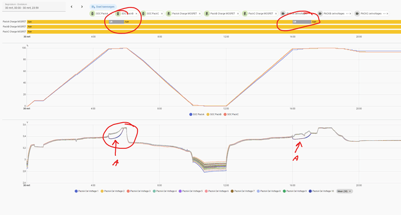

Iets anders, voor mensen met een JK bms;
Afbeeldingslocatie: https://tweakers.net/i/NLoEOcZes79TPx0D5M8Jxbk0JuI=/800x/filters:strip_exif()/f/image/kqokcukpqluYTGMwjvvFAujH.png?f=fotoalbum_large
Ik zie regelmatig dat packA in de par-limiter schiet. De charge mosfet gaat dan ook uit, al blijft ie wel met max 10A laden (wellicht via pack B en C). De SOC is nagelijk gelijk, als ook de cellvoltages. Cellvoltages zakken dan ook stuk in weer tov de andere packs. Ik wil alles op 100% en 3.55v uiteindelijk. Waarom gaat deze packA vaak bij, bijna vol, in de par-limiter? :?
continues current in de JK bms aangepast van 90A naar 120A, not is er geen par-limiter trigger meer, en mosfet blijft aan. Maar; ik zie nu dat de current van PackA steeds afwijkt, van pack B en C.
Alles is vrijwel gelijk, ook cellvoltages zijn ok lijtk het, en over 3 packs zowat gelijk.
Afbeeldingslocatie: https://tweakers.net/i/HrMQ1y7F1WX7n48e4NWIobOPPGY=/800x/filters:strip_icc():strip_exif()/f/image/9DgJNDcw40PhvVeY64EbIWeq.jpg?f=fotoalbum_large
Iemand een id waarom PackA afwijkende current laat zien? :|

  • NiCloX
  • Laatst online: 27-09 20:40
Hoi Tweakers wat doe ik fout.
ik probeer verbinding te krijgen met mijn Deye via een ESP32 zoals zovelen via ESPhome,
ik heb de volgende aansluiting gemaakt en nu echt alles geprobeerd maar krijg geen contact.
ik heb het volgende in esphome staan let wel niet alles is gekopieerd

Afbeeldingslocatie: https://tweakers.net/i/79ne0wj1iwLuPPcWurdS7jqf9EM=/x800/filters:strip_icc():strip_exif()/f/image/wQAWhYKRBu5qC4RaikkPxxtr.jpg?f=fotoalbum_large
  • Lasoul
  • Laatst online: 22-10 15:34
NiCloX schreef op donderdag 2 april 2026 @ 10:41:
esphome:

In plaats van zelf te bouwen kun je ook eenvoudig de "Waveshare RS485 TO POE ETH (B)" gebruiken. In Home Assistant kun je dan via de SunSynk/Deye addon eenvoudig je Deye besturen. Hoef je niet zelf te knutselen. Deze setup bevalt mij erg goed maar er zijn meerdere wegen naar rome :)
Waveshare: https://www.waveshare.com...cskxnoQB2e3mQ8XRov8sN5A6P
Add-on: https://kellerza.github.io/sunsynk/

Of dit, werkt makkelijk en prima:
https://www.tinytronics.n...m5stack-atomic-rs485-base
https://www.tinytronics.n...e-esp32-development-board
Je prikt ze op elkaar, usb c erin en gaan..

@NiCloX
Ik gebruik
framework:
type: arduino
en
modbus_controller:
address: 0xN (N=nummer, ook Deye van default 0 op modbus adres gezet in advanced menu ?)

esp32:
board: esp32dev
framework:
type: esp-idf
# Enable logging
logger:
# Enable Home Assistant API
api:
encryption:
key: "klopt "
ota:
- platform: esphome
password: "5rgrgrgrgrhrhrhrhrh"
wifi:
ssid: !secret wifi_ssid
password: !secret wifi_password
# Enable fallback hotspot (captive portal) in case wifi connection fails
ap:
ssid: "Deye Fallback Hotspot"
password: "WvvXAKHKh3gg"
captive_portal:
uart:
tx_pin: 17
rx_pin: 16
baud_rate: 9600
stop_bits: 1
modbus:
uart_id: mod_bus
flow_control_pin: 4
modbus_controller:
- id: ${modbus_controller_id}
address: 1
modbus_id: modbus1
setup_priority: -10
update_interval: 30s
command_throttle: 200ms
Je settings lijken OK, verzeker je ervan dat je Modbus boardje een TTL versie is, de meeste zijn dat niet namelijk en dan gaat het nooit werken.

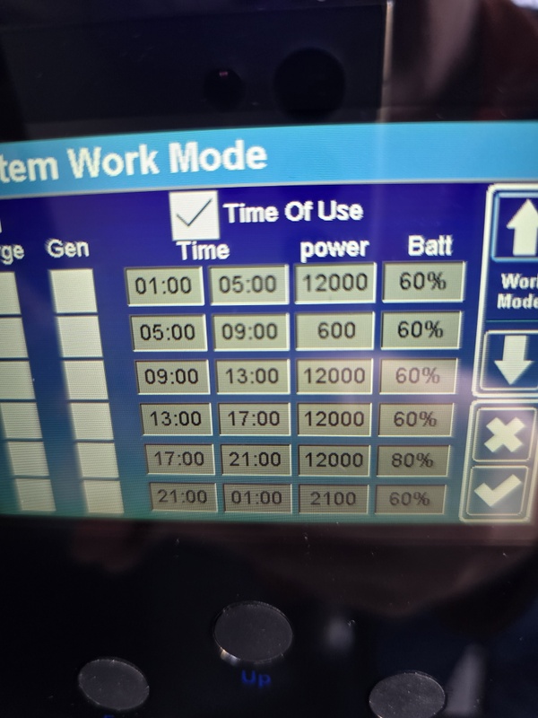

Ik probeer mijn Deye voor nul-op-de-meter te configureren, dus overschot naar de accu en tekort uit de accu.
Bij zonoverschot en laag verbruik werkt het prima, maar zodra er een paar kW verbruikt wordt gaat hij dat uit het net trekken i.p.v. uit de accu. De maximale DC stroom is dan zo'n 10-14A.
Alles is aangesloten op de Grid aansluiting, waarop ook mijn net-tied zonnepanelen omvormer zitten. De CT waardes worden aangeleverd door een gesimuleerde SDM630, deze waardes worden correct op het display aangegeven.
Dit is het resultaat:
Afbeeldingslocatie: https://tweakers.net/i/oGDZ4QC3qDwgbT41rhbVKjilUzU=/x800/filters:strip_icc():strip_exif()/f/image/sJkwwBXnhmgmOs4sBHrHeraO.jpg?f=fotoalbum_large
Dit zijn mijn settings:
Afbeeldingslocatie: https://tweakers.net/i/ofbNOcRmslHnDirthDvWW9M6Nr8=/x800/filters:strip_icc():strip_exif()/f/image/e3lJwCm1YmE4he64qP7970Er.jpg?f=fotoalbum_large
Afbeeldingslocatie: https://tweakers.net/i/dVDZF0L7sBCpRGKOQo4uf2GhnUg=/x800/filters:strip_icc():strip_exif()/f/image/vyoRchheSYSbI4rrDDEpjNfX.jpg?f=fotoalbum_large
Ik kreeg het gedrag alleen voor elkaar met de volgend GEN port settings:
Afbeeldingslocatie: https://tweakers.net/i/DFtPVmauHaBAn5Pu8k4YzYTyAw8=/x800/filters:strip_icc():strip_exif()/f/image/8yxFob290GKWhjsAanvTeGDW.jpg?f=fotoalbum_large
Ik MOET AC coupled on grid side aanzetten (niet onlogisch), dan selecteer ik automatisch GENERATOR INPUT (vreemd dat ik niet de andere settings kan gebruiken), en ik moet ook GEN connect to GRID input aanzetten.
Vreemd is dat als ik deze twee settings aanzet, AUTOMATISCH TimeOfUse aangezet wordt; als je die weer uitzet, en je gaat het menu uit en weer in, dan staat hij weer aan. Bug of feature?
Afbeeldingslocatie: https://tweakers.net/i/o6eYbK_obzoo4-DsQpNWJq-QHw8=/x800/filters:strip_icc():strip_exif()/f/image/RnZwPmOwjUsRsPwr9W2ChsH1.jpg?f=fotoalbum_large
Als ik ToU bewust aanzet en bijvoorbeeld Sell First doe, gaat hij rustig met 100A ontladen, de SoC is 100% dus aan batterij/BMS ligt het niet.
Firmware versie 2107-1172-1809 HMI 1001-C054 .
Heb ik een van de settings verkeerd staan om "gewoon" vanuit de batterij te ontladen?
Heeft iemand een verklaring dat de ToU tabel automatisch aangezet wordt? Bug of feature?
DANK!

Nee hij ziet de huisaansluiting; dat is dus verbruik van het huis minus zonnepaneelopwek. Dát wil je op 0 hebben...

@dingo35 Je max sell power staat op 50Watt, schroef deze eens op naar 8000 ofzo
Deye 12kW Hybrid, 10,6 kW peak solar, 62,4 kWH Seplos batteries, Panasonic K-series 5kW all-electric heatpump
  • dingo35
  • Laatst online: 23-10 13:29
Ja die max sell power en die zero-export power hebben dus geen invloed (wat ook logisch is want ik sell niks, ik wil gewoon 0 op de meter).
MAAR de oplossing blijkt in die rare ToU tabel te zitten: daar moet ik dus GEN aankruisen . Ik begrijp nog steeds niet waarom ik die tabel moet gebruiken, en ben er ook nog niet achter wat hij in deze configuratie met het SoC percentage doet. Het streven naar het SoC % zoals in de handleiding beschreven is igv nul-op-de-meter redelijk zinloos lijkt me.

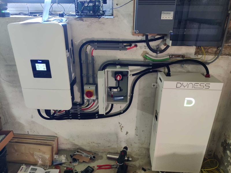

Hallo allen,
ik ben sinds vandaag ook lid van de Deye club. Fijn dat er al zoveel info in dit topic staat!
Omvormer: SUN-6K-SG05LP3-EU-SM2
Firmware: 2107-1170-1809, 1001-C052
Batterij: Dyness Powerbrick pro 14.3 kWh
PV: 2x 8x 455 Wp
Ik ben enkel nog zoekende naar de correcte 'grid mode' voor Belgie. EN50549-1 en VDE lijken mij niet (helemaal) correct als ik naar de settings kijk. Hoe hebben jullie dit opgelost? Ik heb Deye reeds gevraagd of ik een andere firmware nodig heb
Afbeeldingslocatie: https://tweakers.net/i/sZf0EAz2GuVWj1Mk9aXu4yOAjxU=/800x/filters:strip_icc():strip_exif()/f/image/ucK0iBal77ib9GAum0fTKOUG.jpg?f=fotoalbum_large

Een Low-Noise optie in de Deye? Waar zit die dan?

Ik heb low-noise onlangs eens aangezet... horendol werd ik 8)7
Snel weer uit :D Ik heb amper last van de hoge coilwhine. Maar met low-noise aan ervoer ik een zeer indringende toon. Zal vast bij iedereen net anders vallen.

Als je PV hebt anders dan op MPPT van Deye dien je MI te activeren om Deye te laten weten dat er AC-PV aanwezig is.
Bij nieuwere firmware moet je ook nog aangeven waar deze zich bevindt als die niet op de AUX-poort (MI-ingang) aangesloten is. (oudere firmware kijkt alleen naar gridzijde en niet naar load mocht die tussen de gebruikers zitten)
Je eerste pic, accu levert maximaal, jehebt veel tijdsblokken op 12kW staan uitgezonderd het actieve tijdsblok op dat moment op 600W en een ander op 2100W. ( Daarnaast time of use indien geactiveerd is alleen als grid is vrijgeschakelt)

Dacht bij advanced?
Er komt wel een herstart van. Be aware.
  • Get!em
Get!em
Oh die ja!
rvdgaag schreef op donderdag 9 april 2026 @ 08:25:
Humm,waar vind ik die instelling in de Deye ?? Mijn vrouw wordt gek van die whine.
Get!em in "Ervaringen met onbalanshandel door Balans Batterij & Energie"
De deye (en dus mogelijk je huis) gaat wel door het donker direct na het aanvinken en bevestigen van de optie.

Thx @Domba die settings waren me ontgaan, moeten tijdens mijn gerommel met Home Assistant sliders verschoven zijn....
"Daarnaast time of use indien geactiveerd is alleen als grid is vrijgeschakelt"?
Wat bedoel je met vrijgeschakeld? Dat de hoofdschakelaar uit staat (off grid), of iets anders?

Ik bedoel dat de grid relais zijn ingeschakeld.
Er kunnen diverse reden en momenten zijn waarom Deye tijdelijk in off-grid mode gaat, opzettelijk of niet zoals de netkwaliteit buiten die van de instellingen gaat.
Op die momenten draai je op de base settings die time of use overschrijft als die actief is.
Net als bij SOC sturing als er happeringen in communicatie met master-BMS zijn, dat die tijdelijk terugvalt op voltage sturing en moeten de settings voor voltage niet zo afwijkend zijn.
(Bij SOC zie je nog weleens dat SOC-sturing wordt gebruikt met pylontech modules of andere 15S accumodules en de settings voor voltage sturing nog gewoon op default voor 16S accumodules is blijven staan)

Heeft er iemand ervaring met het gebruiken van de 5V die je via de RS485 meter ethernet aansluiting kunt aftappen als je de dipswitch erboven aan zet?
Ik wil 2 ESP32's met in totaal 4 MAX485 boardjes er mee voeden...

Ja 1 boardje gaat goed, 2 niet is mijn ervaring. Ik heb hiervoor een externe din-rail voeding gekocht en aangesloten.

feedback van Deye techsupport gekregen, de 3 Fase 03 EU serie heeft geen low noise mode, alleen de 1 Fase modellen.

Ik heb een 12k 3 fase gelijk aan alle Balans Energie klanten.
  • Lasoul
Ter info: SUN-12K-SG05LP3-EU-SM2 (3 fase) heeft wel de low-noise optie.
  • Get!em
Get!em
Oh die ja!
Ventilatoren maken nog steeds veel herrie met die optie aan, maar de piep van 15kHz 70dB verplaatst naar 20-22kHz a 73dB.
Geluid wordt dus harder, maar is minder hoorbaar voor mensen.

Ik heb exact die versie, maar niet die optie. Blijkbaar nu al verschillende firmware versies, ik zit op 1172, jij?

Ik kan mij herinneren dat ik deze optie ook eerst niet had. Een paar maanden geleden is er bij mij een firmware upgrade doorgevoerd ivm een ander probleem en sindsdien heb ik deze optie. Ik zit op versie 1175.

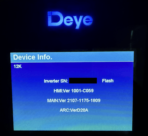

Afbeeldingslocatie: https://tweakers.net/i/5WAH2h1G90wEMWJeQobNVSt6Bi8=/fit-in/4000x4000/filters:no_upscale():strip_exif()/f/image/lrQWe22kWL2nDkxIM1d1CFvu.png?f=user_large
[ Voor 30% gewijzigd door Lasoul op 10-04-2026 12:13 ]
  • dingo35
Wat was je andere probleem, als ik vragen mag? Dan weet ik dat vast als ik er tegenaan ga lopen :-)
  • Lasoul
dingo35 schreef op vrijdag 10 april 2026 @ 12:14:
Ik kreeg opeens allemaal rare kleuren op mijn display en toen hebben ze een nieuwe firmware erop gezet (via Whatsapp support contact gedaan).
[ Voor 39% gewijzigd door Lasoul op 10-04-2026 12:16 ]
  • Thepawn
  • Registratie: Augustus 2019
  • Laatst online: 11-09 10:56
rvdgaag schreef op vrijdag 10 april 2026 @ 08:59:
Heel interessant. Hoe kan ik controleren of mijn SG03LP1 deze mogelijkheid heeft? Over welke diswitch en welke pinnen hebben we het?
6kWp PV, 15kWh Deye thuisaccu, EV, smartEVSE, Zonneplan, HA
  • dingo35
In de handleiding staat (voor mijn LP3) bij de modbus RS485 aansluiting vermeld dat ethernet pinnen 3 en 6 (groen en groen/wit bij mijn ethernet kabels) 5V geven als de dipswitch op "ON" staat. Het blokje boven de RS485 meter aansluiting heeft twee switches, de rechter schakelde bij mij de 5V aan.

  • Laatst online: 15-10 19:09
Iska
In case of fire, use stairs!
Iska schreef op woensdag 8 april 2026 @ 17:33:
Hallo allen,
PV: 2x 8x 455 Wp
Een upgrade naar firmware 1175 bleek de oplossing, mocht een ander tegen hetzelfde probleem aanlopen :)
-- All science is either physics or stamp collecting
