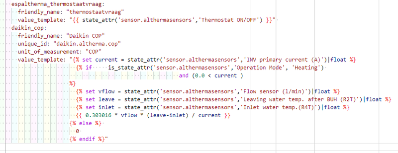

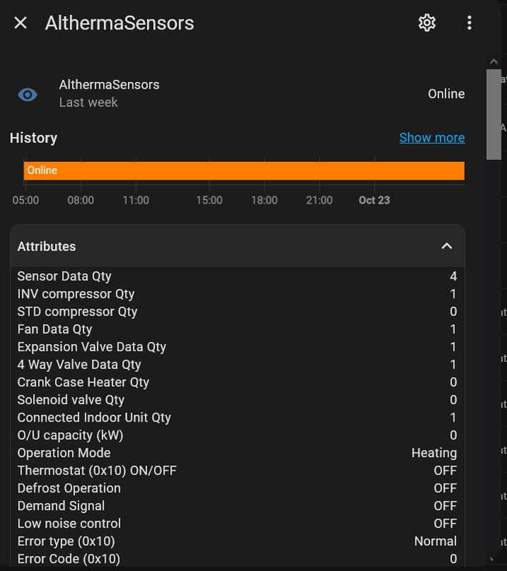

 - sensor:
      - name: "Dampleidingtemperatuur"
        state: "{{ state_attr('sensor.althermasensors','Discharge pipe temp.') }}"
        unit_of_measurement: "°C"
        state_class: measurement
      - name: "Operation mode"
        state: "{{ state_attr('sensor.althermasensors','Operation Mode') }}"
      - name: "I/O Mode"
        state: "{{ state_attr('sensor.althermasensors','I/U operation mode') }}"
      - name: "Current mode"
        state: "{% if is_state('sensor.espaltherma_thermostaat_aan_uit', 'ON') %} {{ state_attr('sensor.althermasensors','Operation Mode') }} {% else %} Uit {% endif %}"
      - name: "Booster thermal protection"
        state: "{{ state_attr('sensor.althermasensors','Thermal protector (Q1L) BUH') }}"
      - name: "Back-up thermal protection"
        state: "{{ state_attr('sensor.althermasensors','Thermal protector BSH') }}"
      - name: "Watertanktemperature"
        state: "{{ state_attr('sensor.althermasensors','DHW tank temp. (R5T)') }}"
      - name: "Flowpump"
        state: "{{ state_attr('sensor.althermasensors','Flow sensor (l/min)') }}"
        unit_of_measurement: "l/min"
      - name: "Water flow switch"
        state: "{{ state_attr('sensor.althermasensors','Water flow switch') }}"
      - name: "Water pump operation"
        state: "{{ state_attr('sensor.althermasensors','Water pump operation') }}"
      - name: "Water pump level (original)"
        state: "{{ state_attr('sensor.althermasensors','Water pump signal (0:max-100:stop)') }}"
        unit_of_measurement: "%"
      - name: "Water pump level"
        state: "{{ 100 - state_attr('sensor.althermasensors','Water pump signal (0:max-100:stop)') }}"
      - name: "Reheat"
        state: "{{ state_attr('sensor.althermasensors','Reheat ON/OFF') }}"
      - name: "Circulation pump"
        state: "{{ state_attr('sensor.althermasensors','Circulation pump operation') }}"
      - name: "Delta T Heating"
        state: "{{ state_attr('sensor.althermasensors','Target delta T heating') }}"
      - name: "Delta T Cooling"
        state: "{{ state_attr('sensor.althermasensors','Target delta T cooling') }}"
      - name: "Outdoor temperature"
        state: "{{ state_attr('sensor.althermasensors','Outdoor air temp.(R1T)') }}"
      - name: "Thermostat"
        state: "{{ state_attr('sensor.althermasensors','Thermostat ON/OFF') }}"
      - name: "Defrost operation"
        state: "{{ state_attr('sensor.althermasensors','Defrost Operation') }}"
      - name: "Back-up heater"
        state: "{{ state_attr('sensor.althermasensors','BUH Step1') }}"
      - name: "Watertank setpoint"
        state: "{{ state_attr('sensor.althermasensors','DHW setpoint') }}"
      - name: "Room temperature setpoint"
        state: "{{ state_attr('sensor.althermasensors','RT setpoint') }}"
      - name: "Water leaving temperature"
        state: "{{ state_attr('sensor.althermasensors','Leaving water temp. before BUH (R1T)') }}"
      - name: "Water inlet temperature"
        state: "{{ state_attr('sensor.althermasensors','Inlet water temp.(R4T)') }}"
      - name: "Heat exchanger temperature"
        state: "{{ state_attr('sensor.althermasensors','Heat exchanger mid-temp.') }}"
      - name: "Refrigerator liquid temperature"
        state: "{{ state_attr('sensor.althermasensors','Refrig. Temp. liquid side (R3T)') }}"
      - name: "Water pressure"
        state: "{{ state_attr('sensor.althermasensors','Water pressure') }}"
        unit_of_measurement: "bar"
      - name: "Leaving water setpoint"
        state: "{{ state_attr('sensor.althermasensors','LW setpoint (main)') }}"
      - name: "Roomtemperature"
        state: "{{ state_attr('sensor.althermasensors','Indoor ambient temp. (R1T)') }}"
      - name: "Inverter current"
        state: "{{ state_attr('sensor.althermasensors','INV primary current (A)') }}"
        unit_of_measurement: "A"
      - name: "Inverter frequency"
        state: "{{ state_attr('sensor.althermasensors','INV frequency (rps)') }}"
        unit_of_measurement: "rps"
      - name: "Voltage"
        state: "{{ state_attr('sensor.althermasensors','Voltage (N-phase) (V)') }}"
        unit_of_measurement: "V"
      - name: "Inverter usage"
        state: "{% if is_state_attr('sensor.althermasensors', 'Thermostat ON/OFF', 'ON') %} {{ (states('sensor.inverter_current')|float * 230 | float) }} {% else %} 0 {% endif %}"
        unit_of_measurement: "W"
      - name: "Heat yield"
        state: "{% if is_state_attr('sensor.althermasensors', 'Thermostat ON/OFF', 'ON') %} {{ (states('sensor.inverter_usage')|float * states('sensor.cop')| float)|round|int }} {% else %} 0 {% endif %}"
      - name : "Low noise control"
        state: "{{ stae_attr('sensor.althermasensors', 'Low noise control') }}"
      - name : "Suction pipe temperature"
        state: "{{ state_attr('sensor.althermasensors', 'Suction pipe temp.') }}"
      - name : "Inverter current secondary"
        state: "{{ state_attr('sensor.althermasensors', 'INV secondary current (A)') }}"
      - name : "Druk sensor"
        state: "{{ state_attr('sensor.althermasensors', 'Pressure sensor') }}"
      - name : "STD Compressor 1"
        state: "{{ state_attr('sensor.althermasensors', 'STD Compressor 1') }}"
      - name : "Vries beveiliging"
        state: "{{ state_attr('sensor.althermasensors', 'Freeze Protection') }}"
      - name : "Stille modus"
        state: "{{ state_attr('sensor.althermasensors', 'Silent Mode') }}"
      - name: "ESPAltherma last update"
        state: "{{ as_timestamp(states.sensor.althermasensors.last_updated) | timestamp_custom('%H:%M:%S',True) }}"
      - name: "COP"
        unit_of_measurement: "COP"
        state: >-
          {% if states('sensor.thermostat') == 'OFF'  %}
          {% set cop = 0.0 | float %}
          {% elif states('sensor.thermostat') == 'ON'
            or states('sensor.inverter_usage') |float >90 %}
          {% set t1 = states('sensor.water_leaving_temperature') | float %}
          {% set t2 = states('sensor.water_inlet_temperature') | float %}
          {% set f = states('sensor.flowpump') | float %}
          {% set pw = states('sensor.inverter_usage') | float %}
          {% set pwg = ((t1 - t2)*f) / 60 * 4184 | float %}
          {% set cop = pwg / pw | float  %}
            {% endif %}
          {% if cop != 0.0 %}
          {{ cop | float | round(1) }}
            {% else %}
          {% endif %}
      - name: "Working COP"
        state: >-
            {% endif %}
          {% if cop != 0.0 %}
            {% else %}
          {% endif %}
      - name: "∆T"
        state: >-
          {{ (states('sensor.water_leaving_temperature')|float - states('sensor.water_inlet_temperature') | float)|round(1) }}

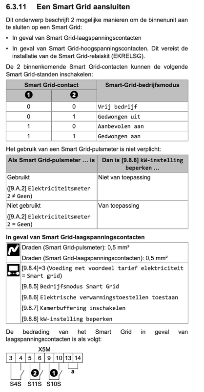

Iemand een tip welk relais ik kan gebruiken met de M5Stack Plus?
Ik wil de Altherma SG1 en SG2 contacten kunnen regelen.
Volgens mij moet dat wel werken met zo'n relay:
https://docs.m5stack.com/en/unit/relay
Het is mij alleen nog niet helemaal duidelijk hoe ik het moet aansluiten. Iemand?
Afbeeldingslocatie: https://tweakers.net/i/EDJwqNaH4YopPQcXKfiykkXwIMI=/x800/filters:strip_exif()/f/image/bZDonXs1SZ5p7y6FnXLpsTsB.png?f=fotoalbum_large

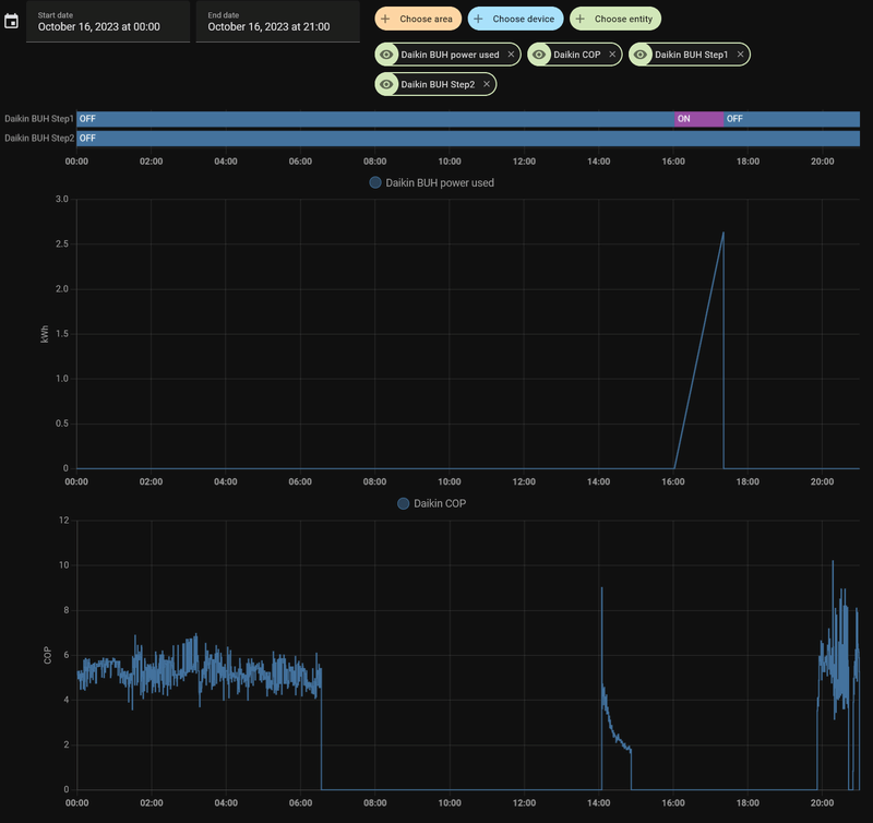

Afbeeldingslocatie: https://tweakers.net/i/vzxljoo8eeQksZJyYevmubAg8uY=/800x/filters:strip_exif()/f/image/yFesr2gumyj5RMstJhZ7SXzJ.png?f=fotoalbum_large
Dit is de cop van een legionella run naar 60 graden, dat lijkt mij wat ambitieus aangezien 53->60 op de buh gaat en dus cop 1 moet zijn.
Klopt mijn cop berekening?

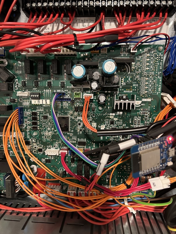

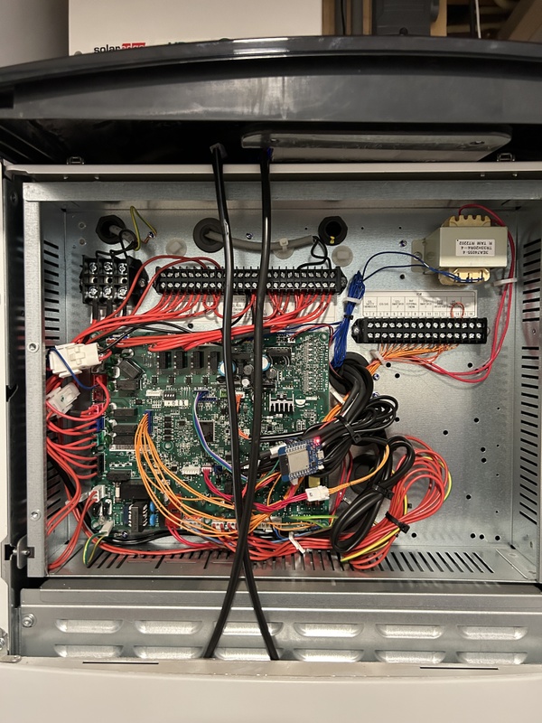

  • Thieske2478
  • Laatst online: 28-10 13:22
Ik heb gisteren ook de ESPAltherma geinstalleerd op mijn Daikin Daikin Altherma 3 R F EHVX08S23E9W + ERGA08EVH. Het lijkt te werken maar het is voor mij net als anderen niet helemaal duidelijk welk model corespondeerd met welk model in ESPAltherma. Ik heb deze nu gekozen en krijg wel veel gegevens door. #include "def/ALTHERMA(LT_DA_04-08KW).h" Heb alles aangezet in dit bestand maar dan krijg je wel heel veel waardes door. Nog even uitzoeken welke regels niet relevant zijn. En ja ik moet nog iets van een montage plek gaan vinden. Afbeeldingslocatie: https://tweakers.net/i/4POfMC5nojtQCcFKlGy7eMMU17U=/x800/filters:strip_icc():strip_exif()/f/image/SoBHDqnMgMG3lyrEVmikHGug.jpg?f=fotoalbum_large
Afbeeldingslocatie: https://tweakers.net/i/AYem68Kai3nv4ZIuOzud0FRzwYE=/x800/filters:strip_icc():strip_exif()/f/image/ytQobVoWMlqspJrTOxXgL7uu.jpg?f=fotoalbum_large

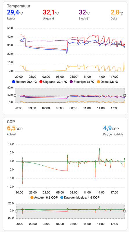

  • Thieske2478
Zo dit ziet er beter uit. Ik kan nu via de ESPAltherma de thermostaat aan en uit zetten.Smartgrid ondersteund mijn model helaas niet alleen via Kwh puls en daar zijn ze nog mee aan het ontwikkelen las ik net op git.
Afbeeldingslocatie: https://tweakers.net/i/aS7yXfccaJFJlganUkb_7amXmQQ=/x800/filters:strip_icc():strip_exif()/f/image/d8hwbZsH4XDCE9XXDxT3VEeK.jpg?f=fotoalbum_large
  - name: "Voltage"
    state: "{% if is_state_attr('sensor.althermasensors', 'Thermostat ON/OFF', 'ON') %} {{ (states('sensor.inverter_current')|float * (states('sensor.remi_voltage_woning'))|float | float) }} {% else %} 0 {% endif %}"
    device_class: energy
    state: "{{ state_attr('sensor.althermasensors', 'Low noise control') }}"
  - name: "COP"
    state: >-
        {% endif %}
      {% if cop != 0.0 %}
        {% else %}
      {% endif %}
  - name: "COP with cooling"
    state: >-
        {% endif %}
      {% if cop != 0.0 %}
        {% else %}
      {% endif %}
  - name: "∆T"
    state: >-

let leave = Number(msg.payload["Leaving water temp. after BUH (R2T)"]); // vertrektemperatuur
let inlet = Number(msg.payload["Inlet water temp.(R4T)"]);              // inlaattemperatuur
let usage = Number(msg.payload["INV primary current (A)"]);             // verbruikte elektrische stroom in A
let vflow = Number(msg.payload["Flow sensor (l/min)"]);                 // volumestroom in liters/min
let qv = vflow / (60 * 1000); // volumestroom in (m³/s) => (l/min) / (60 * 1000)
let p  =  998;                // soortelijke massa van water  =  998 (kg/m³)
let c  = 4190;                // soortelijke warmte van water = 4190 (J/kg.K)
let dT = leave - inlet;       // (Temperatuur uit [K] – Temperatuur in [K])
let pw = qv * p * c * dT;     // vermogen = qv(m³/s) * p(kg/m³) * c(J/kg.K) * dT(K) => J/s = W
// Bereken nu COP door het geleverde vermogen te delen door het verbruikte vermogen
// Voor het gemak spanning van 230V gebruiken (variatie is typisch tussen 225 en 235)
let COP = (0 < usage) ? pw / (usage*230) : 0;
return { payload: COP };
Node-Red is prettig omdat je makkelijk je algoritme kan debuggen, deze heb ik vervolgens geoptimaliseerd (alle vermenigvuldigingen en delingen alvast gedaan) en in mijn sensors.yaml file gegooid:
- platform: template
  sensors:
    daikin_cop:
      friendly_name: "Daikin COP"
      unique_id: "daikin.altherma.cop"
      value_template: "{% set current = state_attr('sensor.none_althermasensors','INV primary current (A)')|float %}
                       {% if     is_state_attr('sensor.none_althermasensors','Operation Mode', 'Heating')
                             and is_state_attr('sensor.none_althermasensors','Freeze Protection', 'OFF')
                             and (0.0 < current )
                         {% set vflow = state_attr('sensor.none_althermasensors','Flow sensor (l/min)')|float %}
                         {% set leave = state_attr('sensor.none_althermasensors','Leaving water temp. after BUH (R2T)')|float %}
                         {% set inlet = state_attr('sensor.none_althermasensors','Inlet water temp.(R4T)')|float %}
                         {{ 0.303016 * vflow * (leave-inlet) / current }}
                       {% else %}
                          0
                       {% endif %}"
Let op: ik heb mijn sensors 'fout' gedefinieerd; ik krijg dus een hele dikke structuur met alle sensors bij elkaar, dus die moet ik uit elkaar plukken met state_attr() in plaats van states().
Dit zou er dan bijvoorbeeld zo uitzien (berekenen eigen verbruik zonnepanelen)
    solaredge_lifetime_selfuse:
      friendly_name: "Lifetime self-use solar"
      unit_of_measurement: "kWh"
      value_template: >-
        {% set SElifetime = states('sensor.solaredge_ac_energy_kwh')|float %}
        {% set P1tariff1  = states('sensor.electricity_meter_energy_production_tarif_1')|float %}
        {% set P1tariff2  = states('sensor.electricity_meter_energy_production_tarif_2')|float %}
        {{ (SElifetime-P1tariff1-P1tariff2) | int }}

Ik heb de BUH er inderdaad niet bijgezet, maar dat is vrij simpel: die kan in 1 of twee stappen meedoen, bij mij alleen stap(1) en is geconfigureerd op 2kW. Deze twee dus:
state_attr('sensor.none_althermasensors', 'BUH Step1')
state_attr('sensor.none_althermasensors', 'BUH Step2')
Die kan je op basis van "OFF/ON" gewoon meetellen.
Volgens mij gaat de inverter uit op dat moment dus de YAML code moet dan een beetje anders gestructureerd worden.

Dus je maakt in Node Red (nog niet bekend mee) een berekening waar 0.303016 uit komt; dat is verder toch een statisch getal (dat ik kan overnemen)?
In de sensor die je dan maakt staat de berekening die dan dynamisch wordt? Of zie ik nu wat over het hoofd...

GJA schreef op zondag 22 oktober 2023 @ 19:40:
Ja: dynamisch zijn flow, delta(T) en verbruikte energie, de rest zijn constanten of omrekenfactoren; achter elkaar is dat dan (1/60000)*998*4190/230 = 0.303016
Voor je inzicht is het goed een tijdje naar die Node-Red beschrijving te staren omdat zo'n getalletje totaal nietszeggend is, vandaar dat ik het even uitbundig uitgewerkt heb ;)
Met deze uitgebreide beschrijving is het dan ook gemakkelijk om andere berekeningen te doen, ik heb ook een variant die de extra circulatiepomp meerekent bijvoorbeeld. Deze winter ga ik de boel nog uitbreiden als defrost gaat meedoen.

Ik heb je code gecopieerd en aangepast in de configuration.yaml gezet.
Hij vindt de config juist, dat vind ik al heel wat. Ne gereset en afwachten of ie data gaat uitspugen.
Ik verwacht nog geen direct succes vanwege wat rode regels....
Ik heb de freezeprotection eruit gelaten; die sensor heb ik niet geactiveerd.

GJA schreef op zondag 22 oktober 2023 @ 22:31:
Hmm, in de template erboven gebruik je wel "state_attr('sensor.althermasensors', ... )", maar daaronder "states( ...)" - dat kan niet allebei goed zijn!
Voor states moet je volgens mij de sensor definitie (met puntjes en underscores) letterlijk gebruiken zoals je die in HA->settings->Devices&Services->entities ziet staan, niet de beschrijvende tekst, zie ook mijn voorbeeldje van de zonnepanelen en p1 meter.
Bij mij dus de gezamenlijke entity met alle altherma data in 1x:
Afbeeldingslocatie: https://tweakers.net/i/FZ1HQSNlJn4763-NJcyZr9aRfpU=/800x/filters:strip_exif()/f/image/hrxrmGEQhQiHlfxRmlhNSeF3.png?f=fotoalbum_large
Als ik deze dan aanklik en op attributes klik zie ik de inhoud
Afbeeldingslocatie: https://tweakers.net/i/Bp-I5KANred-lOvptGxWM6KcwBI=/x800/filters:strip_exif()/f/image/N7XYr4iq8whnj64SZBLFk1BI.png?f=fotoalbum_large
Die ene andere daikin 'sensor' die je zie is in een template (staat er ook bij in de integration kolom), ik doe het dus dubbel... zie definitie

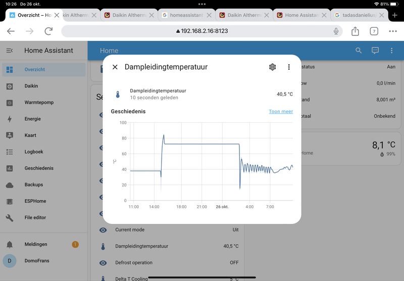

Ik ben nog steeds bezig om mijn attributen van een MQTT koppeling om te zetten naar entiteiten, ik heb ze nu zichtbaar en ik kan ze op een dashboard zien. Maar als ik op een entiteit klik en daarna op het tandwieltje krijg ik onderstaande melding, ik heb dit proberen op te lossen door in de configuratie file een regel uniqu-id toe te voegen maar dit schijnt niet te werken.
Afbeeldingslocatie: https://tweakers.net/i/0zRbHShsq3bhaYJSHNtZiB7UNtQ=/800x/filters:strip_exif()/f/image/qQR2SQ1eOLXsSdpj5bsCxBOL.png?f=fotoalbum_large
Afbeeldingslocatie: https://tweakers.net/i/dsy5Cnqps5S73nHmh_T_EirBscw=/800x/filters:strip_exif()/f/image/xk7kpnma5dzSwEtlgDq70r7f.png?f=fotoalbum_large
Afbeeldingslocatie: https://tweakers.net/i/FY2drcUhTXx8QlfAhEryxhoDAOc=/800x/filters:strip_exif()/f/image/ng4Q2oyJCZclkO1RsUPJ73If.png?f=fotoalbum_large
Bambu Lab P1S || EHVX08S18EJ6V , ESPAltherma || Deye SUN-12K-SG04LP3-EU , 2 x Seplos V4 , 32 x EVE MB31 315 Ah , Tibber

    daikin_hybrid_heating_target_temp:
      friendly_name: "Daikin hybrid heating target temperature"
      unique_id: "daikin.altherma.hybrid_heating_target_temp"
      value_template: "{{ state_attr('sensor.none_althermasensors', 'Hybrid Heating Target Temp.')|float }}"

  • Liviooo
  • Registratie: Oktober 2023
24u geleden de ESPAltherma geïnstalleerd in de warmtepomp. Heb dus nu de eerste data binnen in HA.
Vraag is, hoe analyseer je de eerste resultaten en wat kan ik hier uit afleiden?
Afbeeldingslocatie: https://tweakers.net/i/Ywe-TDVoLH-tYI2pwdbQBKzZhEI=/x800/filters:strip_exif()/f/image/j09o27hOlTyClaAuSQduLiyx.png?f=fotoalbum_large
  • GJA
  • Laatst online: 07-11 22:47
GJA
Liviooo schreef op donderdag 26 oktober 2023 @ 19:20:
Nu begint het tweaken...
Wat je wilt is een lange run op zo laag mogelijk vermogen.
Dus nu kijken of de WP stopt en als dat zo is waarom ie stopt.
Wat je nog wilt weten: compressorstroom, thermostaatvraag, defrost functie aan/uit.
