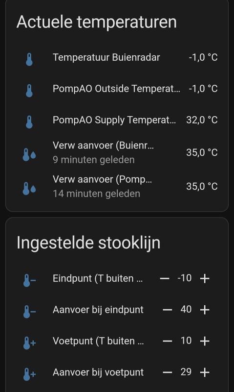

DutchAce schreef op donderdag 18 januari 2024 @ 08:40:
Heb hem al gemaakt voor je :)
Even 5 helpers aanmaken, 4 voor de stooklijn settings (groen omkaderd) en 1 voor de berekende expectedsupplytemp:
Code voor de automation:

alias: PompAO Calculate Expected Supplytemp Stooklijn
description: ""
trigger:
  - platform: state
    entity_id:
      - sensor.pompao_outsidetemp
    variables:
      "y": "{{ states('input_number.pompao_stooklijn_uppersupplytemp') | float  }}"
      y2: "{{ states('input_number.pompao_stooklijn_uppersupplytemp') | float  }}"
      y1: "{{ states('input_number.pompao_stooklijn_lowersupplytemp') | float  }}"
      x2: "{{ states('input_number.pompao_stooklijn_upperoutsidetemp') | float  }}"
      x1: "{{ states('input_number.pompao_stooklijn_loweroutsidetemp') | float  }}"
condition: []
action:
  - choose:
      - conditions:
          - condition: numeric_state
            entity_id: sensor.pompao_outsidetemp
            above: input_number.pompao_stooklijn_upperoutsidetemp
        sequence:
          - service: input_number.set_value
            data:
              value: "{{states('input_number.pompao_stooklijn_lowersupplytemp')}}"
            target:
              entity_id: input_number.pompao_expectedsupplytemp
          - stop: ""
        alias: Upper Saturation Value
      - conditions:
            below: input_number.pompao_stooklijn_loweroutsidetemp
        sequence:
            data:
            target:
          - stop: ""
        alias: Lower Saturation Value
      - conditions:
          - condition: and
            conditions:
                above: input_number.pompao_stooklijn_loweroutsidetemp
                below: input_number.pompao_stooklijn_upperoutsidetemp
        sequence:
            data:
              value: >-
                {{  (states('input_number.pompao_stooklijn_lowersupplytemp') |
                float ) + ((states('sensor.pompao_outsidetemp') | float ) -
                (states('input_number.pompao_stooklijn_loweroutsidetemp') |
                float ) ) *
                ((states('input_number.pompao_stooklijn_uppersupplytemp') |
                float ) -
                (states('input_number.pompao_stooklijn_lowersupplytemp') | float
                ) ) / ((states('input_number.pompao_stooklijn_upperoutsidetemp')
                | float ) -
                float ) ) | round(2)}}
            target:
            alias: y = y1 + (x - x1) ⨯ (y2 - y1) / (x2 - x1)
          - stop: ""
        alias: Interpolate Stooklijn Value
mode: single
Bedankt, scheelt weer een hoop denkwerk! Heb hem nu mooi draaiend en kan de ExpectedSupplyTemp aflezen aan de hand van de PompAO sensor, maar ook aan de hand van de actuele buitentemperatuur zoals Buienradar die aangeeft. Zo kan ik een redelijk betrouwbare vergelijking maken.
Afbeeldingslocatie: https://tweakers.net/i/HzWUZYPCRv_SuYZIO8dRuCYU4zM=/x800/filters:strip_icc():strip_exif()/f/image/gWuRGhwfk4YpPIbG1R5CeSKC.jpg?f=fotoalbum_large
[ Voor 4% gewijzigd door jansd op 19-01-2024 08:07 ]

Denk je even geluk te hebben om bij de settings te kunnen, opslaan lijkt ook te lukken, maar de pomp doet er niks mee 🤯
  • Jurrian7
  • Registratie: Januari 2024
  • Laatst online: 02-10-2024
Al die settings werken niet, te hopen dat de nieuwe app wel werkt
  • Mkw
  • Registratie: Oktober 2023
  • Laatst online: 13-10 14:32
Jurrian7 schreef op zondag 21 januari 2024 @ 19:22:
Meestal niet maar zo heel af en toe wel kun je geluk hebben. Maar laten we hopen dat eind januari komende week al is…
De stooklijn instellingen worden live van de pomp afgelezen weet ik inmiddels. Dus als ze op het dashboard goed zijn, dan staan ze ook echt in de pomp....
