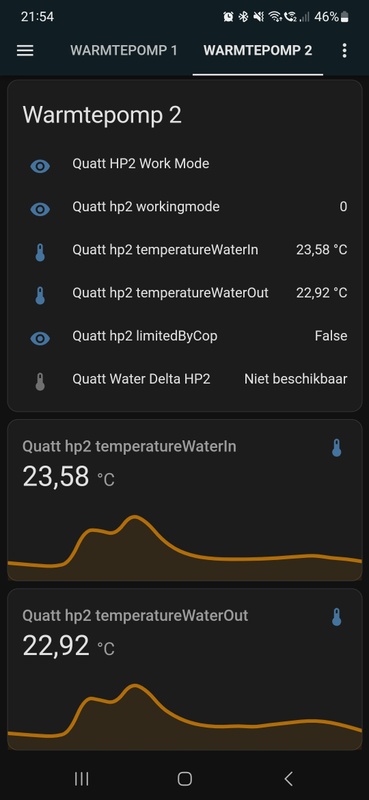

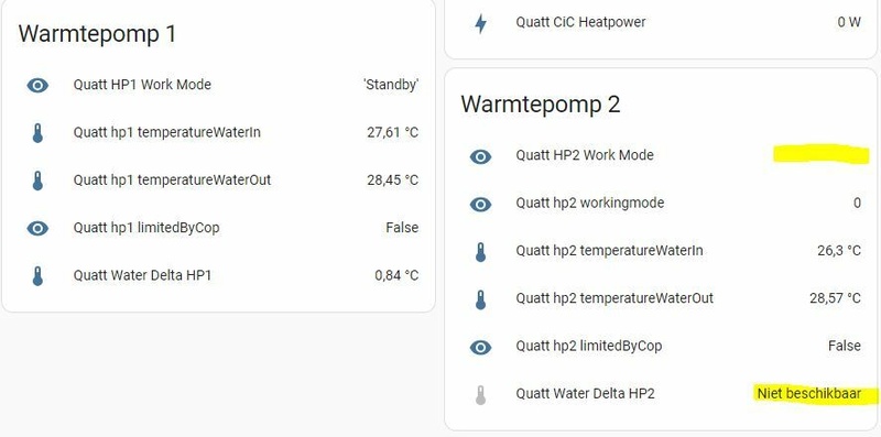

jroz2001 schreef op dinsdag 27 juni 2023 @ 11:11:
Dat deel komt wel in configuration.yaml, maar onder template:
Bij mij heet die sensor Quatt QC. Mijn configuratie ziet er als volgt uit:
24
25
26
27
28
29
30
31
32
33
34
35
36
37
38
39
40
41
42
43
44
45
46
47
48
49
50
51
52
53
54
55
56

#Quatt
rest:
  - resource: http://CIC-hostname:8080/beta/feed/data.json
    scan_interval: 10
    sensor:
      - name: "Quatt hp1 workingmode"
        unique_id: quatt.hp1.getMainWorkingMode
        value_template: "{{ value_json.hp1.getMainWorkingMode }}"
      - name: "Quatt hp1 temperatureOutside"
        unique_id: quatt.hp1.temperatureOutside
        value_template: "{{ value_json.hp1.temperatureOutside | round(2) }}"
        device_class: temperature
        unit_of_measurement: "°C"
      - name: "Quatt hp1 temperatureWaterIn"
        unique_id: quatt.hp1.temperatureWaterIn
        value_template: "{{ value_json.hp1.temperatureWaterIn | round(2) }}"
      - name: "Quatt hp1 temperatureWaterOut"
        unique_id: quatt.hp1.temperatureWaterOut
        value_template: "{{ value_json.hp1.temperatureWaterOut | round(2) }}"
      - name: "Quatt hp1 silentMode"
        unique_id: quatt.hp1.silentModeStatus
        value_template: "{{ value_json.hp1.silentModeStatus }}"
      - name: "Quatt hp1 limitedByCop"
        unique_id: quatt.hp1.limitedByCop
        value_template: "{{ value_json.hp1.limitedByCop }}"
      - name: "Quatt CV"
        unique_id: quatt.boiler.otFbChModeActive
        value_template: "{{ value_json.boiler.otFbChModeActive }}"
      - name: "Quatt SWW"
        unique_id: quatt.boiler.otFbDhwActive
        value_template: "{{ value_json.boiler.otFbDhwActive }}"
      - name: "Quatt CV vlam"
        unique_id: quatt.boiler.otFbFlameOn
        value_template: "{{ value_json.boiler.otFbFlameOn }}"
      - name: "Quatt CV temperatureWaterIn"
        unique_id: quatt.boiler.otFbSupplyInletTemperature
        value_template: "{{ value_json.boiler.otFbSupplyInletTemperature | round(2) }}"
      - name: "Quatt CV temperatureWaterOut"
        unique_id: quatt.boiler.otFbSupplyOutletTemperature
        value_template: "{{ value_json.boiler.otFbSupplyOutletTemperature | round(2) }}"
      - name: "Quatt CV verwarmen"
        unique_id: quatt.boiler.otTbCH
        value_template: "{{ value_json.boiler.otTbCH }}"
      - name: "Quatt flowMeter temperature"
        unique_id: quatt.flowMeter.waterSupplyTemperature
        value_template: "{{ value_json.flowMeter.waterSupplyTemperature | round(2) }}"
      - name: "Quatt flowMeter snelheid"
        unique_id: quatt.flowMeter.flowRate
        value_template: "{{ value_json.flowMeter.flowRate | round(0) }}"
        unit_of_measurement: "l/u"
      - name: "Quatt thermostat verwarmen"
        unique_id: quatt.thermostat.otFtChEnabled
        value_template: "{{ value_json.thermostat.otFtChEnabled }}"
      - name: "Quatt thermostat SWW"
        unique_id: quatt.thermostat.otFtDhwEnabled
        value_template: "{{ value_json.thermostat.otFtDhwEnabled }}"
      - name: "Quatt thermostat koelen"
        unique_id: quatt.thermostat.otFtCoolingEnabled
        value_template: "{{ value_json.thermostat.otFtCoolingEnabled }}"
      - name: "Quatt thermostat control setpoint"
        unique_id: quatt.thermostat.otFtControlSetpoint
        value_template: "{{ value_json.thermostat.otFtControlSetpoint | round(2) }}"
      - name: "Quatt thermostat room setpoint"
        unique_id: quatt.thermostat.otFtRoomSetpoint
        value_template: "{{ value_json.thermostat.otFtRoomSetpoint | round(2) }}"
      - name: "Quatt thermostat room temperature"
        unique_id: quatt.thermostat.otFtRoomTemperature
        value_template: "{{ value_json.thermostat.otFtRoomTemperature | round(2) }}"
      - name: "Quatt QC"
        unique_id: quatt.qc.supervisoryControlMode

In dit geval krijg ik dus geen tekst bij de Quatt HP2 Work mode en geen uitkomst bij Qautt Water Delta HP2, zie onderstaand

Doe eens in sjablonen:
YAML:
{{ states('sensor.quatt_hp2_temperaturewaterout') - states('sensor.quatt_hp2_temperaturewaterin') | float }}
wat krijg je dan?
En als je daar een uitkomst krijgt > reboot :) (het blijft HA he)
[ Voor 16% gewijzigd door paQ op 10-07-2023 20:53 ]
  • emilejager
  • Registratie: Juli 2023
  • Laatst online: 25-07-2024
Dan krijg ik deze melding:
ValueError: Template error: float got invalid input 'unknown' when rendering template '{{ states('sensor.quatt_hp2_temperaturewaterout') - states('sensor.quatt_hp2_temperaturewaterin') | float }}' but no default was specified
  • paQ
  • Laatst online: 14:55
emilejager schreef op maandag 10 juli 2023 @ 21:20:
dan is er een sensor niet aanwezig
Heb je wel alles herladen, of liever herstart als je vage issues krijgt?
wat geeft (leeg sjabloonscherm)
{{ states('sensor.quatt_hp2_temperaturewaterout') | float }}
en
{{ states('sensor.quatt_hp2_temperaturewaterin') | float }}
  • emilejager
paQ schreef op maandag 10 juli 2023 @ 21:45:
en
Al meerdere herstarts gedaan. Ik krijg bij sjablonen deze melding:
ValueError: Template error: float got invalid input 'unknown' when rendering template '{{ states('sensor.quatt_hp2_temperaturewaterout') | float }}' but no default was specified
In mijn configuration.yaml heb ik hem zo staan:
      - name: "Quatt hp2 temperatureWaterOut"
        unique_id: quatt.hp2.temperatureWaterOut
        value_template: "{{ value_json.hp2.temperatureWaterOut | round(2) }}"
Daar geeft die wel output:
Afbeeldingslocatie: https://tweakers.net/i/6T0Kv4QyL6tymC4h70PqGClPI0Y=/x800/filters:strip_icc():strip_exif()/f/image/OhJP9SX4A8uwYFFBsn3Me1C4.jpg?f=fotoalbum_large
  • paQ
Als je in sjablonen nou eens "aterOut" bijv verwijdert, en vanaf daar begint te schrijven zodat ie zelf de opties aangeeft. Lukt dat wel?
Verwijs je verder wel naar zijn eigen CIC / IP / poort?
Het vreemde is dat ie wel andere temp informatie laat zien.
[ Voor 62% gewijzigd door paQ op 10-07-2023 22:07 ]
  • emilejager
paQ schreef op maandag 10 juli 2023 @ 22:01:
Verwijzing naar de CIC was inderdaad goed. Op basis van jouw tip kwam ik er achter dat er uit een eerdere configuratie een andere naam aan leek te hangen (ondanks alle restarts). Handmatig aangepast en nu gaat het goed.

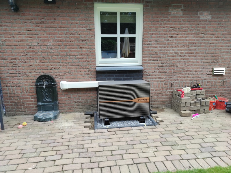

Hoever staan de pootjes (bevestigingen) eigenlijk uit elkaar ?
In verband met de voorbereiding van de grindbak met 2x stoeprand 50cm
Duo quatt, huis 1928, ca 80M2 vloerverwarming beneden,matig geisoleerd, 250 m2 woonoppervlak, midden brabant
  • HBO88
  • Laatst online: 13:29
robmaas schreef op dinsdag 11 juli 2023 @ 18:47:
de kunststof voeten zijn 45 cm lang.
hart-op-hart afstand van de voeten is 66 cm.

Ik overweeg eigenlijk om geen grindbak te doen. Ik heb een steegje naast het huis van stenen, hier staan de containers en daar achter komen de Quatts, dat is dus een looppad waar ik vrijwel nooit langs hoef te lopen, helemaal niet in de winter. De stenen hebben tevens een beetje afloop richting de tuin ivm afwatering.
Dan heeft een grindbak weinig nut toch?
Afbeeldingslocatie: https://tweakers.net/i/7OpE_ZKLDbGgiZAyWFnP3NzDBrA=/800x/filters:strip_icc():strip_exif()/f/image/p7tNX6x4JoLq4VCS0dH5haNl.jpg?f=fotoalbum_large
[ Voor 34% gewijzigd door geerttttt op 11-07-2023 19:27 ]
Oost west, 127.0.0.1 best!
  • rvdgaag
  • Registratie: December 2015
  • Laatst online: 07:47
geerttttt schreef op dinsdag 11 juli 2023 @ 19:26:
de WP geeft met ontdooien 20 tot 25 liter water, als het vriest zal het direct op de straat opvriezen, krijgt amper de kans om af te vloeien, dat wordt dan 1 grote klomp. Ik zou zeker een grindbakje maken.

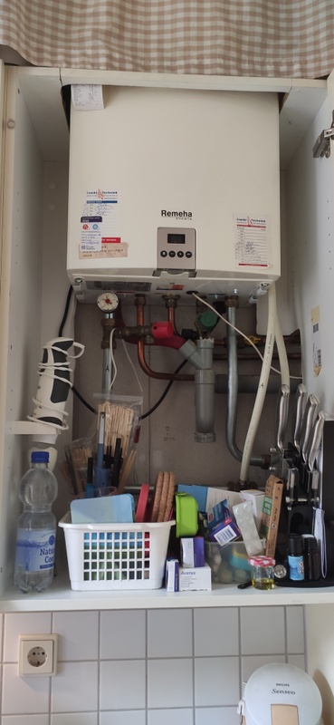

Afbeeldingslocatie: https://tweakers.net/i/Aoj2SN5skGLjBAymQsRB4qPvygw=/x800/filters:strip_icc():strip_exif()/f/image/SRUASXA69XAj44FP4ZHBeLAQ.jpg?f=fotoalbum_large
Keukenkastje is 30 cm diep, 57 cm breed en de ruimte onder de CV is 55 cm. Ben ik benieuwd of hun installatie hierbij gaat passen? Ik zou zeggen dat de CIC tegen een van de zijwanden aan geschroeft kan worden, ze kunnen hiervandaan direct een gat naar buiten boren (zandsteen muur) voor de leidingen en deze er in knopen. Wel zou ik graag een vuilafscheiding er tussen willen, maar dat wordt allemaal wel erg krap vrees ik.

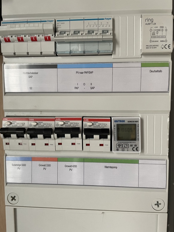

  • Kramerri
  • Registratie: Juni 2023
  • Laatst online: 10-09 07:20
Afbeeldingslocatie: https://tweakers.net/i/-vzr1hAp9YIOf9_4xNBArB0CV14=/x800/filters:strip_icc():strip_exif()/f/image/GfzUPlR3RBoHjwqmnL6sh4gq.jpg?f=fotoalbum_large
Het spul is binnen, woensdag de installatie!
Ik ben ook met de grindbak bezig voor de installatie van komende zaterdag maar in de instructies staat enkel over het opleveren van een bak met grind, niet over 2 stoepranden / blokken waar de Quatt op gezet wordt.
Is dat puur voor het esthetische aspect, zodat de poten tussen het grind komen te staan ipv op het grind?
Zo ja, waarom dan niet op de ondergrond? is de 10cm grind hoogte daar teveel voor?
dat is vooral een technische oorzaak; je warmtepomp moet zo goed mogelijk waterpas staan, bij grind kan zich door de trillingen (tijdens bedrijf) je warmtepomp ongemerkt verschuiven, dat wil je dus niet.
Door deze op voldoende grote blokken te zetten krijg je een stabile ondergrond. De blokken dus ook niet in een grindbed plaatsen, heb je het zelfde probleem.
Maak aan de kant van de afvoer een circa 20 bij 20 cm dieper gat, liefst onder de vorstgrens (circa 60 cm), en vul dat op ook met de grind, het water kan dan via deze vorstvrije afvoer in de grond afgevoerd worden.
Quatt WP 4,5 kW - Atag CV ketel - Honeywell T6 - 23 panelen SolarEdge
  • louzy82
  • Laatst online: 14:20
MacD007 schreef op donderdag 13 juli 2023 @ 13:45:
Wel gek eigenlijk dat ze dat dan zelf niet adviseren in de beschrijving van de grindbak.

Het hoeft ook niet perse. Het ding blijft echt wel staan op fatsoenlijke voeten. Een 'bigfoot' is hol van onder, dus die kun je prima in grind plaatsen. Ze installeren ze ook zo bovenop bestrating op van die plastic balkjes, en dat vinden ze zelf blijkbaar ook prima. Het grind dient puur om vlug een stroom water af te kunnen voeren en het niet de kans krijgt weg te lopen over je bestrating bijv.
Met storm moet je alleen er voor waken dat je het geheel niet op een soort van 'knikkers' plaatst waardoor de wind het apparaat pakt en relatief makkelijk kan schuiven/rollen. Ik begrijp daarom de keuze voor die plastic balkjes toch al niet zo.

  • MacD007
  • Laatst online: 06-06-2025
paQ schreef op donderdag 13 juli 2023 @ 16:43:
nee, die plastic voetjes worden alleen bij montage b.g. gebruikt, de betere rubberen voetjes gebruiken ze op een dak ed.
een warmtepomp dient gewoon waterpas te staan, dat zie je ook bij andere "bekende" merken heel duidelijk staan in hun installatievoorschriften.
als je het met dergelijke lichtgewicht voetjes dan op een laag grind plaatst weet je nooit of dat waterpass blijft, zeker met de trillingen ed. daarom ook de balkjes die je dus op de grond (klei, zand ed plaatst en deze ud perfect waterpas kunt plaatsen.
In de winter (als het vriest, zal door de defrost, een behoorlijke hoeveelheid water in het grindbed stromen, als dit zich echter boven de vorstgrens bevind loop je wel kans dat hier het water bevriest en zich dus ophoopt en niet meer kan wegvloeien onder de grond (onder de vorstgrens).
daarom ook het deel wat dus onder de vorstgrens gaat en dus alles gewoon in de grond weg kan vloeien.
kan ik hieruit opmaken dat je zou zeggen dat ik het beste vraag om de rubberen bigfoots te gebruiken in mijn nog aan te leggen grindbed? eveneens dat ik iets van een betonblok onder elk van de voeten plaats om het eenvoudig waterpas te laten staan?
  • paQ
Dat laatste is prima als je wat meer zekerheid wil dat het waterpas staat (en blijft met veel water).
Bigfoots zou ik sowieso om vragen eerlijk gezegd.

Nou, laatste betaling gedaan. Werkschakelaar ligt klaar, net als een ymvk kabel. 16a groep bijgeprikt in de meterkast.
Komende donderdag komen ze een 125mm gat boren in de kruipruimte, en de maandag erop (24-06-2023) komt Quatt installeren! Ben benieuwd!
Shelly 1pm voor stroommeting moet ik later maar erbij maken denk ik... Waar hebben jullie die verstopt? In de werkschakelaar?

Vandaag was mijn installatie aan de beurt.
2 hele vriendelijke heren uit Slowakije stonden om ca. :09:00 uur op de stoep. Een sprak uitstekend engels, de ander wat minder maar samen kwamen we er dus prima uit.
Ik heb heel hard mn best moeten doen om zelfs maar 1 x koffie aan ze te slijten en ook voor worstenbroodjes met de lunch was er enig aandringen voor nodig voor de bescheiden heren wat aan wilde nemen.
Het was een makkelijke installatie maar ze waren erg meedenken en flexibel. O.a. over waar en op welke hoogte we door de muur zouden boren, de installatie van de vuilafscheider en de installatie van de Honeywell T6 thermostaat die ik zelf gekocht heb.
Ook het snel uitpakken van de kartonnen dozen en mee helpen met de dozen snel naar straat krijgen omdat het oud papier net op dat moment werd opgehaald :9
Ze waren om 14:30 klaar en hebben alles ook weer heel netjes achtergelaten.
We hebben de Quatt op vol vermogen getest en ik stond buiten en had niet eens door dat ie aan stond op een aantal meter afstand.
Quatt was alleen vergeten een koof/goot mee te sturen voor op de muur maar gelukkig hadden ze nog een stuk in de bus liggen.
Ze gingen snel weer door want ze moesten er vandaag nog een installeren vandaag...
Hier vast een foto hoe het er nu uit ziet, ik zal nog een foto maken als het helemaal klaar is (stenen aan de zijkant weer terug geplaatst en de grindbak volledig opgevuld).
