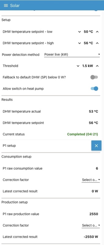

we hebben hier trouwens weer een overvloed aan warm water.....
Vannacht is weer de Solar functie geactiveerd. Blijkbaar om 02:00u een reset en dan gaat hij los?
15/04 04:49:43 - Function Pump speed: 1
15/04 04:21:41 - MQTT Command: SetHeatpump: 0 (rtc on/off)
15/04 04:21:39 - Function RTC: on/off activated - Turn off power (Room temp: 19.19°C)
15/04 04:20:55 - MQTT Command: SetQuietMode: 3 (unknown)
15/04 04:20:53 - Quiet mode manager: Detected 3-way valve set to HEAT position again. Restoring quiet mode to level 3
15/04 04:20:52 - MQTT Command: SetMaxPumpDuty: 96 (unknown)
15/04 04:20:52 - Compressor: stopped
15/04 04:20:52 - Function SoftStart Quietmode: Compressor run ended, quiet mode set to level 3 for next run
15/04 04:20:52 - Function Pump speed: reduced to 96 (17%)
15/04 04:20:38 - MQTT Command: SetOperationMode: 0 (Solar)
15/04 04:20:36 - Function Solar: DHW temperature reached DHW SP High. Restored previous OperatingMode: 0
15/04 02:51:05 - Function SoftStart Quietmode: Timer ended, quiet mode is already set to level 0
15/04 02:49:42 - Function Pump speed: 1
15/04 02:31:05 - MQTT Command: SetMaxPumpDuty: 104 (unknown)
15/04 02:31:05 - Compressor: running
15/04 02:31:05 - Function SoftStart Quietmode: Timer started (20 minutes)
15/04 02:31:05 - Function Pump speed: restored to: 104 (21%)
15/04 02:28:12 - MQTT Command: SetZ1HeatRequestTemperature: 32 (SP Calculation)
15/04 02:28:08 - MQTT Command: SetQuietMode: 0 (QuietMode Manager)
15/04 02:28:06 - Quiet mode manager: Detected 3-way valve set to DHW. Disabling the quiet mode function during DHW. Restored to level 0
15/04 02:27:52 - MQTT Command: SetHeatpump: 1 (Solar)
15/04 02:00:55 - MQTT Command: SetOperationMode: 4 (unknown)
15/04 02:00:54 - MQTT Command: SetDHWTemp: 56 (Solar)
15/04 02:00:53 - Function Solar: Operation mode changed from 0 to 4
15/04 02:00:53 - Function Solar: triggered threshold (kW). DHW SP to 56
15/04 02:00:08 - MQTT Command: SetHeatpump: 1 (unknown)
15/04 02:00:08 - MQTT Command: SetOperationMode: 4 (Solar)
15/04 02:00:06 - Function Solar: Operation mode changed from 0 to 4
15/04 02:00:00 - MQTT Command: SetDHWTemp: 50 (function RTC)
15/04 02:00:00 - Function Solar: New day; Reset Solar function. Set DHW SP to 50

Wat zijn je instellingen van de Solar functie?

edterbak schreef op zaterdag 15 april 2023 @ 15:26:
Afbeeldingslocatie: https://tweakers.net/i/6ohIQk3jC7u3kVtlZAxkYxuSOO8=/x800/filters:strip_icc():strip_exif()/f/image/BmgPwsRgZ8EeZOyDAHjtLYTS.jpg?f=fotoalbum_large
  • edterbak
  • Laatst online: 02-09 21:20
Ghehehe ..
Je hebt een positieve threshold.
Levering is negatief zoals in de grafiek
Je wil daar -1.5 kW hebben. Altijd onder 0
Ik zal de bovengrens wel -0,1 maken
[ Voor 31% gewijzigd door edterbak op 15-04-2023 21:01 ]

edterbak schreef op zaterdag 15 april 2023 @ 16:00:
Ghehehe ..
Ik zal de bovengrens wel 0,1 maken
Aha, tja….. dat was niet helemaal duidelijk. Idd, zou maar 1 kant van de 0 op hoeven te kunnen.
[ Voor 0% gewijzigd door blb4 op 15-04-2023 19:15 . Reden: 2 = 1 ]
  • edterbak
blb4 schreef op zaterdag 15 april 2023 @ 19:08:
Aha, tja….. dat was niet helemaal duidelijk. Idd, zou maar 2 kant van de 0 op hoeven te kunnen.
Wat bedoel je precies ?
  • blb4
  • Laatst online: 04-09 15:27
Euhh… ik bedoelde dus 1 kant vd 0. Maar oplossing is prima, grid -> huis (levering) = positief, huis -> grid (teruglevering = negatief. Kwestie van definitie.
Blijft toch implementatieafhankelijk, er is in de markt geen consensus hoe dit moet.
[ Voor 37% gewijzigd door blb4 op 15-04-2023 19:19 ]
  • edterbak
Okay, ik heb wat aangepast aan de solar functie.
De grafiekjes aangevuld met de threshold waarde. Dus je ziet nu netjes een grijs lijntje in de grafiek die van toepassing is voor je threshold.
De help text is nu aangepast. De bovengrens van de threshold is -0,1 om vergissingen te voorkomen. (Sorry voor de slordige fout van mijn test werk @blb4 )
Morgen na de dhw run kijk ik of deze versie geupload kan worden.
Vandaag was het resultaat dat de logica nog niet 100% goed werkte. Ik hoop het morgen dus wel juist te zien.
Hoop morgen dus wat te kunnen bieden.
Maar, heeft er iemand nog gekeken of ervaring opgedaan met de nieuwe Scheduler optie???
Om het setpoint aan te kunnen passen.
  • blb4
edterbak schreef op zaterdag 15 april 2023 @ 20:40:
Geen probleem @edterbak, als ik geen problemen wil hebben moet ik geen beta sw draaien ;) . En juist door 't testen door verschillende mensen met verschillende ideeen/uitgangspunten/gebrek aan kennis wordt 't resultaat alleen maar beter.
Ik heb totaal niet naar die scheduler opties gekeken, met Solar en Cool al genoeg aan m'n hoofd, er moet ook nog gefietst worden 8). Ik heb er wel even mee gespeeld, de eerste indruk is dat 't allemaal goed in te stellen is maar ik heb er geen use-case voor.
Grappig, over verschillende verwachtingen:
Ik dacht laat ik eens bij de Menu Config een aantal pagina's uitzetten die ik niet gebruik. Dus ik selecteer de pagina's die ik niet wil zien en vervolgens zie ik dus alleen die pagina's..... |:( .
[ Voor 13% gewijzigd door blb4 op 15-04-2023 21:18 . Reden: laatste toevoeging ]

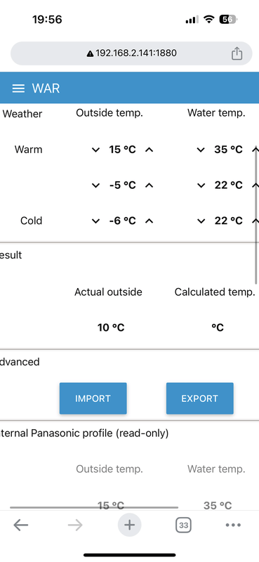

edterbak schreef op zondag 16 april 2023 @ 19:04:
Op dit moment (jouw versie) laat alleen de lijn zien bij DHW, als DHW modus ook geselecteerd is. Ik had gisteren hier al licht wat aan verbouwd. Toevallig. Nu zie je altijd het SP en PV, los van de stand van de 3-weg klep.
Thanks. Net even de Panasonic control unit op Direct gezet & WAR ingeschakeld. (Heb eerst een import gedaan van de instellingen)

Ik check nog even de WAR settings maar klopt dit wel?
Lijkt wel of de temperaturen verwisseld zijn:
-5 = 22°
+15 = 35°
En calculated is leeg.
Afbeeldingslocatie: https://tweakers.net/i/NWaBHkTtDkeHqwIGHJXhGGuN3ZI=/x800/filters:strip_exif()/f/image/oPlyclkHOEyLCcI6Bnwf2IXP.png?f=fotoalbum_large

  • edterbak
@Crazy-
Welke versie heb je geinstalleerd?
22.00 stable
of de laatste beta?
Het is sowieso goed om te weten wat je operating mode is.
Heb je de pomp in direct modus staan, of in compensation curve modus.
De laatste zorgt er voor dat de WAR functie in node red uit gaat. (bewust)
De lijn hoort er zo uit te zien.
Afbeeldingslocatie: https://tweakers.net/i/EFGBf0Ns6RKzGHgoKwnUxXTvokw=/800x/filters:strip_exif()/f/image/QRat9ny03FSXDu0TPhnA4Y1c.png?f=fotoalbum_large

edterbak schreef op zondag 16 april 2023 @ 20:00:
@Crazy-
22.00 stable
of de laatste beta?
Staat op Direct modus. WAR kan ik nu ook activeren.
De grafiek is inderdaad omgedraaid nu; dit kwam nadat ik Import had gekozen (voor ik hem op direct had gezet)
12,85kWp - ZB 7,5m2/400l - 5kW Pana H WP (CV&SWW) - 13,8kWh accu
  • edterbak
Okay,
Die staat ook nog op mijn to-do lijstje.
Ik ben bezig het variabelen hernoemen. Ook deze wilde ik hernoemen, en gelijk 100% controle geven of het klopt. Had al een vermoede dat het niet helemaal klopte..
Het kan geen kwaad als je het zelf corrigeerd in GUI, dan doet hij het gewoon.
Tis alleen niet handig voor nieuwe gebruikers. Hmm. :|

edterbak schreef op zondag 16 april 2023 @ 20:12:
Okay,
Versie 22 trouwens.
Net even de parameters voor WAR ingesteld; grafiek is nu goed. De “cold” kant stond foutief nog
De calculated temperatuur blijft echter leeg
[ Voor 43% gewijzigd door Crazy- op 16-04-2023 20:28 ]

  • edterbak
Waar stuur je de temperatuurmeting heen?
kun je de output de debug node op je temperatuur meting (buiten temperatuur sensor die je gebruikt) hier plakken in een stukje [ code ]
edit/
vraag 1
welke buiten temperatuur sensor gebruik je?
[ Voor 15% gewijzigd door edterbak op 16-04-2023 20:41 ]

edterbak schreef op zondag 16 april 2023 @ 20:40:
edit/
vraag 1
Ah wacht. Moet nog 1 sensor instellen inderdaad… heb nog 3x een DS aan de WP gehangen; nog ff koppelen ;)

  • edterbak
Voor de war functie kun je de standaard buitensensor gebruiken van de panasonic.
als je niks doet, dan gebruikt de node red flow deze automatisch.
Als je dit te slecht vind, like me, dan kun je je custom sensor gebruiken. Zodra deze verbonden wordt, word deze automatisch herkend en gebruikt voor de WAR functie.
En, het kan zijn dat je even op de pijltjes omhoog/omlaag moet drukken op Home dashboard.

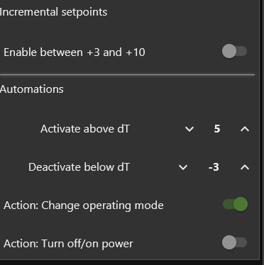

Afbeeldingslocatie: https://tweakers.net/i/klfsU-VCORhZVpvPaICA7vLR_1A=/full-fit-in/4000x4000/filters:no_upscale():fill(white):strip_exif()/f/image/lK77zNUlxd99kihgQIuw462d.png?f=user_large
Dit zijn mijn instellingen momenteel, overdag geen problemen in de nacht wanneer de watertemperatuur lager 18 graden wordt gaat die over op war

@Pietjebel10 je hebt on/off niet aan staan en dus zal ie altijd zelf bepalen of ie aan of uit moet. Op basis van de delta tussen Ta en Tr.
Wil je dat niet, zul je met on/off aan de gang moeten.
Vind overigens de omschrijvingen activate below en deactivate above niet heel eenduidig op dit moment.
[ Voor 51% gewijzigd door MikeyMan op 17-04-2023 15:27 ]

@Pietjebel10
Active above dT 5.
Dit is de temperatuur waarboven de actie wat doet.
De acties zijn:
1: Change operation mode
2: turn off/on power
2 is duidelijk lijkt mij.
1 is dat de HEAT modus uit de huidige modus gehaald wordt.
Dus die "Active above dT 5." doet pas wat als het 5 graden warmer is in je woonkamer tov je setpoint :D
Is wat warm denk ik.
Ik denk dat als je die temperatuur juist insteld, zou het goed moeten komen.
Hoe warm wordt het binnen dan?

Je hebt +5 en -3 ingesteld staan.
Uitgaande van een kamer setpoint van 19 graden houdt dat in dat er bij 24 wordt uitgeschakeld en bij 16 wordt ingeschakeld.
Zie ook de rtc grafiek.

Nooit naar die grafiek gekeken, ben even aan het schuiven gegaan, wordt duidelijk, duurt even maar dan heb je ook wat. 8)7 |:( :*) :*)
  • edterbak
Pietjebel10 schreef op maandag 17 april 2023 @ 16:28:
Pas gelijk even die temperatuur range aan.
Custom -1.6 >>> +10
Ik denk niet dat die +10C heter water door je systeem handig is.
Ik zou die -1.6 lager zetten. -2 ofzo -3
Als de kamertemperatuur hier onder duikt, dan gaat hij als eenmalle de boel verwarmen met 10C extra warm water.

Vanmiddag een solar run gehad, volgens 't boekje (teruglevering > 1,5 kW).
In de logging nog een schoonheidsfoutje (of 2); (function RTC) en (unknown) bij inschakelen, bij uitschakelen staat 't wel goed (Solar):
17/04 17:27:11 - MQTT Command: SetOperationMode: 0 (Solar)
17/04 17:27:09 - Function Solar: DHW temperature reached DHW SP High. Restored previous OperatingMode: 0
17/04 15:42:19 - Compressor: running
17/04 15:39:13 - MQTT Command: SetOperationMode: 4 (unknown)
17/04 15:39:07 - MQTT Command: SetZ1HeatRequestTemperature: 34 (SP Calculation)
17/04 15:38:58 - MQTT Command: SetHeatpump: 1 (unknown)
17/04 15:38:56 - MQTT Command: SetDHWTemp: 56 (function RTC)

@blb4 wat je zou kunnen doen is ff positieve waarde invullen bij teruglevering, dan heb je gewoon weer netjes in de nacht een solarrun :+
