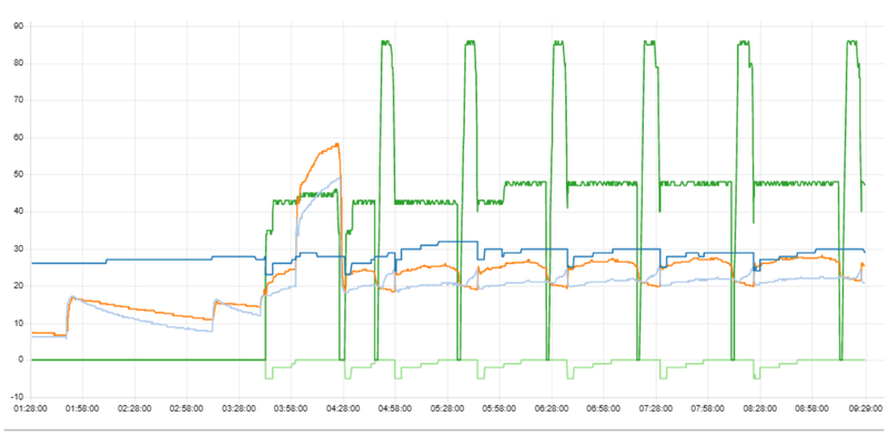

OKay, lekker veel defrosts gehad de afgelopen 24h.
Ik heb er nu aardig wat om te oordelen of de compressor uit/aan/uit zal gaan TIJDENS een defrost.
Hier dus het gedrag van mijn pomp.
Afbeeldingslocatie: https://tweakers.net/i/dCecT8VIoRarPFZJafSUp3x8pgc=/800x/filters:strip_exif()/f/image/EiSQop7IjGEkTJpwevQXoOtG.png?f=fotoalbum_large
Hier het log van alle 8 gevallen.
24
25
26
27

1:
02/03 01:46:25 - Compressor: running
02/03 01:46:25 - Function SoftStart: Correction: 0 > -1 °C - (STARTUP) Freq: 50Hz, SP_Final: 28°C
02/03 01:46:20 - *DEFROSTING: Finished
02/03 01:36:15 - MQTT Command: SetZ1HeatRequestTemperature: 29 (SoftStart)
02/03 01:36:15 - Function SoftStart: Defrost - Correction: 0
02/03 01:36:00 - *DEFROSTING: Started
2:
02/03 03:03:31 - Compressor: running
02/03 03:03:26 - *DEFROSTING: Finished
02/03 02:54:26 - MQTT Command: SetZ1HeatRequestTemperature: 29 (SoftStart)
02/03 02:54:26 - Function SoftStart: Defrost - Correction: 0
02/03 02:53:56 - *DEFROSTING: Started
3:
02/03 04:12:52 - Compressor: running
02/03 04:12:52 - MQTT Command: SetZ1HeatRequestTemperature: 28 (SoftStart)
02/03 04:12:52 - Function SoftStart: Correction: 0 > -1 °C - (STARTUP) Freq: 50Hz, SP_Final: 28°C
02/03 04:12:47 - *DEFROSTING: Finished
02/03 04:03:27 - MQTT Command: SetZ1HeatRequestTemperature: 29 (SoftStart)
02/03 04:03:27 - Function SoftStart: Defrost - Correction: 0
02/03 04:03:07 - *DEFROSTING: Started
4:
02/03 05:21:13 - MQTT Command: SetZ1HeatRequestTemperature: 28 (SoftStart)
02/03 05:21:13 - Compressor: running
02/03 05:21:13 - Function SoftStart: Correction: 0 > -1 °C - (STARTUP) Freq: 51Hz, SP_Final: 28°C
02/03 05:21:08 - *DEFROSTING: Finished
02/03 05:11:58 - MQTT Command: SetZ1HeatRequestTemperature: 29 (SoftStart)
02/03 05:11:58 - Function SoftStart: Defrost - Correction: 0
02/03 05:11:43 - *DEFROSTING: Started
5:
02/03 06:30:19 - Compressor: running
02/03 06:30:14 - MQTT Command: SetZ1HeatRequestTemperature: 28 (SoftStart)
02/03 06:30:14 - Function SoftStart: Correction: 0 > -1 °C - (STARTUP) Freq: 51Hz, SP_Final: 28°C
02/03 06:30:09 - *DEFROSTING: Finished
02/03 06:19:54 - MQTT Command: SetZ1HeatRequestTemperature: 29 (SoftStart)
02/03 06:19:54 - Function SoftStart: Defrost - Correction: 0
02/03 06:19:54 - *DEFROSTING: Started
6:
02/03 07:42:50 - Compressor: running
02/03 07:42:40 - *DEFROSTING: Finished
02/03 07:33:05 - MQTT Command: SetZ1HeatRequestTemperature: 29 (SoftStart)
02/03 07:33:05 - Function SoftStart: Defrost - Correction: 0
02/03 07:32:45 - *DEFROSTING: Started
7:
02/03 08:50:06 - Compressor: running
02/03 08:49:56 - MQTT Command: SetZ1HeatRequestTemperature: 28 (SoftStart)
02/03 08:49:56 - Function SoftStart: Correction: 0 > -1 °C - (STARTUP) Freq: 51Hz, SP_Final: 28°C
02/03 08:49:56 - *DEFROSTING: Finished
02/03 08:40:01 - MQTT Command: SetZ1HeatRequestTemperature: 29 (SoftStart)
02/03 08:40:01 - Function SoftStart: Defrost - Correction: 0
02/03 08:39:51 - *DEFROSTING: Started
8:
02/03 12:05:13 - Compressor: running
02/03 12:04:59 - *DEFROSTING: Finished
02/03 12:01:44 - MQTT Command: SetZ1HeatRequestTemperature: 28 (SP Calculation)
02/03 12:01:44 - Function WAR: Setpoint change: From 29 to 28 °C
02/03 11:53:18 - Function SoftStart: Defrost - Correction: 0
02/03 11:52:38 - *DEFROSTING: Started
Ik zie dus geen enkele keer dat de compressor uit gaat tijdens een defrost.
Is dit gedrag dus daadwerkelijk anders bij sommigen??
Ik probeer niet een punt te maken, maar te begrijpen of het starten/stoppen tijdens defrost een symptoom is van een issue, of niet.
Ik ben benieuwd naar jullie ervaring.
  • blb4
edterbak schreef op donderdag 2 maart 2023 @ 13:17:
Ik zie de compressor in die grafiek toch echt 2 x naar 0 gaan. Daartussendoor ff aan, dat is de defrost.
update: plaatje toegevoegd.
Afbeeldingslocatie: https://tweakers.net/i/M5Jwp6cRFAsMAqzpCaIbGig3uvM=/x800/filters:strip_exif()/f/image/NgUMUd1FuKDgbtOzw5M4us0h.png?f=fotoalbum_large
[ Voor 16% gewijzigd door blb4 op 02-03-2023 16:50 . Reden: plaatje toegevoegd ]
  • gerard053
  • Laatst online: 15:38
blb4 schreef op donderdag 2 maart 2023 @ 13:37:
@edterbak : Wat doet je Operations_Counter? Die telt de compressor starts toch.

  • MikeyMan
  • Laatst online: 17:07
MikeyMan
Vidi, Vici, Veni
Volgens mij zijn de pieken de defrosts toch? ;)
  • edterbak
  • Laatst online: 08-10 19:25
de eerste piek = defrost
de tweede piek = start na defrost.
  • MikeyMan
MikeyMan
Vidi, Vici, Veni
edterbak schreef op donderdag 2 maart 2023 @ 15:10:
Ja, dan pakt de mijne dat toch een beetje anders aan.
De piek is veel hoger, en daarna gaat ie op oude voet verder.
Maar T-Cap handelt sowieso de defrosts anders af dan de rest :)

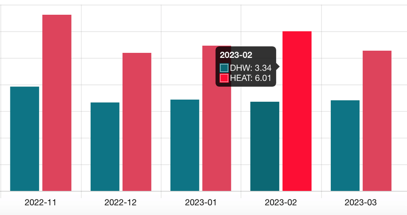

edterbak schreef op vrijdag 3 maart 2023 @ 11:18:
Ik heb dit:
DHW: 3.34
HEAT: 6.02
@edterbak ben jij toevallig mijn buurman ofzo :w. Waardes zitten wel heel dicht bij elkaar.

Links een SS na een DF en rechts een SS na een start.
Na de DF zie ik een SS verhoging die niet in mijn setting bereik past. Klopt het nu dat als gevolg van de SS +1C (of +2C) ik een response zie in de Compressor frequentie en de Water Outlet temperatuur?
Of is het andersom, dat SS plot een resultaat is van een water temperatuur berekening (dat snap ik dan niet echt, maar de programmeur weet vast wel wat er gaande is :*) ).
Afbeeldingslocatie: https://tweakers.net/i/H8_Qs4lkU88i2-0G0jkYd5N_lfE=/full-fit-in/4000x4000/filters:no_upscale():fill(white):strip_exif()/f/image/vgFc1b7dQOApsbp3eyp932Wa.png?f=user_large

  • gerard053
edterbak schreef op vrijdag 3 maart 2023 @ 21:19:
Wat is je vraag nu precies?
Wil je weten wat de logica is, hier de berekening van setpoint gedaan word of alleen begrijpen wat je ziet in de grafiek?
Sowieso is geen van beide grafieken na een defrost. Beide grafieken hebben een lange horizontale streep op de 0 lijn.
Je hebt helemaal gelijk, heb verkeerde snapshot erbij gepakt 8)7
Laat ik het proberen duidelijk te maken aan de hand van dit plaatje.
Afbeeldingslocatie: https://tweakers.net/i/ZlTup-k17BVSg0iJ9LgsBK_n9HE=/800x/filters:strip_exif()/f/image/qNp5IpsNsKiYsfWgvo4oYo58.png?f=fotoalbum_large
Ik heb 3 overshoots gemarkeerd die lijken samen te vallen (lastig met de beperkte resolutie, mis het inzoomen): SS piekje, water outlet temperatuur die piekt en de compressor frequentie die piekt.
Komt de compressor frequentie overshoot van de SS correctie van +2C? Zo ja, dan lijkt me dat de begrenzing niet zo werkt als ik default heb ingesteld.
Je hebt het al kort beantwoord, maar het kwartje valt nog niet bij mij ..

  • edterbak
Ah. Okay.
Hoe de pomp zelf werkt normaal gesproken. Stel even de situatie zonder softstart.
Setpoint is 29c
De pomp start, frequentie gaat omhoog.
De pomp houd de frequentie hoog tot hij ziet dat er reactie is op het uitgaande of terug komende water.
Als de retour temperatuur richting sp gaat dan gaat de pomp terug regelen, frequentie stapsgewijs naar beneden.
Ook houd de pomp in de gaten of van het uitgestuurd water Ta niet te hoog word. Dit laatste is een indicatie dat de warmte in het water niet voldoende afgegeven kan worden in de woning.
Softstart aan
Zodra de pomp aan gaat, verlaagt de functie het setpoint. Hierdoor proberen we de pomp zo snel mogelijk te laten denken dat hij kan terug regelen.
Voorwaarde, interne regeltjes van Panasonic, zegt dat het verschil tussen setpoint en Ta niet te groot mag zijn. Anders stopt hij weer (compressor uit) omdat hij denkt dat de warmte niet afgegeven kan worden.
Daarom heb ik de regel toegevoegd dat dit verschil niet groter mag zijn dan 1c gedurende de eerste 180 seconden.
Dus, die +2 die je even ziet komt doordat de uitgaande temperatuur even omhoog schiet. De softstart functie volgt deze temperatuur en laat het setpoint even mee schuiven zodat de pomp niet uit valt.
Zodra deze temperatuur weer daalt zal het setpoint ook mee dalen.
Is dit een duidelijk verhaal dat je helpt?
  • gerard053
edterbak schreef op vrijdag 3 maart 2023 @ 22:54:
Ah. Okay.
Setpoint is 29c
Softstart aan
Top, nu is het me duidelijk waarom SS de temperatuur volgt. _/-\o_

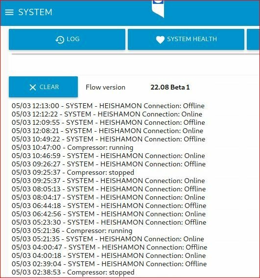

  • Hieke
Zie veel mooie grafieken van Node-Red dashboard i.c.m. Heishamon. Wat opvalt is dat er geen/nauwelijks haperingen zijn in het MQTT-verkeer waardoor er veel details in grafieken te zien zijn. En ook meer data getoond wordt. Zoals compressorfrequentie.
Hier een plaatje van temperatuur in het Node-Red dashboard.
Afbeeldingslocatie: https://tweakers.net/i/RekHriukieKumg8bQTGPypYBmx4=/800x/filters:strip_icc():strip_exif()/f/image/kh4IEXzFlKwxODgNKZdFX4jb.jpg?f=fotoalbum_large
Hier is dat wel anders... En ik hoop dat jullie daar verklaring voor hebben en/of advies in kunnen geven.
Firmware is versie 3.1
Het Wifi-verkeer lijkt niet gehinderd; signaalsterkte schommelt volgens Heishamon rond de 66%. Aantal MQTT-reconnects is laag?
Afbeeldingslocatie: https://tweakers.net/i/Tp54um8W1CM2E7quR1P74eBc1KQ=/full-fit-in/4920x3264/filters:max_bytes(3145728):no_upscale():strip_icc():fill(white):strip_exif()/f/image/E2W1kYf2zEKNGYoUMLthK1hu.jpg?f=user_large
Een stukje uit de log van het dashboard in Node-Red laat wel wat reconnects zien. Afbeeldingslocatie: https://tweakers.net/i/7OK-MGp7tIGyerQE5Nz0sWUJJwU=/full-fit-in/4920x3264/filters:max_bytes(3145728):no_upscale():strip_icc():fill(white):strip_exif()/f/image/b9MUVn66MEuRDiYKwI8QABKX.jpg?f=user_large
Maar is dat reconnect met wifi /MQTT of tussen Heishamon en de warmtepomp?
Want dit soort plaatjes zijn wat teleurstellend..
Afbeeldingslocatie: https://tweakers.net/i/MBjgIH8m3ytuBDPw5h1jrahnPU4=/800x/filters:strip_icc():strip_exif()/f/image/tyhDkUZCzfOtXBcN66Qg8MQn.jpg?f=fotoalbum_large
Betreft een split unit met WH-UD07JE5 en WH-ADC0309J3E5C
En eigenlijk wel benieuwd of dit een wifi-probleem is. Heb geen accesspoint dat ik er ff bij kan leggen. Node-Red, InfluxDB, Grafana en Domoticz draaien op een Raspberry Pi 4 met 2 GB.
Met belangstelling.

  • The-Source
  • Laatst online: 14:53
@Hieke het gaat hier om de wifi communicatie.
Het zou kunnen dat je HM wellicht op 1 wifi kanaal is gelockt? En als je meer dan 1 AP hebt dan zou hij op de verkeerde gelockt kunnen zijn.
Als de HM geen wifi meer heeft creert hij zelf een open AP Heishamon genaamd als ik het goed hierinner.

  • Hieke
@The-Source : dank voor reactie. Was wat onzeker vanwege de term SYSTEM - Heishamon in de logfile...
Er zijn hier geen accesspoints aanwezig. Alle draadloze devices verbinden de KPN router.
Heb zojuist in de settings van Heishamon gekeken.. Enig idee welke setting dit beïnvloedt?
Afbeeldingslocatie: https://tweakers.net/i/1u99lNSePyyHppf2pM6J6irxo-I=/800x/filters:strip_icc():strip_exif()/f/image/LbPsRftCmIkHCwcSQbnk51GZ.jpg?f=fotoalbum_large
Erg druk heeft de router het ook niet. Met arp -a op de RPI vind ik maar 4 devices..
Situatie betreft vrijstaande woning.. Slechts 2 à 3 SSID's zichtbaar op smartphone.
Afstand tussen router en Heishamon is zo'n 5 meter..
De Heishamon bevindt zich in PVC-kastje, bevestigd aan de muur boven de binnenunit en met orgineel meegeverde 5-aderige kabel, -> geen kooi van Faraday.
Zou de instelling mbt ListenOnly er mee te maken kunnen hebben? De CZ-TAW1 (op 1 meter naast de Heishamon) geeft geen verbindingsproblemen.
Benieuwd hoe anderen de stabiliteit van wifi ervaren of hebben verbeterd. _/-\o_
PS: deze RPI draait nu nog even op SD-card.. Ben met corrupte kaartjes bekend.;)

@Hieke denk dat je beter in het Heishamon topic kunt navragen. Dit heeft niet zo veel met de node red flow te maken.
  • The-Source
@Hieke heb je wel een static DHCP reservering gemaakt voor je HM? Idem voor je RPI als deze op DHCP staat.
Nu zal op listenOnly het niet extreem van belang zijn want de HM zal geen waardes pushen naar je WP.
heb je dat haartje als screenshot meegenomen ;)

@Hieke
Waar heb je de heishamon moduele zitten? In de pomp? of buiten de pomp ? in je huis?
ah.... :O

MikeyMan schreef op maandag 6 maart 2023 @ 12:31:
Dank voor suggestie. Zal ik doen.

The-Source schreef op maandag 6 maart 2023 @ 12:36:
Voor al dit soort devices is reservering gemaakt.
Dat haartje is een imperfectie van Teamviewer. :-( Soms ben ik beetje gemakzuchtig, ipv VNC over vpn..

edterbak schreef op maandag 6 maart 2023 @ 14:05:
@Hieke
ah.... :O
Soms kan teveel aan info ook contraproductief zijn. Toch bedankt voor het meedenken. _/-\o_

Nou... Ik durf er echt niks over te zeggen:
Afbeeldingslocatie: https://tweakers.net/i/XIGJF95uzZNARhkq5251IvqFDBI=/800x/filters:strip_exif()/f/image/hyIC6SVEhZE1TMZXtNS4RIwN.png?f=fotoalbum_large
Nogal een zooitje.

Moet screenshot op mobiel maken omdat ik dit typ op werklaptop...
Afbeeldingslocatie: https://tweakers.net/i/pWj1Zk0L8-p366Rj2b9jZxAlwwc=/full-fit-in/4920x3264/filters:max_bytes(3145728):no_upscale():strip_icc():fill(white):strip_exif()/f/image/k4vCwxQS0no5B5OHXa0H6Wvu.jpg?f=user_large
Hij pruttelt nog steeds zoals die dat al sinds 2:00 doet.

Je ziet hier nu toch wel het effect van de softstart terug komen, ondanks het onhandige weer.
Afbeeldingslocatie: https://tweakers.net/i/_aBzIzJMN4Ql3kq8x2h6KN0ppj4=/full-fit-in/4000x4000/filters:no_upscale():fill(white):strip_exif()/f/image/W4BqVWw1vyAydaQU6yEv7BtJ.png?f=user_large
Lijkt erop dat ie hem toch iets te snel los laat weer?
[ Voor 4% gewijzigd door MikeyMan op 08-03-2023 14:55 ]

MikeyMan schreef op woensdag 8 maart 2023 @ 14:55:
Ik heb niet het gevoel dat wat je ziet (stijging hz) veroorzaakt wordt door de softstart.
Probeer het eens zonder softstart?

edterbak schreef op woensdag 8 maart 2023 @ 15:04:
Denk het wel toch? Valt samen met het wegvallen van de verlaging van het setpoint... In ieder geval op het oog.
Maar zal hem even uit zetten, het weer blijft redelijk consistent vandaag.
[ Voor 3% gewijzigd door MikeyMan op 08-03-2023 15:06 ]

MikeyMan schreef op woensdag 8 maart 2023 @ 15:05:
Als dat zo is zou ik de functie niet eens gebruiken.
edit
misschien dat zonder softstart de Hz al hoger begint. Ik ben benieuwd.
[ Voor 9% gewijzigd door edterbak op 08-03-2023 15:08 ]

edterbak schreef op woensdag 8 maart 2023 @ 15:07:
That's not the spirit. Dan moeten we nog een beetje verder sleutelen aan de settings. :+
Ik denk dat ie hem in de eerste drie minuten voldoende in bedwang houdt, daarna lijkt het op te lopen.
Wellicht had ie anders vanaf het begin hoger gelopen. Gaan we straks zien ;)

Eerste drie runs zijn degene van hierboven. Daarna Softstart uit gezet. Oordeel zelf :)
Afbeeldingslocatie: https://tweakers.net/i/pgj1asZGUTco4s0lgxYemodjWGE=/800x/filters:strip_exif()/f/image/Zw6kfXrQDVOAxsxLgU6C8Yfn.png?f=fotoalbum_large
Overigens zit de RTC constant op -2. Dus de WAR maar weer iets gedrukt...
Een grafiekje met de RTC correctie zou hier wellicht bij helpen, maar eens wat knutselen ;)

MikeyMan schreef op woensdag 8 maart 2023 @ 19:35:
Het lijkt wel positief toch, het effect van softstart. Maar ook niet dramatisch veel effect bij jou. Valt mij toch stiekum wat tegen.

edterbak schreef op woensdag 8 maart 2023 @ 20:24:
Ja lijkt idd wel iets te doen. Maar die tcap is toch een ander setje kabouters.
Suggesties wat ik zou kunnen proberen nog qua settings?

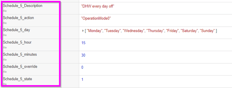

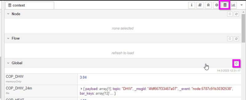

Hi het is al weer een tijdtje stil hier, maar goed ik heb mogelijk een fout gevonden in de scheduler. ik had er meerdere instaan verspreid over de dag.
Op een gegeven moment ben ik ze gaan verwijderen maar heb ze niet eerst disabled.
de lijst van de scheduler is schoon dus dan verwacht je ze niet meer.
Nu veel het mij op dat de panasonic nachts dhw`s had gedaan en dat laat ik na het verwijderen van de regels in de scheduler door de warmtepompboiler oplossen.
Niet nodig dus
Nu was het de bedoeling de panasonic op de RTC met de on /off functie te doen.
En na de aandacht op de dhw viel het mij op dat die ook nog op een oude regel voor HEAT om 6:00 start onder de noemer warm huis bij opstaan.
Die bestaat dus ook nog ondanks niet meer zichtbaar.
Als ik een systemcheck doe dan geeft die aan dat er geen schedules staan maar onder de kap start die ze wel op.
Ik heb voor vanacht mijn oude regel maar weer aangemaakt nodered flow gerestart en netjes disabled voor delete van de regel.
Als die nu vanacht niks meer doet dan was het dit.
Als die nou weer gaat spoken om exact dezelfde tijd dan zie ik mij weer genoodzaakt de global context dir. te wissen.

Balans schreef op maandag 13 maart 2023 @ 14:11:
Niet nodig dus
He, dat is vreemd inderdaad. Ik ga kijken of in de scheduler misschien de oude variabelen zijn blijven steken. Die haal ik er gelijk uit dan.

  • Balans
  • Laatst online: 07-10 22:32
Afbeeldingslocatie: https://tweakers.net/i/11kOp3lC-0QSv3jlqhMPMhn8wbQ=/800x/filters:strip_icc():strip_exif()/f/image/8mPGesFB5VIh1ZbFGgrXfoXC.jpg?f=fotoalbum_large
jammer die DHW van 04:00 valt net weg , maar je ziet dat de heat ook om 06:00 wordgestart
Afbeeldingslocatie: https://tweakers.net/i/9GcdZmKP_UoVL_jQzJ3Ysj5sByo=/800x/filters:strip_icc():strip_exif()/f/image/7DzLzY37NHFoO8hUFa49CMhL.jpg?f=fotoalbum_large
in de scheduler staan ze toch echt uit

  • edterbak
Balans schreef op dinsdag 14 maart 2023 @ 15:44:
Nou, toevallig heb ik net zitten kijken hier naar.
Die prullebakjes halen daadwerkelijk de geprogrameerde zaken weg.
de scheduler zou daarmee eigenlijk dus niet meer KUNNEN werken.
Kun je in het log boek kijken of je de uitgestuurde commando's kunt zien?
Ik vind het een vaag verhaal aan het worden namelijk.
Iets dat ik zie dat niet kan, zeg je dat er wel gebeurt. 8)7 8)7

Aanvullend, kun je rechtstreeks de variabelen bekijken voor me?
Afbeeldingslocatie: https://tweakers.net/i/c7pajh52U0bylhY_B39rhtygtZw=/800x/filters:strip_exif()/f/image/kU0wksMYed9QxtnT73g7NZ7J.png?f=fotoalbum_large
Afbeeldingslocatie: https://tweakers.net/i/U-Ul7S7oPlA6naiNzpyCncxB_hA=/800x/filters:strip_exif()/f/image/3xJBDhszKGZDUu29QMIj582r.png?f=fotoalbum_large
  • Balans
ik heb net wat resten weg zitten gooien uit de context data, daar stonden ze dus nog in zelfs dubbel omdat ik ze weer had aan gemaakt indentiek dus. na verwijdering vanuit de scheduler bleven ze dus wel achter ondanks dat de naam, tijd en opdracht het zelfde was.
hier een knip uit het log

  • edterbak
Pietjebel10 schreef op dinsdag 14 maart 2023 @ 16:02:

Hmm. controleer maar voor de zekerheid of uit zetten voldoende is. Ik weet dat het 'vroeger' niet voldoende was. de automations moeten ook uit.

False informatie.
  • Balans
edterbak schreef op dinsdag 14 maart 2023 @ 16:07:
Dat zegt niks. die persistent check is niet operationeel helaas. heb ik ook nu nog geen oplossing voor.
False informatie.
A ok schijnveiligheid , hoe check ik dan dat het goed is ik heb de howto gevolgd draai alles uit dockers

  • edterbak
Balans schreef op dinsdag 14 maart 2023 @ 16:31:
Gheheh .
Reboot en kijken of je rtc grafiek terug komt...
Nee. Je kunt zien in die lijst rechts hoe de variabelen opgeslagen worden
Als het goed is zie je bij de global variabelen voor 90% "file" er bij staan en niet"memoryOnly"
  • Balans
nou de verhouding 90/10 ga ik niet halen denk eerder 70/30
