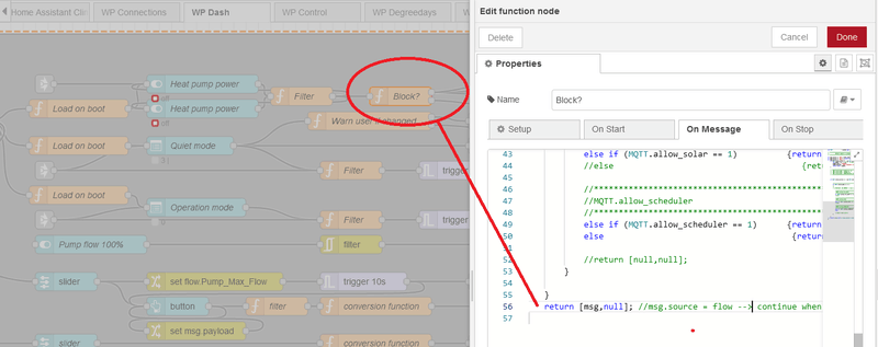

  • edterbak
  • Laatst online: 05-07 16:20
Node ID: 751fec2ce6f8faac
Node name: Block MQTT
if (msg.payload == 1) {
    msg.payload = "MQTT-Commands to HP will be blocked!";
    global.set('MQTT.block_active', 1, "file");
    if (msg.source != "shutdown_detection"){
        global.set('MQTT.block_mode', 1, "file");
[ Voor 9% gewijzigd door edterbak op 09-01-2023 01:15 ]

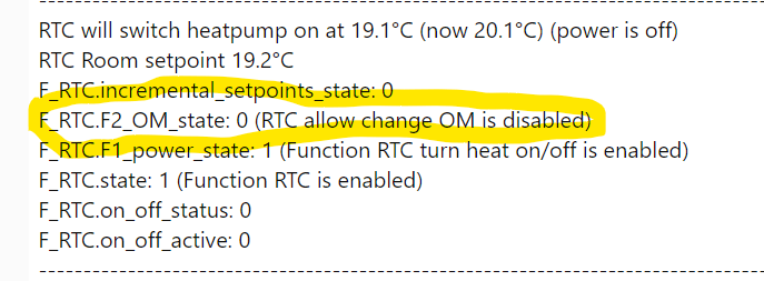

  • Maarten69
  • Registratie: Augustus 2022
Dit is na herstart NR. Gaat al fout bij WP aanzetten via GUI:
24
25
26
27
28
29
30
31
32
33
34
35
36
37
Flow version
21.43 beta (experimental)
09/01 10:18:48 - Function RTC: on/off activated - Turn off power (Room temp: 20.5°C)
09/01 10:18:45 - RTC: Room setpoint changed to: 20 °C
09/01 10:17:21 - MQTT Command - SetZ1HeatRequestTemperature: 26
09/01 10:17:21 - Function SoftStart: Correction: 0 > -2 °C - (STARTUP) Freq: 21Hz, SP_Final: 26°C
09/01 10:17:21 - Compressor: running
09/01 10:15:00 - Function RTC: Operation mode to Heat only
09/01 10:14:21 - CONTROLLER: Manual ON detected. (Wallmounted unit)
09/01 10:14:11 - CONTROLLER: Manual OFF detected. (Wallmounted unit) - Default action used: Unrestricted
09/01 10:14:11 - SYSTEM: MQTT-Commands to HP will be sent normally.
09/01 10:14:11 - CONTROLLER: Manual ON detected. (GUI)
09/01 10:14:11 - MQTT Command - SetHeatpump: 1
09/01 10:13:31 - SYSTEM - HEISHAMON Connection: Online
09/01 10:13:30 - Function - SoftStart Quietmode: ON (Timer: 5 min, Restore level 0)
09/01 10:13:30 - Function - SoftStart: 1
09/01 10:13:30 - Function - RTC: 1
09/01 10:13:27 - SETUP - Sensors: Custom room temperature sensor FOUND and used
09/01 10:13:24 - Function - WAR: 1
09/01 10:13:22 - SYSTEM: WAR settings OK
09/01 10:13:22 - Function SoftStart: Compressor Inactive - Correction: 0
09/01 10:13:22 - Function WAR: Setpoint change: From 30 to 28 °C
09/01 10:13:22 - SETUP - Sensors: Custom outside temperature sensor FOUND and used
09/01 10:13:21 - Compressor: stopped
09/01 10:13:21 - Function NightReduction: New correction: 0 °C
09/01 10:13:21 - SYSTEM: Heatpump is in DIRECT mode
09/01 10:13:21 - Function NightReduction: 0
09/01 10:13:21 - Function Pump speed: 0
09/01 10:13:21 - SYSTEM - HEISHAMON Connection: Offline
09/01 10:13:21 - SYSTEM: Start---------------------------------------------------------------
als laatste verlaag ik het room setpoint naar 20 graden om rtc_off te triggeren, maar er wordt geen MQTT verstuurd.
[ Voor 13% gewijzigd door Maarten69 op 09-01-2023 10:42 ]

  • edterbak
Maarten69 schreef op maandag 9 januari 2023 @ 10:10:
Bij mij is die ook altijd leeg.
@blb4 ik heb ook problemen met RTC on/off functie. Hij verstuurd niet altijd een MQTT-commando.
Ik ga eerst NR herstarten voordat ik wat roep.
Daar heb ik toevallig in v21.43 iets aan verandert. Ik merkte dit namelijk ook. Het is een 'halve' oplossing.
Ik heb na de functie rtc on/off het filter weggehaald.
Ik wil daarna (straks) wel verder onderzoeken of een custom filter nodig is. (kijken naar wat de huidige waarde is, en dan beslissen of uitzenden nodig is...)

  • Maarten69
Ik stel voor versie terug te gaan want nu werkt het (bij mij) helemaal niet.
Ik zie dat je de MQTT block zelfs in de function RTC Automation geïntegreerd hebt.
Volgens mij maak je het te complex op deze manier.
Mijn originele block had 6 regels code, nu zitten we op 56 regels en verspreid over meerdere nodes.
Het moet simpel blijven: Block? zend geen MQTT's wat de flow verder doet is bijzaak.
Al probeert een functie elke minuut een HeatRequest te sturen, block --> jammer dan.
Zo zie ik het.
Ik ga nu zelf terug naar eerdere versie.

EDIT: Ik heb het probleem met niet aan/uit schakelen door RTC Turn power off/on gevonden :)
Hier moet regel 56 komen:
Afbeeldingslocatie: https://tweakers.net/i/sNOBbKkSp_x4YVl_pms9-_WY3c4=/800x/filters:strip_exif()/f/image/WpQFoJEKSc2I4BUdoTGAANNv.png?f=fotoalbum_large
Ja dat was het :)
Edit2 (let op, mocht je dit zelf aanpassen er staat daaronder nog een }
Ben weer blij :)
09/01 16:53:43 - MQTT Command - SetHeatpump: 0
09/01 16:53:43 - Function RTC: on/off activated - Turn off power (Room temp: 20.5°C)
09/01 16:53:40 - RTC: Room setpoint changed to: 20 °C
09/01 16:53:22 - MQTT Command - SetHeatpump: 1
09/01 16:53:22 - Function RTC: on/off - Turn on power (Room temp: 20.5°C)
09/01 16:53:19 - RTC: Room setpoint changed to: 21 °C
[ Voor 74% gewijzigd door Maarten69 op 09-01-2023 16:55 ]

@Maarten69
moet omcirkelde functie niet veranderen als je in RTC action: change operation mode veranderd?
Afbeeldingslocatie: https://tweakers.net/i/aUhYeWYnXnag0H2UvSLZjk6_T58=/full-fit-in/4000x4000/filters:no_upscale():fill(white):strip_exif()/f/image/E551VhP9ZG3jkuLuS2yb5NET.png?f=user_large
