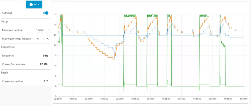

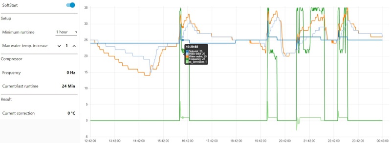

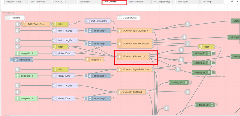

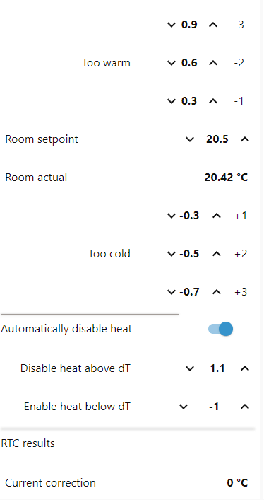

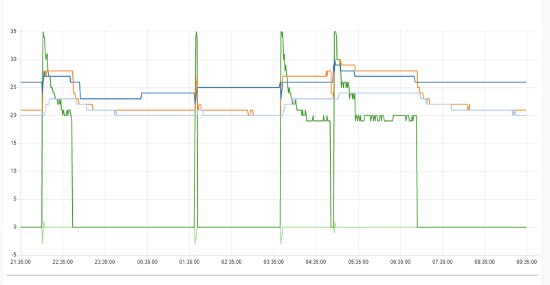

  • djoenez
  • Laatst online: 08:14
zo, de RPI waar HA en node red opdraait herstart. nu al een dag geen 3-4 z1 sets per uur.
Zie nog steeds wel dat de softstart soms wel en soms niet de warmtepomp rustig krijgt. zie hier een voorbeeld van hoe hij hem wel lekker rustig kan houden (run van 2 u):
24
25
26
27
28
29
30
31
32
33
34
35
36
37
38
04/11 02:29:31 - Function SoftStart: Correction: 1 > 0 °C - (STABLE) Freq: 19Hz, Tout: 27°C
04/11 02:29:22 - MQTT Command - SetZ1HeatRequestTemperature: 27
04/11 02:29:21 - Function SoftStart: Correction: 0 > 1 °C - (STABLE) Freq: 19Hz, Tout: 28°C
04/11 02:29:11 - MQTT Command - SetZ1HeatRequestTemperature: 26
04/11 02:29:11 - Function SoftStart: Correction: 1 > 0 °C - (STABLE) Freq: 19Hz, Tout: 27°C
04/11 02:29:01 - MQTT Command - SetZ1HeatRequestTemperature: 27
04/11 02:29:01 - Function SoftStart: Correction: 0 > 1 °C - (STABLE) Freq: 19Hz, Tout: 28°C
04/11 02:28:42 - MQTT Command - SetZ1HeatRequestTemperature: 26
04/11 02:28:42 - Function SoftStart: Correction: 1 > 0 °C - (STABLE) Freq: 20Hz, Tout: 27°C
04/11 02:28:42 - MQTT Command - SetZ1HeatRequestTemperature: 27
04/11 02:28:41 - Function SoftStart: Correction: 0 > 1 °C - (STABLE) Freq: 19Hz, Tout: 28°C
04/11 02:00:24 - Function WAR: T_outside is not valid. Waiting for correct value.
04/11 01:53:46 - MQTT Command - SetZ1HeatRequestTemperature: 26
04/11 01:53:46 - Function SoftStart: Correction: -1 > 0 °C - (STABLE) Freq: 19Hz, Tout: 27°C
04/11 01:53:07 - MQTT Command - SetZ1HeatRequestTemperature: 25
04/11 01:53:07 - Function SoftStart: Correction: 0 > -1 °C - (STABLE) Freq: 20Hz, Tout: 26°C
04/11 01:53:06 - MQTT Command - SetZ1HeatRequestTemperature: 26
04/11 01:53:06 - Function SoftStart: Correction: -1 > 0 °C - (STABLE) Freq: 19Hz, Tout: 27°C
04/11 01:52:57 - MQTT Command - SetZ1HeatRequestTemperature: 25
04/11 01:52:57 - Function SoftStart: Correction: 0 > -1 °C - (STABLE) Freq: 20Hz, Tout: 26°C
04/11 01:52:56 - MQTT Command - SetZ1HeatRequestTemperature: 26
04/11 01:52:56 - Function SoftStart: Correction: -1 > 0 °C - (STABLE) Freq: 19Hz, Tout: 27°C
04/11 01:52:37 - MQTT Command - SetZ1HeatRequestTemperature: 25
04/11 01:52:37 - Function SoftStart: Correction: 0 > -1 °C - (STABLE) Freq: 20Hz, Tout: 26°C
04/11 01:52:36 - MQTT Command - SetZ1HeatRequestTemperature: 26
04/11 01:52:36 - Function SoftStart: Correction: -1 > 0 °C - (STABLE) Freq: 19Hz, Tout: 27°C
04/11 01:38:26 - MQTT Command - SetZ1HeatRequestTemperature: 25
04/11 01:38:26 - Function SoftStart: Correction: -2 > -1 °C - (STABLE) Freq: 19Hz, Tout: 26°C
04/11 01:38:21 - MQTT Command - SetZ1HeatRequestTemperature: 24
04/11 01:38:21 - Function SoftStart: Correction: -1 > -2 °C - (STABLE) Freq: 20Hz, Tout: 25°C
04/11 01:38:16 - MQTT Command - SetZ1HeatRequestTemperature: 25
04/11 01:38:16 - Function SoftStart: Correction: -2 > -1 °C - (STABLE) Freq: 19Hz, Tout: 26°C
04/11 01:32:56 - MQTT Command - SetZ1HeatRequestTemperature: 24
04/11 01:32:56 - Function SoftStart: Correction: -3 > -2 °C - (STABLE) Freq: 27Hz, Tout: 25°C
04/11 01:30:26 - MQTT Command - SetZ1HeatRequestTemperature: 23
04/11 01:30:26 - Function SoftStart: Correction: 0 > -3 °C - (STARTUP) Freq: 18Hz, Tout: 21°C
04/11 01:30:19 - MQTT Command - SetZ1HeatRequestTemperature: 26
04/11 01:30:19 - Function WAR: Setpoint change: From 27 to 28 °C

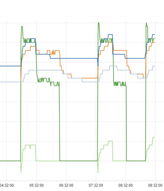

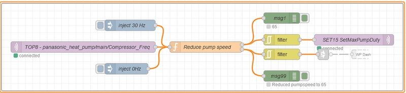

En zonet blijft de WP maar op 30Hz draaien, en is de softstart niet de correctie naar beneden aan het aanpassen:
04/11 10:34:42 - MQTT Command - SetZ1HeatRequestTemperature: 31
04/11 10:34:42 - Function SoftStart: Correction: 2 > 3 °C - (STABLE) Freq: 30Hz, Tout: 30°C
04/11 10:34:28 - MQTT Command - SetZ1HeatRequestTemperature: 30
04/11 10:34:28 - Function SoftStart: Correction: 3 > 2 °C - (STABLE) Freq: 30Hz, Tout: 29°C
04/11 10:34:27 - MQTT Command - SetZ1HeatRequestTemperature: 31
04/11 10:34:27 - Function SoftStart: Correction: 2 > 3 °C - (STABLE) Freq: 31Hz, Tout: 30°C
04/11 10:29:57 - MQTT Command - SetZ1HeatRequestTemperature: 30
04/11 10:29:57 - Function SoftStart: Correction: 0 > 2 °C - (STABLE) Freq: 30Hz, Tout: 29°C
04/11 10:28:43 - MQTT Command - SetZ1HeatRequestTemperature: 28
04/11 10:28:43 - Function SoftStart: Correction: 1 > 0 °C - (CATCH) Freq: 31Hz, Tout: 28°C
04/11 10:28:42 - MQTT Command - SetZ1HeatRequestTemperature: 29
04/11 10:28:42 - Function SoftStart: Correction: 0 > 1 °C - (CATCH) Freq: 30Hz, Tout: 29°C
04/11 10:28:27 - MQTT Command - SetZ1HeatRequestTemperature: 28
04/11 10:28:27 - Function SoftStart: Correction: -1 > 0 °C - (CATCH) Freq: 32Hz, Tout: 28°C
04/11 10:28:07 - MQTT Command - SetZ1HeatRequestTemperature: 27
04/11 10:28:07 - Function SoftStart: Correction: -2 > -1 °C - (CATCH) Freq: 35Hz, Tout: 27°C
04/11 10:28:02 - MQTT Command - SetZ1HeatRequestTemperature: 26
04/11 10:28:02 - Function SoftStart: Correction: -3 > -2 °C - (CATCH) Freq: 34Hz, Tout: 26°C
04/11 10:27:27 - MQTT Command - SetZ1HeatRequestTemperature: 25
04/11 10:27:27 - Function SoftStart: Correction: 0 > -3 °C - (STARTUP) Freq: 20Hz, Tout: 24°C
04/11 10:27:02 - MQTT Command - SetZ1HeatRequestTemperature: 28

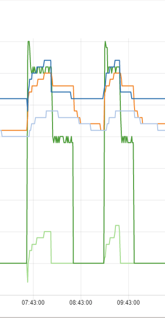

(ik snap dat dit niet heel lang is, maar bij de eerste heeft hij hem in een paar minuten op 19hz, past hij na 7 minuten niets meer aan).
@edterbak , weet jij waar dit aan zou kunnen liggen? soms gaat hij heel mooi z'n correctie aanpassen naar beneden totdat hij 19hz draait, en soms doet softstart niets en blijft de WP lekker 30hz draaien.
[ Voor 9% gewijzigd door djoenez op 04-11-2022 17:02 ]

@MikeyMan @edterbak
Nadeel van die quite mode is dat bij iets lagere temperaturen dit echt zorgt voor meer defrost is m'n ervaring van vorig jaar. Met 15 graden buiten nu uiteraard geen last van.

Hij loopt hier momenteel totaal vast. Tenminste.. z1heatcommando per seconde. Heb heel node red uit moeten zetten. Reboot hielp niet.

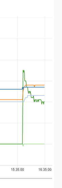

Ik draai nu al een tijdje met versie 20.78. Ik dacht ik doe even niks meer totdat de temp buiten wat gaat zakken.
Nou vanavond was het eindelijk wat kouder. Het is hier nu 5 graden buiten. Dus ik hopen op wat langere runs.
Bij 5 graden buiten staat mijn water temp op 25 graden. Krijg het tot nu toe prima warm met deze lage water temp. Draait nog steeds met quiet mode 3 om het toerental van de compressor te drukken.
Ik zie alleen in de logs nog steeds vrij korte runs met toch een frequentie van 35Hz. Maar ook de laatste dagen wel runs gezien waarbij hij wel direct terug regelt naar 19Hz en daar ook blijft.
Maar in onderstaande log, de 3e run, loopt hij een tijde op een goede 20Hz. Om een of andere reden besluit hij vervolgens toch weer op 35Hz te gaan draaien.
Afbeeldingslocatie: https://tweakers.net/i/Wa-zNaoe2p7YF7bZUIrggDK-DHA=/800x/filters:strip_icc():strip_exif()/f/image/iCwyYCmIiinnJAWjrNGLdGMy.jpg?f=fotoalbum_large
Iemand nog ideeën om hem toch verder terug te laten regelen?
Misschien is dit gewoon een eigenschap van de 9Kw T-Cap, dat kan natuurlijk ook.
Is de water temp misschien te laag? Of moet ik hem nog verder verlagen? Wat is wijsheid...
  • edterbak
  • Laatst online: 28-03 14:27
@fietsensloper
volgens mij heb je in setting tab de heat delta op 3 staan.
zet deze eens op 2?
heat delta is max temp verschil tussen in/uit water. hoe groter je dit maakt, hoe groter de deltaT mag worden, hoe harder hij zijn best mag doen.
heat delta groot = efficienter voor pomp
heat delta klein = comfortabel/stabiel
je kan ook kijken naar je max pump flow.
wat is deze nu?
het is een spelletje met warmtebalans. maar dat is best complex nog.
[ Voor 16% gewijzigd door edterbak op 05-11-2022 01:31 ]

  • Aikon
@edterbak Mijn Setpoint is 20, en de Disable heat above dT is 0,5. Moet 'ie dan afslaan bij 20,5 of 20,6?
[edit]
05/11 15:53:02 - MQTT Command - SetHeatpump: 0
05/11 15:52:57 - MQTT Command - SetHeatpump: 0
En dat gebeurde bij 20,2 of 20,3 graden...
[ Voor 41% gewijzigd door Aikon op 05-11-2022 15:58 ]
  • fietsensloper
  • Registratie: Oktober 2022
  • Laatst online: 21-11-2025
@edterbak De heat delta staat al een paar weken op 2, ook om het vermogen wat te drukken en langere runs te halen. Was natuurlijk lastig met die hoge buiten temperaturen van de laatste weken.
Hier nog even weer een log van afgelopen nacht.
Afbeeldingslocatie: https://tweakers.net/i/318f5eRjQDe2nGTsKT54rsZ1hHY=/800x/filters:strip_exif()/f/image/wpcDB7Titydxe0ZYmMXS2lGS.png?f=fotoalbum_large
De max pompflow staat op 27L/min. Hij kan als ik hem op 100% instel 43L/min draaien over het buffervat.
Ik begrijp gewoon niet waarom hij soms wel verlaagd naar 19Hz, en soms tot het einde van de run blijft draaien op 35Hz.

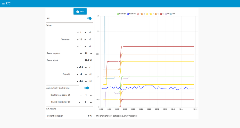

  • Maarten69
  • Registratie: Augustus 2022
@edterbak Ik zit nu op de laatste versie.
Alles gewist, zelfs de contextdata op schijf verwijderd.
Na herstart Node Red flow geïmporteerd en gedeployed.
RTC on/off werkt niet. (WP aan en uitzetten)
Enig idee hoe ik dit het beste kan debuggen?
Alle settings nagelopen, moeten goed staan.
Hier RTC dashboard:
Afbeeldingslocatie: https://tweakers.net/i/0M6MWDx9Rb11jgq8E54xCBVm_OM=/800x/filters:strip_exif()/f/image/eLS5M6bOWnCvaN3oPYwkvr3v.png?f=fotoalbum_large
En hier gehele lijst met contextdata:

en log bij eerste start:
05/11 16:07:09 - Function - RTC: 1
05/11 16:07:09 - Function WAR: Setpoint change: From 20 to 28 °C
05/11 16:07:06 - Function - WAR: 1
05/11 16:07:04 - Function - SoftStart: 1
05/11 16:05:01 - SETUP - Sensors: Custom room temperature sensor FOUND
05/11 16:04:28 - Function - SoftStart: 0
05/11 16:04:28 - Function - RTC: 0
05/11 16:04:25 - SYSTEM: WAR settings OK
05/11 16:04:23 - SETUP - Sensors: Custom room temperature sensor reset.
05/11 16:04:23 - Function - WAR: 0
05/11 16:04:22 - MQTT Command - SetDHWTemp: 52
05/11 16:04:23 - SYSTEM - HEISHAMON Connection: Online
05/11 16:04:20 - Function WAR: Imported TOP32 from Panasonic (Z1_Heat_Curve_Outside_Low_Temp)
05/11 16:04:20 - Function WAR: Imported TOP31 from Panasonic (Z1_Heat_Curve_Outside_High_Temp)
05/11 16:04:20 - Function WAR: Imported TOP30 from Panasonic (Z1_Heat_Curve_Target_Low_Temp)
05/11 16:04:20 - Function WAR: Imported TOP29 from Panasonic (Z1_Heat_Curve_Target_High_Temp)
05/11 16:04:20 - Function WAR: Profile temperatures are not correctly set in the dashboard. Waiting for Panasonic import or user input
05/11 16:04:20 - SETUP - Sensors: Custom outside temperature sensor FOUND and used
05/11 16:04:19 - Function NightReduction: New correction: 0 °C
05/11 16:04:19 - MQTT Command - SetHeatpump: 0
05/11 16:04:19 - SYSTEM: Heatpump is in DIRECT mode
05/11 16:04:19 - SYSTEM - HEISHAMON Connection: Offline
05/11 16:04:19 - SYSTEM: Start---------------------------------------------------------------
8680 Wp, Panasonic Mono-bloc J-Generation WH-MDC07J3E5 1-fase 7kW. Heishamon v3.2.3 , NRflow *custom* , Home Assistant + " kamaradclimber / heishamon-homeassistant", Kaifa MA105 + Shelly PRo 3EM (120A), 3x Marstek 5,12kW v151, lilygo-modbus-485 HA

Gaat toch wederom iets echt niet goed hier momenteel:

Logs
Flow version 20.89
05/11 20:25:05 - MQTT Command - SetZ1HeatRequestTemperature: 25
05/11 20:25:00 - MQTT Command - SetZ1HeatRequestTemperature: 25
05/11 20:25:00 - Function RTC: Correction change: From 1 to 0 °C
05/11 20:15:00 - MQTT Command - SetZ1HeatRequestTemperature: 26
05/11 20:14:55 - MQTT Command - SetZ1HeatRequestTemperature: 26
05/11 20:14:55 - Function RTC: Correction change: From 2 to 1 °C
05/11 20:09:55 - MQTT Command - SetZ1HeatRequestTemperature: 27
05/11 20:09:53 - MQTT Command - SetZ1HeatRequestTemperature: 27
05/11 20:09:53 - Function SoftStart: Correction: 6 > 0 °C - (ENDING) Freq: 31Hz, Tout: 30°C
05/11 20:03:15 - MQTT Command - SetZ1HeatRequestTemperature: 33
05/11 20:03:10 - MQTT Command - SetZ1HeatRequestTemperature: 33
05/11 20:03:10 - Function SoftStart: Correction: 5 > 6 °C - (STABLE) Freq: 30Hz, Tout: 30°C
05/11 20:03:00 - MQTT Command - SetZ1HeatRequestTemperature: 32
05/11 20:02:55 - MQTT Command - SetZ1HeatRequestTemperature: 32
05/11 20:02:55 - MQTT Command - SetZ1HeatRequestTemperature: 33
05/11 20:02:55 - Function SoftStart: Correction: 6 > 5 °C - (STABLE) Freq: 31Hz, Tout: 29°C
05/11 20:02:50 - MQTT Command - SetZ1HeatRequestTemperature: 33
05/11 20:02:50 - Function SoftStart: Correction: 5 > 6 °C - (STABLE) Freq: 30Hz, Tout: 30°C
05/11 20:02:40 - MQTT Command - SetZ1HeatRequestTemperature: 32
05/11 20:02:35 - MQTT Command - SetZ1HeatRequestTemperature: 32
05/11 20:02:35 - Function SoftStart: Correction: 6 > 5 °C - (STABLE) Freq: 31Hz, Tout: 29°C
05/11 20:02:00 - MQTT Command - SetZ1HeatRequestTemperature: 33
05/11 20:01:55 - MQTT Command - SetZ1HeatRequestTemperature: 33
05/11 20:01:55 - Function SoftStart: Correction: 5 > 6 °C - (STABLE) Freq: 30Hz, Tout: 30°C
05/11 19:54:39 - Function SoftStart: Correction: 6 > 5 °C - (STABLE) Freq: 31Hz, Tout: 29°C
05/11 19:54:39 - Function RTC: Correction change: From 1 to 2 °C
05/11 19:52:55 - MQTT Command - SetZ1HeatRequestTemperature: 32
05/11 19:52:50 - MQTT Command - SetZ1HeatRequestTemperature: 32
05/11 19:52:50 - Function SoftStart: Correction: 5 > 6 °C - (STABLE) Freq: 30Hz, Tout: 29°C
05/11 19:52:40 - MQTT Command - SetZ1HeatRequestTemperature: 31
05/11 19:52:35 - MQTT Command - SetZ1HeatRequestTemperature: 31
05/11 19:52:35 - Function SoftStart: Correction: 6 > 5 °C - (STABLE) Freq: 31Hz, Tout: 28°C
05/11 19:52:20 - MQTT Command - SetZ1HeatRequestTemperature: 32
05/11 19:52:15 - MQTT Command - SetZ1HeatRequestTemperature: 32
05/11 19:52:15 - Function SoftStart: Correction: 5 > 6 °C - (STABLE) Freq: 31Hz, Tout: 29°C
05/11 19:45:39 - MQTT Command - SetZ1HeatRequestTemperature: 31
05/11 19:45:35 - MQTT Command - SetZ1HeatRequestTemperature: 31
05/11 19:45:34 - Function SoftStart: Correction: 4 > 5 °C - (STABLE) Freq: 31Hz, Tout: 28°C
05/11 19:44:04 - MQTT Command - SetZ1HeatRequestTemperature: 30
05/11 19:44:00 - MQTT Command - SetZ1HeatRequestTemperature: 30
05/11 19:43:59 - MQTT Command - SetZ1HeatRequestTemperature: 31
05/11 19:43:59 - Function SoftStart: Correction: 5 > 4 °C - (STABLE) Freq: 30Hz, Tout: 27°C
05/11 19:43:54 - MQTT Command - SetZ1HeatRequestTemperature: 31
05/11 19:43:54 - Function SoftStart: Correction: 4 > 5 °C - (STABLE) Freq: 31Hz, Tout: 28°C
05/11 19:42:24 - MQTT Command - SetZ1HeatRequestTemperature: 30
05/11 19:42:20 - MQTT Command - SetZ1HeatRequestTemperature: 30
05/11 19:42:19 - Function SoftStart: Correction: 3 > 4 °C - (STABLE) Freq: 34Hz, Tout: 27°C
05/11 19:41:34 - MQTT Command - SetZ1HeatRequestTemperature: 29
05/11 19:41:29 - MQTT Command - SetZ1HeatRequestTemperature: 29
05/11 19:41:29 - Function SoftStart: Correction: 2 > 3 °C - (CATCH) Freq: 34Hz, Tout: 27°C
05/11 19:40:39 - MQTT Command - SetZ1HeatRequestTemperature: 28
05/11 19:40:35 - MQTT Command - SetZ1HeatRequestTemperature: 28
05/11 19:40:35 - MQTT Command - SetZ1HeatRequestTemperature: 27
05/11 19:40:34 - Function SoftStart: Correction: 1 > 2 °C - (CATCH) Freq: 34Hz, Tout: 26°C
05/11 19:40:30 - MQTT Command - SetZ1HeatRequestTemperature: 27
05/11 19:40:29 - Function SoftStart: Correction: 0 > 1 °C - (CATCH) Freq: 35Hz, Tout: 25°C
05/11 19:40:19 - MQTT Command - SetZ1HeatRequestTemperature: 26
05/11 19:40:15 - MQTT Command - SetZ1HeatRequestTemperature: 26
05/11 19:40:15 - MQTT Command - SetZ1HeatRequestTemperature: 25
05/11 19:40:14 - Function SoftStart: Correction: -1 > 0 °C - (CATCH) Freq: 34Hz, Tout: 24°C
05/11 19:40:10 - MQTT Command - SetZ1HeatRequestTemperature: 25
05/11 19:40:10 - MQTT Command - SetZ1HeatRequestTemperature: 24
05/11 19:40:09 - Function SoftStart: Correction: -2 > -1 °C - (CATCH) Freq: 32Hz, Tout: 23°C
05/11 19:40:05 - MQTT Command - SetZ1HeatRequestTemperature: 24
05/11 19:40:04 - Function SoftStart: Correction: -3 > -2 °C - (CATCH) Freq: 29Hz, Tout: 22°C
05/11 19:39:54 - MQTT Command - SetZ1HeatRequestTemperature: 23
05/11 19:39:49 - MQTT Command - SetZ1HeatRequestTemperature: 23
05/11 19:39:49 - Function SoftStart: Correction: 0 > -3 °C - (STARTUP) Freq: 20Hz, Tout: 21°C
05/11 19:39:34 - MQTT Command - SetZ1HeatRequestTemperature: 26
05/11 19:39:32 - MQTT Command - SetZ1HeatRequestTemperature: 26

Vandaag een paar mooie runs gezien:
Afbeeldingslocatie: https://tweakers.net/i/khwi9NwyUmEED6E5OTRZsbggvoY=/full-fit-in/4000x4000/filters:no_upscale():fill(white):strip_exif()/f/image/lmb9yT9Kf5jIRE26nNIANMo1.png?f=user_large
Blijf het wel apart vinden dat ie pas na 30 minuten terug schakelt naar een mooi laat toerental.
Zojuist de Softstart naar 20 minuten gezet, kijken of ik dat terug ga zien.
  • MikeyMan
  • Laatst online: 28-03 14:55
MikeyMan
Vidi, Vici, Veni
Kortere softstart = korter op hogere toeren:
Afbeeldingslocatie: https://tweakers.net/i/xoE4KsnL4jRwZi-tcM1eRFqQPsI=/full-fit-in/4000x4000/filters:no_upscale():fill(white):strip_exif()/f/image/sYtGeNPNqrojxeZODBuaGmJF.png?f=user_large
Op 20 min blijft ie 20 minuten op 30+ hangen alvorens terug te schakelen.
Lijkt enigszins averechts te werken.
Nu kijken wat er op 10 minuten gebeurt.
[ Voor 5% gewijzigd door MikeyMan op 07-11-2022 10:44 ]

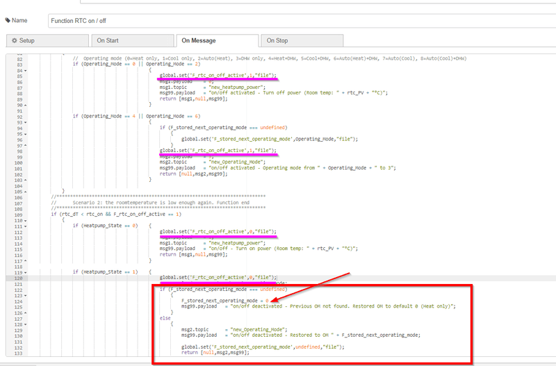

Blijf het bijzonder vinden dat jullie dit niet ervaren.
Vraag: wat hoort deze waarde te zijn bij een nieuwe/schone start?
var F_stored_next_operating_mode    = global.get('F_stored_next_operating_mode',"file");
             if (F_stored_next_operating_mode === undefined) {
                    return null;
  • MikeyMan
MikeyMan
Vidi, Vici, Veni
Maarten69 schreef op maandag 7 november 2022 @ 13:19:
RTC (aan/uit) werkt bij niet omdat bij een schone start F_stored_next_operating_mode undefined is.
Dus verder als die regel zal de functie niet komen.
                    return null;
Punt is dat als de verwarming en RTC goed hun werk doen, dat je niet zo makkelijk buiten de ingestelde waardes komt.
Heb hem al erg krap staan eerlijk gezegd:
Afbeeldingslocatie: https://tweakers.net/i/v2sHbJ2GN-lidT2DXnhcU3tK-u4=/full-fit-in/4000x4000/filters:no_upscale():fill(white):strip_exif()/f/image/bqtBGRNnjG7cWqA7CtxqJSKz.png?f=user_large
Kan hem nog krapper zetten, maar binnen de parameters van de RTC instellen lijkt me geen representatieve test.
  • Maarten69
@MikeyMan Ik snap je antwoord niet. Laat ik het nog een keer uitleggen:
De variabele F_stored_next_operating_mode is bij een eerste installatie undefined.
De functie (function node: Function RTC on / off) checked op deze waarde.
Als deze waarde dus undefined is (en dat is hij bij schone installatie) dan exit hij uit deze functie.
Heeft niets met instellingen te maken van de RTC.

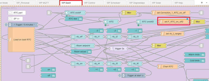

Mijn RTC (aan/uit) fix (Graag bevestiging door @edterbak): Misschien kan @Aikon het testen?
Fix 1/2:
in onderstaande function node:
Afbeeldingslocatie: https://tweakers.net/i/z6merwXhkkvQMGkE7O8q_eMgPRw=/800x/filters:strip_exif()/f/image/gI5uDWqLNQHwOnvGWEo4ClT3.png?f=fotoalbum_large
Dit aanpassen: (rond regel 64)
                //return null;
                 global.set('F_stored_next_operating_mode', 0, "file"); //Default to HEAT if undefined     **fix**
Fix 2/2:
In onderstaande function node:
Afbeeldingslocatie: https://tweakers.net/i/1h0-NQLLodnWerMWbCMCzMFgHzE=/800x/filters:strip_exif()/f/image/k9PPtyGkMREIolmvCXEeB0ct.png?f=fotoalbum_large
De 3de regel toevoegen:
msg.topic = "Function - RTC turn off/on pump";
global.set("F_RTC_on_off2", msg.payload, "file");
global.set('F_rtc_on_off_active', msg.payload, "file"); //bugfix
return msg;
@edterbak Ik weet dat het nu werkt, maar weet niet of het helemaal juist is om bij het omzetten van de RTC pomp aan/uit schakelaar de variabele F_rtc_on_off_active te zetten.
[ Voor 6% gewijzigd door Maarten69 op 07-11-2022 14:20 ]

@edterbak nu met 0 graden watertemp op 30 minuten:
Afbeeldingslocatie: https://tweakers.net/i/dywq5DWj4esZLmWNynJcSr55nn4=/full-fit-in/4000x4000/filters:no_upscale():fill(white):strip_exif()/f/image/n0F0dSmGNkhLcQKvH3tSaQ3q.png?f=user_large

Feature request: pompsnelheid bij compressor aan en uit. Als de compressor is afgeslagen heb ik het liefst dat de waterpomp kalmpjes alles beetje rondpompt, terwijl als de compressor aanstaat hij het opgewekte vermogen moet kwijt raken. Geen haast, maar verbeterd wel de algehele COP!
  • Aikon
Als je de Pana in Direct modus gebruikt blijft de pomp continue lopen in Heat modus. Bij mij doorgaans op laag niveau, 10l/min.
Het water rondpompen zonder de compressor aan kost in principe alleen maar rendement/COP, want je bent eigenlijk je warmte weer naar buiten aan het pompen deels.
Wat is je vraag nu precies of kan je hier al iets mee?
  • MikeyMan
MikeyMan
Vidi, Vici, Veni
Aikon schreef op maandag 7 november 2022 @ 17:34:
Ik denk dat @djoenez bedoelt dat als er geen heat mode draait hij de pompsnelheid verder wil beperken.
Compressor aan: duty cycle @ 50%
Compressor uit: duty cycle @ 5%
Of noem eens een zijstraat.
Of het snel genoeg gaat om de compressor niet te snel op te laten warmen is vers twee.
[ Voor 6% gewijzigd door MikeyMan op 07-11-2022 17:54 ]
  • djoenez
MikeyMan schreef op maandag 7 november 2022 @ 17:53:
Precies! Ik heb hem in direct mode staan, de waterpomp draait nu altijd 13 l/min, met een stroomverbruik van 80w (extern gemeten). Ik heb liever dat als de compressor niet draait de waterpomp de helft of nog minder rondpompt, tot dat de compressor weer aanslaat.
  • Maarten69
djoenez schreef op maandag 7 november 2022 @ 19:05:
Lijkt me niet heel moeilijk om te implementeren. Ik zal even kijken of ik dat voor je kan maken.

  • edterbak
Maarten69 schreef op maandag 7 november 2022 @ 14:16:
Fix 1/2:
                //return null;
Fix 2/2:
return msg;
Ik ga er nu gelijk naar kijken. duik er goed in :)
  • Aikon
Oh ja, dat is al eens voorbij gekomen @djoenez , waarbij ik me verbaasde over het hoge verbruik van je pomp. Mijne verbruikt 20 watt bij 10l/min, ook extern gemeten.
Wat verbruikt je pomp als die minimaal draait?
  • MikeyMan
MikeyMan
Vidi, Vici, Veni
Vraag me alleen wel af hoeveel het verbruik daadwerkelijk daalt als ie er bijvoorbeeld 1.3 liter per minuut draait.
Lastige is overigens wel dat je alleen kunt sturen op pump duty. Wat in elke installatie tot een ander resultaat leidt.
Zou je eventueel op kunnen vangen met een high en low instelling, maar wel iets wat enigszins proefondervindelijk moet.
[ Voor 19% gewijzigd door MikeyMan op 07-11-2022 19:14 ]
  • edterbak
Fix 1/2:
                //return null;
Die fix is helemaal niet nodig. F_stored_next_operating_mode moet alleen opgehaald worden. Als deze leeg is, dan is dat hier prima. Alleen later in de functie lastig omdat hij wel gebruikt wordt. Ik ben niet zo een voorstander om de default heat in te bouwen. Maar het is wel een oplossing voor die zeldzame situatie. Ik denk dat ik deze oplossing verplaats naar beneden en zodoende er een melding in het log kan laten verschijnen. Zodoende is men zich bewust van de standaard waarde die ingevuld is dit keer.
Fix 2/2:
return msg;
Ik begrijp niet waarom je F_rtc_on_off_active wilt programeren. Ik denk dat je daar een fout ergens in ziet.
Maar het doel van de toggle er voor is het aan/uit zetten van deze functie, het on/off gedeelte. Als je de toggle AAN zet, dan wordt er een 1 gestuurd. Met jouw logica zeg je dus dat
variabele F_RTC_on_off2 = 1
variabele F_rtc_on_off_active = 1.
Die laatste is niet juist. Deze variabelle gebruik ik om aan te geven dat de functie (rtc_on/off) ook daadwerkelijk geactiveerd is. dus de temperatuur is boven de rtc_off grens.
Ik ga even kijken verder.
OH, haahahaha. :) nee dus.
Kun je aangeven waarom je deze variabele F_rtc_on_off_active wilt vullen?
  • edterbak
@Maarten69
Dit is wat ik er nu van gemaakt heb om jouw situatie nu eens en voor altijd op te lossen.
Afbeeldingslocatie: https://tweakers.net/i/VnYNRvVZVIF1ebUs6Q3WBCFjd8M=/800x/filters:strip_exif()/f/image/WFQIb7aRcDTQwWe9NuNQGeS3.png?f=fotoalbum_large
die F_rtc_on_off_active die wordt dus aan en uit gezet in de functie.
dit zou 100% goed moeten zijn, mits de functie dus altijd goed doorlopen wordt.
in het rode balkje, daar zie je de oplossing nu, wat eigenlijk effectief gezien het zeflde is als dat jij aangaf.
default 0. maar nu met log vermelding.
Is dit hoe het kan werken voor je?
  • Maarten69
@edterbak Kun je de hele code ff neerzetten? Dan vervang ik het in zijn geheel.

@Maarten69
De post is net aangepast met de goede code

MikeyMan schreef op maandag 7 november 2022 @ 16:35:
lastig te zien zo met dit screenshot wat de frequentie is.
je kunt voor een volgende keer je muis in de grafiek plaatsen om de floating values te laten zien, of een grotere afbeelding maken zodat we kunnen zien wat de Y-as is.
Maar vraag die mij bezig houd, is het resultaat dat je wilde laten zien nu goed of niet?
  • MikeyMan
MikeyMan
Vidi, Vici, Veni
edterbak schreef op maandag 7 november 2022 @ 19:50:
Nou, hij houdt hem minder lang op 30+ hz. Piek die je ziet is rond 34hz. Dus m.i. is dit wel beter dan voorheen. Waarbij ie de hoge frequentie een half uur (ingestelde waarde) volhield. Dit was op jouw verzoek om het met 0 graden maximale verhoging te proberen.
Heb de minimale duur nu wel weer op 30 minuten gezet ter test.
Kan wellicht gebruikt worden om de softstart te verbeteren.
[ Voor 5% gewijzigd door MikeyMan op 07-11-2022 19:58 ]
  • Maarten69
@edterbak Ik laat snel weten of die oplossing de RTC aan/uit problemen oplost.
EDIT: Werkt nog steeds niet...
Maar...
Als ik eerst de WP aan zet en vervolgens het room_setpoint verlaag totdat hij uit zou moeten schakelen, dan gaat hij uit.
Dan wordt er blijkbaar iets gezet, want daarna bij verhogen room_setpoint schakelt de functie de WP weer aan.
Ik weet dus hoe ik het in de GUI kan oplossen.
Kan dit niet makkelijker, of begrijp je niet wat ik bedoel? :)
[ Voor 78% gewijzigd door Maarten69 op 07-11-2022 21:25 ]

  • Maarten69
djoenez schreef op maandag 7 november 2022 @ 20:09:
Net even getest, bij 6l/m heb ik nog 41w (linear met een offset). Mijn huis is jammer genoeg opgeleverd met niet heel veel groepen, dus de waterpomp moet hard werken.
Ik heb onderstaand een group met nodes gemaakt die de Maxpumpduty insteld.
De keuze wordt gemaakt afhankelijk van compressor aan of uit staat.
-Compressor uit --> SetMaxPumpDuty 65 70
-Compressor aan --> SetMaxPumpDuty xx (waarde die je normaal ingesteld had staan)
De wijzigingen zijn in log terug te vinden.
De huidige instelling is tevens afleesbaar bij Settings / Water pump / Current flow
Deze kun importeren in een flow naar keuze (personal tab bijvoorbeeld):
[{"id":"86eb49a0b0f702bc","type":"group","z":"1460ade6f3a27cb9","style":{"stroke":"#999999","stroke-opacity":"1","fill":"none","fill-opacity":"1","label":true,"label-position":"nw","color":"#a4a4a4"},"nodes":["5590b17ce8432ba1","879b071f7e013653","676beb3babed5817","17f55cbc1fe21549","62ecfb10d045c9aa","5c671bda81284e37","06040dc0608cce67","7cfc6efafc98cdcb","1233562c8a35cf20","2da7ef0460d42c19"],"x":1214,"y":419,"w":1112,"h":242},{"id":"5590b17ce8432ba1","type":"mqtt in","z":"1460ade6f3a27cb9","g":"86eb49a0b0f702bc","name":"TOP8 - panasonic_heat_pump/main/Compressor_Freq","topic":"panasonic_heat_pump/main/Compressor_Freq","qos":"0","datatype":"auto","broker":"92e5b2c.00a8b5","nl":false,"rap":true,"rh":0,"inputs":0,"x":1440,"y":540,"wires":[["879b071f7e013653"]]},{"id":"879b071f7e013653","type":"function","z":"1460ade6f3a27cb9","g":"86eb49a0b0f702bc","name":"Reduce pump speed","func":"var Freq=msg.payload;//incoming msg payload is compressor Hz\nlet msg1={};    //  Pin 1 - Pumpspeed to set\nlet msg99 = {}; //  pin 2 - To log\nvar PumpSpeed = global.get(\"PumpMaxFlowSetting\",\"file\"); //default pumpspeed\nif (PumpSpeed === undefined) {return null;} //exit;\n\nvar SavedPumpspeed = global.get(\"SavedPumpspeed\", \"file\"); \nif (SavedPumpspeed === undefined) \n    { \n        SavedPumpspeed = PumpSpeed; //Store default pumpspeed\n        global.set(\"SavedPumpspeed\", PumpSpeed, \"file\"); \n    }\n\nvar LowSpeed = global.get(\"LowSpeed\", \"file\");\nif (LowSpeed === undefined) {\n    LowSpeed = 70; //Store Low pumpspeed\n    global.set(\"LowSpeed\", LowSpeed, \"file\");\n}\n\n\nmsg.topic = \"Waterpump\"\nif (Freq > 0) \n    {                                       //if compressor is running:\n        if (PumpSpeed < SavedPumpspeed) \n            {\n                PumpSpeed = SavedPumpspeed; //restore old speed\n                global.set(\"PumpMaxFlowSetting\", PumpSpeed, \"file\"); //store current setting\n                msg1.payload = PumpSpeed;\n                msg99.topic = \"Function Pumpspeed\";\n                msg99.payload = \"Pumpspeed restored to: \" + PumpSpeed;\n                return [msg1,msg99];\n            }\n\n    } \n    else \n        {                                    //if compressor is off:\n            if (PumpSpeed > LowSpeed)\n                {\n                    PumpSpeed = LowSpeed; //save new pumpspeed \n                    global.set(\"PumpMaxFlowSetting\", PumpSpeed, \"file\"); //store current setting\n                    msg1.payload = PumpSpeed;\n                    msg99.topic = \"Function Pumpspeed\";\n                    msg99.payload = \"Reduced pumpspeed to \" + PumpSpeed;\n                    return [msg1, msg99];\n                }\n\n        } \n        \n\n","outputs":2,"noerr":0,"initialize":"","finalize":"","libs":[],"x":1780,"y":540,"wires":[["676beb3babed5817","7cfc6efafc98cdcb"],["17f55cbc1fe21549","06040dc0608cce67"]]},{"id":"676beb3babed5817","type":"rbe","z":"1460ade6f3a27cb9","g":"86eb49a0b0f702bc","name":"","func":"rbe","gap":"","start":"","inout":"out","septopics":true,"property":"payload","topi":"topic","x":1990,"y":520,"wires":[["62ecfb10d045c9aa"]]},{"id":"17f55cbc1fe21549","type":"rbe","z":"1460ade6f3a27cb9","g":"86eb49a0b0f702bc","name":"","func":"rbe","gap":"","start":"","inout":"out","septopics":true,"property":"payload","topi":"topic","x":1990,"y":560,"wires":[["5c671bda81284e37"]]},{"id":"62ecfb10d045c9aa","type":"mqtt out","z":"1460ade6f3a27cb9","g":"86eb49a0b0f702bc","name":"SET15 SetMaxPumpDuty","topic":"panasonic_heat_pump/commands/SetMaxPumpDuty","qos":"0","retain":"false","respTopic":"","contentType":"","userProps":"","correl":"","expiry":"","broker":"92e5b2c.00a8b5","x":2190,"y":520,"wires":[]},{"id":"5c671bda81284e37","type":"link out","z":"1460ade6f3a27cb9","g":"86eb49a0b0f702bc","name":"link out Log","mode":"link","links":["031e62b0bf3df7d7","47e2a8d99d332229"],"x":2105,"y":560,"wires":[]},{"id":"06040dc0608cce67","type":"debug","z":"1460ade6f3a27cb9","g":"86eb49a0b0f702bc","name":"msg99","active":true,"tosidebar":true,"console":false,"tostatus":true,"complete":"payload","targetType":"msg","statusVal":"payload","statusType":"auto","x":1990,"y":620,"wires":[]},{"id":"7cfc6efafc98cdcb","type":"debug","z":"1460ade6f3a27cb9","g":"86eb49a0b0f702bc","name":"msg1","active":true,"tosidebar":true,"console":false,"tostatus":true,"complete":"payload","targetType":"msg","statusVal":"payload","statusType":"auto","x":1990,"y":460,"wires":[]},{"id":"1233562c8a35cf20","type":"inject","z":"1460ade6f3a27cb9","g":"86eb49a0b0f702bc","name":"inject 30 Hz","props":[{"p":"payload"},{"p":"topic","vt":"str"}],"repeat":"","crontab":"","once":false,"onceDelay":0.1,"topic":"","payload":"30","payloadType":"num","x":1570,"y":480,"wires":[["879b071f7e013653"]]},{"id":"2da7ef0460d42c19","type":"inject","z":"1460ade6f3a27cb9","g":"86eb49a0b0f702bc","name":"inject 0Hz","props":[{"p":"payload"},{"p":"topic","vt":"str"}],"repeat":"","crontab":"","once":false,"onceDelay":0.1,"topic":"","payload":"0","payloadType":"num","x":1560,"y":600,"wires":[["879b071f7e013653"]]},{"id":"92e5b2c.00a8b5","type":"mqtt-broker","name":"MQTT (x.x.x.x)","broker":"core-mosquitto","port":"1883","clientid":"","autoConnect":true,"usetls":false,"compatmode":false,"protocolVersion":"4","keepalive":"60","cleansession":true,"birthTopic":"","birthQos":"0","birthRetain":"false","birthPayload":"","birthMsg":{},"closeTopic":"","closeQos":"0","closeRetain":"false","closePayload":"","closeMsg":{},"willTopic":"","willQos":"0","willRetain":"false","willPayload":"","willMsg":{},"userProps":"","sessionExpiry":""}]
Afbeeldingslocatie: https://tweakers.net/i/NcoXC3XIvHFvIKJ06FEuW7EyKkE=/800x/filters:strip_exif()/f/image/H9yZqWx3qnPoyyMjeDSG8u91.png?f=fotoalbum_large
[ Voor 9% gewijzigd door Maarten69 op 09-11-2022 17:36 ]

Paar nette runs gezien:
Afbeeldingslocatie: https://tweakers.net/i/c4nc3IGtsCH7uHKBafoYLhDeexI=/800x/filters:strip_exif()/f/image/hVkD2kXEh9GZvrBNoHyl6tlO.png?f=fotoalbum_large
Snap alleen niet waarom de run om 5 uur nu stopte. Kan dit komen doordat de nightreduction op dat moment werd uitgeschakeld?
[ Voor 47% gewijzigd door MikeyMan op 08-11-2022 09:35 ]
  • edterbak
Dat is zo lastig te zeggen
Met de nieuwe extra logging zie je of er iets uit de flow komt kwa berekening.
Als je dat niks ziet straks bij vergelijkbare situatie, dan doet de pomp het zelf

Todo:
- plaatje 2 bij Solar klopt geloof ik niet toch, de waardes gaan omlaag en moet kWh aangeven.
- settings van scheduler naar Settings
- omschrijving Force DHW bij scheduler is wat onduidelijk. Sowieso kan je alleen een 'forcefull' DHW doen, en niet DHW modus aanzetten waarna altijd een normale DHW run begint. Is dat iets waar iets mee moet gebeuren?
- uitleg Settings en Home pagina
- Home > Heat, onderste streep weg

Afbeeldingslocatie: https://tweakers.net/i/rl3_35KeHAv6IsyRIiupom9Msxs=/full-fit-in/4000x4000/filters:no_upscale():fill(white):strip_exif()/f/image/LmzZVqZM9UMbekFFBk3py5lT.png?f=user_large
Ik krijg ook wel mooie runs trouwens :) Maar het wisselt nog steeds, en kan er niet altijd vat op krijgen.
Heat delta 8
Softstart 30 min, max corr. 4

  • MikeyMan
MikeyMan
Vidi, Vici, Veni
edterbak schreef op dinsdag 8 november 2022 @ 12:08:
Ik snap hier echt niks van.
Heb je Home Assistant draaien op de achtegrond ?
Op wat voor systeem draait de flow ? rpi?
Flow draait op mn Synology nas.
Ben sinds een weekje wel aan het testen met Home assistant. Maar daar heb ik geen enkele logica of knoppen oid ingesteld voor Heishamon.
Heb na 11:31 niks geks meer gezien trouwens.
Even in de gaten houden.
[ Voor 8% gewijzigd door MikeyMan op 08-11-2022 12:15 ]
  • MikeyMan
MikeyMan
Vidi, Vici, Veni
edterbak schreef op dinsdag 8 november 2022 @ 12:11:
@MikeyMan
Hoe kan het dat de logica binnen 10 seconden nieuwe waarden berekent.
Is er ergens iets dat heel jumpy geprogrameerd is met grensen?
08/11 11:28:55 - Function - Calculate new SP: New final SP calculated: Current setpont: 24 °C. New calculated setpoint: 28 °C
08/11 11:28:50 - Function - Calculate new SP: New final SP calculated: Current setpont: 24 °C. New calculated setpoint: 27 °C
08/11 11:28:45 - Function - Calculate new SP: New final SP calculated: Current setpont: 24 °C. New calculated setpoint: 26 °C
De begrenzing van RTC heb ik vrij strak staan, maar zo te zien is dat niet waar deze wijzigingen vandaan komen. Dan verwacht ik een RTC vermelding in de log.
En zo snel fluctueert de temperatuur -mede door de smooth node- ook niet.
Wat is de oorsprong van die ‘function’?
[ Voor 6% gewijzigd door MikeyMan op 08-11-2022 12:20 ]

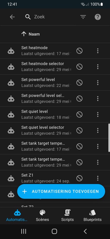

  • Maarten69
MikeyMan schreef op dinsdag 8 november 2022 @ 12:14:
Als je in HA heishamon.yaml hebt dan moet je nog wel de automations uitschakelen, ben je dat niet vergeten?
Afbeeldingslocatie: https://tweakers.net/i/_niUfvXWFBB3EFy41Z7G2WxjaZ4=/x800/filters:strip_icc():strip_exif()/f/image/Yop63WOy4w6KeDscWUXKmzC7.jpg?f=fotoalbum_large
[ Voor 28% gewijzigd door Maarten69 op 08-11-2022 12:41 ]
