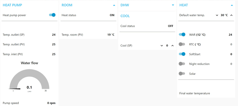

Hier kun je ook de verschillen tussen AAN en UIT zien:
Afbeeldingslocatie: https://tweakers.net/i/tjzlxy7suthFS2_US_ro-SvXjU8=/full-fit-in/4000x4000/filters:no_upscale():fill(white):strip_exif()/f/image/tbEiIUcn4GeGwrV7RyTiomfE.png?f=user_large
-WAR berekende temp klopt (ook bij uit)
-RTC correctie blijft altijd grayed-out
-Softstart grayed-out werkt niet
Take your time! Bedankt in ieder geval.

Maarten69 schreef op zondag 16 oktober 2022 @ 09:32:
Wat ik niet snap is dat je opnieuw die p1 enzo moest aansluiten.

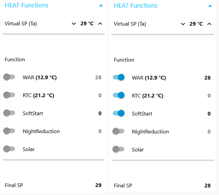

Na herstart NR:
16/10 10:03.47 - MQTT Command - SetZ1HeatRequestTemperature: NaN
16/10 10:03.42 - MQTT Command - SetZ1HeatRequestTemperature: NaN
16/10 10:03.41 - Function - SoftStart: 1
16/10 10:03.41 - Function - WAR: 0
16/10 10:03.41 - Function - RTC: 1
16/10 10:03.40 - MQTT Command - SetZ1HeatRequestTemperature: NaN
16/10 10:03.40 - SYSTEM: EXPERIMENTAL Warning: Your heatpump seems to be setup to use an external roomthermostat. > internal WAR
16/10 10:03.39 - MQTT Command - SetZ1HeatRequestTemperature: NaN
16/10 10:03.37 - SYSTEM: WAR settings OK
16/10 10:03.37 - MQTT Command - SetZ1HeatRequestTemperature: NaN
16/10 10:03.36 - MQTT Command - SetZ1HeatRequestTemperature: NaN
16/10 10:03.36 - Function WAR: RoomThermostat found. Using internal Panasonic WAR function. NodeRed WAR function is disabled
16/10 10:03.36 - MQTT Command - SetZ1CoolRequestTemperature: 0
16/10 10:03.35 - MQTT Command - SetZ1HeatRequestTemperature: NaN
16/10 10:03.34 - Function SoftStart: Correction - stage 1 (CATCH) from -3 to 2 °C
16/10 10:03.34 - MQTT Command - SetZ1HeatRequestTemperature: NaN
16/10 10:03.33 - SYSTEM - HEISHAMON Connection - : Online
16/10 10:03.33 - Function WAR: Setpoint change: From empty to 27 °C
16/10 10:03.33 - Function NightReduction: New correction: 0 °C
16/10 10:03.33 - Function SoftStart: Correction - stage 1 (STARTUP) from n/a to -3 °C
16/10 10:03.33 - NR Function - NightReduction: 0
16/10 10:03.32 - SYSTEM: Start
Na het aan en uitzetten van de WAR, RTC en Softstart en aanpassen van Virtual_SP stuurde hij weer een correcte SetZ1HeatRequestTemperature uit.

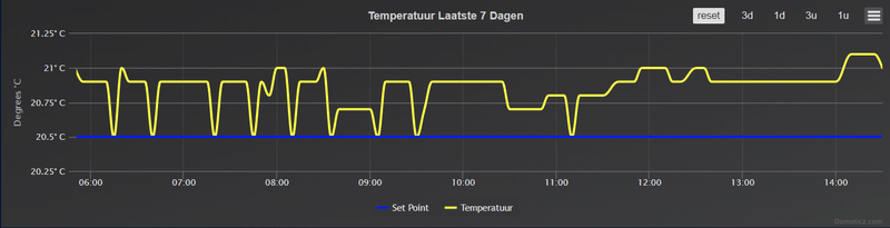

17/10 14:27.40 - Function - RTC: 0
17/10 14:27.18 - MQTT Command - SetOperationMode: 4
Dus dat is zoals beoogd :)
Krijg nu alleen gek genoeg weer meerdere
Zit nog boven DHW setpoint na de legionellarun van gisteren, dus gedrag zoals @Aikon meldt zie ik nog niet terug.
Zal ook nog even wat middeling toepassen op de inkomende sensor. Dit is wat wispelturig :+

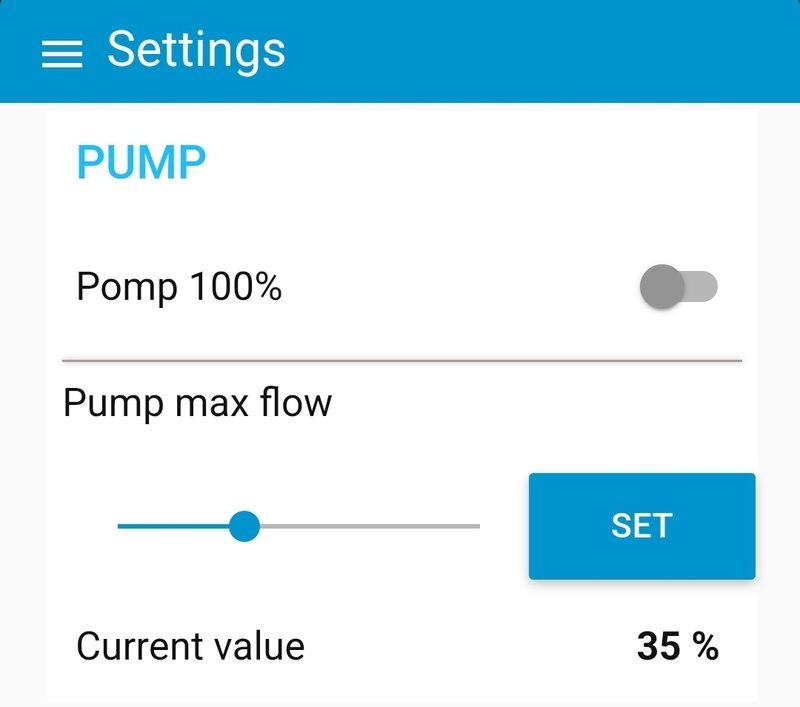

@Aikon
- Pump 100% flow is dubbel op met de functie eronder waar je ook de max flow kan instellen
Dit zijn wel 2 verschillende zaken.
Afbeeldingslocatie: https://tweakers.net/i/n2SSa1rEeU18PRyVBOTCrQO77uk=/800x/filters:strip_icc():strip_exif()/f/image/oDSl0vov9bsyNoamDnUTLbYA.jpg?f=fotoalbum_large
De toggle 100% is een service optie om de pomp tijdelijk op maximaal te zetten.
Die instelling eronder is de max pump dury. Hierbij kan de WP nog zelf terugregelen.

Ik heb de WAR pagina verbeterd volgens je text hierboven. is dit wat je voor ogen had?
Afbeeldingslocatie: https://tweakers.net/i/RenN-XLDZgfc7d2Xq9GUJ_vxxv8=/full-fit-in/4000x4000/filters:no_upscale():fill(white):strip_exif()/f/image/FQb6ur9hMSkl9Na8WDCxLswS.png?f=user_large
  • Aikon
@edterbak Ja, dat is precies wat ik bedoelde.

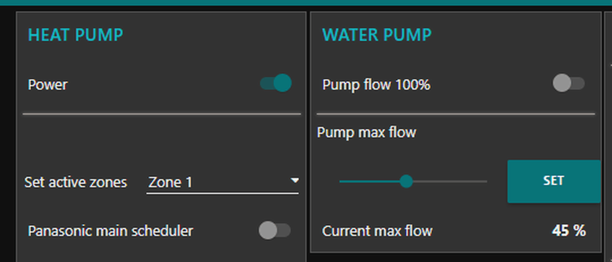

Settings
- GENERAL hernoemen naar HEAT PUMP,
en de flow optie(s) kunnen daar onder vallen (PUMP kan dus weg)
HEAT PUMP is de gehele warmtepomp.
PUMP is de water pomp alleen.
Nu heb het het even gemaakt als onderstaand.
Afbeeldingslocatie: https://tweakers.net/i/CiZb5inyha1D0JOhyvajdKfmfkE=/full-fit-in/4000x4000/filters:no_upscale():fill(white):strip_exif()/f/image/oJD2vTfhq1CrdPprUtBXinTe.png?f=user_large
Na deze toelichting kun je aangeven hoe je dit het meest logisch vind.

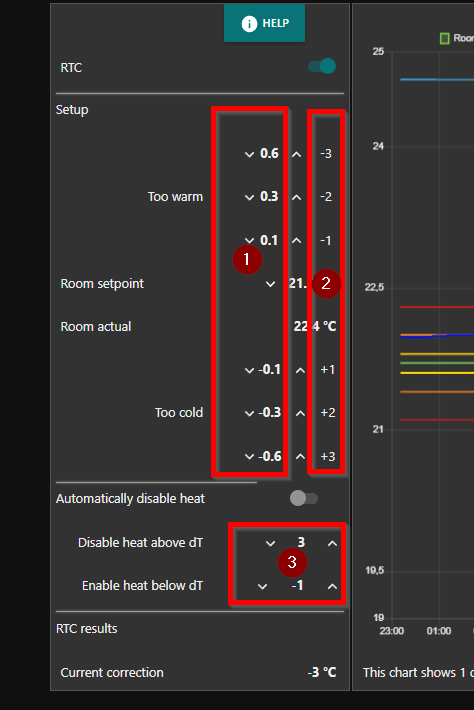

RTC
- °C achter de waardes
- geen delta weergeven voor uitzetten heat, maar absolute temperatuur, is duidelijker
- Start SP & Result SP kunnen wel weg, start sp is afhankelijk van WAR en de result SP kan nog veranderen verderop in de stooklijn, beetje dubbelop met de HOME page, Current correction is wel nuttig
Afbeeldingslocatie: https://tweakers.net/i/VA4_GSfrJP7ugWG3Vd2MKbqkyLg=/full-fit-in/4000x4000/filters:no_upscale():fill(white):strip_exif()/f/image/PSxlHwxNH45eAhdW1bi14cJv.png?f=user_large
°C, erachter, bedoel je de kolom bij 1 of 2, of 1en2?
Geen delta weergeven, is een goede suggestie. Zal ik later doen, want dit heeft wat meer programeer werk nodig. niet heel veel though...

Er stond eerst de tekst Water details boven de outlet/outlet/inlet temperaturen.
Wat mij betreft is er geen onderscheid, de water pump is onderdeel van de heat pump. Wmb valt de water pump gewoon onder het kopje heat pump.
Ik bedoel overal waar je °C weergeeft, dan ook consequent °C erachter zetten.
de 2 setpoints onder punt 1 zijn de temperaturen dat je wilt dat het water wordt. Low is het setpoint welke je ook instelt in Home.
Verder beneden bij result daar zie je de huidige watertemperatuur in je DHW tank bij 2, en bij 3 zie je wat op dit moment het setpoint is. is het de low of high setpoint.
Het zijn dus alle 4 verschillende getallen / bronnen.
Die onderste 2 waarden staan ook op de Home page, dus wat dat betreft zijn ze dubbelop imo. Ik hou wel van minimalistisch, dus wmb kunnen ze daar gewoon weg. Maar het is ook wel weer relevant om te zien welke setpoint actief is, maar wellicht is iets als Current setpoint: low/high dan duidelijker ipv een getal, welke je dan weer moet relateren met de ingestelde setpoints. Low of high is direct duidelijk.
Tooltiops zijn daar niet mogelijk.
Tooltips zijn dus helaas niet mogelijk op die 2 velden.
Helaas.

Ik zet net de Pump Flow op 100%, maar krijg dan de corresponderende optie te zien op de thermostaat. Ik kan dan wel de waarde veranderen met omhoog en omlaag, maar de andere knopjes doen niks (op de thermostaat zelf). Pas als ik de toggle weer uitzet reageren die weer. Is dat bij anderen ook zo?
  • edterbak
  • Laatst online: 22:43
Ja. Dat pump max is een service toggle.
Pomp logica en alles staat uit.
Misschien moet door naar een ander tabje?
  • Aikon
Working as designed dus?
Wat bedoel je?

Laatste flow nu ook geïnstalleerd volgens log: v20.74
Ik moest wel alles weer connecten (Temp, P1)
Ik heb nu alleen geen "Final water temperature" voorheen Final_SP op het HOME dashboard.
Edit: Nu Node Red herstart, nog steeds niks.
Heat Pump Power aangezet, nog steeds niks.
WAR, RTC, SOFTSTART aan/uit gezet, nog steeds niks.
Veranderen van Default water temp. (virtual SP): nu krijg ik een Final water temperature!
Poging 2 na een herstart:
Weer geen "Final water temperature" ook niet na veranderen" Default water temp".
Heat Pump Power aangezet nu wel "Final water temperature" als ik "Default water temp" wijzig.
De voorwaarde is nu dus dat de WP aan staat, duidelijk.
RTC: De RTC schakelt de WP nog steeds niet aan net als vorige versie.
Hebben anderen met deze versie v20.74 daar geen last van?
[ Voor 42% gewijzigd door Maarten69 op 20-10-2022 11:31 ]
