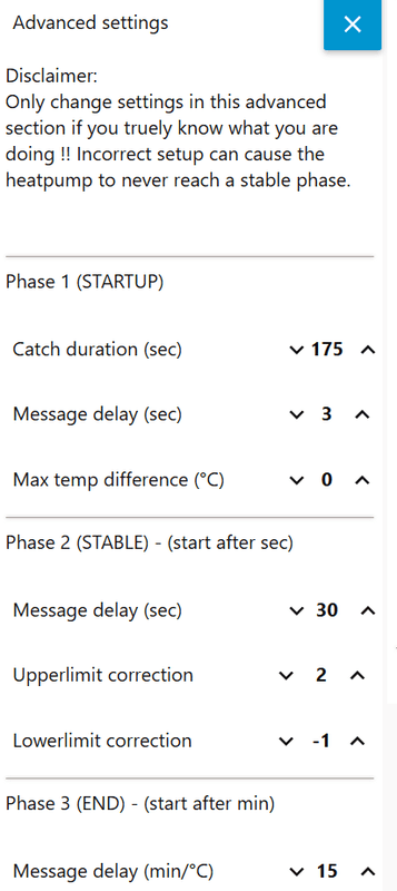

wumpe schreef op donderdag 13 maart 2025 @ 06:09:
Good Morning @edterbak
yesterday i have startet a run with night reduction -2 degress and quietmode off. catch duration is 175 and message delay is 30. outdoortemp is +3 degress.
it looks better, but the frenquency on start is very strong. i have a t-cap 9kW super quiet on a old house with 22000kwh heatconsumption anno. (water flow max is 31 L/min and the TRV every all open)
i test in a few days on outdoortemp > 7 degress
thx and a good day :)
OK, I left the night reduction with -2 degrees during the day, but 12 o'clock and 14 o'clock the run did not work :-(
Afbeeldingslocatie: https://tweakers.net/i/DgsnxrxHre5TSQrcfHzsdEcPre4=/800x/filters:strip_exif()/f/image/y5KNgQtpkFEHzZqAR3toOJwA.png?f=fotoalbum_large
Afbeeldingslocatie: https://tweakers.net/i/l7GEs3XUbdw0uHJX0qEsYcIHzlE=/x800/filters:strip_exif()/f/image/a3DqQaufPHIs8a8AE221jnoO.png?f=fotoalbum_large
Afbeeldingslocatie: https://tweakers.net/i/El7H4ilDcFIlIIMohT0iS-p1OcE=/800x/filters:strip_exif()/f/image/X6AWdVOVsWe0KcMGo8IhcOXI.png?f=fotoalbum_large
@edterbak
in WP Control -> Function Softstart v2
line 55
var F_NR_correction     = global.get('NightReductionWaterTemp.current_value',"file");
you read the current_value , but in file is current_value = 0, only correction = -2 and state = 1
line 58
var F_SS_SP_start       = SP_start + F_RTC_correction + F_NR_correction;
you calc F_SS_SP_Start with current_value=0
maybe the calculation is wrong ?
i set the -2 degrees direct in SP_war variable in WAR2Direct Function and test it
line 83 in WAR2DIRECT Function
SP_war = parseFloat(SP_war)-2;
greetings

Hi Wumpe,
Thank you for the detailed respons !!! :P
I think you might be on to something. I will look at that.
But a day or two ago, I asked a question here (in Dutch), if the current NightReduction is obsolete or still needed.
The reason I asked this, is that in the scheduler you can now directly set the water temperature or water shift. THis you can do multiple times a day if you want, making it more flexible.
Only issue is (just thought of this) this does not work with DIRECT mode in combination with WAR function.
Afbeeldingslocatie: https://tweakers.net/i/b5ZNqIxepzsioQ9tdnN1yWvYNq4=/fit-in/4000x4000/filters:no_upscale():strip_exif()/f/image/kyDfEwZsXhI9opL9ISGbtKqc.png?f=user_large
So to be honest, I am wondering if the nightreduction function can be taken out... Have not decided yet.
Regardless, I will look at your suggested issue-area. Thanks again
  • edterbak
  • Laatst online: 29-08 13:17
@wumpe
I did find a incorrect thing. additionally I have changed a bit of the logic. it seemed wonky...
Now I did a couple of tests and it seems to work in stable situation.
I want to test it in startup moment as well. I need to wait for that a bit.
Next version should include a fix with nightreduction.
btw.
For purpose of expectation management..
The order in which the HEAT functions are handled is
  1. water temp (manual)
  2. WAR function
  3. RTC function
  4. NR function
  5. SoftStart function
The result of 1 is used as startpoint for 2
The result of 2 is used as startpoint for 3
The result of 3 is used as startpoint for 4
The result of 4 is used as startpoint for 5
So you can expect the Night reduction function to possibly be partially nullified by the softstart function.
Only the operaing window of the softstart function wll shift down,
Maybe this helps.

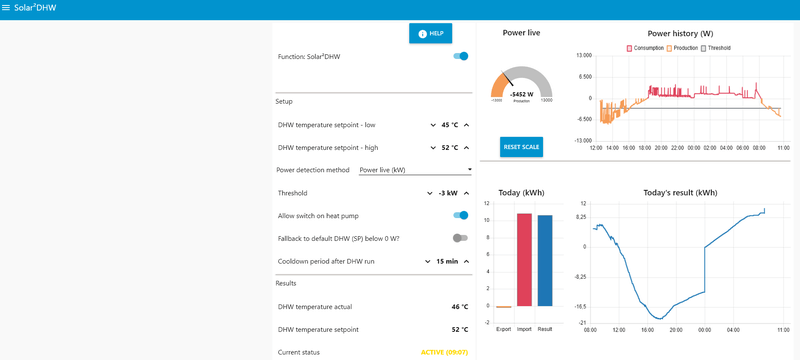

is dit de trigger dat NR dan alsnog overschakelt naar HEAT + DHW terwijl HEAT gevraagd is?
De scheduler zijn slects triggers die je geeft op een bepaald moment.
Je kunt trigger HEAT geven op tijdstip X
Je kunt trigger HEAT+DHW geven op tijdstip Y
Er is geen bewuste logica aanwezig welke bijhoud dat tussen X en Y de operating mode HEAT moet zijn en dit corrigeerd. Dit is veel te complex.
Ik heb wel ingebouwd dat als een Solar2DHW functie afgetrapt wordt, dat de huidige OperatingMode wordt opgeslagen. Als de Solar2DHW functie klaar is, dan revert de OM weer terug naar het opgeslagen OM.
Een scheduled action zal als Solar2DHW actief is, niet domweg de OM aanpassen.
Als een scheduled task (change OM) afgetrapt wordt tijdens een functie als Solar2DHW, dan past de scheduler niet de actieve OM aan, maar de opgeslagen OM.
Dus dan zal zodra de Solar2DHW klaar is toch de juiste OM worden gezet.
Dat is het idee.
Maar er zitten hier/daar ook wat vertragingen ingebouwd. Revert over 15/30 minuten .. dat soort dingen.
Dus hetkan een vertekenend beeld geven en de indruk geven dat het niet klopt. Als het een lange tijd zo blijft kan het wel een issue zijn.

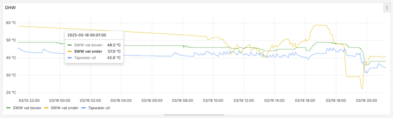

Ik probeer al een tijdje mijn sterilisatie run te optimaliseren, maar het wil voor geen meter lukken. Tijdens het opwarmen van de boiler schakelt de pomp vaak aan en uit (zie onderstaande grafiek).
Heeft er iemand tips hoe ik dit het beste kan aanpakken om een betere opwarming van het boilervat naar 60 graden kan organiseren?
Afbeeldingslocatie: https://tweakers.net/i/zLZ4pWPEN39y8Xbv8CwgvhCGdcY=/800x/filters:strip_exif()/f/image/KVlI7ulzHmd5SvRNU50boQrf.png?f=fotoalbum_large

Nnoitra schreef op maandag 3 februari 2025 @ 13:24:
@edterbak en/of anderen,
Ik zie in de log dat ie tijdens softStart, na een calculatie, niet altijd of een hele tijd niet MQTT bericht stuurt om de shift aan te passen.
03/02 12:59:12 - Function - Calculate new SP: New final T shift calculated: Current T shift: 1 °C. New calculated T shift: 2 °C
03/02 12:59:12 - Function SoftStart: Correction: -1 > 0 °C - (ENDING) Freq: 24Hz, SP_Final: 2°C
03/02 12:44:11 - Function - Calculate new SP: New final T shift calculated: Current T shift: 0 °C. New calculated T shift: 1 °C
03/02 12:44:11 - Function SoftStart: Correction: -2 > -1 °C - (ENDING) Freq: 23Hz, SP_Final: 1°C
03/02 12:29:11 - Function - Calculate new SP: New final T shift calculated: Current T shift: -1 °C. New calculated T shift: 0 °C
03/02 12:29:11 - Function SoftStart: Correction: -3 > -2 °C - (ENDING) Freq: 23Hz, SP_Final: 0°C
03/02 12:14:11 - Function - Calculate new SP: New final T shift calculated: Current T shift: -2 °C. New calculated T shift: -1 °C
03/02 12:14:11 - Function SoftStart: Correction: -4 > -3 °C - (ENDING) Freq: 23Hz, SP_Final: -1°C
03/02 11:59:11 - Function - Calculate new SP: New final T shift calculated: Current T shift: -3 °C. New calculated T shift: -2 °C
03/02 11:59:11 - Function SoftStart: Correction: -5 > -4 °C - (ENDING) Freq: 29Hz, SP_Final: -2°C
03/02 11:47:21 - Function SoftStart: --> Pump relaxing took too long... (30Hz) Continuing with Phase 2. (Count: 5/5. Resetting counter)
03/02 11:47:11 - Function SoftStart: Correction: -5 > -5 °C - (EVALUATING) Freq: 29Hz, SP_Final: -3°C
03/02 11:44:11 - Function SoftStart: --> Pump did not yet relax (30Hz). Restarting Phase 1 again... (Count: 5/5)
03/02 11:44:00 - Function SoftStart: Correction: -5 > -5 °C - (EVALUATING) Freq: 30Hz, SP_Final: -3°C
03/02 11:43:32 - MQTT Command: SetZ1HeatRequestTemperature: -3 (SoftStart)
03/02 11:43:32 - Function - Calculate new SP: New final T shift calculated: Current T shift: -2 °C. New calculated T shift: -3 °C
03/02 11:43:28 - Function SoftStart: Correction: -4 > -5 °C - (STARTUP) Freq: 30Hz, SP_Final: -3°C
03/02 11:42:38 - MQTT Command: SetZ1HeatRequestTemperature: -2 (SoftStart)
03/02 11:42:38 - Function - Calculate new SP: New final T shift calculated: Current T shift: -1 °C. New calculated T shift: -2 °C
03/02 11:42:38 - Function SoftStart: Correction: -3 > -4 °C - (STARTUP) Freq: 29Hz, SP_Final: -2°C
03/02 11:42:31 - MQTT Command: SetZ1HeatRequestTemperature: -1 (SoftStart)
Bij een volgende softStart run (na bv een defrost) kan ie dan wel weer een tijd gewoon goed lopen en de MQTTs versturen.
Tot ie op een geven moment wéér geen MQTTs wil versturen.

In het Pana menu heb ik de sterilisatie run op zondag 13:00u gepland staan
daar is ie ook netjes mee begonnen
maar hij is er niet meer uitgekomen?
Afbeeldingslocatie: https://tweakers.net/i/JDuk3smH-pOwVSjAaRgn8MnbOUM=/800x/filters:strip_exif()/f/image/jamX9kMGEb9wzitWUy0oLHwl.png?f=fotoalbum_large
Afbeeldingslocatie: https://tweakers.net/i/ASuCYB76WAnT7m9Ij1mf2jqHgbQ=/800x/filters:strip_exif()/f/image/2az6NpDhe3V0Ylr2XxgaOgdj.png?f=fotoalbum_large

16/03 13:11:54 - MQTT Command: SetDHWTemp: 45 (Solar)
16/03 13:11:53 - Function Solar: Restoring DHW setpoint to: 45°C
16/03 13:11:53 - Function Solar: Stored next operating mode is removed
16/03 13:11:53 - Function Solar: Cooldown period (15 minutes) has ended. Solar function done for today

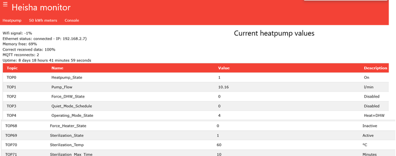

16/03 13:00:22 - TOP69_Sterilization_State: 1
16/03 12:58:42 - TOP20_ThreeWay_Valve_State: 0
ook komt de sterilsatie niet tot de 60GrC
Afbeeldingslocatie: https://tweakers.net/i/LXv7WDLQrxYKkgnJCGW5HrnIOQI=/800x/filters:strip_exif()/f/image/tVA3e4c2deRwfPHGCAhZ5ViK.png?f=fotoalbum_large

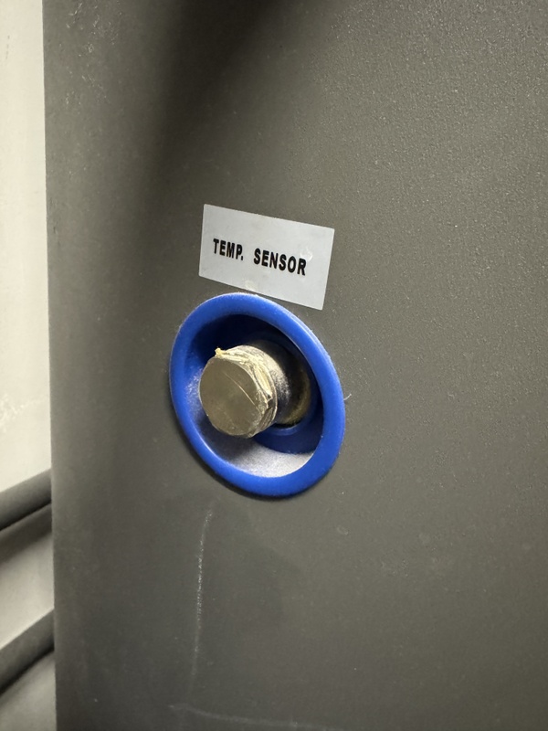

Welke boiler heb jij ook alweer en waar zit die temperatuursensor? Kan 't zijn dat die erg laag zit waardoor deze dus (te) snel een temperatuurdrop geeft?
Ik heb dit probleem niet maar gebruik ook andere logica, bij mij staat gedurende 't stookseizoen de OM default op 0 (Heat) en controleer ik tussen 13:00u en 14:00u of de temperatuur van de boiler te laag is geworden (DHW temp < DHW target + DHW Delta) en alleen dan wordt er een DHW run gestart. Oftewel eigenlijk doet die DHW Delta er niet toe.
hi @blb4
ik heb een Nexus 300Liter boilervat
deze is 155cm hoog
er zitten 2 voorzieningen in voor de temperatuursensor, op 45cm en 107cm hoog
de temperatuursensor zit in de 45cm voorziening
Gasloos 2019 + WP Panasonic H-serie 7kW + 300 liter boilervat + PV 12.415Wp + Home Assistant + Hyundai Ioniq 6 First Edition + Zaptec laadpaal
  • BazemanKM
  • Laatst online: 15:50
hemertje schreef op zondag 16 maart 2025 @ 20:36:
hi @blb4
deze is 155cm hoog
Hoort volgens mij in de bovenste.

destijds bij de aanleg in januari 2019 wist de installateur mij te vertellen
dat ie de tempsensor in de onderste monteerde want dat werd er het snelst koud water gemonitord en gelijk DHW gestart zodat je, volgens hem, onuitputtelijk warm water in theorie zou hebben, de WP zou het aanmaken van SWW kunnen bijhouden bij een lopende warmwater kraan?
zo werd mij dus verteld...

ondanks de douchebespaarkop valt het me op dat de tiener en directie in huis het met het douchen het voor elkaar krijgen het SWW water onderin te laten droppen van 50GrC naar 23GrC
de Pana reageert daar nu direct op door gelijk SWW te gaan maken
Afbeeldingslocatie: https://tweakers.net/i/cLmBYOz-QwhkGFNqsyAUF5Ce-Sw=/800x/filters:strip_exif()/f/image/UpTcrmb6oLMUfE2zXfIBd6lz.png?f=fotoalbum_large
Zie hier verschillen tussen onder en boven en de temperatuur, die er uit gaat.
https://www.fam-oldenburger.nl/category/domotica/

BazemanKM schreef op zondag 16 maart 2025 @ 21:18:
grote verschillen inderdaad @BazemanKM !
mooie inzichten

Hoe werkt zo'n aansluiting in het boilervat?
wanneer je die pluggen eruit draait, zit daarachter gelijk het water of een kleine holle ruimte met hierin de tempsensor die de temp van het water overneemt?
Afbeeldingslocatie: https://tweakers.net/i/lVMsRPV-r1mv0dmWwlbn0CLzQAw=/x800/filters:strip_icc():strip_exif()/f/image/8Pzm98SXUIWLDArgOz3NRaCT.jpg?f=fotoalbum_large
Afbeeldingslocatie: https://tweakers.net/i/khFRMKvhGEwOgSjIUI4jVvO_9kQ=/x800/filters:strip_icc():strip_exif()/f/image/Fl4pG49zubRjyIWJsAFqLz7i.jpg?f=fotoalbum_large
[ Voor 26% gewijzigd door hemertje op 17-03-2025 20:35 ]

Ik durf niet te zeggen hoe zo een vat werkt.
staat er geen type plaatje op ergens dat je kunt googlen naar de handleiding? hopelijk vind je zo een instructie of tekening
na het zien van de grafiek over tonder en tboven, zou je haast zeggen dat je ze alle 3 wilt aansluiten.

hemertje schreef op maandag 17 maart 2025 @ 20:35:
hier gelukkig ook nog geen lijfstraffen @blb4 :P
Geen idee hoe 't bij die van jou zit, bij mijn Panasonic boiler zit er zoals jij 't beschrijft een holle ruimte waar je de sensor de nodige centimeters in kunt duwen; de sensor zit dus niet in 't water zelf. Goed de handleiding bestuderen van jou boiler dus!

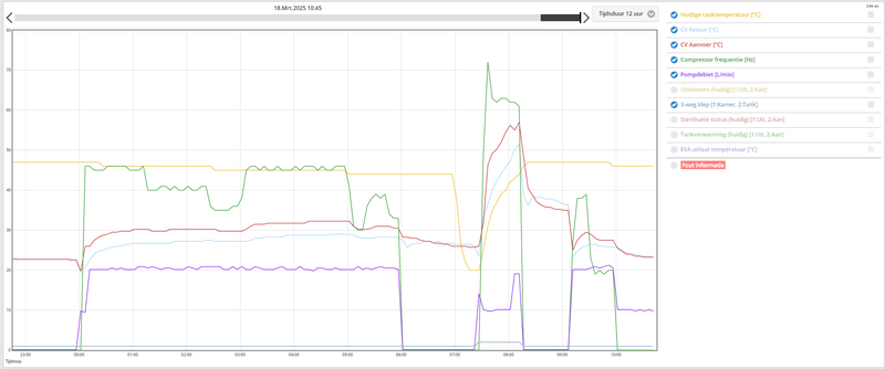

ik heb het idee Ed dat de DHW en de Solar2DHW niet loopt zoals die zou moeten lopen
vanmorgen is er door 2 personen gedoucht en dus is de Auto DHW gaan draaien
echter niet tot de ingestelde DHW Setpoint van 52GrC maar tot 47GrC, zie de Pana statistieken
de Solar2DHW is inmiddels actief want er wordt meer dan 3kW aan zonnestroom aan het net teruggeleverd
toch draait de compressor niet of stijgt de temperatuur in het boilervat?
sterker nog, volgens de Pana statistieken draait de compressor vanaf 10:00u niet meer!?
