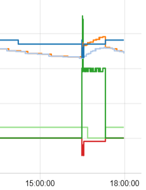

second: i have found a bug. is night reduction activatet, softstart-function is not correctly running. i have flow 24.10, but the bug is still running since 24.07.
Afbeeldingslocatie: https://tweakers.net/i/YXQiXfI0priqzF6ppYrVbsmoHmY=/800x/filters:strip_exif()/f/image/WUFAQoYNqWEscDyVDFmSTu6b.png?f=fotoalbum_large
night reduction is set -2 degree and i drive only with WAR-Funktion and Softstart incl. Quietmodeaddon
Afbeeldingslocatie: https://tweakers.net/i/loEF1ef7WpdKhpEtg3whVYS2kkU=/fit-in/4000x4000/filters:no_upscale():strip_exif()/f/image/qS3LQ5Cui1KMstVHhbfkYR94.png?f=user_large
9pm is night reduction activatet
thx

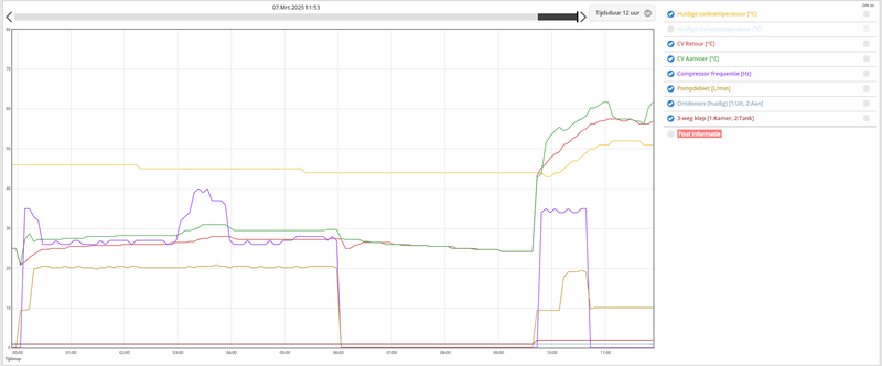

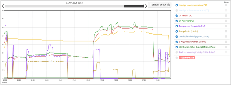

  • hemertje
  • Registratie: Juli 2015
  • Laatst online: 22:24
@edterbak

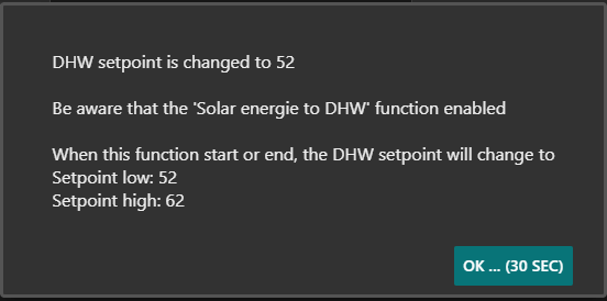

binnen Solar2DHW heb ik Fallback to default DHW (SP) below 0 W? ingeschakeld

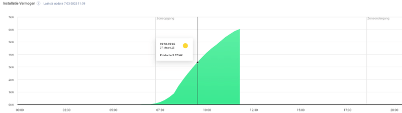

ik krijg volle bak zonnestroom binnen
Afbeeldingslocatie: https://tweakers.net/i/3iyyYltm97Uk3FtSHZbd4xiAY8M=/800x/filters:strip_exif()/f/image/pQ7LFihysu9foA3L5yT4C4UC.png?f=fotoalbum_large
toch zie ik in de NR Log en op de Pana statistieken dat er getoggeld wordt tussen de DHW temperature setpoint - Low en de High ?
Afbeeldingslocatie: https://tweakers.net/i/Wl6hwUlxCAdX2-_4mlU8YHH0LpE=/800x/filters:strip_exif()/f/image/QbplF1z58MYbkCPvIQKieIJH.png?f=fotoalbum_large
Flow version
24.11 (stable beta)
07/03 12:00:47 - Scheduler: Solar function active. Not changing operating mode now, but setting next operating mode to 4
07/03 11:26:24 - MQTT Command: SetDHWTemp: 62 (Solar)
07/03 11:26:23 - Function Solar: triggered threshold (kW). DHW SP to 62
07/03 11:25:54 - MQTT Command: SetDHWTemp: 52 (Solar)
07/03 11:25:53 - Function Solar: triggered threshold (undefined). Above 0kWh threshold. DHW SP to 52
07/03 11:05:24 - MQTT Command: SetDHWTemp: 62 (Solar)
07/03 11:05:23 - Function Solar: triggered threshold (kW). DHW SP to 62
07/03 10:42:10 - MQTT Command: SetQuietMode: 3
07/03 10:42:10 - MQTT Command: SetMaxPumpDuty: 94 (pump speed)
07/03 10:42:10 - Compressor: stopped
07/03 10:42:10 - Function SoftStart Quietmode: Compressor run ended, quiet mode set to level 3 for next run
07/03 10:42:10 - Function Pump speed: Max pumpspeed set to 94 (16%) (Low)
07/03 09:52:08 - MQTT Command: SetDHWTemp: 52 (Solar)
07/03 09:52:07 - Function Solar: triggered threshold (undefined). Above 0kWh threshold. DHW SP to 52
07/03 09:50:02 - Function SoftStart Quietmode: Timer ended, quiet mode is already set to level 2
07/03 09:45:01 - MQTT Command: SetMaxPumpDuty: 245 (pump speed)
07/03 09:45:01 - Compressor: running
07/03 09:45:01 - Function SoftStart Quietmode: Timer started (5 minutes)
07/03 09:45:01 - Function Pump speed: Max pumpspeed set to 245 (95%) (DHW)
07/03 09:41:56 - MQTT Command: SetQuietMode: 2
07/03 09:41:56 - Quiet mode manager: Detected 3-way valve set to DHW. Disabling the quiet mode function during DHW. Restored to level 2
07/03 09:41:56 - MQTT Command: SetMaxPumpDuty: 94 (pump speed)
07/03 09:41:56 - TOP20_ThreeWay_Valve_State: 1
07/03 09:41:56 - Function Pump speed: Max pumpspeed set to 94 (16%) (Low)
07/03 09:41:56 - TOP4_Operating_Mode_State: 4
07/03 09:41:54 - MQTT Command: SetOperationMode: 4
07/03 09:41:53 - MQTT Command: SetDHWTemp: 62 (Solar)
07/03 09:41:53 - MQTT Command: SetHeatpump: 1 (Solar)
07/03 09:41:52 - Function Solar: Operation mode changed from 0 to 4
07/03 09:41:52 - Function Solar: triggered threshold (kW). DHW SP to 62
07/03 09:41:52 - Function Solar: Stored next operating mode is set to 0
07/03 09:38:41 - Function - Calculate new SP: New final SP calculated: Current setpoint: 26 °C. New calculated setpoint: 24 °C
07/03 09:38:36 - Function WAR: Setpoint change: From 27.1 to 27 °C
07/03 09:33:36 - Function WAR: Setpoint change: From 27.2 to 27.1 °C
07/03 09:13:35 - Function WAR: Setpoint change: From 27.3 to 27.2 °C
07/03 09:08:34 - Function WAR: Setpoint change: From 27.4 to 27.3 °C
07/03 09:07:46 - Function - Calculate new SP: New final SP calculated: Current setpoint: 26 °C. New calculated setpoint: 25 °C
07/03 09:07:46 - Function RTC: Correction change: From -2 to -3 °C (Room actual: 20.92 °C)
07/03 08:58:34 - Function WAR: Setpoint change: From 27.5 to 27.4 °C
07/03 08:52:46 - Function WAR: Setpoint change: From 27.6 to 27.5 °C
07/03 08:48:33 - Function WAR: Setpoint change: From 27.7 to 27.6 °C
07/03 08:43:33 - Function WAR: Setpoint change: From 27.8 to 27.7 °C
07/03 08:38:33 - Function WAR: Setpoint change: From 27.9 to 27.8 °C
07/03 08:33:32 - Function WAR: Setpoint change: From 28 to 27.9 °C
07/03 08:18:31 - Function WAR: Setpoint change: From 28.1 to 28 °C
07/03 08:13:31 - Function WAR: Setpoint change: From 28.2 to 28.1 °C
07/03 08:03:31 - Function WAR: Setpoint change: From 28.3 to 28.2 °C
07/03 07:52:46 - Function WAR: Setpoint change: From 28.2 to 28.3 °C
07/03 07:18:28 - Function WAR: Setpoint change: From 28.3 to 28.2 °C
07/03 06:48:25 - Function WAR: Setpoint change: From 28.2 to 28.3 °C
07/03 06:18:24 - Function WAR: Setpoint change: From 28.1 to 28.2 °C
07/03 06:13:24 - Function - Calculate new SP: New final SP calculated: Current setpoint: 26 °C. New calculated setpoint: 27 °C
07/03 06:13:24 - Function WAR: Setpoint change: From 28 to 28.1 °C
07/03 06:02:52 - MQTT Command: SetQuietMode: 3 (SoftStart Quietmode)
07/03 06:02:52 - Function SoftStart: SoftStart function end
07/03 06:02:52 - Compressor: stopped
07/03 06:02:52 - Function SoftStart Quietmode: Compressor run ended, quiet mode set to level 3 for next run
07/03 06:02:46 - MQTT Command: SetHeatpump: 0 (rtc automation: on/off)
07/03 06:02:46 - Function RTC: Automation 'Turn off/on power' triggered - power OFF (Room temp: 20.7°C)
07/03 06:00:52 - TOP4_Operating_Mode_State: 0
07/03 06:00:49 - MQTT Command: SetOperationMode: 0
07/03 06:00:46 - MQTT Command: SetCurves: target: 26 (SP Calculation)
07/03 06:00:46 - Function - Calculate new SP: New final SP calculated: Current setpoint: 29 °C. New calculated setpoint: 26 °C
07/03 06:00:46 - Function RTC: Correction change: From 1 to -2 °C (Room actual: 20.67 °C)
07/03 06:00:46 - RTC: Room setpoint changed to: 20 °C
07/03 06:00:46 - Scheduler - Set room setpoint (RTC): 20
07/03 06:00:46 - Scheduler: Stored next operating mode empty. Setting new operating mode to: 0
07/03 05:58:22 - MQTT Command: SetCurves: target: 29 (SP Calculation)
07/03 05:58:22 - Function - Calculate new SP: New final SP calculated: Current setpoint: 30 °C. New calculated setpoint: 29 °C
07/03 05:58:22 - Function WAR: Setpoint change: From 28.2 to 28 °C
07/03 05:52:46 - Function WAR: Setpoint change: From 28.3 to 28.2 °C
07/03 05:33:21 - Function WAR: Setpoint change: From 28.2 to 28.3 °C
07/03 05:28:21 - Function WAR: Setpoint change: From 28.3 to 28.2 °C
07/03 05:03:19 - Function WAR: Setpoint change: From 28.2 to 28.3 °C
07/03 04:33:17 - Function WAR: Setpoint change: From 28.1 to 28.2 °C
07/03 04:18:16 - MQTT Command: SetCurves: target: 30 (SP Calculation)
07/03 04:18:16 - Function - Calculate new SP: New final SP calculated: Current setpoint: 29 °C. New calculated setpoint: 30 °C
07/03 04:18:16 - Function WAR: Setpoint change: From 28 to 28.1 °C
07/03 04:12:46 - Function WAR: Setpoint change: From 27.8 to 28 °C
07/03 04:08:15 - Function WAR: Setpoint change: From 27.9 to 27.8 °C
07/03 03:58:14 - Function WAR: Setpoint change: From 28 to 27.9 °C
07/03 03:53:14 - MQTT Command: SetCurves: target: 29 (SP Calculation)
07/03 03:53:14 - Function - Calculate new SP: New final SP calculated: Current setpoint: 30 °C. New calculated setpoint: 29 °C
07/03 03:53:14 - Function WAR: Setpoint change: From 28.1 to 28 °C
07/03 03:32:46 - MQTT Command: SetCurves: target: 30 (SP Calculation)
07/03 03:32:46 - Function - Calculate new SP: New final SP calculated: Current setpoint: 31 °C. New calculated setpoint: 30 °C
07/03 03:32:46 - Function RTC: Correction change: From 2 to 1 °C (Room actual: 20.41 °C)
07/03 03:13:12 - MQTT Command: SetCurves: target: 31 (SP Calculation)
07/03 03:13:12 - Function - Calculate new SP: New final SP calculated: Current setpoint: 30 °C. New calculated setpoint: 31 °C
07/03 03:13:12 - Function WAR: Setpoint change: From 28 to 28.1 °C
07/03 03:00:49 - MQTT Command: SetCurves: target: 30 (SP Calculation)
07/03 03:00:49 - Function - Calculate new SP: New final SP calculated: Current setpoint: 27 °C. New calculated setpoint: 30 °C
07/03 03:00:46 - Function RTC: Correction change: From -1 to 2 °C (Room actual: 20.35 °C)
07/03 03:00:46 - RTC: Room setpoint changed to: 21 °C
07/03 03:00:46 - Scheduler - Set room setpoint (RTC): 21
07/03 02:53:10 - Function WAR: Setpoint change: From 27.9 to 28 °C
07/03 02:43:10 - Function WAR: Setpoint change: From 27.8 to 27.9 °C
07/03 02:32:46 - MQTT Command: SetCurves: target: 27 (SP Calculation)
07/03 02:32:46 - Function - Calculate new SP: New final SP calculated: Current setpoint: 28 °C. New calculated setpoint: 27 °C
07/03 02:32:46 - Function RTC: Correction change: From 0 to -1 °C (Room actual: 20.32 °C)
07/03 02:22:46 - MQTT Command: SetCurves: target: 28 (SP Calculation)
07/03 02:22:46 - Function - Calculate new SP: New final SP calculated: Current setpoint: 27 °C. New calculated setpoint: 28 °C
07/03 02:22:46 - Function RTC: Correction change: From -1 to 0 °C (Room actual: 20.29 °C)
07/03 02:17:46 - MQTT Command: SetCurves: target: 27 (SP Calculation)
07/03 02:17:46 - Function - Calculate new SP: New final SP calculated: Current setpoint: 28 °C. New calculated setpoint: 27 °C
07/03 02:17:46 - Function RTC: Correction change: From 0 to -1 °C (Room actual: 20.3 °C)
07/03 02:13:07 - Function WAR: Setpoint change: From 27.7 to 27.8 °C
07/03 01:43:05 - Function WAR: Setpoint change: From 27.6 to 27.7 °C
07/03 01:28:04 - Function WAR: Setpoint change: From 27.7 to 27.6 °C
07/03 01:13:03 - Function WAR: Setpoint change: From 27.8 to 27.7 °C
07/03 00:52:46 - Function WAR: Setpoint change: From 27.7 to 27.8 °C
07/03 00:51:07 - MQTT Command: SetCurves: target: 28 (SP Calculation)
07/03 00:50:03 - Function - Calculate new SP: New final SP calculated: Current setpoint: 27 °C. New calculated setpoint: 28 °C
07/03 00:50:03 - Function SoftStart: Correction: -1 > 0 °C - (ENDING) Freq: 27Hz, SP_Final: 20°C
07/03 00:43:02 - Function WAR: Setpoint change: From 27.8 to 27.7 °C
07/03 00:35:03 - MQTT Command: SetCurves: target: 27 (SP Calculation)
07/03 00:35:03 - Function - Calculate new SP: New final SP calculated: Current setpoint: 26 °C. New calculated setpoint: 27 °C
07/03 00:35:03 - Function SoftStart: Correction: -2 > -1 °C - (ENDING) Freq: 26Hz, SP_Final: 19°C
07/03 00:23:14 - Function SoftStart: --> Pump relaxing took too long... (32Hz) Continuing with Phase 2. (Count: 5/5. Resetting counter)
07/03 00:23:03 - Function SoftStart: Correction: -2 > -2 °C - (EVALUATING) Freq: 32Hz, SP_Final: 18°C
07/03 00:22:46 - Function SoftStart: Correction: -1 > -2 °C - (STARTUP) Freq: 33Hz, SP_Final: 18°C
07/03 00:22:46 - Function RTC: Correction change: From -1 to 0 °C (Room actual: 20.25 °C)
07/03 00:20:03 - Function SoftStart: --> Pump did not yet relax (32Hz). Restarting Phase 1 again... (Count: 5/5)
07/03 00:19:53 - Function SoftStart: Correction: -1 > -1 °C - (EVALUATING) Freq: 32Hz, SP_Final: 18°C
07/03 00:18:05 - MQTT Command: SetCurves: target: 26 (SP Calculation)
07/03 00:18:05 - Function - Calculate new SP: New final SP calculated: Current setpoint: 27 °C. New calculated setpoint: 26 °C
07/03 00:18:05 - Function SoftStart: Correction: 0 > -1 °C - (STARTUP) Freq: 33Hz, SP_Final: 18°C
07/03 00:17:55 - MQTT Command: SetCurves: target: 27 (SP Calculation)
07/03 00:17:55 - Function - Calculate new SP: New final SP calculated: Current setpoint: 28 °C. New calculated setpoint: 27 °C

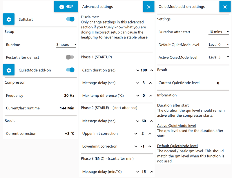

07/03 00:17:55 - Function SoftStart: Correction: 1 > 0 °C - (STARTUP) Freq: 33Hz, SP_Final: 19°C
07/03 00:17:46 - Function WAR: Setpoint change: From 27.7 to 27.8 °C
07/03 00:17:34 - MQTT Command: SetCurves: target: 28 (SP Calculation)
07/03 00:17:34 - Function - Calculate new SP: New final SP calculated: Current setpoint: 29 °C. New calculated setpoint: 28 °C
07/03 00:17:30 - Function SoftStart: Correction: 2 > 1 °C - (STARTUP) Freq: 32Hz, SP_Final: 20°C
07/03 00:17:15 - MQTT Command: SetCurves: target: 29 (SP Calculation)
07/03 00:17:03 - Function - Calculate new SP: New final SP calculated: Current setpoint: 28 °C. New calculated setpoint: 29 °C
07/03 00:17:03 - Function SoftStart: Correction: 1 > 2 °C - (STARTUP) Freq: 36Hz, SP_Final: 21°C
07/03 00:16:52 - Function SoftStart: --> Pump did not yet relax (36Hz). Restarting Phase 1 again... (Count: 4/5)
07/03 00:16:42 - Function SoftStart: Correction: 1 > 1 °C - (EVALUATING) Freq: 36Hz, SP_Final: 20°C
07/03 00:16:24 - MQTT Command: SetCurves: target: 28 (SP Calculation)
07/03 00:16:24 - Function - Calculate new SP: New final SP calculated: Current setpoint: 29 °C. New calculated setpoint: 28 °C
07/03 00:16:20 - Function SoftStart: Correction: 2 > 1 °C - (STARTUP) Freq: 35Hz, SP_Final: 20°C
07/03 00:16:13 - MQTT Command: SetCurves: target: 29 (SP Calculation)
07/03 00:16:13 - Function - Calculate new SP: New final SP calculated: Current setpoint: 28 °C. New calculated setpoint: 29 °C
07/03 00:16:13 - Function SoftStart: Correction: 1 > 2 °C - (STARTUP) Freq: 35Hz, SP_Final: 21°C
07/03 00:13:41 - Function SoftStart: --> Pump did not yet relax (36Hz). Restarting Phase 1 again... (Count: 3/5)
07/03 00:13:31 - Function SoftStart: Correction: 1 > 1 °C - (EVALUATING) Freq: 36Hz, SP_Final: 20°C
07/03 00:12:15 - MQTT Command: SetCurves: target: 28 (SP Calculation)
07/03 00:12:12 - MQTT Command: SetCurves: target: 28 (SP Calculation)
07/03 00:11:55 - Function - Calculate new SP: New final SP calculated: Current setpoint: 27 °C. New calculated setpoint: 28 °C
07/03 00:11:53 - Function SoftStart: Correction: 0 > 1 °C - (STARTUP) Freq: 36Hz, SP_Final: 20°C
07/03 00:11:44 - MQTT Command: SetCurves: target: 27 (SP Calculation)
07/03 00:11:44 - Function - Calculate new SP: New final SP calculated: Current setpoint: 28 °C. New calculated setpoint: 27 °C
07/03 00:11:40 - Function SoftStart: Correction: 1 > 0 °C - (STARTUP) Freq: 35Hz, SP_Final: 19°C
07/03 00:11:23 - MQTT Command: SetCurves: target: 28 (SP Calculation)
07/03 00:11:23 - Function - Calculate new SP: New final SP calculated: Current setpoint: 27 °C. New calculated setpoint: 28 °C
07/03 00:11:23 - Function SoftStart: Correction: 0 > 1 °C - (STARTUP) Freq: 35Hz, SP_Final: 20°C
07/03 00:11:00 - Function SoftStart: Correction: 1 > 0 °C - (STARTUP) Freq: 36Hz, SP_Final: 19°C
07/03 00:10:58 - Function SoftStart: Correction: 0 > 1 °C - (STARTUP) Freq: 35Hz, SP_Final: 20°C
07/03 00:10:30 - Function SoftStart: --> Pump did not yet relax (35Hz). Restarting Phase 1 again... (Count: 2/5)
07/03 00:10:20 - Function SoftStart: Correction: 0 > 0 °C - (EVALUATING) Freq: 35Hz, SP_Final: 19°C
07/03 00:09:09 - MQTT Command: SetQuietMode: 2 (SoftStart Quietmode)
07/03 00:09:09 - Function SoftStart Quietmode: Timer ended, restoring quiet mode to level 2
07/03 00:07:43 - MQTT Command: SetCurves: target: 27 (SP Calculation)
07/03 00:07:43 - Function - Calculate new SP: New final SP calculated: Current setpoint: 26 °C. New calculated setpoint: 27 °C
07/03 00:07:43 - Function SoftStart: Correction: -1 > 0 °C - (STARTUP) Freq: 35Hz, SP_Final: 19°C
07/03 00:07:29 - MQTT Command: SetCurves: target: 26 (SP Calculation)
07/03 00:07:29 - Function - Calculate new SP: New final SP calculated: Current setpoint: 27 °C. New calculated setpoint: 26 °C
07/03 00:07:29 - Function SoftStart: Correction: 0 > -1 °C - (STARTUP) Freq: 36Hz, SP_Final: 18°C
07/03 00:07:20 - Function SoftStart: --> Pump did not yet relax (36Hz). Restarting Phase 1 again... (Count: 1/5)
07/03 00:07:14 - MQTT Command: SetCurves: target: 27 (SP Calculation)
07/03 00:07:14 - Function - Calculate new SP: New final SP calculated: Current setpoint: 26 °C. New calculated setpoint: 27 °C
07/03 00:07:14 - Function SoftStart: Correction: -1 > 0 °C - (EVALUATING) Freq: 36Hz, SP_Final: 19°C
07/03 00:07:09 - Function SoftStart: Correction: -1 > -1 °C - (EVALUATING) Freq: 35Hz, SP_Final: 18°C
07/03 00:06:23 - MQTT Command: SetCurves: target: 26 (SP Calculation)
07/03 00:06:23 - Function - Calculate new SP: New final SP calculated: Current setpoint: 25 °C. New calculated setpoint: 26 °C
07/03 00:06:23 - Function SoftStart: Correction: -2 > -1 °C - (STARTUP) Freq: 36Hz, SP_Final: 18°C
07/03 00:06:08 - MQTT Command: SetCurves: target: 25 (SP Calculation)
07/03 00:06:08 - Function - Calculate new SP: New final SP calculated: Current setpoint: 24 °C. New calculated setpoint: 25 °C
07/03 00:06:08 - Function SoftStart: Correction: -3 > -2 °C - (STARTUP) Freq: 38Hz, SP_Final: 17°C
07/03 00:05:53 - MQTT Command: SetCurves: target: 24 (SP Calculation)
07/03 00:05:53 - Function - Calculate new SP: New final SP calculated: Current setpoint: 23 °C. New calculated setpoint: 24 °C
07/03 00:05:53 - Function SoftStart: Correction: -4 > -3 °C - (STARTUP) Freq: 38Hz, SP_Final: 16°C
07/03 00:05:13 - MQTT Command: SetCurves: target: 23 (SP Calculation)
07/03 00:05:13 - Function - Calculate new SP: New final SP calculated: Current setpoint: 22 °C. New calculated setpoint: 23 °C
07/03 00:05:13 - Function SoftStart: Correction: -5 > -4 °C - (STARTUP) Freq: 22Hz, SP_Final: 15°C
07/03 00:04:09 - MQTT Command: SetCurves: target: 22 (SP Calculation)
07/03 00:04:09 - Function - Calculate new SP: New final SP calculated: Current setpoint: 27 °C. New calculated setpoint: 22 °C
07/03 00:04:09 - Function SoftStart: Correction: 0 > -5 °C - (STARTUP) Freq: 15Hz, SP_Final: 14°C
07/03 00:04:09 - MQTT Command: SetMaxPumpDuty: 150 (pump speed)
07/03 00:04:09 - Compressor: running
07/03 00:04:09 - Function SoftStart Quietmode: Timer started (5 minutes)
07/03 00:04:09 - Function Pump speed: Max pumpspeed set to 150 (45%) (HEAT)
07/03 00:02:59 - Function WAR: Setpoint change: From 27.8 to 27.7 °C
07/03 00:00:54 - MQTT Command: SetMaxPumpDuty: 94 (pump speed)
07/03 00:00:54 - Function Pump speed: Max pumpspeed set to 94 (16%) (Low)
07/03 00:00:54 - TOP4_Operating_Mode_State: 4
07/03 00:00:49 - MQTT Command: SetOperationMode: 4
07/03 00:00:46 - MQTT Command: SetHeatpump: 1 (GUI)
07/03 00:00:46 - Scheduler - Power: 1
07/03 00:00:46 - Scheduler: RTC automation active. Stored next operating mode is removed
07/03 00:00:00 - Function Solar: New day; Reset Solar function. DHW SP = 52
07/03 00:00:00 - SYSTEM: Total amount of offline messages today: 3
PS weet iemand of je in de Pana statistieken kan weergeven of dat de Backup Heater is ingeschakeld, welk vinkje is dat?
Tankverwarming (huidig) 1:uit 2:aan staat de hele week al op 1 / uit

edterbak schreef op vrijdag 7 maart 2025 @ 12:38:
Kun je een screen shot maken van je solar2dhw scherm?
Even mee kijken

wumpe schreef op vrijdag 7 maart 2025 @ 11:07:
Hi @all
@edterbak first, thx for the nice nodered dashboard :)
thx
Hello Wumpe! Nice surprise seing a non-Dutchy nerd here :) Welcome of course.
You mention night reducion. Which one exactly?
There are two variants. The one targeting the water temperature and one the roomtemperature. I think you are referring to the water temp correction. But i'd like to know for sure. :)
Can you also share a bit of log showing the incorrect value being calculated?

hemertje schreef op vrijdag 7 maart 2025 @ 12:09:
@edterbak

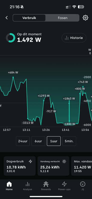

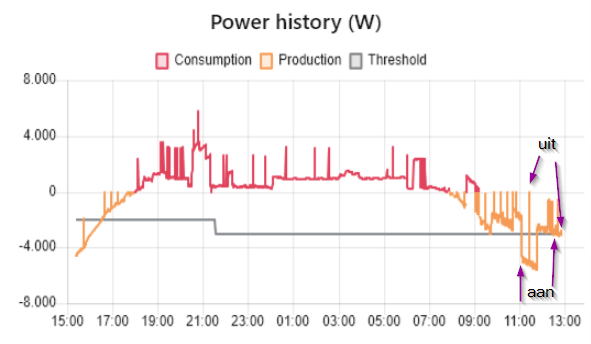

Misschien dat ik het al zie iets dat misschien het pendel-gedrag kan verklaren.
Als je panelen stroom leveren en je huishouden produceert meer stroom en komt voorbij de threshold van -3kW, dan begint uiteraard de pomp DHW te aan te sturen. Dit zie je ook in het log terug.
Zodra je pomp aan staat, gebruikt deze ook meer stroom. Het gevolg hiervan is dat je stroomproductie naar het net toe afneemt. Zo ver, logisch.
Je zou zeggen dat bij 3000 W, je genoeg ruimte hebt op je levering dat de pomp vrij uit zijn werk kan doen. Ik heb gisteren toevallig een grafiekje bijgemaakt op het dashboard dat het stroomgebruik van de pomp laat zien. Zie onderstaande afbeelding.
Afbeeldingslocatie: https://tweakers.net/i/GTYOdktNyiqQAZS0vtAmCAUeNyg=/800x/filters:strip_exif()/f/image/OgO712Ua4bIFVsWN46fndkSH.png?f=fotoalbum_large
Gemeten is het stroomgebruik van 2000 W tot ca 2500 W. Als de 53°C behaald is, dan gaat hij over op volledig elektrisch. Dus dat zal die piek zijn naar 4500 W. Klein stukje overlap van compressor + elektrisch.
Anyway... Van die 3000W wat je threshold is, hou je dus tijdens een DHW run 500-1000W over dat je levert.
Als iemand thuis op dat moment een waterkoker aanzet, dan kom je boven de 0 W levering uit, en stopt de DHW run.
Ik denk dat dit aan de hand is. Ik denk dat het 'pendel-gedrag' is.
Je kunt dit oplossen door die toggle "fallback to default DHW...." uit te laten. Dan zal hij dus niet meer stoppen met de DHW run tot hij echt de temperatuur bereikt heeft.
Dus als je die toggle uit zet, en je ziet het pendel-gedrag niet meer, dan was dat het.
Ik log die zelf niet. Ik heb net gekeken in heishamon. Ik denk dat het 1 van deze twee TOPS zou moeten zijn.
TOP60 Internal_Heater_State 0 Inactive
TOP61 External_Heater_State 0 Inactive
Maar zeker weten doe ik het niet. Misschien is er iemand die dit kan bevestigen.

Volgens de Tibber P1 grafieken ben ik overdag de hele dag aan het terugleveren geweest
Afbeeldingslocatie: https://tweakers.net/i/7HAFyZhOhA_pWXzeH_qPEaNXShc=/x800/filters:strip_exif()/f/image/6No7qtlHB3lLNiumSCQtCOQA.png?f=fotoalbum_large
Afbeeldingslocatie: https://tweakers.net/i/EBALdg3bFZPQc19V_RRV6ydXn0M=/x800/filters:strip_exif()/f/image/fbrM0srjQ7eYixFpz4bJK6wo.png?f=fotoalbum_large
Afbeeldingslocatie: https://tweakers.net/i/agVZTQnAuffynpowrQbvKuy8_bg=/x800/filters:strip_exif()/f/image/krQmDinoNSbf00rSabA7W1MG.png?f=fotoalbum_large
Afbeeldingslocatie: https://tweakers.net/i/1KufSpoygwSE-j40WhXc3-f5Nys=/x800/filters:strip_exif()/f/image/gx9hZbZLY559AynAC7gXbBOx.png?f=fotoalbum_large
Afbeeldingslocatie: https://tweakers.net/i/KUx9J_0Ae30NKow2utDefbWt5iM=/x800/filters:strip_exif()/f/image/MHOz382siccNCEI7J1PHSGPD.png?f=fotoalbum_large

Ja, het ziet er op de grafiekjes wel zo uit ja.
Maar je ziet dus niet alle datapunten in de grafiekjes. Er zal best een filter per minuut op zitten of zo. Dus dat je het niet ziet kan.
De flow bekijkt werkelijk ieder binnenkomend signaal. Berekent het resultaat . Dat is seconden data.
Het is niet uit te sluiten denk ik met deze vergroting.
Kun je inzoemen op het tijdstip waar je ziet in het logboek dat de DHW cyclus gestopt was?
Als je daar ook op gedetaileerdere data ook ziet dat er geen dipje was, dan is het inderdaad vreemd.
Anyway.
Ik zie nog steeds in je grafiek dat alleen de grafiek van "Power history" goed werkt.
Ik zie Todays result nog wat vreemds.
Bij Todays result verwacht ik dat als je huishouden stroom consumptie heeft, dat de blauwe lijn naar boven gaat. Bij productie naar beneden.
Jouw grafiek laat alleen de lijn naar beneden toe zien, nooit omhoog.
Ik mis ook de balkjes aan de linker kant van die grafiek
Heb je de p1 meter aangesloten of alleen de zonnestroom productie?

edterbak schreef op vrijdag 7 maart 2025 @ 21:08:
Anyway.
ja ik kon de grafieken ook al niet verklaren, dacht al dat het aan mij lag :P
P1 en Productie zijn aangesloten
sensor.tibber_pulse_hemertje_power_production
Afbeeldingslocatie: https://tweakers.net/i/VU_aRr4PRIBAmlOAEqioNmg2Mjo=/800x/filters:strip_exif()/f/image/NUjF5NhwMqcOngLPM5a98EUI.png?f=fotoalbum_large
Gasloos 2019 + WP Panasonic H-serie 7kW + 300 liter boilervat + PV 12.415Wp + Home Assistant + Hyundai Ioniq 6 First Edition + Zaptec laadpaal

Ja,
En toch gaat er iets nog niet helemaal goed.
Een mooie parabool...
Afbeeldingslocatie: https://tweakers.net/i/l5ioB60YgrOYCgIdwsToCSEow9Y=/fit-in/4000x4000/filters:no_upscale():strip_exif()/f/image/oRZTfXImldGoPxYpq7FdsjzC.png?f=user_large
Een mooie parabool
Afbeeldingslocatie: https://tweakers.net/i/4JcG7CsIkC1r-WqhAQ9XsWytpO4=/fit-in/4000x4000/filters:no_upscale():strip_exif()/f/image/AvlGuzClm1iHp9HqA1pvyuWk.png?f=user_large
Een plat dak...
Afbeeldingslocatie: https://tweakers.net/i/hN-HJzxPLG4YSt-5Tw7EGjiHRcU=/fit-in/4000x4000/filters:no_upscale():strip_exif()/f/image/zBh7mH8etxuQ9d5N9lktydLG.png?f=user_large
Dit is niet natuurlijk. Er is dus iets aan de hand wat niet klopt. Ik heb nu alleen nog geen idee waar dit in kan zitten.
Aarh...Never mind. Dat is consumptie :D :D :D plat dak is op zich wel fijn hier hahahaha.. suffert. (me)
Misschien moet je even het zelfde tijdvak laten zien van Node Red in de grafiek. Dit heeft me op het verkeerde been gezet hahaha.

Ik denk wel dat het klopt, het aan/uit gaan van de DHW cyclus op basis van de grafiek.
Uit je log
07/03 13:15:53 - Function Solar: triggered threshold (undefined). Above 0kWh threshold. DHW SP to 52
Afbeeldingslocatie: https://tweakers.net/i/FA3CFbGIerILPuL_ko99Wgmv3y0=/fit-in/4000x4000/filters:no_upscale():strip_exif()/f/image/l6VOR8o31kmdfbjp96o3s8xV.png?f=user_large
1 van de events staat in de tijdlijn, deze niet 13:15:53
[ Voor 5% gewijzigd door edterbak op 07-03-2025 21:37 ]

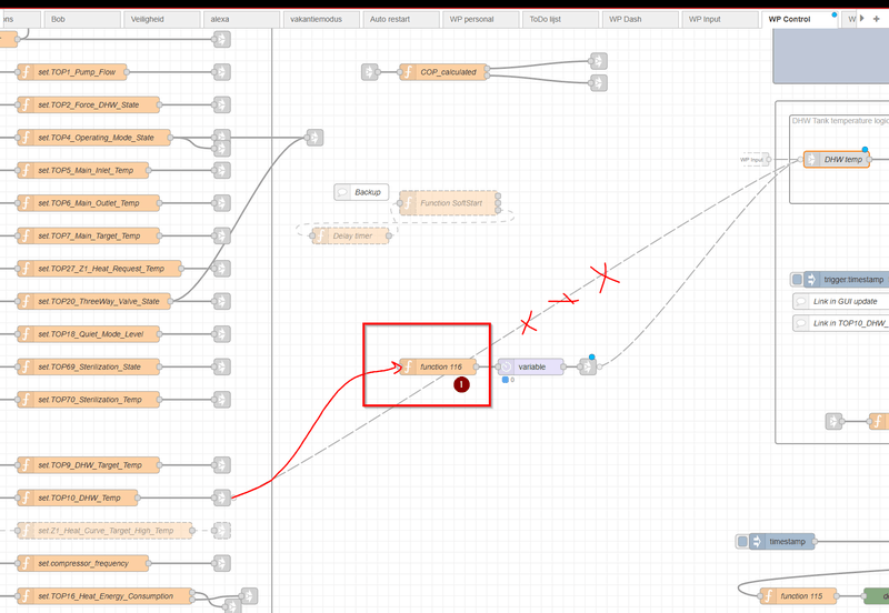

  • edterbak
  • Laatst online: 26-09 21:16
@hemertje
Als je naar de grafieken van je gaat kijken, dan zie je wel dat het wat 'spikey' is.
De afbeelding waar ik hier boven wat pijltjes in heb gezet, laat dat ook duidelijk zien.
Zitten deze spikes nu ook in de data van je p1 sensor, in deze plaatjes.
hemertje in "Heishamon <> Node Red voor Panasonic warmtepompen"
Je ziet wat lichtblauwe lijntjes onder de dikkere lijn. Zijn dit die zelfde piekjes? Of is dit wat anders?

I have been looking at the code now for some time. I cant seem to find the cause.
I have tested it myself yesterday. It worked here without any issue together with NightReduction.
But I am running the pump in compensation curve mode currently. I will try Direct mode today.
Could you also try to change a setting in the softstart part to see if this helps?
Softstart > Advanced settings > Phase 1 > Catch duration : 175 seconds
Softstart > Advanced settings > Phase 2 > Message delay: 30 seconds
Disable QuitMode add-on in the main setting page. Rule out any combi error.

- kan je 'DHW Setpoint' in de NR-code nog koppelen aan 'DHW temperature setpoint - low' zodat deze altijd gelijk zijn aan elkaar?
Korte antwoord: Nee.... Ghehee.
De reden.
Als een gebruiker DHW setpoint (settings tab) aanpast, dan verwacht die altijd response.
Als Solar2DHW wel actief is, dan is 'Solar dhw - Setpoint HIGH' actief
Als Solar2DHW niet actief is, dan is 'Solar dhw - Setpoint LOW' actief
Als solar2DHW enabled is (toggle is aan) , dan wordt iedere nacht het setpoint gereset naar low.
Als een gebruiker het setpoint aanpast, moet deze niet vergeten dat dit wordt 'overschreven' door de setpoints zoals gezet in solar2dhw.
Je krijgt hier een popup van.

De reden.
Als solar2dhw functie niet aan staat, dan komt deze popup niet.
dan aub een check inbouwen

boredgeestje schreef op dinsdag 11 maart 2025 @ 21:15:
Nog een idee voor het dashboard (voor zover niet nu al te doen?):
Bij het bereiken van het DHW-start setpoint een tijdsverlenging voor de daadwerkelijke start van de DHW-run kunnen instellen.
Mijn setpoint is bijv. 46 graden. Als ik douche en mijn 192 liter tank koelt af naar die temperatuur, verstoort de DHW run de gelaagdheid van het vat en is de resterende bruikbare warmte bovenin het vat snel weg.
Waarom dan geen lager setpoint? De ervaring daarbij heeft geleerd dat een lager setpoint veel minder bruikbare warmte in het vat geeft. Als ik ga douchen en het vat zit bijv. net boven een setpoint van 40 graden, dan heb ik al te snel een lauwe douche. Zeker icm een direct startende run op het boilervat als het setpoint gemaakt wordt. Niet goed voor de WAF 😄
Je kan het zelf testen door dit te importeren in [WP Control] tab.

De draadjes op deze manier verbreken en aansluiten. De stippellijnen zie je als je op de link-in/link-out node klikt welke je in de afbeelding ziet.
Afbeeldingslocatie: https://tweakers.net/i/cukW1gmWntztVAxx-AjkDawnWAg=/800x/filters:strip_exif()/f/image/zpikdhWDrlHC0U16aG2VQLGb.png?f=fotoalbum_large
De functie (1) openen en het getal achter 'delay' aanpassen.
var varDelay = 5; // in minutes  <<<< Adjust to desire
Delay is de tijd die je wilt tussen trigger en het daadwerkelijk aanslaan.
Nu kun je even testen of het werkt. en een verbetering geef.t

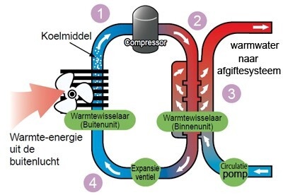

Ja, een defrost komt door ijs op de radiator.
De compressor comprimeert een gas tot vloeistof. Hierbij warmte vrij. Dit snoept de cv water vrolijk op en dat gaat het huis in.
Als de compressiewarmte afgegeven is, gaat de vloeistof door een ventiel(verdamper) waarin de vloeistof weer een gas word. Het verdampen kost juist heel veel energie. Op dit moment is het gas behoorlijk veel kouder dan het begon voor de compressor even eerder. Om weer terug te komen op de begin temperatuur moet het weer worden opgewarmd.
Deze energie (warmte) trekt de pomp uit de buitenlucht mbv een ventilator.
De ventilatie lucht uit een warmtepomp is dus altijd flink kouder dan de lucht temperatuur.
Gevolgd is dat bij temperaturen rond het vriespunt buiten, de boel dicht vriest.
Je ziet al dat het dichtvriezen niks te maken heeft met je cv water temperatuur. :)

  • wumpe
  • Registratie: Maart 2025
  • Laatst online: 04-05-2025
edterbak schreef op dinsdag 11 maart 2025 @ 08:57:
Good Morning @edterbak
yesterday i have startet a run with night reduction -2 degress and quietmode off. catch duration is 175 and message delay is 30. outdoortemp is +3 degress.
Afbeeldingslocatie: https://tweakers.net/i/cY7IXT-NFv55ebClUEVkkCsa75g=/fit-in/4000x4000/filters:no_upscale():strip_exif()/f/image/kMUEYBfzKjF7bRpLEZBZc7Y2.png?f=user_large
Afbeeldingslocatie: https://tweakers.net/i/-FImUr3b0gd88AHp8nN9QnHjRCg=/800x/filters:strip_exif()/f/image/8KMOnUmv83cpuFQCHzNt3Q3e.png?f=fotoalbum_large
it looks better, but the frenquency on start is very strong. i have a t-cap 9kW super quiet on a old house with 22000kwh heatconsumption anno. (water flow max is 31 L/min and the TRV every all open)
i test in a few days on outdoortemp > 7 degress
thx and a good day :)
