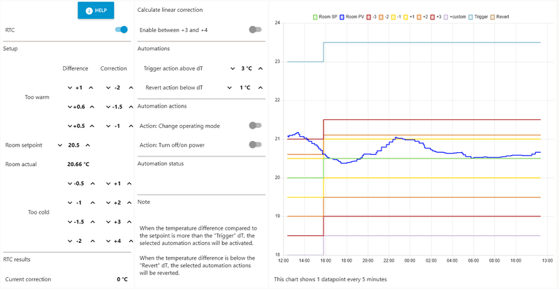

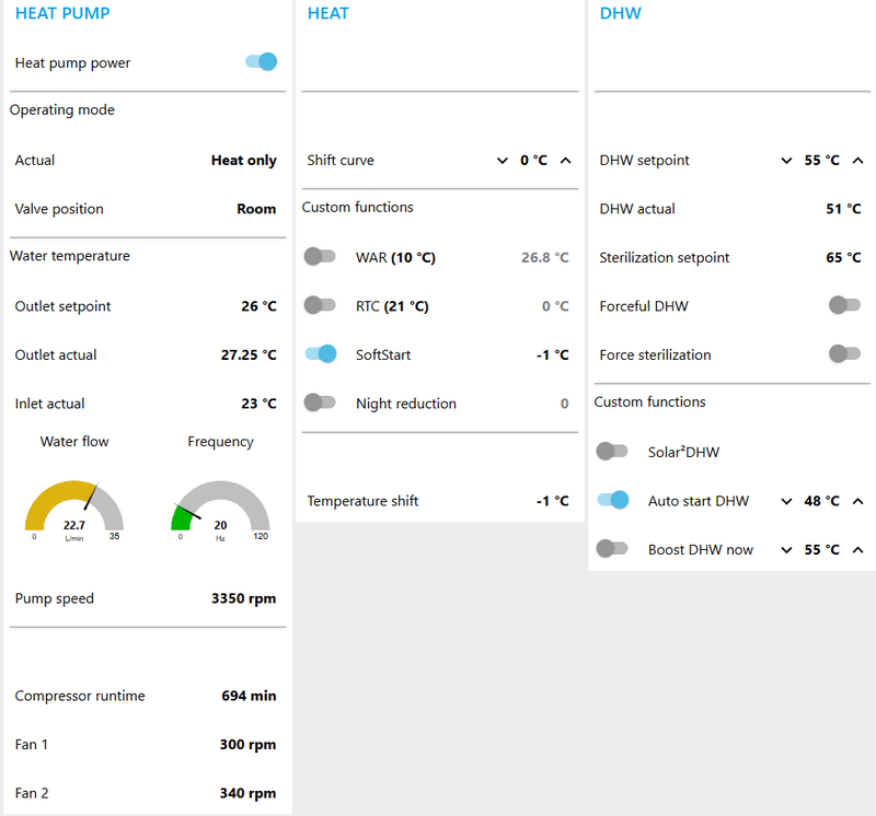

gisteravond een aanpassing gedaan aan de WAR en RTC
de temperatuur die nu in de woonkamer gemeten wordt is vrijwel de ingestelde temperatuur, dus dat is goed
Room setpoint 20.5
Room actual 20.66 °
Afbeeldingslocatie: https://tweakers.net/i/W8Wlu5M4gT2c7mL7RJSqwah-VJs=/800x/filters:strip_exif()/f/image/9hwclNW0uxsFNaULjipIQ0gx.png?f=fotoalbum_large
Afbeeldingslocatie: https://tweakers.net/i/DxJWCyZ06HhdhWauWmSwqzFKu5Q=/800x/filters:strip_exif()/f/image/xmnhUkezubApAhNJUlkDjLEW.png?f=fotoalbum_large
Afbeeldingslocatie: https://tweakers.net/i/7R9FWYlbhVm6dGoCP0M0JVHLbE4=/800x/filters:strip_exif()/f/image/Y9jBR2xNKpXI62Bdg6sfMJrc.png?f=fotoalbum_large
alleen loopt het systeem heel onrustig nu

Flow version
24.07 Stable
20/12 11:50:54 - Function - Calculate new SP: New final SP calculated: Current setpoint: 28 °C. New calculated setpoint: 27 °C
20/12 11:50:54 - Function SoftStart: SoftStart function end
20/12 11:50:54 - TOP20_ThreeWay_Valve_State: 1
20/12 11:48:08 - Function SoftStart: --> Pump did not yet relax (24Hz). Restarting Phase 1 again...
20/12 11:47:58 - Function SoftStart: Correction: 1 > 1 °C - (EVALUATING) Freq: 24Hz, SP_Final: 21°C
20/12 11:44:57 - Function SoftStart: --> Pump did not yet relax (24Hz). Restarting Phase 1 again...
20/12 11:44:54 - Function SoftStart: Correction: 1 > 1 °C - (EVALUATING) Freq: 24Hz, SP_Final: 21°C
20/12 11:44:47 - Function SoftStart: Correction: 1 > 1 °C - (EVALUATING) Freq: 23Hz, SP_Final: 21°C
20/12 11:41:53 - MQTT Command: SetCurves: target: 28 (SP Calculation)
20/12 11:41:53 - Function - Calculate new SP: New final SP calculated: Current setpoint: 29 °C. New calculated setpoint: 28 °C
20/12 11:41:53 - Function SoftStart: Correction: 2 > 1 °C - (STARTUP) Freq: 28Hz, SP_Final: 21°C
20/12 11:41:47 - Function SoftStart: --> Pump did not yet relax (27Hz). Restarting Phase 1 again...
20/12 11:41:43 - MQTT Command: SetCurves: target: 29 (SP Calculation)
20/12 11:41:43 - Function - Calculate new SP: New final SP calculated: Current setpoint: 28 °C. New calculated setpoint: 29 °C
20/12 11:41:43 - Function SoftStart: Correction: 1 > 2 °C - (EVALUATING) Freq: 28Hz, SP_Final: 22°C
20/12 11:41:36 - Function SoftStart: Correction: 1 > 1 °C - (EVALUATING) Freq: 27Hz, SP_Final: 21°C
20/12 11:40:11 - MQTT Command: SetCurves: target: 28 (SP Calculation)
20/12 11:40:11 - Function - Calculate new SP: New final SP calculated: Current setpoint: 29 °C. New calculated setpoint: 28 °C
20/12 11:40:02 - Function SoftStart: Correction: 2 > 1 °C - (STARTUP) Freq: 27Hz, SP_Final: 21°C
20/12 11:40:01 - MQTT Command: SetCurves: target: 29 (SP Calculation)
20/12 11:40:01 - Function - Calculate new SP: New final SP calculated: Current setpoint: 28 °C. New calculated setpoint: 29 °C
20/12 11:40:01 - Function SoftStart: Correction: 1 > 2 °C - (STARTUP) Freq: 27Hz, SP_Final: 22°C
20/12 11:38:36 - Function SoftStart: --> Pump did not yet relax (28Hz). Restarting Phase 1 again...
20/12 11:38:26 - Function SoftStart: Correction: 1 > 1 °C - (EVALUATING) Freq: 28Hz, SP_Final: 21°C
20/12 11:36:07 - MQTT Command: SetCurves: target: 28 (SP Calculation)
20/12 11:36:07 - Function - Calculate new SP: New final SP calculated: Current setpoint: 29 °C. New calculated setpoint: 28 °C
20/12 11:35:57 - Function SoftStart: Correction: 2 > 1 °C - (STARTUP) Freq: 27Hz, SP_Final: 21°C
20/12 11:35:56 - MQTT Command: SetCurves: target: 29 (SP Calculation)
20/12 11:35:56 - Function - Calculate new SP: New final SP calculated: Current setpoint: 28 °C. New calculated setpoint: 29 °C
20/12 11:35:56 - Function SoftStart: Correction: 1 > 2 °C - (STARTUP) Freq: 28Hz, SP_Final: 22°C
20/12 11:35:25 - Function SoftStart: --> Pump did not yet relax (28Hz). Restarting Phase 1 again...
20/12 11:35:18 - Function SoftStart: Correction: 1 > 1 °C - (EVALUATING) Freq: 27Hz, SP_Final: 21°C
20/12 11:35:18 - Function WAR: Setpoint change: From 26.7 to 26.6 °C
20/12 11:35:15 - Function SoftStart: Correction: 1 > 1 °C - (EVALUATING) Freq: 28Hz, SP_Final: 21°C
20/12 11:35:03 - MQTT Command: SetCurves: target: 28 (SP Calculation)
20/12 11:35:03 - Function - Calculate new SP: New final SP calculated: Current setpoint: 29 °C. New calculated setpoint: 28 °C
20/12 11:34:53 - Function SoftStart: Correction: 2 > 1 °C - (STARTUP) Freq: 27Hz, SP_Final: 21°C
20/12 11:34:51 - MQTT Command: SetCurves: target: 29 (SP Calculation)
20/12 11:34:51 - Function - Calculate new SP: New final SP calculated: Current setpoint: 28 °C. New calculated setpoint: 29 °C
20/12 11:34:51 - Function SoftStart: Correction: 1 > 2 °C - (STARTUP) Freq: 28Hz, SP_Final: 22°C
20/12 11:34:10 - MQTT Command: SetCurves: target: 28 (SP Calculation)
20/12 11:34:10 - Function - Calculate new SP: New final SP calculated: Current setpoint: 29 °C. New calculated setpoint: 28 °C
20/12 11:34:01 - Function SoftStart: Correction: 2 > 1 °C - (STARTUP) Freq: 28Hz, SP_Final: 21°C
20/12 11:34:01 - MQTT Command: SetCurves: target: 29 (SP Calculation)
20/12 11:34:01 - Function - Calculate new SP: New final SP calculated: Current setpoint: 28 °C. New calculated setpoint: 29 °C
20/12 11:34:01 - Function SoftStart: Correction: 1 > 2 °C - (STARTUP) Freq: 28Hz, SP_Final: 22°C
20/12 11:33:49 - MQTT Command: SetCurves: target: 28 (SP Calculation)
20/12 11:33:49 - Function - Calculate new SP: New final SP calculated: Current setpoint: 29 °C. New calculated setpoint: 28 °C

20/12 08:01:22 - Function SoftStart: Correction: 1 > 2 °C - (STARTUP) Freq: 29Hz, SP_Final: 22°C
20/12 08:00:01 - Function SoftStart: --> Pump did not yet relax (30Hz). Restarting Phase 1 again...
20/12 07:59:51 - Function SoftStart: Correction: 1 > 1 °C - (EVALUATING) Freq: 30Hz, SP_Final: 21°C
20/12 07:56:50 - Function SoftStart: --> Pump did not yet relax (29Hz). Restarting Phase 1 again...
20/12 07:56:40 - Function SoftStart: Correction: 1 > 1 °C - (EVALUATING) Freq: 29Hz, SP_Final: 21°C
20/12 07:53:40 - Function SoftStart: --> Pump did not yet relax (30Hz). Restarting Phase 1 again...
20/12 07:53:29 - Function SoftStart: Correction: 1 > 1 °C - (EVALUATING) Freq: 30Hz, SP_Final: 21°C
20/12 07:50:29 - Function SoftStart: --> Pump did not yet relax (29Hz). Restarting Phase 1 again...
20/12 07:50:19 - Function SoftStart: Correction: 1 > 1 °C - (EVALUATING) Freq: 29Hz, SP_Final: 21°C
20/12 07:47:18 - Function SoftStart: --> Pump did not yet relax (30Hz). Restarting Phase 1 again...
20/12 07:47:08 - Function SoftStart: Correction: 1 > 1 °C - (EVALUATING) Freq: 29Hz, SP_Final: 21°C
20/12 07:44:07 - Function SoftStart: --> Pump did not yet relax (29Hz). Restarting Phase 1 again...
20/12 07:43:57 - Function SoftStart: Correction: 1 > 1 °C - (EVALUATING) Freq: 29Hz, SP_Final: 21°C
20/12 07:40:57 - Function SoftStart: --> Pump did not yet relax (29Hz). Restarting Phase 1 again...
20/12 07:40:46 - Function SoftStart: Correction: 1 > 1 °C - (EVALUATING) Freq: 30Hz, SP_Final: 21°C
20/12 07:37:46 - Function SoftStart: --> Pump did not yet relax (30Hz). Restarting Phase 1 again...
20/12 07:37:42 - Function SoftStart: Correction: 1 > 1 °C - (EVALUATING) Freq: 30Hz, SP_Final: 21°C
20/12 07:37:36 - Function SoftStart: Correction: 1 > 1 °C - (EVALUATING) Freq: 29Hz, SP_Final: 21°C
20/12 07:34:35 - Function SoftStart: --> Pump did not yet relax (29Hz). Restarting Phase 1 again...
20/12 07:34:25 - Function SoftStart: Correction: 1 > 1 °C - (EVALUATING) Freq: 29Hz, SP_Final: 21°C
20/12 07:31:24 - Function SoftStart: --> Pump did not yet relax (30Hz). Restarting Phase 1 again...
20/12 07:31:22 - Function SoftStart: Correction: 1 > 1 °C - (EVALUATING) Freq: 30Hz, SP_Final: 21°C
20/12 07:31:17 - Function SoftStart: Correction: 1 > 1 °C - (EVALUATING) Freq: 29Hz, SP_Final: 21°C
20/12 07:31:14 - Function SoftStart: Correction: 1 > 1 °C - (EVALUATING) Freq: 30Hz, SP_Final: 21°C
20/12 07:28:14 - Function SoftStart: --> Pump did not yet relax (29Hz). Restarting Phase 1 again...
20/12 07:28:03 - Function SoftStart: Correction: 1 > 1 °C - (EVALUATING) Freq: 30Hz, SP_Final: 21°C
20/12 07:25:03 - Function SoftStart: --> Pump did not yet relax (29Hz). Restarting Phase 1 again...
20/12 07:24:53 - Function SoftStart: Correction: 1 > 1 °C - (EVALUATING) Freq: 29Hz, SP_Final: 21°C
20/12 07:21:52 - Function SoftStart: --> Pump did not yet relax (29Hz). Restarting Phase 1 again...
20/12 07:21:42 - Function SoftStart: Correction: 1 > 1 °C - (EVALUATING) Freq: 29Hz, SP_Final: 21°C
20/12 07:18:41 - Function SoftStart: --> Pump did not yet relax (29Hz). Restarting Phase 1 again...
20/12 07:18:31 - Function SoftStart: Correction: 1 > 1 °C - (EVALUATING) Freq: 30Hz, SP_Final: 21°C
20/12 07:15:31 - Function SoftStart: --> Pump did not yet relax (30Hz). Restarting Phase 1 again...
20/12 07:15:20 - Function SoftStart: Correction: 1 > 1 °C - (EVALUATING) Freq: 29Hz, SP_Final: 21°C
20/12 07:12:20 - Function SoftStart: --> Pump did not yet relax (29Hz). Restarting Phase 1 again...
20/12 07:12:10 - Function SoftStart: Correction: 1 > 1 °C - (EVALUATING) Freq: 29Hz, SP_Final: 21°C
20/12 07:09:09 - Function SoftStart: --> Pump did not yet relax (30Hz). Restarting Phase 1 again...
20/12 07:08:59 - Function SoftStart: Correction: 1 > 1 °C - (EVALUATING) Freq: 30Hz, SP_Final: 21°C
20/12 07:05:58 - Function SoftStart: --> Pump did not yet relax (29Hz). Restarting Phase 1 again...
20/12 07:05:48 - Function SoftStart: Correction: 1 > 1 °C - (EVALUATING) Freq: 29Hz, SP_Final: 21°C
20/12 07:04:07 - MQTT Command: SetCurves: target: 28 (SP Calculation)
20/12 07:04:07 - Function - Calculate new SP: New final SP calculated: Current setpoint: 29 °C. New calculated setpoint: 28 °C
20/12 07:04:05 - Function SoftStart: Correction: 2 > 1 °C - (STARTUP) Freq: 30Hz, SP_Final: 21°C
20/12 07:04:04 - Function SoftStart: Correction: 1 > 2 °C - (STARTUP) Freq: 31Hz, SP_Final: 22°C
20/12 07:03:59 - Function SoftStart: Correction: 2 > 1 °C - (STARTUP) Freq: 33Hz, SP_Final: 21°C
20/12 07:03:59 - MQTT Command: SetCurves: target: 29 (SP Calculation)
20/12 07:03:59 - Function - Calculate new SP: New final SP calculated: Current setpoint: 28 °C. New calculated setpoint: 29 °C
20/12 07:03:59 - Function SoftStart: Correction: 1 > 2 °C - (STARTUP) Freq: 33Hz, SP_Final: 22°C
20/12 07:02:48 - Function SoftStart: --> Pump did not yet relax (34Hz). Restarting Phase 1 again...
20/12 07:02:37 - Function SoftStart: Correction: 1 > 1 °C - (EVALUATING) Freq: 35Hz, SP_Final: 21°C
20/12 06:59:37 - Function SoftStart: --> Pump did not yet relax (34Hz). Restarting Phase 1 again...
20/12 06:59:27 - Function SoftStart: Correction: 1 > 1 °C - (EVALUATING) Freq: 34Hz, SP_Final: 21°C
20/12 06:56:26 - Function SoftStart: --> Pump did not yet relax (35Hz). Restarting Phase 1 again...
20/12 06:56:16 - Function SoftStart: Correction: 1 > 1 °C - (EVALUATING) Freq: 34Hz, SP_Final: 21°C
20/12 06:55:11 - MQTT Command: SetCurves: target: 28 (SP Calculation)
20/12 06:55:11 - Function - Calculate new SP: New final SP calculated: Current setpoint: 27 °C. New calculated setpoint: 28 °C
20/12 06:55:03 - Function SoftStart: Correction: 0 > 1 °C - (STARTUP) Freq: 35Hz, SP_Final: 21°C
20/12 06:55:00 - MQTT Command: SetCurves: target: 27 (SP Calculation)
20/12 06:54:24 - Function - Calculate new SP: New final SP calculated: Current setpoint: 28 °C. New calculated setpoint: 27 °C
20/12 06:54:20 - Function SoftStart: Correction: 1 > 0 °C - (STARTUP) Freq: 35Hz, SP_Final: 20°C
20/12 06:53:47 - MQTT Command: SetCurves: target: 28 (SP Calculation)
20/12 06:53:47 - Function - Calculate new SP: New final SP calculated: Current setpoint: 27 °C. New calculated setpoint: 28 °C
20/12 06:53:38 - Function SoftStart: Correction: 0 > 1 °C - (STARTUP) Freq: 39Hz, SP_Final: 21°C
20/12 06:53:34 - MQTT Command: SetCurves: target: 27 (SP Calculation)
20/12 06:53:34 - Function - Calculate new SP: New final SP calculated: Current setpoint: 28 °C. New calculated setpoint: 27 °C
20/12 06:53:29 - Function SoftStart: Correction: 1 > 0 °C - (STARTUP) Freq: 39Hz, SP_Final: 20°C
20/12 06:53:28 - MQTT Command: SetCurves: target: 28 (SP Calculation)
20/12 06:53:28 - Function - Calculate new SP: New final SP calculated: Current setpoint: 27 °C. New calculated setpoint: 28 °C
20/12 06:53:28 - Function SoftStart: Correction: 0 > 1 °C - (STARTUP) Freq: 40Hz, SP_Final: 21°C
20/12 06:53:19 - MQTT Command: SetCurves: target: 27 (SP Calculation)
20/12 06:53:19 - Function - Calculate new SP: New final SP calculated: Current setpoint: 28 °C. New calculated setpoint: 27 °C
20/12 06:53:19 - Function SoftStart: Correction: 1 > 0 °C - (STARTUP) Freq: 39Hz, SP_Final: 20°C
20/12 06:53:15 - Function SoftStart: --> Pump did not yet relax (40Hz). Restarting Phase 1 again...
20/12 06:53:05 - Function SoftStart: Correction: 1 > 1 °C - (EVALUATING) Freq: 39Hz, SP_Final: 21°C
20/12 06:52:48 - MQTT Command: SetCurves: target: 28 (SP Calculation)
20/12 06:52:48 - Function - Calculate new SP: New final SP calculated: Current setpoint: 27 °C. New calculated setpoint: 28 °C
20/12 06:52:48 - Function SoftStart: Correction: 0 > 1 °C - (STARTUP) Freq: 44Hz, SP_Final: 21°C
20/12 06:51:54 - MQTT Command: SetQuietMode: 0 (SoftStart Quietmode)
20/12 06:51:54 - Function SoftStart Quietmode: Timer ended, restoring quiet mode to level 0
20/12 06:50:05 - Function SoftStart: --> Pump did not yet relax (44Hz). Restarting Phase 1 again...
20/12 06:49:54 - Function SoftStart: Correction: 0 > 0 °C - (EVALUATING) Freq: 44Hz, SP_Final: 20°C
20/12 06:49:02 - MQTT Command: SetCurves: target: 27 (SP Calculation)
20/12 06:49:02 - Function - Calculate new SP: New final SP calculated: Current setpoint: 26 °C. New calculated setpoint: 27 °C
20/12 06:49:02 - Function SoftStart: Correction: -1 > 0 °C - (STARTUP) Freq: 45Hz, SP_Final: 20°C
20/12 06:48:37 - MQTT Command: SetCurves: target: 26 (SP Calculation)
20/12 06:48:37 - Function - Calculate new SP: New final SP calculated: Current setpoint: 25 °C. New calculated setpoint: 26 °C
20/12 06:48:37 - Function SoftStart: Correction: -2 > -1 °C - (STARTUP) Freq: 42Hz, SP_Final: 19°C
20/12 06:47:37 - MQTT Command: SetCurves: target: 25 (SP Calculation)
20/12 06:47:37 - Function - Calculate new SP: New final SP calculated: Current setpoint: 23 °C. New calculated setpoint: 25 °C
20/12 06:47:37 - Function SoftStart: Correction: -3 > -2 °C - (STARTUP) Freq: 20Hz, SP_Final: 18°C
20/12 06:47:34 - Function - Calculate new SP: New final SP calculated: Current setpoint: 23 °C. New calculated setpoint: 24 °C
20/12 06:47:29 - MQTT Command: SetCurves: target: 24 (SP Calculation)
20/12 06:47:27 - Function - Calculate new SP: New final SP calculated: Current setpoint: 22 °C. New calculated setpoint: 24 °C
20/12 06:47:27 - Function SoftStart: Correction: -4 > -3 °C - (STARTUP) Freq: 20Hz, SP_Final: 17°C
20/12 06:47:24 - MQTT Command: SetCurves: target: 23 (SP Calculation)
20/12 06:47:24 - Function - Calculate new SP: New final SP calculated: Current setpoint: 22 °C. New calculated setpoint: 23 °C
20/12 06:47:12 - Function SoftStart: Correction: -5 > -4 °C - (STARTUP) Freq: 19Hz, SP_Final: 16°C
20/12 06:47:09 - MQTT Command: SetCurves: target: 22 (SP Calculation)
20/12 06:47:09 - Function - Calculate new SP: New final SP calculated: Current setpoint: 23 °C. New calculated setpoint: 22 °C
20/12 06:47:03 - Function SoftStart: Correction: -4 > -5 °C - (STARTUP) Freq: 18Hz, SP_Final: 15°C
20/12 06:47:03 - MQTT Command: SetCurves: target: 23 (SP Calculation)
20/12 06:47:03 - Function - Calculate new SP: New final SP calculated: Current setpoint: 27 °C. New calculated setpoint: 23 °C
20/12 06:47:03 - Function SoftStart: Correction: -5 > -4 °C - (STARTUP) Freq: 17Hz, SP_Final: 16°C
20/12 06:46:59 - MQTT Command: SetCurves: target: 22 (SP Calculation)
20/12 06:46:59 - Function - Calculate new SP: New final SP calculated: Current setpoint: 27 °C. New calculated setpoint: 22 °C
20/12 06:46:59 - Function SoftStart: Correction: -4 > -5 °C - (STARTUP) Freq: 17Hz, SP_Final: 15°C
20/12 06:46:54 - MQTT Command: SetCurves: target: 23 (SP Calculation)
20/12 06:46:54 - Function - Calculate new SP: New final SP calculated: Current setpoint: 27 °C. New calculated setpoint: 23 °C
20/12 06:46:54 - Function SoftStart: Correction: 0 > -4 °C - (STARTUP) Freq: 5Hz, SP_Final: 16°C
20/12 06:46:54 - Compressor: running
20/12 06:46:54 - Function SoftStart Quietmode: Timer started (5 minutes)
20/12 06:36:54 - MQTT Command: SetCurves: target: 27 (SP Calculation)
20/12 06:36:54 - Function - Calculate new SP: New final SP calculated: Current setpoint: 34 °C. New calculated setpoint: 27 °C
20/12 06:36:47 - Function SoftStart: SoftStart function end
20/12 06:36:47 - Compressor: stopped
20/12 06:36:47 - Function SoftStart Quietmode: Compressor run ended, quiet mode is already set to level 3
20/12 06:36:47 - MQTT Command: SetCurves: target: 34 (SP Calculation)
20/12 06:36:47 - Function - Calculate new SP: New final SP calculated: Current setpoint: 27 °C. New calculated setpoint: 34 °C
20/12 06:36:47 - Function SoftStart: Correction: 0 > 7 °C - (STARTUP) Freq: 36Hz, SP_Final: 27°C
20/12 06:36:44 - MQTT Command: SetQuietMode: 3 (QuietMode Manager)
20/12 06:36:44 - Quiet mode manager: Detected 3-way valve set to HEAT position again. Restoring quiet mode to level 3
20/12 06:36:44 - TOP20_ThreeWay_Valve_State: 0
20/12 06:25:33 - MQTT Command: SetQuietMode: 0 (SoftStart Quietmode)
20/12 06:25:33 - Function SoftStart Quietmode: Timer ended, restoring quiet mode to level 0
20/12 06:20:33 - Compressor: running
20/12 06:20:33 - Function SoftStart Quietmode: Timer started (5 minutes)
20/12 05:54:57 - MQTT Command: SetQuietMode: 3 (SoftStart Quietmode)
20/12 05:54:57 - Compressor: stopped
20/12 05:54:57 - Function SoftStart Quietmode: Compressor run ended, quiet mode set to level 3 for next run
20/12 05:28:34 - MQTT Command: SetQuietMode: 0 (SoftStart Quietmode)
20/12 05:28:34 - Function SoftStart Quietmode: Timer ended, restoring quiet mode to level 0
20/12 05:23:34 - Compressor: running
20/12 05:23:34 - Function SoftStart Quietmode: Timer started (5 minutes)
20/12 04:58:18 - MQTT Command: SetQuietMode: 3 (SoftStart Quietmode)
20/12 04:58:18 - Compressor: stopped
20/12 04:58:18 - Function SoftStart Quietmode: Compressor run ended, quiet mode set to level 3 for next run
20/12 04:32:46 - MQTT Command: SetQuietMode: 0 (SoftStart Quietmode)
20/12 04:32:46 - Function SoftStart Quietmode: Timer ended, restoring quiet mode to level 0
20/12 04:27:46 - Compressor: running
20/12 04:27:46 - Function SoftStart Quietmode: Timer started (5 minutes)
20/12 04:01:19 - MQTT Command: SetQuietMode: 3 (SoftStart)
20/12 04:01:19 - Compressor: stopped
20/12 04:01:19 - Function SoftStart Quietmode: Compressor run ended, quiet mode set to level 3 for next run
20/12 03:36:47 - Function SoftStart: SoftStart function end
20/12 03:36:47 - TOP20_ThreeWay_Valve_State: 1
20/12 03:29:13 - Function SoftStart: --> Pump relaxed... (19Hz) Continuing with Phase 2
20/12 03:29:03 - Function SoftStart: Correction: 0 > 0 °C - (EVALUATING) Freq: 20Hz, SP_Final: 20°C
20/12 03:28:51 - Function SoftStart: Correction: 1 > 0 °C - (STARTUP) Freq: 20Hz, SP_Final: 20°C
20/12 03:27:34 - Function SoftStart: Correction: 0 > 1 °C - (STARTUP) Freq: 25Hz, SP_Final: 21°C
20/12 03:27:26 - Function SoftStart: Correction: 1 > 0 °C - (STARTUP) Freq: 24Hz, SP_Final: 20°C
20/12 03:27:14 - Function SoftStart: Correction: 0 > 1 °C - (STARTUP) Freq: 24Hz, SP_Final: 21°C
20/12 03:27:01 - Function SoftStart: Correction: 1 > 0 °C - (STARTUP) Freq: 24Hz, SP_Final: 20°C
20/12 03:26:59 - Function SoftStart: Correction: 0 > 1 °C - (STARTUP) Freq: 24Hz, SP_Final: 21°C
20/12 03:26:41 - Function SoftStart: Correction: 1 > 0 °C - (STARTUP) Freq: 25Hz, SP_Final: 20°C
20/12 03:26:34 - Function SoftStart: Correction: 0 > 1 °C - (STARTUP) Freq: 25Hz, SP_Final: 21°C
20/12 03:26:03 - Function SoftStart: --> Pump did not yet relax (24Hz). Restarting Phase 1 again...
20/12 03:25:52 - Function SoftStart: Correction: 0 > 0 °C - (EVALUATING) Freq: 24Hz, SP_Final: 20°C
20/12 03:22:52 - Function SoftStart: --> Pump did not yet relax (24Hz). Restarting Phase 1 again...
20/12 03:22:42 - Function SoftStart: Correction: 0 > 0 °C - (EVALUATING) Freq: 25Hz, SP_Final: 20°C
20/12 03:19:41 - Function SoftStart: --> Pump did not yet relax (24Hz). Restarting Phase 1 again...
20/12 03:19:31 - Function SoftStart: Correction: 0 > 0 °C - (EVALUATING) Freq: 24Hz, SP_Final: 20°C
20/12 03:16:31 - Function SoftStart: --> Pump did not yet relax (25Hz). Restarting Phase 1 again...
20/12 03:16:20 - Function SoftStart: Correction: 0 > 0 °C - (EVALUATING) Freq: 25Hz, SP_Final: 20°C
20/12 03:13:20 - Function SoftStart: --> Pump did not yet relax (25Hz). Restarting Phase 1 again...
20/12 03:13:10 - Function SoftStart: Correction: 0 > 0 °C - (EVALUATING) Freq: 25Hz, SP_Final: 20°C
20/12 03:10:09 - Function SoftStart: --> Pump did not yet relax (24Hz). Restarting Phase 1 again...
20/12 03:09:59 - Function SoftStart: Correction: 0 > 0 °C - (EVALUATING) Freq: 24Hz, SP_Final: 20°C
20/12 03:06:58 - Function SoftStart: --> Pump did not yet relax (25Hz). Restarting Phase 1 again...
20/12 03:06:48 - Function SoftStart: Correction: 0 > 0 °C - (EVALUATING) Freq: 25Hz, SP_Final: 20°C
20/12 03:03:48 - Function SoftStart: --> Pump did not yet relax (24Hz). Restarting Phase 1 again...
20/12 03:03:37 - Function SoftStart: Correction: 0 > 0 °C - (EVALUATING) Freq: 24Hz, SP_Final: 20°C
20/12 03:00:37 - Function SoftStart: --> Pump did not yet relax (24Hz). Restarting Phase 1 again...
20/12 03:00:27 - Function SoftStart: Correction: 0 > 0 °C - (EVALUATING) Freq: 24Hz, SP_Final: 20°C
20/12 02:57:26 - Function SoftStart: --> Pump did not yet relax (25Hz). Restarting Phase 1 again...
20/12 02:57:16 - Function SoftStart: Correction: 0 > 0 °C - (EVALUATING) Freq: 25Hz, SP_Final: 20°C
20/12 02:54:15 - Function SoftStart: --> Pump did not yet relax (25Hz). Restarting Phase 1 again...
20/12 02:54:05 - Function SoftStart: Correction: 0 > 0 °C - (EVALUATING) Freq: 24Hz, SP_Final: 20°C
20/12 02:51:05 - Function SoftStart: --> Pump did not yet relax (24Hz). Restarting Phase 1 again...
20/12 02:50:54 - Function SoftStart: Correction: 0 > 0 °C - (EVALUATING) Freq: 24Hz, SP_Final: 20°C
20/12 02:47:54 - Function SoftStart: --> Pump did not yet relax (25Hz). Restarting Phase 1 again...
20/12 02:47:44 - Function SoftStart: Correction: 0 > 0 °C - (EVALUATING) Freq: 24Hz, SP_Final: 20°C
20/12 02:44:43 - Function SoftStart: --> Pump did not yet relax (25Hz). Restarting Phase 1 again...
20/12 02:44:33 - Function SoftStart: Correction: 0 > 0 °C - (EVALUATING) Freq: 25Hz, SP_Final: 20°C
20/12 02:41:32 - Function SoftStart: --> Pump did not yet relax (24Hz). Restarting Phase 1 again...
20/12 02:41:22 - Function SoftStart: Correction: 0 > 0 °C - (EVALUATING) Freq: 24Hz, SP_Final: 20°C
20/12 02:38:21 - Function SoftStart: --> Pump did not yet relax (25Hz). Restarting Phase 1 again...
20/12 02:38:11 - Function SoftStart: Correction: 0 > 0 °C - (EVALUATING) Freq: 24Hz, SP_Final: 20°C
20/12 02:35:11 - Function SoftStart: --> Pump did not yet relax (24Hz). Restarting Phase 1 again...
20/12 02:35:00 - Function SoftStart: Correction: 0 > 0 °C - (EVALUATING) Freq: 25Hz, SP_Final: 20°C
20/12 02:34:44 - Function WAR: Setpoint change: From 26.9 to 27 °C
20/12 02:32:00 - Function SoftStart: --> Pump did not yet relax (24Hz). Restarting Phase 1 again...
20/12 02:31:50 - Function SoftStart: Correction: 0 > 0 °C - (EVALUATING) Freq: 25Hz, SP_Final: 20°C
20/12 02:28:49 - Function SoftStart: --> Pump did not yet relax (24Hz). Restarting Phase 1 again...
20/12 02:28:39 - Function SoftStart: Correction: 0 > 0 °C - (EVALUATING) Freq: 24Hz, SP_Final: 20°C
20/12 02:26:48 - Function SoftStart: Correction: 1 > 0 °C - (STARTUP) Freq: 25Hz, SP_Final: 20°C
20/12 02:26:46 - Function SoftStart: Correction: 0 > 1 °C - (STARTUP) Freq: 25Hz, SP_Final: 21°C
20/12 02:26:33 - Function SoftStart: Correction: 1 > 0 °C - (STARTUP) Freq: 28Hz, SP_Final: 20°C
20/12 02:26:15 - Function SoftStart: Correction: 0 > 1 °C - (STARTUP) Freq: 29Hz, SP_Final: 21°C
20/12 02:25:58 - Function SoftStart: Correction: 1 > 0 °C - (STARTUP) Freq: 29Hz, SP_Final: 20°C
20/12 02:25:56 - Function SoftStart: Correction: 0 > 1 °C - (STARTUP) Freq: 28Hz, SP_Final: 21°C
20/12 02:25:38 - Function SoftStart: --> Pump did not yet relax (29Hz). Restarting Phase 1 again...
20/12 02:25:28 - Function SoftStart: Correction: 0 > 0 °C - (EVALUATING) Freq: 28Hz, SP_Final: 20°C
20/12 02:25:13 - Function SoftStart: Correction: 1 > 0 °C - (STARTUP) Freq: 28Hz, SP_Final: 20°C
20/12 02:25:11 - Function SoftStart: Correction: 0 > 1 °C - (STARTUP) Freq: 28Hz, SP_Final: 21°C
20/12 02:24:43 - Function SoftStart: Correction: 1 > 0 °C - (STARTUP) Freq: 29Hz, SP_Final: 20°C
20/12 02:24:41 - Function SoftStart: Correction: 0 > 1 °C - (STARTUP) Freq: 28Hz, SP_Final: 21°C
20/12 02:24:28 - Function SoftStart: Correction: 1 > 0 °C - (STARTUP) Freq: 28Hz, SP_Final: 20°C
20/12 02:24:26 - Function SoftStart: Correction: 0 > 1 °C - (STARTUP) Freq: 29Hz, SP_Final: 21°C
20/12 02:24:18 - Function SoftStart: Correction: 1 > 0 °C - (STARTUP) Freq: 28Hz, SP_Final: 20°C
20/12 02:24:16 - Function SoftStart: Correction: 0 > 1 °C - (STARTUP) Freq: 29Hz, SP_Final: 21°C
20/12 02:22:28 - Function SoftStart: --> Pump did not yet relax (28Hz). Restarting Phase 1 again...
20/12 02:22:17 - Function SoftStart: Correction: 0 > 0 °C - (EVALUATING) Freq: 28Hz, SP_Final: 20°C
20/12 02:19:17 - Function SoftStart: --> Pump did not yet relax (29Hz). Restarting Phase 1 again...
20/12 02:19:07 - Function SoftStart: Correction: 0 > 0 °C - (EVALUATING) Freq: 29Hz, SP_Final: 20°C
20/12 02:16:06 - Function SoftStart: --> Pump did not yet relax (28Hz). Restarting Phase 1 again...
20/12 02:15:56 - Function SoftStart: Correction: 0 > 0 °C - (EVALUATING) Freq: 28Hz, SP_Final: 20°C
20/12 02:12:55 - Function SoftStart: --> Pump did not yet relax (29Hz). Restarting Phase 1 again...
20/12 02:12:45 - Function SoftStart: Correction: 0 > 0 °C - (EVALUATING) Freq: 28Hz, SP_Final: 20°C
20/12 02:11:31 - Function WAR: Setpoint change: From 27 to 26.9 °C
20/12 02:09:45 - Function SoftStart: --> Pump did not yet relax (29Hz). Restarting Phase 1 again...
20/12 02:09:34 - Function SoftStart: Correction: 0 > 0 °C - (EVALUATING) Freq: 29Hz, SP_Final: 20°C
20/12 02:06:34 - Function SoftStart: --> Pump did not yet relax (29Hz). Restarting Phase 1 again...
20/12 02:06:31 - Function SoftStart: Correction: 0 > 0 °C - (EVALUATING) Freq: 28Hz, SP_Final: 20°C
20/12 02:06:24 - Function SoftStart: Correction: 0 > 0 °C - (EVALUATING) Freq: 29Hz, SP_Final: 20°C
20/12 02:03:23 - Function SoftStart: --> Pump did not yet relax (28Hz). Restarting Phase 1 again...
20/12 02:03:13 - Function SoftStart: Correction: 0 > 0 °C - (EVALUATING) Freq: 29Hz, SP_Final: 20°C
20/12 02:02:51 - Function SoftStart: Correction: 1 > 0 °C - (STARTUP) Freq: 29Hz, SP_Final: 20°C
20/12 02:02:34 - Function SoftStart: Correction: 0 > 1 °C - (STARTUP) Freq: 34Hz, SP_Final: 21°C
20/12 02:02:26 - Function SoftStart: Correction: 1 > 0 °C - (STARTUP) Freq: 34Hz, SP_Final: 20°C
20/12 02:02:24 - Function SoftStart: Correction: 0 > 1 °C - (STARTUP) Freq: 34Hz, SP_Final: 21°C
20/12 02:02:11 - Function SoftStart: Correction: 1 > 0 °C - (STARTUP) Freq: 33Hz, SP_Final: 20°C
20/12 02:01:59 - Function SoftStart: Correction: 0 > 1 °C - (STARTUP) Freq: 34Hz, SP_Final: 21°C
20/12 02:01:51 - Function SoftStart: Correction: 1 > 0 °C - (STARTUP) Freq: 34Hz, SP_Final: 20°C
20/12 02:01:39 - Function - Calculate new SP: New final SP calculated: Current setpoint: 27 °C. New calculated setpoint: 28 °C
20/12 02:01:39 - Function SoftStart: Correction: 0 > 1 °C - (STARTUP) Freq: 33Hz, SP_Final: 21°C
20/12 02:00:12 - Function SoftStart: --> Pump did not yet relax (34Hz). Restarting Phase 1 again...
20/12 02:00:02 - Function SoftStart: Correction: 0 > 0 °C - (EVALUATING) Freq: 34Hz, SP_Final: 20°C
20/12 01:59:41 - Function WAR: Setpoint change: From 26.9 to 27 °C
20/12 01:57:02 - Function SoftStart: --> Pump did not yet relax (34Hz). Restarting Phase 1 again...
20/12 01:56:57 - MQTT Command: SetCurves: target: 27 (SP Calculation)
20/12 01:56:51 - Function - Calculate new SP: New final SP calculated: Current setpoint: 28 °C. New calculated setpoint: 27 °C
20/12 01:56:51 - Function SoftStart: Correction: 0 > 0 °C - (EVALUATING) Freq: 34Hz, SP_Final: 20°C
20/12 01:56:51 - Function SoftStart: Correction: 1 > 0 °C - (EVALUATING) Freq: 34Hz, SP_Final: 20°C
20/12 01:56:29 - MQTT Command: SetCurves: target: 28 (SP Calculation)
20/12 01:56:29 - Function - Calculate new SP: New final SP calculated: Current setpoint: 27 °C. New calculated setpoint: 28 °C
20/12 01:56:29 - Function SoftStart: Correction: 0 > 1 °C - (STARTUP) Freq: 38Hz, SP_Final: 21°C
20/12 01:55:41 - MQTT Command: SetQuietMode: 0 (SoftStart Quietmode)
20/12 01:55:41 - Function SoftStart Quietmode: Timer ended, restoring quiet mode to level 0
20/12 01:53:51 - Function SoftStart: --> Pump did not yet relax (38Hz). Restarting Phase 1 again...
20/12 01:53:41 - Function SoftStart: Correction: 0 > 0 °C - (EVALUATING) Freq: 38Hz, SP_Final: 20°C
20/12 01:52:39 - MQTT Command: SetCurves: target: 27 (SP Calculation)
20/12 01:52:39 - Function - Calculate new SP: New final SP calculated: Current setpoint: 26 °C. New calculated setpoint: 27 °C
20/12 01:52:39 - Function SoftStart: Correction: -1 > 0 °C - (STARTUP) Freq: 39Hz, SP_Final: 20°C
20/12 01:52:09 - MQTT Command: SetCurves: target: 26 (SP Calculation)
20/12 01:52:09 - Function - Calculate new SP: New final SP calculated: Current setpoint: 25 °C. New calculated setpoint: 26 °C
20/12 01:52:09 - Function SoftStart: Correction: -2 > -1 °C - (STARTUP) Freq: 37Hz, SP_Final: 19°C
20/12 01:51:19 - MQTT Command: SetCurves: target: 25 (SP Calculation)
20/12 01:51:19 - Function - Calculate new SP: New final SP calculated: Current setpoint: 24 °C. New calculated setpoint: 25 °C
20/12 01:51:19 - Function SoftStart: Correction: -3 > -2 °C - (STARTUP) Freq: 19Hz, SP_Final: 18°C
20/12 01:51:09 - MQTT Command: SetCurves: target: 24 (SP Calculation)
20/12 01:51:09 - Function - Calculate new SP: New final SP calculated: Current setpoint: 23 °C. New calculated setpoint: 24 °C
20/12 01:51:09 - Function SoftStart: Correction: -4 > -3 °C - (STARTUP) Freq: 20Hz, SP_Final: 17°C
20/12 01:50:40 - MQTT Command: SetCurves: target: 23 (SP Calculation)
20/12 01:50:40 - Function - Calculate new SP: New final SP calculated: Current setpoint: 27 °C. New calculated setpoint: 23 °C
20/12 01:50:40 - Function SoftStart: Correction: 0 > -4 °C - (STARTUP) Freq: 15Hz, SP_Final: 16°C
20/12 01:50:40 - Compressor: running
20/12 01:50:40 - Function SoftStart Quietmode: Timer started (5 minutes)
20/12 01:40:55 - Function - Calculate new SP: New final SP calculated: Current setpoint: 34 °C. New calculated setpoint: 27 °C
20/12 01:40:50 - MQTT Command: SetCurves: target: 27 (SP Calculation)
20/12 01:40:50 - Function - Calculate new SP: New final SP calculated: Current setpoint: 26 °C. New calculated setpoint: 27 °C
20/12 01:40:45 - Function SoftStart: SoftStart function end
20/12 01:40:45 - Compressor: stopped
20/12 01:40:45 - Function SoftStart Quietmode: Compressor run ended, quiet mode set to level 3 for next run
20/12 01:40:45 - MQTT Command: SetCurves: target: 34 (SP Calculation)
20/12 01:40:45 - Function - Calculate new SP: New final SP calculated: Current setpoint: 26 °C. New calculated setpoint: 34 °C
20/12 01:40:45 - Function SoftStart: Correction: 0 > 7 °C - (STARTUP) Freq: 36Hz, SP_Final: 27°C
20/12 01:40:45 - MQTT Command: SetQuietMode: 3 (QuietMode Manager)
20/12 01:40:45 - Function WAR: Setpoint change: From 27 to 26.9 °C
20/12 01:40:45 - Quiet mode manager: Detected 3-way valve set to HEAT position again. Restoring quiet mode to level 3
20/12 01:40:45 - TOP20_ThreeWay_Valve_State: 0
20/12 01:25:19 - MQTT Command: SetQuietMode: 0 (SoftStart Quietmode)
20/12 01:25:19 - Function SoftStart Quietmode: Timer ended, restoring quiet mode to level 0
20/12 01:20:19 - Compressor: running
20/12 01:20:19 - Function SoftStart Quietmode: Timer started (5 minutes)
20/12 00:57:07 - MQTT Command: SetQuietMode: 3
20/12 00:57:07 - Compressor: stopped
20/12 00:57:07 - Function SoftStart Quietmode: Compressor run ended, quiet mode set to level 3 for next run
20/12 00:31:16 - MQTT Command: SetQuietMode: 0 (SoftStart Quietmode)
20/12 00:31:16 - Function SoftStart Quietmode: Timer ended, restoring quiet mode to level 0
20/12 00:26:15 - Compressor: running
20/12 00:26:15 - Function SoftStart Quietmode: Timer started (5 minutes)
20/12 00:01:49 - MQTT Command: SetQuietMode: 3 (SoftStart Quietmode)
20/12 00:01:49 - Compressor: stopped
20/12 00:01:49 - Function SoftStart Quietmode: Compressor run ended, quiet mode set to level 3 for next run
20/12 00:00:00 - SYSTEM: Total amount of offline messages today: 1
19/12 23:31:31 - Function - Calculate new SP: New final SP calculated: Current setpoint: 26 °C. New calculated setpoint: 27 °C
19/12 23:31:31 - Function RTC: Correction change: From -1 to 0 °C (Room actual: 20.98 °C)
19/12 22:47:54 - Function SoftStart Quietmode: Timer ended, quiet mode is already set to level 0
19/12 22:42:54 - Compressor: running
19/12 22:42:54 - Function SoftStart Quietmode: Timer started (5 minutes)
19/12 22:41:09 - MQTT Command: SetQuietMode: 0 (QuietMode Manager)
19/12 22:41:09 - Quiet mode manager: Detected 3-way valve set to DHW. Disabling the quiet mode function during DHW. Restored to level 0
19/12 22:41:09 - TOP20_ThreeWay_Valve_State: 1
19/12 22:39:39 - MQTT Command: SetQuietMode: 3 (SoftStart Quietmode)
19/12 22:39:39 - Function SoftStart: SoftStart function end
19/12 22:39:39 - Compressor: stopped
19/12 22:39:39 - Function SoftStart Quietmode: Compressor run ended, quiet mode set to level 3 for next run
19/12 22:36:31 - MQTT Command: SetCurves: target: 26 (SP Calculation)
19/12 22:36:31 - Function - Calculate new SP: New final SP calculated: Current setpoint: 27 °C. New calculated setpoint: 26 °C
19/12 22:36:31 - Function RTC: Correction change: From 0 to -1 °C (Room actual: 21.05 °C)
19/12 21:57:35 - MQTT Command: SetCurves: target: 27 (SP Calculation)
19/12 21:57:35 - Function - Calculate new SP: New final SP calculated: Current setpoint: 28 °C. New calculated setpoint: 27 °C
19/12 21:57:35 - Function WAR: Setpoint change: From 27.5 to 27 °C
19/12 21:57:04 - Function WAR: Setpoint change: From 28 to 27.5 °C
19/12 21:56:33 - Function WAR: Setpoint change: From 28.5 to 28 °C
19/12 21:54:51 - SYSTEM: TimeZone set to: Europe/Amsterdam
19/12 21:29:14 - Function - Calculate new SP: New final SP calculated: Current setpoint: 28 °C. New calculated setpoint: 29 °C
19/12 21:29:14 - Function WAR: Setpoint change: From 27.5 to 28.5 °C
19/12 21:16:33 - Function SoftStart Quietmode: Timer ended, quiet mode is already set to level 0
19/12 21:11:36 - SYSTEM: MQTT Broker: Node Red MQTT node connected
19/12 21:11:34 - SYSTEM: Persistent storage: OK
19/12 21:11:33 - Function - RTC: 1
19/12 21:11:33 - Function - SoftStart: 1
19/12 21:11:33 - Function - WAR: 1

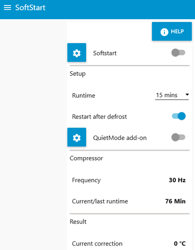

Afbeeldingslocatie: https://tweakers.net/i/fUE0pajwywnObxL3PMG54kNHekM=/800x/filters:strip_exif()/f/image/60JqOffIzmRORs1B9jiz81c0.png?f=fotoalbum_large
wat is de / een oplossing om deze korte runs van de compressor tegen te gaan en het systeem te optimaliseren?
[ Voor 0% gewijzigd door Septillion op 21-12-2024 17:58 . Reden: Code in quote-tags om hem wat compacter te maken ]
Gasloos 2019 + WP Panasonic H-serie 7kW + 300 liter boilervat + PV 12.415Wp + Home Assistant + Hyundai Ioniq 6 First Edition + Zaptec laadpaal
  • pc_freak1
  • Registratie: Maart 2018
  • Laatst online: 15:38
hemertje schreef op vrijdag 20 december 2024 @ 12:34:
korte runs zijn niet altijd te voorkomen. namelijk, je ruimte is op de gewenste temperatuur, en er verdwijnt simpelweg niet genoeg warmte uit de ruimte om een lange run te verantwoorden zonder dat je ruimte te warm word.

Afbeeldingslocatie: https://i.imgur.com/64OB8wt.png

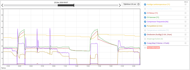

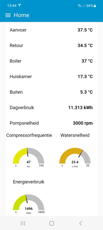

Nav de eerdere reacties van afgelopen tijd (waarvoor dank voor het meedenken!) draai ik de laatste dagen op WAR met een strakke RTC waardoor de temperatuur in de woonkamer niet fluctueert maar gelijk blijft
Mijn systeem:
  • BI:WH-SDC07H3E5-1
  • BU:WH-UD07HE5-1
Met onderstaande instellingen heb ik het idee dat het inmiddels best wel optimaal staat ingesteld?
Settings
Operation mode
Heat+DHW     (4)
Quiet mode    Level 2
De Pumpspeed heb ik zo ingesteld dat bij HEAT de pompsnelheid in de leidingen 20liter/min is zonder overbodige overdruk in de leidingen waardoor de pomp met minimale snelheid draait met 20liter/min
Op advies van @djoenez heb ik proefondervindelijk deze % vastgesteld, bij minder % draait het systeem bij HEAT minder dan de optimale 20liter/min, bij meer % blijft de snelheid 20liter/min maar heb je overdruk wat onnodig extra energie kost
Bij LOW draait het systeem met 10liter/min
De instellingen van Pumpspeed
Flexible pumpspeed
Max speed settings (%)
Low     26
HEAT    37
DHW     37
De instellingen van WAR
Weather   Outside temp.   Water temp.
Warm
                 10 °C        25 °C
                 0 °C         28 °C
Cold
                 -10 °C       30 °C
De instellingen van RTC
Too warm
Difference         Correction
+0.6                   -3
+0.2                   -2
+0.2                   -1
Room setpoint           20.5
Room actual             20.58 °C
Too cold
-0.2                    +1
-0.4                    +2
-0.6                    +3
-0.8                    +4
Binnen de RTC draai ik met
Automations
Trigger action above dT     0.6 °C
Revert action below dT      0 °C
Automation actions
Action: Change operating mode     ON
Action: Turn off/on power         ON
Softstart staat uit
de Panasonic grafieken van de afgelopen dagen
Afbeeldingslocatie: https://tweakers.net/i/b4iIz2-zMwhSgXV0L9W7DTq3mhQ=/800x/filters:strip_exif()/f/image/JCL87cFaDWPG2r33VPg7BL84.png?f=fotoalbum_large
Afbeeldingslocatie: https://tweakers.net/i/qmrqJesAMZeN7QnfKcPMkMP8j8g=/800x/filters:strip_exif()/f/image/3KShgZCW8vSKREFT3ce7XTGR.png?f=fotoalbum_large
Afbeeldingslocatie: https://tweakers.net/i/jcS8F3-1tjxGSAB7FOtvnOzNs7I=/800x/filters:strip_exif()/f/image/EqeJASKDdEz5MG6FJeKDWhUP.png?f=fotoalbum_large
Afbeeldingslocatie: https://tweakers.net/i/YN1FLB2BvtyrKuIR3Jzux-r3-9U=/800x/filters:strip_exif()/f/image/XgaCq4N1l5WiwRcXaItQrurV.png?f=fotoalbum_large
Afbeeldingslocatie: https://tweakers.net/i/xZLm95IjY5UtomE7BnTPi-pyCo4=/800x/filters:strip_exif()/f/image/laZMC6Pq4xpo9DiuZibEihNs.png?f=fotoalbum_large
Wat vind jij ervan?
Zie of heb jij nog verbetervoorstellen, dan verneem ik ze graag van je!
_/-\o_

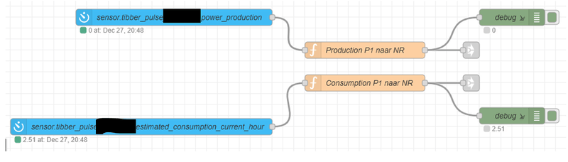

edterbak schreef op zaterdag 14 december 2024 @ 12:11:
Nogmaals.....
Je bent NIET verplicht om MQTT te gebruiken om iets dat in home assistant bekend is, informatie door te laten geven aan node red.
node-red-contrib-home-assistant-websocket
Daarmee kun je alle entities in home assistant aanroepen, uitlezen of aansturen.
Daarbij komt, als je Node Red in de Addon draait in home assistant, dan zit dit standaard er in.
Dus of je nu een p1 meter in home assistant hebt,
Dus of je nu een temperatuur sensor in home assistant hebt.
Dus of je nu een lamp in home assistant hebt. ....
je hebt alle informatie beschikbaar in Node Red.
Duidelijker dan dit wordt het niet :)
**edit... waziger wordt het plaatje wel kennelijk. Raar. Ik heb hem wat meer gecropt.
De groene box is een 'Geef wat door aan HA' actie.
De rode box is een "Lees wat uit in HA' actie.
@edterbak
Om de Tibber Pulse P1 meter uit te lezen heb ik de
poll-state
node gebruikt om deze voor
Production P1 naar NR
en
Consumption P1 naar NR
uit te lezen
Name en Entity ID:
sensor.tibber_pulse_XXXXXXXX_power_production
sensor.tibber_pulse_hemertje_estimated_consumption_current_hour
Afbeeldingslocatie: https://tweakers.net/i/Ci-vBE0V2H47HnGQ6D1lRB7Choc=/800x/filters:strip_exif()/f/image/owrsCZLokJEbO4DEgYHbioqX.png?f=fotoalbum_large
Automations
Automation actions
Softstart staat uit
Wat vind jij ervan?
_/-\o_
Too warm
+1.5                   -3
+1.0                   -2
+0.5                   -1
Too warm
+1.5                   -3
+1.0                   -2
+0.5                   -1
Bij too warm staat alles op +5 en bij too cold alles op -5, dus dit gedeelte zet ik buiten spel. Ik heb wel bij automations de trigger en revert op +0,3 en -0,3 gezet zodat de WP afschakelt/inschakelt op basis hiervan.

Softstart heb ik gisteren aangezet om te kijken wat dat doet
in de NR log zie ik veel regels dat het systeem niet tot rust komt
Function SoftStart: --> Pump did not yet relax (56Hz). Restarting Phase 1 again...
Flow version
24.07 Stable
28/12 13:22:30 - Function WAR: Setpoint change: From 27.7 to 28 °C
28/12 13:15:55 - Function WAR: Setpoint change: From 28 to 27.7 °C
28/12 13:03:04 - Function SoftStart: SoftStart function end
28/12 13:03:04 - *DEFROSTING: Finished
28/12 13:01:09 - Compressor: running
28/12 13:00:08 - Compressor: stopped
28/12 12:56:28 - Compressor: running
28/12 12:55:28 - Compressor: stopped
28/12 12:54:38 - Function SoftStart: Defrost - Correction: 0
28/12 12:54:28 - *DEFROSTING: Started
28/12 12:47:28 - Function WAR: Setpoint change: From 27.7 to 28 °C
28/12 12:40:55 - Function WAR: Setpoint change: From 28 to 27.7 °C
28/12 11:56:55 - Function SoftStart: SoftStart function end
28/12 11:56:55 - *DEFROSTING: Finished
28/12 11:55:04 - Compressor: running
28/12 11:54:04 - Compressor: stopped
28/12 11:50:39 - Compressor: running
28/12 11:49:34 - Compressor: stopped
28/12 11:48:49 - Function SoftStart: Defrost - Correction: 0
28/12 11:48:34 - *DEFROSTING: Started
28/12 11:05:55 - MQTT Command: SetCurves: target: 28 (SP Calculation)
28/12 11:05:55 - Function - Calculate new SP: New final SP calculated: Current setpoint: 29 °C. New calculated setpoint: 28 °C
28/12 11:05:54 - Function WAR: Setpoint change: From 28.2 to 28 °C
28/12 10:54:26 - Function SoftStart: SoftStart function end
28/12 10:54:26 - *DEFROSTING: Finished
28/12 10:52:36 - Compressor: running
28/12 10:51:35 - Compressor: stopped
28/12 10:47:55 - Compressor: running
28/12 10:46:55 - Compressor: stopped
28/12 10:46:05 - Function SoftStart: Defrost - Correction: 0
28/12 10:45:55 - *DEFROSTING: Started
28/12 10:39:20 - MQTT Command: SetCurves: target: 29 (SP Calculation)
28/12 10:39:20 - Function - Calculate new SP: New final SP calculated: Current setpoint: 28 °C. New calculated setpoint: 29 °C
28/12 10:37:20 - Function WAR: Setpoint change: From 28 to 28.2 °C
28/12 10:25:55 - MQTT Command: SetCurves: target: 28 (SP Calculation)
28/12 10:25:55 - Function - Calculate new SP: New final SP calculated: Current setpoint: 29 °C. New calculated setpoint: 28 °C
28/12 10:25:54 - Function WAR: Setpoint change: From 28.2 to 28 °C
28/12 10:20:33 - MQTT Command: SetCurves: target: 29 (SP Calculation)
28/12 10:20:33 - Function - Calculate new SP: New final SP calculated: Current setpoint: 32 °C. New calculated setpoint: 29 °C
28/12 10:18:37 - Function SoftStart: SoftStart function end
28/12 10:18:37 - Function - SoftStart: 0
28/12 10:18:36 - Function SoftStart: --> Pump did not yet relax (44Hz). Restarting Phase 1 again...
28/12 10:18:26 - Function SoftStart: Correction: 3 > 3 °C - (EVALUATING) Freq: 43Hz, SP_Final: 23°C
28/12 10:15:47 - MQTT Command: SetCurves: target: 32 (SP Calculation)
28/12 10:15:47 - Function - Calculate new SP: New final SP calculated: Current setpoint: 31 °C. New calculated setpoint: 32 °C
28/12 10:15:36 - Function SoftStart: Correction: 2 > 3 °C - (STARTUP) Freq: 44Hz, SP_Final: 23°C
28/12 10:15:33 - MQTT Command: SetCurves: target: 31 (SP Calculation)
28/12 10:15:33 - Function - Calculate new SP: New final SP calculated: Current setpoint: 32 °C. New calculated setpoint: 31 °C
28/12 10:15:33 - Function SoftStart: Correction: 3 > 2 °C - (STARTUP) Freq: 43Hz, SP_Final: 22°C
28/12 10:15:25 - Function SoftStart: --> Pump did not yet relax (43Hz). Restarting Phase 1 again...
28/12 10:15:23 - Function SoftStart: Correction: 2 > 3 °C - (EVALUATING) Freq: 43Hz, SP_Final: 23°C
28/12 10:15:19 - Function SoftStart: Correction: 3 > 2 °C - (EVALUATING) Freq: 43Hz, SP_Final: 22°C
28/12 10:15:18 - MQTT Command: SetCurves: target: 32 (SP Calculation)
28/12 10:15:18 - Function - Calculate new SP: New final SP calculated: Current setpoint: 31 °C. New calculated setpoint: 32 °C
28/12 10:15:18 - Function SoftStart: Correction: 2 > 3 °C - (EVALUATING) Freq: 43Hz, SP_Final: 23°C
28/12 10:15:15 - Function SoftStart: Correction: 2 > 2 °C - (EVALUATING) Freq: 44Hz, SP_Final: 22°C
28/12 10:12:15 - Function SoftStart: --> Pump did not yet relax (44Hz). Restarting Phase 1 again...
28/12 10:12:04 - Function SoftStart: Correction: 2 > 2 °C - (EVALUATING) Freq: 43Hz, SP_Final: 22°C
28/12 10:09:04 - Function SoftStart: --> Pump did not yet relax (44Hz). Restarting Phase 1 again...
28/12 10:08:54 - Function SoftStart: Correction: 2 > 2 °C - (EVALUATING) Freq: 44Hz, SP_Final: 22°C
28/12 10:07:49 - MQTT Command: SetCurves: target: 31 (SP Calculation)
28/12 10:07:49 - Function - Calculate new SP: New final SP calculated: Current setpoint: 30 °C. New calculated setpoint: 31 °C
28/12 10:07:41 - Function SoftStart: Correction: 1 > 2 °C - (STARTUP) Freq: 44Hz, SP_Final: 22°C
28/12 10:07:37 - MQTT Command: SetCurves: target: 30 (SP Calculation)
28/12 10:07:37 - Function - Calculate new SP: New final SP calculated: Current setpoint: 31 °C. New calculated setpoint: 30 °C
28/12 10:07:32 - Function SoftStart: Correction: 2 > 1 °C - (STARTUP) Freq: 43Hz, SP_Final: 21°C
28/12 10:07:31 - MQTT Command: SetCurves: target: 31 (SP Calculation)
28/12 10:07:31 - Function - Calculate new SP: New final SP calculated: Current setpoint: 30 °C. New calculated setpoint: 31 °C
28/12 10:07:31 - Function SoftStart: Correction: 1 > 2 °C - (STARTUP) Freq: 44Hz, SP_Final: 22°C
28/12 10:05:53 - Function SoftStart: --> Pump did not yet relax (43Hz). Restarting Phase 1 again...
28/12 10:05:43 - Function SoftStart: Correction: 1 > 1 °C - (EVALUATING) Freq: 44Hz, SP_Final: 21°C
28/12 10:02:42 - Function SoftStart: --> Pump did not yet relax (43Hz). Restarting Phase 1 again...
28/12 10:02:32 - Function SoftStart: Correction: 1 > 1 °C - (EVALUATING) Freq: 43Hz, SP_Final: 21°C
28/12 09:59:42 - MQTT Command: SetCurves: target: 30 (SP Calculation)
28/12 09:59:42 - Function - Calculate new SP: New final SP calculated: Current setpoint: 31 °C. New calculated setpoint: 30 °C
28/12 09:59:42 - Function SoftStart: Correction: 2 > 1 °C - (STARTUP) Freq: 44Hz, SP_Final: 21°C
28/12 09:59:35 - MQTT Command: SetCurves: target: 31 (SP Calculation)
28/12 09:59:35 - Function - Calculate new SP: New final SP calculated: Current setpoint: 29 °C. New calculated setpoint: 31 °C
28/12 09:59:35 - Function SoftStart: Correction: 0 > 2 °C - (STARTUP) Freq: 43Hz, SP_Final: 22°C
28/12 09:59:27 - *DEFROSTING: Finished
28/12 09:57:32 - Compressor: running
28/12 09:56:32 - Compressor: stopped
28/12 09:52:56 - Compressor: running
28/12 09:51:56 - Compressor: stopped
28/12 09:50:58 - MQTT Command: SetCurves: target: 29 (SP Calculation)
28/12 09:50:58 - Function - Calculate new SP: New final SP calculated: Current setpoint: 30 °C. New calculated setpoint: 29 °C
28/12 09:50:58 - Function SoftStart: Defrost - Correction: 0
28/12 09:50:56 - *DEFROSTING: Started
28/12 09:48:52 - Function SoftStart: --> Pump did not yet relax (45Hz). Restarting Phase 1 again...
28/12 09:48:41 - Function SoftStart: Correction: 1 > 1 °C - (EVALUATING) Freq: 46Hz, SP_Final: 21°C
28/12 09:48:31 - MQTT Command: SetCurves: target: 30 (SP Calculation)
28/12 09:48:31 - Function - Calculate new SP: New final SP calculated: Current setpoint: 31 °C. New calculated setpoint: 30 °C
28/12 09:48:31 - Function SoftStart: Correction: 2 > 1 °C - (STARTUP) Freq: 45Hz, SP_Final: 21°C
28/12 09:45:55 - Function SoftStart: Correction: 3 > 2 °C - (STARTUP) Freq: 45Hz, SP_Final: 22°C
28/12 09:45:54 - Function WAR: Setpoint change: From 28 to 28.2 °C
28/12 09:45:41 - Function SoftStart: --> Pump did not yet relax (45Hz). Restarting Phase 1 again...
28/12 09:45:31 - Function SoftStart: Correction: 3 > 3 °C - (EVALUATING) Freq: 46Hz, SP_Final: 23°C
28/12 09:42:30 - Function SoftStart: --> Pump did not yet relax (46Hz). Restarting Phase 1 again...
28/12 09:42:20 - Function SoftStart: Correction: 3 > 3 °C - (EVALUATING) Freq: 46Hz, SP_Final: 23°C
28/12 09:39:19 - Function SoftStart: --> Pump did not yet relax (45Hz). Restarting Phase 1 again...
28/12 09:39:09 - Function SoftStart: Correction: 3 > 3 °C - (EVALUATING) Freq: 45Hz, SP_Final: 23°C
28/12 09:36:09 - Function SoftStart: --> Pump did not yet relax (45Hz). Restarting Phase 1 again...
28/12 09:35:58 - Function SoftStart: Correction: 3 > 3 °C - (EVALUATING) Freq: 45Hz, SP_Final: 23°C
28/12 09:32:58 - Function SoftStart: --> Pump did not yet relax (45Hz). Restarting Phase 1 again...
28/12 09:32:48 - Function SoftStart: Correction: 3 > 3 °C - (EVALUATING) Freq: 45Hz, SP_Final: 23°C
28/12 09:29:47 - Function SoftStart: --> Pump did not yet relax (45Hz). Restarting Phase 1 again...
28/12 09:29:45 - Function SoftStart: Correction: 3 > 3 °C - (EVALUATING) Freq: 45Hz, SP_Final: 23°C
28/12 09:29:40 - Function SoftStart: Correction: 3 > 3 °C - (EVALUATING) Freq: 46Hz, SP_Final: 23°C
28/12 09:29:37 - Function SoftStart: Correction: 3 > 3 °C - (EVALUATING) Freq: 45Hz, SP_Final: 23°C
28/12 09:27:18 - Function SoftStart: Correction: 2 > 3 °C - (STARTUP) Freq: 45Hz, SP_Final: 23°C
28/12 09:27:15 - Function WAR: Setpoint change: From 28.2 to 28 °C
28/12 09:26:36 - Function SoftStart: --> Pump did not yet relax (46Hz). Restarting Phase 1 again...
28/12 09:26:26 - Function SoftStart: Correction: 2 > 2 °C - (EVALUATING) Freq: 45Hz, SP_Final: 22°C
28/12 09:24:48 - MQTT Command: SetCurves: target: 31 (SP Calculation)
28/12 09:24:48 - Function - Calculate new SP: New final SP calculated: Current setpoint: 30 °C. New calculated setpoint: 31 °C
28/12 09:24:48 - Function SoftStart: Correction: 1 > 2 °C - (STARTUP) Freq: 45Hz, SP_Final: 22°C
28/12 09:23:26 - Function SoftStart: --> Pump did not yet relax (46Hz). Restarting Phase 1 again...
28/12 09:23:15 - Function SoftStart: Correction: 1 > 1 °C - (EVALUATING) Freq: 45Hz, SP_Final: 21°C
28/12 09:20:15 - Function SoftStart: --> Pump did not yet relax (46Hz). Restarting Phase 1 again...
28/12 09:20:05 - Function SoftStart: Correction: 1 > 1 °C - (EVALUATING) Freq: 46Hz, SP_Final: 21°C
28/12 09:17:20 - MQTT Command: SetCurves: target: 30 (SP Calculation)
28/12 09:17:20 - Function - Calculate new SP: New final SP calculated: Current setpoint: 31 °C. New calculated setpoint: 30 °C
28/12 09:17:20 - Function SoftStart: Correction: 2 > 1 °C - (STARTUP) Freq: 45Hz, SP_Final: 21°C
28/12 09:17:08 - MQTT Command: SetCurves: target: 31 (SP Calculation)
28/12 09:17:08 - Function - Calculate new SP: New final SP calculated: Current setpoint: 29 °C. New calculated setpoint: 31 °C
28/12 09:17:08 - Function SoftStart: Correction: 0 > 2 °C - (STARTUP) Freq: 46Hz, SP_Final: 22°C
28/12 09:17:04 - *DEFROSTING: Finished
28/12 09:15:14 - Compressor: running
28/12 09:14:14 - Compressor: stopped
28/12 09:10:39 - Compressor: running
28/12 09:09:34 - Compressor: stopped
28/12 09:08:35 - MQTT Command: SetCurves: target: 29 (SP Calculation)
28/12 09:08:35 - Function - Calculate new SP: New final SP calculated: Current setpoint: 30 °C. New calculated setpoint: 29 °C
28/12 09:08:35 - Function SoftStart: Defrost - Correction: 0
28/12 09:08:34 - *DEFROSTING: Started
28/12 09:06:44 - Function SoftStart: --> Pump did not yet relax (43Hz). Restarting Phase 1 again...
28/12 09:06:34 - Function SoftStart: Correction: 1 > 1 °C - (EVALUATING) Freq: 44Hz, SP_Final: 21°C
28/12 09:05:55 - Function SoftStart: Correction: 2 > 1 °C - (STARTUP) Freq: 43Hz, SP_Final: 21°C
28/12 09:05:54 - Function WAR: Setpoint change: From 28 to 28.2 °C
28/12 09:03:34 - Function SoftStart: --> Pump did not yet relax (44Hz). Restarting Phase 1 again...
28/12 09:03:23 - Function SoftStart: Correction: 2 > 2 °C - (EVALUATING) Freq: 44Hz, SP_Final: 22°C
28/12 09:01:59 - Function SoftStart: Correction: 3 > 2 °C - (STARTUP) Freq: 44Hz, SP_Final: 22°C
28/12 09:01:52 - Function SoftStart: Correction: 2 > 3 °C - (STARTUP) Freq: 43Hz, SP_Final: 23°C
28/12 09:01:49 - MQTT Command: SetCurves: target: 30 (SP Calculation)

28/12 06:53:56 - Function SoftStart: Correction: 3 > 2 °C - (STARTUP) Freq: 51Hz, SP_Final: 22°C
28/12 06:53:54 - Function SoftStart: Correction: 2 > 3 °C - (STARTUP) Freq: 51Hz, SP_Final: 23°C
28/12 06:53:46 - MQTT Command: SetCurves: target: 30 (SP Calculation)
28/12 06:53:46 - Function - Calculate new SP: New final SP calculated: Current setpoint: 31 °C. New calculated setpoint: 30 °C
28/12 06:53:46 - Function SoftStart: Correction: 3 > 2 °C - (STARTUP) Freq: 50Hz, SP_Final: 22°C
28/12 06:53:15 - Function SoftStart: --> Pump did not yet relax (50Hz). Restarting Phase 1 again...
28/12 06:53:05 - Function SoftStart: Correction: 3 > 3 °C - (EVALUATING) Freq: 50Hz, SP_Final: 23°C
28/12 06:50:04 - Function SoftStart: --> Pump did not yet relax (51Hz). Restarting Phase 1 again...
28/12 06:49:54 - Function SoftStart: Correction: 3 > 3 °C - (EVALUATING) Freq: 51Hz, SP_Final: 23°C
28/12 06:46:53 - Function SoftStart: --> Pump did not yet relax (51Hz). Restarting Phase 1 again...
28/12 06:46:43 - Function SoftStart: Correction: 3 > 3 °C - (EVALUATING) Freq: 51Hz, SP_Final: 23°C
28/12 06:43:43 - Function SoftStart: --> Pump did not yet relax (51Hz). Restarting Phase 1 again...
28/12 06:43:40 - Function SoftStart: Correction: 3 > 3 °C - (EVALUATING) Freq: 51Hz, SP_Final: 23°C
28/12 06:43:32 - Function SoftStart: Correction: 3 > 3 °C - (EVALUATING) Freq: 50Hz, SP_Final: 23°C
28/12 06:40:32 - Function SoftStart: --> Pump did not yet relax (51Hz). Restarting Phase 1 again...
28/12 06:40:22 - Function SoftStart: Correction: 3 > 3 °C - (EVALUATING) Freq: 50Hz, SP_Final: 23°C
28/12 06:37:21 - Function SoftStart: --> Pump did not yet relax (51Hz). Restarting Phase 1 again...
28/12 06:37:11 - Function SoftStart: Correction: 3 > 3 °C - (EVALUATING) Freq: 50Hz, SP_Final: 23°C
28/12 06:37:08 - Function SoftStart: Correction: 2 > 3 °C - (STARTUP) Freq: 50Hz, SP_Final: 23°C
28/12 06:37:05 - Function WAR: Setpoint change: From 28.2 to 28 °C
28/12 06:35:15 - MQTT Command: SetCurves: target: 31 (SP Calculation)
28/12 06:35:15 - Function - Calculate new SP: New final SP calculated: Current setpoint: 30 °C. New calculated setpoint: 31 °C
28/12 06:35:13 - Function SoftStart: Correction: 1 > 2 °C - (STARTUP) Freq: 51Hz, SP_Final: 22°C
28/12 06:35:05 - MQTT Command: SetCurves: target: 30 (SP Calculation)
28/12 06:35:05 - Function - Calculate new SP: New final SP calculated: Current setpoint: 31 °C. New calculated setpoint: 30 °C
28/12 06:34:58 - Function SoftStart: Correction: 2 > 1 °C - (STARTUP) Freq: 51Hz, SP_Final: 21°C
28/12 06:34:58 - MQTT Command: SetCurves: target: 31 (SP Calculation)
28/12 06:34:58 - Function - Calculate new SP: New final SP calculated: Current setpoint: 30 °C. New calculated setpoint: 31 °C
28/12 06:34:58 - Function SoftStart: Correction: 1 > 2 °C - (STARTUP) Freq: 51Hz, SP_Final: 22°C
28/12 06:34:10 - Function SoftStart: --> Pump did not yet relax (51Hz). Restarting Phase 1 again...
28/12 06:34:00 - Function SoftStart: Correction: 1 > 1 °C - (EVALUATING) Freq: 50Hz, SP_Final: 21°C
28/12 06:31:00 - Function SoftStart: --> Pump did not yet relax (50Hz). Restarting Phase 1 again...
28/12 06:30:49 - Function SoftStart: Correction: 1 > 1 °C - (EVALUATING) Freq: 51Hz, SP_Final: 21°C
28/12 06:29:57 - Function SoftStart: Correction: 0 > 1 °C - (STARTUP) Freq: 51Hz, SP_Final: 21°C
28/12 06:29:53 - Function SoftStart: Correction: 1 > 0 °C - (STARTUP) Freq: 50Hz, SP_Final: 20°C
28/12 06:29:52 - MQTT Command: SetCurves: target: 30 (SP Calculation)
28/12 06:29:52 - Function - Calculate new SP: New final SP calculated: Current setpoint: 29 °C. New calculated setpoint: 30 °C
28/12 06:29:52 - Function SoftStart: Correction: 0 > 1 °C - (STARTUP) Freq: 50Hz, SP_Final: 21°C
28/12 06:28:44 - MQTT Command: SetCurves: target: 29 (SP Calculation)
28/12 06:28:44 - Function - Calculate new SP: New final SP calculated: Current setpoint: 30 °C. New calculated setpoint: 29 °C
28/12 06:28:44 - Function SoftStart: Correction: 1 > 0 °C - (STARTUP) Freq: 50Hz, SP_Final: 20°C
28/12 06:27:54 - MQTT Command: SetCurves: target: 30 (SP Calculation)
28/12 06:27:54 - Function - Calculate new SP: New final SP calculated: Current setpoint: 29 °C. New calculated setpoint: 30 °C
28/12 06:27:54 - Function SoftStart: Correction: 2 > 1 °C - (STARTUP) Freq: 49Hz, SP_Final: 21°C
28/12 06:27:52 - MQTT Command: SetCurves: target: 31 (SP Calculation)
28/12 06:27:52 - Function - Calculate new SP: New final SP calculated: Current setpoint: 29 °C. New calculated setpoint: 31 °C
28/12 06:27:52 - Function SoftStart: Correction: 0 > 2 °C - (STARTUP) Freq: 47Hz, SP_Final: 22°C
28/12 06:27:44 - *DEFROSTING: Finished
28/12 06:25:54 - Compressor: running
28/12 06:24:54 - Compressor: stopped
28/12 06:21:09 - Compressor: running
28/12 06:20:09 - Compressor: stopped
28/12 06:19:14 - MQTT Command: SetCurves: target: 29 (SP Calculation)
28/12 06:19:14 - Function - Calculate new SP: New final SP calculated: Current setpoint: 30 °C. New calculated setpoint: 29 °C
28/12 06:19:14 - Function SoftStart: Defrost - Correction: 0
28/12 06:19:09 - *DEFROSTING: Started
28/12 06:17:04 - Function SoftStart: --> Pump did not yet relax (56Hz). Restarting Phase 1 again...
28/12 06:16:53 - Function SoftStart: Correction: 1 > 1 °C - (EVALUATING) Freq: 56Hz, SP_Final: 21°C
28/12 06:16:14 - Function SoftStart: Correction: 2 > 1 °C - (STARTUP) Freq: 56Hz, SP_Final: 21°C
28/12 06:16:12 - Function SoftStart: Correction: 1 > 2 °C - (STARTUP) Freq: 56Hz, SP_Final: 22°C
28/12 06:16:08 - MQTT Command: SetCurves: target: 30 (SP Calculation)
28/12 06:16:08 - Function - Calculate new SP: New final SP calculated: Current setpoint: 31 °C. New calculated setpoint: 30 °C
28/12 06:16:03 - Function SoftStart: Correction: 2 > 1 °C - (STARTUP) Freq: 55Hz, SP_Final: 21°C
28/12 06:15:59 - MQTT Command: SetCurves: target: 31 (SP Calculation)
28/12 06:15:59 - Function - Calculate new SP: New final SP calculated: Current setpoint: 30 °C. New calculated setpoint: 31 °C
28/12 06:15:54 - Function WAR: Setpoint change: From 28 to 28.2 °C
28/12 06:13:53 - Function SoftStart: --> Pump did not yet relax (56Hz). Restarting Phase 1 again...
28/12 06:13:43 - Function SoftStart: Correction: 2 > 2 °C - (EVALUATING) Freq: 55Hz, SP_Final: 22°C
28/12 06:12:48 - MQTT Command: SetCurves: target: 30 (SP Calculation)
28/12 06:12:48 - Function - Calculate new SP: New final SP calculated: Current setpoint: 31 °C. New calculated setpoint: 30 °C
28/12 06:12:48 - Function SoftStart: Correction: 3 > 2 °C - (STARTUP) Freq: 56Hz, SP_Final: 22°C
28/12 06:10:42 - Function SoftStart: --> Pump did not yet relax (55Hz). Restarting Phase 1 again...
28/12 06:10:32 - Function SoftStart: Correction: 3 > 3 °C - (EVALUATING) Freq: 56Hz, SP_Final: 23°C
28/12 06:07:31 - Function SoftStart: --> Pump did not yet relax (56Hz). Restarting Phase 1 again...
28/12 06:07:21 - Function SoftStart: Correction: 3 > 3 °C - (EVALUATING) Freq: 56Hz, SP_Final: 23°C
28/12 06:06:29 - MQTT Command: SetCurves: target: 31 (SP Calculation)
28/12 06:06:11 - Function - Calculate new SP: New final SP calculated: Current setpoint: 32 °C. New calculated setpoint: 31 °C
28/12 06:06:01 - Function SoftStart: Correction: 4 > 3 °C - (STARTUP) Freq: 55Hz, SP_Final: 23°C
28/12 06:06:01 - MQTT Command: SetCurves: target: 32
28/12 06:06:01 - MQTT Command: SetCurves: target: 32 (SP Calculation)
28/12 06:06:01 - Function - Calculate new SP: New final SP calculated: Current setpoint: 31 °C. New calculated setpoint: 32 °C
28/12 06:06:01 - Function SoftStart: Correction: 3 > 4 °C - (STARTUP) Freq: 55Hz, SP_Final: 24°C
28/12 06:05:33 - MQTT Command: SetCurves: target: 31 (SP Calculation)
28/12 06:05:33 - Function - Calculate new SP: New final SP calculated: Current setpoint: 32 °C. New calculated setpoint: 31 °C
28/12 06:05:28 - Function SoftStart: Correction: 4 > 3 °C - (STARTUP) Freq: 55Hz, SP_Final: 23°C
28/12 06:05:26 - MQTT Command: SetCurves: target: 32 (SP Calculation)
28/12 06:05:26 - Function - Calculate new SP: New final SP calculated: Current setpoint: 31 °C. New calculated setpoint: 32 °C
28/12 06:05:26 - Function SoftStart: Correction: 3 > 4 °C - (STARTUP) Freq: 56Hz, SP_Final: 24°C
28/12 06:05:08 - Function SoftStart: Correction: 4 > 3 °C - (STARTUP) Freq: 55Hz, SP_Final: 23°C
28/12 06:05:06 - Function SoftStart: Correction: 3 > 4 °C - (STARTUP) Freq: 55Hz, SP_Final: 24°C
28/12 06:04:58 - MQTT Command: SetCurves: target: 31 (SP Calculation)
28/12 06:04:58 - Function - Calculate new SP: New final SP calculated: Current setpoint: 32 °C. New calculated setpoint: 31 °C
28/12 06:04:53 - Function SoftStart: Correction: 4 > 3 °C - (STARTUP) Freq: 55Hz, SP_Final: 23°C
28/12 06:04:26 - MQTT Command: SetCurves: target: 32 (SP Calculation)
28/12 06:04:26 - Function - Calculate new SP: New final SP calculated: Current setpoint: 31 °C. New calculated setpoint: 32 °C
28/12 06:04:26 - Function SoftStart: Correction: 3 > 4 °C - (STARTUP) Freq: 56Hz, SP_Final: 24°C
28/12 06:04:21 - Function SoftStart: --> Pump did not yet relax (56Hz). Restarting Phase 1 again...
28/12 06:04:18 - Function SoftStart: Correction: 4 > 3 °C - (EVALUATING) Freq: 56Hz, SP_Final: 23°C
28/12 06:04:13 - Function SoftStart: Correction: 3 > 4 °C - (EVALUATING) Freq: 56Hz, SP_Final: 24°C
28/12 06:04:13 - MQTT Command: SetCurves: target: 31 (SP Calculation)
28/12 06:04:13 - Function - Calculate new SP: New final SP calculated: Current setpoint: 32 °C. New calculated setpoint: 31 °C
28/12 06:04:13 - Function SoftStart: Correction: 4 > 3 °C - (EVALUATING) Freq: 56Hz, SP_Final: 23°C
28/12 06:04:10 - Function SoftStart: Correction: 4 > 4 °C - (EVALUATING) Freq: 56Hz, SP_Final: 24°C
28/12 06:03:51 - MQTT Command: SetCurves: target: 32 (SP Calculation)
28/12 06:03:51 - Function - Calculate new SP: New final SP calculated: Current setpoint: 31 °C. New calculated setpoint: 32 °C
28/12 06:03:51 - Function SoftStart: Correction: 3 > 4 °C - (STARTUP) Freq: 56Hz, SP_Final: 24°C
28/12 06:01:10 - Function SoftStart: --> Pump did not yet relax (55Hz). Restarting Phase 1 again...
28/12 06:01:00 - Function SoftStart: Correction: 3 > 3 °C - (EVALUATING) Freq: 56Hz, SP_Final: 23°C
28/12 05:57:59 - Function SoftStart: --> Pump did not yet relax (56Hz). Restarting Phase 1 again...
28/12 05:57:49 - Function SoftStart: Correction: 3 > 3 °C - (EVALUATING) Freq: 55Hz, SP_Final: 23°C
28/12 05:54:48 - Function SoftStart: --> Pump did not yet relax (56Hz). Restarting Phase 1 again...
28/12 05:54:38 - Function SoftStart: Correction: 3 > 3 °C - (EVALUATING) Freq: 55Hz, SP_Final: 23°C
28/12 05:53:50 - MQTT Command: SetCurves: target: 31 (SP Calculation)
28/12 05:53:50 - Function - Calculate new SP: New final SP calculated: Current setpoint: 30 °C. New calculated setpoint: 31 °C
28/12 05:53:50 - Function SoftStart: Correction: 2 > 3 °C - (STARTUP) Freq: 55Hz, SP_Final: 23°C
28/12 05:51:38 - Function SoftStart: --> Pump did not yet relax (56Hz). Restarting Phase 1 again...
28/12 05:51:27 - Function SoftStart: Correction: 2 > 2 °C - (EVALUATING) Freq: 56Hz, SP_Final: 22°C
28/12 05:51:25 - MQTT Command: SetCurves: target: 30 (SP Calculation)
28/12 05:51:25 - Function - Calculate new SP: New final SP calculated: Current setpoint: 29 °C. New calculated setpoint: 30 °C
28/12 05:51:25 - Function SoftStart: Correction: 1 > 2 °C - (STARTUP) Freq: 56Hz, SP_Final: 22°C
28/12 05:49:20 - MQTT Command: SetCurves: target: 29 (SP Calculation)
28/12 05:49:20 - Function - Calculate new SP: New final SP calculated: Current setpoint: 28 °C. New calculated setpoint: 29 °C
28/12 05:49:20 - Function SoftStart: Correction: 0 > 1 °C - (STARTUP) Freq: 56Hz, SP_Final: 21°C
28/12 05:48:27 - Function SoftStart: --> Pump did not yet relax (56Hz). Restarting Phase 1 again...
28/12 05:48:17 - Function SoftStart: Correction: 0 > 0 °C - (EVALUATING) Freq: 56Hz, SP_Final: 20°C
28/12 05:48:00 - MQTT Command: SetCurves: target: 28 (SoftStart)
28/12 05:47:35 - Function SoftStart: Correction: -1 > 0 °C - (STARTUP) Freq: 56Hz, SP_Final: 20°C
28/12 05:47:32 - MQTT Command: SetCurves: target: 27 (SP Calculation)
28/12 05:47:32 - Function - Calculate new SP: New final SP calculated: Current setpoint: 28 °C. New calculated setpoint: 27 °C
28/12 05:47:25 - Function SoftStart: Correction: 0 > -1 °C - (STARTUP) Freq: 56Hz, SP_Final: 19°C
28/12 05:47:25 - MQTT Command: SetCurves: target: 28 (SP Calculation)
28/12 05:47:25 - Function - Calculate new SP: New final SP calculated: Current setpoint: 27 °C. New calculated setpoint: 28 °C
28/12 05:47:25 - Function SoftStart: Correction: -1 > 0 °C - (STARTUP) Freq: 56Hz, SP_Final: 20°C
28/12 05:46:01 - MQTT Command: SetCurves: target: 27 (SP Calculation)
28/12 05:46:01 - Function - Calculate new SP: New final SP calculated: Current setpoint: 28 °C. New calculated setpoint: 27 °C
28/12 05:46:01 - Function SoftStart: Correction: 0 > -1 °C - (STARTUP) Freq: 55Hz, SP_Final: 19°C
28/12 05:45:55 - MQTT Command: SetCurves: target: 28 (SP Calculation)
28/12 05:45:55 - Function - Calculate new SP: New final SP calculated: Current setpoint: 27 °C. New calculated setpoint: 28 °C
28/12 05:45:55 - Function SoftStart: Correction: -1 > 0 °C - (STARTUP) Freq: 55Hz, SP_Final: 20°C
28/12 05:45:36 - MQTT Command: SetCurves: target: 27 (SP Calculation)
28/12 05:45:36 - Function - Calculate new SP: New final SP calculated: Current setpoint: 28 °C. New calculated setpoint: 27 °C
28/12 05:45:36 - Function SoftStart: Correction: 0 > -1 °C - (STARTUP) Freq: 52Hz, SP_Final: 19°C
28/12 05:45:26 - MQTT Command: SetCurves: target: 28 (SP Calculation)
28/12 05:45:26 - Function - Calculate new SP: New final SP calculated: Current setpoint: 29 °C. New calculated setpoint: 28 °C
28/12 05:45:26 - Function SoftStart: Correction: 1 > 0 °C - (STARTUP) Freq: 48Hz, SP_Final: 20°C
28/12 05:45:20 - MQTT Command: SetCurves: target: 29 (SP Calculation)
28/12 05:45:20 - Function - Calculate new SP: New final SP calculated: Current setpoint: 28 °C. New calculated setpoint: 29 °C
28/12 05:45:20 - Function SoftStart: Correction: 0 > 1 °C - (STARTUP) Freq: 45Hz, SP_Final: 21°C
28/12 05:45:16 - *DEFROSTING: Finished
28/12 05:43:26 - Compressor: running
28/12 05:42:26 - Compressor: stopped
28/12 05:38:26 - Compressor: running
28/12 05:37:26 - Compressor: stopped
28/12 05:36:30 - MQTT Command: SetCurves: target: 28 (SP Calculation)
28/12 05:36:30 - Function - Calculate new SP: New final SP calculated: Current setpoint: 26 °C. New calculated setpoint: 28 °C
28/12 05:36:30 - Function SoftStart: Defrost - Correction: 0
28/12 05:36:26 - *DEFROSTING: Started
28/12 05:33:31 - Function SoftStart: --> Pump did not yet relax (41Hz). Restarting Phase 1 again...
28/12 05:33:26 - Function SoftStart: Correction: -2 > -2 °C - (EVALUATING) Freq: 41Hz, SP_Final: 18°C
28/12 05:33:21 - Function SoftStart: Correction: -2 > -2 °C - (EVALUATING) Freq: 44Hz, SP_Final: 18°C
28/12 05:32:19 - MQTT Command: SetCurves: target: 26 (SP Calculation)
28/12 05:32:19 - Function - Calculate new SP: New final SP calculated: Current setpoint: 25 °C. New calculated setpoint: 26 °C

zou dat komen door de strakke RTC waarden die ik had ingesteld?
nu zijn er vannacht ook wel diverse defrost momenten geweest!
Afbeeldingslocatie: https://tweakers.net/i/5B7ZpNMys3LGuaYTNf70MILTxEM=/800x/filters:strip_exif()/f/image/f8vqQwAWf8qDa05AnTwhHBB1.png?f=fotoalbum_large
ik zal het eens gaan proberen met minder strakke RTC-waarden (standaard waarden van Ed) en de Softstart Aan met de QuietMode add-on Aan (Default & Active QuietMode level op 3)

Guy-Manuel schreef op zaterdag 28 december 2024 @ 13:34:
deze bedoel je?
Afbeeldingslocatie: https://tweakers.net/i/ZnL5MFhR9a2kkv72U6rOVGafOck=/fit-in/4000x4000/filters:no_upscale():strip_exif()/f/image/kOlpq0aMtTs2VZoY3OQP92oE.png?f=user_large

Kan iemand mij misschien wijzen waar stap voor stap staat uitgelegd hoe ik de P1 waarde in het nodered dashboard krijg?
Ik kan dit nergens vinden. Het is hier ook wel eens voorbij gekomen, zoals hier. Maar ik mis hoe ik de p1 poort doorstuur naar nodered.
Waar komt de P1 waarde op binnen? HA, Domoticz, MQTT ?
Via HA -> DSMR Smart Meter

Dan heb je in Node-RED iets nodig dat de data uit HA kan gebruiken. Ik heb daar geen kennis van, anderen mogelijk wel.
Misschien iets meer info geven over welke middelen je beschikbaar hebt. Zoals: zie je deze data in MQTT Explorer, welke versie van Ed draai je, heb je wel een personal tabblad, heb je wel genoeg info als je actueel vermogen afleest, etc.
En realiseer je je dat je na elke update van Ed je dan zijn flow moet aanpassen...🫣
Je krijgt dan echt maatwerk.. mijn plaatje is nog niet compleet.
Afbeeldingslocatie: https://tweakers.net/i/5m6rSgmVNKkl8f34LBDvNdgzW-A=/x800/filters:strip_icc():strip_exif()/f/image/6hnGZ4uHsilB0BGQSTX1q1Kk.jpg?f=fotoalbum_large
NR is nieuw voor mij.
Ik draai versie 24.03. Ik zie de data van de P1 niet in mqtt-explorer, want die gaat van de p1-poort naar de DSMR-integratie. Ik heb geen personal tab? Ik heb in HA een netto-energieverbruik sensor, daar zou node-red genoeg aan moeten hebben lijkt me. Maar hoe krijg ik die zichtbaar in de solar2DHW?
Als ik na iedere update zijn flow moet aanpassen (waar ik geen verstand van heb( is het toch veel makkelijker om zelf een automation te bouwen in HA? Daar zie ik immers mijn netto-energieverbuik en kan ik de DHW-temp verhogen of verlagen. Is de solar2DHW alleen een functie voor zeer gevorderden?

In mijn beleving is de actuele waarde van vermogen in dashboard tonen heel iets anders dan solar2dhw werkend krijgen..
Solar2DHW heb ik wel werkend in NR, maar kan je daar alleen bij helpen als je de topics in MQTT Explorer kunt zien.
Via welk protocol gaat dat verkeer?
Heb je MQTT Explorer wel geinstalleerd?
Kan je zeker aanraden om die applicatie ook eens te installeren om beeld te krijgen van mqtt-verkeer in je netwerk.
Als je HA wil inzetten om solar2dhw te configureren kan ik je niet helpen. Echter solar2dhw is niet voor gevorderden.
Kijk de beschrijving van flow installation van Ed op github nog eens door inzake een Personal tabblad.
How to personalize or customize

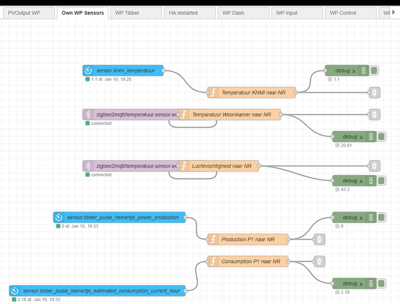

hierzo
hemertje in "Heishamon <> Node Red voor Panasonic warmtepompen"

Ok ik heb eens getest met SS weer, maar die in de laatste versies draait bij mij niet goed. Uiteindelijk heb ik de functie SS uit versie 24.04 gehaald en in de laatste versie terug gezet.
Nu draait alles soepel, WAR - RTC - SS en zelfs met enkele defrost met de lage temperaturen buiten blijft de temperatuur binnen constant.
Afbeeldingslocatie: https://tweakers.net/i/Re-Chhs57QG2KUabFrQ-qYi0jRI=/fit-in/4000x4000/filters:no_upscale():strip_exif()/f/image/hlcPpwDckukURAjDsHCzyZsG.png?f=user_large
Afbeeldingslocatie: https://tweakers.net/i/cjCfTXxfgzVb0JvTXLS0CL8NDbE=/800x/filters:strip_exif()/f/image/f6mUJGTxfJhu1EkVGV8gojC5.png?f=fotoalbum_large

@appiejs
Kan je toelichten wat er met SoftStart niet goed ging bij je?
Waarom heb je het idee dat dit onderdeel in 24.04 beter ontworpen is in 24.04?
Welke code heb je uit 24.04 gehaald en welke code hiermee vervangen in 24.07?

Ik heb mogelijk een issue met de SoftStart functie met mijn 12kW T-cap. Ik schrijf specifiek mogelijk, omdat ik momenteel wel een compressor runtime heb van bijna 700 minuten.
Afgelopen week heeft de WP niet gedraaid in verband met vakantie en ik heb hem gisteren weer ingeschakeld voor verwarmen.
Gisteren overdag schoot hij continu in een defrost en heb ik hem uiteindelijk met SoftStart laten draaien. Dit resulteert in een goede lange run, maar mijn aanvoer is eigenlijk nog iets te koud. Volgens SoftStart staat deze nog op -1 ingesteld. Na gisteravond is er echter geen update meer geregistreerd in mijn log.
Ik draai op versie 24.06 Stable, zonder additionele aanpassingen wel met een WP Personal.

Toevallig kom ik hier om precies deze zelfde bug te rapporteren:
Ik zie ook deze 2 regels in mijn log:
05/01 19:45:04 - Function SoftStart: temporally disabled during defrost
05/01 19:45:04 - *DEFROSTING: Started
En volgens mij had hij tijdens deze defrost van correction -1 naar 0 willen gaan, maar vanwege de disabled doet hij dat niet. En dus blijft hij nu op de -1 hangen..
(Toevallig heb ik ook een 12J T-CAP, maar ik heb niet het vermoeden dat dit er echt toe doet)

sinds vanmorgen is de WP niet meer gaan verwarmen en heb ik in Node Red onder Settings handmatig de WP van DHW gewijzigd naar HEAT+DHW
in de log zie je dat de compressor om 07:14 uur gestopt is
08/01 07:14:39 - Compressor: stopped
en dat ik hem handmatig overschreven heb om 10:41
08/01 10:41:17 - Compressor: running
Afbeeldingslocatie: https://tweakers.net/i/H-eSBr2IF7JESIYwMXFF56mJs1c=/800x/filters:strip_exif()/f/image/Qnm8IL0MsWVxwHHq3zIWHAX9.png?f=fotoalbum_large
Flow version
24.07 Stable

08/01 10:52:16 - MQTT Command: SetCurves: target: 29 (SP Calculation)
08/01 10:52:16 - Function - Calculate new SP: New final SP calculated: Current setpoint: 28 °C. New calculated setpoint: 29 °C
08/01 10:52:16 - Function SoftStart: Correction: -3 > -2 °C - (STARTUP) Freq: 53Hz, SP_Final: 21°C
08/01 10:50:49 - Function SoftStart: --> Pump did not yet relax (52Hz). Restarting Phase 1 again...
08/01 10:50:42 - MQTT Command: SetCurves: target: 28 (SP Calculation)
08/01 10:50:42 - Function - Calculate new SP: New final SP calculated: Current setpoint: 27 °C. New calculated setpoint: 28 °C
08/01 10:50:42 - Function SoftStart: Correction: -4 > -3 °C - (EVALUATING) Freq: 52Hz, SP_Final: 20°C
08/01 10:50:39 - Function SoftStart: Correction: -4 > -4 °C - (EVALUATING) Freq: 52Hz, SP_Final: 19°C
08/01 10:48:12 - MQTT Command: SetCurves: target: 27 (SP Calculation)
08/01 10:47:42 - Function - Calculate new SP: New final SP calculated: Current setpoint: 26 °C. New calculated setpoint: 27 °C
08/01 10:47:42 - Function SoftStart: Correction: -5 > -4 °C - (STARTUP) Freq: 53Hz, SP_Final: 19°C
08/01 10:47:38 - Function SoftStart: --> Pump did not yet relax (53Hz). Restarting Phase 1 again...
08/01 10:47:28 - Function SoftStart: Correction: -5 > -5 °C - (EVALUATING) Freq: 53Hz, SP_Final: 18°C
08/01 10:46:17 - MQTT Command: SetQuietMode: 0 (SoftStart Quietmode)
08/01 10:46:17 - Function SoftStart Quietmode: Timer ended, restoring quiet mode to level 0
08/01 10:44:31 - MQTT Command: SetCurves: target: 26 (SP Calculation)
08/01 10:44:31 - Function - Calculate new SP: New final SP calculated: Current setpoint: 25 °C. New calculated setpoint: 26 °C
08/01 10:44:31 - Function SoftStart: Correction: -6 > -5 °C - (STARTUP) Freq: 52Hz, SP_Final: 18°C
08/01 10:44:27 - Function SoftStart: --> Pump did not yet relax (52Hz). Restarting Phase 1 again...
08/01 10:44:17 - Function SoftStart: Correction: -6 > -6 °C - (EVALUATING) Freq: 52Hz, SP_Final: 17°C
08/01 10:44:17 - MQTT Command: SetCurves: target: 25 (SP Calculation)
08/01 10:44:17 - Function - Calculate new SP: New final SP calculated: Current setpoint: 26 °C. New calculated setpoint: 25 °C
08/01 10:44:17 - Function SoftStart: Correction: -5 > -6 °C - (EVALUATING) Freq: 52Hz, SP_Final: 17°C
08/01 10:41:17 - MQTT Command: SetCurves: target: 26 (SP Calculation)
08/01 10:41:17 - Function - Calculate new SP: New final SP calculated: Current setpoint: 31 °C. New calculated setpoint: 26 °C
08/01 10:41:17 - Function SoftStart: Correction: 0 > -5 °C - (STARTUP) Freq: 15Hz, SP_Final: 18°C
08/01 10:41:17 - MQTT Command: SetMaxPumpDuty: 134 (pump speed)
08/01 10:41:17 - Function SoftStart Quietmode: Timer started (5 minutes)
08/01 10:41:17 - Function Pump speed: Max pumpspeed set to 134 (37%) (HEAT)
08/01 10:38:47 - MQTT Command: SetCurves: target: 31 (SP Calculation)
08/01 10:38:47 - Function - Calculate new SP: New final SP calculated: Current setpoint: 25 °C. New calculated setpoint: 31 °C
08/01 10:38:47 - Function RTC: Correction change: From 1 to 3 °C (Room actual: 19.89 °C)
08/01 10:38:47 - Function WAR: Setpoint change: From 23.9 to 27.8 °C
08/01 10:37:57 - TOP4_Operating_Mode_State: 4
08/01 10:37:55 - MQTT Command: SetOperationMode: 4 (GUI)
08/01 08:08:43 - MQTT Command: SetQuietMode: 2 (GUI)
08/01 07:43:46 - TOP4_Operating_Mode_State: 3
08/01 07:43:41 - MQTT Command: SetOperationMode: 3
08/01 07:43:41 - Auto-start-DHW function: DHW temperature: 42°C. Lower threshold: 42°C. Starting DHW run.
08/01 07:14:39 - MQTT Command: SetCurves: target: 25 (SP Calculation)
08/01 07:14:39 - Function - Calculate new SP: New final SP calculated: Current setpoint: 26 °C. New calculated setpoint: 25 °C
08/01 07:14:39 - Function SoftStart: SoftStart function end
08/01 07:14:39 - MQTT Command: SetMaxPumpDuty: 113 (pump speed)
08/01 07:14:39 - Function SoftStart Quietmode: Compressor run ended, quiet mode is already set to level 3
08/01 07:14:39 - Function Pump speed: Max pumpspeed set to 113 (26%) (Low)
08/01 07:11:40 - MQTT Command: SetCurves: target: 26 (SP Calculation)
08/01 07:11:40 - Function - Calculate new SP: New final SP calculated: Current setpoint: 27 °C. New calculated setpoint: 26 °C
08/01 07:11:40 - Function SoftStart: Correction: 2 > 1 °C - (STABLE) Freq: 21Hz, SP_Final: 22°C
08/01 07:11:40 - Function SoftStart: --> Pump relaxed... (21Hz) Continuing with Phase 2
08/01 07:11:30 - Function SoftStart: Correction: 2 > 2 °C - (EVALUATING) Freq: 21Hz, SP_Final: 23°C
08/01 07:09:44 - Function SoftStart: Correction: 3 > 2 °C - (STARTUP) Freq: 20Hz, SP_Final: 23°C
08/01 07:09:37 - Function SoftStart: Correction: 2 > 3 °C - (STARTUP) Freq: 22Hz, SP_Final: 24°C
08/01 07:09:34 - MQTT Command: SetCurves: target: 27 (SP Calculation)
08/01 07:09:34 - Function - Calculate new SP: New final SP calculated: Current setpoint: 28 °C. New calculated setpoint: 27 °C
08/01 07:09:28 - Function SoftStart: Correction: 3 > 2 °C - (STARTUP) Freq: 24Hz, SP_Final: 23°C
08/01 07:09:27 - MQTT Command: SetCurves: target: 28 (SP Calculation)
08/01 07:09:27 - Function - Calculate new SP: New final SP calculated: Current setpoint: 27 °C. New calculated setpoint: 28 °C
08/01 07:09:22 - Function SoftStart: Correction: 2 > 3 °C - (STARTUP) Freq: 24Hz, SP_Final: 24°C
08/01 07:09:19 - MQTT Command: SetCurves: target: 27 (SP Calculation)
08/01 07:09:17 - Function - Calculate new SP: New final SP calculated: Current setpoint: 28 °C. New calculated setpoint: 27 °C
08/01 07:09:09 - Function SoftStart: Correction: 3 > 2 °C - (STARTUP) Freq: 24Hz, SP_Final: 23°C
08/01 07:09:06 - MQTT Command: SetCurves: target: 28 (SP Calculation)
08/01 07:09:06 - Function - Calculate new SP: New final SP calculated: Current setpoint: 27 °C. New calculated setpoint: 28 °C
08/01 07:09:06 - Function SoftStart: Correction: 2 > 3 °C - (STARTUP) Freq: 24Hz, SP_Final: 24°C
08/01 07:08:59 - MQTT Command: SetCurves: target: 27 (SP Calculation)
08/01 07:08:59 - Function - Calculate new SP: New final SP calculated: Current setpoint: 28 °C. New calculated setpoint: 27 °C
08/01 07:08:59 - Function SoftStart: Correction: 3 > 2 °C - (STARTUP) Freq: 24Hz, SP_Final: 23°C
08/01 07:08:52 - Function SoftStart: Correction: 2 > 3 °C - (STARTUP) Freq: 25Hz, SP_Final: 24°C
08/01 07:08:47 - Function SoftStart: Correction: 3 > 2 °C - (STARTUP) Freq: 25Hz, SP_Final: 23°C
08/01 07:08:47 - MQTT Command: SetCurves: target: 28 (SP Calculation)
08/01 07:08:47 - Function - Calculate new SP: New final SP calculated: Current setpoint: 27 °C. New calculated setpoint: 28 °C
08/01 07:08:47 - Function SoftStart: Correction: 2 > 3 °C - (STARTUP) Freq: 25Hz, SP_Final: 24°C
08/01 07:08:34 - Function SoftStart: Correction: 3 > 2 °C - (STARTUP) Freq: 25Hz, SP_Final: 23°C
08/01 07:08:29 - Function SoftStart: --> Pump did not yet relax (25Hz). Restarting Phase 1 again...
08/01 07:08:24 - Function SoftStart: Correction: 2 > 3 °C - (EVALUATING) Freq: 24Hz, SP_Final: 24°C
08/01 07:08:24 - MQTT Command: SetCurves: target: 27 (SP Calculation)
08/01 07:08:24 - Function - Calculate new SP: New final SP calculated: Current setpoint: 28 °C. New calculated setpoint: 27 °C
08/01 07:08:24 - Function SoftStart: Correction: 3 > 2 °C - (EVALUATING) Freq: 25Hz, SP_Final: 23°C
08/01 07:08:19 - Function SoftStart: Correction: 3 > 3 °C - (EVALUATING) Freq: 25Hz, SP_Final: 24°C
08/01 07:05:19 - Function SoftStart: --> Pump did not yet relax (24Hz). Restarting Phase 1 again...
08/01 07:05:08 - Function SoftStart: Correction: 3 > 3 °C - (EVALUATING) Freq: 25Hz, SP_Final: 24°C
08/01 07:02:08 - Function SoftStart: --> Pump did not yet relax (25Hz). Restarting Phase 1 again...
08/01 07:01:58 - Function SoftStart: Correction: 3 > 3 °C - (EVALUATING) Freq: 24Hz, SP_Final: 24°C
08/01 06:58:57 - Function SoftStart: --> Pump did not yet relax (24Hz). Restarting Phase 1 again...
08/01 06:58:47 - Function SoftStart: Correction: 3 > 3 °C - (EVALUATING) Freq: 24Hz, SP_Final: 24°C
08/01 06:55:46 - Function SoftStart: --> Pump did not yet relax (25Hz). Restarting Phase 1 again...
08/01 06:55:36 - Function SoftStart: Correction: 3 > 3 °C - (EVALUATING) Freq: 25Hz, SP_Final: 24°C
08/01 06:54:18 - Function SoftStart: Correction: 4 > 3 °C - (STARTUP) Freq: 25Hz, SP_Final: 24°C
08/01 06:54:17 - Function SoftStart: Correction: 3 > 4 °C - (STARTUP) Freq: 24Hz, SP_Final: 25°C
08/01 06:54:13 - MQTT Command: SetCurves: target: 28 (SP Calculation)
08/01 06:54:13 - Function - Calculate new SP: New final SP calculated: Current setpoint: 29 °C. New calculated setpoint: 28 °C
08/01 06:54:13 - Function SoftStart: Correction: 4 > 3 °C - (STARTUP) Freq: 25Hz, SP_Final: 24°C
08/01 06:52:36 - Function SoftStart: --> Pump did not yet relax (25Hz). Restarting Phase 1 again...
08/01 06:52:25 - Function SoftStart: Correction: 4 > 4 °C - (EVALUATING) Freq: 24Hz, SP_Final: 25°C
08/01 06:51:31 - MQTT Command: SetCurves: target: 29 (SP Calculation)
08/01 06:51:31 - Function - Calculate new SP: New final SP calculated: Current setpoint: 28 °C. New calculated setpoint: 29 °C
08/01 06:51:21 - Function SoftStart: Correction: 3 > 4 °C - (STARTUP) Freq: 33Hz, SP_Final: 25°C
08/01 06:51:18 - MQTT Command: SetCurves: target: 28 (SP Calculation)
08/01 06:51:18 - Function - Calculate new SP: New final SP calculated: Current setpoint: 29 °C. New calculated setpoint: 28 °C
08/01 06:51:18 - Function RTC: Correction change: From 2 to 1 °C (Room actual: 20.15 °C)
08/01 06:50:47 - MQTT Command: SetCurves: target: 29 (SP Calculation)
08/01 06:50:47 - Function - Calculate new SP: New final SP calculated: Current setpoint: 30 °C. New calculated setpoint: 29 °C
08/01 06:50:47 - Function SoftStart: Correction: 4 > 3 °C - (STARTUP) Freq: 34Hz, SP_Final: 25°C
08/01 06:50:28 - MQTT Command: SetCurves: target: 30 (SP Calculation)
08/01 06:50:28 - Function - Calculate new SP: New final SP calculated: Current setpoint: 29 °C. New calculated setpoint: 30 °C
08/01 06:50:21 - Function SoftStart: Correction: 3 > 4 °C - (STARTUP) Freq: 37Hz, SP_Final: 26°C
08/01 06:50:17 - MQTT Command: SetCurves: target: 29 (SP Calculation)
08/01 06:50:17 - Function - Calculate new SP: New final SP calculated: Current setpoint: 30 °C. New calculated setpoint: 29 °C
08/01 06:50:12 - Function SoftStart: Correction: 4 > 3 °C - (STARTUP) Freq: 38Hz, SP_Final: 25°C
08/01 06:50:01 - MQTT Command: SetCurves: target: 30 (SP Calculation)
08/01 06:50:01 - Function - Calculate new SP: New final SP calculated: Current setpoint: 29 °C. New calculated setpoint: 30 °C
08/01 06:50:01 - Function SoftStart: Correction: 3 > 4 °C - (STARTUP) Freq: 37Hz, SP_Final: 26°C
08/01 06:49:25 - Function SoftStart: --> Pump did not yet relax (38Hz). Restarting Phase 1 again...
08/01 06:49:15 - Function SoftStart: Correction: 3 > 3 °C - (EVALUATING) Freq: 37Hz, SP_Final: 25°C
08/01 06:46:14 - Function SoftStart: --> Pump did not yet relax (37Hz). Restarting Phase 1 again...
08/01 06:46:04 - Function SoftStart: Correction: 3 > 3 °C - (EVALUATING) Freq: 38Hz, SP_Final: 25°C
08/01 06:43:03 - Function SoftStart: --> Pump did not yet relax (38Hz). Restarting Phase 1 again...
08/01 06:42:53 - Function SoftStart: Correction: 3 > 3 °C - (EVALUATING) Freq: 37Hz, SP_Final: 25°C
08/01 06:39:53 - Function SoftStart: --> Pump did not yet relax (37Hz). Restarting Phase 1 again...
08/01 06:39:42 - Function SoftStart: Correction: 3 > 3 °C - (EVALUATING) Freq: 37Hz, SP_Final: 25°C
08/01 06:39:00 - Function SoftStart: Correction: 2 > 3 °C - (STARTUP) Freq: 38Hz, SP_Final: 25°C
08/01 06:38:55 - Function SoftStart: Correction: 3 > 2 °C - (STARTUP) Freq: 38Hz, SP_Final: 24°C
08/01 06:38:55 - MQTT Command: SetCurves: target: 29 (SP Calculation)
08/01 06:38:55 - Function - Calculate new SP: New final SP calculated: Current setpoint: 28 °C. New calculated setpoint: 29 °C
08/01 06:38:55 - Function SoftStart: Correction: 2 > 3 °C - (STARTUP) Freq: 38Hz, SP_Final: 25°C
08/01 06:36:42 - Function SoftStart: --> Pump did not yet relax (38Hz). Restarting Phase 1 again...
08/01 06:36:32 - Function SoftStart: Correction: 2 > 2 °C - (EVALUATING) Freq: 38Hz, SP_Final: 24°C
08/01 06:35:21 - Function SoftStart: Correction: 3 > 2 °C - (STARTUP) Freq: 37Hz, SP_Final: 24°C
08/01 06:35:20 - Function SoftStart: Correction: 2 > 3 °C - (STARTUP) Freq: 38Hz, SP_Final: 25°C
08/01 06:35:16 - MQTT Command: SetCurves: target: 28 (SP Calculation)
08/01 06:35:16 - Function - Calculate new SP: New final SP calculated: Current setpoint: 29 °C. New calculated setpoint: 28 °C
08/01 06:35:16 - Function SoftStart: Correction: 3 > 2 °C - (STARTUP) Freq: 37Hz, SP_Final: 24°C
08/01 06:34:56 - MQTT Command: SetCurves: target: 29 (SP Calculation)
08/01 06:34:56 - Function - Calculate new SP: New final SP calculated: Current setpoint: 28 °C. New calculated setpoint: 29 °C
08/01 06:34:50 - Function SoftStart: Correction: 2 > 3 °C - (STARTUP) Freq: 38Hz, SP_Final: 25°C
08/01 06:34:46 - MQTT Command: SetCurves: target: 28 (SP Calculation)
08/01 06:34:46 - Function - Calculate new SP: New final SP calculated: Current setpoint: 29 °C. New calculated setpoint: 28 °C
08/01 06:34:46 - Function SoftStart: Correction: 3 > 2 °C - (STARTUP) Freq: 38Hz, SP_Final: 24°C
08/01 06:34:40 - MQTT Command: SetCurves: target: 29 (SP Calculation)
08/01 06:34:40 - Function - Calculate new SP: New final SP calculated: Current setpoint: 28 °C. New calculated setpoint: 29 °C
08/01 06:34:40 - Function SoftStart: Correction: 2 > 3 °C - (STARTUP) Freq: 37Hz, SP_Final: 25°C
08/01 06:33:56 - MQTT Command: SetCurves: target: 28 (SP Calculation)
08/01 06:33:56 - Function - Calculate new SP: New final SP calculated: Current setpoint: 29 °C. New calculated setpoint: 28 °C
08/01 06:33:56 - Function SoftStart: Correction: 3 > 2 °C - (STARTUP) Freq: 37Hz, SP_Final: 24°C
08/01 06:33:41 - MQTT Command: SetCurves: target: 29 (SP Calculation)
08/01 06:33:41 - Function - Calculate new SP: New final SP calculated: Current setpoint: 30 °C. New calculated setpoint: 29 °C
08/01 06:33:41 - Function SoftStart: Correction: 4 > 3 °C - (STARTUP) Freq: 37Hz, SP_Final: 25°C
08/01 06:33:35 - MQTT Command: SetCurves: target: 30 (SP Calculation)
08/01 06:33:35 - Function - Calculate new SP: New final SP calculated: Current setpoint: 26 °C. New calculated setpoint: 30 °C
08/01 06:33:35 - Function SoftStart: Correction: 0 > 4 °C - (STARTUP) Freq: 43Hz, SP_Final: 26°C
08/01 06:33:26 - *DEFROSTING: Finished
08/01 06:31:36 - Compressor: running
08/01 06:30:36 - Compressor: stopped
08/01 06:26:11 - Compressor: running
08/01 06:25:11 - Compressor: stopped
08/01 06:24:13 - MQTT Command: SetCurves: target: 26 (SP Calculation)
08/01 06:24:13 - Function - Calculate new SP: New final SP calculated: Current setpoint: 28 °C. New calculated setpoint: 26 °C
08/01 06:24:13 - Function SoftStart: Defrost - Correction: 0
08/01 06:24:11 - *DEFROSTING: Started
08/01 06:22:15 - Function SoftStart: Correction: 3 > 2 °C - (STARTUP) Freq: 34Hz, SP_Final: 24°C

iemand een idee waarom deze niet automatisch terug naar Heating is gegaan?
  • Pietjebel10
  • Laatst online: 28-09 09:27
[/quote]
Volgerns mij houd je softstart de nieuwe opstart tegen die zet de Setpoint temepratuur, ver naar beneden. Daarom draai ik momenteel zonder softstart

Zolang de compressor niet naar 19/20 hz gezakt is blijft hij fase 1 herstarten
Wat zijn je instellingen van de softstrat?
  • ConQuestador
  • Laatst online: 16:54
Dewim1 schreef op donderdag 9 januari 2025 @ 11:06:
ah, is dat de nieuwe logica..
Ik had hier gister ook een issue mee met mijn T-CAP:
Eerst was de temperatuur buiten <4 waardoor de minimum frequentie 34/35Hz is, de slowstart draaide al geruime tijd en was bijna klaar te stoppen.
Toen de temperatuur boven de 4 graden kwam, was de slowstart nog bezig. Maar doordat de frequentie nog geen 19/20Hz was begon de slowstart weer helemaal van voor af aan. De correctie werd erg laag gezet, waardoor uiteindelijk de WP afsloeg.
Panasonic 12J T-CAP | Atlantic Explorer 270L | 4 x MHI SRK24ZS-WF + SRF35ZS-W | 12.000 Wp Enphase | Home Assistant, Heishamon, Mhi-ctrl | Alfa Romeo Giulia Veloce
  • wervisser
  • Laatst online: 15-08 11:19
De instellingen zijn 'out-of-the-box', dus nauwelijks iets aan verandert. Staat bij dat je het echt moet snappen voor je iets aanpast, aangezien dat niet het geval is :z
Maar met deze temperatuur zal de WP volgens mij nooit op 19/20Hz uitkomen. Hij draait het afgelopen uur op 34Hz.
Setup
Runtime 15 mins
Restart after defrost aangezet
QuietMode add-on staat uit.
Phase 1
Catch duration 180
Message delay 3
Max temp difference -1
Phase 2
Message dealy 60
Upperlimit correction 1
  • hemertje

ik zag vanmiddag aan de Panasonic statistieken dat het weer mis ging met de NR sturing
ergens rond 13:30u ging de frequentie van de compressor naar nul
Afbeeldingslocatie: https://tweakers.net/i/xgw-tjDYekWFwAT-CEhuroiJxVw=/800x/filters:strip_exif()/f/image/IgqmCCXQxRNHrIrdDhQejCx7.png?f=fotoalbum_large
bij thuiskomst zag ik bij de NR Sensors dat de kamertemperatuur rond 17:30 gezakt was naar 19,8GrC terwijl de RTC staat ingesteld op 20,5GrC
onder NR Settings zag ik dat de Operation Mode op DHW Only (3) stond waar ik HEAT+DHW (4) verwachtte
ik heb toen handmatig de mode gewijzigd naar HEAT+DHW (4)
Afbeeldingslocatie: https://tweakers.net/i/wDK1dm18MdfL1vDqQes_QPfnWg8=/x800/filters:strip_exif()/f/image/cqXl73zIhIkvplTHWCdwC9HH.png?f=fotoalbum_large
een stukje NR logging:
Flow version
24.07 Stable
09/01 20:46:18 - MQTT Command: SetCurves: target: 30 (SP Calculation)
09/01 20:46:18 - Function - Calculate new SP: New final SP calculated: Current setpoint: 31 °C. New calculated setpoint: 30 °C
09/01 20:46:18 - Function RTC: Correction change: From 1 to 0 °C (Room actual: 20.33 °C)
09/01 20:11:18 - MQTT Command: SetCurves: target: 31 (SP Calculation)
09/01 20:11:18 - Function - Calculate new SP: New final SP calculated: Current setpoint: 32 °C. New calculated setpoint: 31 °C
09/01 20:11:18 - Function RTC: Correction change: From 2 to 1 °C (Room actual: 20.19 °C)
09/01 20:10:55 - Function WAR: Setpoint change: From 29.2 to 29.3 °C
09/01 20:01:19 - Function WAR: Setpoint change: From 29.1 to 29.2 °C
09/01 19:54:51 - Function WAR: Setpoint change: From 29.3 to 29.1 °C
09/01 19:54:47 - Function WAR: Setpoint change: From 29.8 to 29.3 °C
09/01 19:54:42 - MQTT Command: SetCurves: target: 32 (SP Calculation)
09/01 19:54:42 - Function - Calculate new SP: New final SP calculated: Current setpoint: 30 °C. New calculated setpoint: 32 °C
09/01 19:54:42 - Function WAR: Setpoint change: From 27.8 to 29.8 °C
09/01 19:48:08 - Function SoftStart: SoftStart function end
09/01 19:48:08 - *DEFROSTING: Finished
09/01 19:46:18 - Compressor: running
09/01 19:45:18 - Compressor: stopped
09/01 19:41:18 - MQTT Command: SetCurves: target: 30 (SP Calculation)
09/01 19:41:18 - Function - Calculate new SP: New final SP calculated: Current setpoint: 31 °C. New calculated setpoint: 30 °C
09/01 19:41:18 - Function RTC: Correction change: From 3 to 2 °C (Room actual: 19.92 °C)
09/01 19:40:48 - Compressor: running
09/01 19:39:48 - Compressor: stopped
09/01 19:38:58 - Function SoftStart: Defrost - Correction: 0
09/01 19:38:48 - *DEFROSTING: Started
09/01 18:29:28 - Function SoftStart: SoftStart function end
09/01 18:29:28 - *DEFROSTING: Finished
09/01 18:27:33 - Compressor: running
09/01 18:26:28 - Compressor: stopped
09/01 18:21:48 - Compressor: running
09/01 18:20:48 - Compressor: stopped
09/01 18:20:02 - Function SoftStart: Defrost - Correction: 0
09/01 18:19:47 - *DEFROSTING: Started
09/01 17:45:44 - Auto-start-DHW function: Operating mode reverted to 4
09/01 17:32:34 - MQTT Command: SetMaxPumpDuty: 134 (pump speed)
09/01 17:32:34 - Compressor: running
09/01 17:32:34 - Function Pump speed: Max pumpspeed set to 134 (37%) (HEAT)
09/01 17:30:44 - Auto-start-DHW function: DHW temperature: 46°C reached. End Auto-start-DHW. Reverting operating mode in 15 minutes.
09/01 17:29:29 - MQTT Command: SetCurves: target: 31 (SP Calculation)
09/01 17:29:29 - Function - Calculate new SP: New final SP calculated: Current setpoint: 28 °C. New calculated setpoint: 31 °C
09/01 17:29:29 - Function RTC: Correction change: From 0 to 3 °C (Room actual: 19.87 °C)
09/01 17:29:29 - Function WAR: Setpoint change: From 27.9 to 27.8 °C
09/01 17:29:29 - TOP4_Operating_Mode_State: 4
09/01 17:29:24 - MQTT Command: SetOperationMode: 4 (GUI)
09/01 17:27:34 - MQTT Command: SetMaxPumpDuty: 113 (pump speed)
09/01 17:27:34 - Compressor: stopped
09/01 17:27:34 - Function Pump speed: Max pumpspeed set to 113 (26%) (Low)
09/01 17:27:29 - TOP20_ThreeWay_Valve_State: 0
09/01 16:40:06 - MQTT Command: SetMaxPumpDuty: 134 (pump speed)
09/01 16:40:06 - Compressor: running
09/01 16:40:06 - Function Pump speed: Max pumpspeed set to 134 (37%) (DHW)
09/01 16:37:01 - TOP20_ThreeWay_Valve_State: 1
09/01 13:37:29 - MQTT Command: SetMaxPumpDuty: 113 (pump speed)

SoftStart heb ik volgens mij gisteren uit gezet, dus hoezo stopt de SoftStart?
Afbeeldingslocatie: https://tweakers.net/i/MfuJPgdPotdDnwYlpMhfIyGpPBE=/fit-in/4000x4000/filters:no_upscale():strip_exif()/f/image/rqm9T3jZw0mTEhFVKFyJvUX4.png?f=user_large
DHW start niet om 13:37, op dat tijdstip gaat de compressor juist naar nul

Setup
Runtime 15 mins

Pietjebel10 schreef op woensdag 1 januari 2025 @ 14:03:
War regeling data aanpassing. I.v.m. het grote verschil tussen de gemeten(thuis buiten temperatuur)- en de gevoelstemperatuur(KNMI). Ruim 4 graden verschil, bleef mijn kamer te koud. Ik importeer/gebruik nu de gegevens via de KNMI plugin voor HA en importeer de gevoelstemparatuur in NR. Dit werkt bij mij beter en corrigeert mijn WAR regeling bij deze grote verschillen.
https://github.com/golles/ha-knmi
heb de KNMI plugin ook geinstalleerd nu
ik gebruik de KNMI buitentemperatuur als input ipv de Pana buitensensor

hemertje schreef op vrijdag 10 januari 2025 @ 19:35:
mijn WP Sensor NR blad
Hou dan wel er rekening mee dat als de plugin geen nieuwe data krijgt je WAR kompleet ontregelt raakt. Ik had van de week een aantal dagen geen data via deze plugin.

Knielen schreef op vrijdag 10 januari 2025 @ 19:39:
hoi @Knielen
goeie tip, thx!
kunnen we in Node Red een IfThenElse maken?
standaard de KNMI sensor en als die geen input geeft terugvallen naar de alternatieve kamersensor?

hemertje schreef op zondag 12 januari 2025 @ 17:35:
hoi @Knielen
goeie tip, thx!
Als je een buitentemperatuur sensor gebruikt (no matter the source) en deze knoopt aan de grijze link-in node [MQTT/HomeAssistant/Domoticz_1_Outside_Temperature], dan zit hier een controle op.
Als deze langer dan 2h geen gegevens binnengekomen zijn, valt de buitentemp gebruikt in de WAR functie weer terug op de Panasonic sensor TOP14.
