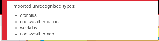

Hmmm, ik blijf maar de Homeassistant boom houden ipv de Panasonic parameters in Node Red - Contect Data?
Gasloos 2019 + WP Panasonic H-serie 7kW + 300 liter boilervat + PV 12.415Wp + Home Assistant + Hyundai Ioniq 6 First Edition + Zaptec laadpaal
  • Natrixz
  • Laatst online: 22:40
hemertje schreef op dinsdag 26 november 2024 @ 10:30:
@Natrixz @djoenez @Krisp
Waar hoort de coderegel thuis?
[{"id":"63f58601642903de","type":"group","z":"ac86d42a29852803","name":"Determine room temperature","style":{"label":true,"fill":"#d1d1d1"},"nodes":["071fd378027c2a1c","86eaf8ad791419d7","8a24b55b79985c68","3147ab1f956d046c"],"x":734,"y":731.5,"w":662,"h":97},{"id":"071fd378027c2a1c","type":"ps-strategy-heat-capacitor","z":"ac86d42a29852803","g":"63f58601642903de","name":"Determine room temperature","timeHeat1C":"240","timeCool1C":"240","maxTempAdjustment":"0.4","boostTempHeat":"0.5","boostTempCool":"0.7","minSavings":"0.03","setpoint":"19.5","x":940,"y":780,"wires":[["86eaf8ad791419d7"],[],[]]},{"id":"86eaf8ad791419d7","type":"switch","z":"ac86d42a29852803","g":"63f58601642903de","name":"Filter outliers","property":"payload","propertyType":"msg","rules":[{"t":"gt","v":"10","vt":"num"},{"t":"else"}],"checkall":"true","repair":false,"outputs":2,"x":1230,"y":780,"wires":[["8a24b55b79985c68"],[]]},{"id":"8a24b55b79985c68","type":"link out","z":"ac86d42a29852803","g":"63f58601642903de","name":"Set room setpoint","mode":"link","links":["9a106cdefc873348"],"x":1355,"y":780,"wires":[]},{"id":"3147ab1f956d046c","type":"link in","z":"ac86d42a29852803","g":"63f58601642903de","name":"link in 62","links":["67fd7b3293b538cf"],"x":775,"y":780,"wires":[["071fd378027c2a1c"]]},{"id":"52933b5a502cf15d","type":"group","z":"ac86d42a29852803","name":"Get energy prices (decide on which one)","style":{"fill":"#bfc7d7","label":true},"nodes":["77d28a94767686f8","b27c143c7bfe97c7","23eb119f465c18a9","7e108813b76d59f0","8cf9e190b6100f7f","018ecd8886088f24","45e17cbe17e8860d","1f6a2e12ad0d961b","ebe54f29705ee6c4","60f20f0668304c0d","67fd7b3293b538cf","c5e0cbd18ab76b66"],"x":194,"y":339,"w":1212,"h":322},{"id":"77d28a94767686f8","type":"function","z":"ac86d42a29852803","d":true,"g":"52933b5a502cf15d","name":"Prep for Powersaver nodes","func":"const nordpool = msg.payload;\n\nfunction toIsoString(date) {\n    var tzo = -date.getTimezoneOffset(), dif = tzo >= 0 ? \"+\" : \"-\",\n        pad = function (num) {\n            return (num < 10 ? \"0\" : \"\") + num;\n        };\n\n    return (\n        date.getFullYear() + \"-\" +\n        pad(date.getMonth() + 1) + \"-\" +\n        pad(date.getDate()) + \"T\" +\n        pad(date.getHours()) + \":\" +\n        pad(date.getMinutes()) + \":\" +\n        pad(date.getSeconds()) + dif +\n        pad(Math.floor(Math.abs(tzo) / 60)) + \":\" +\n        pad(Math.abs(tzo) % 60)\n    );\n}\n\nconst payload = {\n    priceData: nordpool.map((h) => {\n        const date = new Date(h.timestamp);\n        const start = toIsoString(date);\n        const value = Math.round(h.price * 10) / 10000;\n\n        return {\n            start,\n            value,\n        };\n    }),\n};\n\nreturn { payload };","outputs":1,"noerr":0,"initialize":"","finalize":"","libs":[],"x":780,"y":560,"wires":[["67fd7b3293b538cf"]]},{"id":"b27c143c7bfe97c7","type":"nordpool-api-plus","z":"ac86d42a29852803","g":"52933b5a502cf15d","name":"Nordpool - tomorrow","area":"NL","currency":"EUR","action":"dayAhead","x":520,"y":620,"wires":[["77d28a94767686f8"]]},{"id":"23eb119f465c18a9","type":"inject","z":"ac86d42a29852803","d":true,"g":"52933b5a502cf15d","name":"","props":[{"p":"payload"},{"p":"topic","vt":"str"}],"repeat":"","crontab":"23 14 * * *","once":true,"onceDelay":"20","topic":"","payload":"","payloadType":"date","x":310,"y":620,"wires":[["b27c143c7bfe97c7"]]},{"id":"7e108813b76d59f0","type":"nordpool-api-plus","z":"ac86d42a29852803","g":"52933b5a502cf15d","name":"Nordpool - today","area":"NL","currency":"EUR","action":"dayAhead","x":510,"y":560,"wires":[["77d28a94767686f8"]]},{"id":"8cf9e190b6100f7f","type":"inject","z":"ac86d42a29852803","d":true,"g":"52933b5a502cf15d","name":"","props":[{"p":"payload"},{"p":"topic","vt":"str"}],"repeat":"","crontab":"","once":true,"onceDelay":"10","topic":"","payload":"","payloadType":"date","x":310,"y":560,"wires":[["7e108813b76d59f0"]]},{"id":"018ecd8886088f24","type":"ps-receive-price","z":"ac86d42a29852803","g":"52933b5a502cf15d","name":"Price Receiver","x":1040,"y":480,"wires":[["67fd7b3293b538cf"]]},{"id":"45e17cbe17e8860d","type":"api-current-state","z":"ac86d42a29852803","g":"52933b5a502cf15d","name":"","server":"","version":3,"outputs":1,"halt_if":"","halt_if_type":"str","halt_if_compare":"is","entity_id":"sensor.nordpool","state_type":"num","blockInputOverrides":false,"outputProperties":[{"property":"payload","propertyType":"msg","value":"","valueType":"entityState"},{"property":"data","propertyType":"msg","value":"","valueType":"entity"}],"for":"","forType":"num","forUnits":"minutes","override_topic":false,"state_location":"payload","override_payload":"msg","entity_location":"data","override_data":"msg","x":770,"y":480,"wires":[["018ecd8886088f24","1f6a2e12ad0d961b"]]},{"id":"1f6a2e12ad0d961b","type":"function","z":"ac86d42a29852803","g":"52933b5a502cf15d","name":"Prep for Influx","func":"msg.payload = parseFloat(msg.payload);\nmsg.topic = \"hourly_price\";\nreturn msg;","outputs":1,"noerr":0,"initialize":"","finalize":"","libs":[],"x":1040,"y":380,"wires":[["ebe54f29705ee6c4"]]},{"id":"ebe54f29705ee6c4","type":"influxdb out","z":"ac86d42a29852803","g":"52933b5a502cf15d","influxdb":"","name":"Log energy price","measurement":"energy_price","precision":"","retentionPolicy":"","database":"database","precisionV18FluxV20":"s","retentionPolicyV18Flux":"","org":"test","bucket":"x","x":1290,"y":380,"wires":[]},{"id":"60f20f0668304c0d","type":"cronplus","z":"ac86d42a29852803","g":"52933b5a502cf15d","name":"","outputField":"payload","timeZone":"Europe/Amsterdam","storeName":"memoryOnly","commandResponseMsgOutput":"output1","defaultLocation":"","defaultLocationType":"default","outputs":1,"options":[{"name":"schedule1","topic":"topic1","payloadType":"bool","payload":"true","expressionType":"cron","expression":"30 1 * * * ? *","location":"","offset":"0","solarType":"all","solarEvents":"sunrise,sunset"}],"x":400,"y":480,"wires":[["45e17cbe17e8860d"]]},{"id":"67fd7b3293b538cf","type":"link out","z":"ac86d42a29852803","g":"52933b5a502cf15d","name":"link out 62","mode":"link","links":["d1e5026a16dbc676","3147ab1f956d046c","161227f39fcbc429","1c054137d0201081","5e57908d7ea0be44","b2d8d3c2cff86243"],"x":1205,"y":540,"wires":[]},{"id":"c5e0cbd18ab76b66","type":"inject","z":"ac86d42a29852803","d":true,"g":"52933b5a502cf15d","name":"Replan when restarted nodes","props":[{"p":"payload"},{"p":"topic","vt":"str"}],"repeat":"","crontab":"","once":false,"onceDelay":"60","topic":"","payload":"{\"commands\":{\"replan\":true}}","payloadType":"json","x":980,"y":620,"wires":[["67fd7b3293b538cf"]]},{"id":"1b8443f3a2fbced4","type":"group","z":"ac86d42a29852803","name":"Determine sterilisation scheme","style":{"fill":"#ffbfbf","label":true},"nodes":["b661b0da22d60992","230cbd34c03550c8","fb60cc084377388f","6cf298fc9c936de6","4ac4a4131a6a8465","ea2a1e3399a58c98","3cd1a1bc9111c34d","cc2c987231bf3a2d","161227f39fcbc429","1c054137d0201081","64ca8a80f8111a29"],"x":194,"y":919,"w":1222,"h":189.5},{"id":"b661b0da22d60992","type":"ps-strategy-lowest-price","z":"ac86d42a29852803","g":"1b8443f3a2fbced4","name":"Sterilisation lowest price ","fromTime":"00","toTime":"00","hoursOn":"2","maxPrice":"","doNotSplit":true,"sendCurrentValueWhenRescheduling":true,"outputValueForOn":"true","outputValueForOff":"false","outputValueForOntype":"bool","outputValueForOfftype":"bool","outputIfNoSchedule":"false","outputOutsidePeriod":"false","contextStorage":"memoryOnly","x":390,"y":980,"wires":[[],[],["230cbd34c03550c8"]]},{"id":"230cbd34c03550c8","type":"ps-schedule-merger","z":"ac86d42a29852803","g":"1b8443f3a2fbced4","name":"Merge day and time for sterilisation","outputIfNoSchedule":"false","logicFunction":"AND","schedulingDelay":"1000","sendCurrentValueWhenRescheduling":true,"outputValueForOn":"true","outputValueForOff":"false","outputValueForOntype":"bool","outputValueForOfftype":"bool","x":700,"y":980,"wires":[["ea2a1e3399a58c98","cc2c987231bf3a2d"],[],["64ca8a80f8111a29"]]},{"id":"fb60cc084377388f","type":"ps-strategy-fixed-schedule","z":"ac86d42a29852803","g":"1b8443f3a2fbced4","name":"Sterilisation day","periods":[{"start":"00","value":"true"}],"validFrom":"","validTo":"","days":{"Mon":false,"Tue":true,"Wed":false,"Thu":false,"Fri":false,"Sat":false,"Sun":false},"sendCurrentValueWhenRescheduling":true,"outputValueForOn":"true","outputValueForOff":"false","outputValueForOntype":"bool","outputValueForOfftype":"bool","outputIfNoSchedule":"false","contextStorage":"memoryOnly","x":420,"y":1060,"wires":[[],[],["230cbd34c03550c8"]]},{"id":"6cf298fc9c936de6","type":"link out","z":"ac86d42a29852803","g":"1b8443f3a2fbced4","name":"link out 39","mode":"link","links":["d0fda364deccc7f0"],"x":1375,"y":960,"wires":[]},{"id":"4ac4a4131a6a8465","type":"change","z":"ac86d42a29852803","g":"1b8443f3a2fbced4","name":"Prep for Sterilization planner","rules":[{"t":"set","p":"topic","pt":"msg","to":"Sterilization","tot":"str"},{"t":"set","p":"payload","pt":"msg","to":"1","tot":"num"}],"action":"","property":"","from":"","to":"","reg":false,"x":1190,"y":960,"wires":[["6cf298fc9c936de6"]]},{"id":"ea2a1e3399a58c98","type":"function","z":"ac86d42a29852803","g":"1b8443f3a2fbced4","name":"Turn heatpump on if necessary","func":"var HP_state = global.get('TOP0_Heatpump_State', \"file\");     // get the current state of the heatpump. Is it on or off.\n////////////////////////////////////////////////////////////////\nif ((HP_state == 0))                            // check if the override state is enabled, AND currently heatpump state is off \n{\n    msg = { payload: 1, topic: \"override\" };\n};\nreturn msg; ","outputs":1,"noerr":0,"initialize":"","finalize":"","libs":[],"x":1200,"y":1000,"wires":[["3cd1a1bc9111c34d"]]},{"id":"3cd1a1bc9111c34d","type":"link out","z":"ac86d42a29852803","g":"1b8443f3a2fbced4","name":"Power on Planning","mode":"link","links":["071ac5a0f08a8fdb","d9b3ca8bfaa4c10a"],"x":1375,"y":1000,"wires":[]},{"id":"cc2c987231bf3a2d","type":"delay","z":"ac86d42a29852803","g":"1b8443f3a2fbced4","name":"","pauseType":"delay","timeout":"1","timeoutUnits":"seconds","rate":"1","nbRateUnits":"1","rateUnits":"second","randomFirst":"1","randomLast":"5","randomUnits":"seconds","drop":false,"allowrate":false,"outputs":1,"x":995,"y":960,"wires":[["4ac4a4131a6a8465"]],"l":false},{"id":"161227f39fcbc429","type":"link in","z":"ac86d42a29852803","g":"1b8443f3a2fbced4","name":"link in 63","links":["67fd7b3293b538cf"],"x":235,"y":980,"wires":[["b661b0da22d60992"]]},{"id":"1c054137d0201081","type":"link in","z":"ac86d42a29852803","g":"1b8443f3a2fbced4","name":"link in 64","links":["67fd7b3293b538cf"],"x":285,"y":1060,"wires":[["fb60cc084377388f"]]},{"id":"64ca8a80f8111a29","type":"link out","z":"ac86d42a29852803","g":"1b8443f3a2fbced4","name":"link out 63","mode":"link","links":["b0897fa49e0b6e73"],"x":915,"y":1000,"wires":[]},{"id":"628b23cdd7529b06","type":"group","z":"ac86d42a29852803","name":"Determine DHW strategy","style":{"fill":"#bfdbef","label":true},"nodes":["a0d088fca91b26b4","8446dc090c0347fc","da7e68fd39fd25f2","f4b11920a2bc19b7","894b093e7020e766","7406ef2f61d0906a","eba8c63b733501c2","3ee6946a57749651","c567a1a68c52ad51","b248caed16a3e771","2a8c3c20cd9b4ff7","5e57908d7ea0be44","16428e63b0053db5"],"x":194,"y":1139,"w":1272,"h":182},{"id":"a0d088fca91b26b4","type":"ps-strategy-lowest-price","z":"ac86d42a29852803","g":"628b23cdd7529b06","name":"Lowest Price","fromTime":"18","toTime":"06","hoursOn":"1","maxPrice":"","doNotSplit":true,"sendCurrentValueWhenRescheduling":true,"outputValueForOn":"true","outputValueForOff":"false","outputValueForOntype":"bool","outputValueForOfftype":"bool","outputIfNoSchedule":"false","outputOutsidePeriod":"false","contextStorage":"memoryOnly","x":930,"y":1240,"wires":[["eba8c63b733501c2","c567a1a68c52ad51"],["2a8c3c20cd9b4ff7"],["16428e63b0053db5"]]},{"id":"8446dc090c0347fc","type":"function","z":"ac86d42a29852803","g":"628b23cdd7529b06","name":"Determine DHW strategy ","func":"const DHWTemp = msg.payload\nconst date = new Date();\nconst hour = date.getHours();\nconst TargetTemp = global.get('TOP9_DHW_Target_Temp','file')\nconst heatdelta = global.get('TOP22_DHW_Heat_Delta', 'file');\nconst delta = TargetTemp - DHWTemp + heatdelta;\n\nif(hour >= 6 && hour <18){\n    var toTime = 18\n}\nelse {\n    var toTime = 6\n};\n\nif (delta > 0) {\n    const config = {\n        \"name\": \"Lowest Price\",\n        \"config\": {\n            \"fromTime\": hour,\n            \"toTime\": toTime,\n            \"hoursOn\": 1,\n            \"override\": \"auto\"\n        }\n    };\n\nmsg.payload = config;\n}\nelse \n\n{ const config = {\n    \"name\": \"Lowest Price\",\n    \"config\": {\n        \"fromTime\": hour,\n        \"toTime\": toTime,\n        \"hoursOn\": 0,\n        \"override\": \"off\"\n    }\n};\n\nmsg.payload = config};\n\n// msg.payload = context.data.DHW_Target_Temp\n\nreturn msg; \n\n","outputs":1,"noerr":0,"initialize":"","finalize":"","libs":[],"x":650,"y":1240,"wires":[["a0d088fca91b26b4"]]},{"id":"da7e68fd39fd25f2","type":"mqtt in","z":"ac86d42a29852803","g":"628b23cdd7529b06","name":"DHWTemp","topic":"panasonic_heat_pump/main/DHW_Temp","qos":"2","datatype":"auto-detect","broker":"accae33c.753638","nl":false,"rap":true,"rh":0,"inputs":0,"x":280,"y":1240,"wires":[["f4b11920a2bc19b7"]]},{"id":"f4b11920a2bc19b7","type":"rbe","z":"ac86d42a29852803","g":"628b23cdd7529b06","name":"","func":"rbe","gap":"","start":"","inout":"out","septopics":true,"property":"payload","topi":"topic","x":430,"y":1240,"wires":[["8446dc090c0347fc"]]},{"id":"894b093e7020e766","type":"link out","z":"ac86d42a29852803","g":"628b23cdd7529b06","name":"Force DHW","mode":"link","links":["ef28d0205d50cb26"],"x":1425,"y":1180,"wires":[]},{"id":"7406ef2f61d0906a","type":"change","z":"ac86d42a29852803","g":"628b23cdd7529b06","name":"Prep for force DHW ","rules":[{"t":"set","p":"topic","pt":"msg","to":"DHW","tot":"str"},{"t":"set","p":"payload","pt":"msg","to":"1","tot":"num"}],"action":"","property":"","from":"","to":"","reg":false,"x":1220,"y":1180,"wires":[["894b093e7020e766"]]},{"id":"eba8c63b733501c2","type":"function","z":"ac86d42a29852803","g":"628b23cdd7529b06","name":"Turn heatpump on if necessary","func":"var HP_state = global.get('TOP0_Heatpump_State', \"file\");     // get the current state of the heatpump. Is it on or off.\n////////////////////////////////////////////////////////////////\nif ((HP_state == 0))                            // check if the override state is enabled, AND currently heatpump state is off \n{\n    msg = { payload: 1, topic: \"override\" };\n};\nreturn msg; ","outputs":1,"noerr":0,"initialize":"","finalize":"","libs":[],"x":1240,"y":1220,"wires":[["3ee6946a57749651"]]},{"id":"3ee6946a57749651","type":"link out","z":"ac86d42a29852803","g":"628b23cdd7529b06","name":"Power on Planning","mode":"link","links":["071ac5a0f08a8fdb","d9b3ca8bfaa4c10a"],"x":1425,"y":1220,"wires":[]},{"id":"c567a1a68c52ad51","type":"delay","z":"ac86d42a29852803","g":"628b23cdd7529b06","name":"","pauseType":"delay","timeout":"1","timeoutUnits":"seconds","rate":"1","nbRateUnits":"1","rateUnits":"second","randomFirst":"1","randomLast":"5","randomUnits":"seconds","drop":false,"allowrate":false,"outputs":1,"x":1025,"y":1180,"wires":[["7406ef2f61d0906a"]],"l":false},{"id":"b248caed16a3e771","type":"link out","z":"ac86d42a29852803","g":"628b23cdd7529b06","name":"Power on Planning","mode":"link","links":["071ac5a0f08a8fdb","d9b3ca8bfaa4c10a"],"x":1425,"y":1260,"wires":[]},{"id":"2a8c3c20cd9b4ff7","type":"function","z":"ac86d42a29852803","g":"628b23cdd7529b06","name":"Turn heatpump off if possible","func":"var Operating_state = global.get('TOP4_Operating_Mode_State', \"file\");     // get the current state of the heatpump. Is it on or off.\nvar Pump_Flow = global.get('TOP1_Pump_Flow', \"memoryOnly\")\n////////////////////////////////////////////////////////////////\nif ((Operating_state == 3 && Pump_Flow < 1))                            // check if only DHW is enabled \n{\n    msg = { payload: 0, topic: \"override\" };\n};\nreturn msg; ","outputs":1,"noerr":0,"initialize":"","finalize":"","libs":[],"x":1230,"y":1260,"wires":[["b248caed16a3e771"]]},{"id":"5e57908d7ea0be44","type":"link in","z":"ac86d42a29852803","g":"628b23cdd7529b06","name":"link in 65","links":["67fd7b3293b538cf"],"x":805,"y":1220,"wires":[["a0d088fca91b26b4"]]},{"id":"16428e63b0053db5","type":"link out","z":"ac86d42a29852803","g":"628b23cdd7529b06","name":"link out 64","mode":"link","links":["b0897fa49e0b6e73"],"x":1045,"y":1280,"wires":[]},{"id":"accae33c.753638","type":"mqtt-broker","name":"MQTT","broker":"x.x.x.x","port":"1883","clientid":"node-red","autoConnect":true,"usetls":false,"compatmode":false,"protocolVersion":"5","keepalive":"60","cleansession":false,"birthTopic":"","birthQos":"0","birthRetain":"false","birthPayload":"","birthMsg":{},"closeTopic":"","closeQos":"0","closeRetain":"false","closePayload":"","closeMsg":{},"willTopic":"","willQos":"0","willRetain":"false","willPayload":"","willMsg":{},"userProps":"","sessionExpiry":""},{"id":"608a7292e1808e4d","type":"group","z":"ac86d42a29852803","name":"Visualisation for HA (opt)","style":{"fill":"#e3f3d3","label":true},"nodes":["01c3265cd075021e","cad33a63f66ef72e","b0a01df532296971","b0897fa49e0b6e73"],"x":584,"y":1371.5,"w":862,"h":97},{"id":"01c3265cd075021e","type":"ps-schedule-merger","z":"ac86d42a29852803","g":"608a7292e1808e4d","name":"Merge for HA visuatisation","outputIfNoSchedule":"false","logicFunction":"OR","schedulingDelay":2000,"sendCurrentValueWhenRescheduling":true,"outputValueForOn":"true","outputValueForOff":"false","outputValueForOntype":"bool","outputValueForOfftype":"bool","x":800,"y":1420,"wires":[[],[],["cad33a63f66ef72e"]]},{"id":"cad33a63f66ef72e","type":"function","z":"ac86d42a29852803","g":"608a7292e1808e4d","name":"Convert true/false to 1/0","func":"msg.payload.hours.forEach(h => h.onOff = h.onOff ? \"1\" : \"0\")\nreturn msg;","outputs":1,"noerr":0,"initialize":"","finalize":"","libs":[],"x":1110,"y":1420,"wires":[["b0a01df532296971"]]},{"id":"b0a01df532296971","type":"ha-sensor","z":"ac86d42a29852803","g":"608a7292e1808e4d","name":"Info from PS to HA","entityConfig":"eab799518168f5a3","version":0,"state":"payload","stateType":"str","attributes":[{"property":"Schedule","value":"payload.schedule","valueType":"msg"},{"property":"Hours","value":"payload.hours","valueType":"msg"},{"property":"Control","value":"payload.hours[0].onOff","valueType":"str"},{"property":"Current","value":"payload.current","valueType":"str"}],"inputOverride":"allow","outputProperties":[],"x":1330,"y":1420,"wires":[[]]},{"id":"b0897fa49e0b6e73","type":"link in","z":"ac86d42a29852803","g":"608a7292e1808e4d","name":"link in 66","links":["64ca8a80f8111a29","16428e63b0053db5"],"x":625,"y":1420,"wires":[["01c3265cd075021e"]]},{"id":"eab799518168f5a3","type":"ha-entity-config","server":"33cb7d2214929908","deviceConfig":"541b42292cfc1dd5","name":"sensor config ","version":"6","entityType":"sensor","haConfig":[{"property":"name","value":"Powersaver"},{"property":"icon","value":""},{"property":"entity_category","value":""},{"property":"entity_picture","value":""},{"property":"device_class","value":""},{"property":"unit_of_measurement","value":""},{"property":"state_class","value":""}],"resend":true,"debugEnabled":false},{"id":"33cb7d2214929908","type":"server","name":"Home Assistant","version":5,"addon":false,"rejectUnauthorizedCerts":false,"ha_boolean":"y|yes|true|on|home|open","connectionDelay":true,"cacheJson":true,"heartbeat":false,"heartbeatInterval":"30","areaSelector":"friendlyName","deviceSelector":"friendlyName","entitySelector":"friendlyName","statusSeparator":": ","statusYear":"hidden","statusMonth":"short","statusDay":"numeric","statusHourCycle":"default","statusTimeFormat":"h:m","enableGlobalContextStore":false},{"id":"541b42292cfc1dd5","type":"ha-device-config","name":"","hwVersion":"","manufacturer":"Node-RED","model":"","swVersion":""}]
kan je me het een en ander toelichten?
thx!
Import als een separate /new flow =)

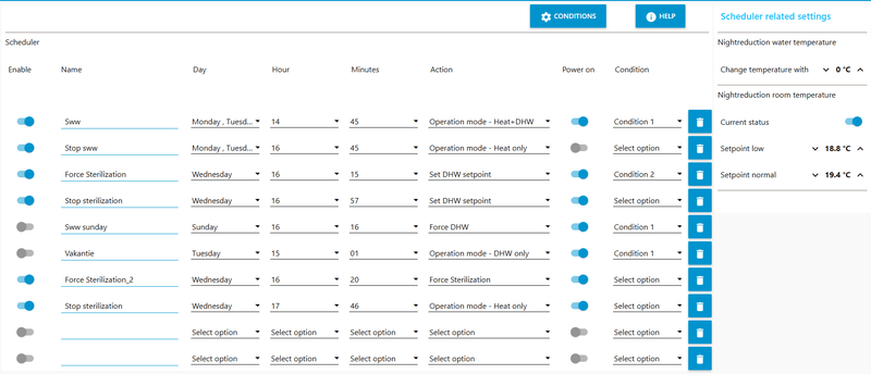

@edterbak Ik heb nu al 2 dagen (op 24.06) dat mijn scheduler niet meer voldoende werkt om DWH te maken. Dit werkte voorheen altijd prima.
Ik heb recentelijk dus de upgrade van 24.03 naar 24.05 gedaan en toen werkte het volgens mij nog wel. Nu heb ik gisterenochtend van 24.05 naar 24.06 de update gedaan. Dit alles volgens de update flow zoals beschreven op de website.
Ook heb ik sinds de toevoeging van externe thermostaat dat de pomp overdreven hard bezig is. Zie ook de softstart logging.
Dit is de log. Hier schakel ik uiteindelijk handmatig de pomp aan. Condition 1 is DWH temp above 45.
Flow version 24.06 Stable
26/11 16:30:14 - Function SoftStart: Correction: -3 > -3 °C - (EVALUATING) Freq: 63Hz, SP_Final: 17°C
26/11 16:27:56 - Function WAR: Setpoint change: From 27 to 27.5 °C
26/11 16:27:23 - Function SoftStart: --> Pump did not yet relax (64Hz). Restarting Phase 1 again...
26/11 16:27:18 - Function SoftStart: Correction: -3 > -3 °C - (EVALUATING) Freq: 63Hz, SP_Final: 17°C
26/11 16:27:13 - Function SoftStart: Correction: -3 > -3 °C - (EVALUATING) Freq: 58Hz, SP_Final: 17°C
26/11 16:26:21 - Function SoftStart: Correction: -4 > -3 °C - (STARTUP) Freq: 56Hz, SP_Final: 17°C
26/11 16:25:56 - Function SoftStart: Correction: -5 > -4 °C - (STARTUP) Freq: 48Hz, SP_Final: 16°C
26/11 16:24:33 - Function SoftStart: Correction: -4 > -5 °C - (STARTUP) Freq: 27Hz, SP_Final: 15°C
26/11 16:24:28 - Function SoftStart: Correction: -3 > -4 °C - (STARTUP) Freq: 24Hz, SP_Final: 16°C
26/11 16:24:23 - Compressor: running
26/11 16:24:23 - Function SoftStart: Correction: 0 > -3 °C - (STARTUP) Freq: 20Hz, SP_Final: 17°C
26/11 16:23:07 - TOP20_ThreeWay_Valve_State: 0
26/11 16:19:32 - Compressor: stopped
26/11 15:38:56 - Compressor: running
26/11 15:35:51 - TOP20_ThreeWay_Valve_State: 1
26/11 15:35:48 - MQTT Command: SetHeatpump: 1 (GUI)
26/11 14:46:00 - TOP4_Operating_Mode_State: 4
26/11 14:45:58 - MQTT Command: SetOperationMode: 4 (scheduler)
26/11 14:45:57 - Scheduler: Stored next operating mode empty. Setting new operating mode to: 4
26/11 14:27:56 - Function RTC: Correction change: From -1 to 0 °C (Room actual: 19.49 °C)
26/11 11:22:56 - Function WAR: Setpoint change: From 27.5 to 27 °C
Afbeeldingslocatie: https://tweakers.net/i/VBX2nULA8YEvvh25gcPWn73Kyy8=/800x/filters:strip_exif()/f/image/7hNyjZDx3PbG1HTvQuoXkv2V.png?f=fotoalbum_large
  • Wat betekent "niet meer voldoende werkt"?
  • Wat is "overdreven hard"?
  • Waarom heb je de RTC nog aan staan en wat verwacht je hiervan?
  • Heb je de juiste softstart settings bij fase 1?
  • Waarom heb je een regel om de sterilisatie te stoppen?
WH-MDC09J3E5
  • edterbak
  • Laatst online: 29-08 13:17
imdos schreef op dinsdag 26 november 2024 @ 16:34:
Dat is wel gek.
Kun je van condition 1 alle waarden opnieuw instellen? Kijken of dat helpt.
Je zou ook nu al even een kijkje kunnen nemen in je context store.
Dit verwacht ik ongeveer te zien:
Voornamelijk gaat het om die schedule_override... niet waar het rode balkje om zit.
Afbeeldingslocatie: https://tweakers.net/i/KJ_NNonxURb6bIdlwNk-YZFQS00=/800x/filters:strip_exif()/f/image/A5SIrNjfOkRtjOV3YN2biblt.png?f=fotoalbum_large
Afbeeldingslocatie: https://tweakers.net/i/bXLnhp0DEKjvccKAcax3yxhg-60=/800x/filters:strip_exif()/f/image/utPAD9geWqcVKQsl77HJLXWe.png?f=fotoalbum_large

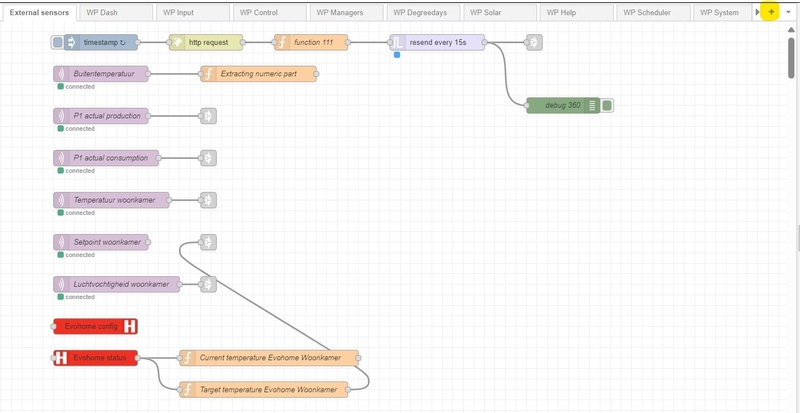

Guy-Manuel schreef op zondag 24 november 2024 @ 18:22:
Nee, ik heb een eigen tabblad aangemaakt en die external sensors genoemd en daar staan de inputs, daarna zijn deze met een link-out node gekoppeld aan de link-in nodes op het WP-input tab.
Zo kun je voor een update van Ed ook WP Input verwijderen. Na het importeren van een nieuwe flow zijn de link-out en link-in nodes automatisch alweer gekoppeld.
@Guy-Manuel
Wil jeje Tabbladen [External sensors] en [WP Input] delen met ons?

  • Heb je eigenlijk nog iets veranderd aan de RTC instellingen sinds de vorige keer?
  • Zou je eens een tijd RTC uit kunnen zetten en gewoon WAR draaien, wat gebeurd er dan?
  • Heb je wellicht meteen de mogelijkheid om de stooklijn de optimaliseren.
  • Je hebt een verdeler en radiatoren, hoe ziet je installatie er precies uit? Heb je een gesloten of een open verdeler, leidingwerk etc. Hoeveel ruimtes worden er verwarmd op welke manier?
  • Wat heb je inmiddels al uit de scheduler gehaald en wat voor conditions heb/had je daarbij ingesteld?
  • Wat schort eraan met de sterilisatie, heb je het element direct aangesloten op de contacten van de panasonic en de tank verwarming op external gezet?
Afbeeldingslocatie: https://tweakers.net/i/r1Bxezyqdk4P4TR-_Vh2lmS8rhw=/800x/filters:strip_icc():strip_exif()/f/image/VRFHprssBK29O7yM3QG2zOXj.jpg?f=fotoalbum_large
Afbeeldingslocatie: https://tweakers.net/i/o9tljjPCUf6FT02HB43JTFx1YKY=/800x/filters:strip_icc():strip_exif()/f/image/jfzkcWKeCSugJtnUyzF71HGn.jpg?f=fotoalbum_large

hemertje schreef op woensdag 27 november 2024 @ 20:11:
@Guy-Manuel
Wat wil je graag hebben? ;) WP Input is gewoon default zoals Ed deze heeft gemaakt,
en external sensors is gewoon een leeg tabje met wat MQTT-in nodes en link-out nodes
Afbeeldingslocatie: https://tweakers.net/i/H1qx8MCDV2rL-dBmayqSzUcLIDo=/800x/filters:strip_icc():strip_exif()/f/image/MFk92PQknRg6pfExB7isZ3vL.jpg?f=fotoalbum_large
WH-MDC09J3E5
  • hemertje
  • Registratie: Juli 2015
  • Laatst online: 31-08 14:18
dankje, ik ben op zoek naar je oplossing
zoals je het eerder omschreef vind ik het een mooie oplossing om in de toekomst te kunnen updaten zonder je inputs opnieuw te hoeven instellen in Ed's zijn [WP Input]
ik heb laatst de Aqara Temperatuur- en luchtvochtigheidssensor T1 | Zigbee 3.0 gekocht die nu in de woonkamer hangt, deze kan ik dus in de [External sensors] toevoegen en deze met een node-out koppelen via een node-in met [WP inputs] ?
  • Guy-Manuel
  • Laatst online: 24-08 05:46
hemertje schreef op woensdag 27 november 2024 @ 20:35:
De flows van Ed waren mijn introductie met NR, dus mijn kennis is vrij beperkt ;)
Maar ik heb precies gedaan wat Ed heeft beschreven, niet meer.
Ik heb NR los draaien van HA, en publiceer (waarschijnlijk nogal omslachtig) de entiteiten via MQTT om ze in NR via een een MQTT in weer op te pikken.
yaml voorbeeld:
- alias: Update Temperature
trigger:
platform: time_pattern
seconds: /30
action:
- service: homeassistant.update_entity
data:
entity_id: sensor.zigbee_woonkamer_temp_hum_temperature
- service: mqtt.publish
data:
topic: home/woonkamer/temperatuur
payload: '{{ states(''sensor.zigbee_woonkamer_temp_hum_temperature'') }}'
retain: true
Wellicht is het makkelijker via de home-assistant nodes. ChatGPT is je vriend.
Afbeeldingslocatie: https://tweakers.net/i/EnsG9HcnMzuLfiTjqhjVwVWwjbo=/fit-in/4920x3264/filters:max_bytes(3145728):no_upscale():strip_icc():strip_exif()/f/image/UP73aRvMNlAsKTxidIK6ud7n.jpg?f=user_large
En ja, zo kun je ze koppelen, Ed heeft de link-in nodes al voorbereid.
WH-MDC09J3E5

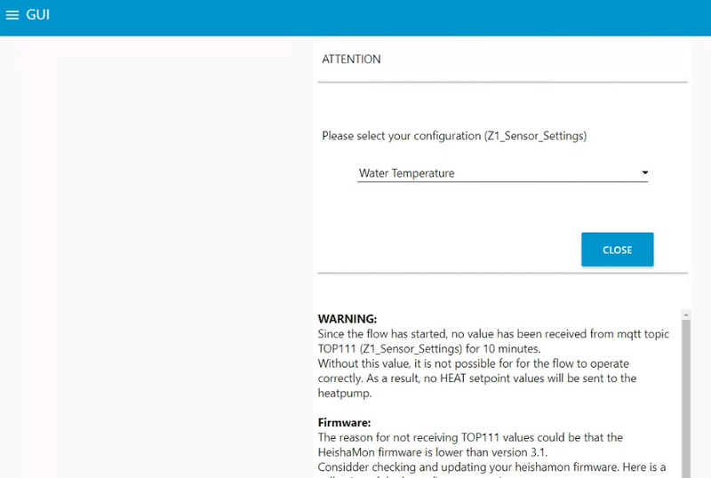

  • Aziona
  • Laatst online: 21:12
Bij het installeren van versie 24.06 (meen ik) krijg ik de melding over TOP111 en een te lage firmware versie terwijl ik wel versie 3.8 heb. Hoe zou dat komen dat ik desondanks deze melding krijg?
Afbeeldingslocatie: https://tweakers.net/i/yOEA_Qb1cnCME_9-C6zTJT5uw8M=/800x/filters:strip_exif()/f/image/dTOWbUY3vQaSonM1hHzgMsNA.png?f=fotoalbum_large

Aziona schreef op donderdag 28 november 2024 @ 13:57:
Dat is gek inderdaad. Ik zit ook op 3.8, zonder deze boodschap.
Kun je zien of je TOP111 ontvangt op in de heishamon? en hoe heet dit topic exact?
Ik heb dit ook ervaren tijdens een update (van 24.03 naar 24.05 of naar 24.06). Met ook afgewisseld met de melding dat de heishamon helemaal niet gevonden kon worden.
Bij mij duurde het enkele minuten (10 - 12 ongeveer) en toen was alles weer normaal.
Ik vermoed dat dit komt omdat de mqtt broker tijdelijk niet mag connecten op de mosquitto broker (vanwege Uniek ID conflict).
Ik kon de laatste update sneller online komen door de mqtt test functie te gebruiken in het tabje bij System.
Klopt mijn redenatie? @edterbak

imdos schreef op vrijdag 29 november 2024 @ 09:41:
Afbeeldingslocatie: https://tweakers.net/i/PKE0fxCgnfpV3Sonufxs_O3ws-w=/fit-in/4000x4000/filters:no_upscale():strip_exif()/f/image/pdTsfWTaTf73Cs7fjV1xxb4z.png?f=user_large
Ja dat kan zijn ja.
Het is een situatie welke soms wel eens dwars zit.
Ik had in het verleden de Client ID ingevuld. Dit omdat mijn mqtt broker (HiveMQ of EMQX) een beperkt aantal ID's toelaat. Ik kwam lang gleden ineens voor een verassing te staan dat het fout ging. van daar.
Maar ik heb omdat er hier in het forum een keer wat feedback op kwam dat dit soms conflicten op leverde.. ik weet niet meer exact... Heb dit weer leeg gemaakt. Nu is de client dus bij iedere reboot van Node Red mogelijk anders.
Het zou dus mogelijk kunnen zijn dat dit effect een rol speelt en dat de broker dus wat tijd nodig heeft om dat op te pakken.
Maar dit is wel wat gis-werk aan mijn kant hoor of dit is wat je ervaart. Ik weet niet exact hoe dat werkelijk werkt. :)

  • hemertje
Een paar vraagjes aan de kenners hier?
Hoe pas ik de Homewizard P1 meter zo aan zodat deze door de HA MQTT broker herkent wordt?
En hoe koppel ik deze aan de Node Red input? Dubbelklik op MQTT/HomeAssistant/Domoticz_5_Production en vervolgens de P1 meter selecteren?
Laatst heb ik de Aqara Temperatuur- en luchtvochtigheidssensor T1 | Zigbee 3.0 aangeschaft en toegevoegd
Onder Settings - Devices - Zigbee Home Automation zie ik deze als 'lumi.sensor_ht.agl02'
Hoe maak ik ook deze zichtbaar onder MQTT?
Hoe koppel ik deze vervolgens aan de MQTT/HomeAssistant/Domoticz_2_Room_Temperature in Node Red?
Op de Overview pagina lees ik bij Forecast Thuis de actuele buitentemperatuur af
Hoe koppel ik deze aan de Node Red MQTT/HomeAssistant/Domoticz_1_Outside_Temperature?

Wat is de operating mode op dat moment dat hij aan het spammen is iedere 5 minuten?
//// Operating mode     0=Heat only,     1=Cool only,       2=Auto(Heat),       3=DHW only,       4=Heat+DHW,      5=Cool+DHW,       6=Auto(Heat)+DHW,       7=Auto(Cool),     8=Auto(Cool)+DHW
[edit]
Ik vermoed Operating Mode 6 (Auto+DHW).. right?
Kun je alsjeblieft mij voorzien van informatie. Je geeft zo weinig om wat mee te kunnen.
Wat zijn je instellingen... zoals
Welke functies staan aan.
Wat is de huidige operating mode wanneer je dit ziet.
Hoe heb je de COOL modus ingesteld, DIRECT / STOOKLIJN?
Help mij je te helpen.. :)

Ik gebruik alleen Heat only en Heat+DHW. in beide gevallen doet hij het (er gebeurd verder niets mee)
RTC en SoftStart staan aan.
Room setpoint is 21 en RTC correctie is -3, dat maakt wel 18 ;-)
30/11 14:25:05 - MQTT Command: SetZ1CoolRequestTemperature: 19 (GUI)
30/11 14:24:10 - MQTT Command: SetZ1CoolRequestTemperature: 18 (SoftStart)
30/11 14:22:07 - Function - Calculate new SP: New final T shift calculated: Current T shift: 5 °C. New calculated T shift: 4 °C
Zie hierboven, de SoftStart geeft de 18 graden door. De 19 is van mij handmatig.

Zeker, alleen moet je de binnenkomende Node aanpassen. MQTT Explorer is daar handig voor om dat op te zoeken.
[{"id":"c98a6e84.07966","type":"tab","label":"WP eigen","disabled":false,"info":""},{"id":"737aa6fd.c0bbd8","type":"mqtt in","z":"c98a6e84.07966","name":"Domoticz Gemiddelde kamertemperatuur","topic":"domoticz/out/331","qos":"2","datatype":"auto-detect","broker":"92e5b2c.00a8b5","nl":false,"rap":false,"inputs":0,"x":260,"y":100,"wires":[["c38c10aa944804da"]]},{"id":"ddce2add.a6e758","type":"mqtt in","z":"c98a6e84.07966","name":"Gemiddelde buitentemperatuur","topic":"domoticz/out/640","qos":"2","datatype":"auto-detect","broker":"92e5b2c.00a8b5","nl":false,"rap":false,"inputs":0,"x":230,"y":160,"wires":[["9f168ee3e29ba512"]]},{"id":"ade9a826.da6908","type":"mqtt in","z":"c98a6e84.07966","name":"P1 verbruik/consumption","topic":"domoticz/out/35","qos":"2","datatype":"auto-detect","broker":"92e5b2c.00a8b5","nl":false,"rap":false,"inputs":0,"x":210,"y":220,"wires":[["3da545fc1ccf9429"]]},{"id":"7e9393f.a80ed6c","type":"mqtt in","z":"c98a6e84.07966","name":"P1 production","topic":"domoticz/out/35","qos":"2","datatype":"auto-detect","broker":"92e5b2c.00a8b5","nl":false,"rap":false,"inputs":0,"x":170,"y":280,"wires":[["a15f4be62375883c"]]},{"id":"3da545fc1ccf9429","type":"link out","z":"c98a6e84.07966","name":"Consumption","mode":"link","links":["9d14f9dbabd85620"],"x":515,"y":220,"wires":[]},{"id":"c38c10aa944804da","type":"link out","z":"c98a6e84.07966","name":"RTC","mode":"link","links":["73bf30cdf65e98ac"],"x":515,"y":100,"wires":[]},{"id":"9f168ee3e29ba512","type":"link out","z":"c98a6e84.07966","name":"Outside","mode":"link","links":["7559389970f919c5"],"x":515,"y":160,"wires":[]},{"id":"a15f4be62375883c","type":"link out","z":"c98a6e84.07966","name":"Production","mode":"link","links":["25b5c6c2e35987ca"],"x":795,"y":280,"wires":[]},{"id":"93a0a11fcacdcd9a","type":"json","z":"c98a6e84.07966","name":"","property":"payload","action":"","pretty":false,"x":390,"y":460,"wires":[["7cec2c7799c2e2a4","8f626ae64fb064aa"]]},{"id":"8f626ae64fb064aa","type":"debug","z":"c98a6e84.07966","name":"","active":true,"tosidebar":true,"console":true,"tostatus":true,"complete":"payload","targetType":"msg","statusVal":"payload","statusType":"auto","x":560,"y":600,"wires":[]},{"id":"97f2390f116b4749","type":"link out","z":"c98a6e84.07966","name":"link out 112","mode":"link","links":["50510191e3d7f7fc"],"x":1065,"y":380,"wires":[]},{"id":"7cd1e3b53344afa6","type":"mqtt in","z":"c98a6e84.07966","name":"","topic":"domoticz/out/419","qos":"2","datatype":"auto-detect","broker":"92e5b2c.00a8b5","nl":false,"rap":true,"rh":0,"inputs":0,"x":180,"y":460,"wires":[["93a0a11fcacdcd9a"]]},{"id":"7cec2c7799c2e2a4","type":"switch","z":"c98a6e84.07966","name":"","property":"payload.nvalue","propertyType":"msg","rules":[{"t":"eq","v":"0","vt":"msg"},{"t":"eq","v":"1","vt":"msg"}],"checkall":"true","repair":false,"outputs":2,"x":610,"y":460,"wires":[["19464d9b6dcf1655"],["0036cf8cd2307db9"]]},{"id":"19464d9b6dcf1655","type":"function","z":"c98a6e84.07966","name":"","func":"msg.payload = 0\nreturn msg;","outputs":1,"timeout":"","noerr":0,"initialize":"","finalize":"","libs":[],"x":800,"y":360,"wires":[["97f2390f116b4749"]]},{"id":"0036cf8cd2307db9","type":"function","z":"c98a6e84.07966","name":"","func":"msg.payload = 1\nreturn msg;","outputs":1,"timeout":"","noerr":0,"initialize":"","finalize":"","libs":[],"x":800,"y":440,"wires":[["97f2390f116b4749"]]},{"id":"92e5b2c.00a8b5","type":"mqtt-broker","name":"MQTT","broker":"192.168.2.4","port":"1883","clientid":"","autoConnect":true,"usetls":false,"compatmode":false,"protocolVersion":"4","keepalive":"60","cleansession":true,"autoUnsubscribe":true,"birthTopic":"","birthQos":"0","birthRetain":"false","birthPayload":"","birthMsg":{},"closeTopic":"","closeQos":"0","closeRetain":"false","closePayload":"","closeMsg":{},"willTopic":"","willQos":"0","willRetain":"false","willPayload":"","willMsg":{},"userProps":"","sessionExpiry":""}]

Wat staat er achter "System > Hardware > Cooling mode"?
  • BazemanKM
  • Laatst online: 22:22
edterbak schreef op zaterdag 30 november 2024 @ 16:30:
Compensation curve
https://www.fam-oldenburger.nl/category/domotica/
  • edterbak
There you have it.... :D :D
De functie werkt niet goed met compensation curve voor cool. (lees: werkt niet)
Als je cool functie wilt gebruiken via node red, dan moet je in de controller aangeven dat je cool via direct wilt aansturen.

Hallo Ed,
Om Solar²DHW te kunnen laten werken zal Node Red moeten weten of de zonnepanelen een overschot produceren?
Dan zal ik in Node Red de import/export status van de Homewizard P1 meter moeten koppelen toch?
Zonder dat je inputs koppelt aan Node Red kan Node Red je actuele situatie toch niet bepalen en op deze temperatuur gaan sturen?
De WAR functie berekend je water temperatuur op basis van de buitentemperatuur, dus je zal deze buitentemperatuur moeten koppelen aan die van je thuissituatie?
Op de Overview pagina van Home Assistant zie ik bij ‘Forecast thuis’ dat het buiten 8GrC is (Weather forecast from met.no, delivered by the Norwegian Meteorological Institute.)
De zal dan in MQTT beschikbaar moeten komen neem ik aan om te kunnen koppelen?
Kan je voor Room setpoint je Panasonic kamerthermostaat gebruiken net als iedere andere Zigbee thermostaat? Gebruikt Node Red standaard de waarde van de Panasonic kamerthermostaat?

BazemanKM schreef op zaterdag 30 november 2024 @ 16:23:
@BazemanKM Waar pas ik deze Code toe en hoe?

hemertje schreef op zondag 1 december 2024 @ 15:42:
Hallo Ed,
Je kan voor al deze zaken een sensor selecteren die je ter beschikking hebt en als je die niet hebt zal je wat moeten regelen.
Als je P1 sensor hebt kan je die gebruiken, ik heb nog een oude ferrarismeter maar wel via andere oplossing mijn opbrengst van PV beschikbaar, die gebruik ik dus. Natuurlijk zorgen dat die in node-red beschikbaar is maar dat is meestal geen probleem via MQTT of enige andere node.
Buitentemperatuur kan je van alles voor gebruiken, de meest voor de hand liggende is de buitentemperatuur die de WP via heishamon doorgeeft. Kan je dus via MQTT in node-red hangen.
Room setpoint is natuurlijk afhankelijk van wat jij gebruikt als thermostaat en of je die op 1 of andere manier beschikbaar kan maken binnen node-red. Als je een vrij simpel schema hebt kan je die ook via de scheduler functie van 't dashboard invoeren.

blb4 schreef op zondag 1 december 2024 @ 15:58:
.............en als je die niet hebt zal je wat moeten regelen.
En daar zit mijn probleem, ik heb nog onvoldoende kennis van Home Assistant zodat ik snap wat en waar ik moet bewerkstelligen....
  • BazemanKM
hemertje schreef op zondag 1 december 2024 @ 15:43:
Node-RED, import, plakken en dan een nieuw tabblad.

  • Hieke
@hemertje Misschien dat ik je tekst niet goed kan lezen of dat ik begrippen door elkaar haal, maar
Solar2DHW is functie om boilerwater op te stoken en WAR is om CV-water te verwarmen.
Ik heb Solar2DHW via onderstaande flow in het Personal tabblad staan. Daar zijn de koppelingen naar de flows van ED in opgenomen.
Ik heet geen Ed, maar weet wel het antwoord en je zult het ook op de te importeren flow zien.
De import en export vanaf P1/slimme meter wordt doorgegeven aan het dashboard en daar kan je dan de instellingen doen.

@hemertje
Zoals hierboven al geschreven...
Als je homewizard integratie hebt ingesteld en werkend hebt in HomeAssistant, dan kun je deze rechtstreeks in Node Red uitlezen.
NodeRed <-> HomeAssistent heeft namelijk een allemaal nodes beschikbaar om te kunnen communiceren.
Afbeeldingslocatie: https://tweakers.net/i/-2mPLkoTGfpy2Sdc-ZbUCdlXElM=/232x232/filters:strip_exif()/f/image/okkI7qAZeg40cvv25ZFMOR7X.png?f=fotoalbum_tile
click to enlarge
En als je niet IN HA de node red addon gebruikt, kun je deze pallet installeren met (bijne) het zelfde resultaat.
- node-red-contrib-home-assistant-websocket

Natrixz schreef op dinsdag 26 november 2024 @ 14:01:
@Natrixz
Bij mij worden eer paar variabelen niet herkend
Afbeeldingslocatie: https://tweakers.net/i/UbIQyBEA-wlvz7Mezymd3Oijhsw=/fit-in/4000x4000/filters:no_upscale():strip_exif()/f/image/RIq70tnRqYHVBB14OuGkaqph.png?f=user_large

  • Natrixz
hemertje schreef op zondag 1 december 2024 @ 20:47:
@Natrixz
Dat zijn additionele plugins die je even moet installeren ;)
