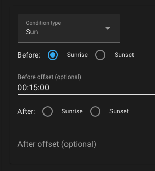

Om even terug te komen op deze automation. Ik heb hem nu zo en dat lijkt goed te werken:
YAML:
24
25
26
27
28
29
30
31
32
33
34
35
36
37
38
39
40
41
42
43
44
45
46
47
48
49
50
51
52
53
54
55
56
57
58
59
60
61
62
63
64
65
66
67
68
69
70
71
72
73
74
75
76
77
78
79
80
81
82
83
84
85
86
87
88
89
90
91
92
93
94
95
96
97
98
99
100
101
102
103
104
105
106
107
108
109
110
111
112
113
114
115
116
117
118
119
120
121
122
123
124
125
126
127
128
129
130
131
132
133
134
135
136
137
138
139
140
141
142
143
144
145
146
147
148
149
150
151
152
153
154
155
156
157
158
159
160
161
162
163
164
165
166
## Tuinverlichting aan/uit                                                                                 ##
- id: '202111200646'
  alias: Tuinverlichting aan/uit
  description: Aansturen alle buitenverlichting
  trigger:
    - platform: time
      at: input_datetime.patio_licht_aan_ochtend_1
    - platform: time
      at: input_datetime.carport_licht_aan_ochtend
    - platform: time
      at: input_datetime.patio_licht_uit_ochtend_1
    - platform: time
      at: input_datetime.carport_licht_uit_ochtend
    - platform: time
      at: input_datetime.patio_licht_aan_ochtend_2
    - platform: sun
      event: sunrise
      offset: '-00:15:00'
    - platform: numeric_state
      entity_id: sun.sun
      attribute: elevation
      below: -4.0
      entity_id: sun.sun
      below: -27.0
    - platform: time
      at: input_datetime.lichten_s_avonds_uit
  action:
    - choose:
        - conditions: #patio aan 1
            - condition: trigger
            - condition: state
              entity_id: binary_sensor.workday_sensor
              state: 'on'
            - condition: sun
              before: sunrise
              before_offset: 00:15:00
          sequence:
            - service: light.turn_on
              entity_id: light.hue_outdoor_spot_4
        - conditions: #patio uit 1
            - condition: state
              state: 'on'
          sequence:
            - service: light.turn_off
        - conditions: #carport aan
            - condition: state
              state: 'on'
            - condition: sun
              before: sunrise
          sequence:
              entity_id: light.carport
        - conditions: #carport uit
            - condition: state
              state: 'on'
          sequence:
            - delay:
                hours: 0
                minutes: 1
                seconds: 0
                milliseconds: 0
        - conditions: #patio aan 2
            - condition: sun
              before: sunrise
          sequence:
        - conditions: #patio uit 2
          sequence:
        - conditions: #buitenverlichting aan avond
            - condition: time
              before: input_datetime.lichten_s_avonds_uit
            - condition: state
              entity_id: input_boolean.buitenverlichting_mag_aan
              state: 'on'
          sequence:
              entity_id:
                - light.hue_outdoor_spot_1
                - light.hue_outdoor_spot_2
                - light.hue_outdoor_spot_3
                - light.hue_outdoor_spot_4
                - light.hue_outdoor_spot_5
                - light.hue_outdoor_spot_6
                - light.carport
            - delay:
                hours: 0
                minutes: 1
                seconds: 0
                milliseconds: 0
        - conditions: #terrasverlichting uit avond
          sequence:
              entity_id:
        - conditions: #buitenverlichting uit avond
          sequence:
              entity_id:
                - light.carport
            - delay:
                hours: 0
                minutes: 1
                seconds: 0
                milliseconds: 0
              entity_id:

@breinonline Paar dingen die me nog opvallen:
Als eerste natuurlijk dat je trigger id's iets leesbaars mogen zijn :+
Tweede, je weet dat je conditie en je trigger rond sunrise dus een half uur uit elkaar liggen? De trigger gebeurd voor zonsopgang en de conditie is voor na zonsopgang. Voor patio2 zou dit bijvoorbeeld een probleem kunnen zijn. Want als 'input_datetime.patio_licht_aan_ochtend_2' nu 7:00 uur is maar sunrise ook, dan zal om 7:00 uur het licht netjes aan gaan (immer is het voor sunrise + 0:15). Maar je zet hem 's morgens eigenlijk uit voor die tijd (namelijk sunrise - 0:15).
En sterker nog, ik zou zelfs een beetje een slag om arm nemen. Want je hebt er ook niets aan om het licht voor 1 minuut aan te zetten omdat de triggers die dag zo uit komen :+
En problemen met je 'light.carport'? :+
En bedenk dat niets je tegen houdt om de ochtend en avond tijden te verschuiven en dan krijg je dus wel wat onvoorspelbare zaken daar je erg van een volgorde uit gaat van de tijden. Hoeft op zich geen probleem te zijn als alleen jij de tijden verzet maar wel iets om rekening mee te houden.
[ Voor 8% gewijzigd door Septillion op 26-11-2021 15:09 ]

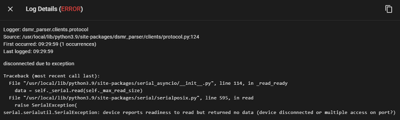

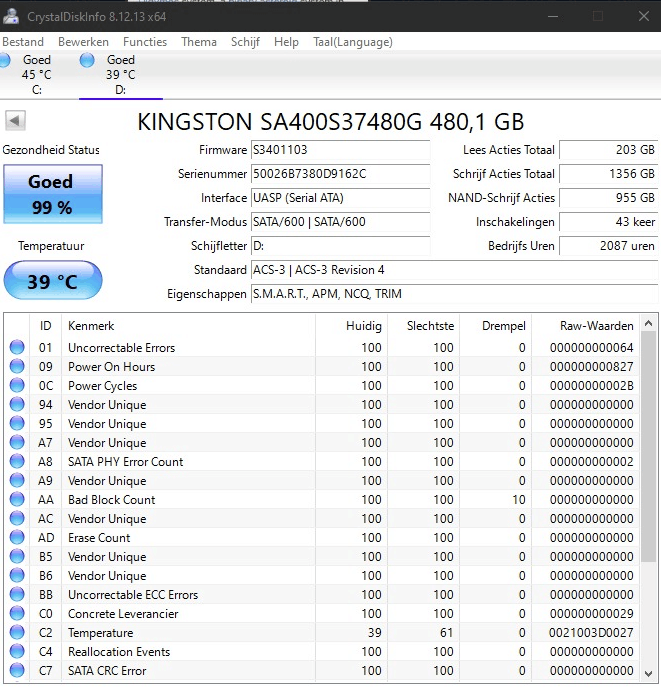

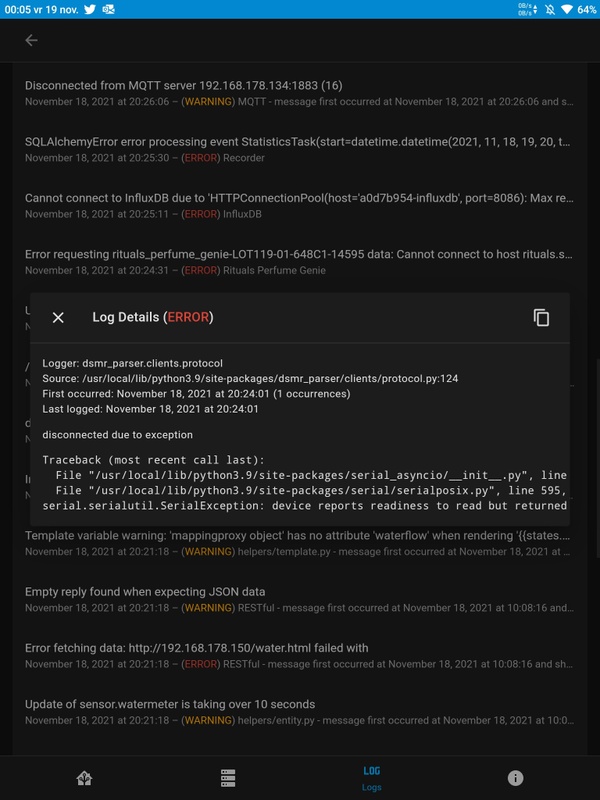

Hallo allen,
Ik lees al een tijdje mee, nou kom loop ik de laatste tijd er een beetje tegenaan dat mijn HA niet stabiel is en random volledig vastloopt, er lijkt ook niet direct een aanleiding te zijn (soms overdag, soms random midden in de nacht). Als ik er op tijd bij ben, kan ik nog de log zien, zie foto's hieronder, het vreemde is dat sommige functies van het dashboard nog steeds werken, maar het overgrote deel (Tuya, Zigbee, etc.) werkt niet en geef "unaivalable weer".
Het enige wat nog helpt is de stroom eraf, via de supervisor krijg ik hem dan ook niet gereboot / of de core herstart, allemaal vage errors. Zo ook als ik check config click, geeft hij de melding, config not found.
Wat ik al heb geprobeerd:
  • recorder verplaatsen naar MariaDB (de database was na +- 2 maanden 2Gb groot)
  • verschillende plugins en integrations uitgezet
  • Downgraden naar verschillende vorige supervisor edities
  • backups terugzetten van toen het nog wel stabiel was
  • Ik heb al de officiële stroomadapter (https://www.amazon.nl/gp/...tle_o02_s01?ie=UTF8&psc=1 maar heb nu een andere sterkere voeding eraan hangen (fingers crossed...)
Ik heb sterk het vermoeden dat het aan de SSD ligt, ik heb hem van de Pi afgehaald en via Windows met Crystal Disk Info gekeken, zie hieronder. Als jullie nog tips en/of tricks hebben hoe ik de SSD fatsoenlijk kan onderzoeken, hoor ik het graag!
Help is very much appreciated!!

Septillion schreef op vrijdag 26 november 2021 @ 15:02:
Tja, ik ben toch de enige die hierin werkt, ik schrijf mijn code niet voor GoT :p
Ah, daar had je het al eerder over. Maar het lijkt gewoon goed te werken.... Als ik hem open in het automations gebeuren geeft HASS het ook zo weer:
Afbeeldingslocatie: https://tweakers.net/i/J0ba6GSgeomtc5KdQ0cp5SPybPk=/full-fit-in/4000x4000/filters:no_upscale():fill(white):strip_exif()/f/image/7jw0FWqUmDsjNBILPvGkgRKU.png?f=user_large
Ik zou zeggen dat before_offset altijd impliceert dat de opgegeven tijd ervoor eraf gaat. Als je offset gebruikt, dan zou de tijd negatief aangegeven moeten worden.
Ja, die zit af en toe net buiten bereik. Hij zit om de hoek en ik heb een switch in de schuur als extra node om de carport te bereiken. Maar af en toe wil het toch niet, met twee keer schakelen lukt het meestal wel.
Klopt, maar ik stel ze in inderdaad dus daar let ik wel op.
  • TheFes
  • Laatst online: 09:22
breinonline schreef op vrijdag 26 november 2021 @ 15:50:
Die condition kijkt wanneer de zon op komt, telt daar 15 minuten bij op en kijkt vervolgens of de huidige tijd daar voor is.
Dus stel, zonsopkomst is om 7:00, dan geeft deze condition tot 7:15 "True" en daarna "False"

  • Septillion
  • Laatst online: 08:20
Dan nog, het maakt het voor jezelf ook een heel stuk leesbaarder als je daar iets zinnigs neer zet. Zeker als je er over een half jaar weer eens mee bezig gaat. Dan lees ik liever:
YAML:
            - condition: state
              state: 'on'
# Dan:
            - condition: state
              state: 'on'
Nee, dat is dus niet zo. De 'before' slaat dan ook niet op de offset. Het geeft aan dat het de offset is voor het 'before'-deel van de sun-conditie is.
YAML:
  - condition: sun
    before: sunset
    before_offset: '1:00'
    after: sunrise
    after_offset: '-1:00'
Is dus waar tussen 1 uur voor zonsopkomst tot 1 uur na zonsondergang.
Zie ook het plaatje uit de sun-condition
Afbeeldingslocatie: https://www.home-assistant.io/images/docs/scripts/sun-conditions.svg
Daar je trigger (sunrise - 0:15) altijd voor je conditie (sunrise + 0:15) valt zie je geen problemen. Maar zodra je 'input_datetime.patio_licht_aan_ochtend_2' dus nu na je trigger (sunrise - 0:15) komt te liggen maar voor je conditie (sunrise + 0:15) kan het dus zijn dat je het licht aan zet maar dat de trigger om hem in de ochtend uit te zetten al geweest is.
Zet je 'input_datetime.patio_licht_aan_ochtend_2' maar eens om 7:15 morgen, dan zal hij dan gewoon aan gaan. En daar zonsopgang om 7:16 is betekend dat je trigger voor uit om 7:01 geweest is (7:16 -0:15).
En ik zou dus zelfs wat extra marge houden. Morgen brandt je patio 2 verlichting welgeteld 1 minuut :+ Aan om 7:00, uit om 7:01 (7:16 zonsopgang - 0:15). Ik zou de conditie voor het aan dus nog 5 minuutjes voor de trigger voor uit zetten. Dan is het licht minimaal 5 minuten aan.

  • breinonline
  • Laatst online: 08:07
breinonline
Are you afraid to be known?
TheFes schreef op vrijdag 26 november 2021 @ 16:09:
Ah! :o
Septillion schreef op vrijdag 26 november 2021 @ 16:19:
YAML:
  - condition: sun
    before: sunset
    after: sunrise
Okee, ik ben nu toch bezig. Dan moet het volgens mij zo werken zoals bedacht:

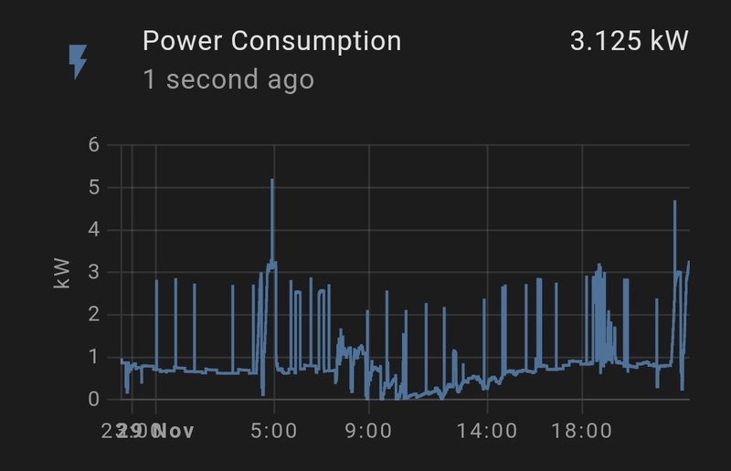

Vraagje over het uitlezen van de slimme meter dmv de P1 poort en een RPi4 icm home assistant. Heb e.e.a. werkend met een standaard P1 usb kabel direct in de RPi en de slimme meter integratie.
Echter heb ik last van pieken bij het uitlezen. Het lijkt er sterk op dat het geen piekwaardes in de meter zelf zijn maar echt fouten bij het uitlezen. De pieken zijn namelijk ontzettend kort en lijken constant qua hoogte bovenop het daadwerkelijke verbruik.
Heeft iemand dit wel eens gezien of heeft iemand dit probleem zelf ook (gehad)?
Afbeeldingslocatie: https://tweakers.net/i/HwZOdJbirqVHSQB50IjtPi-sLXo=/800x/filters:strip_icc():strip_exif()/f/image/Y9zxfc4IEZczWL5NgSUts2Ok.jpg?f=fotoalbum_large
  • M3rcury
M3rcury
Quick
Heb je een Quooker? Die geeft bij mij hetzelfde patroon.
No signature required.
  • CAP-Team
  • Laatst online: 23:40
CAP-Team
XBL: CAPTeam
heb ik ook. ik heb een keuken boiler.
Microsoft Surface Pro 6 | Samsung Galaxy S21FE | XBOX Series X
  • SgtCaffran
  • Laatst online: 25-09 23:50
M3rcury schreef op maandag 29 november 2021 @ 22:40:
Elke keer als ik een foutieve aanname doe zeg ik tegen mezelf dat ik geen aannames meer moet doen. :F
Wij hebben inderdaad een Quooker! Dat klinkt als een logische verklaring. Volgende stap is dus om deze waarde op te nemen in mijn echte database en er een average overheen te gooien. Bedankt! _/-\o_
  • tolunaygul12
Dat is inderdaad een boiler of een Quooker, hier hetzelfde gedrag op de 3EM meter.
Afbeeldingslocatie: https://tweakers.net/i/CbE9DjV3T1W8qVfrcM_YHtD3VU8=/100x75/filters:strip_icc():strip_exif()/f/image/qrLP6e0ARtPkWU5l3q4JCRUa.jpg?f=fotoalbum_small
Ondertussen heb ik maar het complete shelly gebeuren verwijderd en compleet opnieuw begonnen met alle devices toevoegen en instellen, was even een ochtend werk. Tot nu toe blijft alles goed..
1 device verlies af en toe de verbinding met HA. Kan het via de shelly app aanzetten. dan zie ik ook de status updaten in HA, maar vanuit HA aan/uit/dim werkt niet. Hetzelfde voor de rolluik is dezelfde kamer. Eens kijken wat ik daaraan kan doen. Wifi verbinding in deze kamer is uitstekend.
  • Septillion
Boiler, Quooker, ik zie ze ook bij mijn koelkast of espressomachine.
@SgtCaffran Weergeven in een custom:mini-graph-card?
