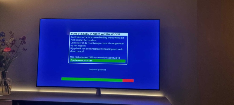

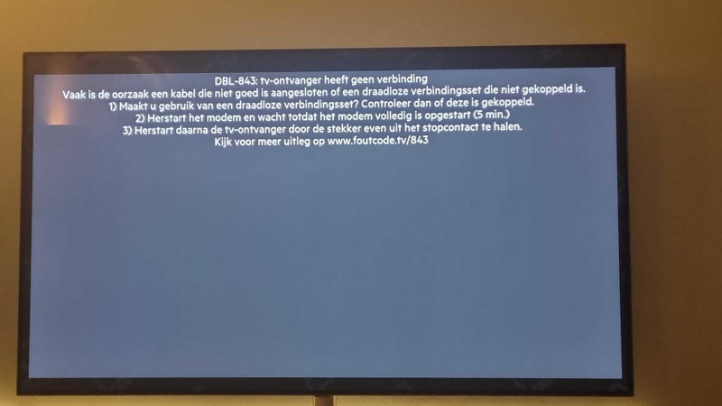

  • Tijntje
  • Laatst online: 27-11 13:40
Tijntje
Hello?!
Ik had enkel nog NPO 1, 2 en 3 en heb mijn 4K media box een reset gegeven echter blijft hij nu hangen in de initalisatie, krijg een Foutcode 563
Heb mijn Unifi netwerk ook al eens een herstart gegeven
admin@USG:~$ show interfaces
Codes: S - State, L - Link, u - Up, D - Down, A - Admin Down
Interface    IP Address                        S/L  Description
eth0         -                                 u/u  WAN
eth0.4       10.254.144.7/22                   u/u  IPTV
eth0.6       -                                 u/u
eth1         192.168.2.254/24                  u/u  LAN
             2a02:a468:b7f7:1:618:d6ff:fe83:a9ec/64
eth1.100     192.168.100.254/24                u/u
eth1.661     192.168.3.1/24                    u/u
eth2         -                                 A/D
lo           127.0.0.1/8                       u/u
             ::1/128
pppoe2       x.x.x.x                       u/u
admin@USG:~$ show ip route
Codes: K - kernel route, C - connected, S - static, R - RIP, O - OSPF,
       I - ISIS, B - BGP, > - selected route, * - FIB route
K>* 0.0.0.0/0 is directly connected, pppoe2
C>* 10.254.144.0/22 is directly connected, eth0.4
C>* 127.0.0.0/8 is directly connected, lo
C>* 192.168.2.0/24 is directly connected, eth1
C>* 192.168.3.0/24 is directly connected, eth1.661
C>* 192.168.100.0/24 is directly connected, eth1.100
C>* 195.190.228.75/32 is directly connected, pppoe2
K>* 213.75.112.0/21 via 10.254.144.1, eth0.4
admin@USG:~$ tail /var/log/kpn.log
[Sun Nov 13 19:33:30 CET 2022] [set-kpn-hook.sh] Executed at Sun Nov 13 19:33:30 CET 2022
[Sun Nov 13 19:33:30 CET 2022] [set-kpn-hook.sh] Configuration changes have been commited, adding crontab for kpn.sh
[Sun Nov 13 19:33:30 CET 2022] [kpn.sh] Connecting pppoe2 after changing MTU
Bringing interface pppoe2 up...
[Sun Nov 13 19:33:31 CET 2022] [kpn.sh] removing lock file at /config/scripts/post-config.d/kpn.lock
[Sun Nov 13 19:34:02 CET 2022] [kpn.sh] Executed at Sun Nov 13 19:34:02 CET 2022
[Sun Nov 13 19:34:02 CET 2022] [kpn.sh] creating lock file at /config/scripts/post-config.d/kpn.lock
[Sun Nov 13 19:34:02 CET 2022] [kpn.sh] KPN found in crontab, removing /etc/cron.d/kpn
[Sun Nov 13 19:34:02 CET 2022] [kpn.sh] removing lock file at /config/scripts/post-config.d/kpn.lock
[Sun Nov 13 19:34:02 CET 2022] [kpn.sh] Finished
admin@USG:~$
Iemand een idee? @Coolhva
EDIT:
Na een aantal herstarten en reprovisions nogsteeds niets:
24
25
26
27
28
29
30
31
32
33
34
35
36
37
38
39
40
41
42
43
44
eth0         -                                 u/u  WAN
eth0.4       10.214.172.95/22                  u/u  IPTV
eth0.6       -                                 u/u
eth2         -                                 A/D
lo           127.0.0.1/8                       u/u
             ::1/128
pppoe2       x.x.x.x                       u/u
C>* 10.214.172.0/22 is directly connected, eth0.4
K>* 213.75.112.0/21 via 10.214.172.1, eth0.4
[Sun Nov 13 21:39:49 CET 2022] [set-kpn-hook.sh] Executed at Sun Nov 13 21:39:49 CET 2022
[Sun Nov 13 21:39:49 CET 2022] [set-kpn-hook.sh] Configuration changes have been commited, adding crontab for kpn.sh
[Sun Nov 13 21:39:49 CET 2022] [kpn.sh] Connecting pppoe2 after changing MTU
[Sun Nov 13 21:39:49 CET 2022] [kpn.sh] removing lock file at /config/scripts/post-config.d/kpn.lock
[Sun Nov 13 21:40:02 CET 2022] [kpn.sh] Executed at Sun Nov 13 21:40:02 CET 2022
[Sun Nov 13 21:40:02 CET 2022] [kpn.sh] creating lock file at /config/scripts/post-config.d/kpn.lock
[Sun Nov 13 21:40:02 CET 2022] [kpn.sh] KPN found in crontab, removing /etc/cron.d/kpn
[Sun Nov 13 21:40:04 CET 2022] [kpn.sh] removing lock file at /config/scripts/post-config.d/kpn.lock
[Sun Nov 13 21:40:04 CET 2022] [kpn.sh] Finished
admin@USG:~$ show ip multicast interfaces
Intf             BytesIn        PktsIn      BytesOut       PktsOut            Local
eth1.661           0.00b             0         0.00b             0      192.168.3.1
eth1.100           0.00b             0         0.00b             0  192.168.100.254
eth0.4             0.00b             0         0.00b             0    10.214.172.95
pppoe2             0.00b             0         0.00b             0      x.x.x.x
[ Voor 35% gewijzigd door Tijntje op 13-11-2022 21:47 ]

garp schreef op zondag 13 november 2022 @ 11:17:
Nu merk ik dat ik op websites/apps die IPv6 doen, die filterende effecten weg zijn. Is het mogelijk om op de externe IPv6 verbinding eigen DNS servers te definieren, zodat mijn filters ook via IPv6 werken? In de GUI kan dat wel voor het IPv4 deel van de WAN verbinding, voor IPv6 is er geen entry.
Ik heb deze handleiding gevolgd om al het verkeer om te leiden naar mijn eigen dns server (pi-hole)
Enkel dns over https kan het bypassen maar regulier dns wordt allemaal afgevangen.
  • nero355
  • Laatst online: 21-10 18:32
nero355
ph34r my [WCG] Cows :P
nklaver234 schreef op zondag 13 november 2022 @ 22:07:
De oplossing die @garp echter zoekt is de config.json aanpassen met eigen IPv6 DNS Servers i.p.v. degenen die @Coolhva erin heeft gezet! ;)
EDIT:
24
25
26
27
28
29
30
31
32
33
34
35
36
37
38
39
40
41
42
43
44
eth0         -                                 u/u  WAN
eth0.6       -                                 u/u
eth2         -                                 A/D
lo           127.0.0.1/8                       u/u
             ::1/128
pppoe2       x.x.x.x                       u/u
Even mezelf quoten :)
Net geprobeerd met de orginele experia modem en dan werkt het wel weer en kan de software op de tv box worden gedownload en geïnstalleerd.
Krijg het alleen nog niet aan de praat op mijn USG.
Het heeft echt een jaar perfect gewerkt en er is verder niet veel aangepast behalve firmware updates van Unifi.
Als ik vanuit een werkende experia box live mij USG er weer tussen zet blijft TV werken als hij aan blijft staan.
Zodra ik de tv box uit zet blijft hij weer hangen tijdens het opstarten met dezelfde fout code
Voor de volledigheid dit is mijn config

Heb nog een andere VIP2952 staan, deze heeft hetzelfde gedrag als de 4k box, op dit moment laat hij enkel NPO 1, 2 en 3 zien. ALs ik hem uitzet start hij netjes op, maar heb ik enkel deze zenders weer.
Als ik hem een Factory Reset geef, start hij niet meer op en krijg ik een fout code 301
Beide TV boxen staan op het IPTV vlan

Dat vermoeden heb ik wel, ik kan nu op mijn 4k box wel weer tv kijken nadat ik hem via de Experia 1 keer aangesloten heb gehad en de software heb ingeladen.
Nu kan ik hem op de USG weer aansluiten en herstarten en het blijft werken
De oude 1080P VIP krijg ik met geen mogelijkheid meer aan de praat, die blijft hangen bij het opstarten ook als ik hem via de Experia aansluit

Ik heb PRECIES het zelfde probleem ineens! Ik had op NED1, 2 & 3 beeld en op de rest zwart. Nu na een herstart van de tv box krijgt ik error 563. Heb ook alles al geprobeerd maar niks lijkt meer te werken. Als je een oplossing weet dan hoor ik dat graag!! Die DHCP DNS Server setting had ik altijd al zo staan dat maakt in dit geval niks uit.

Wij zijn net terug van vakantie en ondanks dat het al jaren als een zonnetje draait achter een USG, hier ook hetzelfde probleem. Ned 1/2/3 werken, opnames werken, ook geen foutmeldingen verder, maar alle andere zenders zijn zwart. Dit gaat om reguliere, niet-4K-ontvangers. Coolhva config, geen apart VLAN.
Ga later eens e.e.a. proberen, maar het lijkt toch wat algemener te zijn dan misschien gedacht.
Update:
Gaat om 2x model Arris VIP 2952 v2. Via opstartmenu -> software verwijderen gekozen, zodat de software vers geïnstalleerd wordt. Via de USG niet in orde te krijgen, geeft dan error 301.
KPN-modem aangesloten, Arris hier direct op aangesloten, gaf in eerste instantie nog een error 309, maar ging na nog een herstart die het apparaat zelf deed wel goed updaten. Hierna stelde hij nog een update voor, die je evt. uit kon stellen, maar ook maar meteen gedaan. Alles werkt weer naar behoren nu.
Momenteel KPN-modem afgekoppeld en USG weer ingeprikt, Arris dus ook weer op eigen netwerk erbij. Tot nu toe werkt alles weer, de vraag is of dat permanent is, of dat een evt. volgende update weer problemen gaat geven.

  • kuwerti
  • Laatst online: 28-11 07:13
Een korte vraag voordat ik een heleboel artikelen ga lezen:
Ik heb al lange tijd probleemloos een USG4 pro draaien op KPN glasvezel met een ARRIS-VIP2952. Nu ga ik overstappen naar de ARRIS VIP5202 (4k). Moet ik hiervoor de configuratie in mijn USG4 aanpassen, of zou dit probleemloos moeten werken. (met andere woorden oude kastje eruit, nieuwe kastje erin)
Ik heb dus GEEN KPN-router ertussen zitten
[ Voor 5% gewijzigd door kuwerti op 21-11-2022 16:13 ]
  • VicSmurf
  • Laatst online: 27-11 11:14
kuwerti schreef op maandag 21 november 2022 @ 15:58:
Dat zou gewoon moeten werken, je hoeft de configuratie niet aan te passen. Wellicht dat je update problemen krijgt zoals wij gemeldt hebben.
  • Deef_K
  • Laatst online: 23:02
Vandaag is alles in werking gesteld door kpn en probeer ik de handleiding te volgen. Waar het al fout gaat:
Cloudkey
usr/lib/unifi/data/sites/default/
Ik heb geen sites/default. Deze heb ik zelf aangemaakt.
De locatie /config/scripts/post-config.d kan ik totaal niet vinden.
Ik kom nu geen stap verder. Hoe nu verder?
  • kuwerti
VicSmurf schreef op maandag 21 november 2022 @ 16:40:
zo te zien gaat de update goed.
zag de volgende meldingen langskomen:
  1. Downloaden van de software, moment geduld a.u.b. schakel de TV ontvanger niet uit (met een progress bar)
  2. Voorbereiden van de software moment geduld a.u.b. schakel de TV ontvanger niet uit
  3. Bijwerken van de software moment geduld a.u.b. schakel de TV ontvanger niet uit
  4. De software wordt opgestart, schakel de TV ontvanger niet uit
dus het downloaden en installatie van de software lijkt goed te gaan.
Afbeeldingslocatie: https://tweakers.net/i/XyAumRPYgZWOqOMAK5yJBTPBnqY=/800x/filters:strip_icc():strip_exif()/f/image/vzXez5hpQZx9BHtzurjF3Eu3.jpg?f=fotoalbum_large
echter na het opstarten van het tv-kastje krijg ik dit te zien:
Afbeeldingslocatie: https://tweakers.net/i/j9mpE6miM61b9U1f6Sp7I-XDK8w=/800x/filters:strip_icc():strip_exif()/f/image/QjGobY5XlHhtjwjuo9Oio5AL.jpg?f=fotoalbum_large
als ik zoek op de foutcode dan is dit
"Je tv-ontvanger heeft geen verbinding met je modem (Experia Box / KPN Box)" dat is logisch want deze box heb ik ook niet :-) :9
Iemand een idee hoe op te lossen? Ik zal hem morgen eerst eens even aan de experiabox hangen (zoals @Tijntje gedaan heeft) . Die experia ligt ergens in de kast weg te stoffen. kijken of dat gaat helpen :-)
[ Voor 26% gewijzigd door kuwerti op 21-11-2022 21:28 ]

ik heb de nieuwe 4k nu tijdelijk aangesloten op de KPN experiabox. I kwam nu veel verder (moest abbonummer en pincode invoeren om kastje te registreren' so far so good en ik kreeg zelfs beeld :-) maar, helaas. Toen ik de experiabox er weer tussenuit haalde en het via de USG4 pro liet lopen krijg ik deze melding:
Afbeeldingslocatie: https://tweakers.net/i/slpiZFmuzaSnDMoHj_9GvcXwsRo=/800x/filters:strip_icc():strip_exif()/f/image/zNzgQtFtYPyi7wHEwiiGv6f8.jpg?f=fotoalbum_large
uiteraard alles al een keer herstart, imgp-proxy herstart, usg4 herstart maar zonder resultaat. zie ik iets over het hoofd?
  • kuwerti
kuwerti schreef op dinsdag 22 november 2022 @ 19:33:
gefixed. een paar keer de lan kabel eruit en erin, herstarten en nu werkt het allemaal.

Deef_K schreef op woensdag 23 november 2022 @ 10:49:
Ok.
Ik heb alles gereset en opnieuw gedaan. De locatie /usr/lib/unifi/data/sites/default/ heb ik op de cloudkey aan moeten maken omdat deze niet bestond. In de laatste versie van de controller bestaat volgens mij geen floorplan meer zodat je deze kan aanmaken. https://www.vanachterberg...y-sides-folder/index.html Ik heb deze regels nog een keer via putty gedaan.
In deze map heb ik config.gateway.json geplaatst. Deze heeft de rechten 0644.
De kpn.sh heb ik op de USG geplaatst in /config/scripts/post-config.d met rechten 0755. Provision gedrukt. Box opnieuw opgestart en dan blijft die hangen. Opnieuw provisionen. Opnieuw opstarten. Blijft weer hangen op 85%. IGMP Snooping staat aan. VLAN heb ik niet toegepast.
Bij het controleren van de kpn log krijg ik onderstaande melding.
cat: can't open '/var/log/kpn.log': No such file or directory
Situatie
USG -> US-8-60W -> US-8 -> IPV TV kastje
Hier gaat het mis volgens mij : /usr/lib/unifi/data/sites/default/ moet je niet aanmaken, je moet de file uploaden naar /usr/lib/unifi/data/sites/JOUWSITENAAM/

  • garp
  • Laatst online: 28-11 13:34
Deef_K schreef op donderdag 24 november 2022 @ 19:49:
Ik heb geprobeerd een nieuwe netwerk aan te maken met de naam Thuisnetwerk maar deze vind ik niet terug op de cloudkey via ssh. Ik loop helemaal vast.
Je zegt netwerk, maar bedoelt site neem ik aan?
Nogmaals; je hebt een site-naam. In de voorbeelden heet die ‘default’, maar die heb jij dus niet. Je hebt een eigen site naam. En daar daar moet die json file in.
We kunnen wel ff een teams sessie doen, kijken we samen. PM me als je dat wilt.

Met behulp van @garp het tv kijken aan de praat gekregen. Bleek waarschijnlijk een update te zijn die via de experiabox binnen gehengeld moest worden.
Alleen opnames en terugkijken lukt niet. (STB-zap-03 / -40462 - Videoserver niet gevonden). Is hier een oplossing voor?
