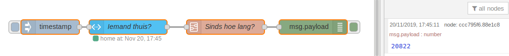

Wie weet wat ik hier fout doe?
Als er niemand thuis is & de tijd is tussen 9:30-10:00 & als de huidige status van de stofzuiger gedockt is,dan moet hij de zone onder de eet tafel stofzuigen.
Met een Inject node werkt het, maar niet automatisch, Afgelopen nacht waren we een nachtje weg, dan gebeurt er tussen 9:30-10:00 helemaal niks..
Nu zie je onder de "Iemand aanwezig?" node te staan 27 nov 16:07, maar gisteren als we vertrekken staat er dus not_home 26 nov xx:xx, zal het daar fout gaan? Want op het moment dat de status not_home word, is het niet tussen 09:30-10:00..dan gaat het zuig feest niet door.
Afbeeldingslocatie: https://i.imgur.com/5qTaBNn.png
[{"id":"5305ec00.bae284","type":"change","z":"41fe5df1.db00a4","name":"Onder tafel","rules":[{"t":"set","p":"payload","pt":"msg","to":"{\"command\":\"zoned_cleanup\",\"zone_ids\":[\"Onder de tafel\"]}","tot":"str"}],"action":"","property":"","from":"","to":"","reg":false,"x":855.0000610351562,"y":504.00004291534424,"wires":[["f4ae3cb5.de3a4"]]},{"id":"f4ae3cb5.de3a4","type":"mqtt out","z":"41fe5df1.db00a4","name":"","topic":"valetudo/rockrobo/custom_command","qos":"0","retain":"","broker":"e1d6f880.b26ee8","x":1011.0000228881836,"y":570.0000286102295,"wires":[]},{"id":"15c53732.7504a9","type":"api-current-state","z":"41fe5df1.db00a4","name":"Als stoffie docked is..","server":"1997c54b.5ff4fb","version":1,"outputs":2,"halt_if":"docked","halt_if_type":"str","halt_if_compare":"is","override_topic":false,"entity_id":"vacuum.rockrobo","state_type":"str","state_location":"payload","override_payload":"msg","entity_location":"data","override_data":"msg","blockInputOverrides":false,"x":627.6001129150391,"y":502.0000534057617,"wires":[["5305ec00.bae284"],[]]},{"id":"fe7a1867.23e898","type":"time-range-switch","z":"41fe5df1.db00a4","name":"Timerange 09:30 - 10:00","lat":"","lon":"","startTime":"09:30","endTime":"10:00","startOffset":0,"endOffset":0,"x":378.0000991821289,"y":516.3638677597046,"wires":[["15c53732.7504a9"],[]]},{"id":"8a360ff4.04ea8","type":"server-state-changed","z":"41fe5df1.db00a4","name":"Iemand aanwezig?","server":"1997c54b.5ff4fb","version":1,"entityidfilter":"group.aanwezigheid","entityidfiltertype":"exact","outputinitially":false,"state_type":"str","haltifstate":"home","halt_if_type":"str","halt_if_compare":"is","outputs":2,"output_only_on_state_change":true,"x":137.3636474609375,"y":524.0909633636475,"wires":[[],["fe7a1867.23e898"]]},{"id":"e1d6f880.b26ee8","type":"mqtt-broker","z":"","name":"","broker":"192.168.1.76","port":"1883","clientid":"","usetls":false,"compatmode":false,"keepalive":"60","cleansession":true,"birthTopic":"","birthQos":"0","birthPayload":"","closeTopic":"","closeQos":"0","closePayload":"","willTopic":"","willQos":"0","willPayload":""},{"id":"1997c54b.5ff4fb","type":"server","z":"","name":"Home Assistant","legacy":false,"hassio":false,"rejectUnauthorizedCerts":false,"ha_boolean":"y|yes|true|on|home|open","connectionDelay":true}]
[ Voor 5% gewijzigd door Dacuuu op 27-11-2019 19:00 ]

Dacuuu schreef op woensdag 27 november 2019 @ 18:57:
Volgens mij veranderd de status van een event state alleen op het moment dat je weg bent. Daarna niet meer. Als je de node poll state gebruikt kun je de interval instellen, bijvoorbeeld om de 5 minuten. Je moet alleen nog een timer inbouwen zodat hij niet direct weer start als hij week docked. Eventueel kun je ook de tijd waarin hij mag beginne korter zetten.
  • Dacuuu
  • Laatst online: 07-11 22:31
Robje1244 schreef op woensdag 27 november 2019 @ 20:01:
Vandaag probeer ik het met een extra globale variable, die dan elke nacht reset, zodat de stofzuiger maar 1x loopt.
  • Jurgen
  • Laatst online: 16-10 08:21
Ik los dit op door een inject node elk half uur tussen 9-17 te triggerren, met daarachter een voorwaarde of 'is stoffie al geweest' en 'iemand thuis'.
Zoals gezegd wordt jouw automation alleen getriggerd als de status van 'iemand thuis' veranderd. Dit gebeurt dus buiten de genoemde tijden.

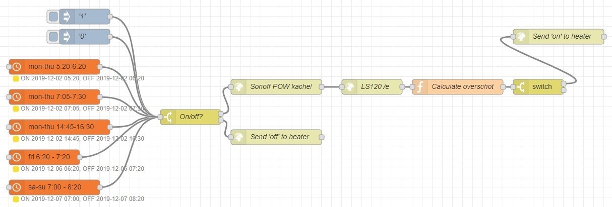

  • ThinkPad
  • Laatst online: 13:15
ThinkPad
"Stroom-overschot-affakkelaar"
Ik heb zonnepanelen en wek meer op dan ik verbruik. Hierdoor heb ik jaarlijks ~800 kWh overschot. Ik heb een elektrisch kacheltje neergezet om dit 'af te fakkelen'. Deze gaat aan één uur voordat het klokprogramma van de CV-ketel begint, om zo de CV-ketel mee te helpen en mijn gasverbruik te drukken. Node-RED schakelt via de schedex timer de kachel aan (hangt aan een Sonoff) voordat we beneden komen/voordat we thuiskomen (het is een ventilatorkachel dus die maakt wat herrie en zet ik daarom liever niet aan als we er zijn). Dit werkt prima, maar is niet heel veel meer dan een tijdschakelaar natuurlijk.
Heb het nu uitgebreid dat Node-RED de meterstanden van slimme meter opvraagt (via YouLess LS120 die aan P1-poort hangt) en dan zelf berekent wat ik nog aan overschot heb (ik heb hem de meterstanden van begin energiecontract gegeven zodat hij dit kan doen). Afhankelijk daarvan zet hij de kachel wel/niet aan zodat ik nooit buiten m'n overschot kan gaan gebruiken.
Is natuurlijk niet helemaal 100% accuraat, want m'n huishouden gebruikt natuurlijk ook stroom wat van het overschot afsnoept als er een paar dagen weinig opwek is. Het is dus meer een safeguard zodat de kachel niet onnodig stroom staat te verstoken, wat mij dan juist éxtra geld zou kosten :z
Afbeeldingslocatie: https://tweakers.net/ext/f/KTbvuc5ngqFktACwW11zuTeh/full.jpg
JSON:
[{"id":"5d3fc8dc.c7c078","type":"schedex","z":"c2c401d7.9a123","name":"mon-thu 5:20-6:20","suspended":false,"lat":"52.9940410","lon":"6.5140600","ontime":"5:20","ontopic":"","onpayload":"1","onoffset":0,"onrandomoffset":0,"offtime":"6:20","offtopic":"","offpayload":"0","offoffset":0,"offrandomoffset":0,"mon":true,"tue":true,"wed":true,"thu":true,"fri":false,"sat":false,"sun":false,"x":250,"y":120,"wires":[["3bcd9b54.e32e34"]]},{"id":"12dda4b1.9a721b","type":"http request","z":"c2c401d7.9a123","name":"Send 'on' to heater","method":"GET","ret":"obj","url":"http://192.168.6.33/cm?cmnd=Power1%20On","tls":"","x":1250,"y":60,"wires":[[]]},{"id":"3bcd9b54.e32e34","type":"switch","z":"c2c401d7.9a123","name":"On/off?","property":"payload","propertyType":"msg","rules":[{"t":"eq","v":"1","vt":"num"},{"t":"eq","v":"0","vt":"num"}],"checkall":"true","repair":false,"outputs":2,"x":520,"y":220,"wires":[["f7139ce2.8cdd7"],["9aaabf86.b30d4"]]},{"id":"9aaabf86.b30d4","type":"http request","z":"c2c401d7.9a123","name":"Send 'off' to heater","method":"GET","ret":"obj","url":"http://192.168.6.33/cm?cmnd=Power1%20Off","tls":"","x":690,"y":260,"wires":[[]]},{"id":"5e3dd5f5.1cfd5c","type":"schedex","z":"c2c401d7.9a123","name":"mon-thu 14:45-16:30","suspended":false,"lat":"52.9940410","lon":"6.5140600","ontime":"14:45","ontopic":"","onpayload":"1","onoffset":0,"onrandomoffset":0,"offtime":"16:30","offtopic":"","offpayload":"0","offoffset":0,"offrandomoffset":0,"mon":true,"tue":true,"wed":true,"thu":true,"fri":false,"sat":false,"sun":false,"x":260,"y":240,"wires":[["3bcd9b54.e32e34"]]},{"id":"cd5ee6b8.879d48","type":"schedex","z":"c2c401d7.9a123","name":"fri 6:20 - 7:20","suspended":false,"lat":"52.9940410","lon":"6.5140600","ontime":"6:20","ontopic":"","onpayload":"1","onoffset":0,"onrandomoffset":0,"offtime":"7:20","offtopic":"","offpayload":"0","offoffset":0,"offrandomoffset":0,"mon":false,"tue":false,"wed":false,"thu":false,"fri":true,"sat":false,"sun":false,"x":230,"y":300,"wires":[["3bcd9b54.e32e34"]]},{"id":"ddfe222f.fda43","type":"schedex","z":"c2c401d7.9a123","name":"sa-su 7:00 - 8:20","suspended":false,"lat":"52.9940410","lon":"6.5140600","ontime":"7:00","ontopic":"","onpayload":"1","onoffset":0,"onrandomoffset":0,"offtime":"8:20","offtopic":"","offpayload":"0","offoffset":0,"offrandomoffset":0,"mon":false,"tue":false,"wed":false,"thu":false,"fri":false,"sat":true,"sun":true,"x":250,"y":360,"wires":[["3bcd9b54.e32e34"]]},{"id":"f7139ce2.8cdd7","type":"http request","z":"c2c401d7.9a123","name":"Sonoff POW kachel","method":"GET","ret":"obj","url":"http://192.168.6.33/cm?cmnd=status%208","tls":"","x":690,"y":160,"wires":[["8bd6e834.f77ec8"]]},{"id":"660071ea.5819a","type":"inject","z":"c2c401d7.9a123","name":"'1'","topic":"","payload":"1","payloadType":"num","repeat":"","crontab":"","once":false,"onceDelay":0.1,"x":310,"y":20,"wires":[["3bcd9b54.e32e34"]]},{"id":"ef7e30c.5d70bd","type":"inject","z":"c2c401d7.9a123","name":"'0'","topic":"","payload":"0","payloadType":"num","repeat":"","crontab":"","once":false,"onceDelay":0.1,"x":310,"y":60,"wires":[["3bcd9b54.e32e34"]]},{"id":"74eef02.5885c1","type":"schedex","z":"c2c401d7.9a123","name":"mon-thu 7:05-7:30","suspended":false,"lat":"52.9940410","lon":"6.5140600","ontime":"7:05","ontopic":"","onpayload":"1","onoffset":0,"onrandomoffset":0,"offtime":"7:30","offtopic":"","offpayload":"0","offoffset":0,"offrandomoffset":0,"mon":true,"tue":true,"wed":true,"thu":true,"fri":false,"sat":false,"sun":false,"x":250,"y":180,"wires":[["3bcd9b54.e32e34"]]},{"id":"8bd6e834.f77ec8","type":"http request","z":"c2c401d7.9a123","name":"LS120 /e","method":"GET","ret":"obj","url":"http://192.168.6.28/e","tls":"","x":880,"y":160,"wires":[["cbcd76a2.4e5838"]]},{"id":"cbcd76a2.4e5838","type":"function","z":"c2c401d7.9a123","name":"Calculate overschot","func":"var p1start = 1407.477; // \"Import laagtarief\" op 1-11-2018\nvar p2start = 1013.068; // \"Import hoogtarief\" op 1-11-2018\n\nvar n1start = 1132.201; // \"Export laagtarief\" op 1-11-2018\nvar n2start = 2782.018; // \"Export hoogtarief\" op 1-11-2018\n\nvar p1verschil = msg.payload[0].p1 - p1start;\nvar p2verschil = msg.payload[0].p2 - p2start;\nvar n1verschil = msg.payload[0].n1 - n1start;\nvar n2verschil = msg.payload[0].n2 - n2start;\n\nvar p1import = p1verschil + p2verschil;\nvar p1export = n1verschil + n2verschil;\n\n//var overschot = p1export - p1import;\n\nif (p1export - p1import > 10) {\n\toverschot = Number(p1export - p1import)\n} else { var overschot = 0}\n\nmsg.payload = {\n    //p1verschil,\n    //p2verschil,\n    //n1verschil,\n    //n2verschil,\n    //p1import,\n    //p1export,\n    overschot\n};\n\nreturn msg;\n","outputs":1,"noerr":0,"x":1050,"y":160,"wires":[["b43b0946.ebff28"]]},{"id":"b43b0946.ebff28","type":"switch","z":"c2c401d7.9a123","name":"","property":"payload.overschot","propertyType":"msg","rules":[{"t":"gt","v":"0","vt":"num"},{"t":"eq","v":"0","vt":"num"}],"checkall":"true","repair":false,"outputs":2,"x":1210,"y":160,"wires":[["12dda4b1.9a721b"],[]]}]

ThinkPadd schreef op zondag 1 december 2019 @ 10:42:
Leuk bedacht. Combineer je het nog met een temperatuursensor in huis / maand van het jaar / weersverwachting? Je wil m.i. niet gaan verwarmen als het buiten 30 graden gaat worden ;)
  • ThinkPad
ThinkPad
DeadMetal schreef op maandag 2 december 2019 @ 12:30:
Niet nodig, de ventilatorkachel heeft zelf een thermostaat ingebouwd :)

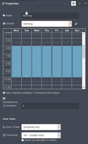

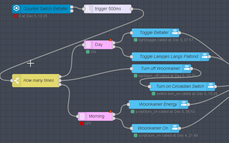

Vandaag begonnen met Node Red. Ik was altijd aan het stoeien met het goed krijgen van de automations in Home Assistant. Duurde me soms te lang voordat ik het voor elkaar had en NodeRed leek mee een goede om te proberen.
En dat is ook zo, ik heb al snel één van mijn moeilijkste automations in Node Red zitten en de automation uit kunnen zetten.
Maar ik zit met een klein ding. Via TheHookup ben ik op de Light Scheduler Node gewezen. En die doet inderdaad precies wat ik verwacht. Namelijk op basis van een schedule filteren welke lamp er aangezet wordt of welke scene.
Maar nu geeft NodeRed bij het deployen elke keer een foutmelding over deze Light Scheduler Node:
The workspace contains some nodes that are not properly configured:
[Wall Switch Eettafel] Morning (light-scheduler-filter)
[Wall Switch Eettafel] Day (light-scheduler-filter)
Are you sure you want to deploy?
Maar meer dan een "Invalid Properties: - Settings" wordt er niet gegeven. De ontwikkeleer heeft al 6 maanden helaas niets gedaan en recente issues worden niet op gereageerd.
Heeft iemand hier ervaring met deze Node en een oplossing hiervoor? Ik wil niet dat ik blind die melding wegklik als ik ga deployen. Er kan een echte fout tussen zitten.
Of heeft iemand een andere node die hetzelfde kan doen? Dus op basis van tijd het ene of het andere gaan schakelen op basis van een input?

  • Jelte
Hier een screenshot van de flow en van de instelling van de scheduler:
Afbeeldingslocatie: https://tweakers.net/ext/f/qN7gFKIm1ShKkf1YTGZrywT2/full.png
Afbeeldingslocatie: https://tweakers.net/ext/f/CxkS6ud6k2ZnJqNHMSVDFM2T/full.png
Dat visuele deel is leuk, maar mag zeker ook gewoon in tekst ingevuld worden. Het gaat om het filter gedeelte. Dat je binnen de schedule iets anders doet dan er buiten.
Maar ik merk dat niemand die node gebruikt ;) Ik heb nog een lijntje bij die vent van TheHookup uit staan, hij zou tegen hetzelfde aan moeten lopen lijkt me.
[ Voor 16% gewijzigd door Jelte op 05-12-2019 11:32 ]

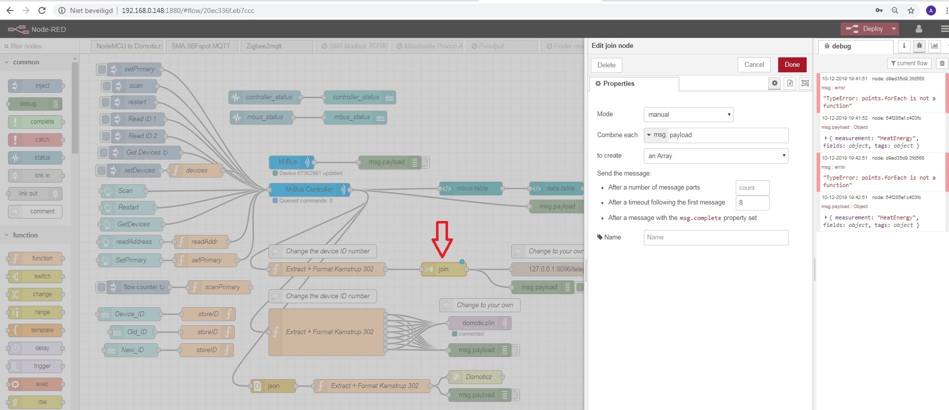

@MrBarBarian
Heb je iets aan dit voorbeeldje?
Is een functieblok voor dat het verzonden wordt.
24
25
26
27
28
29
30
31
32
let TotalHeatEnergy = msg.payload.devices["67362961"].DataRecord[1].Value;
let TotalCoolEnergy = msg.payload.devices["67362961"].DataRecord[2].Value;
let FlowTemperature = msg.payload.devices["67362961"].DataRecord[8].Value /100;
let ReturnTemperature = msg.payload.devices["67362961"].DataRecord[9].Value /100;
let DiffTemperature = msg.payload.devices["67362961"].DataRecord[10].Value /100;
let PowerInstValue = msg.payload.devices["67362961"].DataRecord[11].Value *100;
let FlowInstValue = msg.payload.devices["67362961"].DataRecord[13].Value;
let _msg = {
    payload: []
_msg.payload=
        measurement: "HeatEnergy",
        fields: {
            totalheatenergy:   TotalHeatEnergy,
            totalcoolenergy:   TotalCoolEnergy,
            flowtemperature:   FlowTemperature,
            returntemperature: ReturnTemperature,
            difftemperature:   DiffTemperature,
            power:             PowerInstValue,
            flow:              FlowInstValue,
        tags:{
            device: "Kamstrup",
        timestamp: flow.get('timestamp')
return _msg;
Excuus: deze "join" moet er wel tussen. Zie plaatje.
Afbeeldingslocatie: https://tweakers.net/ext/f/KnqbKYRnwF8PCqKoVxBBaRTP/thumb.jpg
[ Voor 8% gewijzigd door AUijtdehaag op 10-12-2019 19:45 ]
  • MrBarBarian
  • Laatst online: 07-03-2023
@AUijtdehaag Die join hielp idd ;) Tnx..

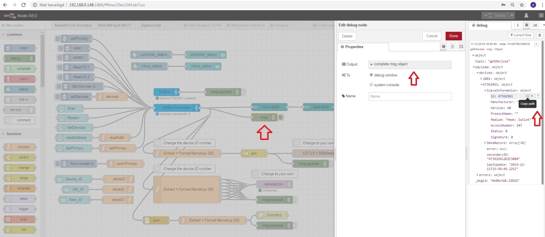

Nog een vraag: hoe kom je aan die deviceID's?
[ Voor 78% gewijzigd door MrBarBarian op 10-12-2019 22:16 ]
iRacing Profiel
  • AUijtdehaag
@MrBarBarian
Een "debug" erachter zetten en dan complete msg object, copy path of iets dergelijks?
Afbeeldingslocatie: https://tweakers.net/ext/f/zJMbdvPJfi8DcjGZKiztJh4Z/thumb.jpg

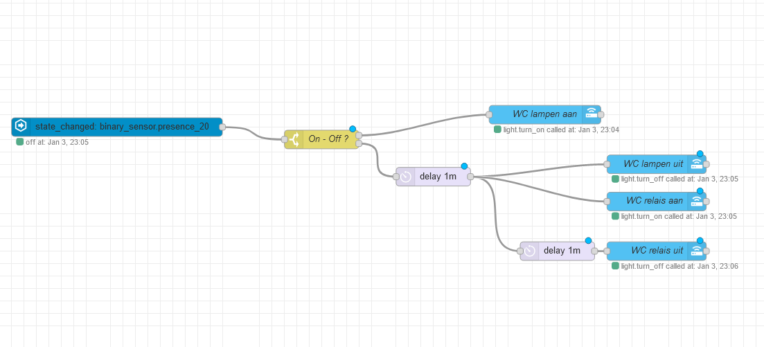

Goed ik heb nu best wat leuke dingen gemaakt met Node Red maar ik loop tegen een noob-ding aan denk ik...
Mijn situatie: deconz + home assistant en ik wil lampen met PIRs bedienen.
Op een "on" trigger gaat de lamp aan, op een "off"-trigger een timer en gaat de lamp uit. Alleen als ik in de tussentijd weer beweeg (waarom geldt dit vooral voor de WC) gaat het licht uit en weer aan... en gaat alsnog de blower loeien. Die blower hoort pas aan te gaan als ik al lang weg ben (irritant ding maar soms helaas noodzakelijk :+ ) .
ik heb nu dit staan:
Ik las oa deze post (DeadMetal in "Node-RED - grafisch 'programmeren' (bijv. voor domotica)") , dus ik zou nog een soort extra check kunnen maken om te kijken of de PIR nog aan is en dan een wachttijd en een soort lus schrijven. Maar volgens mij kan het mooier.
In concreto:
Dus na de 1e delay een check doen of de PIR nog uit is. Zo ja, doorgaan, zo nee weer naar de 1e delay.
Afbeeldingslocatie: https://tweakers.net/ext/f/1RrnlTuZNA4OgblRtC3lTNi0/medium.png
Kan dit beter?
Noot: ik realiseer me dat ik in plaats van 3 parallele dingen daar ook 1 serieel ding van kan maken. Yep dat is wellicht netter, zeker ihkv dat relais,
[ Voor 6% gewijzigd door Boudewijn op 03-01-2020 23:32 ]
  • DeadMetal
  • Laatst online: 04-11 08:43
DeadMetal
Ik zou m'n wc-licht zelf niet willen automatiseren, je bevindt je immers vlak naast de schakelaar, maar dat terzijde
@Boudewijn Je zou bij de 1e node nog 'on' bij de if-state kunnen toevoegen, dan kan die 2e node (on or off) weg. Verder zou je bijvoorbeeld nog met de 'wait until' node van HA kunnen werken, dan wacht hij met verder gaan totdat de sensor weer op 'off' gaat. Je kan dat combineren met een instelbare timeout waarde zodat de node een extra uitgang krijgt. Daar koppel je dan de acties aan als de sensor na X minuten nog steeds niet op off staat.
[ Voor 16% gewijzigd door DeadMetal op 07-01-2020 11:28 ]
  • Tsurany
Tsurany
Boudewijn schreef op vrijdag 3 januari 2020 @ 23:30:
Kan dit beter?
Ik zou het in twee flows verdelen:
- Trigger bij het detecteren van beweging die het licht aanzet en een timestamp in een variabele wegschrijft.
- Timer die elke X seconden kijkt of het licht aan is en zo ja hoe lang dit licht al aan staat. Is het te lang? Dan het licht uit zetten.
  • Dacuuu
In concreto:
Kan dit beter?
Ik gebruik de stoptimer node, dan kan je een timer stoppen, en als je hem inderdaad doorverbind gaat het voor jou ook werken.
Afbeeldingslocatie: https://i.imgur.com/OJZbIGs.png

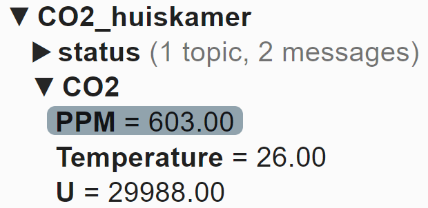

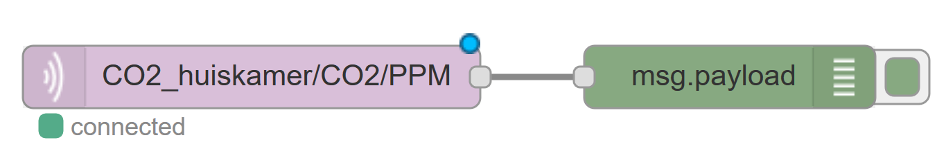

Paar maanden terug geprobeerd om wat processen van Domoticz naar Node Red te verplaatsen. Toen, gefrustreerd door de simpelste dingen die niet leken te lukken, (tijdelijk) opgegeven. Vandaag weer vol goede moed begonnen, maar wederom lukken de simpelste zaken niet. Ondanks dat het vrij basic is ga ik mijn vraag toch hier stellen, want ik wil wel eens verder geraken dan naar niet werkende flows kijken :)
Om met één probleem te beginnen: MQTT berichtjes die ik prima zie verschijnen in MQTT Explorer krijg ik tot nu toe niet te zien in NR.
Ik heb een aantal CO2-sensoren in huis die hun waardes via MQTT pushen. Bijvoorbeeld de sensor in de huiskamer:
Afbeeldingslocatie: https://tweakers.net/ext/f/c9KAokIOLrgygMhv9CpWhbFv/medium.png
In MQTT Explorer zie ik netjes alle waardes die geupdate worden.
Het gaat mij om de PPM, dus het topic wordt CO2_huiskamer/CO2/PPM (copy paste uit MQTT Explorer).
Afbeeldingslocatie: https://tweakers.net/ext/f/mvkxgStTLgy1yrh6eoB3pmZn/medium.png
In NR een simpele debugflow gemaakt. Ik deploy de flow en.. het debugscherm blijft leeg. Tegelijkertijd zie ik in MQTT Explorer dat er netjes waardes binnen blijven stromen van de sensor.
Ook als ik voor het topic nog een / plaats (zoals bijvoorbeeld gesuggereerd in deze guide) blijft het debugscherm leeg. Voor zover ik weet heb ik echt dezelfde stappen gevolgd als in die guide. Welke basic fout maak ik hier?

Ben ik ook wel benieuwd naar, ben eens tegen hetzelfde aangelopen nu ik je post zo lees. Maar verder nooit echt in verdiept, gebruik ook geen MQTT meer eigenlijk.

Gizz schreef op dinsdag 7 januari 2020 @ 16:27:
Ik test het nu ook even..hier gaat het prima? :? Probeer eens je debug output op complete msg te zetten, wat krijg je dan?

Gizz
Dunder-Mifflin, Inc.
Dacuuu schreef op dinsdag 7 januari 2020 @ 16:57:
Dank voor het meedenken. Ook op complete msg bleef de boel leeg.
Het goede nieuws is dat ik nu data ontvang nadat ik mijn MQTT broker heb herstart.. Blijf het vreemd vinden dat NR niets ontving want MQTT Explorer zag, zoals eerder gezegd, netjes alle berichten.
  • Boudewijn
Boudewijn
omdat het kan
DeadMetal schreef op dinsdag 7 januari 2020 @ 11:22:
Mja net niet dus. maar deze use-case geldt voor meer plekken. De plee is wel heel simpel (1 sensor) dus mooi voorbeeld.
Hmm ja dat is denk ik wel wat ik wilde. Morgen eens kijken of dat goed werkt, dank voor de tip.
Tsurany schreef op dinsdag 7 januari 2020 @ 12:26:
Wat is hier mooier aan dan aan die wait until waarbij je wacht tot de PIR weer uit is? dat lijkt me best wel charmant tbh.
Dacuuu schreef op dinsdag 7 januari 2020 @ 12:33:
Je hebt hier in feite een lusje gecreeerd dat 2x per minuut het volume van je tv wat zachter zet?
  • Dacuuu
Boudewijn schreef op dinsdag 7 januari 2020 @ 22:04:
Ja mijn voorbeeld is slechts een voorbeeld.
Maar je moet hem dus gewoon doorlussen.
  • Boudewijn
Boudewijn
omdat het kan
Dacuuu schreef op dinsdag 7 januari 2020 @ 22:11:
Check, duidelijk. Dank je wel!
