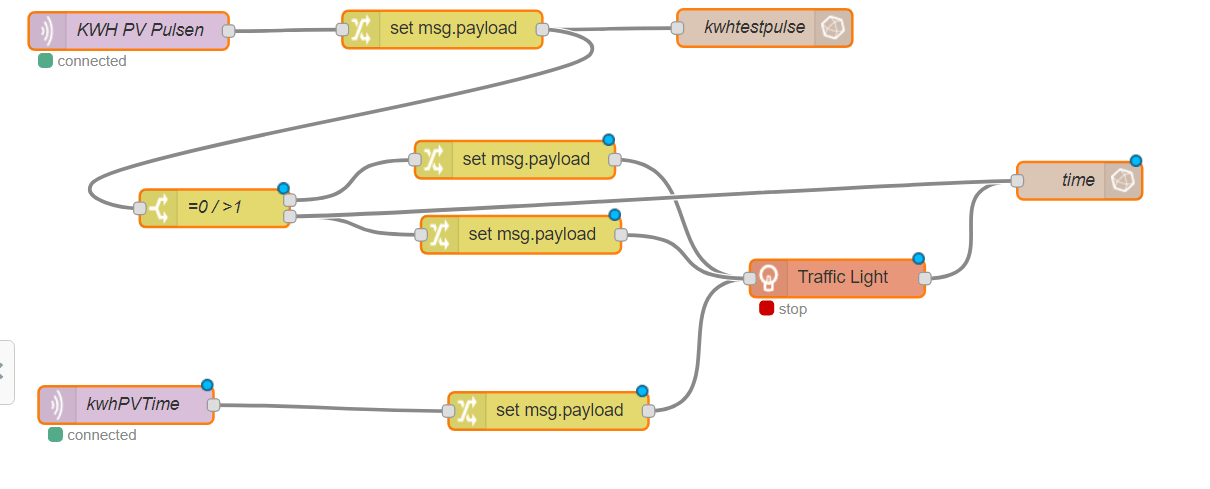

  • H143
  • Laatst online: 08:43
Aegle schreef op maandag 20 mei 2019 @ 13:44:
@H143: nee, nog niet. Wegens andere beslommeringen staat het momenteel ook even op een laag pitje...
ik heb het inmiddels voor elkaar mochten er de afgelopen minuut geen pulsen geweest zijn dan gaat hij dmv een flow automatisch naar 0w
Afbeeldingslocatie: https://tweakers.net/ext/f/huG5cTsxDJky9agVRl5LYLaK/thumb.png
ongetwijfeld kan dit een stuk netter voor mij werkt het in iedergeval. mocht iemand mij willen verbeteren graag :) daar kunnen we alleen maar wat van leren
[{"id":"72a736e2.ab0008","type":"mqtt in","z":"a2fb3f6e.317d","name":"KWH PV Pulsen","topic":"/ESP_Easy/PV/Count","qos":"2","datatype":"auto","broker":"8cdc16b6.c2b8c8","x":118.10000610351562,"y":132.0000286102295,"wires":[["f660d217.2082a"]]},{"id":"5bd69fba.71993","type":"influxdb out","z":"a2fb3f6e.317d","influxdb":"e3e8b0c3.4354c","name":"kwhtestpulse","measurement":"kwhPVcount","precision":"","retentionPolicy":"","x":627.1000595092773,"y":129.60005378723145,"wires":[]},{"id":"f660d217.2082a","type":"change","z":"a2fb3f6e.317d","name":"","rules":[{"t":"set","p":"payload","pt":"msg","to":"$number(payload)","tot":"jsonata"}],"action":"","property":"","from":"","to":"","reg":false,"x":369.1000518798828,"y":130.80002975463867,"wires":[["5bd69fba.71993","3d716806.1fe798"]]},{"id":"f969e6f6.259928","type":"mqtt in","z":"a2fb3f6e.317d","name":"kwhPVTime","topic":"/ESP_Easy/PV/Time","qos":"2","datatype":"auto","broker":"8cdc16b6.c2b8c8","x":116,"y":431.200008392334,"wires":[["4c3b0aeb.08e154"]]},{"id":"4c3b0aeb.08e154","type":"change","z":"a2fb3f6e.317d","name":"","rules":[{"t":"set","p":"payload","pt":"msg","to":"$number(payload)","tot":"jsonata"}],"action":"","property":"","from":"","to":"","reg":false,"x":454.0000305175781,"y":436.00000762939453,"wires":[["83095e2f.bee73"]]},{"id":"5568b1c1.1ea61","type":"influxdb out","z":"a2fb3f6e.317d","influxdb":"e3e8b0c3.4354c","name":"time","measurement":"kwhPVtime","precision":"","retentionPolicy":"","x":879.0000534057617,"y":251.80002975463867,"wires":[]},{"id":"83095e2f.bee73","type":"traffic","z":"a2fb3f6e.317d","name":"","property_allow":"payload","filter_allow":"aan","ignore_case_allow":false,"negate_allow":false,"send_allow":false,"property_stop":"payload","filter_stop":"uit","ignore_case_stop":false,"negate_stop":false,"send_stop":false,"default_start":false,"differ":false,"x":685.1000595092773,"y":330.00000762939453,"wires":[["5568b1c1.1ea61"]]},{"id":"6c016e5c.d683d","type":"change","z":"a2fb3f6e.317d","name":"","rules":[{"t":"set","p":"payload","pt":"msg","to":"uit","tot":"str"}],"action":"","property":"","from":"","to":"","reg":false,"x":432.0000305175781,"y":295.0000047683716,"wires":[["83095e2f.bee73"]]},{"id":"7f5165f4.75281c","type":"change","z":"a2fb3f6e.317d","name":"","rules":[{"t":"set","p":"payload","pt":"msg","to":"aan","tot":"str"}],"action":"","property":"","from":"","to":"","reg":false,"x":427.1666069030762,"y":234.99998092651367,"wires":[["83095e2f.bee73"]]},{"id":"3d716806.1fe798","type":"switch","z":"a2fb3f6e.317d","name":"=0 / >1","property":"payload","propertyType":"msg","rules":[{"t":"gte","v":"1","vt":"num"},{"t":"eq","v":"0","vt":"str"}],"checkall":"true","repair":false,"outputs":2,"x":187.00006484985352,"y":273.88877296447754,"wires":[["7f5165f4.75281c"],["6c016e5c.d683d","5568b1c1.1ea61"]],"outputLabels":["off",""]},{"id":"8cdc16b6.c2b8c8","type":"mqtt-broker","z":"","name":"Mosquitto","broker":"192.168.1.102","port":"1883","clientid":"nodered","usetls":false,"compatmode":false,"keepalive":"60","cleansession":true,"birthTopic":"","birthQos":"0","birthPayload":"","closeTopic":"","closeQos":"0","closePayload":"","willTopic":"","willQos":"0","willPayload":""},{"id":"e3e8b0c3.4354c","type":"influxdb","z":"","hostname":"192.168.1.102","port":"8086","protocol":"http","database":"test","name":"","usetls":false,"tls":""}]

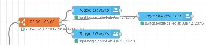

Amai seg!
Volgens mij probeer je dit te bereiken:
Afbeeldingslocatie: https://tweakers.net/ext/f/EhRitcei04QWnDqJEmEhgRbV/full.jpg
Zo heb ik het. De LR lights is hier een groep van lichten, en de kitchen LED strip is één licht :) De input komt van een Tradfri-knop.
Wat het doet: Mijn keuken-LED staat altijd aan als ik thuis ben. Overdag of 's avonds zet ik handmatig de lichten aan met de Tradfri-knop, die dan alleen de LR lights bedient. Ik ga altijd tussen 22:00 en 03:00 slapen. Als ik tussen 22:00 en 03:00 weer op de knop druk, dan schakelen alle lampen bij mij thuis uit, volgens mij is dat ongeveer wat je wil. Ik gebruik hier de 'time range node' voor.

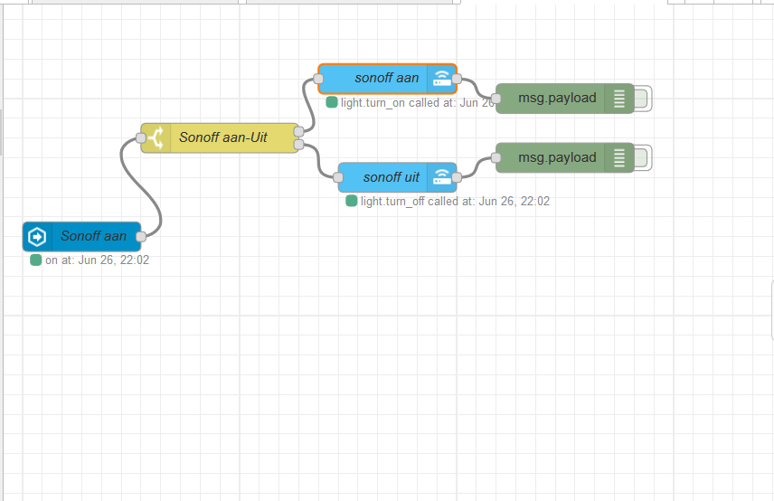

goedeavond, nieuw op dit forum, pas kort overgestapt van Domoticz naar HA. en zag de Node red wat lijkt op blocky.
Net een lamp met een motion sensor in de kast met N.R. aan de praat gekregen.
Ben nu bezig om de sonoffs (4 stuks) gelijk met de ikea lampen uit en aan te laten gaan.
Dit is het schema wat volgens mij zou moeten werken?
Afbeeldingslocatie: https://tweakers.net/ext/f/XnSSTOCoezAvtMDqkSgkJA40/thumb.png
Ron
  • DeadMetal
  • Laatst online: 04-11 08:43
DeadMetal
Welkom! Ja zoiets kan je doen. Ik begrijp je code niet helemaal, het lijkt nu alsof je een Sonoff wilt aandoen als er een Sonoff is aangegaan, ik zou dan Ikea ergens verwachten. Maar jij kent jouw setup het beste.
Die gele switch node kan je tegenwoordig weglaten. Bij de 1e node zou je 'on' kunnen invullen bij de 'if-state'. Dan komt er vervolgens een 2e output bij aan die node, die geldt dan voor 'off' (of eigenlijk: alles wat niet 'on' is).

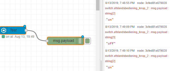

  • Bman59
  • Laatst online: 21:53
Korte vraag mbt node-red.
Ik ben al mijn automations aan het overzetten naar Node Red, en tot heden gaat dit aardig.
Nu heb ik een automation, die reageert op een fire_event, of button press (trigger). Dit is een RFXCom 443 apparaat
Nu weet ik niet welke node ik moet gebruiken, om zo'n event af te vangen. Kan iemand mij in de juiste richting helpen?
Alvast bedankt.

  • Bman59
Kaspers schreef op dinsdag 13 augustus 2019 @ 18:50:
Waar vanaf ben je ze aan het overzetten? Mocht dat home-assistant zijn, dan zou de makkelijkste optie zijn om de entities daar in laten staan, om vervolgens in NR de trigger via de 'stage-changed' node te laten verlopen.
Ze komen inderdaad uit Hassio. De entiti id's laat ik daar ook lekker staan.
Zojuist even een state_change node aangemaakt, entitiy id er in gezet, en de debug meld wel een on als de schakelaar initeel op off staat. Druk ik dan nog maals op on; dan registreert node-red deze niet.
Hassio node red
Zie hier op het screenshot; van on naar of en terug gaat, maar als ik 10x op de "on" knop druk krijg ik geen output.
  • Kaspers
  • Laatst online: 06-11 14:13
Bman59 schreef op dinsdag 13 augustus 2019 @ 19:53:
Dat kun je oplossen door dit vinkje even weg te halen:
Afbeeldingslocatie: https://i.imgur.com/N91pPHO.png
  • Snuffel
Snuffel
Vroem!
Ik zou het volgende willen doen in mijn huis, maar heb geen idee of dit mogelijk is of niet.
Mijn lampen wil ik aan/uit laten gaan op bepaalde tijdstippen, geen probleem, dat heb ik voor elkaar.
Echter wil ik na uitschakelen van de verlichting beneden dat deze alleen aangaat op het moment dat er iemand beneden komt. En dat deze niet triggert op het heen en weer lopen van de katten.
Is dat mogelijk? En zo ja: hoe?
heb ik dan een bewegingsmelder nodig die alleen maar werkt tussen bepaalde tijdstippen? En is dat te regelen in NodeRed?
Of moet ik werken met bijvoorbeeld een deursensor die alleen werkt tussen bepaalde tijdstippen?
Dus twee vragen: wat is de makkelijkste/beste oplossing en kan je apparatuur in NodeRed zodanig inregelen dat ze alleen tussen bepaalde tijdstippen werkzaam zijn?

  • DeadMetal
DeadMetal
Snuffel schreef op donderdag 15 augustus 2019 @ 10:14:
Je kan de time-range-switch module gebruiken. Daarin kan je vaste begin en eindtijdstippen configureren. Enkel daarbinnen wordt een bericht doorgelaten. Je kan de tijdstippen ook baseren op zonsopgang of -ondergang. Zo laat ik de lamp in mijn hal automatisch aangaan als de voordeur open gaat (deursensor), maar enkel als het buiten donker is.
[ Voor 35% gewijzigd door DeadMetal op 18-08-2019 08:36 ]

  • Bman59
Kaspers schreef op woensdag 14 augustus 2019 @ 21:59:
Helaas werkt het uitvinken van de optie niet.
Ik probeer dus zoiets te maken in node-red;
YAML:
- alias: voordeurbel_melding
  trigger:
      - platform: event
        event_type: button_pressed
        event_data: {"entity_id": "switch.afstandsbediening_knop_2"}
  • DeadMetal

Weet iemand wat hier misgaat? Ik heb twee varianten om hetzelfde te bereiken en die werken allebei niet goed.
1) Als ik deze manier gebruik worden waardes van 0 en van groter dan 1 goed opgeslagen in de influxdb. Bij waardes tussen 0 en 1 gaat het mis: 0.430 wordt opgeslagen als 430 en veroorzaakt daardoor direct een flinke spike. Het lijkt alsof de waarde in dat geval als .430 overgezet wordt en ergens bij een string naar decimal omzetting er dan maar het beste van gemaakt wordt. Ik heb nog geprobeerd het met 1,00 te vermenigvuldigen om een decimal te forceren maar dat maakte geen verschil.
Afbeeldingslocatie: https://i.imgur.com/ssTGSRX.png
2) Als alternatief wilde ik dan maar deze waardes handmatig op 0 zetten. Resultaat: alles werd op 0 gezet.
Afbeeldingslocatie: https://i.imgur.com/lQoxTIN.png
Wat zou ik het beste kunnen doen?
  • Plofke
  • Laatst online: 19-10-2023
Vraagje: is deze sonoff: SONOFF BASICR3 - WIFI DIY Smart Switch "standaard" klaar om samen te werken met domoticz? Of zal er ook geflashed moeten worden?
Hij ondersteunt IFTT wat houdt dat dan in? Wat maakt deze specialer zeg maar?
Yucon schreef op vrijdag 6 september 2019 @ 16:23:
Dit al geprobeerd?
parsefloat(msg.payload.Power.value)
  • Yucon
  • Laatst online: 07-11 13:21
Yucon
*broem*
Verwijderd schreef op vrijdag 6 september 2019 @ 18:53:
Dit al geprobeerd?
Dit leek me het ei van Columbus. Maar het werkte niet..
Toen ik nog eens beter keek bleek dit de oorzaak:
Afbeeldingslocatie: https://i.imgur.com/Dp0p0ym.png
Onder de 1 kW verandert de eenheid en geeft de API ineens het vermogen in watt terug. 8)7
