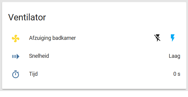

Voor diegene die homeassistant gebruiken en mijn ESP_EASY plugin. :)F
ITHO FAN Homeassistant
Hieronder de home assistant config scripts:
24
25
26
27
28
29
30
31
32
33
34
35
36
37
38
39
40
41
42
43
sensor:
  - platform: mqtt
    state_topic: "/ESP_Easy/Fan/Timer"
    value_template: "{{value}}"
    unit_of_measurement: 's'
  - platform: mqtt
    state_topic: "/ESP_Easy/Fan/State"
    value_template: >
      {% if value|float==0 %}Standby{% endif %}
      {% if value|float==1 %}Laag{% endif %}
      {% if value|float==2 %}Medium{% endif %}
      {% if value|float==3 %}Hoog{% endif %}
      {% if value|float==4 %}Full{% endif %}
      {% if value|float>=11 %}Hoog(T){% endif %}
fan:
  - platform: mqtt
    command_topic: "/ESP_Easy/Fan/cmd"
    state_topic : "/ESP_Easy/Fan/State"
    speed_command_topic: "/ESP_Easy/Fan/cmd"
    speed_state_topic: "/ESP_Easy/Fan/State"
    state_value_template: "{% if value|float==0 %}State 0{% endif %}{% if value|float >0 %}State 1{% endif %}"
    speed_value_template: "{% if value|float==0 %}State 0{% endif %}{% if value|float >0 and value|float <=4 %}State {{value}}{% endif %}{% if value|float >=11 %}State 3{% endif %}"
    payload_on: "State 1"
    payload_off: "State 0"
    payload_low_speed: "State 1"
    payload_medium_speed: "State 2"
    payload_high_speed: "State 3"
    optimistic: "true"
    speeds:
      - low
      - medium
      - high
group:
  Ventilator:
    entities:
      - fan.afzuiging_badkamer
      - sensor.Snelheid
      - sensor.Tijd
customize.yaml
   sensor.tijd:
      icon: mdi:timer
   sensor.snelheid:
      icon: mdi:transfer

  • jodur
  • Laatst online: 16-11 10:00
Heb in de ESP_EASY plugin de variabele LastIDindex geimplementeerd: :)F https://github.com/jodur/ESPEASY_Plugin_ITHO/tree/LastIdIndex
LET OP is een andere branch, je kan ook nog het orgineel pakken!
MQTT topic: /ESP_Easy/<task name>/LastIDindex
Payload values:
0=> laatste commando is verstuurd door ESP_EASY (via de C1101 natuurlijk)
1=> laatste commando is verstuurd door device met ID1 (zoals ingesteld bij device settings)
2=> laatste commando is verstuurd door device met ID2 (zoals ingesteld bij device settings)
3=> laatste commando is verstuurd door device met ID3 (zoals ingesteld bij device settings)
Komt dan een extra sensor bij (zie voorgaande post)
Homeassistant config voorbeeld:
- platform: mqtt
    name : Laatste bediening
    state_topic: "/ESP_Easy/Fan/LastIDindex"
    value_template: >
      {% if value|float==0 %}Hass{% endif %}
      {% if value|float==1 %}Badkamer{% endif %}
      {% if value|float==2 %}Keuken{% endif %}
      {% if value|float==3 %}WC{% endif %}
