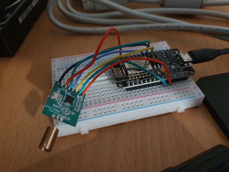

Kan iemand mij op weg helpen? Ik probeer de itho (cve eco rft) met esphome werkend te krijgen.
ik probeer dit met
https://github.com/Scriptman/ESPHome_ITHO_Eco_Fan_CC1101
of 1 van de 4 forks. Echter bij het compilen krijg ik de onderstaande error.
ik doe dit met python (geen add-on door hass docker)
24
25
26
27
28
29
30
31
32
33
34
35
36
37
38
39
40
41
42
43
44
45
46
47
48
49
50
51
52
53
54
Generating LD script .pioenvs/itho_eco_fan/ld/local.eagle.app.v6.common.ld
Compiling .pioenvs/itho_eco_fan/lib4d9/ESP8266WiFi/BearSSLHelpers.cpp.o
Compiling .pioenvs/itho_eco_fan/lib4d9/ESP8266WiFi/CertStoreBearSSL.cpp.o
ithorvlo.yml: In lambda function:
ithorvlo.yml:45:33: error: expected type-specifier before 'FanSendStandby'
ithorvlo.yml:47:29: error: could not convert '{fansendstandby}' from '<brace-enclosed initializer list>' to 'std::vector<esphome::switch_::Switch*>'
ithorvlo.yml:55:29: error: expected type-specifier before 'FanSendLow'
ithorvlo.yml:57:25: error: could not convert '{fansendlow}' from '<brace-enclosed initializer list>' to 'std::vector<esphome::switch_::Switch*>'
ithorvlo.yml:65:32: error: expected type-specifier before 'FanSendMedium'
ithorvlo.yml:67:28: error: could not convert '{fansendmedium}' from '<brace-enclosed initializer list>' to 'std::vector<esphome::switch_::Switch*>'
ithorvlo.yml:75:30: error: expected type-specifier before 'FanSendHigh'
ithorvlo.yml:77:26: error: could not convert '{fansendhigh}' from '<brace-enclosed initializer list>' to 'std::vector<esphome::switch_::Switch*>'
ithorvlo.yml:85:28: error: expected type-specifier before 'FanSendIthoTimer1'
ithorvlo.yml:87:24: error: could not convert '{fansendt1}' from '<brace-enclosed initializer list>' to 'std::vector<esphome::switch_::Switch*>'
ithorvlo.yml:93:28: error: expected type-specifier before 'FanSendIthoTimer2'
ithorvlo.yml:95:24: error: could not convert '{fansendt2}' from '<brace-enclosed initializer list>' to 'std::vector<esphome::switch_::Switch*>'
ithorvlo.yml:101:28: error: expected type-specifier before 'FanSendIthoTimer3'
ithorvlo.yml:103:24: error: could not convert '{fansendt3}' from '<brace-enclosed initializer list>' to 'std::vector<esphome::switch_::Switch*>'
ithorvlo.yml:109:30: error: expected type-specifier before 'FanSendIthoJoin'
ithorvlo.yml:111:26: error: could not convert '{fansendjoin}' from '<brace-enclosed initializer list>' to 'std::vector<esphome::switch_::Switch*>'
ithorvlo.yml:118:26: error: expected type-specifier before 'FanRecv'
ithorvlo.yml:120:66: error: could not convert '{<expression error>, <expression error>, <expression error>}' from '<brace-enclosed initializer list>' to 'std::vector<esphome::text_sensor::TextSensor*>'
ithorvlo.yml:14:7: error: 'Idlist' was not declared in this scope
ithorvlo.yml:17:7: error: 'Mydeviceid' was not declared in this scope
Compiling .pioenvs/itho_eco_fan/lib4d9/ESP8266WiFi/ESP8266WiFi.cpp.o
ithorvlo.yml:48:3: warning: control reaches end of non-void function [-Wreturn-type]
ithorvlo.yml:58:3: warning: control reaches end of non-void function [-Wreturn-type]
ithorvlo.yml:68:3: warning: control reaches end of non-void function [-Wreturn-type]
ithorvlo.yml:78:3: warning: control reaches end of non-void function [-Wreturn-type]
ithorvlo.yml:88:3: warning: control reaches end of non-void function [-Wreturn-type]
ithorvlo.yml:96:3: warning: control reaches end of non-void function [-Wreturn-type]
ithorvlo.yml:104:3: warning: control reaches end of non-void function [-Wreturn-type]
ithorvlo.yml:112:3: warning: control reaches end of non-void function [-Wreturn-type]
ithorvlo.yml:121:3: warning: control reaches end of non-void function [-Wreturn-type]
*** [.pioenvs/itho_eco_fan/src/main.cpp.o] Error 1

Hoi Tweakers,
Ik heb dit topic behoorlijk doorgespit maar het ontbreekt mij aan kennis om de juiste info te filteren.
Ik heb een ESP32 met een nRF905 geknutseld en de code van eelcohn gebruikt welke primair voor Zender/BUVA is.
Er is echter ook een manual optie waarbij de volgende parameters moeten worden geset:
  • Frequency
  • Transmit power
  • Receive power
  • Auto-retransmit
  • Transmit address width
  • Receive address width
  • Transmit payload width
  • Receive payload width
  • Receive address
  • Output clock frequency
  • Output clock enabled
  • Xtal clock frequency
  • CRC enabled
  • CRC mode
Een enkele kan ik vinden maar niet allemaal.
Heeft iemand ervaring met de api van eelcohn, of een advies voor firmware om mijn configuratie te laten werken?
Hoor het graag. Alvast dank.
Grtn,
Kees

Niet lullig bedoelt maar dit topic gaat over het aansturen van de itho cve's niet over de buva units. Die zijn qua aansturing en protocol echt anders.
Ik zou je adviseren om bij Eelco op de github pagina een issue aan te maken, ik geloof dat hij het een beetje druk heeft met wat projectjes maar wie weet kan hij je snel verder helpen.

Yep denk het wel. Volgens mij heeft Eelco de RF communicatie van de buva opgepikt, deze gedecodeerd en naar software omgezet naar iets wat met een ESP8266 en RF module te gebruiken is.
Dit is specifiek voor de buva te gebruiken, niet voor de itho helaas. Daar heb je de libs voor nodig die ook hier besproken worden.

Dank je wel Arjen! Dan ga ik een C1101 module zoeken.
Adviseer je ook gelijk een ESP8266 of kan ik de ESP32 blijven gebruiken?
  • arjenhiemstra

Ik gebruik voor de meeste projecten nu een esp32, sneller, meer geheugen, meer pinnen voor een lagere prijs.

Sorry voor mijn (wellicht) domme vraag, maar zijn de connecties op de pins voor de esp32 gelijk aan die voor de esp8266? Zo lijkt het wel namelijk. Alvast dank.
  • arjenhiemstra
  • Laatst online: 22:43
Kees de kapper schreef op woensdag 27 oktober 2021 @ 22:16:
Nee, de esp32 heeft meer pinnen dan de esp8266
  • Kees de kapper
  • Laatst online: 22-02 17:19
arjenhiemstra schreef op donderdag 28 oktober 2021 @ 00:24:
De GPIO nummering voor de esp826 kan ik dan ook niet gebruiken voor de esp32. MOSI en MISO hebben namelijk wel dezelfde GPIO. Indien de aansluitingen anders zijn, is er dan een schema beschikbaar?
Dank nogmaals.
CC11xx pinsESP8266 pinsESP32 PinsESP32 PinsArduino pinsDescription
VCC VCC 3V3 R1 VCC 3v3
GND GND GND R2 GND Ground
MOSI 13=D7 GPIO 13 (HSPI_MOSI) L3 Pin 11 Data input to CC11xx
SCK 14=D5 GPIO 14 (HSPI_CLK) / GPIO 18 (SPI_CLK) L5 / R9 Pin 13 Clock pin
MISO/GDO1 12=D6 GPIO 12 (HSPI_MISO) L4 Pin 12 Data output from CC11xx / serial clock from CC11xx
GDO2 04=D2 GPIO 04 R5 Pin 2 Programmable output
GDO0 ? Pin ? Programmable output
CSN 15=D8 GPIO 15 (HSPI_CS0) / GPIO 5 (SPI_CS0) / Pin 10 Chip select / (SPI_SS)

Gisteren interessant issue met mijn setup (Wemos D1 Mini, met CC1101), met HomeAssistant en Apple HomeKit verbonden. Diverse automations, prima. Werkte uitstekend zonder onderbreking sinds begin van het jaar.
Omdat het bordje en de CC1101 los hing en zonder redelijke bescherming naast mijn CV hing, wilde ik het netjes wegwerken in een plastic doosje. Waarschijnlijk door stralingsinterferentie (?) kwam de Wemos D1 mini niet meer op, geen verbinding meer via WiFi. Opnieuw flashen dan maar, maar ook dat werkte helaas niet meer, mogelijk toch hardware defect?
Mu een nieuwe NodeMCU geflasht en toen ik weer probeerde het bordje en de CC1101 bij elkaar te stoppen ging het weer mis. Na opnieuw flashen en instellen werkt ie wel weer. Echter met 1 probleem dat mijn remote die in de badkamer hangt niet meer wordt uitgelezen door ESPEasy. Het Device-ID wordt dus niet herkend, en in de log (bij web log level = debug-modus) komt het Device ID niet in beeld.
Nu is dat niet heel erg, maar HomeAssistant en Homekit kan nu niet de actuele stand meer zien. Iemand een idee of dat te maken heeft met het aantal keren verbinden? Of wat hieraan gedaan kan worden?
[ Voor 4% gewijzigd door dafo op 28-11-2021 14:02 . Reden: Kleine aanvulling ]
  • Sten Vollebregt
  • Laatst online: 16:27
Sten Vollebregt
Zie je wel andere Device IDs langs komen? Zo niet check dan of de interrupt pin wel goed is aangesloten en ingesteld. Als dit op een I2C pin zit dan moet je deze bus wel uitzetten in ESPEasy.
My case has so many fans that it hovers above the ground
  • dafo
  • Laatst online: 01-09 10:09
Sten Vollebregt schreef op zondag 28 november 2021 @ 14:23:
Ik zie geen andere Device ID's binnenkomen inderdaad. De GD02 Interrupt pin zit bij mij op D3, maar daar staat een 'gevaren driehoekje' bij. Hoe kan ik bepalen of dit een I2C pin is en hoe kan ik deze uitzetten? Sorry, ik ben een leek op dit terrein.
Afbeeldingslocatie: https://tweakers.net/i/yc0dXiVru7n6L9i54KzwVzgcBKs=/full-fit-in/4000x4000/filters:no_upscale():fill(white):strip_exif()/f/image/qVCoJhyj0Gx3V7QJ28sTUfrU.png?f=user_large
[ Voor 14% gewijzigd door dafo op 28-11-2021 14:48 ]
  • Sten Vollebregt
Sten Vollebregt
Alles met een driehoek wil je vermijden. GPIO-0 wordt bijvoorbeeld gebruikt tijdens boot en heeft een pull-up weerstand waardoor hij niet altijd goed werkt als input (https://randomnerdtutoria...6-pinout-reference-gpios/).
  • Praetorian
  • Laatst online: 29-10 13:12
Met andere woorden, de enige die je als interupt kunt gebruiken is dus D0.
Op zich had ik hetzelfde met plugin 145 i.c.m. met een nodeMCU, vond het vaag om te zien dat de bijna overal voorgestelde D1 pin ook niet gebruikt kon worden.
De interupt zorgt ervoor dat geluisterd gaat worden naar berichten, de interupt is als het ware een aankondiging van bericht.
[ Voor 26% gewijzigd door Praetorian op 06-12-2021 21:48 ]
  • Sten Vollebregt
Sten Vollebregt
Praetorian schreef op maandag 6 december 2021 @ 21:47:
Nee, GPIO-16 van de ESP ondersteund als enige geen interrupts. In principe kan je elke vrij pin gebruiken, m.u.v. GPIO-16 en pinnen die een bepaalde waarde moeten hebben bij boot. Alles in grijs geeft een 2e functie in ESPEasy, maar als je geen i2c gebruikt is D1 gewoon vrij. Als je I2C, SPI en de UART gebruikt dan heb je wel een uitdaging.
[ Voor 19% gewijzigd door Sten Vollebregt op 07-12-2021 10:45 ]

  • Praetorian
Sten Vollebregt schreef op dinsdag 7 december 2021 @ 10:43:
Als je naar dat screenshot kijkt en het advies volgt om geen pinnen te kiezen waar een uitroepteken achter staat, blijft er niets over, de rest is greyed out.
Hoe zit dat dan?
  • Sten Vollebregt
Sten Vollebregt
Je kan i2c of SPI uitzetten on hardware en dan kan je ze gewoon gebruiken.
  • Praetorian
Ah check, dat wist ik niet, dan is dat hopelijk ook de oplossing voor mijn NodeMCU. Thanks.

Alles werkt nu, ik heb EasyESP dusdanig aangepast dat deze op een selector switch past. (Ik kon geen manier vinden om levels te customizen van selector switches in Domoticz, dan maar in de firmware van de NodeMCU)
Afbeeldingslocatie: https://tweakers.net/i/3xpo36AONXsp3lQ9yLEjnu9q9bI=/full-fit-in/4000x4000/filters:no_upscale():fill(white):strip_exif()/f/image/SK0wgdprhkmv4RDbMFJu4Vkx.png?f=user_large
Ook werkt de afstandsbediening in de badkamer i.c.m. het de plugin. Dus alles wat te zien is in de selector switch, wordt ook aangepast n.a.v. welke toets er op de afstandsbediening wordt ingedrukt, ja ook de timers.
Dit project is nu voor mij afgesloten, wellicht moet ik het nog eens van het breadboard afhalen, maar het kan ook zomaar gebeuren dat ik gewoon een nieuw breadboardje koop...
Afbeeldingslocatie: https://tweakers.net/i/xOKXTyAzuhzJRVyyNnTPHKnlg_w=/800x/filters:strip_icc():strip_exif()/f/image/MM1ulOoMwR6847CKSkVsUSlk.jpg?f=fotoalbum_large
Aan de makers en contributers van de plugin, bedankt!
  • 1ntroduc3
  • Laatst online: 06-11 13:27
Praetorian schreef op vrijdag 10 december 2021 @ 00:51:
We zijn meer dan 24 uur verder, bij deze wil ik het afsluiten in deze post;
Gefeliciteerd! Heb jij de door jou aangepaste versie ergens beschikbaar?
