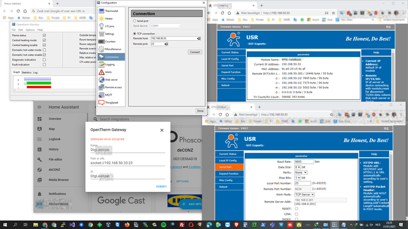

Hoi hoi
Ik ben ook aan mijn HA/OTGW verhaal begonnen :-)
Op zich loopt de start niet slecht, maar bij de HA integratie loopt het fout.
Afbeeldingslocatie: https://tweakers.net/i/qzLuxXPtKmGhUCrwsCq36EOK6ko=/800x/filters:strip_exif()/f/image/4Fj70iukV5YHACie8JVIgsvQ.png?f=fotoalbum_large
(btw; in de screenshot
192.168.50.183 = windows PC succesfully using Openthem Monitor (wifi)
192.168.50.10 = Home assistant (cable)
192.168.50.33 = OTGW (cable) )
De setup is Vallaint met VR33 <> OTGW <> Honeywell round modulation
De logs leren me dat een paketje/waarde (DATA_SLAVE_MAX_CAPACITY) verkeerd verwerkt wordt ...
Logger: aiohttp.server
Source: components/opentherm_gw/config_flow.py:55
First occurred: 12:37:38 AM (1 occurrences)
Last logged: 12:37:38 AM
Error handling request
File “/usr/local/lib/python3.8/site-packages/aiohttp/web_protocol.py”, line 422, in _handle_request
resp = await self._request_handler(request)
File “/usr/local/lib/python3.8/site-packages/aiohttp/web_app.py”, line 499, in _handle
resp = await handler(request)
File “/usr/local/lib/python3.8/site-packages/aiohttp/web_middlewares.py”, line 118, in impl
return await handler(request)
File “/usr/src/homeassistant/homeassistant/components/http/security_filter.py”, line 56, in security_filter_middleware
File “/usr/src/homeassistant/homeassistant/components/http/request_context.py”, line 18, in request_context_middleware
File “/usr/src/homeassistant/homeassistant/components/http/ban.py”, line 72, in ban_middleware
File “/usr/src/homeassistant/homeassistant/components/http/auth.py”, line 127, in auth_middleware
File “/usr/src/homeassistant/homeassistant/components/http/view.py”, line 129, in handle
result = await result
File “/usr/src/homeassistant/homeassistant/components/config/config_entries.py”, line 169, in post
return await super().post(request, flow_id)
File “/usr/src/homeassistant/homeassistant/components/http/data_validator.py”, line 60, in wrapper
result = await method(view, request, *args, **kwargs)
File “/usr/src/homeassistant/homeassistant/helpers/data_entry_flow.py”, line 106, in post
result = await self._flow_mgr.async_configure(flow_id, data)
File “/usr/src/homeassistant/homeassistant/data_entry_flow.py”, line 155, in async_configure
result = await self._async_handle_step(flow, cur_step[“step_id”], user_input)
File “/usr/src/homeassistant/homeassistant/data_entry_flow.py”, line 213, in _async_handle_step
result: Dict = await getattr(flow, method)(user_input)
File “/usr/src/homeassistant/homeassistant/components/opentherm_gw/config_flow.py”, line 60, in async_step_init
res = await asyncio.wait_for(test_connection(), timeout=10)
File “/usr/local/lib/python3.8/asyncio/tasks.py”, line 494, in wait_for
return fut.result()
File “/usr/src/homeassistant/homeassistant/components/opentherm_gw/config_flow.py”, line 55, in test_connection
status = await otgw.connect(self.hass.loop, device)
File “/usr/local/lib/python3.8/site-packages/pyotgw/pyotgw.py”, line 139, in connect
await self.get_status()
File “/usr/local/lib/python3.8/site-packages/pyotgw/pyotgw.py”, line 383, in get_status
v.DATA_SLAVE_MAX_CAPACITY: int(capmodlimits[0]),
ValueError: invalid literal for int() with base 10: ‘0.00’
De OTGW komt van nodo - deze week geleverd
Kan ik een manuele config aanmaken om de DATA_SLAVE_MAX_CAPACITY over te slaan ? OT monitor op windows doet alles correct. Is dit dan een bug ? Als ik het goed begrijp kan ik via MQTT ook communiceren ? (ik heb nog niks met MQTT op staan)
Het doel is monitoring en manuele setpoint override ...
Alle hulp is welkom - thx

  • sjorsjuhmaniac
  • Laatst online: 08:07
ebx schreef op maandag 1 februari 2021 @ 01:54:
Hoi hoi
Als ik naar de source kijk vermoed ik dat dit komt door de firmware upgrade van PIC == otgw zelf. De otgw code is geupdate ~ 2weken terug en het PS commando geeft sinds v5.0 een andere reeks data terug. De error is namelijk dat de data niet naar een int geconverteerd kan worden.
Welke versie firmware draaitje otgw? Zou je in the OTMonitor log tabje moeten kunnen zien. Anders kan je een PR=A commando sturen om het op te vragen.
De oplossing voor nu zou zijn om:
- een bug rapport op de mvn23/pyotgw github repo posten en kijken wat ze zeggen
- of een oude versie firmware op de pic te flashen
- of naar een mqtt oplossing te gaan
- als een tweaker via de developer ssh inloggen op de HA core en de source pyotgw.py aanpassen door de value naar een float en dan een int te casten. Ik denkt dat hij nu als string gepakt wordt.
*geen idee of deze libraries in HA aangepast kunnen worden, mogelijk dat dit in een van de images staat waardoor je het niet kan aanpassen.
v.DATA_SLAVE_MAX_CAPACITY: int(float(capmodlimits[0])),
[ Voor 13% gewijzigd door sjorsjuhmaniac op 01-02-2021 03:00 ]

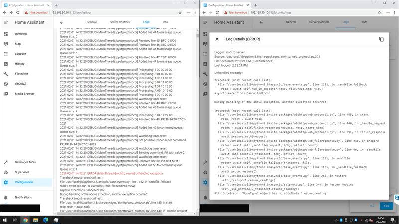

Helaas is mijn probleem nog niet opgelost - HA maakt verbinding maar kan geen enkele waarde lezen :-(
Ik kan mijn volgend probleem beginne oplossen ...
Afbeeldingslocatie: https://tweakers.net/i/xk7pke6Tw2AqJTkF2Aa06bVwFV4=/800x/filters:strip_exif()/f/image/l0RFyWEPeIVirgHgPRYVp1JU.png?f=fotoalbum_large
Afbeeldingslocatie: https://tweakers.net/i/rxOhWHVOrW79E27Nkfcyrp0TMS8=/800x/filters:strip_exif()/f/image/JEQd0y6ajjbgAIlPjE3HlUqU.png?f=fotoalbum_large
Ik kan mijn volgend probleem beginnen oplossen ...

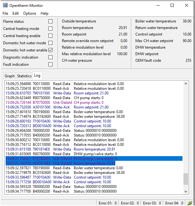

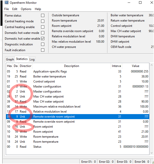

Zouden die "Unknowns" hier de oorzaak kunnen zijn ? Elk commando dat succesvol is wordt vergezeld van een unknown. Hoort dit zo te zijn ?
Afbeeldingslocatie: https://tweakers.net/i/Bq8QrtSMZThVRDVTKclBbx60CcA=/full-fit-in/4000x4000/filters:no_upscale():fill(white):strip_exif()/f/image/pbMDatjliD5OGpRzr6y3xU6C.png?f=user_large
Afbeeldingslocatie: https://tweakers.net/i/puVToXt0YX7o4E6fAp-xIHfx08w=/full-fit-in/4000x4000/filters:no_upscale():fill(white):strip_exif()/f/image/XFUkKDbRH0gwco4VUGu6RN9E.png?f=user_large
Die unknowns zijn vreemd. Je krijgt wel een data-id maar geen juiste data. Dit is precies elke keer na een commando?
Is dit hetzelfde als je ook een commando via OTMonitor verstuurd?

  • Reley
  • Laatst online: 09:20
Reley
Zoom Zoom
sjorsjuhmaniac schreef op woensdag 24 februari 2021 @ 09:30:
Hmm... dat is toch vreemd want mqtt via OTMonitor werkt 'wel goed'. Kreeg je foutmeldingen? Welke versie OTMon draai je?
Net even op de pi geupgrade naar 5.1
Gateway zelf draait nog 4.3 ivm die incompatibiliteit, maar ik vermoed dat dat niet geld als ik het via MQTT wil doen.
MQTT staat aan en ingesteld, maar in HA komt er niets binnen...
Dat terwijl andere MQTT devices wel werken... (ESPHOME en gegevens van een P1 monitor)
Zie wel in een log:
Timed out waiting for command: PR, value: M.
10:30:01 – /usr/local/lib/python3.8/site-packages/pyotgw/pyotgw.py (ERROR) - bericht kwam voor het eerst om 23 februari 2021 14:06:42 en verschijnt 6717 keer
Disconnected: None
10:29:58 – /usr/local/lib/python3.8/site-packages/pyotgw/protocol.py (ERROR) - bericht kwam voor het eerst om 23 februari 2021 14:08:21 en verschijnt 479 keer
Log toegevoegd
[ Voor 30% gewijzigd door Reley op 24-02-2021 10:32 ]
  • sjorsjuhmaniac
Reley schreef op woensdag 24 februari 2021 @ 10:24:
OK, je mqtt setup werkt in het algemeen dus wel goed.
Let op: mqtt via OTMon heeft GEEN HA mqtt discovery. Dit betekend dat je niet automagisch al je devices in HA te zien krijgt. Je moet ze handmatig in de yaml als sensoren toevoegen.
py-otgw-mqtt, met de aanpassingen die ik eerder linkte, heeft dat wel.
Zie wel in een log:
Disconnected: None
Log toegevoegd
De error is van de OTGW HA integratie en die "heb je niet meer nodig" als mqtt werkt. Ik weet niet hoe die integratie precies werkt maar mogelijk gooit die ook roet in het eten. Kun je die uit zetten of verwijderen als je met mqtt test? (nadat je handmatig een sensor hebt toegevoegd)
[ Voor 4% gewijzigd door sjorsjuhmaniac op 24-02-2021 11:17 ]
